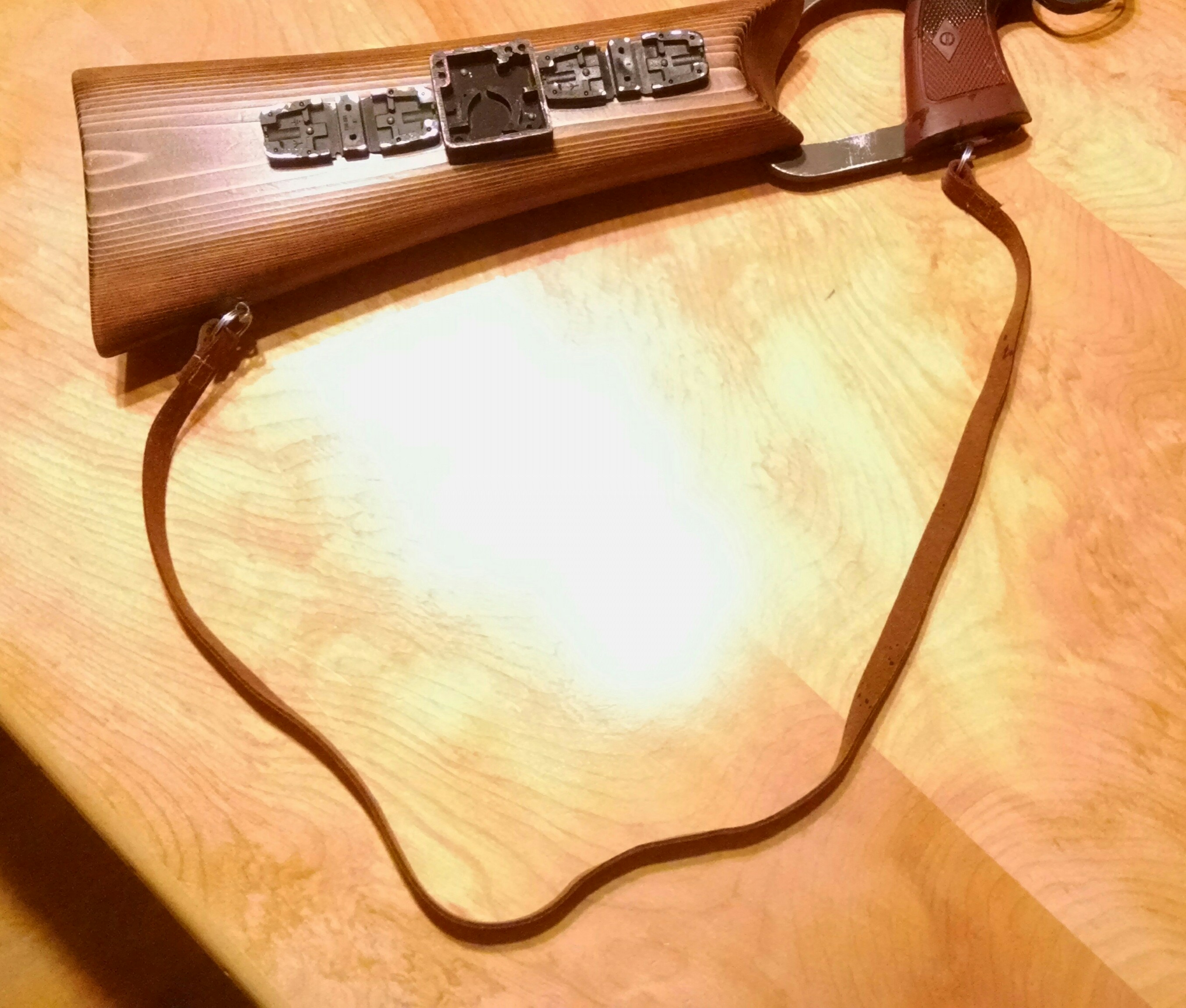

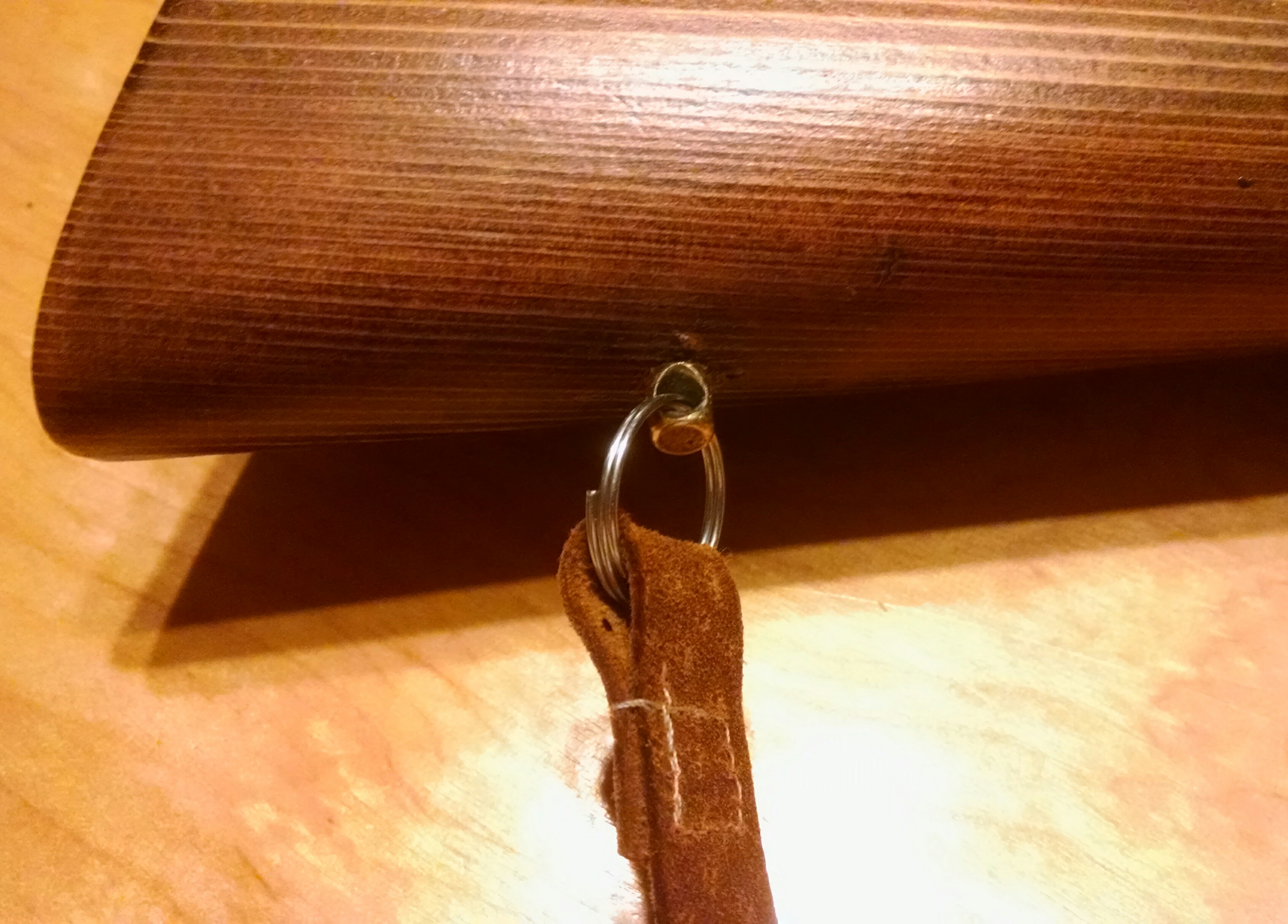

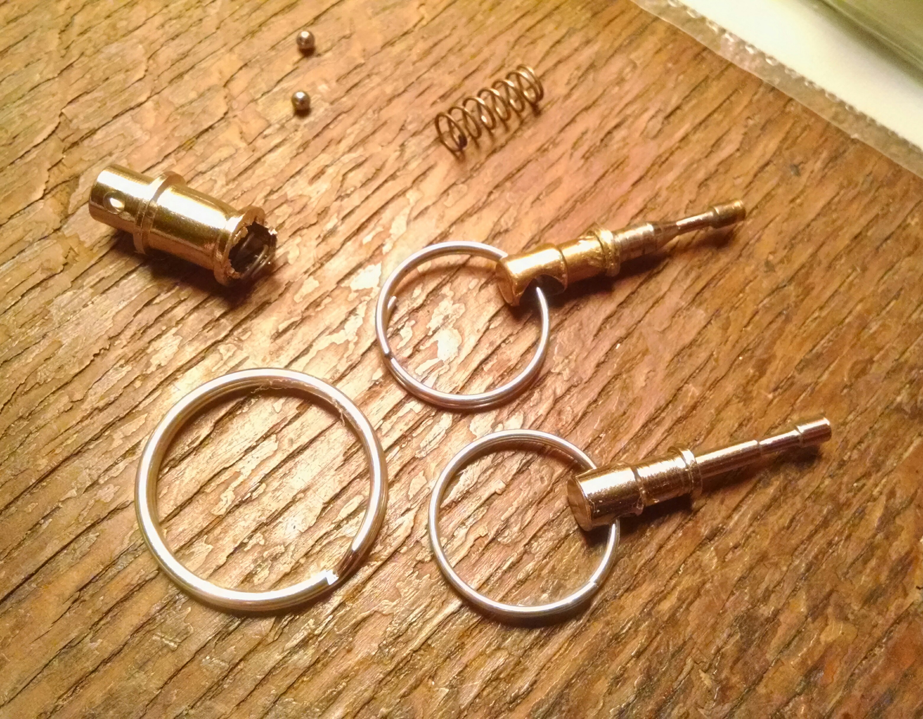

Made a little progress on my EE-3. Cannibalized some key rings to get the little swivel things, then some filing to remove a shouldered part, and some careful drilling and epoxy to mount them in my stock and handle. Re-purpoosed a broken binocular case strap for its pigskin, restored with some hubbard's shoe grease to make it supple again, and eyeballed the length at around 27". I sewed the ends into loops rather than tying the strap though itself so as not to tear eventually. Very happy with the results.
Looks great Greg. I had problems with my rifle sling coming off, I caught it on my knees or something and pulled it off. I intend to sew it with a couple of hidden stitches. Your stock turned out great!

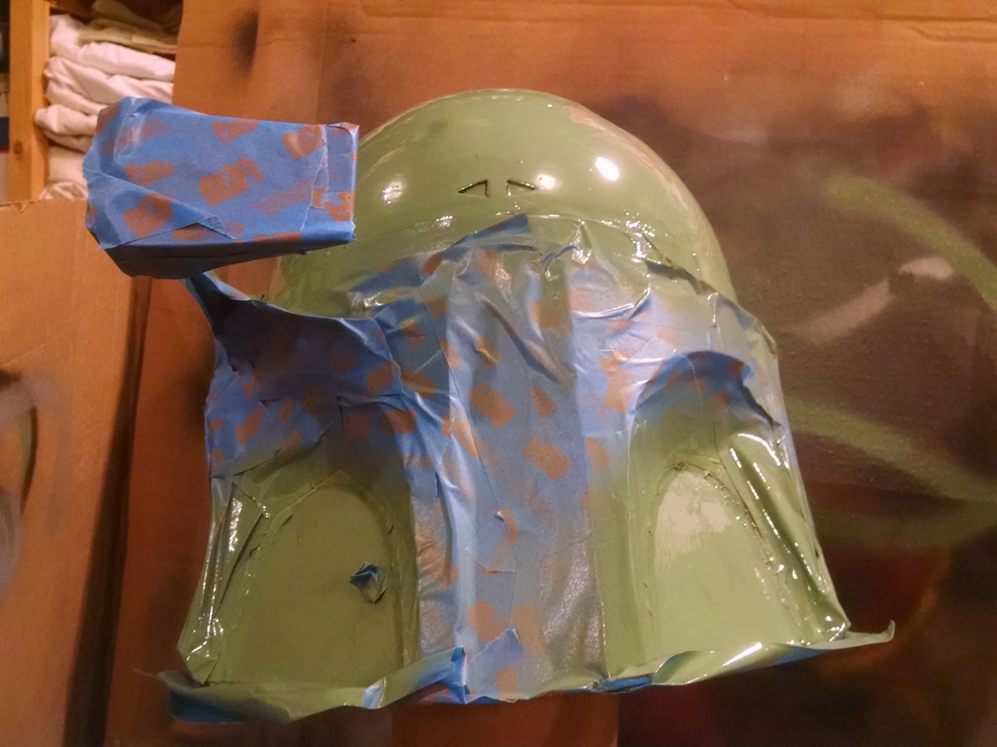

And more recently I switched to Moss Green for my dome and cheeks:

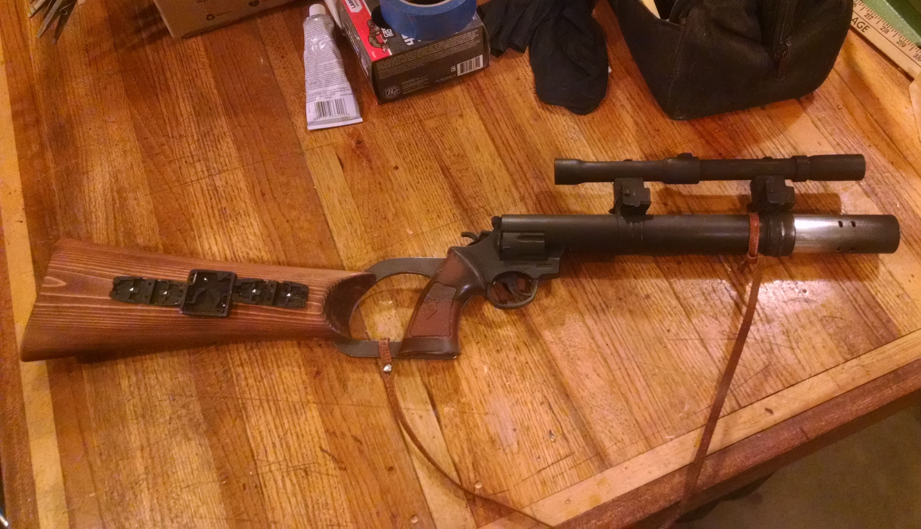

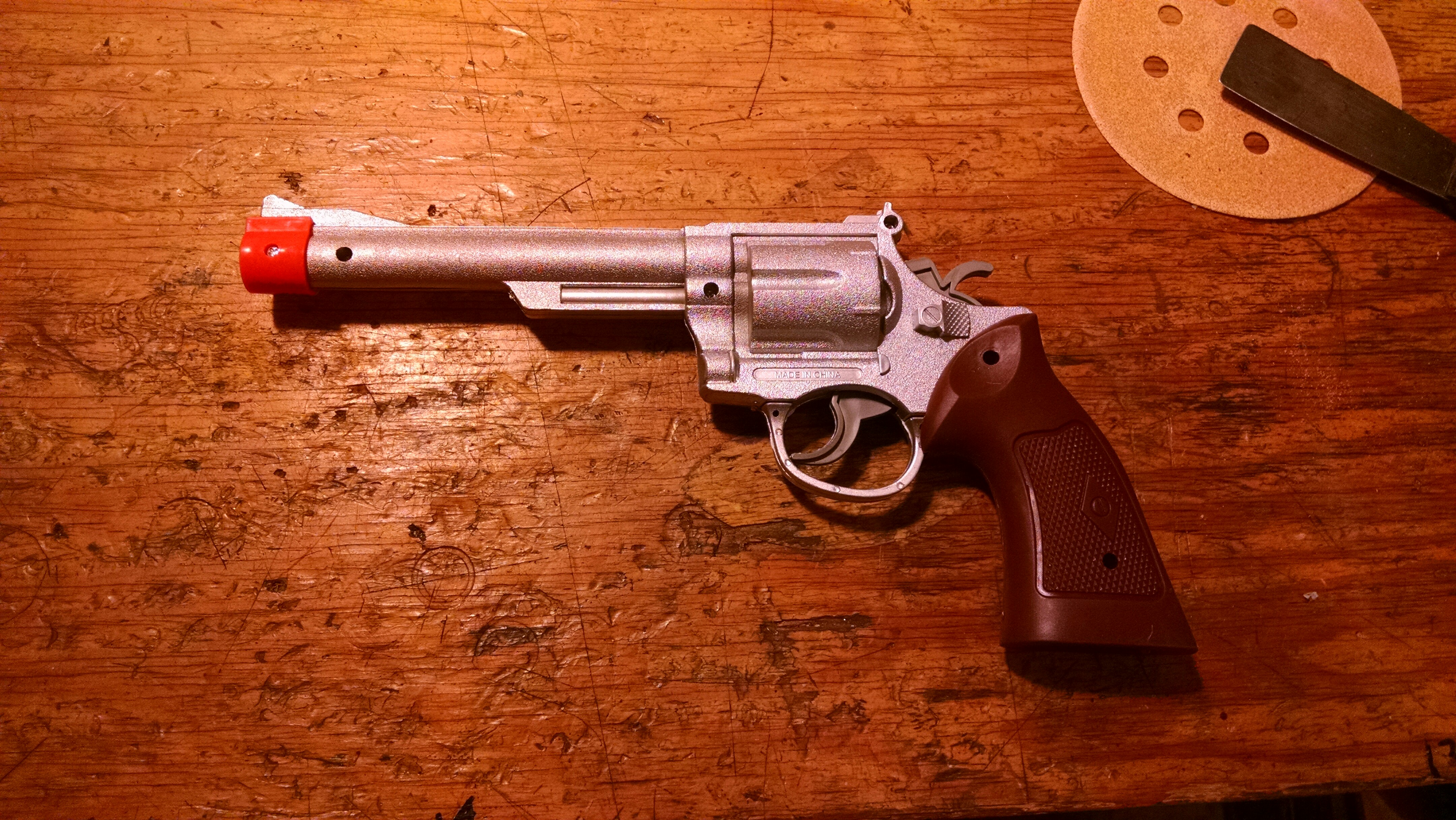

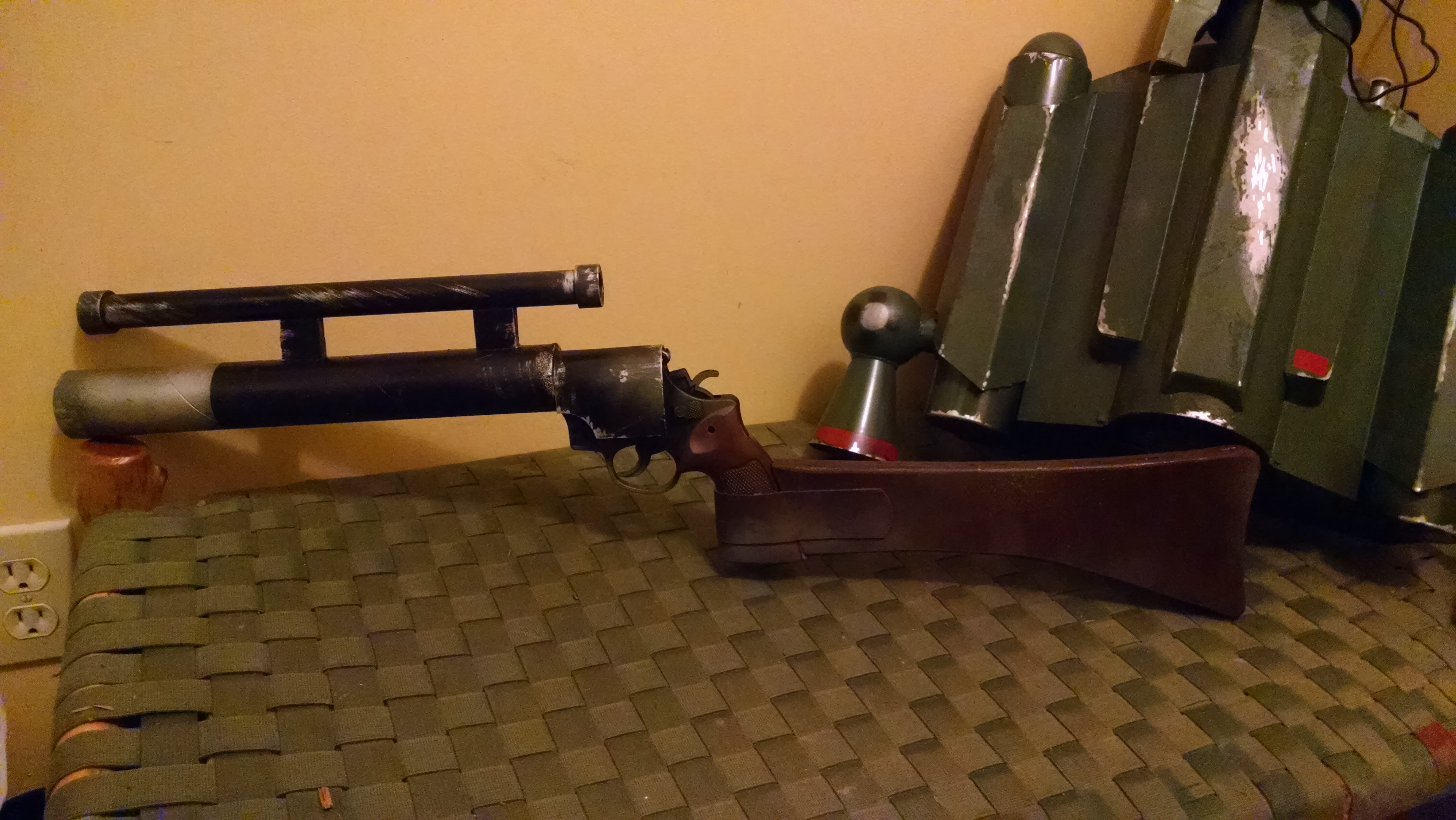

Thanks guys, the base gun is a western style plastic revolver from a seasonal costume shop. Cost about $7 (overpriced), the trigger moves and the hammer moves as well.
I added cardboard barrel, pvc scope, some cardboard parts, foamcore posterboard stock, good for halloween but not near accurate.
Later I swapped in a better scope from pvc conduit parts, a 1.5" ABS sink drain tailpiece barrel, 1.5" chromed brass flash tube drilled according to templates here. Also made a real wood stock, aluminum stock extension. Fellow TDH member sent me some stock greeblies. Sling is old binoculars case strap I had.
Then I used a different wider strap, keychain parts to mount the sling to approximately the right places.
Soon, before our local large convention 3/11, I want to improve the barrel shape by expanding it to the rear so it's tapered, make more accurate scope mounts and a larger stronger handle/breach section. This will delete the original toy gun parts from the prop. It will fit better and be stronger, right now the plastic toy gun parts are near breaking with the added weight of the more realistic parts. I'll add the breach shape and breach greeblies then as well. Eventually, maybe when I'm doing this work, I'll transfer the electronics of my toy ROTJ EE-3 to this, to have sound and LED flash. That's all I have planned.
I estimate my total actual money spent at about $50 including parts and paint. Not including my time of course...

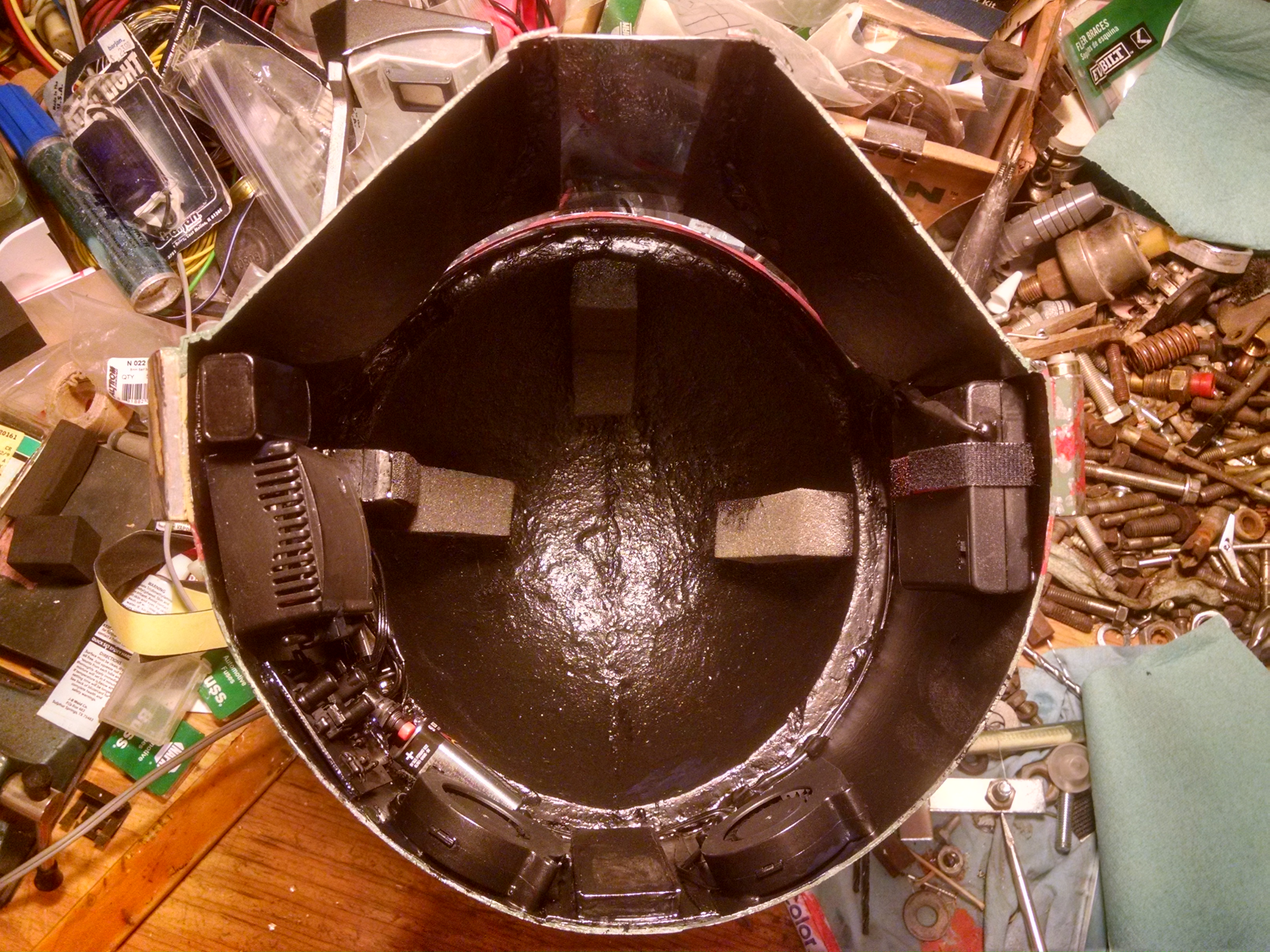

Anyway prior to the troop, I did some updates. I painted the inside of my helmet with some satin black acrylic paint. Make it look very tidy and also sealed some of the exposed Illustration board.

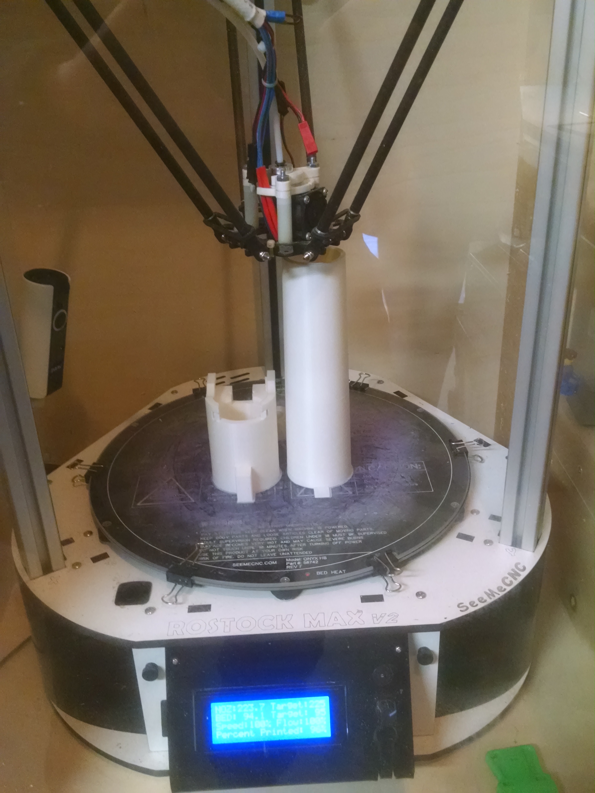

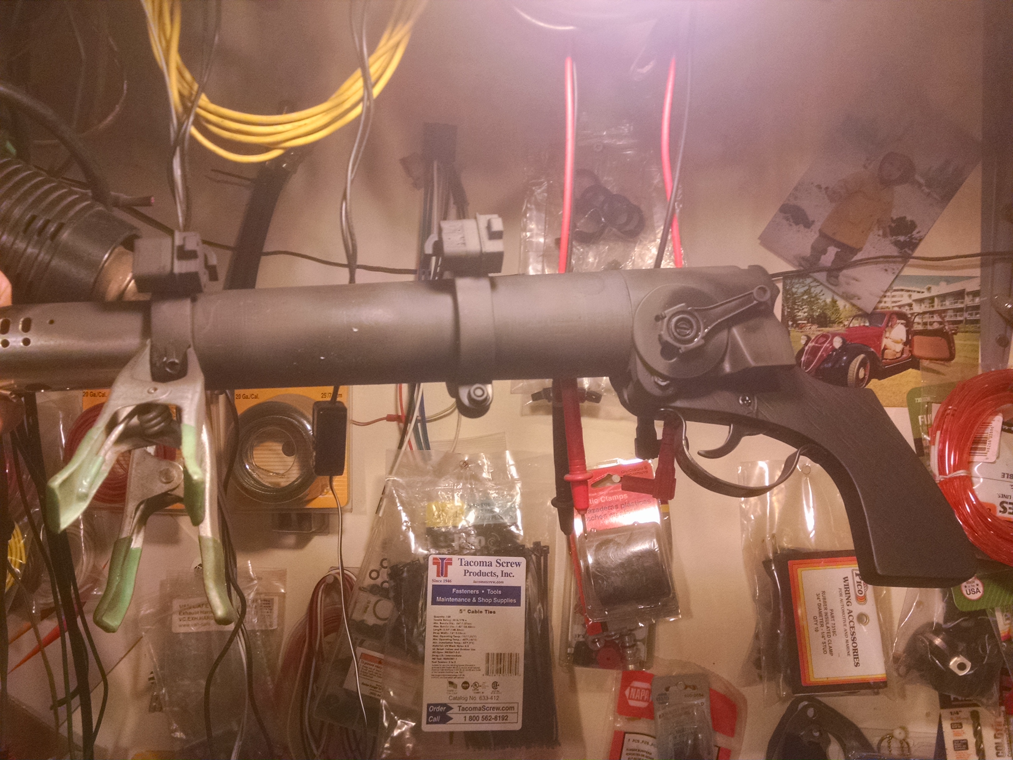

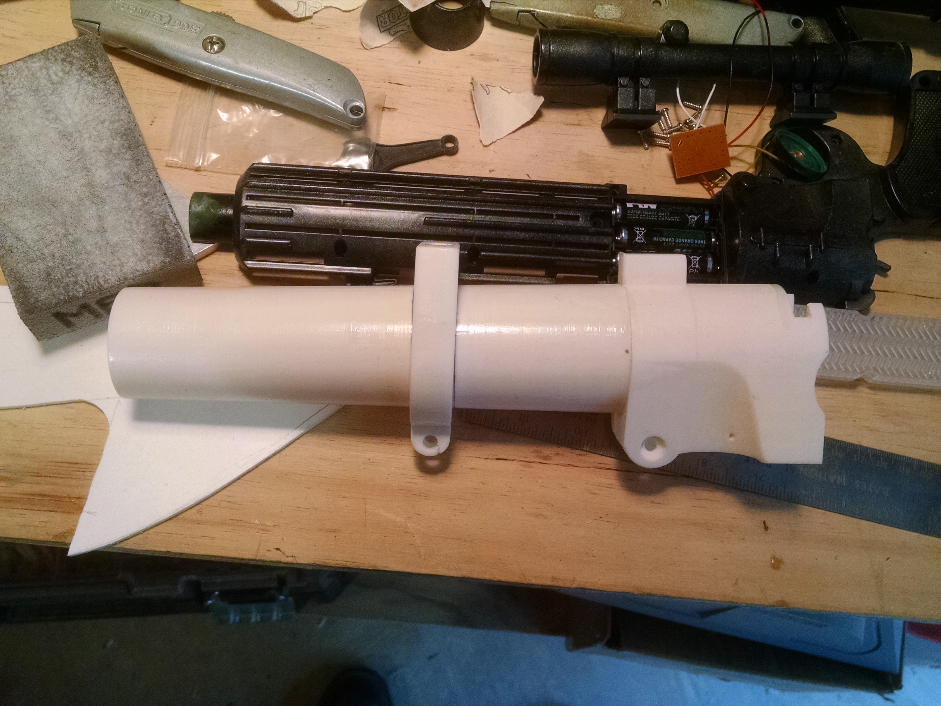

Next I turned my attention to my EE-3. It's been fine but not very accurate up to now, I described how I build it in an above post. I wanted a more accurate barrel, breach, and scope mounts. I tried tapering ABS and PVC pipe by cutting a slit and inserting a wedge, which didn't work. I next tried tapering a 2" ABS pipe on my belt sander, but it overheated and deformed. Next I asked a fellow garrison member if he could 3D print the parts, he did at our next armor party.

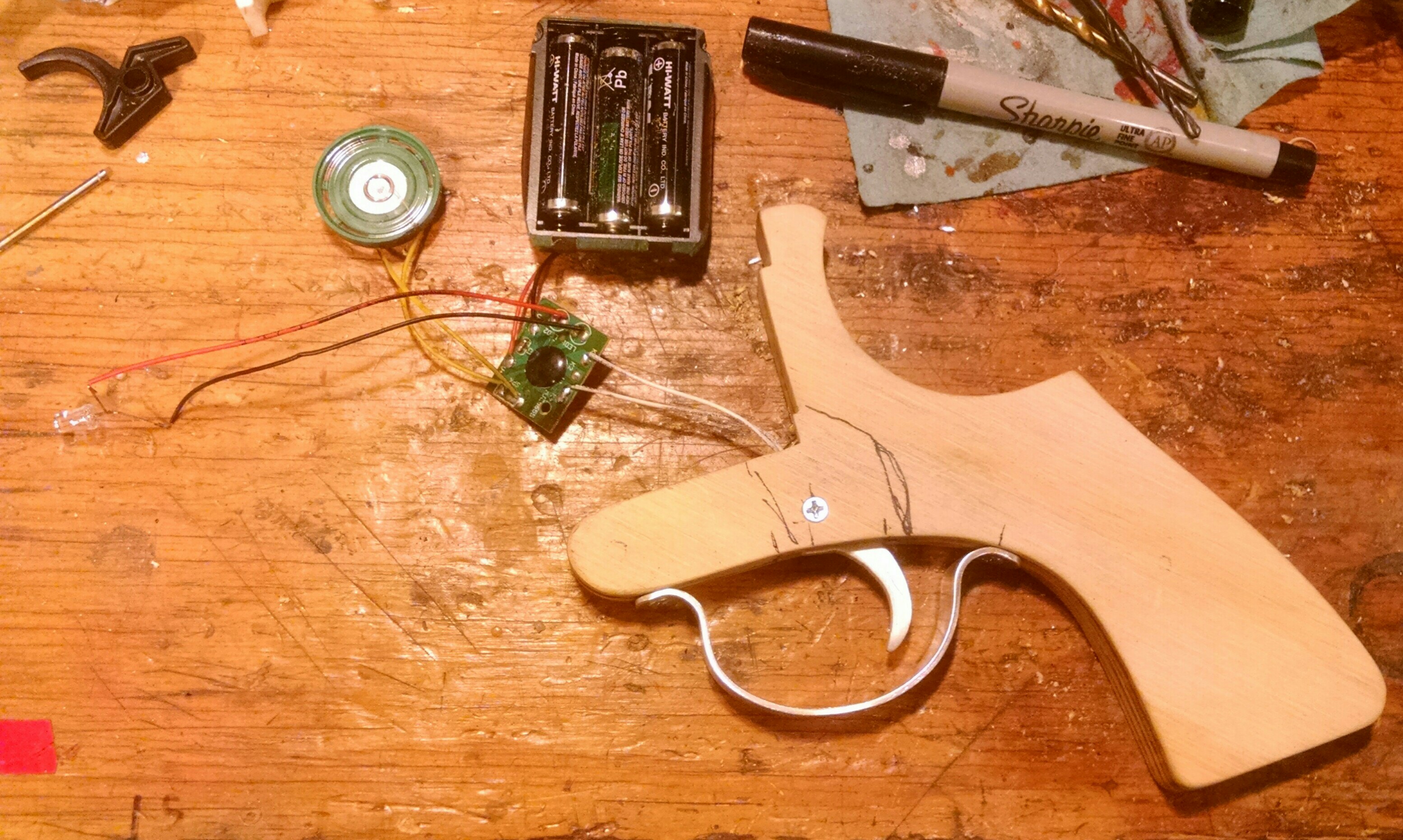

And I made a new handle section from 5/8" plywood. Originally I was going to make it from aluminum but my piece wasn't thick enough. Also fabbed a trigger and trigger guard from aluminum, and started swapping in the electronics from my toy ROTJ blaster.
Made a new flash tube as well so it was long enough to fit into the new barrel and still be long enough. Looking good in black primer:

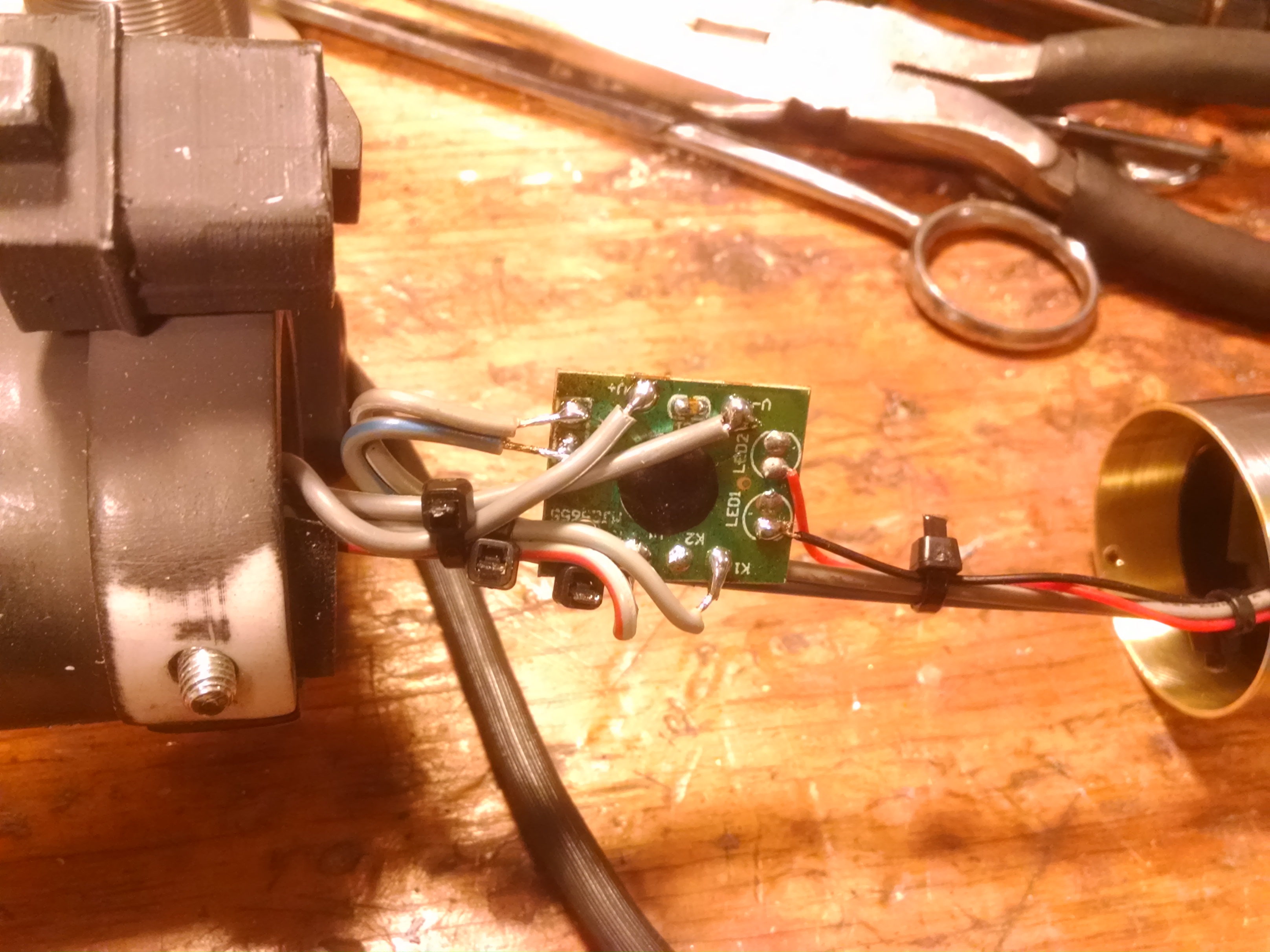

Here's the electronics board. Attached to this I soldered new trigger, speaker and and power wires. I glued the speaker to the flash diffuser (after cutting the diffuser down to make it shorter and fit inside the flash tube) and used a couple of set screws to secure the parts in the front and back. I adapter a 3-AAA battery holder from a flashlight and it slips into the back, like loading a flare, slips into a 1-1/4" drain tailpiece that sleeves in the 3D barrel. The breach is held shut with a small screw.

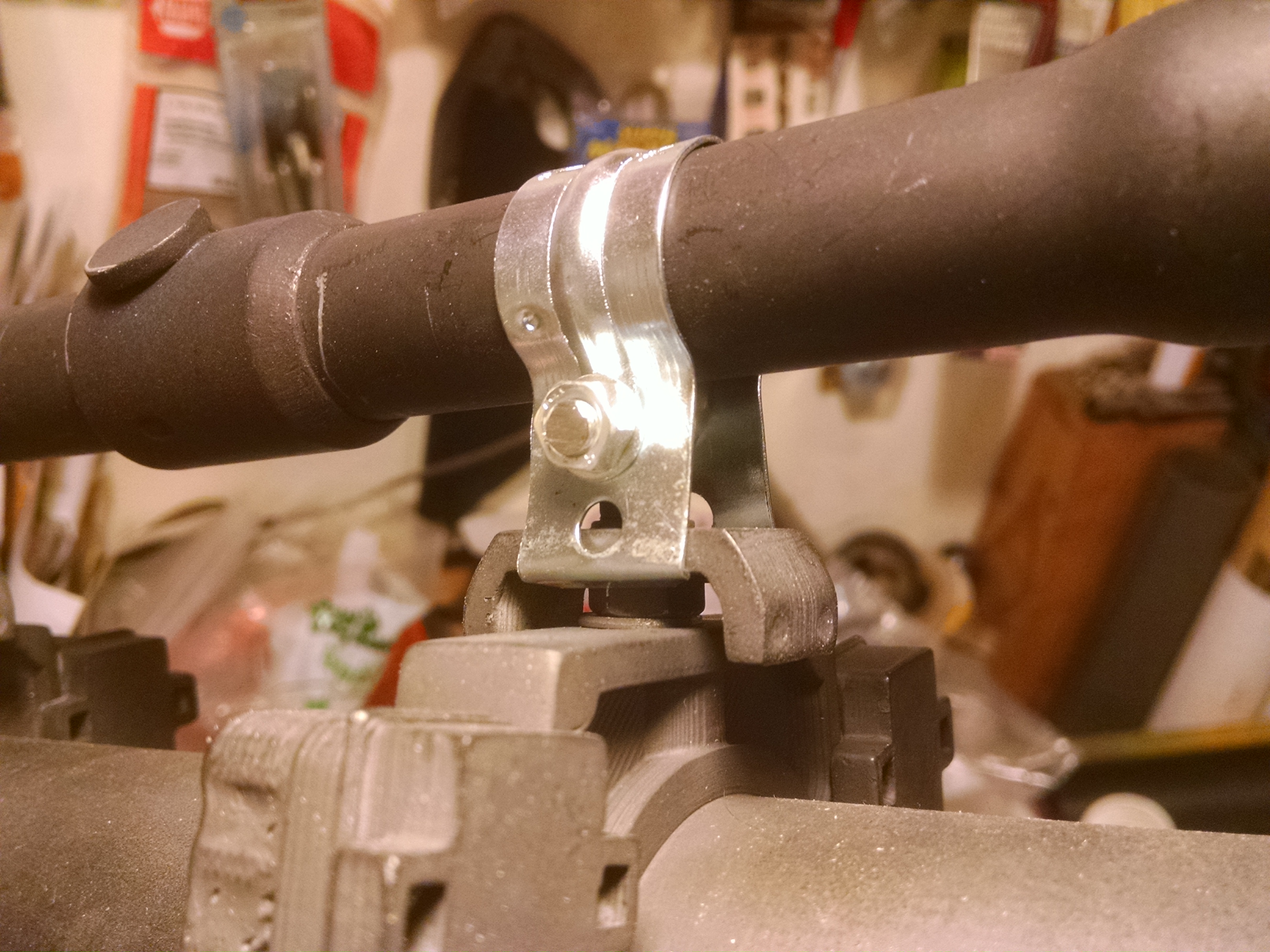

Here's some pipe strap used as scope mounts. Not 100% accurate but worked well enough.
