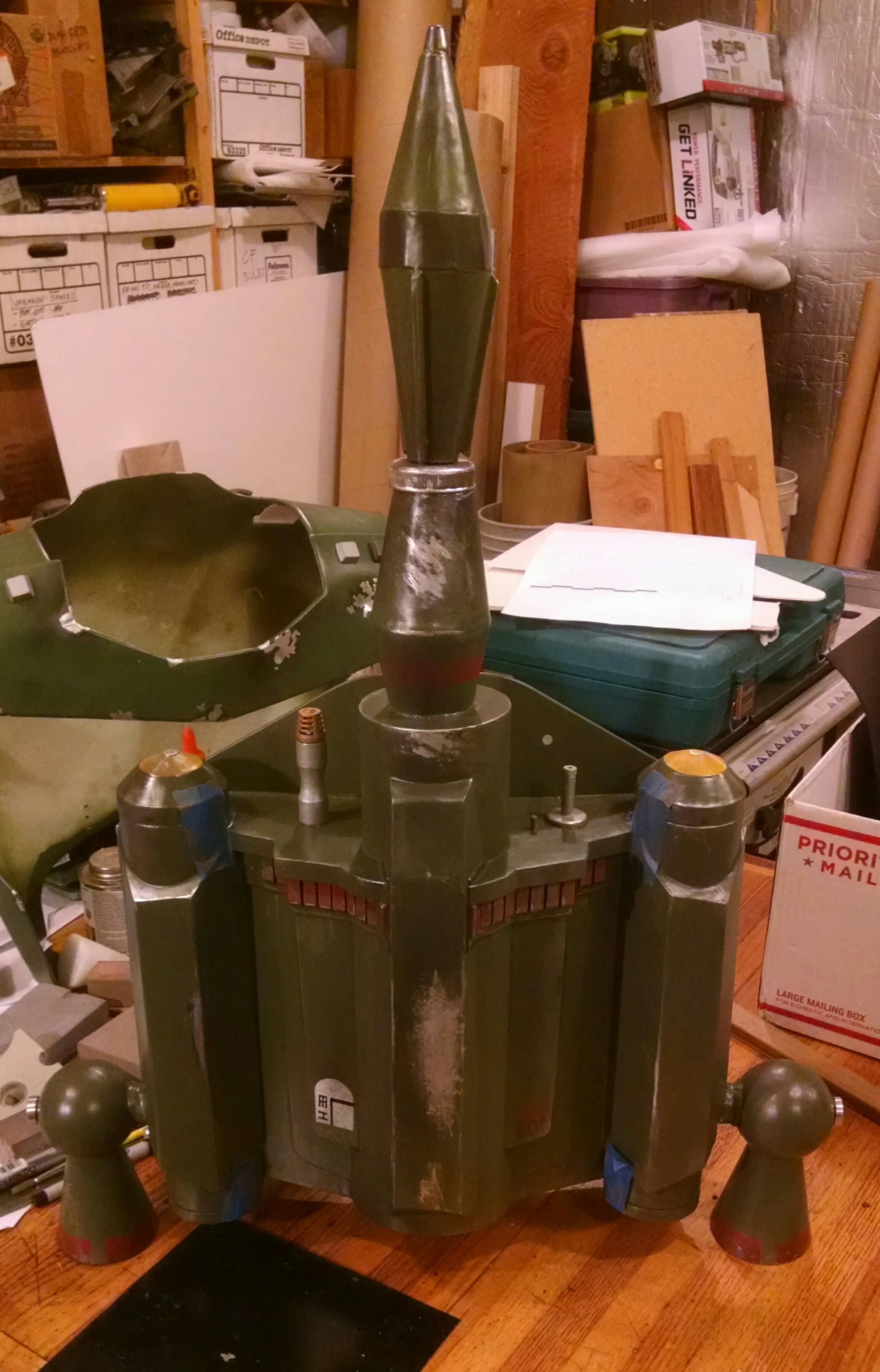

Been busy making improvements. Did some work on my jetpack, adding piano keys and overhang to the top edge, paint details. Made new tank caps of carstock, filled with spray foam, lots of paint.

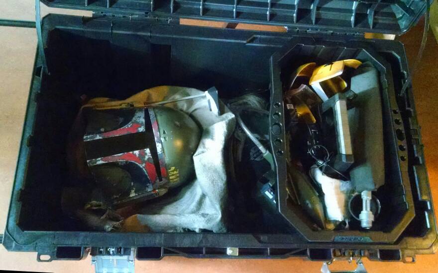

Finally got one of those large wheeled bins, husky brand. My ESB Fett fits in nicely, room to spare.
Last time I stored my costume I broke the surprisingly delicate rocket from its base, so I changed how it mounts to a stud and captive nut method. I tried a couple of different glues and settled on JB weld epoxy, worked great in the end. Added round toothpicks to secure the hooks to the rocket, previously I used nails which were too loose. The toothpicks were a nice press fit.

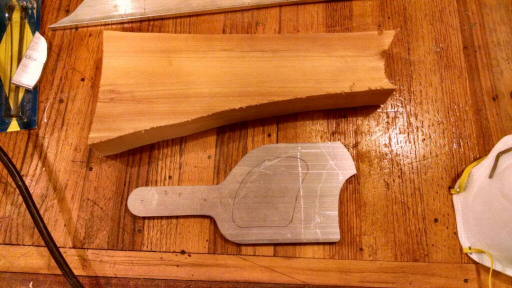

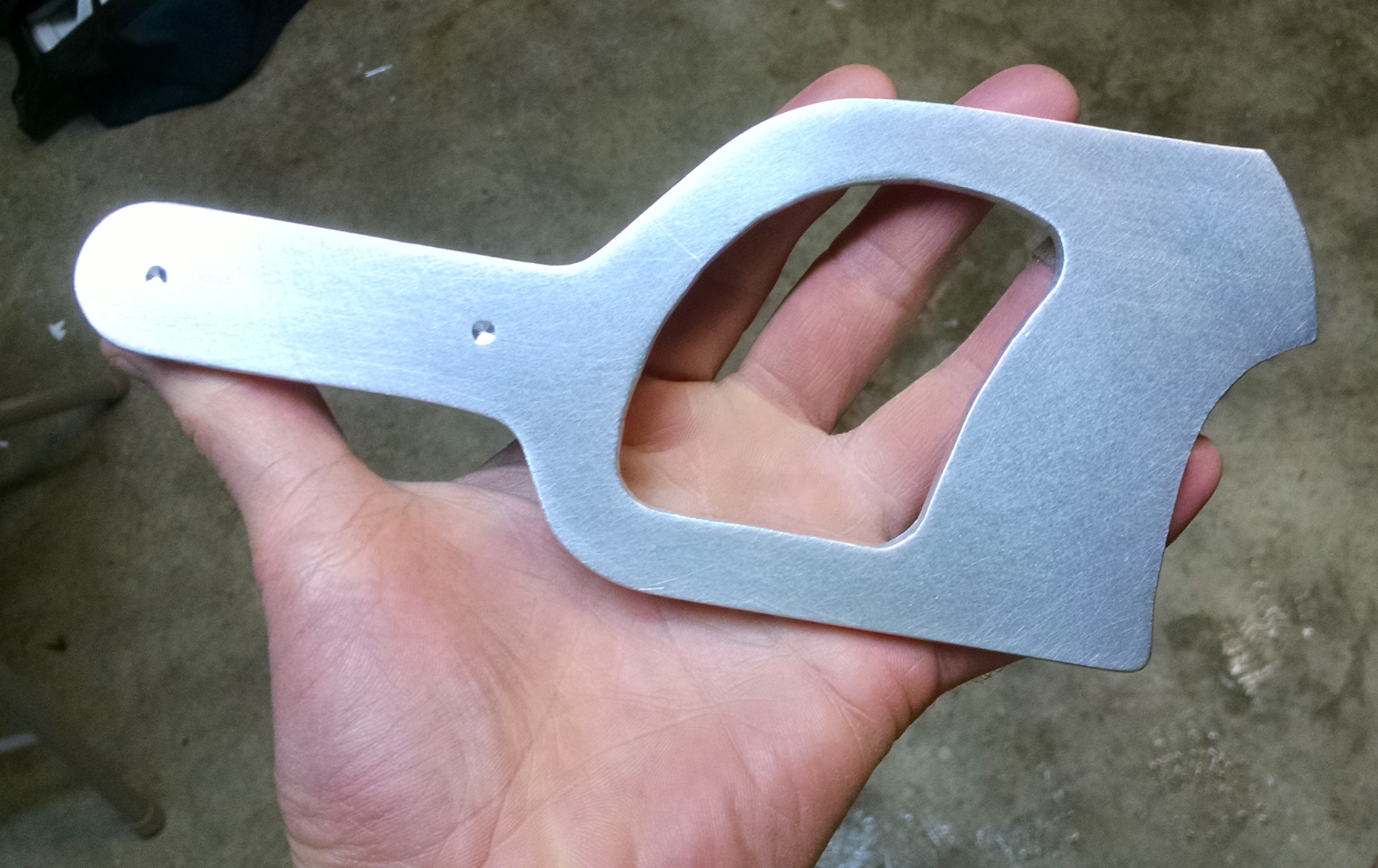

EE-3 progress... I finished the metal part and the stock, and had to rush to get something assembled for my first official 501st troop.

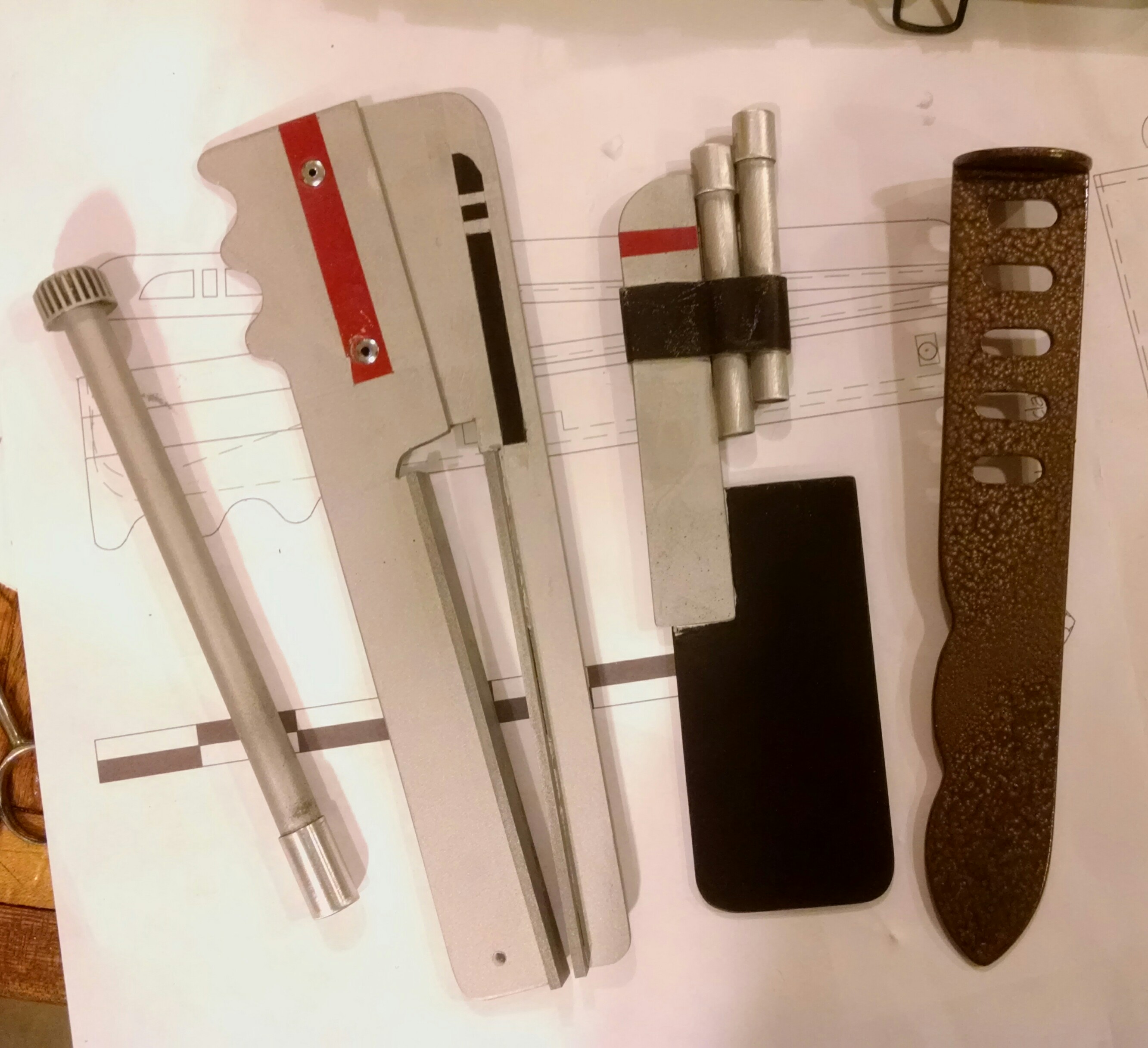

Metal stock-to-grip part, made from 1/4" aluminum flat stock. Cut out on a scrollsaw and finished with dremel tool and sanders.

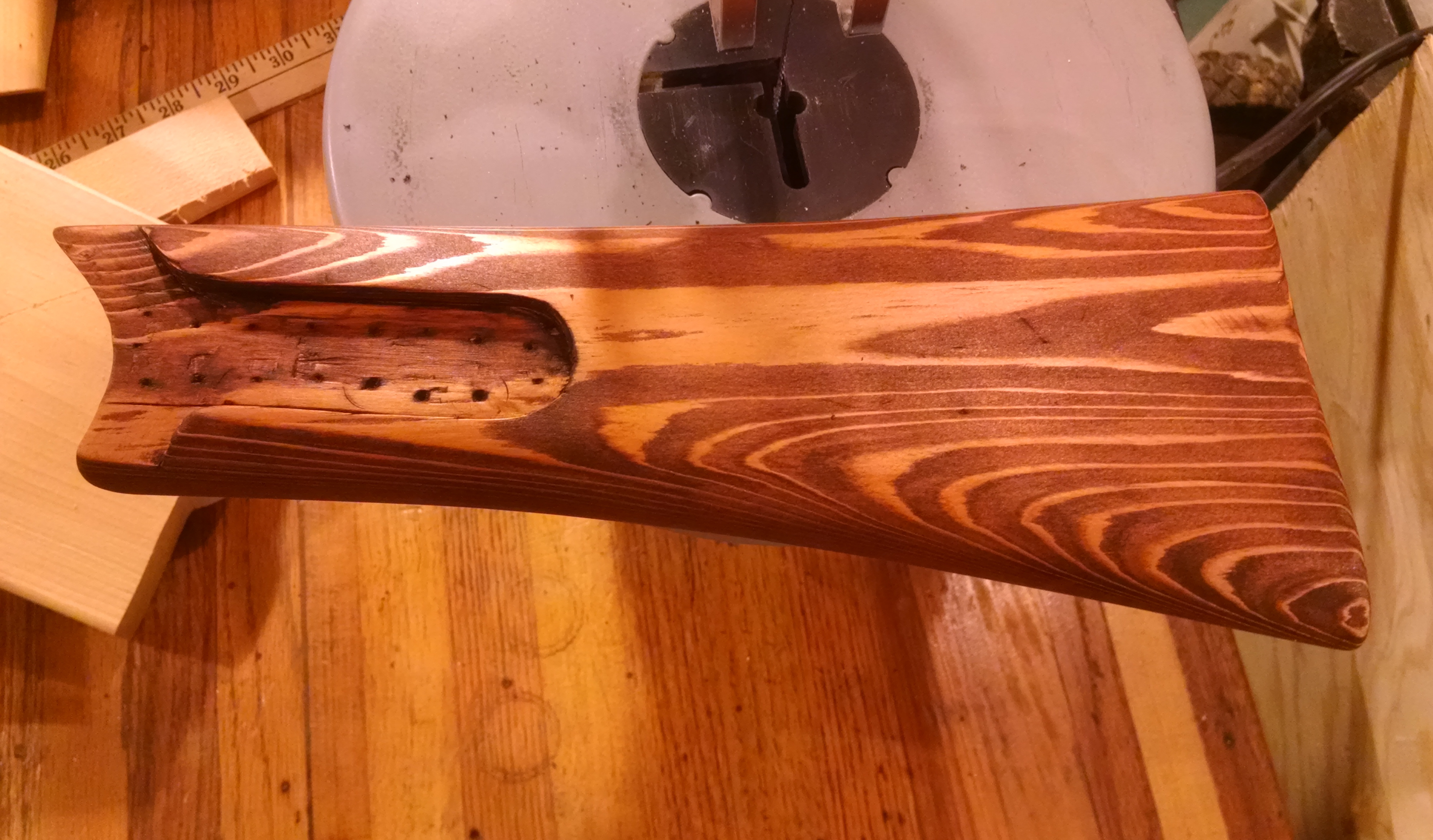

The stock, made from 2x6 cedar (for lightness) and shaped on a belt sander. Mortised using a 1/2" forstner bit and chisels. Stained with Minwax.

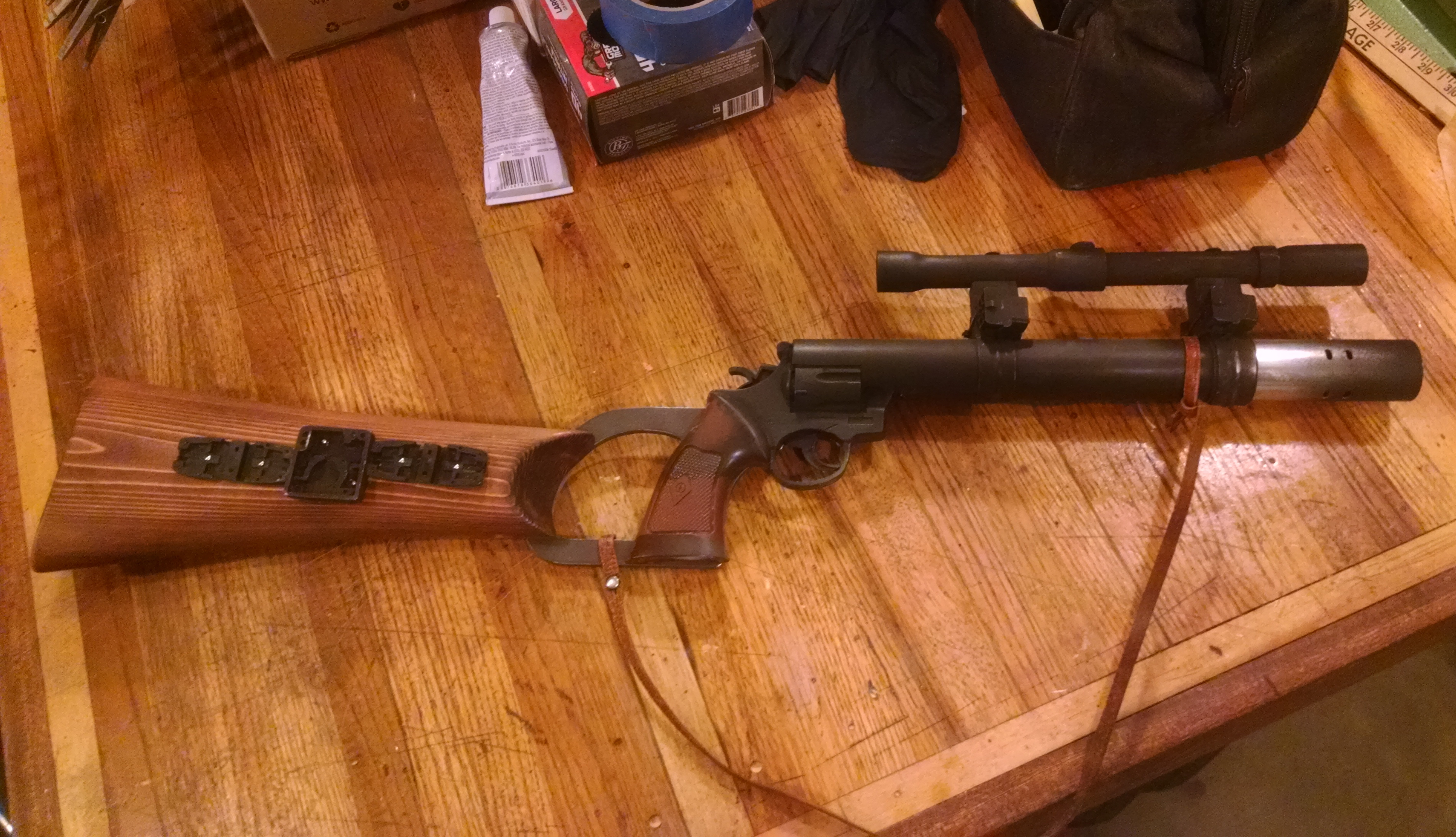

"Scope" made from 1/2" pvc conduit and union. 2 10' lengths of conduit were used to get the bell ends, and mated in the center with the union, which is beveled on one end. One bell end was trimmed short and the resulting ring was used as a detail at the other end. I fashioned adjustment knobs from sintra (not shown, see next pic) and glued them to the scope before painting and mounting with screws and conduit straps to block of wood.
How it all came together. The barrel is 1-1/2" ABS drain tailpiece, and the tip is 1-1/2" chromed brass drain tailpiece drilled according to plans I found on this site. Quicky paint job and strap tied on literally last-minute. Stock greeblies glued on but also pinned with brads since the glue would not be dry before I needed to carry it. Molex connectors tied on with zipties for this troop. V8 rod details not finished for this troop.

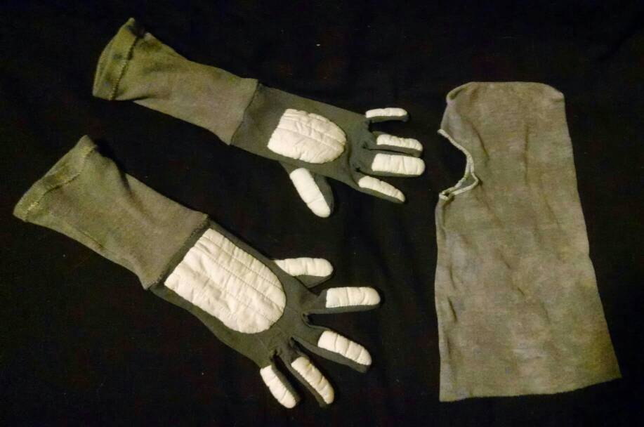

Made some much needed alterations to my gloves. I bought 2 cotton painter's hoods at the hardware store and dyed them gray. Then took one and cut the closed part into two strips, made stretchy cuffs for my gloves. Stitched them by hand last night but wasn't happy with the results.
Dug out a hand-me-down Pfaff sewing machine and learned to use it. Re-sewed the cuffs with plain zigzag stitching, much better. I'll probably enlarge the opening on the remaining hood but my hope is it'll keep kids from remarking they can see my chin.
