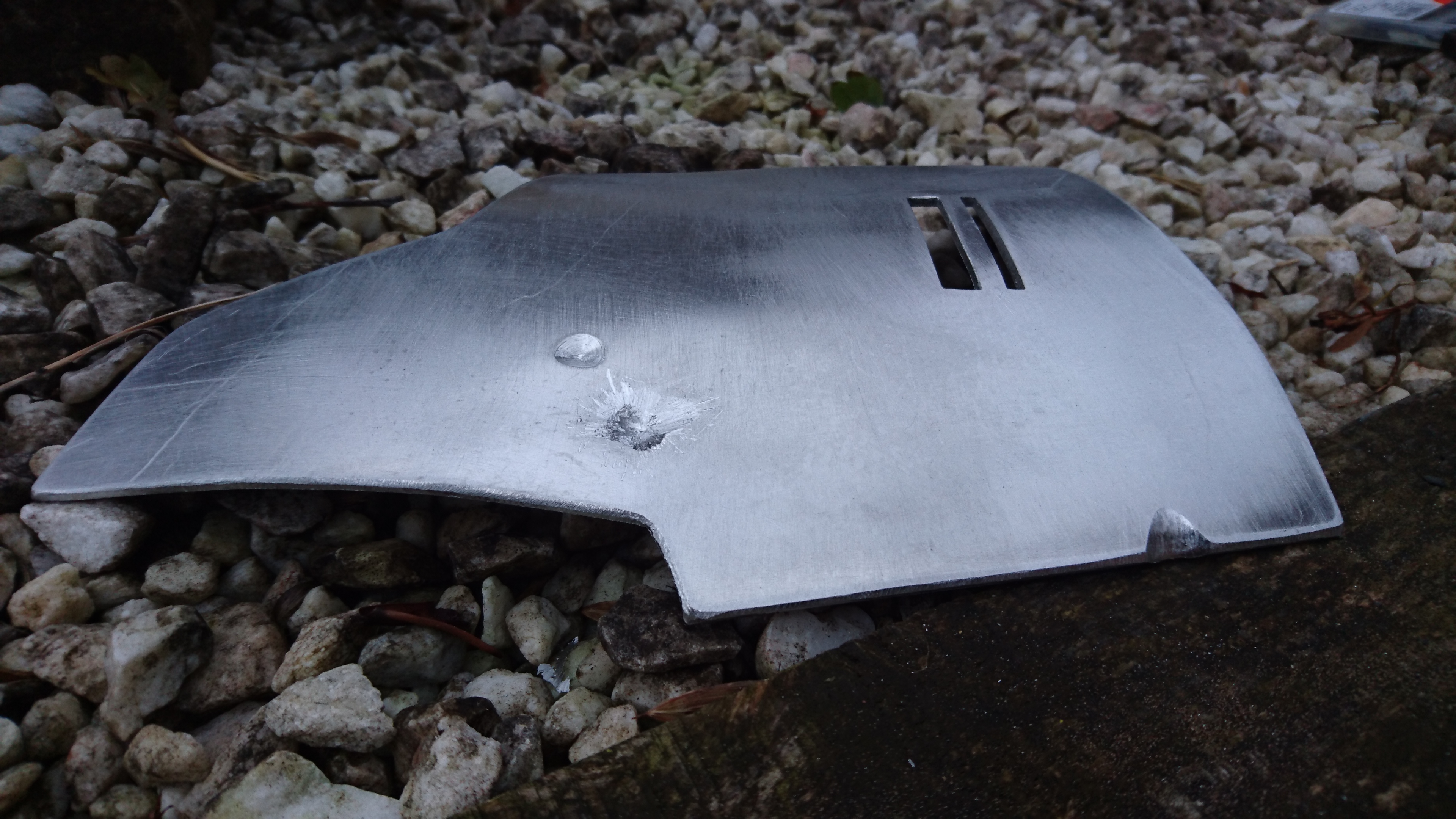

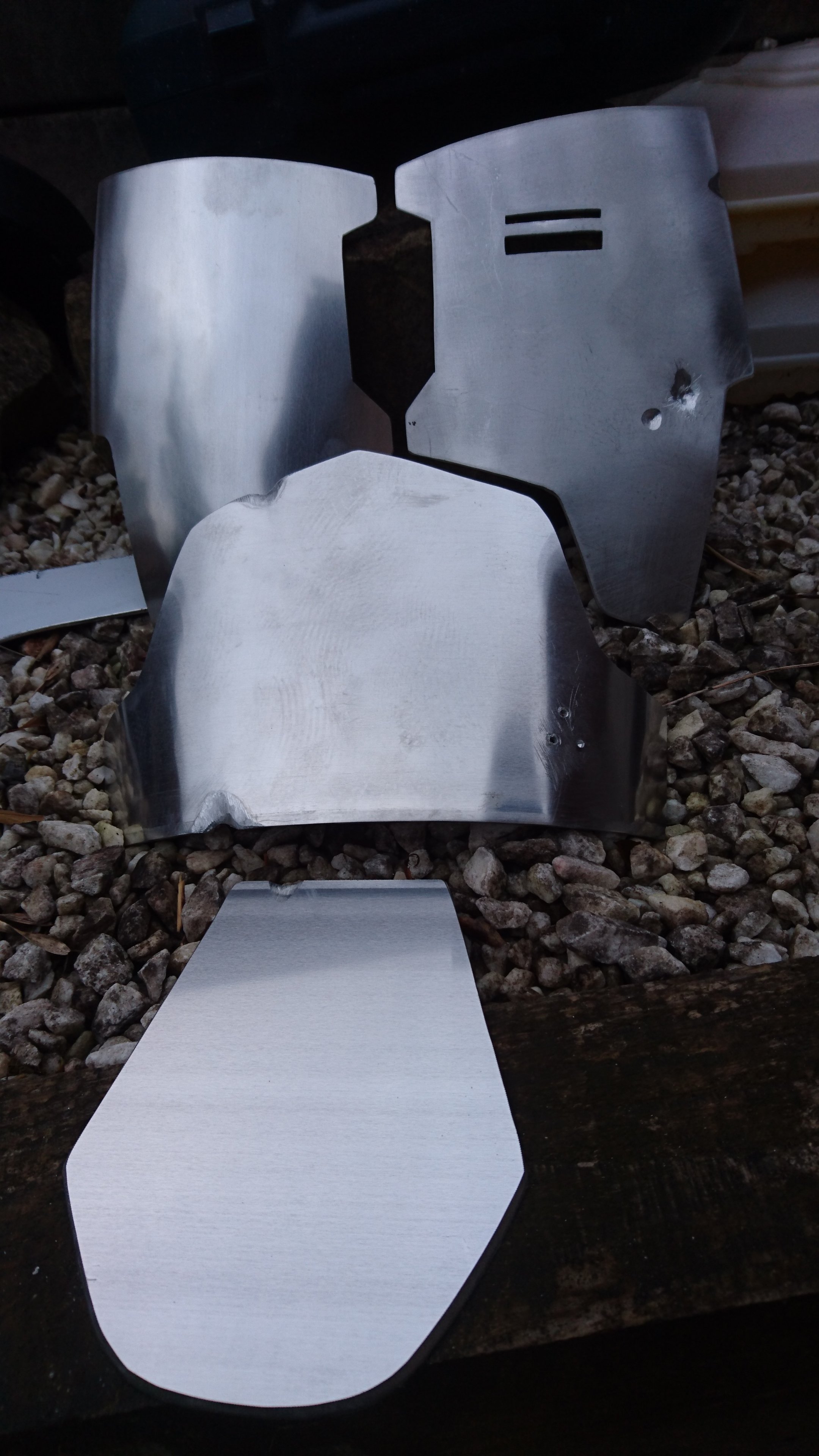

And here are the results of some of the (purposeful) :D damage I managed to do to the aluminium at this point.
I'm not entirely satisfied but with the tools I have, I think it will do for now (the more I look at reference pictures, the more issues I see with my damage so I'll return to them before long...)

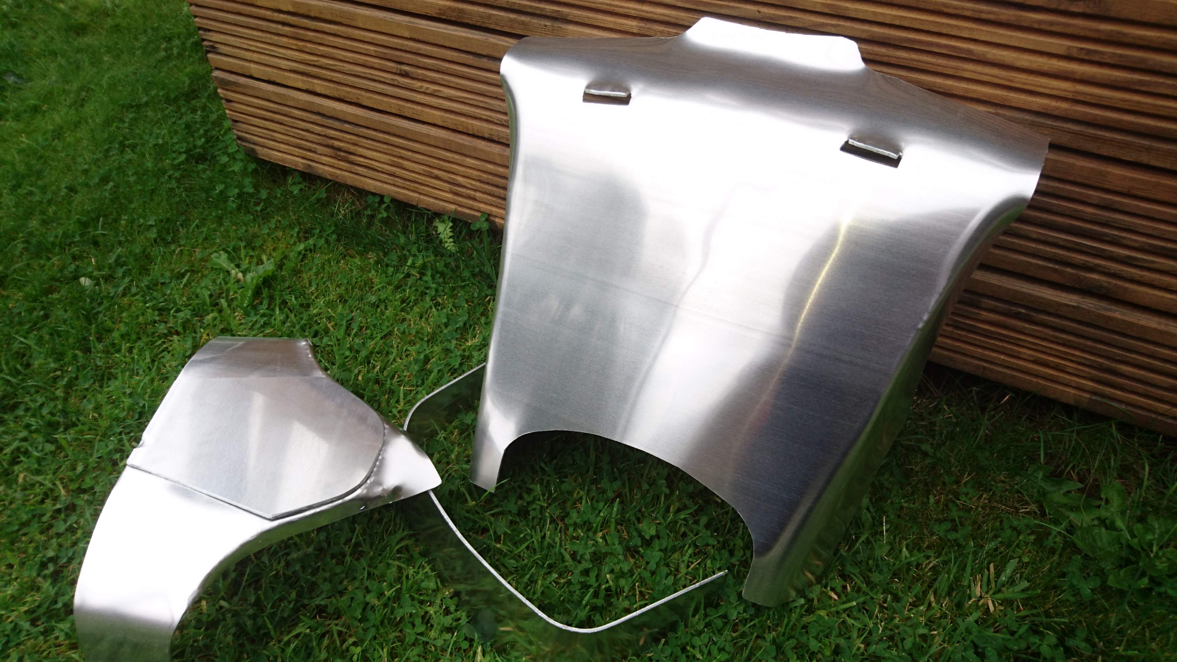

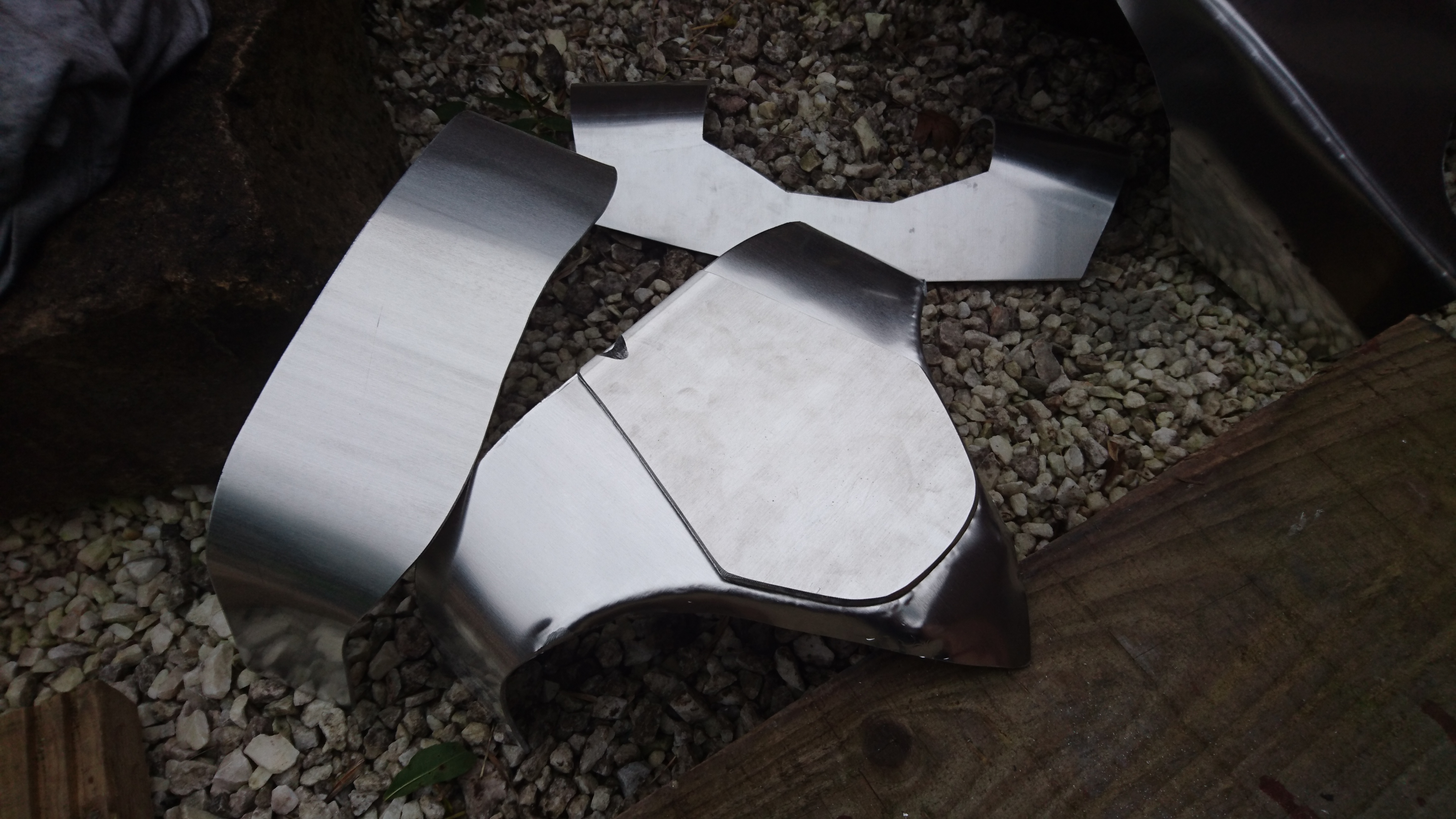

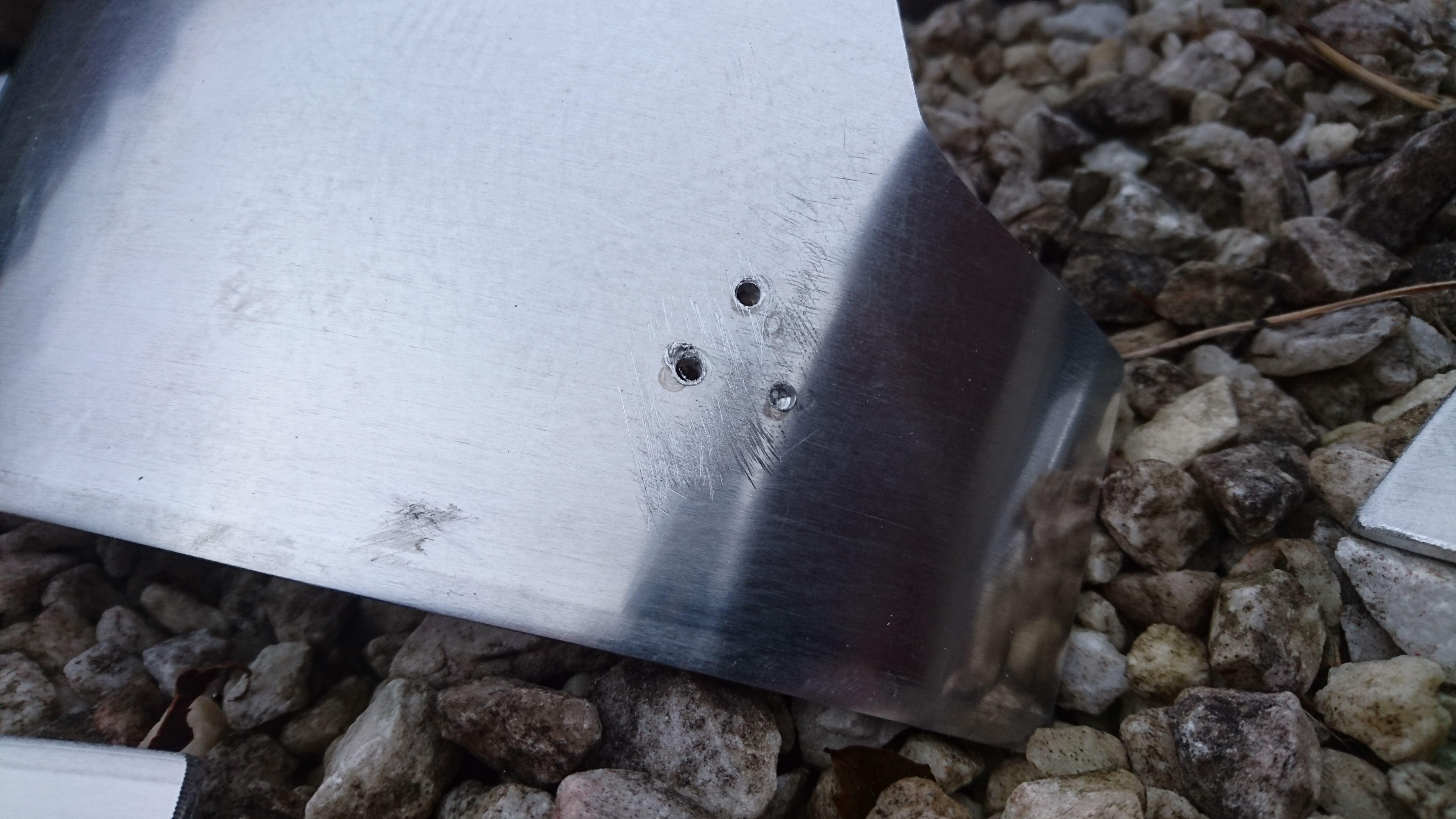

Stomach armour, I hand-filed the edges away to create the damage (I need to take better pics, sorry)
I might fill these stomach armour holes in and try again... not sure they go all the way through in the ESB armour... doh. Maybe I'll just fill them in a little.
I'll do heavier damage to them overall, I just wanted to test what I could do for now.
That's all for now. I hope to give the damage a second pass and work on the back armour panels later this week too.

Ok so because my workshop is essentially my back garden, and I live in Ireland (famous for its fantastic weather) :lol: I only got a couple of hours work done this weekend.

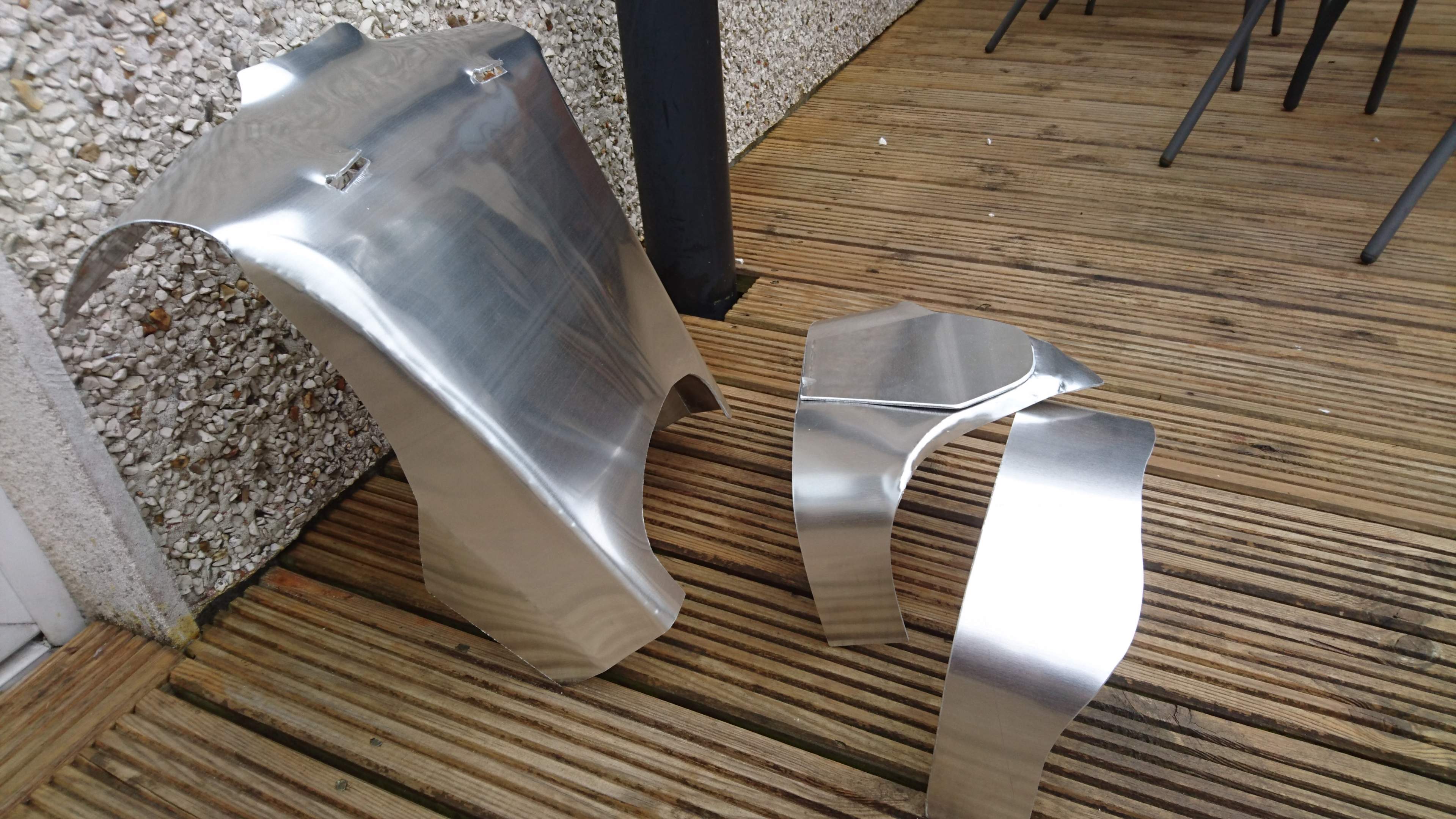

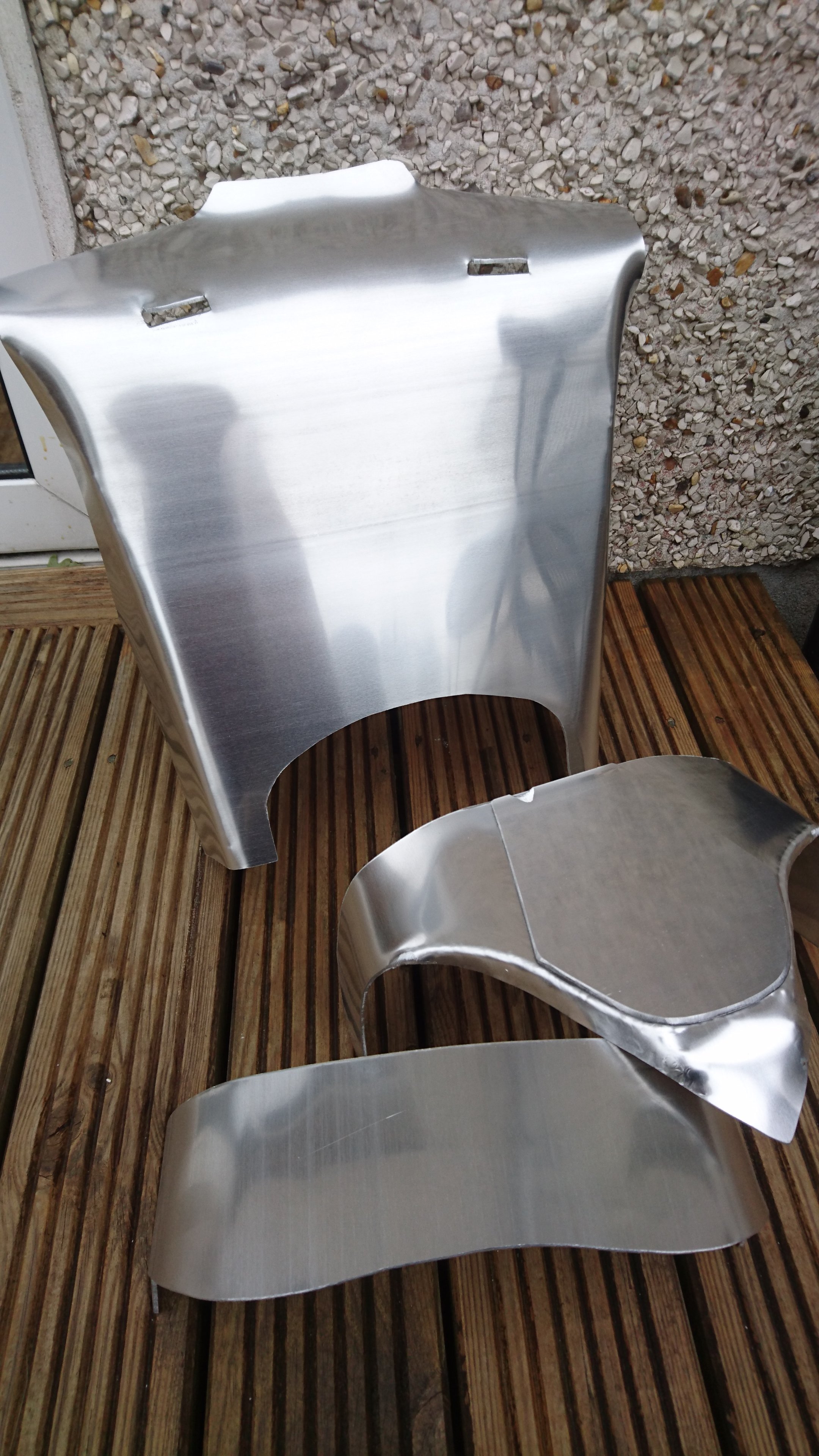

Here is the fruit of that.
Created the rear butt armour and rounded the front base-cod-plate.
I did get some more supplies to fix the top cod plate onto the main base plate but I didn't get time to try that.
The base cod plate is a bit rough so it will be smoothed where it meets the top plate and I need to add more damage to the top cod plate also.
Then I had a go at making the rear armour piece. I'm not that happy with it TBH.
1: I shouldn't have cut the straps holes with a wide U shape (it would have looked better with just a line-cut and then hammered out from the inside).
2: The shoulders are too wide for me at the top so I'll have to trim them in a bit
3: The back curve into the side of the back armour doesn't look correct. It pops out at the side so I might re-shape it as it looks more like Iron Man than Boba Fett. :p
Ah well lesson learned...for my next one HAHA!
