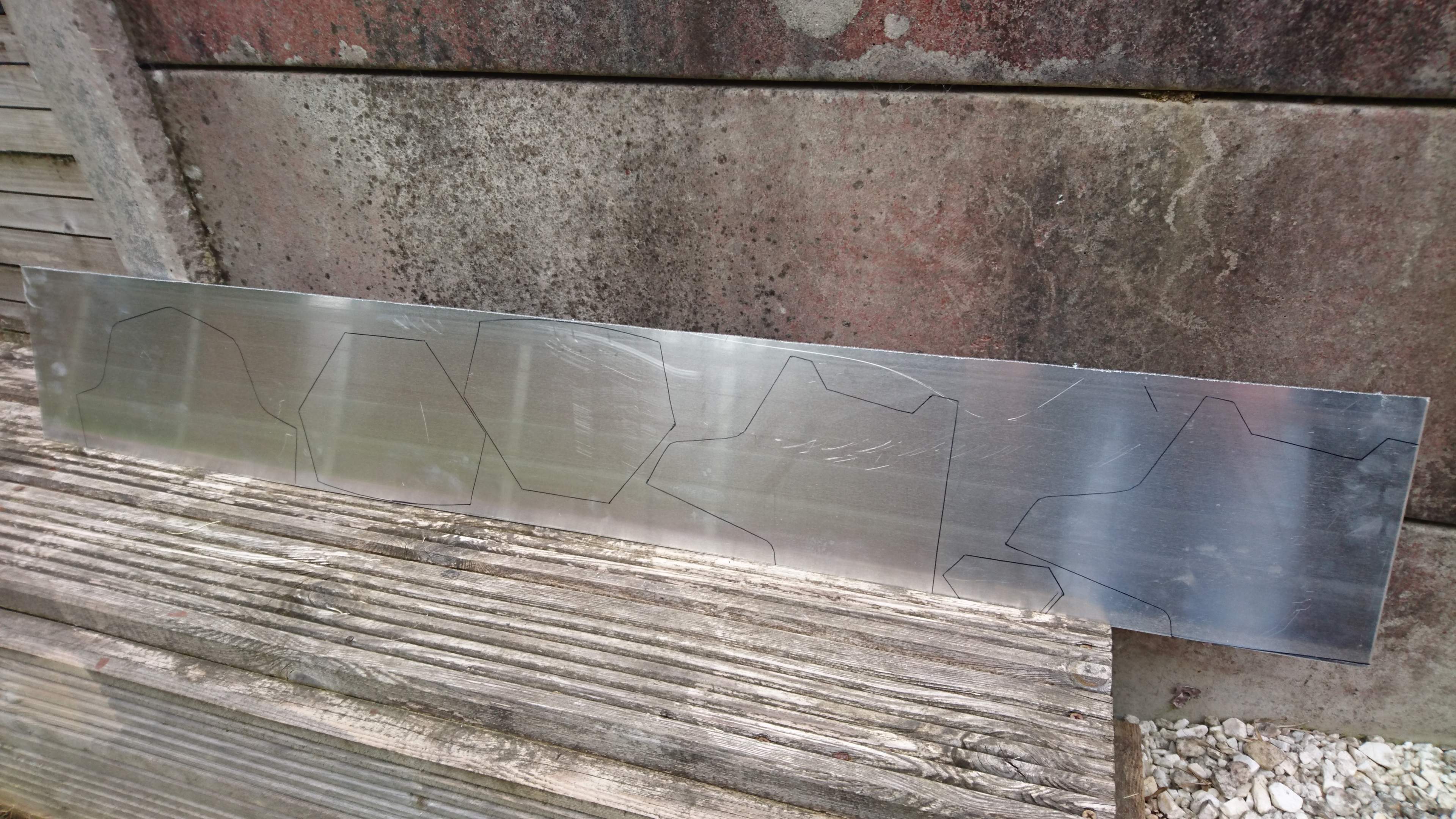

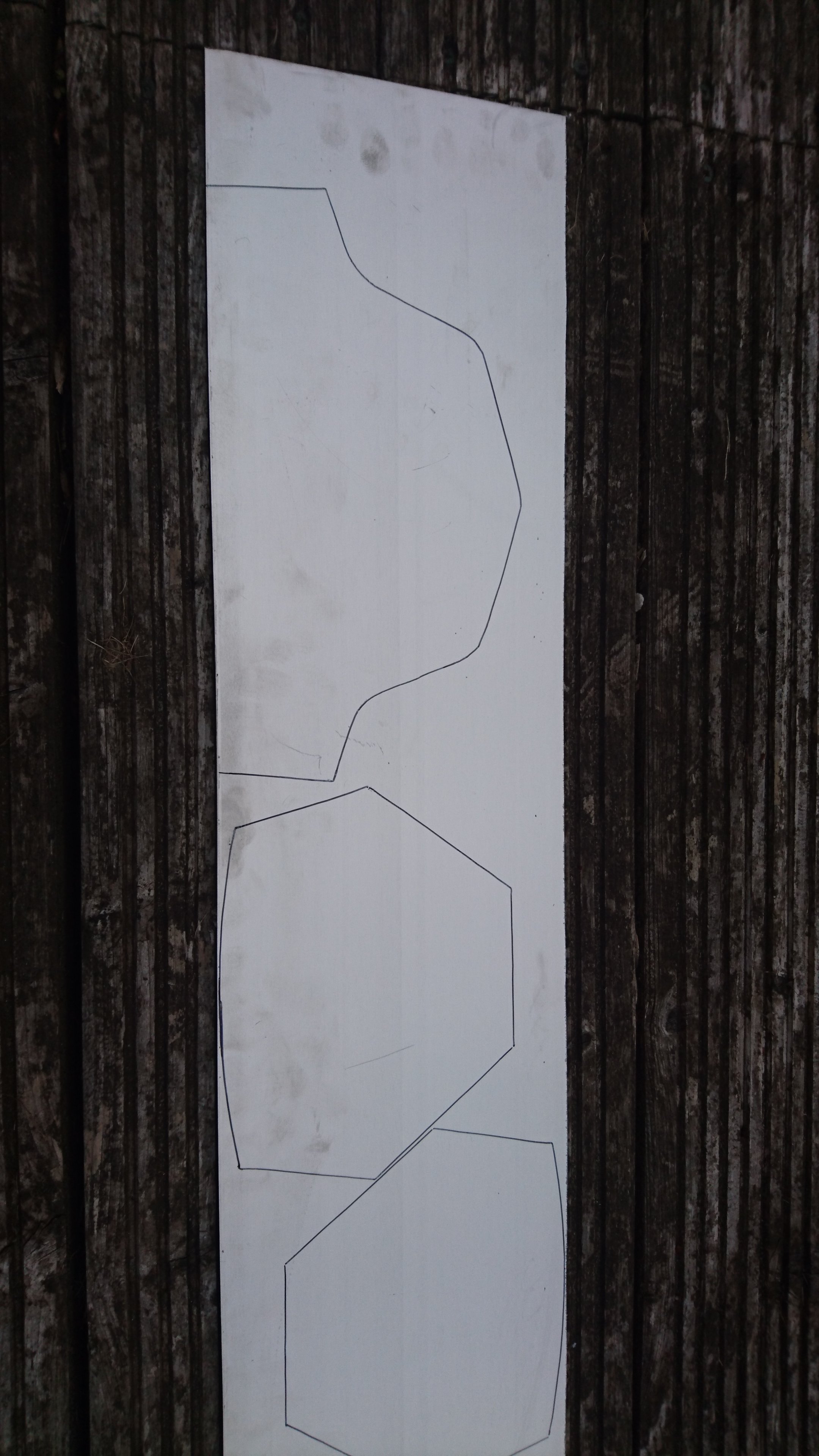

I used medium sized templates for this armour work. Traced onto cereal-box cardboard and then onto the aluminum.
I used a Jigsaw tool to cut the metal (I found out the hard way that I need to cut really close to the lines because I have to hand-file all the edges and this takes some time) :)

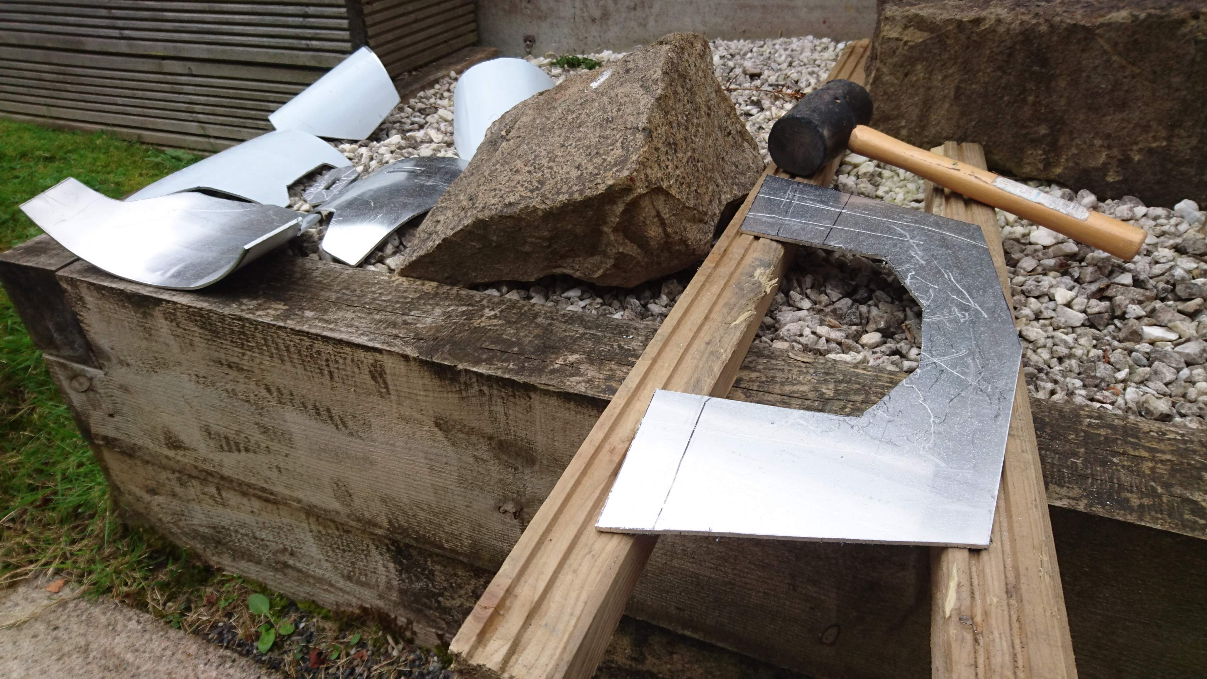

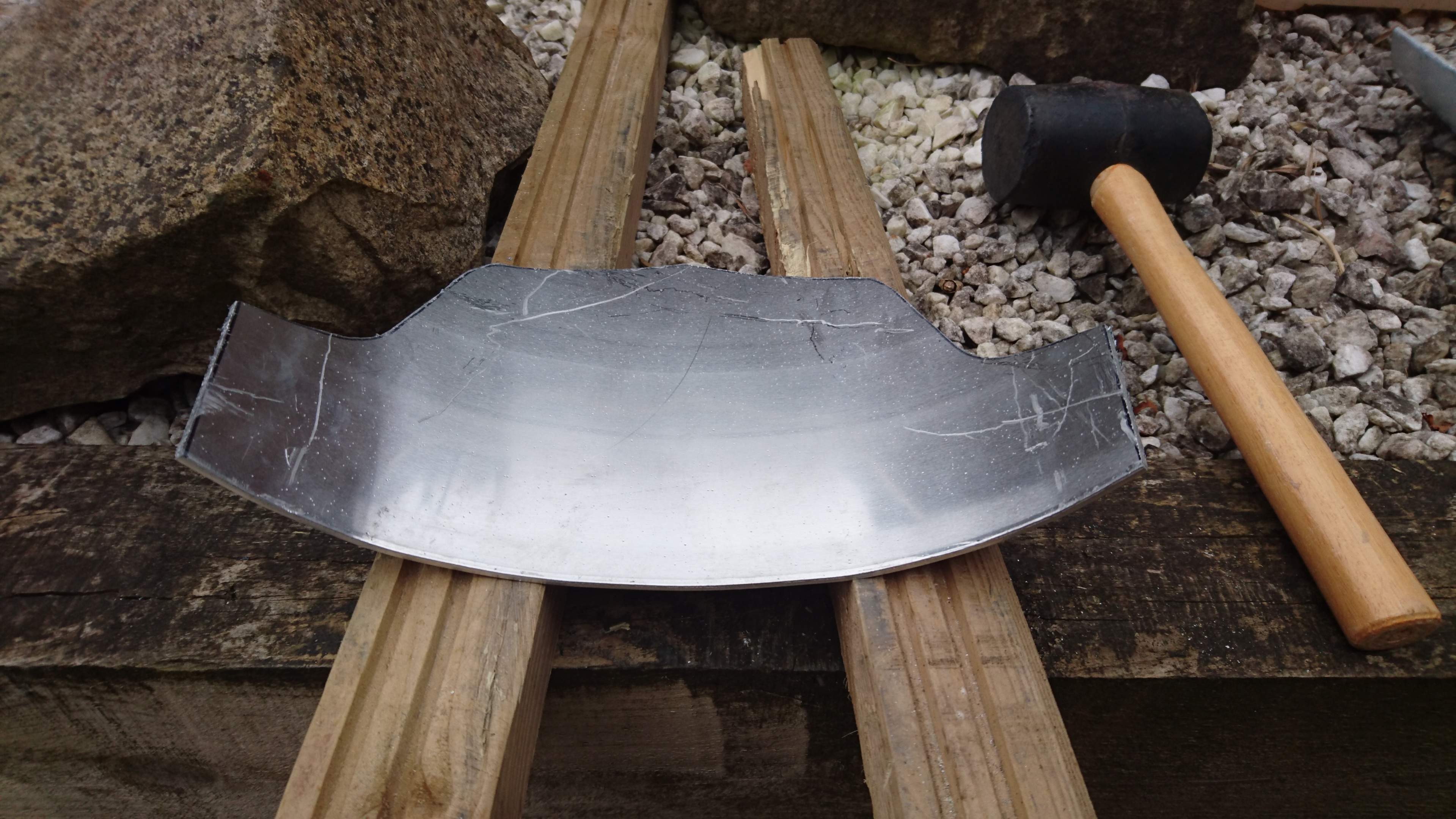

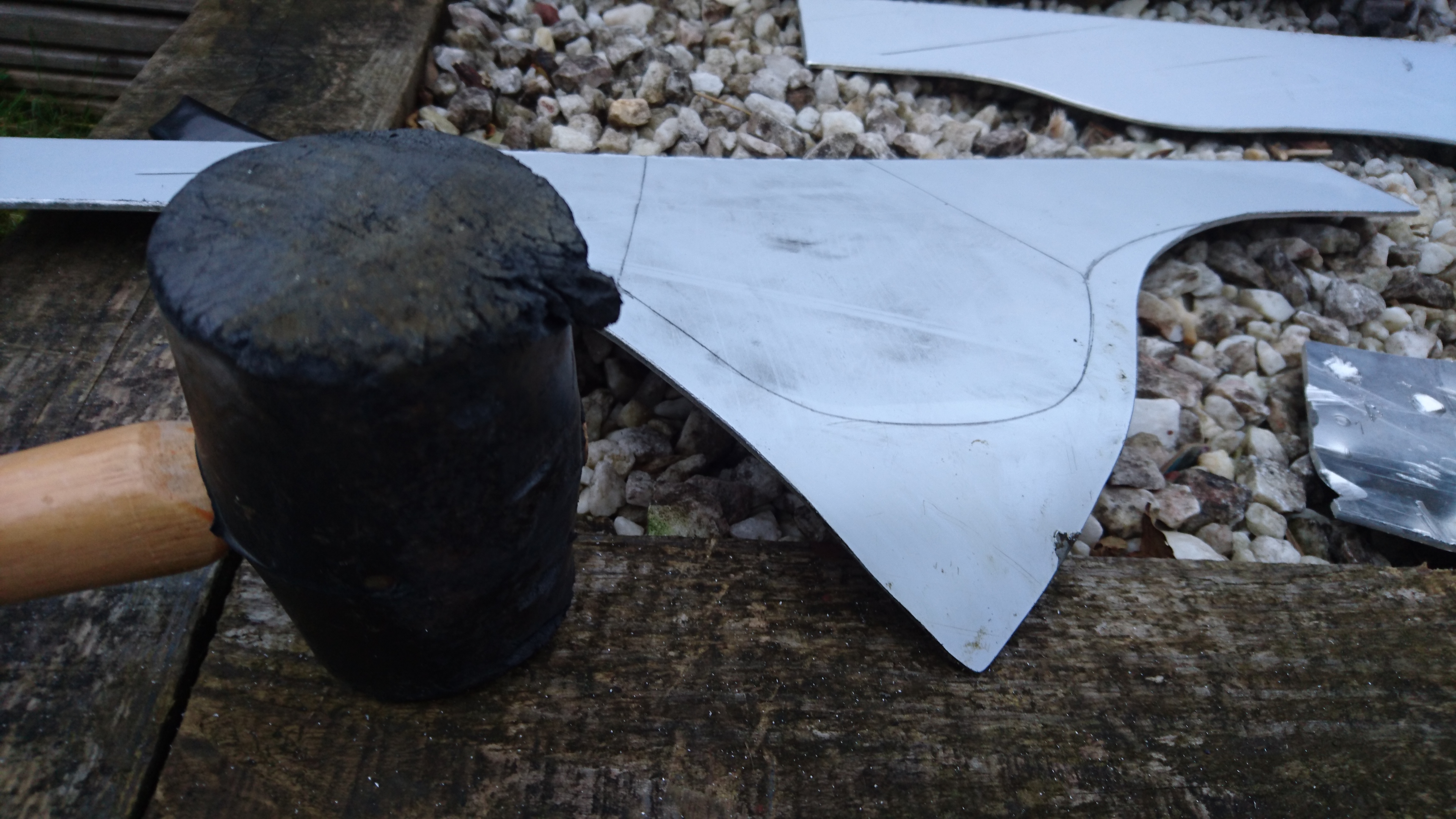

After looking at Cyberpyrots' videos and testing different hammers on the metal, I ended up using a rubber mallet which seems to have the added bonus of not marking the metal and giving a nice rounded shape to the metal when I need to add curves in places. Oh yeah I also got some tiny pieces of metal stuck under my skin (which I later had to remove with a sewing needle), so I eventually wore gloves :$
I also wore protective glasses for all the cutting and filing as those tools (especially the filing) do throw up a lot of fine metal pieces.

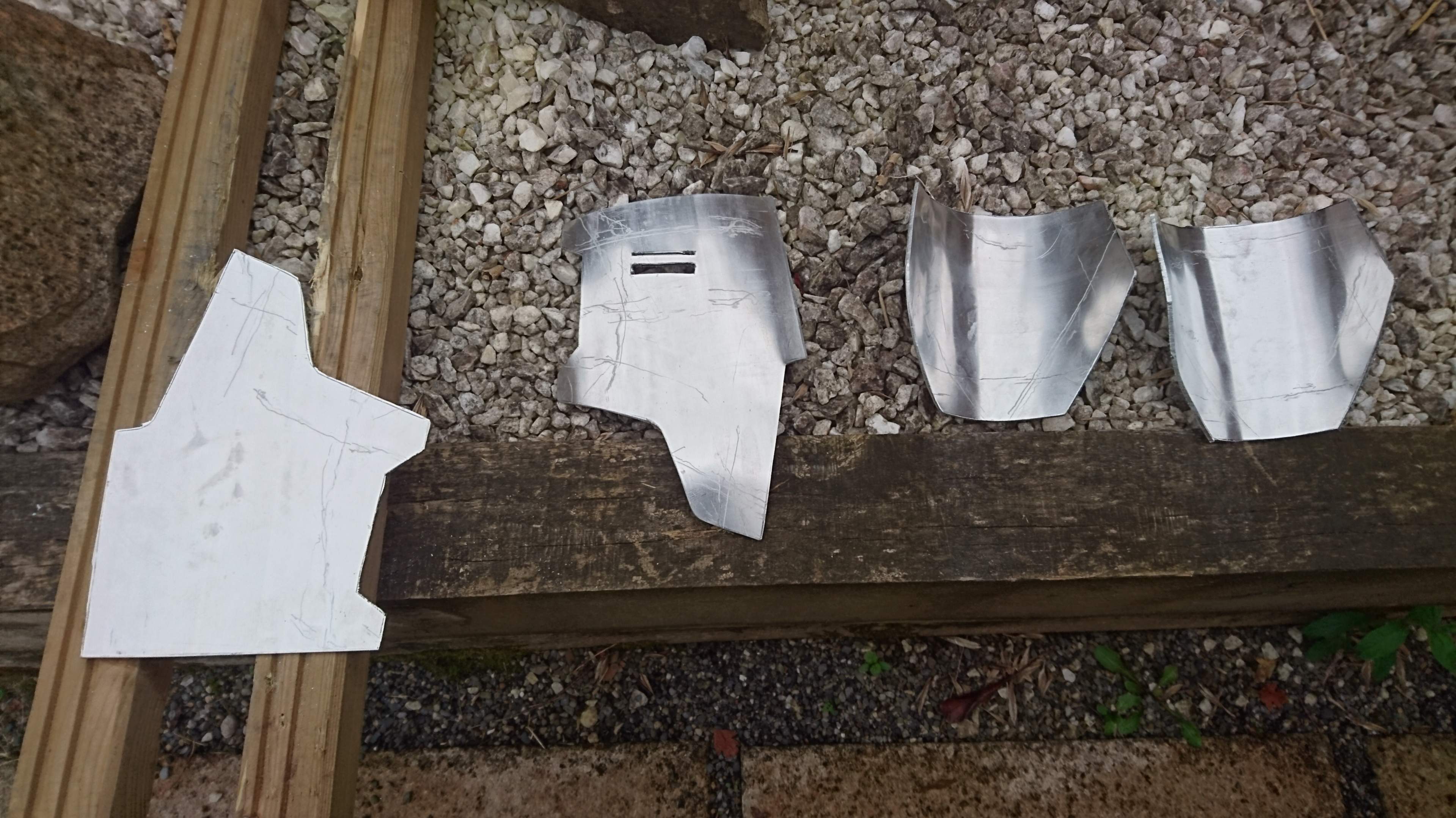

I started with the shoulders first. So here you can see them, alongside the other flat pieces (apologies for the light, I usually don't get to work till evening time).

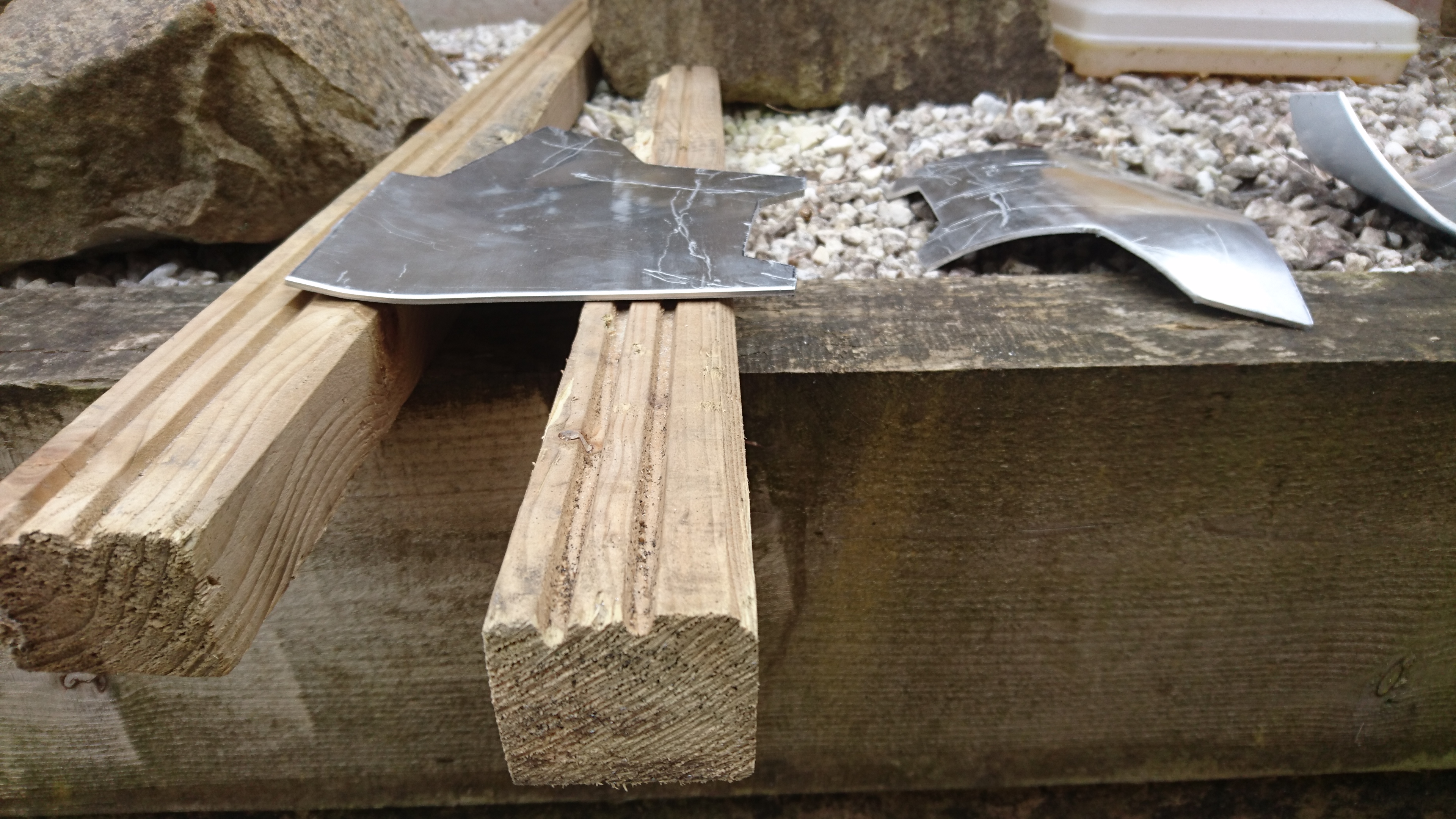

Then I progressed onto the other pieces once I learned to hit the metal in a straight line going down when trying to curve it (otherwise you end up with a skewed piece which doesn't look symmetrical).
I also learned that you need to check the metal every few hits to make sure your curve is progressing well.
Below: as you can see, my "workshop/garage" isn't very fancy :D
As with Cyberpyrots' metal work, I start hitting the metal from top to bottom in the straight line (between the wooden pieces you see below) to achieve a uniform curve. Then move the entire metal piece over to the left once I'm happy the curve is forming nicely).

I drilled a few guide holes for the chest piece here and then hand filed the "tronics" boxes. Takes a while indeed.
And here we have the fruits of my first labour... For me, this is a weeks work (an hour or 2 here and there). I now understand why this takes so long :D

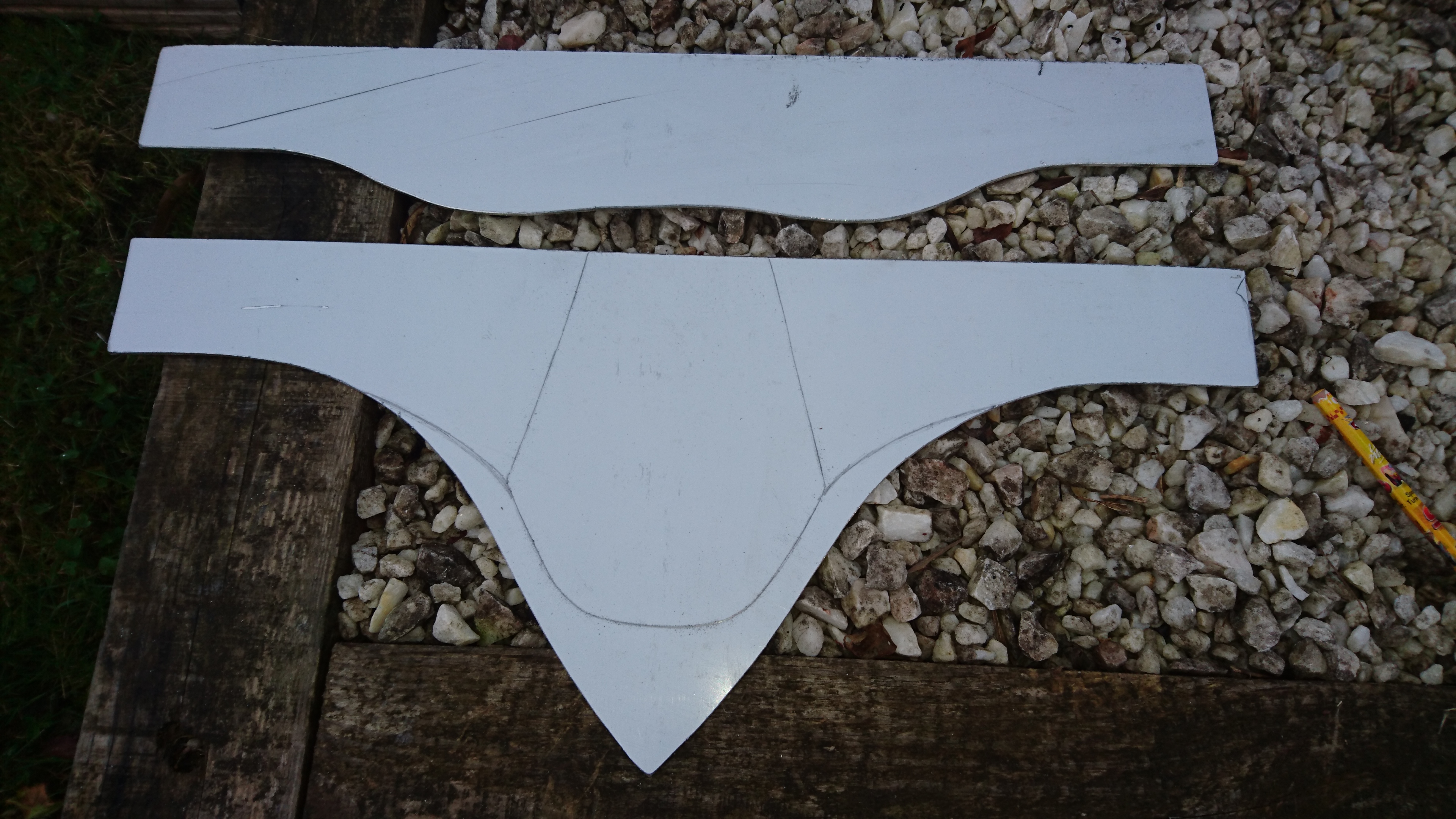

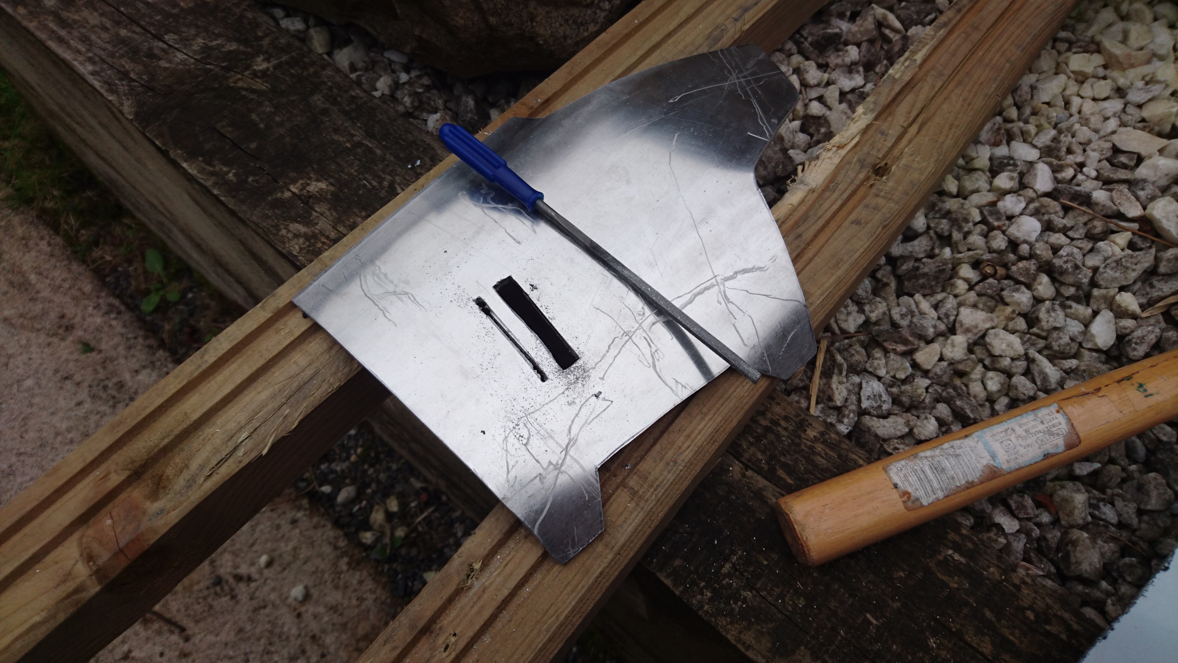

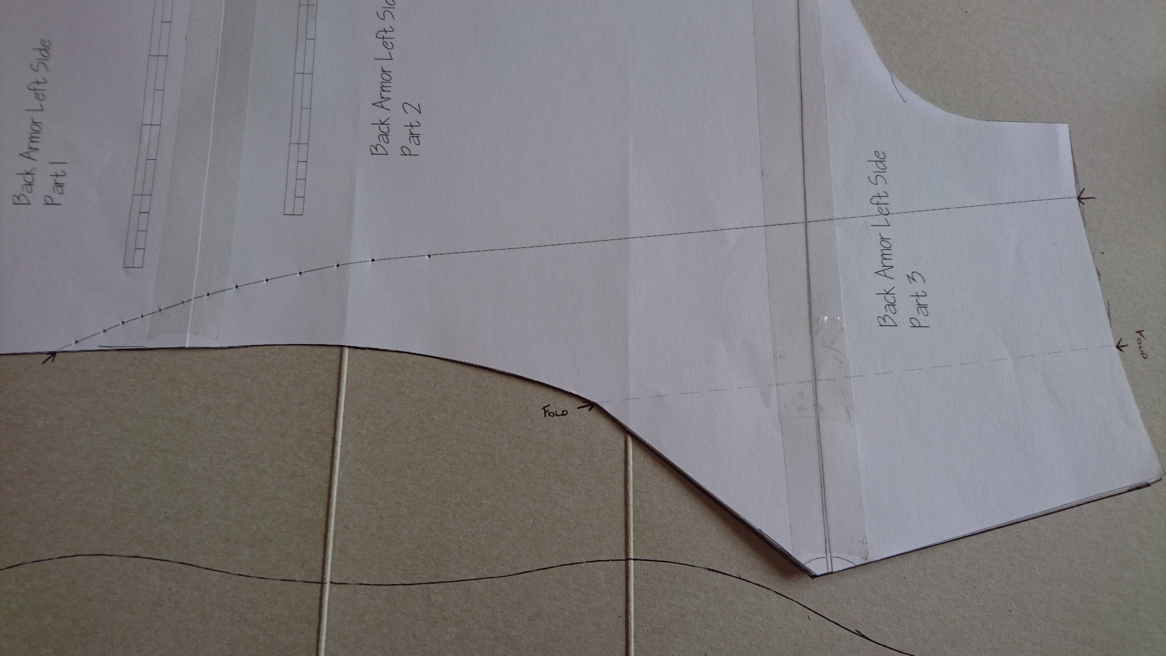

I cut a few more shapes from the paper/cardboard templates and began work on some of them...
Note, the reason for the dots along the folder line along the back armour here is when I do eventually set to bending the aluminium, that I know what path to take along the bend.

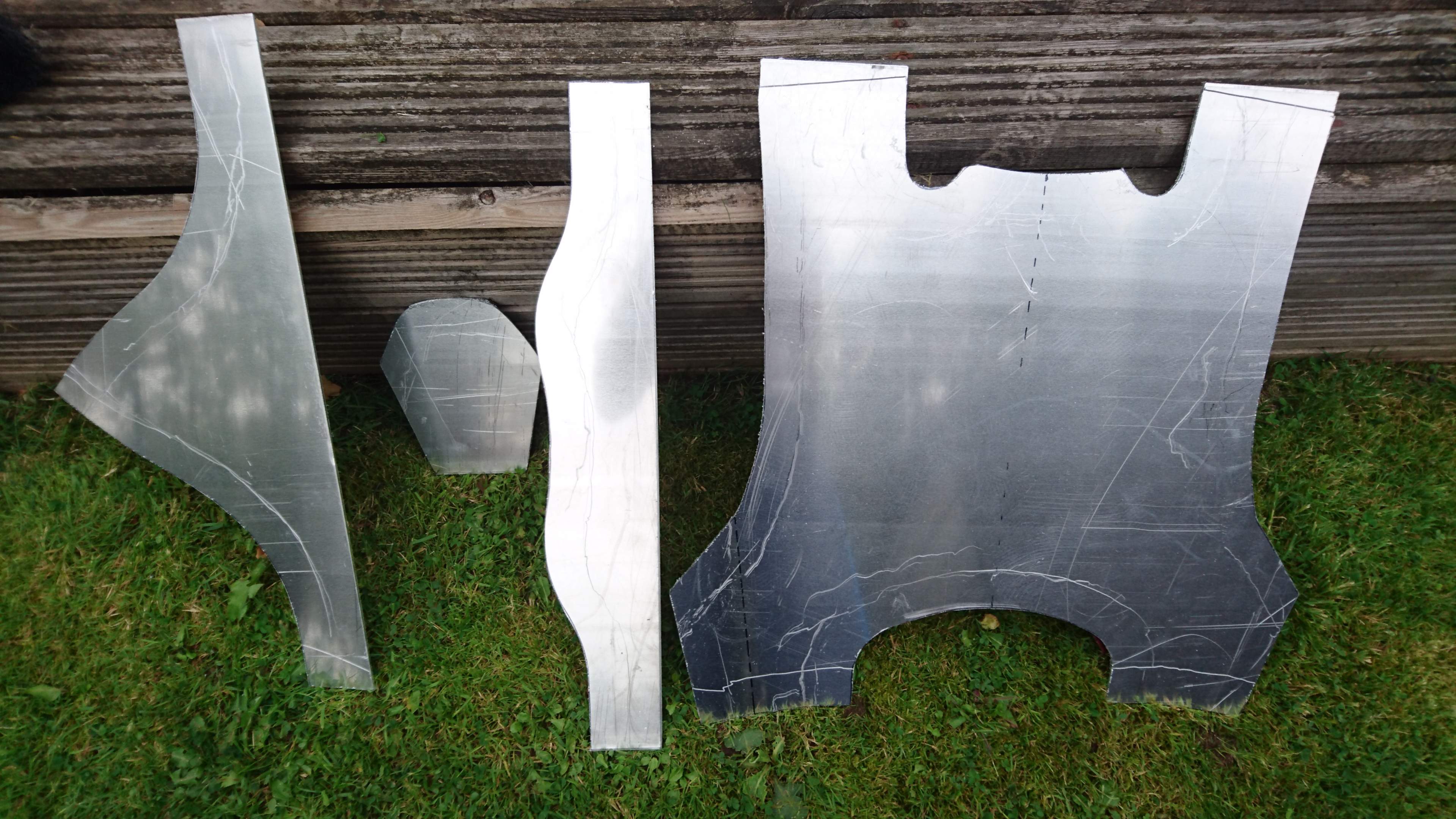

Some rough cutting done...
Note: I extended beyond the guide lines for both the shoulder/neck armour piece and the back plate (the piece on the right, below) as I only get to make the cut once and I'm leaving some extra/overlap when it comes time to join the neck piece and the back armour

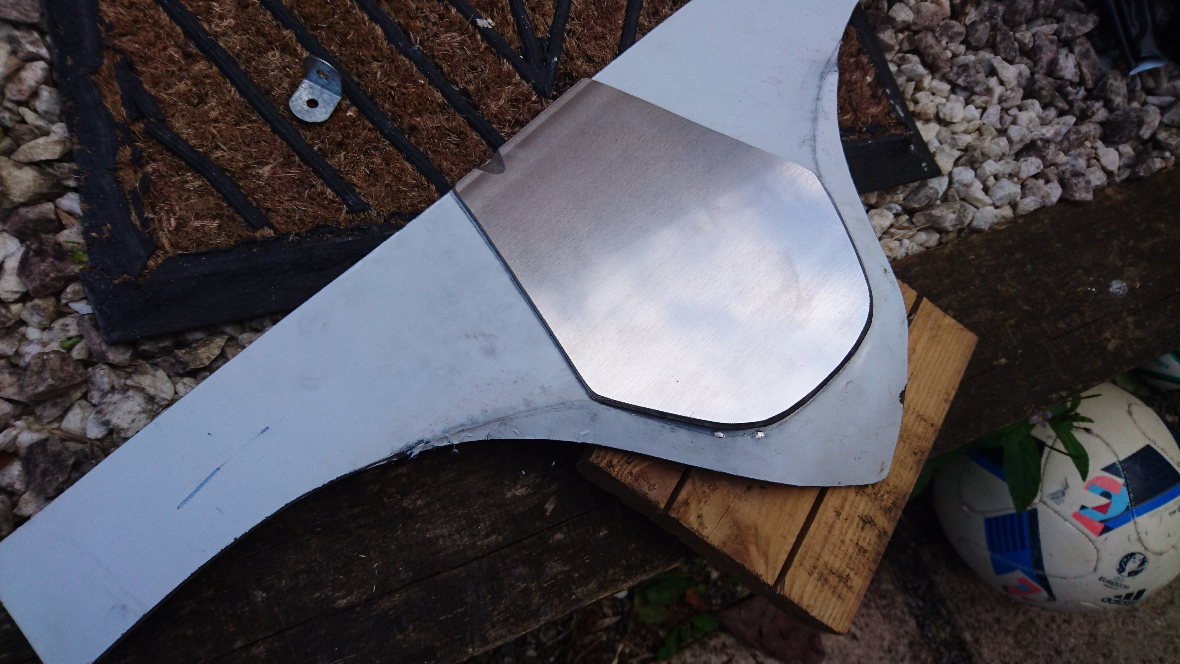

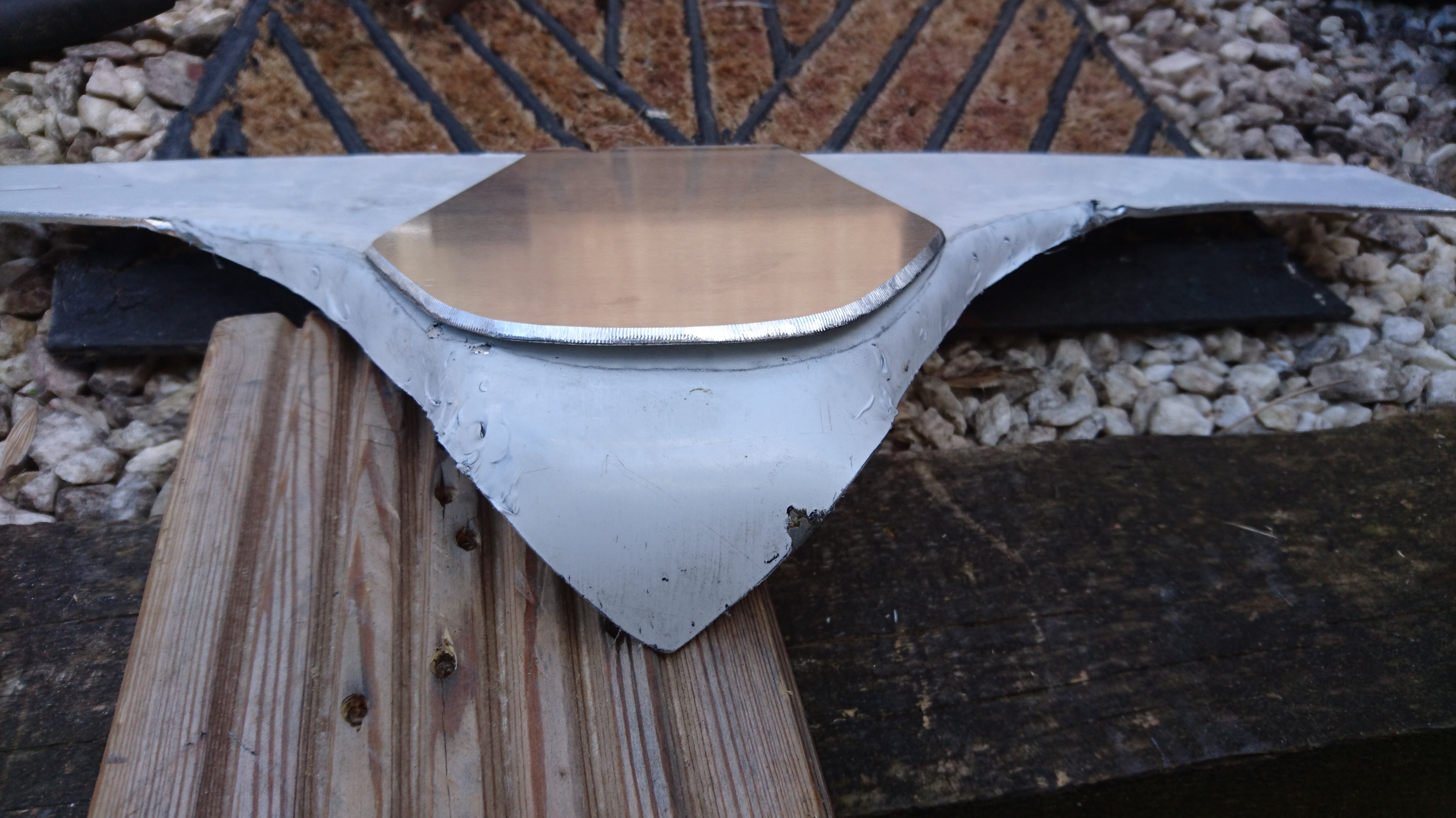

I decided to tackle the code piece first...not the easiest of pieces...
So I trace the top cod piece (which is second from the left in the picture above) onto the main cod plate to give me an outline of where to begin shaping the lower area.
And here it is sitting on top of the cod plate for reference...

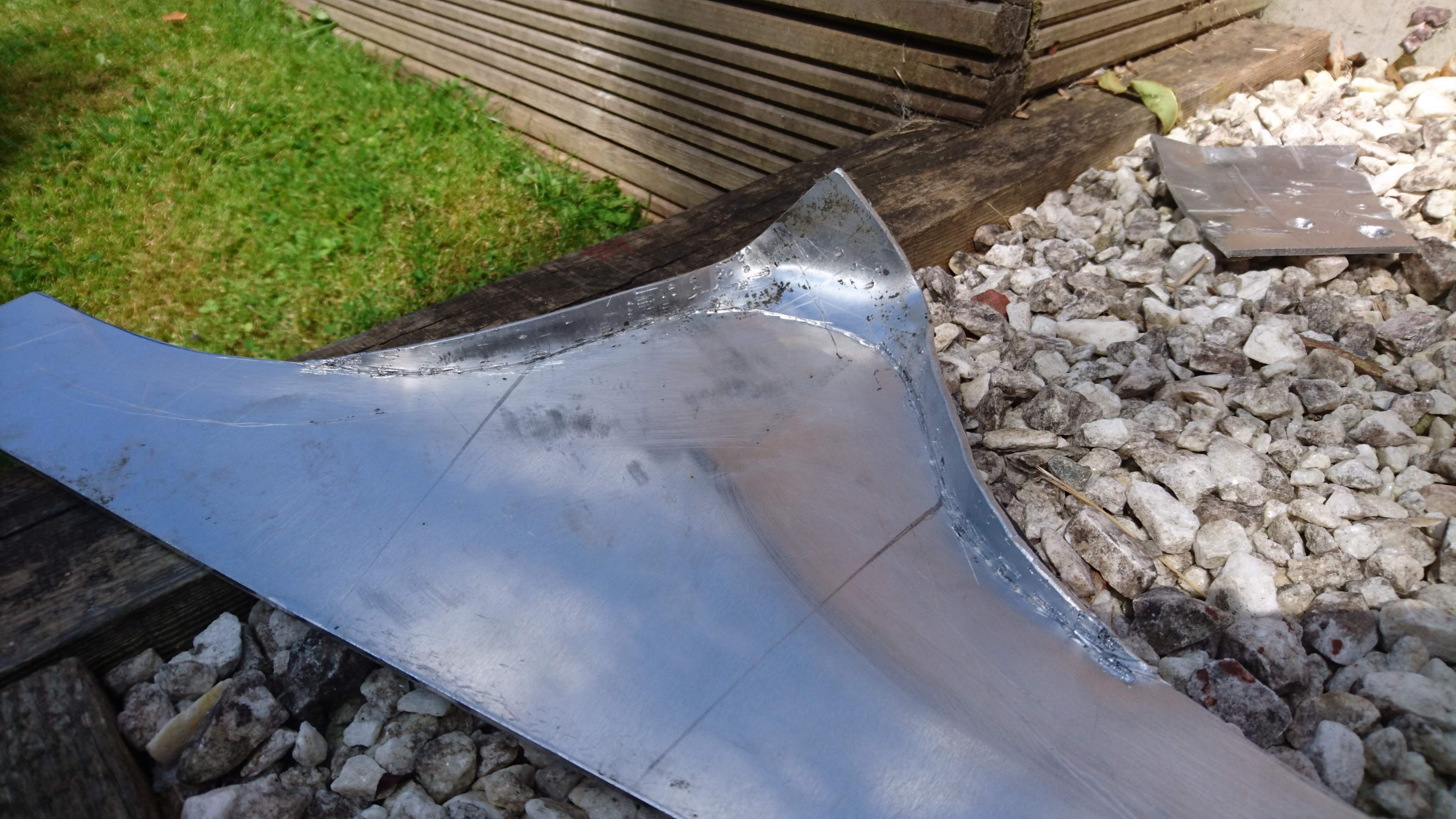

However, my rubber mallet wasn't up to the task this time, as I need to bend the metal in a very strict shape. Hmmm onto plan B now...

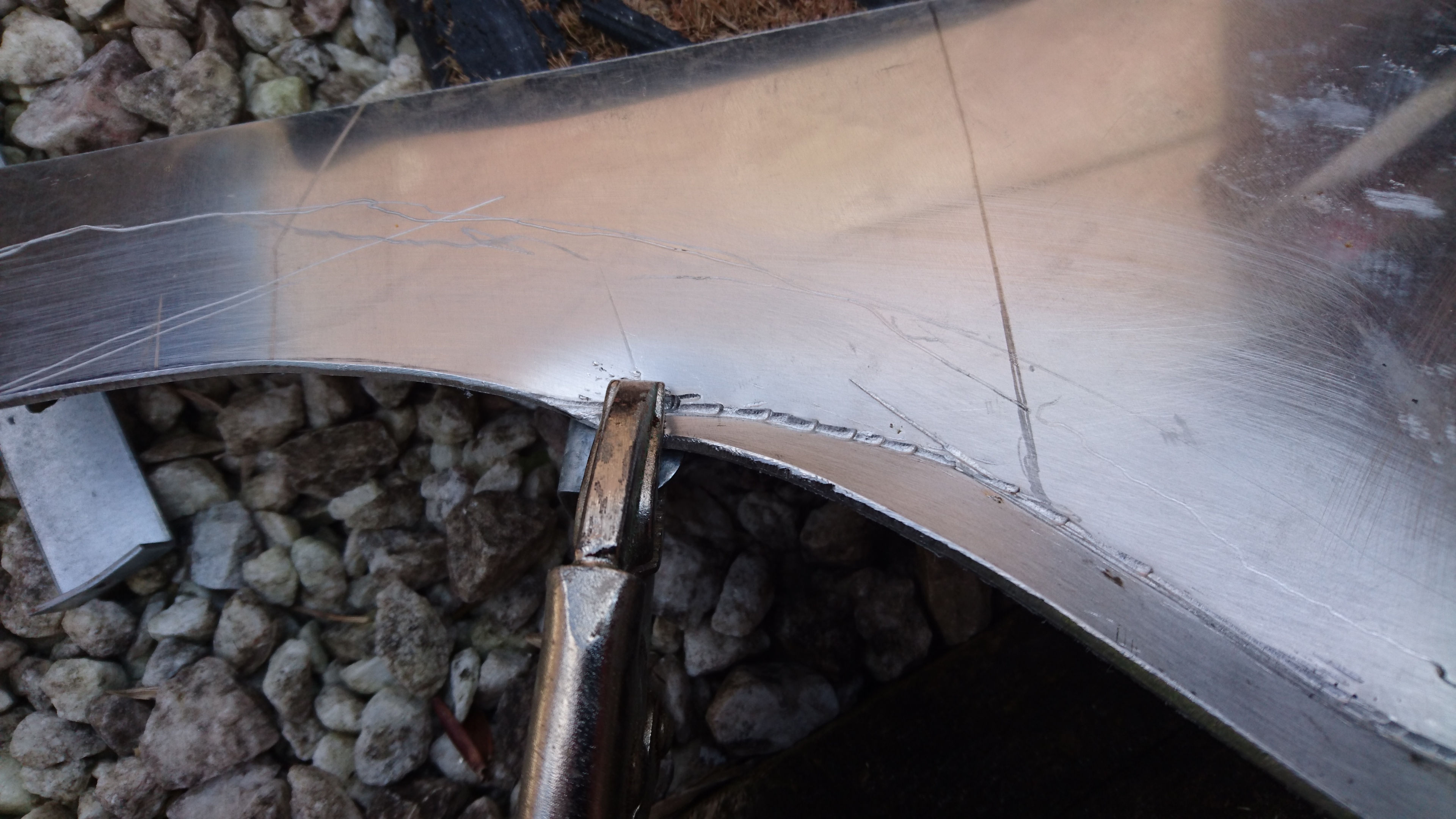

So after looking on youtube I spot that you can achieve some better shaping of metal by weakening the back of it with a few well placed chisel marks (in this case I had a concrete chisel to hand)..
So I got to it... and this process pretty much starts the process for you...
Ok pictures seem to behaving now so without further faffing...

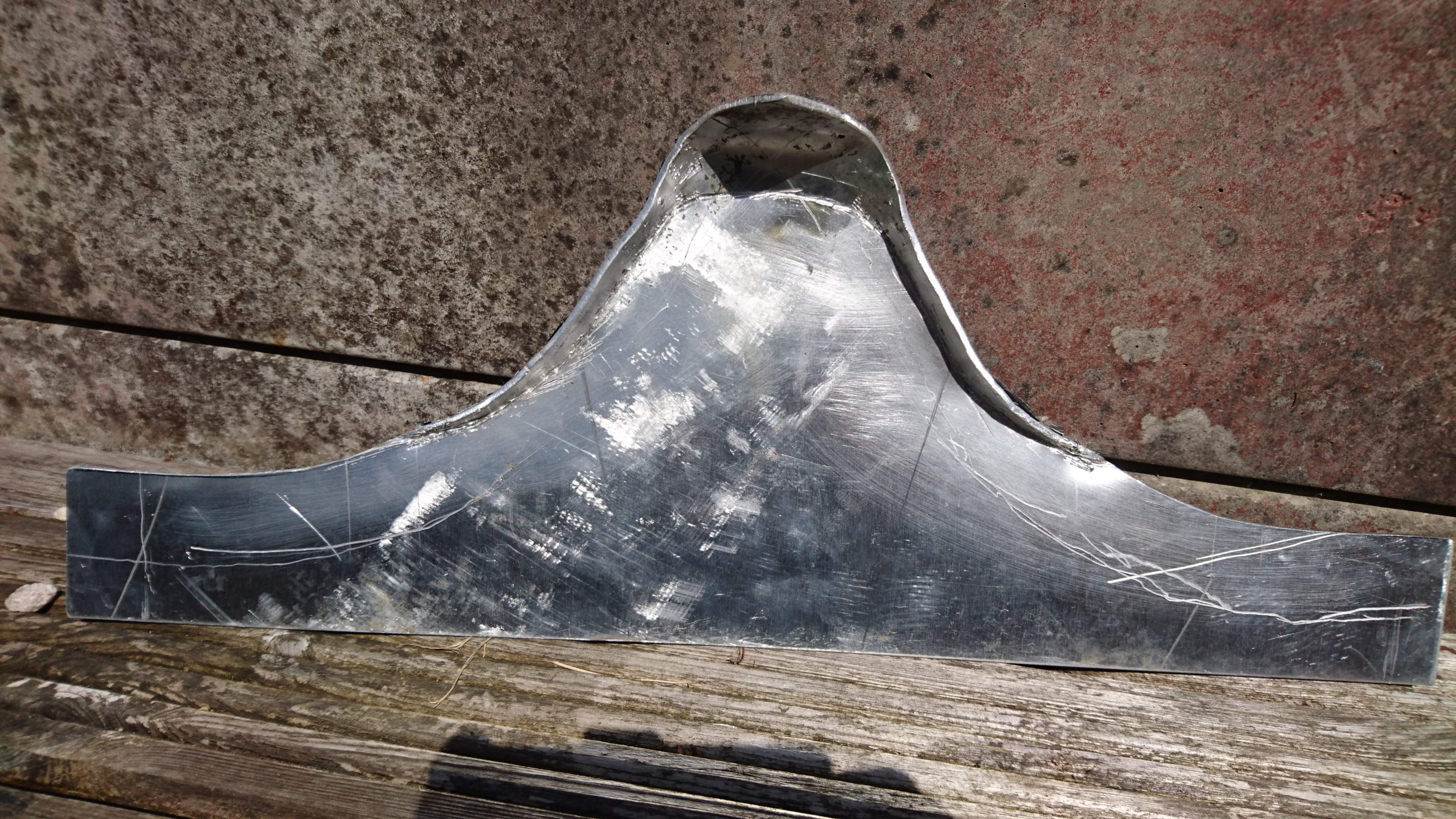

I used a vice-grips (with a small piece of metal in between the teeth and the aluminium to then hand bend the metal piece by piece.
It looks ugly but the result should be ok in the end...
I check every now and then, how the curve is coming along... not too bad so far, so I keep going...
Increasing the curve more severely with each pass...
Until... nearly there.
I'm happy-ish (for now)...
