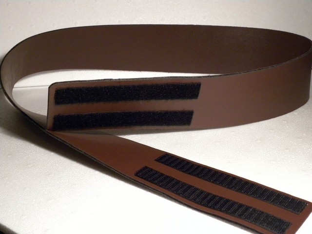

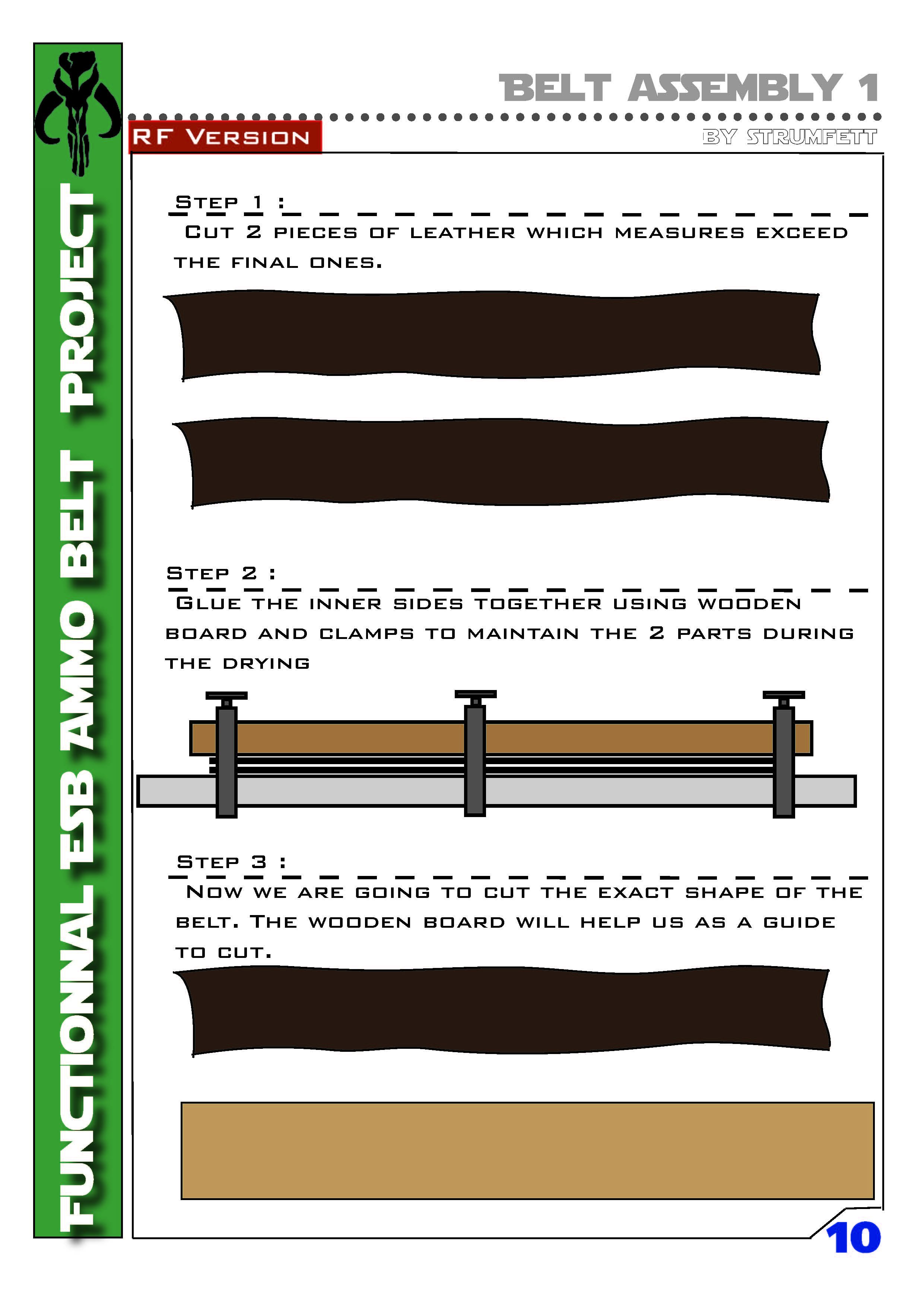

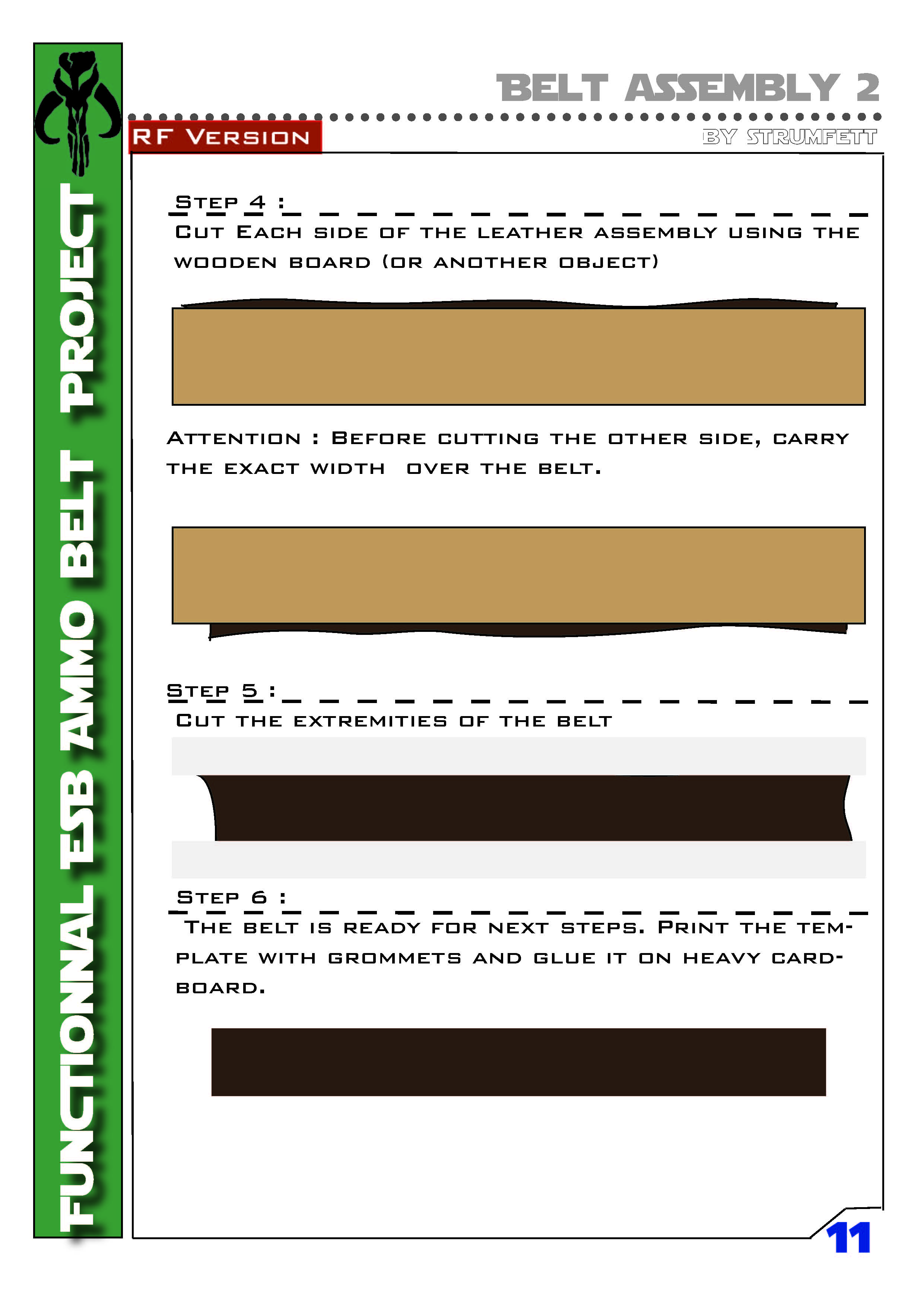

Here is the belt assembly tutorial. It's the method i used but others are possible. I hope to post pics of my belt finished soon (just hundreds of holes to do for sewings...).
10 - Belt assembly 1.jpg11 - Belt assembly 2.jpg12 - Belt assembly 3.jpg13 - Belt assembly 4.jpg

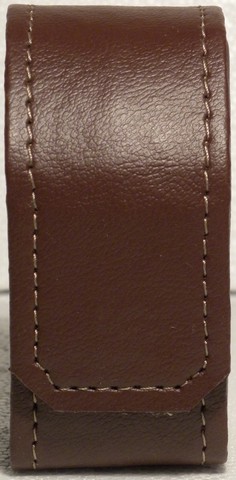

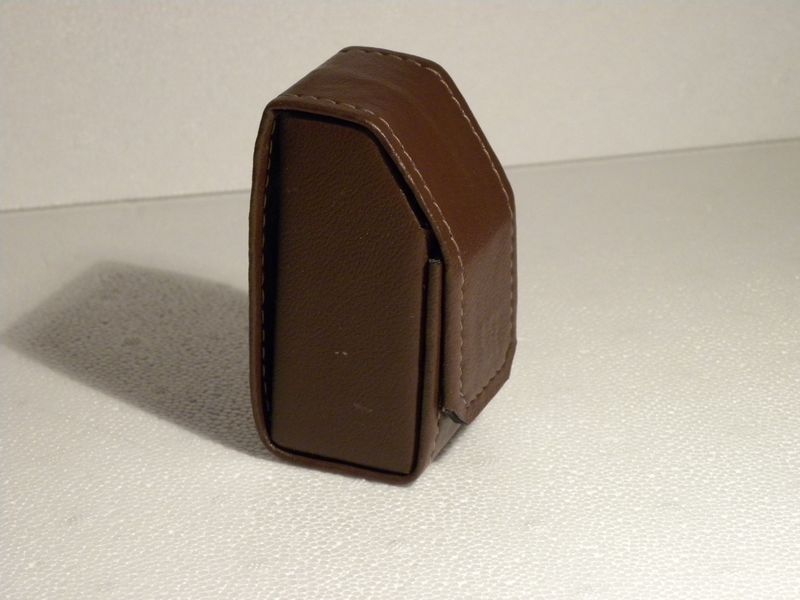

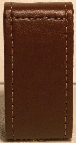

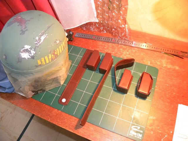

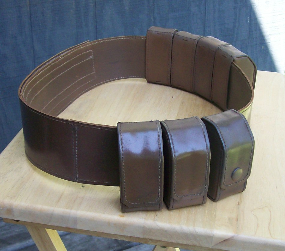

Here is some pics of finished pouches. For the belt, i had to redo it because of bad quality glue ( hundreds of sewing lost....:()
For the sewings i see on ref pics that they aren't completely white. so i use tea to color them.
The sewings in the belt are still missing
And a pic took during assembling step

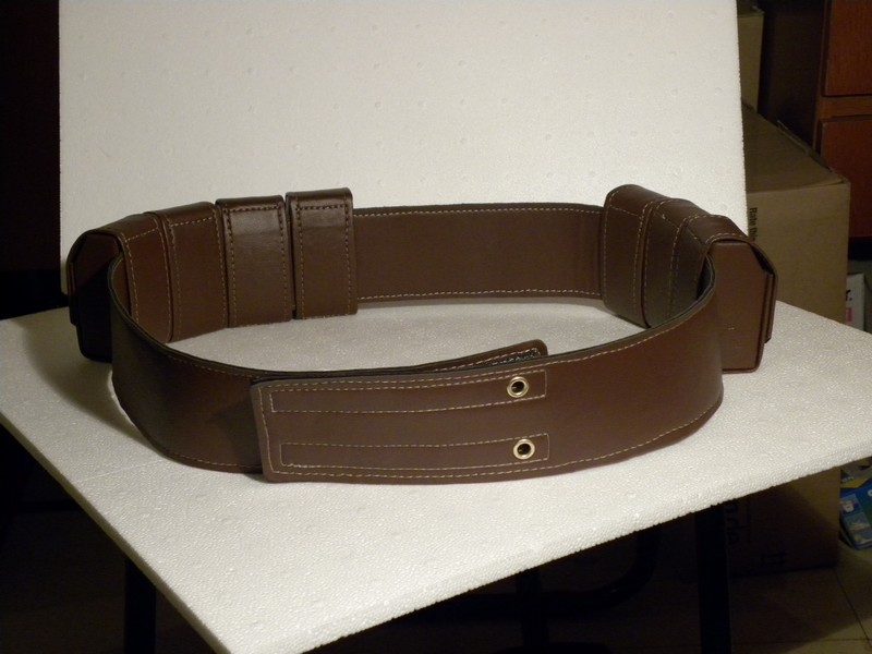

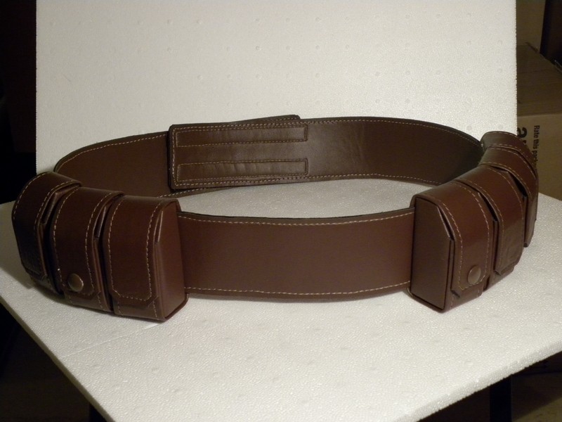

Have just finished sewings of my belt.....I think it would be better using a sewing machine but i'm happy to see how it turned
i have just to put the buttons and the gromets

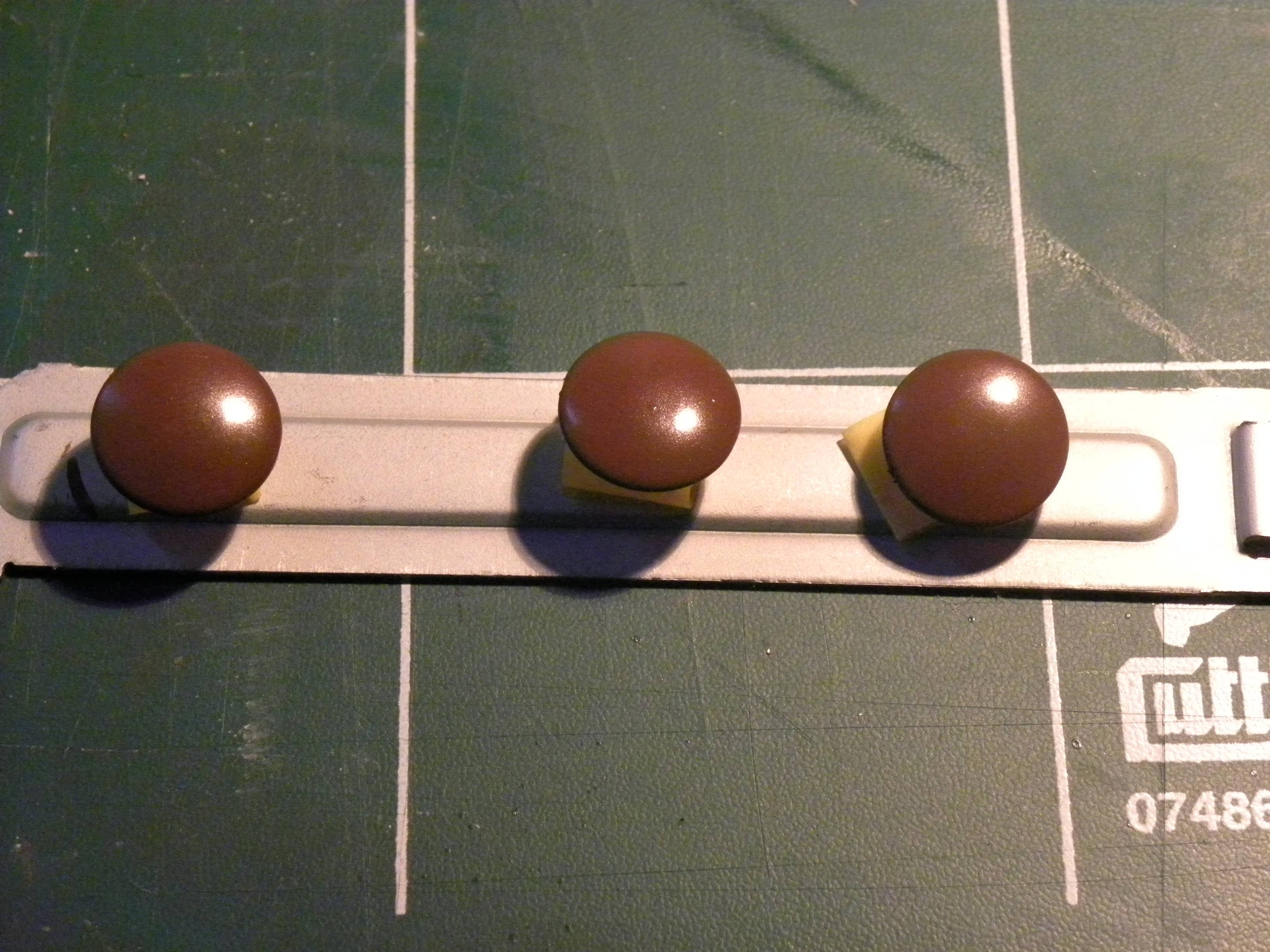

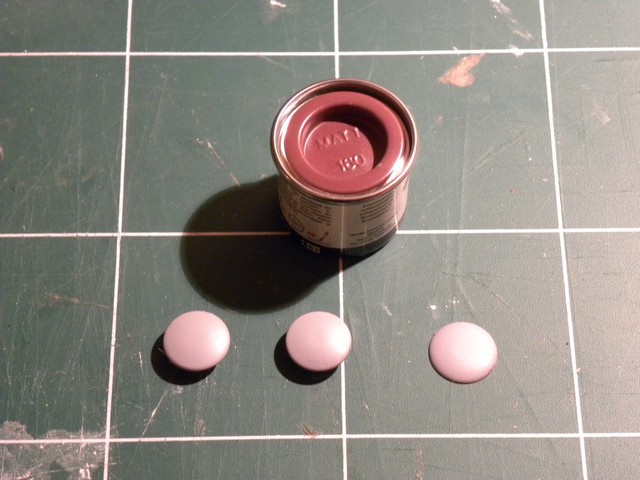

For the button, they are already primered
i found an Humbrol color that can match (in reality it's more dark and brown than on the pic).

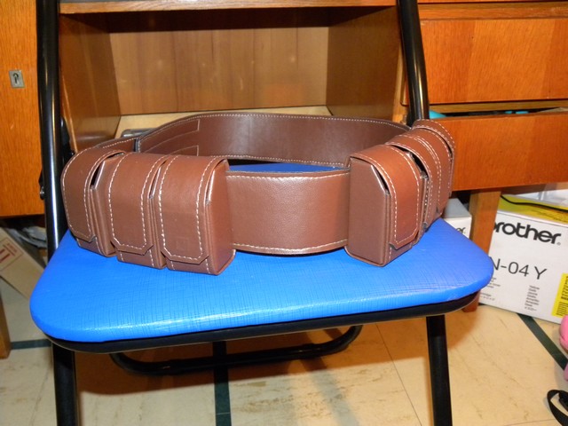

Here's the belt with buttons and grommets.
I must fix the problem of the flaps as RafalFett pointed out it to me.

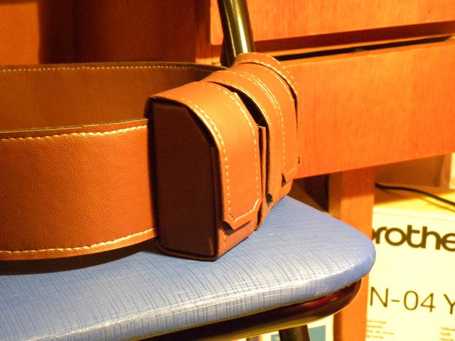

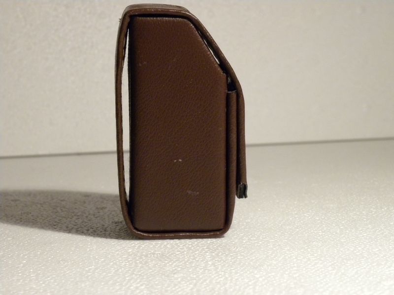

I try to fix the flap using an extra pouch.
1 ) I cut about 4 millimeter at the beginning of the flap
2 ) I marked the folds using an iron. Adjusted temperature to synthetic and used a wet cloth to avoid damaging the leather.
Here's the result :
Is it better ?
I still need to add wheatering but it's not the most difficult part if i start on a good base.
