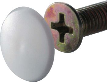

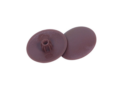

Now for the button on the front , my calculation shows that the diameter must be 13 mm (about 0,51 in) i find this in my hardware store with the exact diameter :
I think that after painting it will be pretty close to the real ones and cheaper.

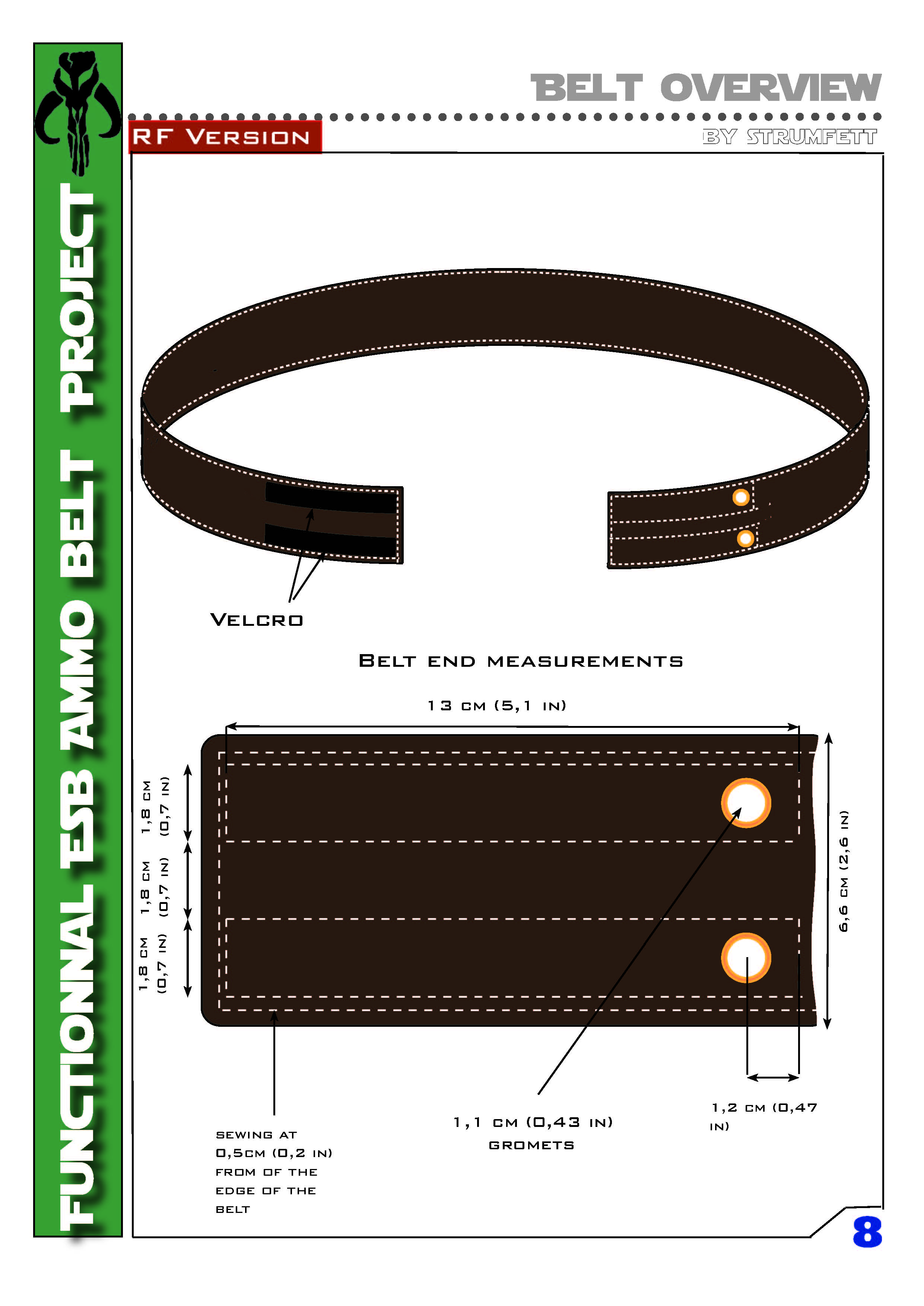

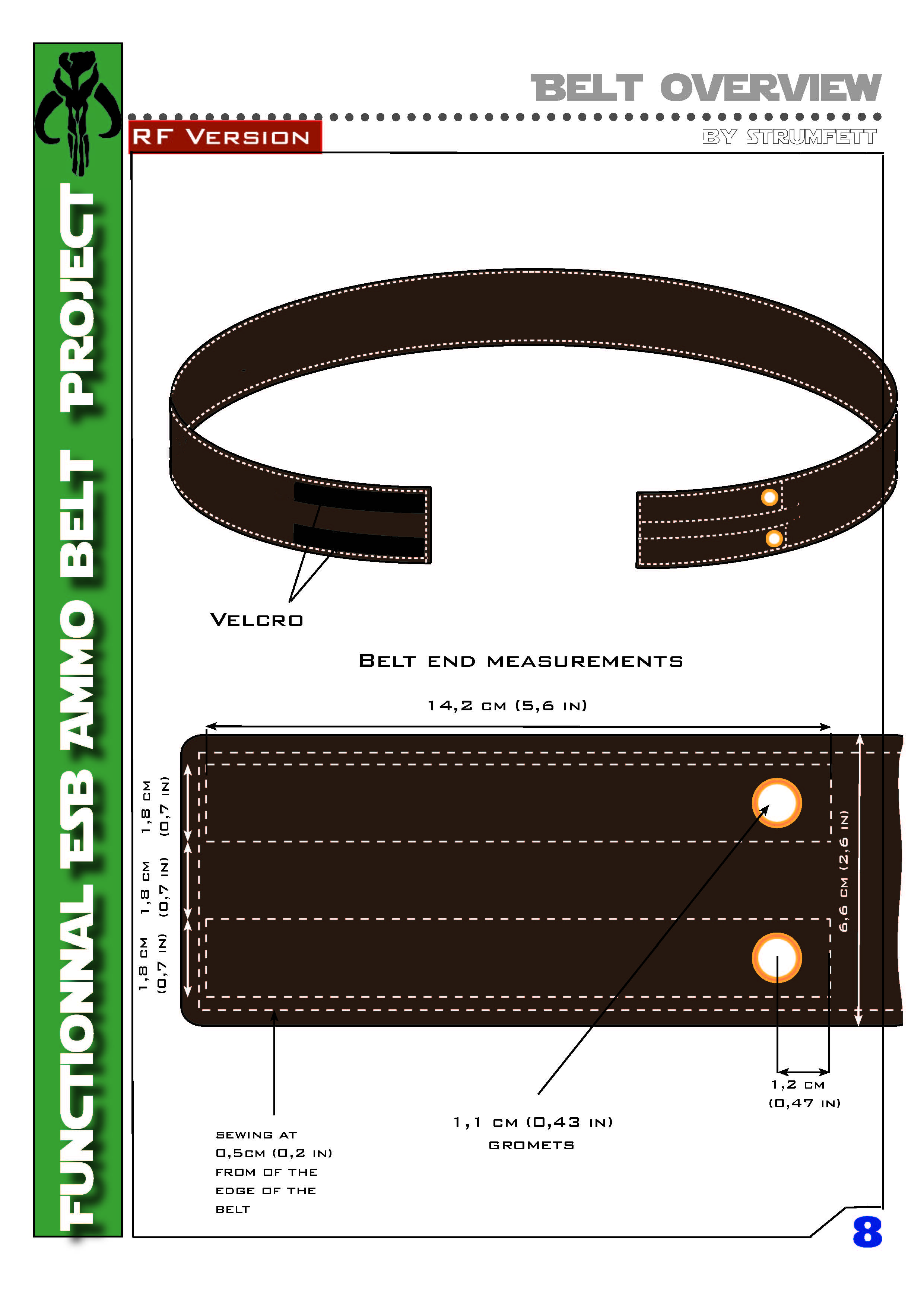

SO here's the belt overview with the differents measures.Templates will follow with how-to.

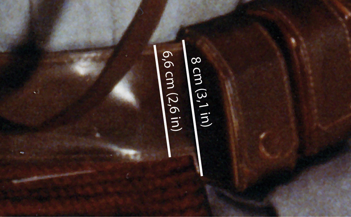

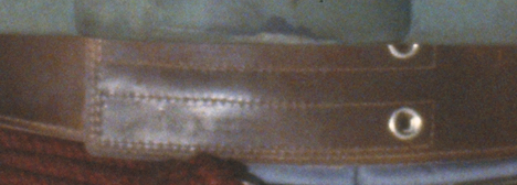

A detail hit my attention, when looking at this pic below, it seems that the end of the belt is rounded.If i make a mistake i will correct the templates but it's the only ref pic i have.
I use this ref pic to find belt's height

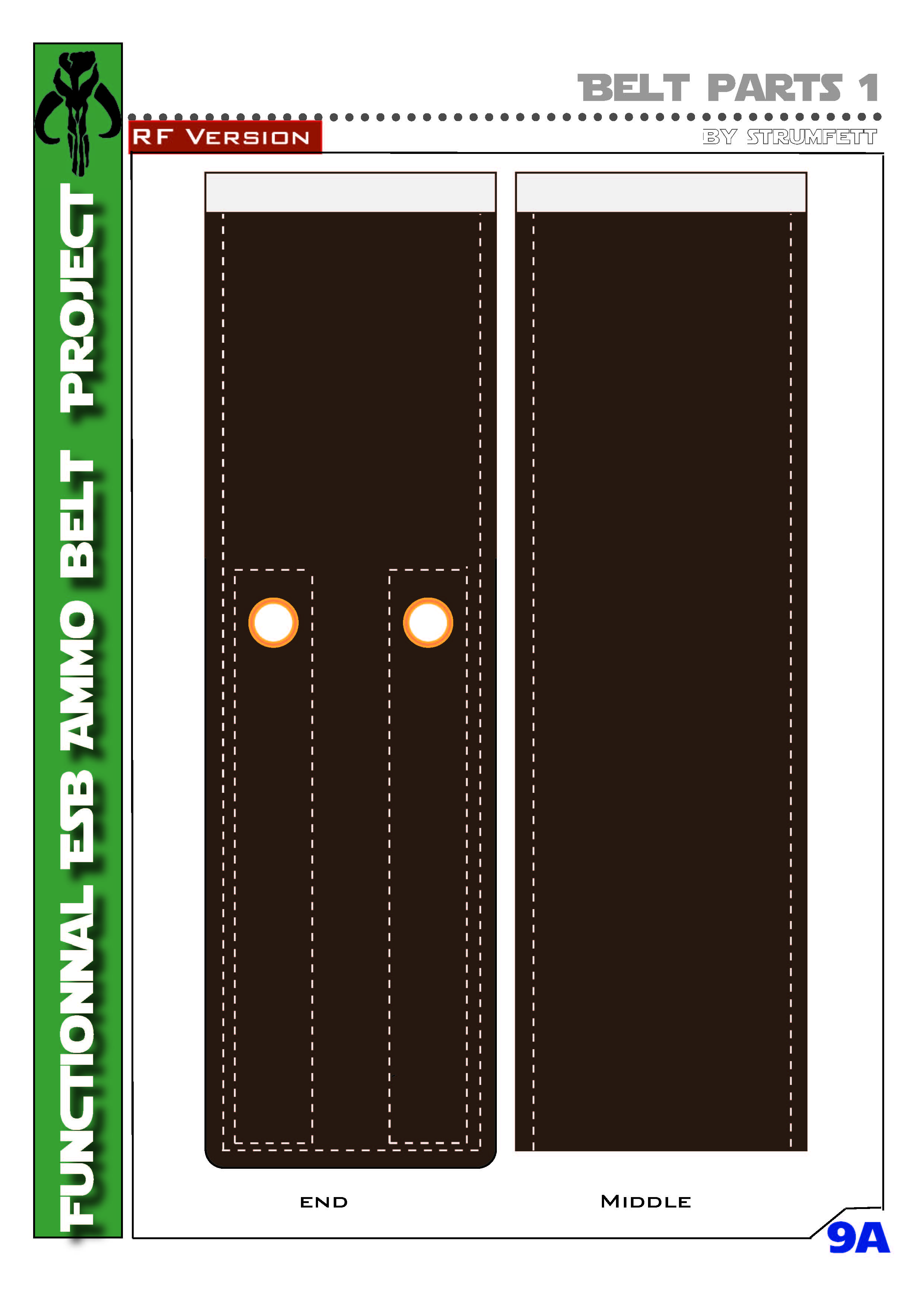

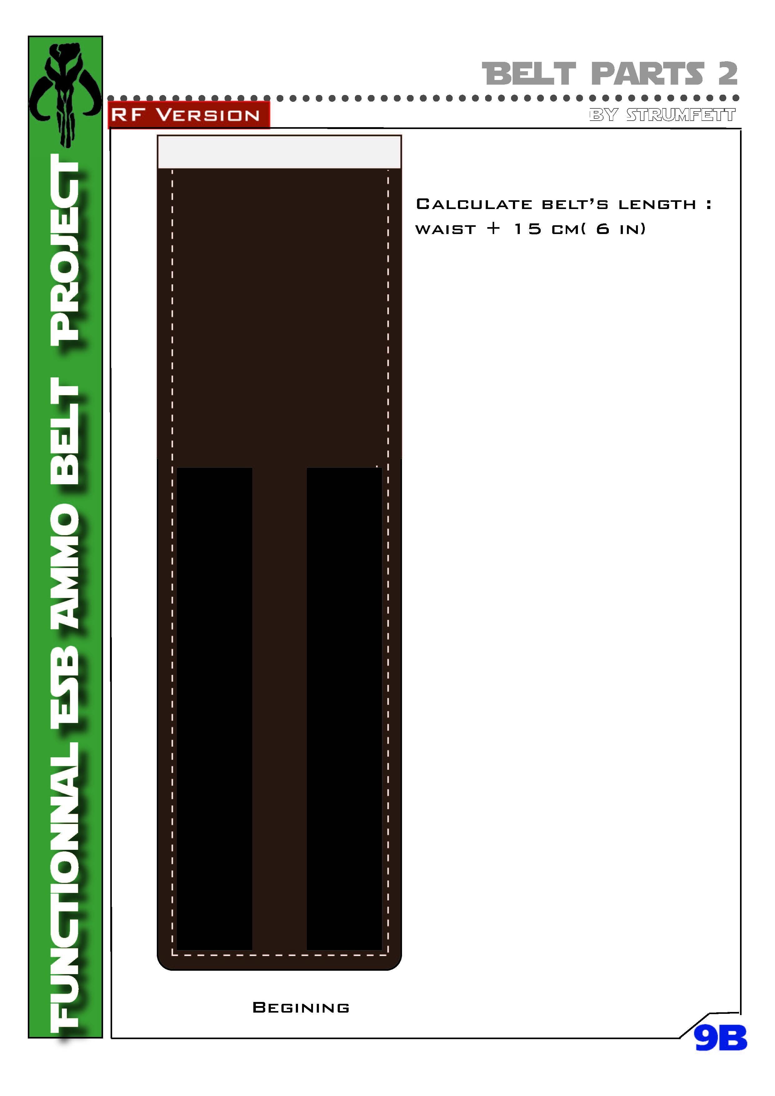

Hi !
Here's the first part of the templates.
I will post A4 and LTR docs later (i need your opinion on measurements and shapes before to validate definitively the templates)

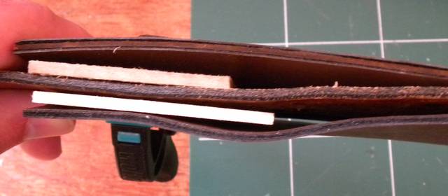

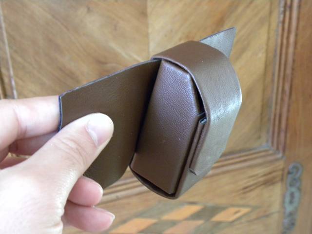

I also worked on the belt structure. When looking at the ref pics, i have the feeling that the edges are sharped. So i make several attempts and this is the results :
1 - Just two layers of leather :
IMO the structure is too flexible and with the weight of the pouches it will cause the belt to sag.
2 - With cardboard
The rigidity is better and i think there will be no problem curving it.
And there is a comparative between the 2 solutions and a real leather belt :
In order from the top : belt with cardboard, real belt, belt without cardboard.
In your opinion, which solution is better?

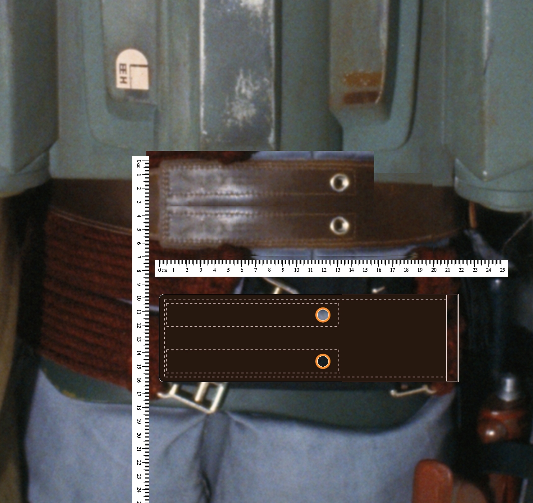

I'm a big fan of your project and you did an excellent job so far! Here is an image I did by adding a mirrored lower part of the ammo belt to creat a whole:
It seems that you need to lengthen the sewing with 12mm, but all the other parts looks good to me.
I think the double layered ammo belt (around 2-3mm total thickness) without cardboard is the best choice because when you put the belt on you it should be tight and not loose, this way the ammo pouches won't hang on the belt. But if you use thinner sinthetic material, then the cardboard support is an excellent addition.
Thanks Rafal, you are incredible!
So there's the corrected version. I'll post a tutorial for making the belt from the templates.
For the structure you have conviced me and i will go for a 2 layer belt.
