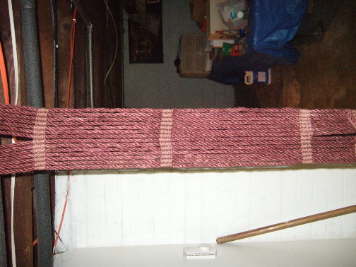

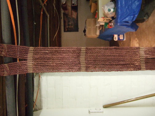

finally getting back to posting pics and the recipe I used for dyeing my girth.
This is basically Darth Mule's method with some changes
I started with 16 cups of water on the stove in a big pot at almost a boil.
Then I used liquid RIT dye 4 table spoons of Dark Brown and 3 table spoons of Scarlett
I put the dye in a 2 cup glass measuring container and added enough hot water to have 2 cups of liquid in the container.
I then added this to the pot on the stove. The rest I followed Darth Mule's method as follows except I only simmered 5 min after adding the vinegar as my belt was starting to look very dark.
Dissolve 1/2 cup plain salt into 2 cups hot water and add to dyebath. Be sure to do this after the dye has been added and mixed into the dyebath.
Add belt and stir frequently until dyebath reaches just below boiling and simmer there for 10 minutes.
Add 2/3 cup white vinegar and simmer an additional 15 minutes stirring occasionally.
Remove from dyebath and rinse belt until water runs clear. If it doesn't look dark enough for you. Put it back in the dyebath and let it stay in longer this time.
I added 2 images one with flash more red and one without brownish

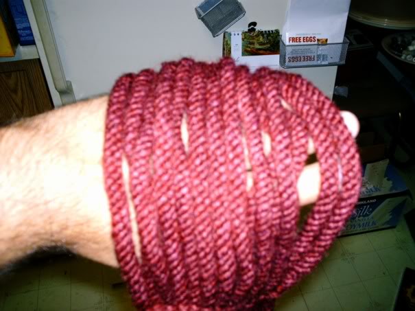

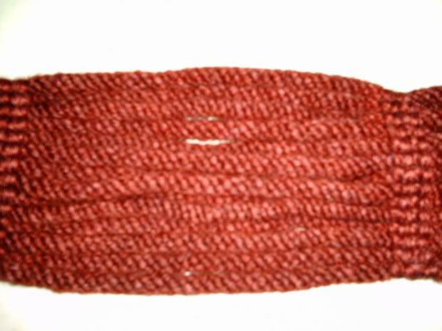

ok i dyed mine with great results, came out like shinobis above, heres what I did
2 1/2 gallons very hot water on stove
added 1/2 cup of salt and 2 4 finger pinches of powder detergent
stirred
1/2 bottle of Rit Wine Red
strirred
1 bottle of Rit scarlett
stirred
wet belt with hot water and added to dye for 30 minuted stirring about ever 5 minutes
rinsed belt with cold water until water coming off was pink
ran through warm wash cycle w/ 1/2 cap of liquid detergent
it is still pretty damp in the pic
