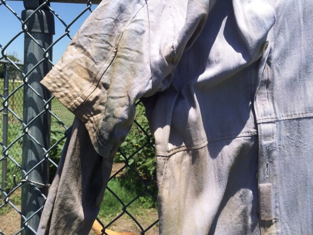

I don't mix I literally just use spray paints and mist them on the fabric. Keep the nozzle well away from it and then move closer until you see the results you want. I use a mix of colors to get the results I want. If you are worried about the learning curve just start on some scrap fabric or an old pair of khakis or something. You can see how the results are before jumping in on the real thing.
Here is a pic of my flightsuit as I was doing this technique.
As you can see I just threw it over the chain link fence and misted the paint on using the breeze. I tried to make the parts that would be dirtier.........well dirtier by giving it more and then tapering off the farther away I got.

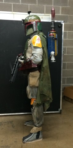

Here is how it looks once I got done...........this side shot shows the leg and cape weathering along with the arms...
