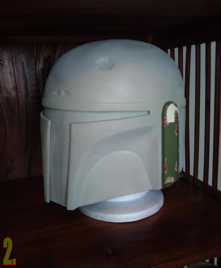

PREP STAGES

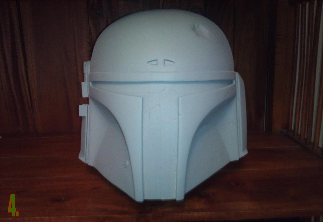

I actually hate this part, but it has to be done. I have given some shots of the raw kit, then some where I added in the appropriate nicks and scratches, and a finally primed and basecoated lid ready for action. I am mainly using Humbrols with a couple Floquil colours here and there. The basecoat is Humbrol light grey (147). I’d like to take this time to send out big props to Terminal Fettler for his Humbrol colour lists, and also to Ponte for some variant ideas..

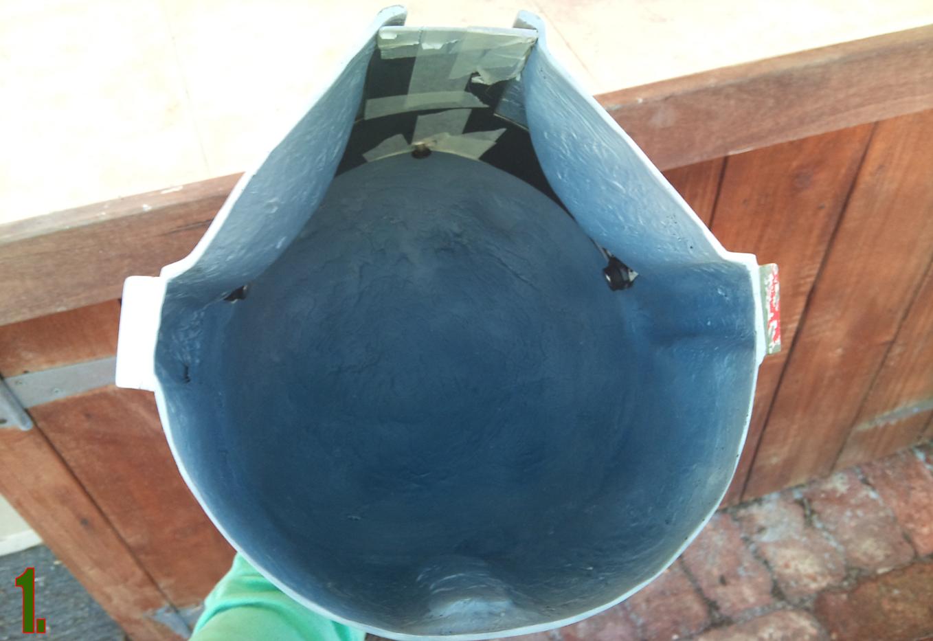

INTERIOR
Still some work to be done here, but have sprayed the interior blue/grey shade, making sure it is heavier at the top in colour. It is actually very close in person to the reference pics, but is a little hard to nail down in photos, as because it is dark in the dome, you either put the flash on which makes it seem bright blue, or have no flash where it looks a little too grey. I think the photo I have here gives a fair idea though. I always prefer to spray the interior first, to limit getting any interior paint on final outside paint job (Probably just me becoming a pedantic old fart..) This section will be updated, as I have an exact replica interior also from james to add in, as well as the hard hat liner and other nooks and crannies. Once complete, the interior should look very authentic (fingers crossed anyway..). This was also the time where I fitted my visor via Chicago screws, and will fit the metal holders for the bottom of the visor later down the track after all the paint..
LEFT EAR

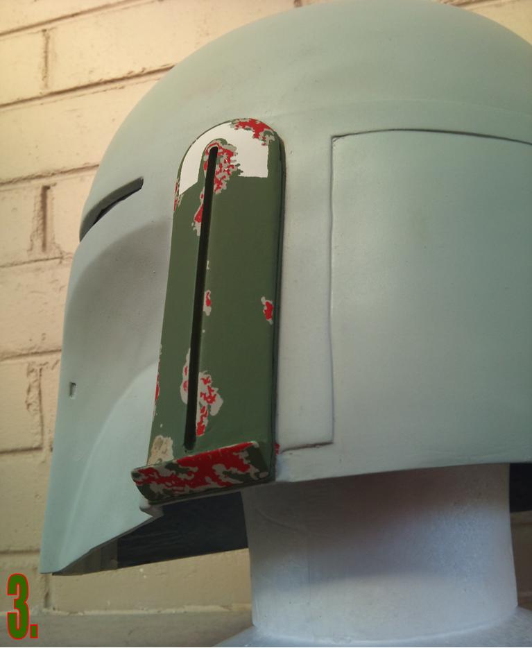

A pretty straightforward job here, the main thing that took time here was the white decal (which I am painting on this time round and not using decals), just making sure it was nice and even. Real happy with the finish, and used TF’s colour list exact with lovely colour results. I did weather up the little ‘cloud like bubble’ shape on the bottom left with a rust type colour as per the ref pics. Its one area where many of the excellent stencils have red in them, which isn’t actually present on the real lid. With all my paint, I use the stencils as much as possible, but there are some inaccuracies, so I am constantly going to the reference pics (and getting square eyes in the process.. :/) the final upside down ‘E’ decals I have rub on letters for which I will add down the track..
Left Ear Colour List : Humbrol (147) base coat, Humbrol Red (60), Humbrol Grey (28)+(64) 1:1 ratio, Humbrol Green (159)+(78) 1:1 ratio, Humbrol white (33) for decal.

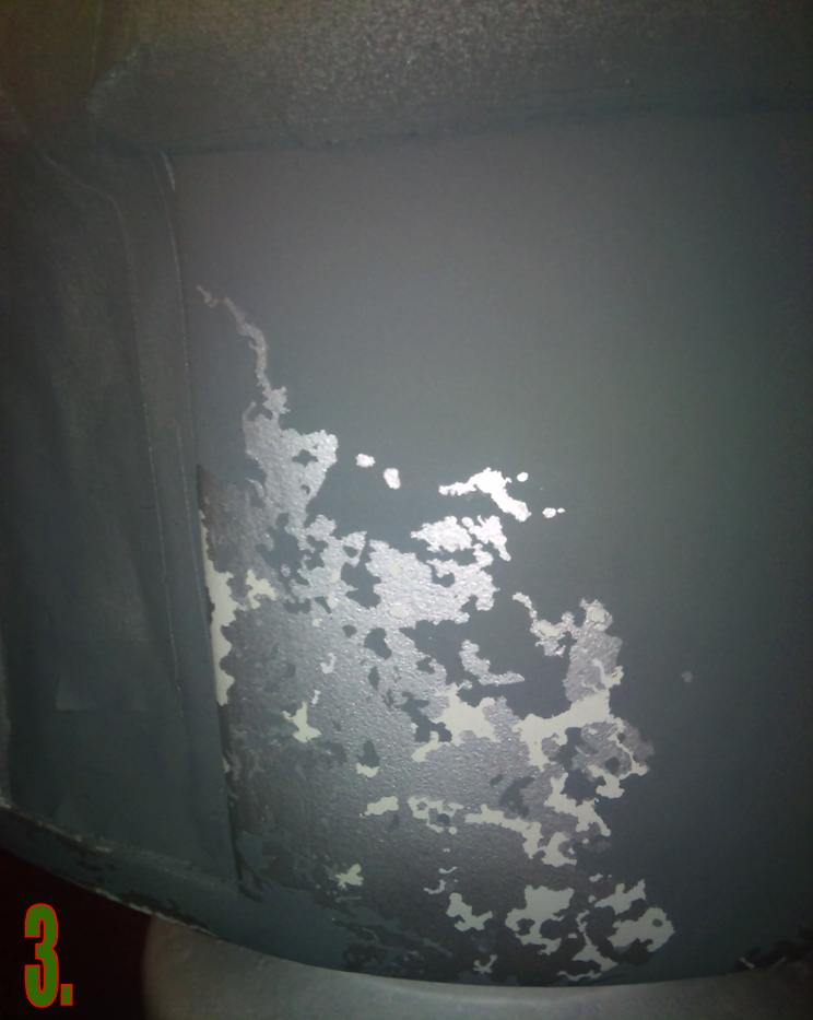

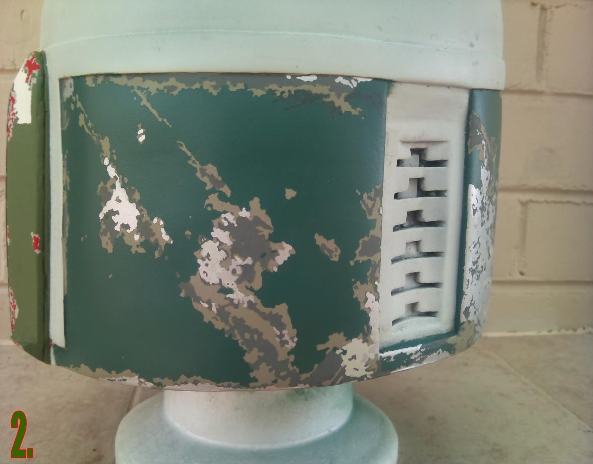

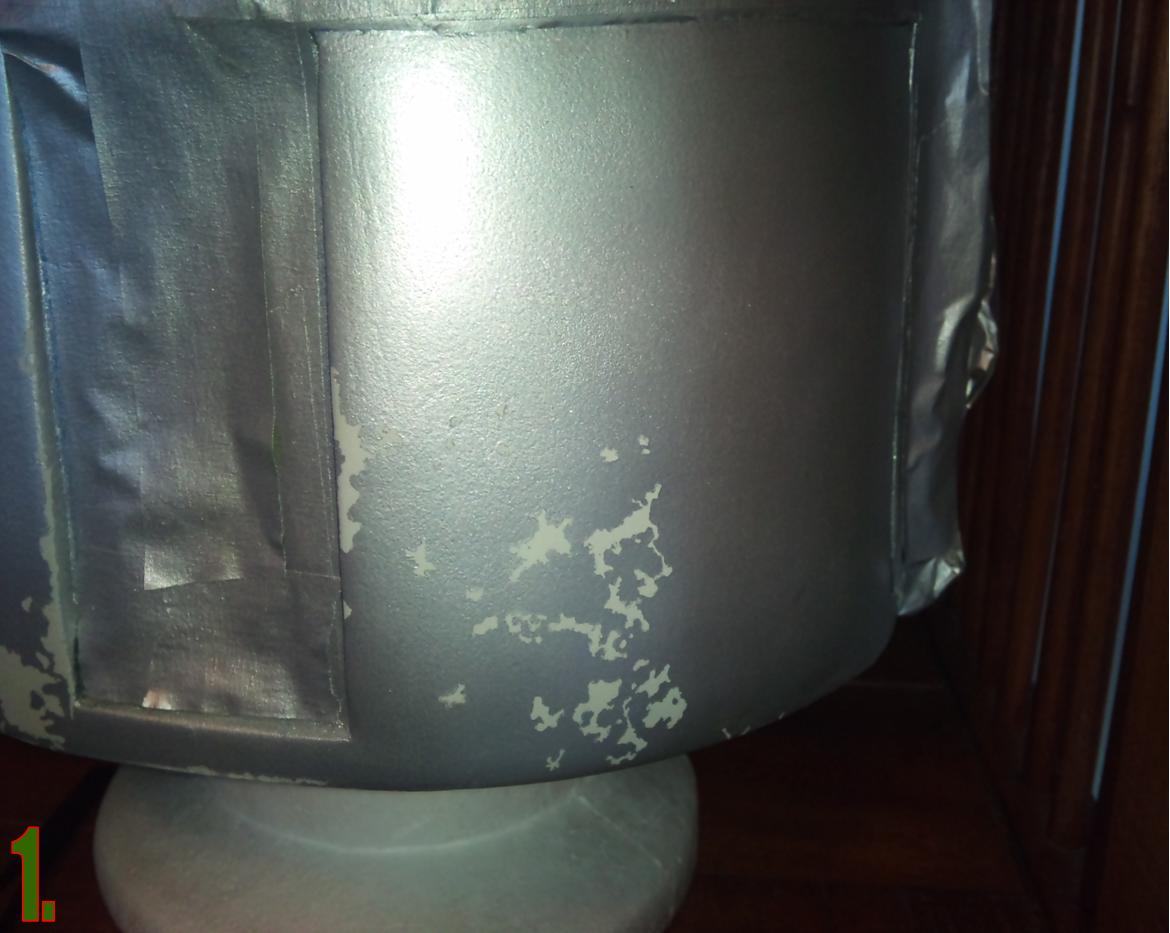

BACK PANELS

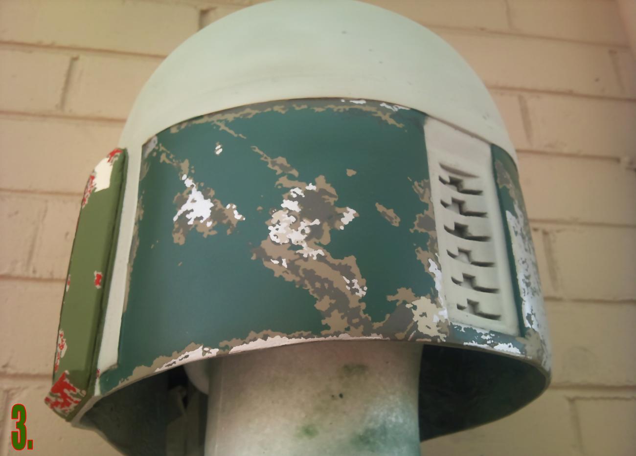

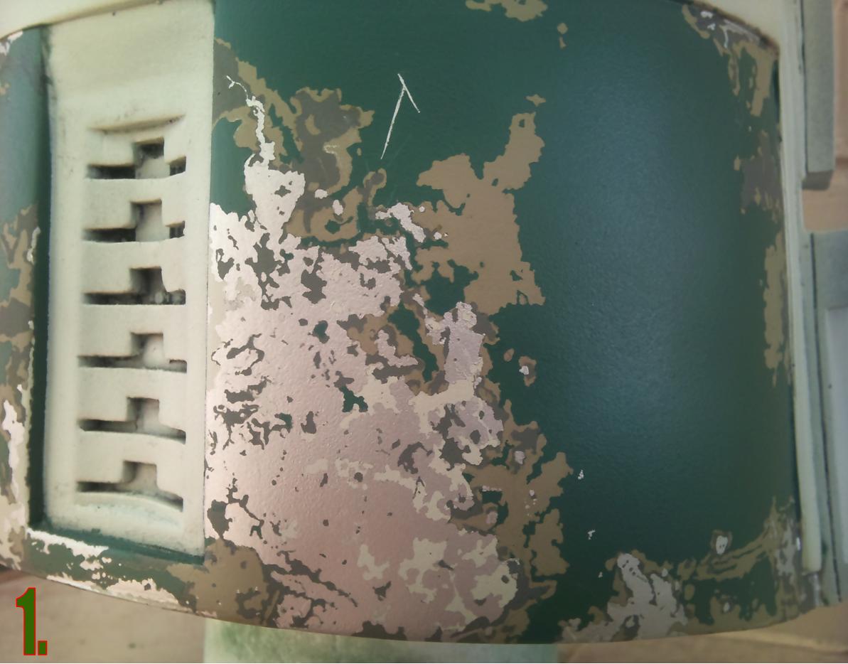

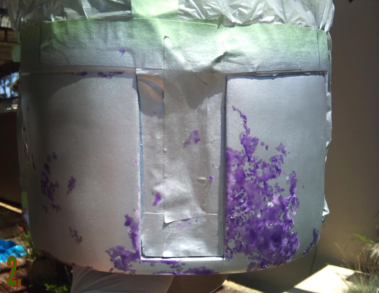

Wow, these were seriously time consuming. Some of the stencilling and liquid mask sessions were marathon sessions, and while I was rapt with the result, I won’t lie in telling you I loved every minute of it – far from it actually. But, the moment where you peel all that liquid mask off, and your paintjob stars to come to life, definitely is rewarding. It’s at this time i’d like to thank the excellent Humbrol Maskol – Such a great guy. Such an easy masking fluid to use, I’ve had very few if any bad experiences with it, and even while waiting for a colour to come in, and leaving it on for a week, it peeled off as easy as if it had only been on a day. Really happy with my back panels, I aimed to get them as close as possible.

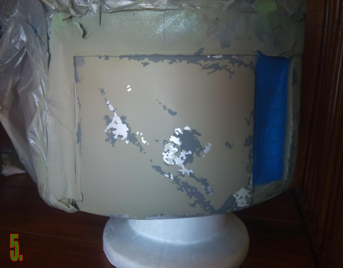

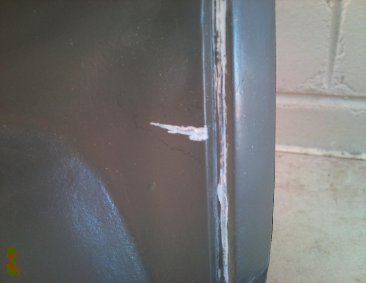

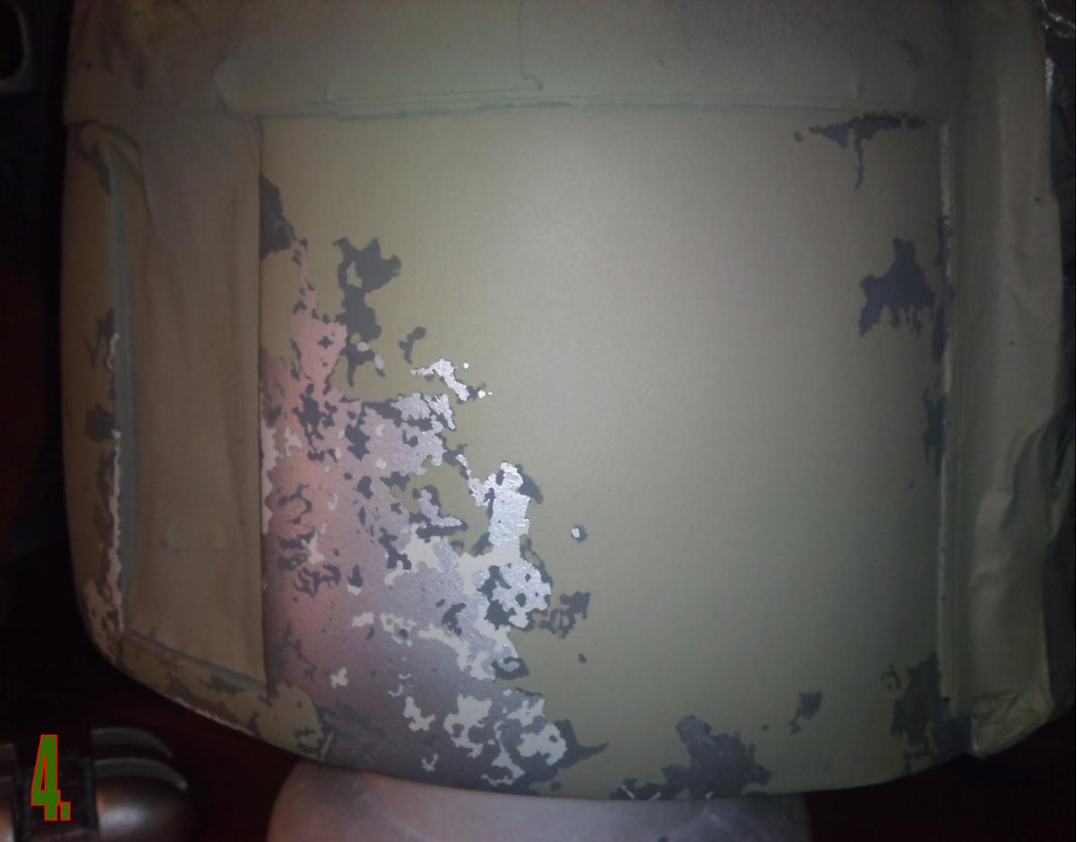

BACK PANELS (cont...)

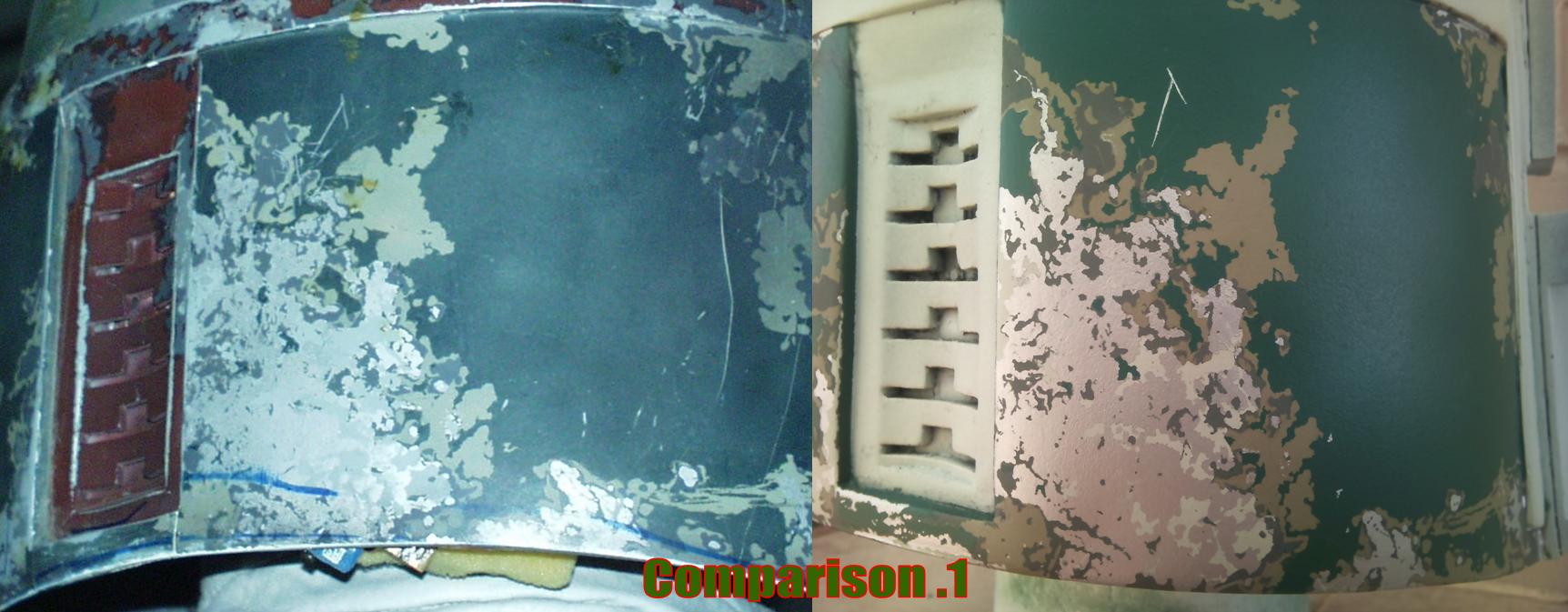

Still in the process of adding in all the fine scratches (you will see the start of these on the right panel upper angled ‘T’ shape scratch starting to get added, and you may sight some light water soluble white pencil reference lines), and a few fine details, but they are essentially 98% done. Used all of TF’s colours once again, except I used Floquil ‘Concrete’ for the beige, as I still think that is the closest. More to come over the weeks peeps..
Back Panel Colour List : Humbrol light grey (147) base coat, Humbrol Silver (11), Humbrol grey (79), Floquil Concrete, Humbrol Green (76) + Blue (96) mix ratio 1:1.
