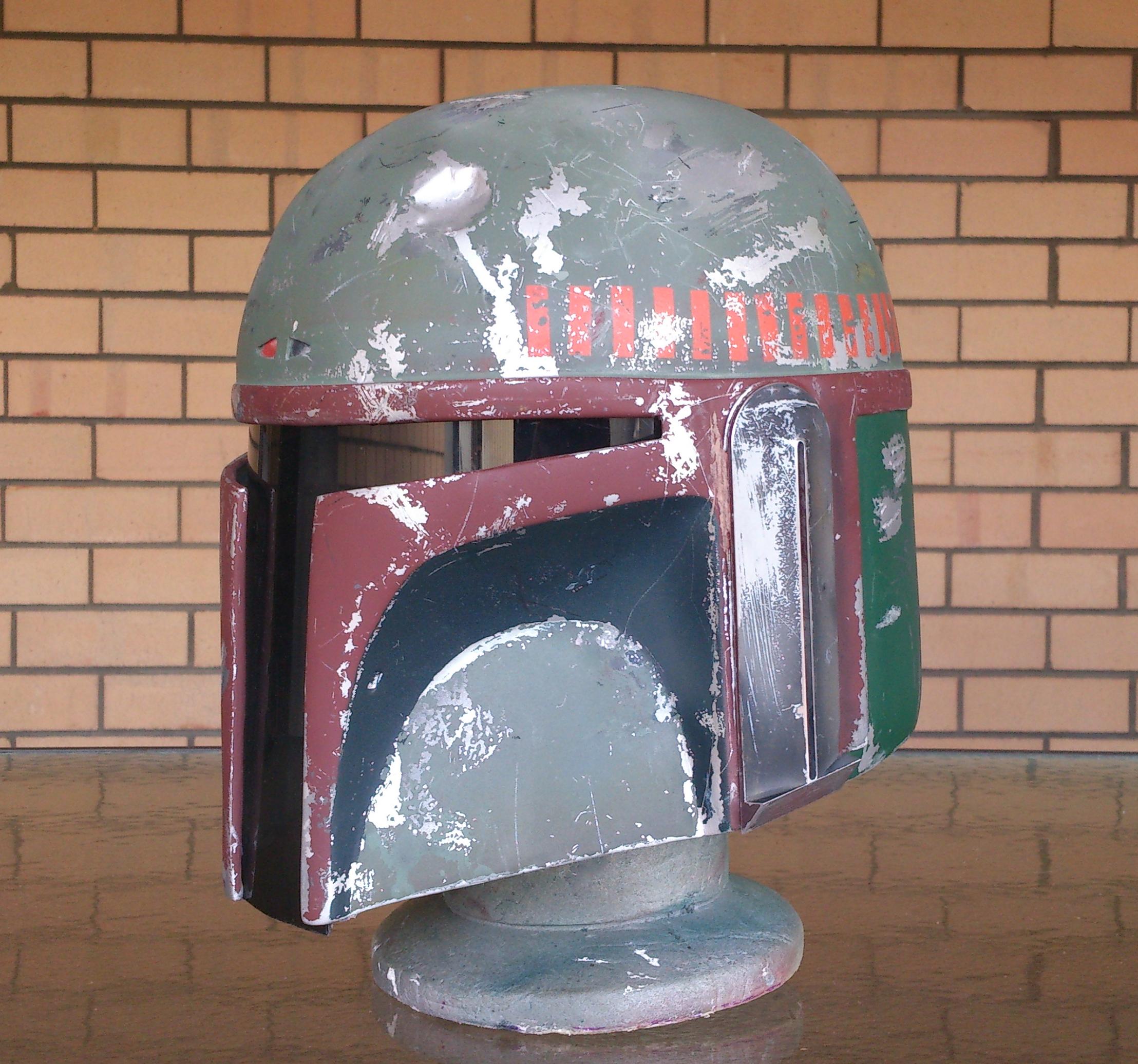

*UPDATE 2013* WIP : Jayvee's 'lil' chunk of ROTJ love' paint up
8th MAY 2013

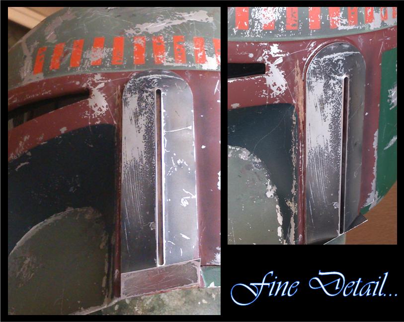

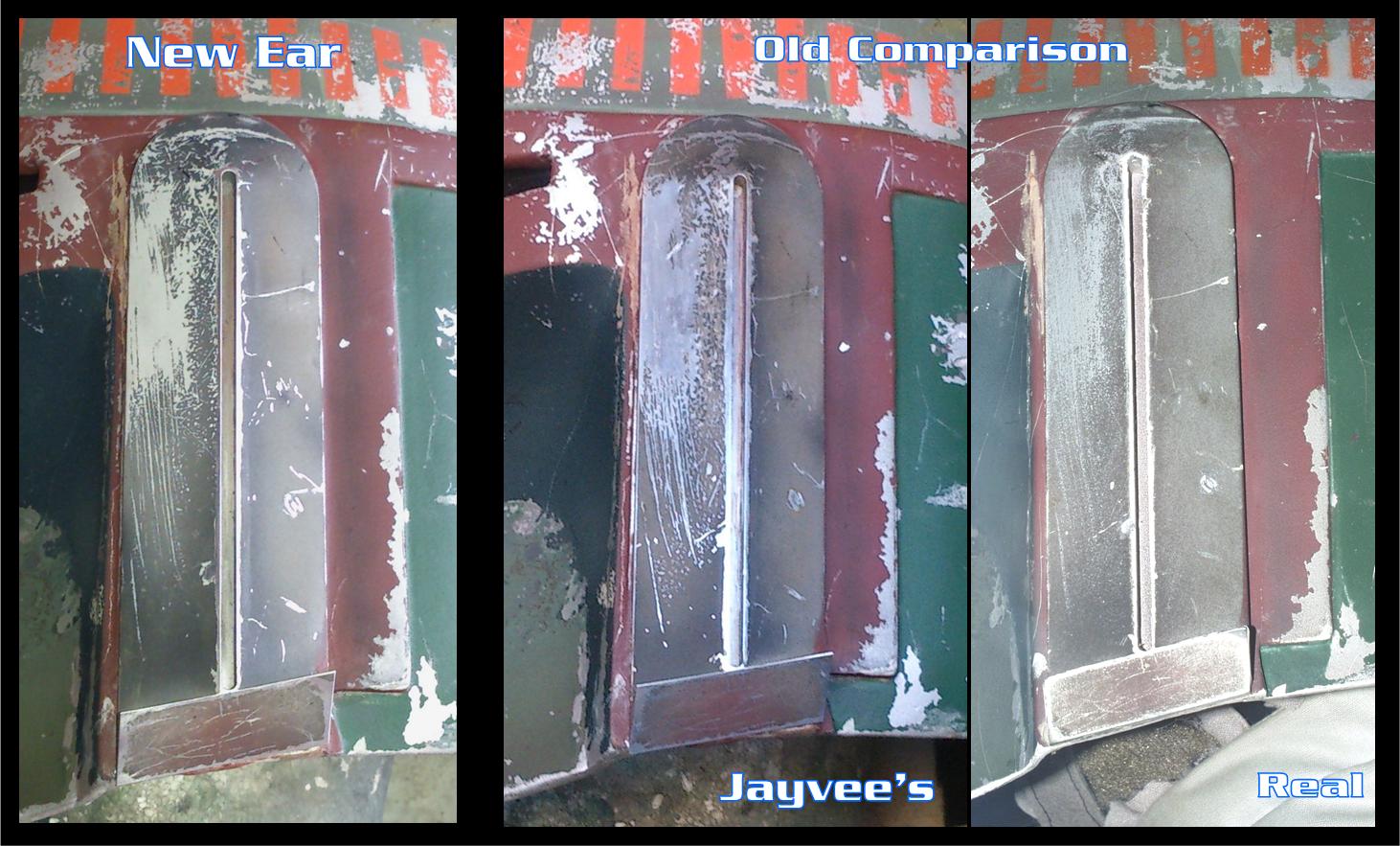

Morning Fett-Pimps and Pimpettes! I’ve been steadily working away at this lid, and in the last week, been able to nail down some fine details like the sides of the ears, some drips and stain marks and a few other minor odds and bobs. I have also weathered up the RF topper and am in the process of weathering the stalk, so all those knick-knacks should have photos ready in the next week or so...
This update is an addition of the ears update. My vey excellent ‘spare set of eyes’ – Garrett (Terminal Fettler), pointed out that I missed an underlying colour on the non–rangefinder ear. Of course, the great man was spot on the money, so I went about correcting it :thumbsup:. I was originally just going to use some washes to bring up the shade, but didn’t like the test results, so simply stripped part of the ear and started again – this time placing a nice light basecoat of super light grey (Humbrol 147 – this has also been updated in the first posts colour list).
Once that coat was down and dry, I re-stenciled my areas to remain this light grey/white shade, and then masked to reapply the darker mists of grey, gunmetal etc to match the rest of the ear and the reference pics. Once done, I started on the fine detail work, and bazinga – a new ear was concocted! I was very happy with this, as I really took extra time and care to get the patterns more correct, and I think it is now far closer to the real ear in colour, damage patterns and fine detail. A big shout out to Garrett for his Spidey sense and keen detection skills, and super stoked I could get to what I feel, is a better result than before :D. Some light pastel weathering will be applied to dirty the light grey up a tad down the track, but it is actually not quite as white as it appears in the early photos, and some fine detail is a tad washed out in the pics - due in part to some storms going on with shifting light when I was taking the photos and some light refracting off. Overall though, this lot of pics should give a general story. Peace my friends, thanks for looking!

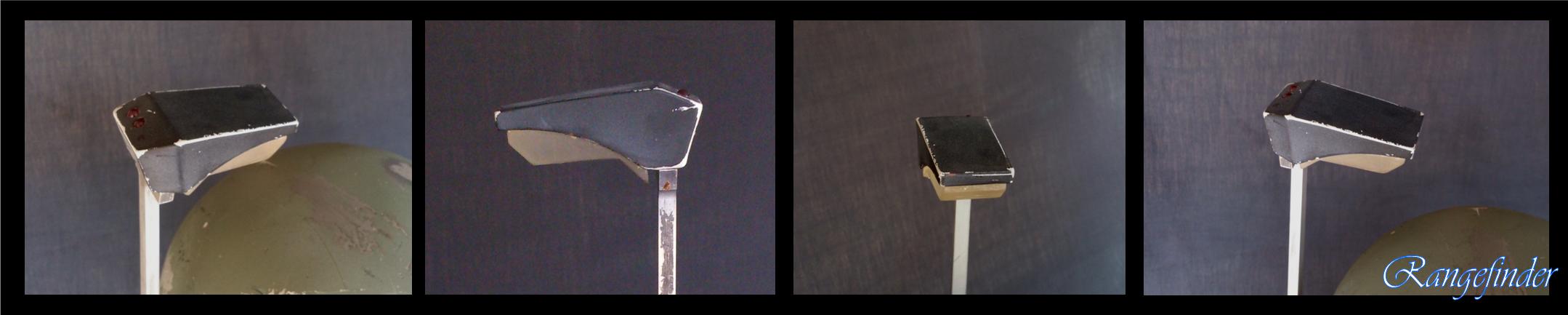

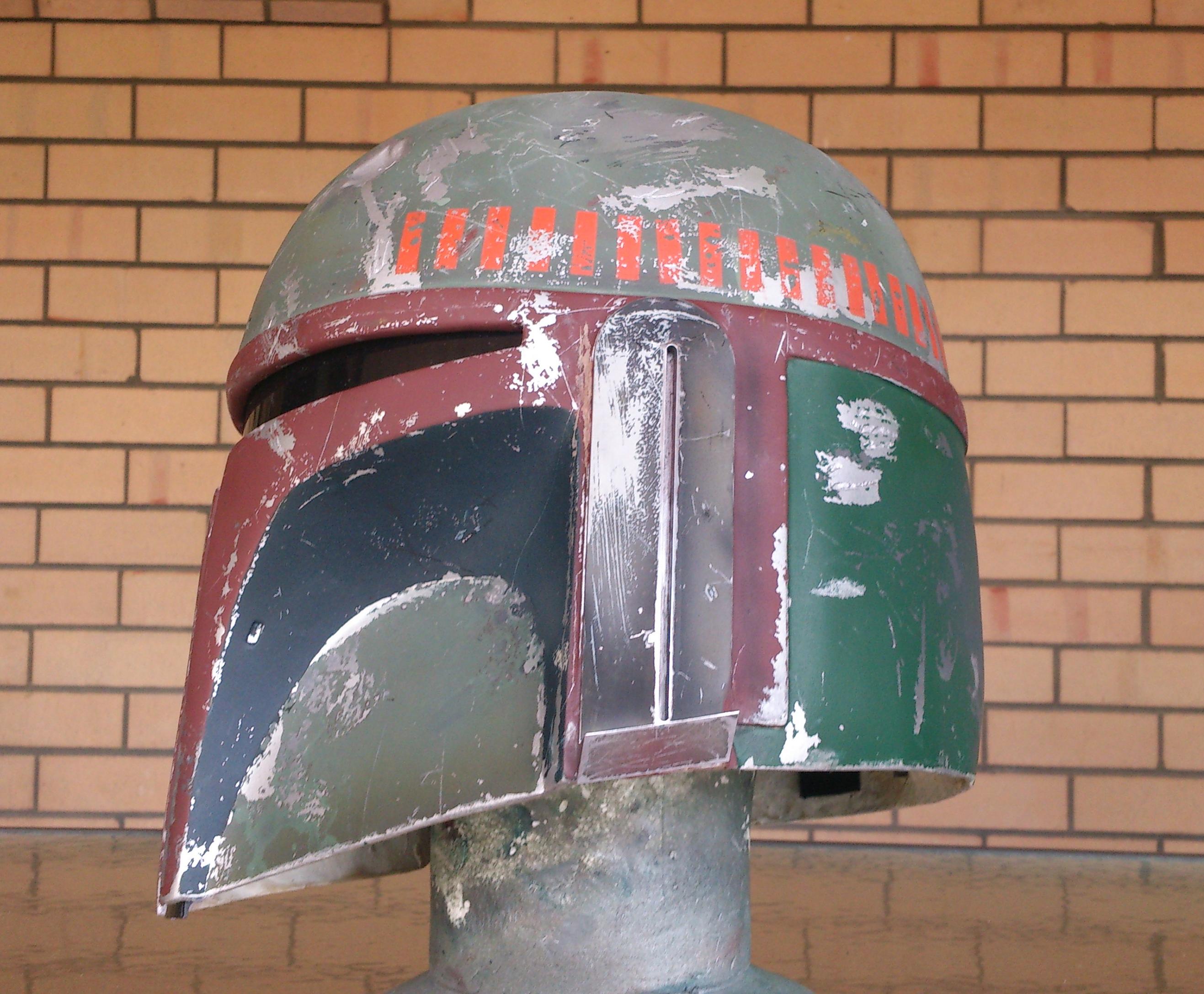

Howdy Fett-Superstars! Another small addittion to this thread, which sees 99% of he main exterior paintwork done. Here, we have ther rangefinder stalk and topper, and this one was really fun to do. I also have some fine detail work which is shown in the next post..
Now, pretty standard stuff here, but trying to get the damage patterns correct is always the challenge. I noticed that the black paint of the topper, was stripped down in parts to the underlying gel coat; as well as appearing to have a misting and 'dusty effect' over the black, and darker black scuff marks could be seen within. I tried to emulate this by adding a basecoat super light grey (humbrol 147) first, then layering the black on the main area. I liquid masked a few of the darker black scuff marks, and then super lightly misted over the black with light grey (humbrol 147) to achieve the dusty effect.
The stalk was another, that seems like it has actually been painted silver over the metal, as the corners and scratches within it were far brighter than the main body. I used humbrol aluminium (56), which has a slightly more bluish tinge than straight silver. I then applied the damage in the right spots, and sanded back corners etc to reveal the bright metal. Overall, very happy, but the light just wasn't on my side today, so you can't pick up a lot of the subtle colour changes in these photos.
In any case, we have pics of the different angles of the RF topper in 1; some shots of the topper and stalk as a whole in 2; and a detail comparison pic in 3. In the comparison pic, you may be able to see that I even tried to emulate the cut off brass screw on the underside. There is also an oval shaped one on the rear of the stalk which I added in also.. :)

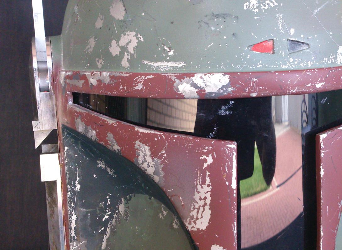

And then, onto some fine detail areas. These are areas that many miss out, but are the important things for me in the accuracy stakes. Pic 1 is showing the small orange substance drops up the rangefinder ear. I imagine it was a glue of some sort, but I was able to replicate it with a humbrol clear orange paint (which is actually a nightmare of a paint to use). There is also some of these drips elsewhere around the helmet. Pic 2 is something I really wanted to include and get right, and its the small white scuff marks on the actual visor. The MOM version definately has these, wether they were on the hero lid in the movie, im not certain, as I haven't investigated. Pic 3 shows the earcap off revealing the micro-switch, and also the newly finished up rectangle seperating the top and bottom earpiece. You may be able to detect some more orange scuffs on this section.
