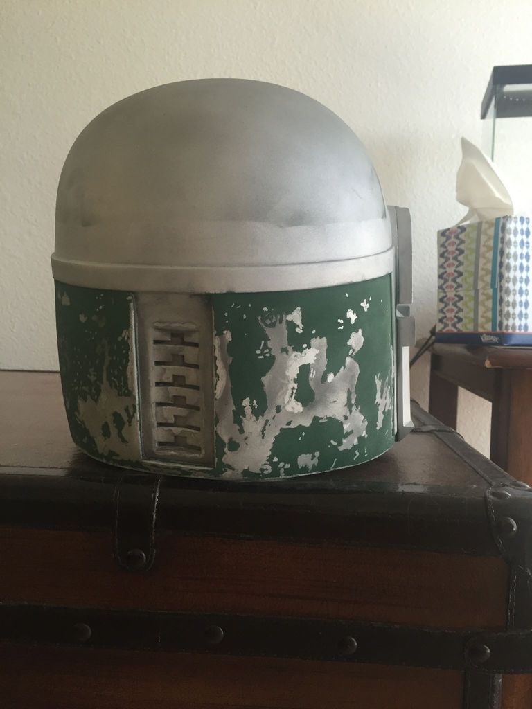

It seems to fit... Although I can't compare side by side since Floquil went out of business, but side by side via pictures and testing before I paint it on, it seems to fit.
Awesome bud. I felt it didn't have enough bright green 'pop' to it, but that's great that it looks the goods for you and could be well worth investigating ☺

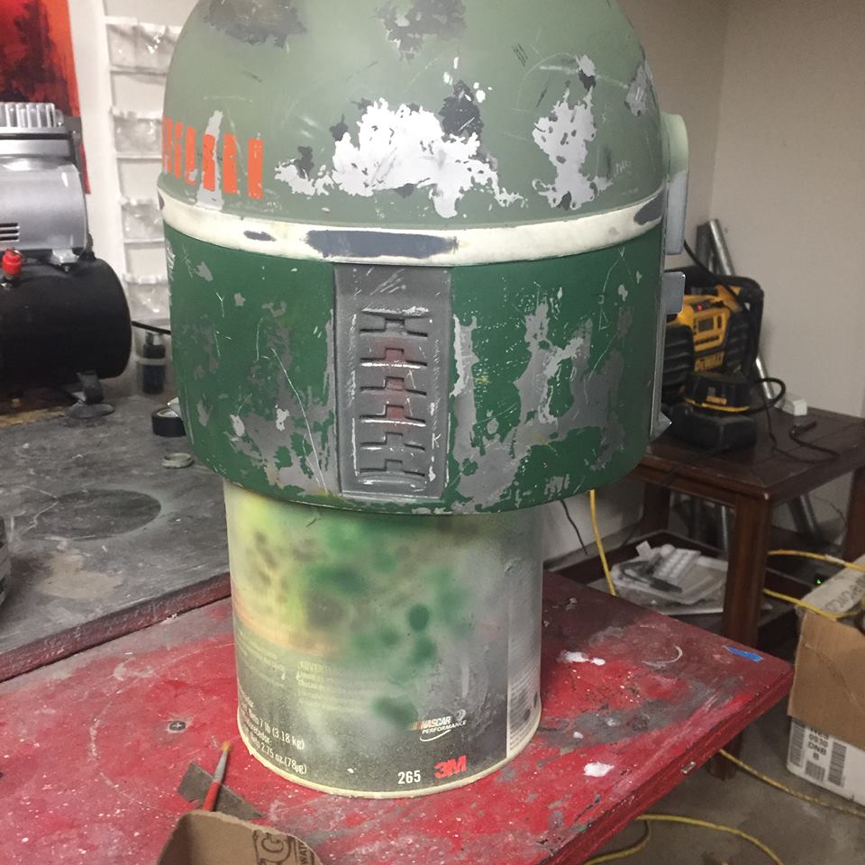

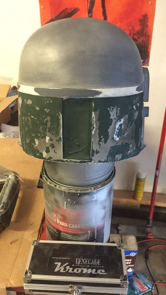

Gonna have to repaint because for some reason Mona Lisa mineral spirits paint thinner doesn't like Humbrol enamel paint..... Almost no adhesion to the paint and the Maskol to most of the gunmetal, tank and ocean grey with it :/ The Silver was thinned with some mineral spirits i got at home depot and did the job well.
