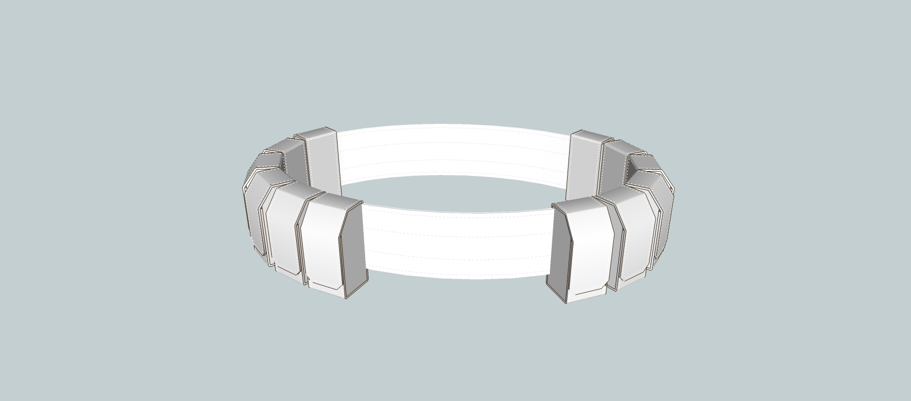

Hi Peregrinus, thanks for your interest.
These are the files for the PP1 Version :
[TABLE="width: 800, align: center"]
[TR]
[TD="align: center"]Summary[/TD]
[TD="align: center"]Ref pics[/TD]
[TD="align: center"]Belt overview[/TD]
[TD="align: center"]Pouches [/TD]
[TD="align: center"]Belt's ends[/TD]
[/TR]
[TR]
[TD="align: center"] PP1 Belt summary.jpg[/TD]
[TD="align: center"]PP1  belt description and ref pics.jpg[/TD]
[TD="align: center"]PP1 Belt scaled .jpg[/TD]
[TD="align: center"]PP1 Belt Pouches.jpg[/TD]
[TD="align: center"]PP1 Belt ends.jpg[/TD]
[/TR]
[/TABLE]
And the link to download Sketchup file : Sketchup file

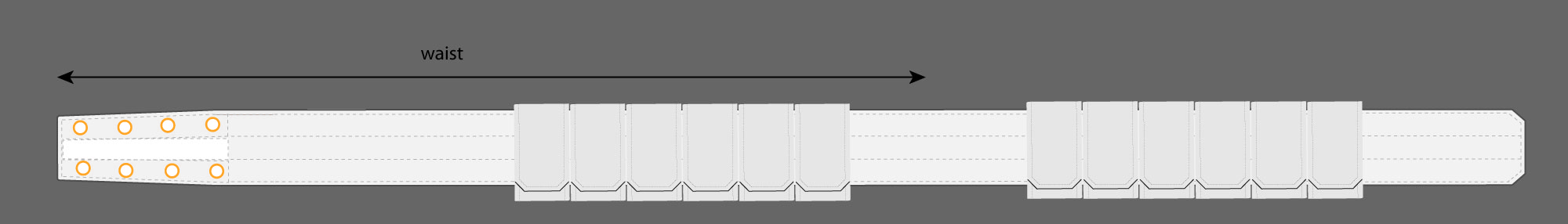

Super Trooper (ST) Version :
[TABLE="width: 800"]
[TR]
[TD="align: right"]
Ref pics​
[/TD]
[TD="align: right"]
Pouches​
[/TD]
[/TR]
[TR]
[TD="align: center"]ST Belt summary .jpg[/TD]
[TD="align: center"]ST belt description and ref pics.jpg[/TD]
[TD="align: center"]ST Belt scaled .jpg[/TD]
[TD="align: center"]ST Pouch measurements.jpg[/TD]
[TD="align: center"]ST Belt ends.jpg
[/TD]
[/TR]
[/TABLE]
Sketchup File : Link

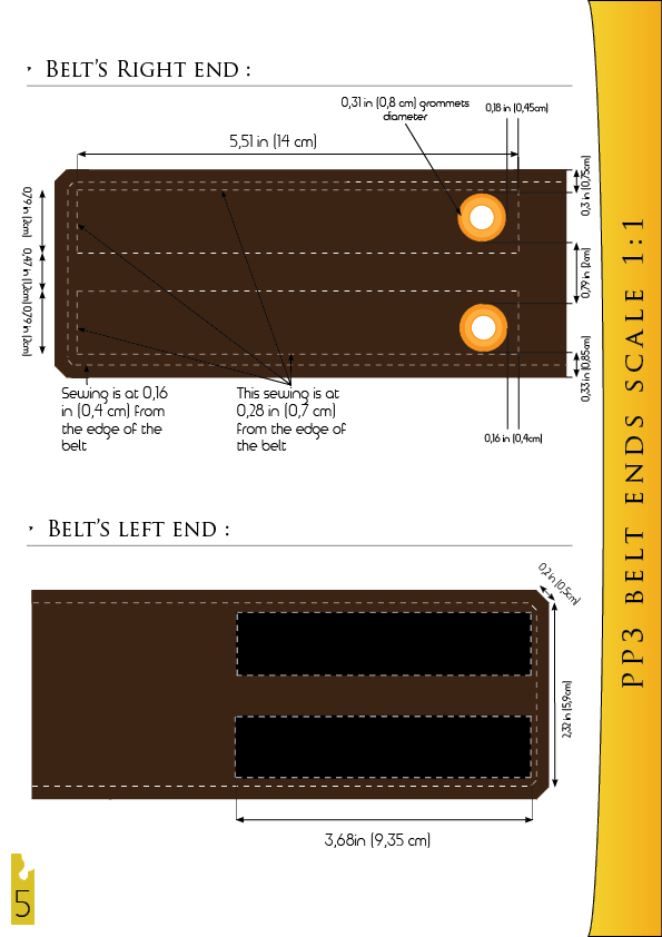

The PreProduction #3 (PP3) version :
[TR]
[TD="align: center"]Description[/TD]
[TD="align: center"]Belt scaled 1:4[/TD]
[TD="align: center"]Pouches[/TD]
[TD="align: center"]Belt's end[/TD]
[/TR]
[TR]
[TD="align: center"]PP3 Belt summary.jpg[/TD]
[TD="align: center"]PP3 belt description and ref pics.jpg[/TD]
[TD="align: center"]PP3 Belt scaled .jpg
[/TD]
[TD="align: center"]PP3 Pouch measurements.jpg
[/TD]
[TD="align: center"]PP3 Belt ends.jpg
[/TD]
[/TR]
[/TABLE]
