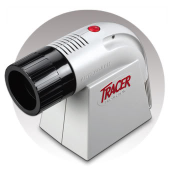

This is what I use to transfer drawings to a bigger scale right out of a regular print-out but sometimes I have to scale up or down to print. It works well for me. What I do is attach the medium ie; paper or sintra sheets on the wall from a good distance then put the projector on top of the image to be transferred. From there I trace the image down on the preferred medium.
