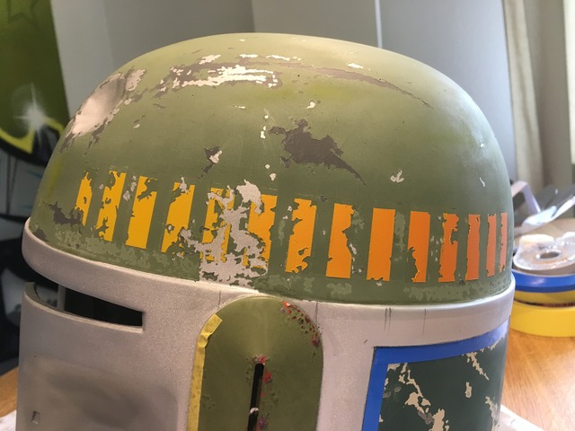

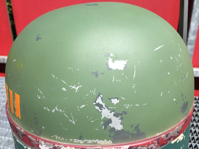

Hi, I finally finished my helmet and want to share some pictures of the making with you. My ESB WIP for the costume can be seen here:
http://www.thedentedhelmet.com/showthread.php?t=54674

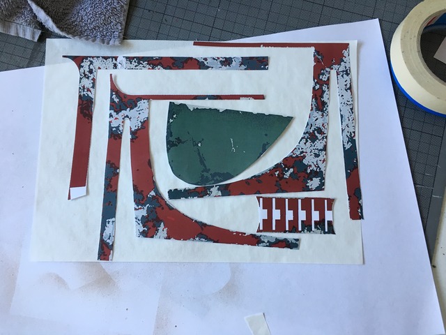

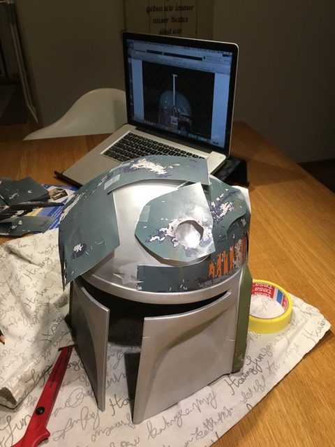

The helmet wich was painted silver along with the jetpack has to be finished. So i Printer out Rafalfett´s famous stencils wich where scaled by Armydad in this thread:
http://www.theden...hp?t=55243
Thank you both for doing so much for the community and make a first timer like me able to paint a such difficult bucket!
I used the famous paintlist in this thread:
http://www.theden...hp?t=30707

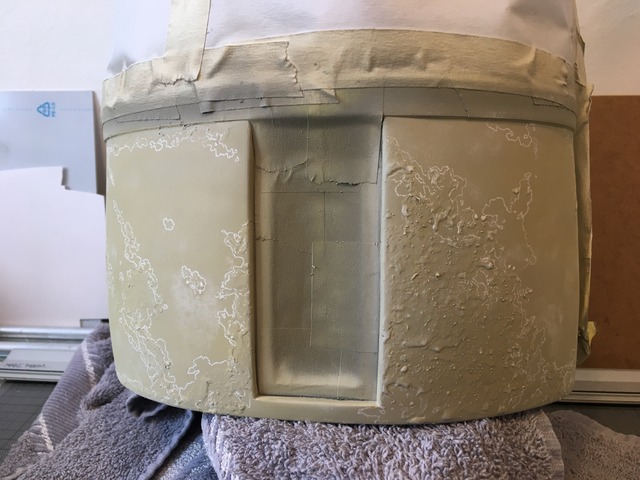

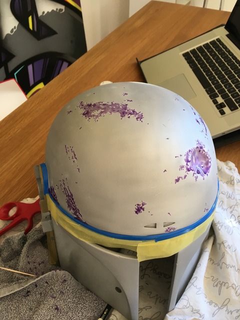

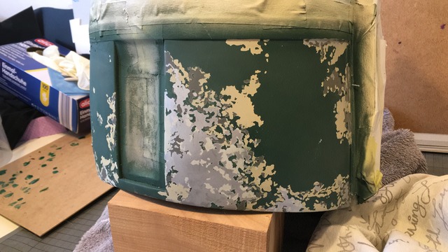

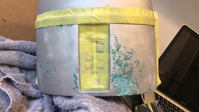

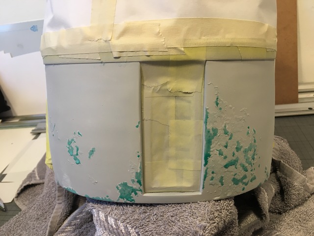

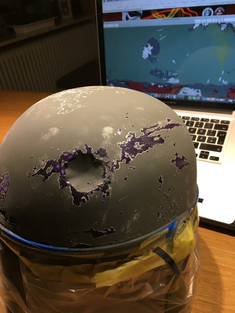

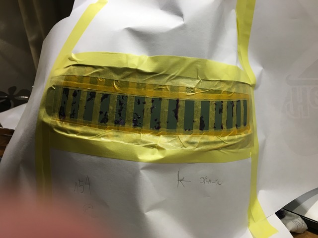

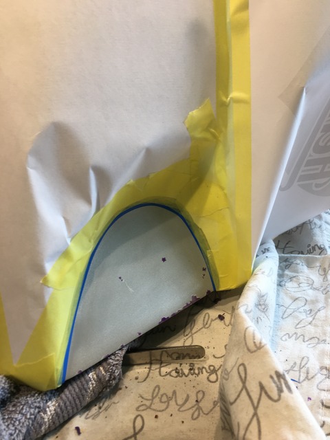

I clued the stencils with spray-clue to the white tracing paper for easy handling:

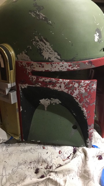

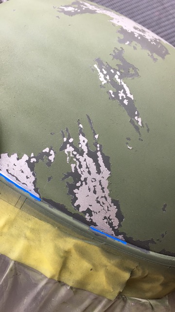

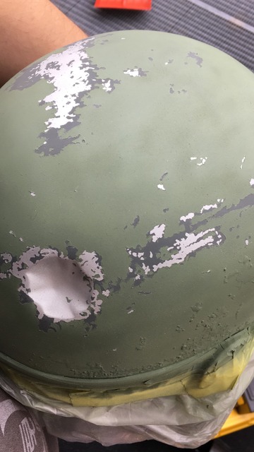

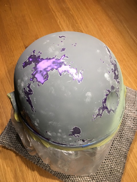

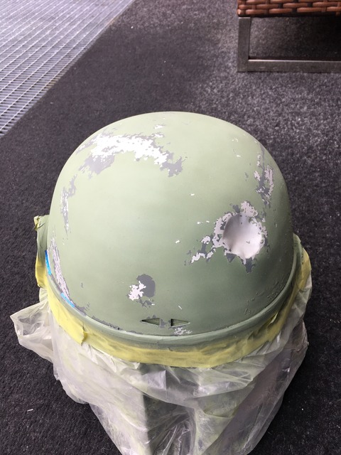

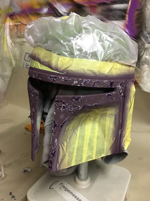

Now I went on with painting the ears and the dome:

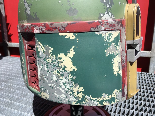

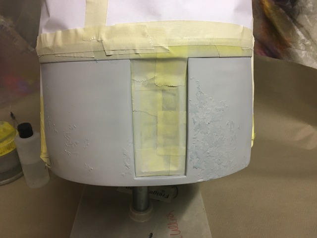

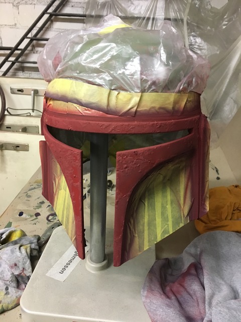

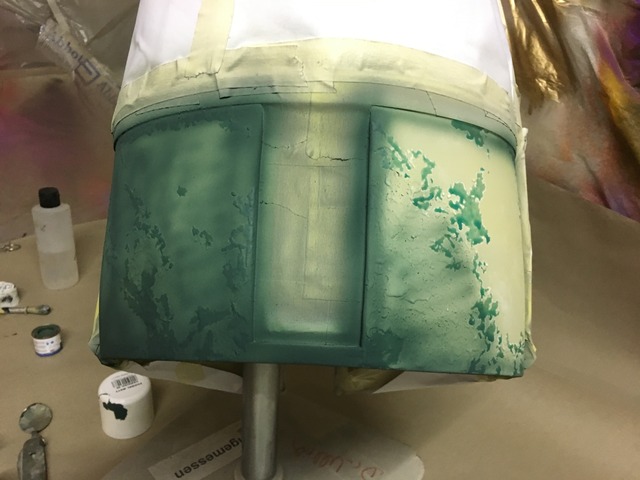

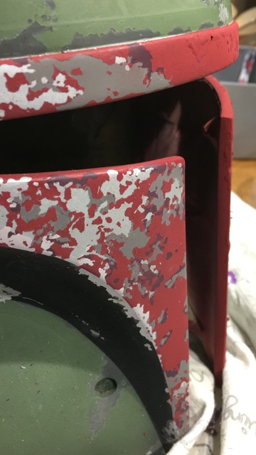

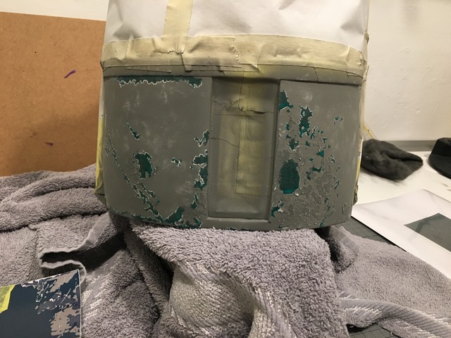

And then the cheeks and the rest:
Nearly done:

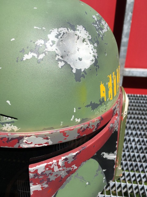

In the meantime I did some more detailing with a brush and sealed everything with clear coat. Some detailed pictures of the helmet I will post the next days...

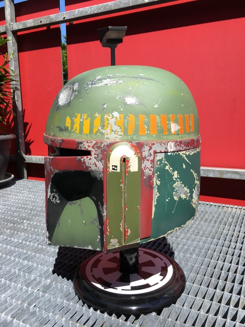

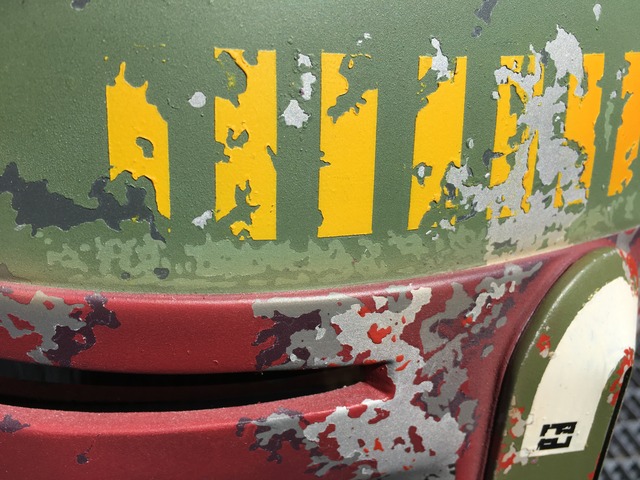

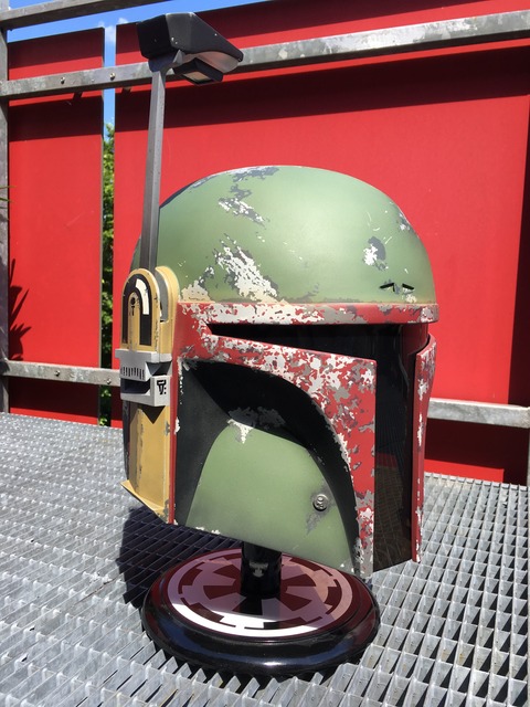

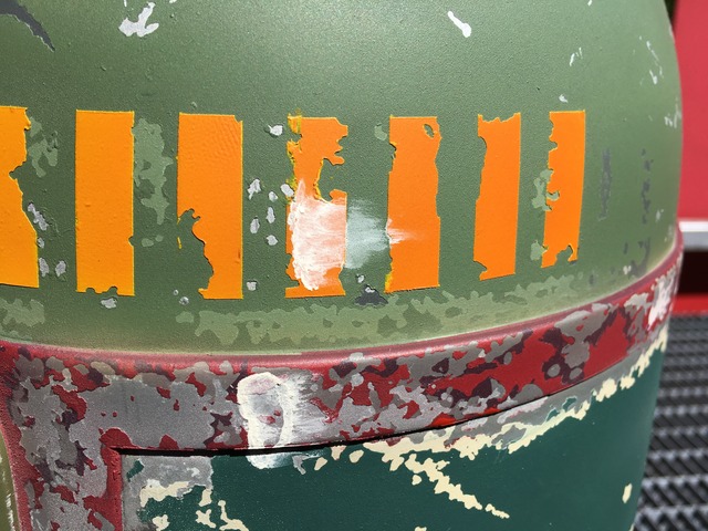

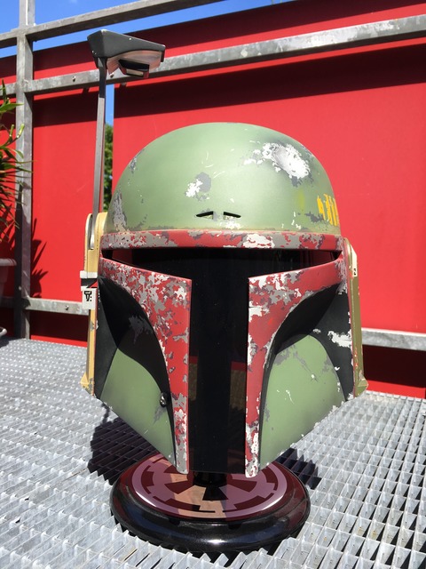

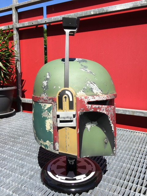

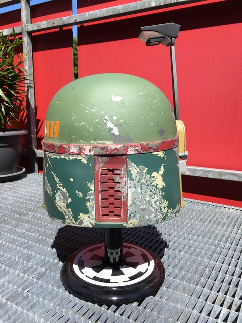

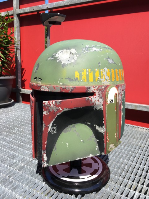

And finally the finished helmet:
I hope you like it! Because its the first helmet I painted I am pretty pleased how it came out...

I tried Humbrol and I guess it was Valejo but Humbrol was much easier to remove even after days and with layers of paint over it.
