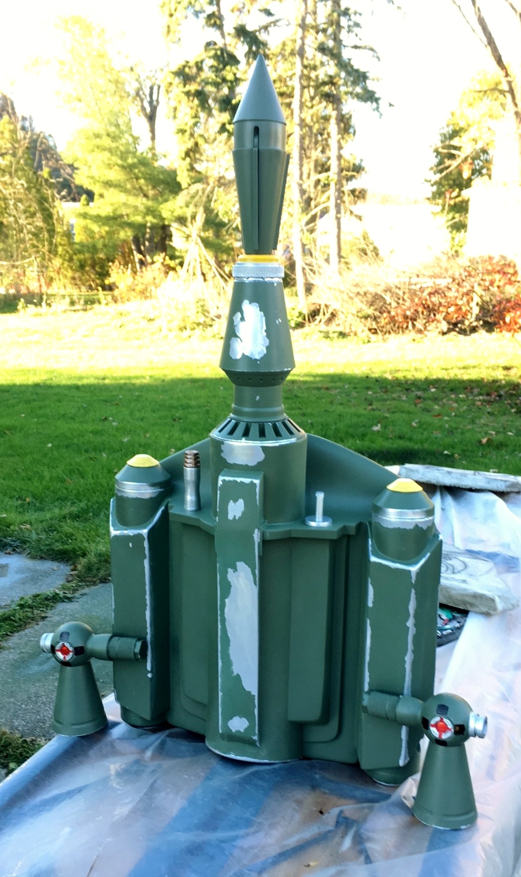

FINALLY! A noteworthy update for a change! After sitting in the box for almost 2 months, I finally started to paint the Jetpack. I started with the fuselage and a few of the smaller pieces. Unfortunately, I ran out of daylight before I could take pictures, so those will follow later (hopefully tomorrow). I started with 2 solid base layers of Rustoleum Metallic – Metallic Matte Nickel. Next, I used toothpaste to cover some of the silver in order to replicate the weathered areas seen in the CRL. (I’ve used the toothpaste method before on a couple of other projects with very positive results, so I just stuck with what I know.) Next, I applied 3 good, solid coats of Rustoleum Spruce Green, called it a day, and let it dry thoroughly. I wasn't happy with how it turned out; the color on the lid of the can appears darker than how it actually came out, and although it’s probably 501st approvable as is, I'm just not happy with it. I plan on re-doing it in the Krylon Italin Olive. Once it's nice and dry, I'll wipe off the toothpaste and get some pictures uploaded so you guys can give me your two cents.

Recent update: I just applied the first coat of Krylon Italian Olive onto the fuselage, and I couldn't be more pleased! It looks WAY better to me. Unfortunately, I didn't snap any pictures for comparison while it was still Rustoleum Spruce Green, but believe me when I tell you it just didn't look right. I plan on spending the afternoon painting the rest of the pieces, so hopefully I'll have some pretty sweet pictures to post up later this evening.

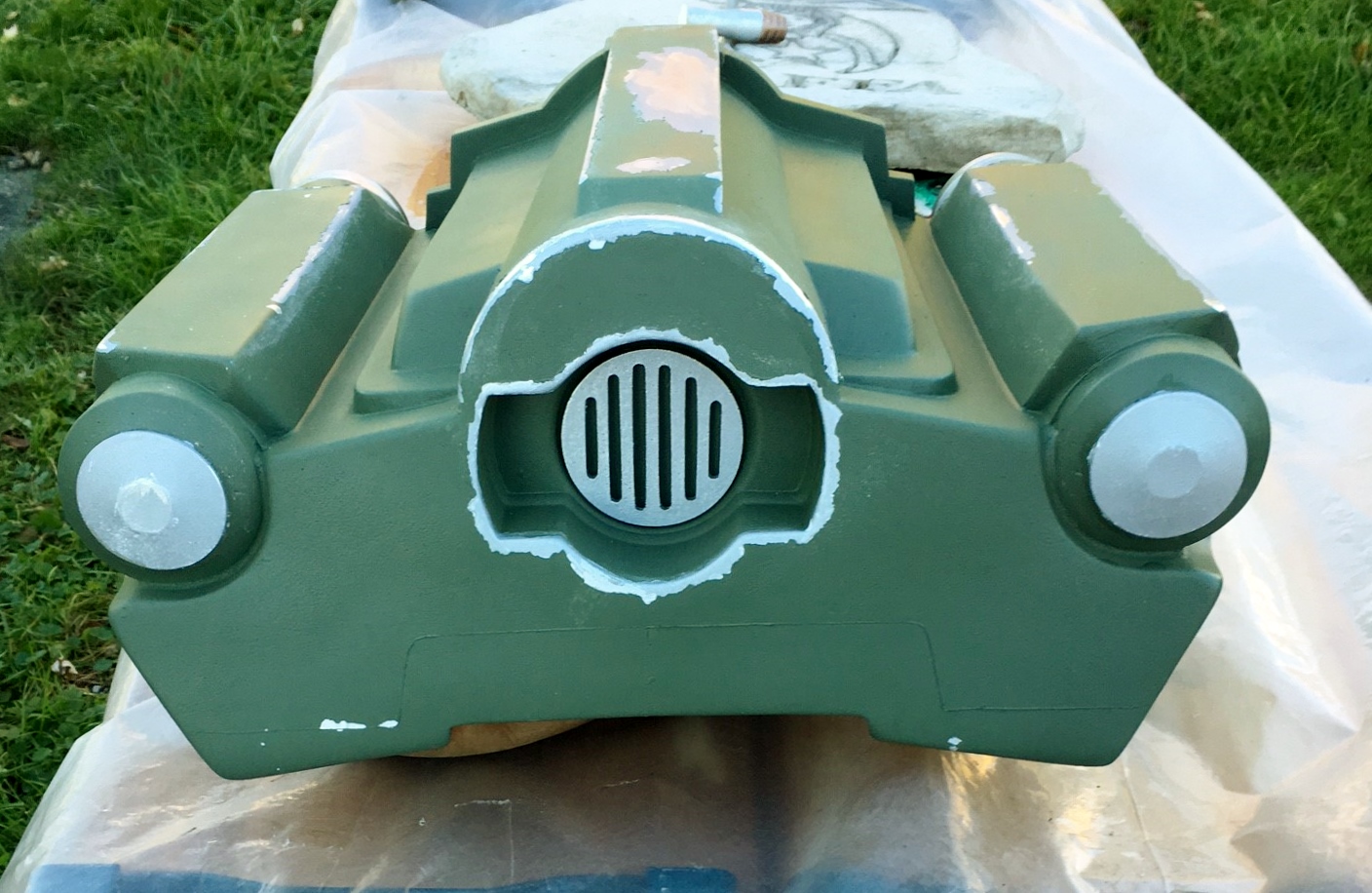

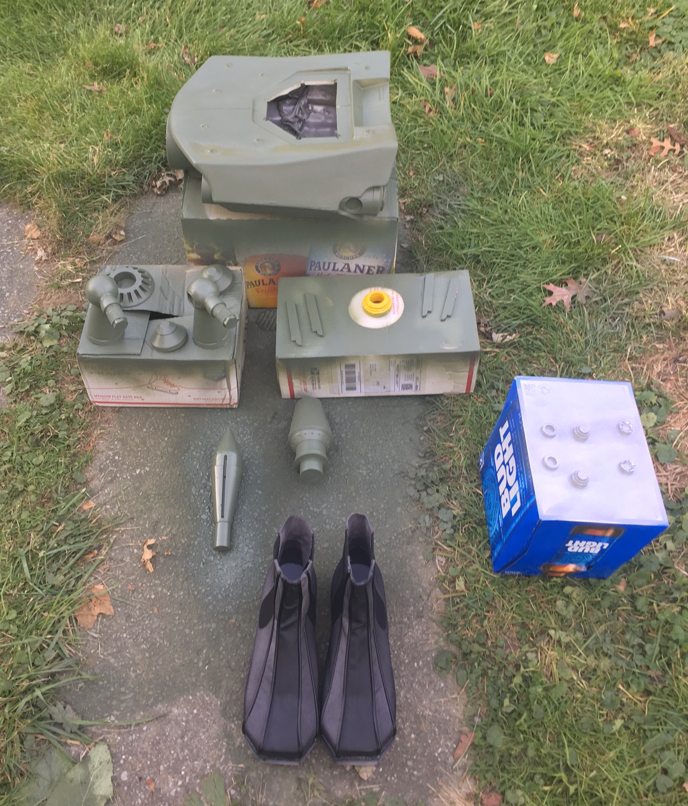

Ok, guys, here are the fruits of my labor. (And please, pardon my ghetto-fabulous sidewalk "workshop.") From what I can tell, the colors, lighting, shading, shadows, etc. in the pictures are pretty much on point and true to what it actually looks like in person. Some of the pieces appear glossy or shiny because they were still a little wet with either paint or sealant. I ran out of daylight again today before I could clean off the toothpaste and see how the weathering on the fuselage turned out, but maybe I'll get to that tomorrow. As for my boots, the first thing I did was lightly spray a medium layer of satin black spraypaint over them to tone down that new, bright gray color. Next, I used black shoe polish to fill in the center stripe, as well as create the smudges and get into the tight little cracks and seams around the soles. Although they turned out a tad darker than I originally planned, I'm pretty happy with how they turned out overall, but, I'm far from finished with the weathering process. Ok, without further adieu, tell me what you think:

Whew! Another day of painting and assembling the Jetpack, and I think it's turning out quite well so far. So, obviously, I brushed off the toothpaste, and went over the silver with a much shinier silver paint marker to really add some detail. The pictures don't really do it justice, but it looks pretty awesome in person. I really like the "burned out" effect I'm working on inside the thrusters. I still have a lot of shading to do there, but I'll get there. In addition to some more detailed weathering and shading on the main fuselage, I still need to paint and attach the "piano keys," drill out the holes and build the PVC rig for the thrusters, and stencil on the 3 markings. Oh, and I almost forgot - for the sake of the pictures, I set the beacon light and adjustment knob on top, but they're not attached yet. I'm looking for some guidance on exactly how far back from the edge they should sit. Plus, I'm not in any hurry to glue down the beacon light, because I'd like to upgrade to one that actually works at some point. I spoke to Big Dane about getting in on his next harness run, so once I have it, I can measure, fit, and drill the holes out for that as well.
