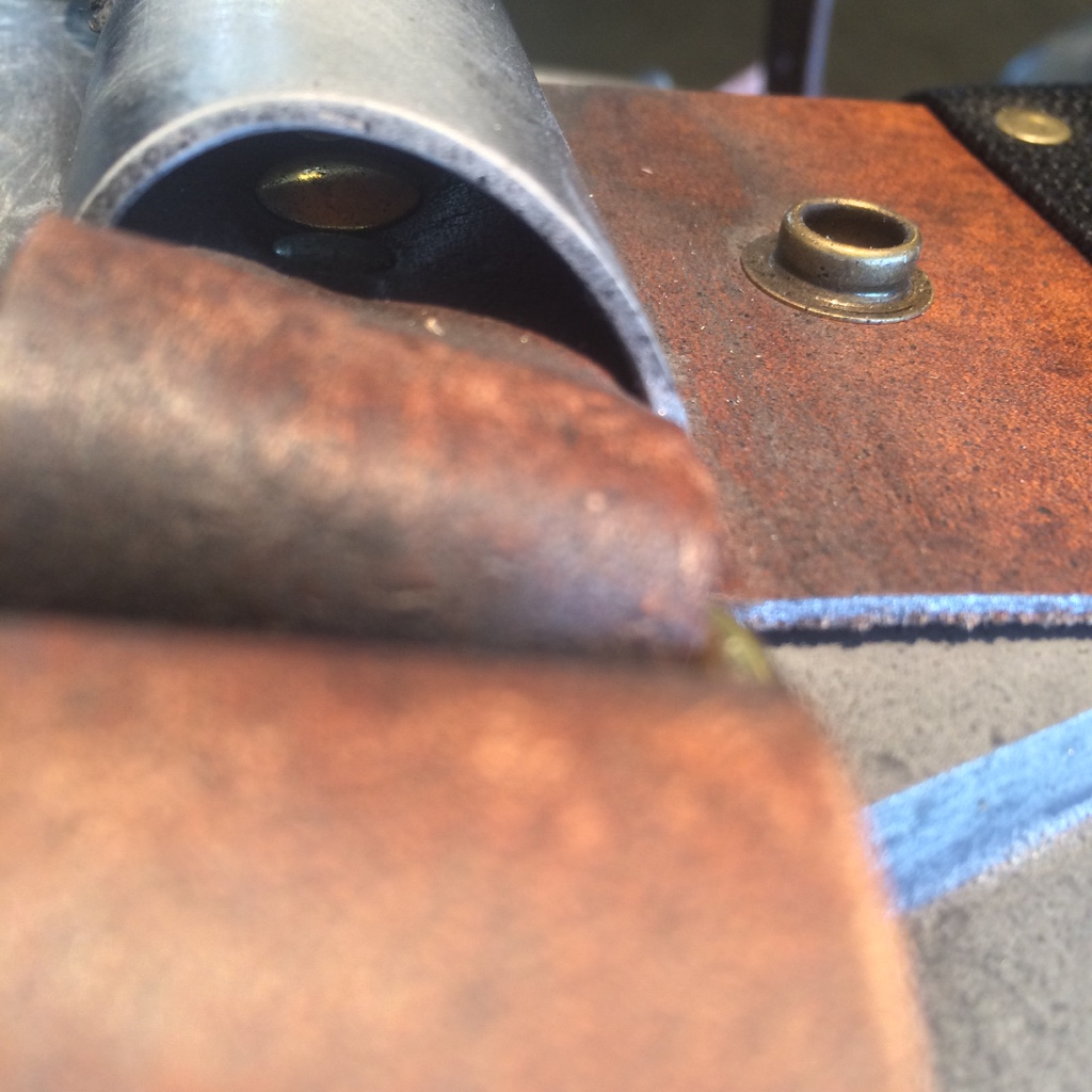

Common practice for the thigh armor is that it is connected via chicago screws to the holsters which are connected to the cod piece and it all buckles around the waist in the back via a large plastic clip.

How did you connect the holster harnes to the cod piece? By a chicago screw?
Yes. A chicago screw through the thigh plate into the inside of the holster. If you were to look down inside my empty holster you would see the chicago screw. So it involves drilling a small hole through your thigh plate and through the back of the holster.
