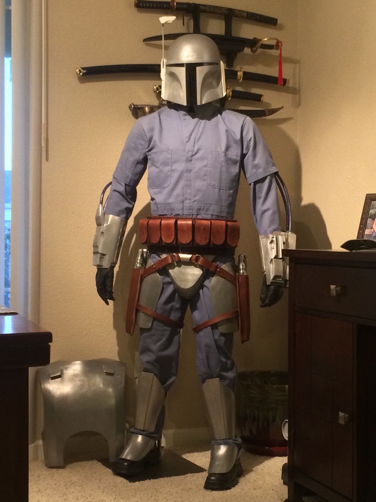

Hey guys. Just wanted to share the complete suit build I have the pleasure of currently working on for a fellow member. Luckily (because I love building these suits), I would have to say this is my 5th or 6th Jango build. So please let me know if there are any questions regarding the methods I have come to prefer on the assembly/attachment of any parts through these experiences. My two main concerns when building a suit are always as lightweight and as comfortable as possible.
I'm also excited to be working closely with someone locally in creating a very accurate and high quality leather vest, and whose attention to detail far surpasses mine. Just yesterday we were discussing recreating the slight folds seen in the leather of the shoulder/sleeve parts that appear to be created by the weight of the armor.
The boots are Prada, the gloves are just some old black U.S. Navy issues, and the flight suit is converted from two pairs of Red Kap coveralls. Everything else was made by me. Well on to a few pics for now...

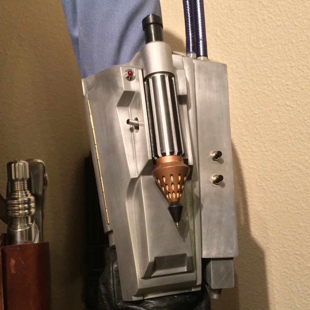

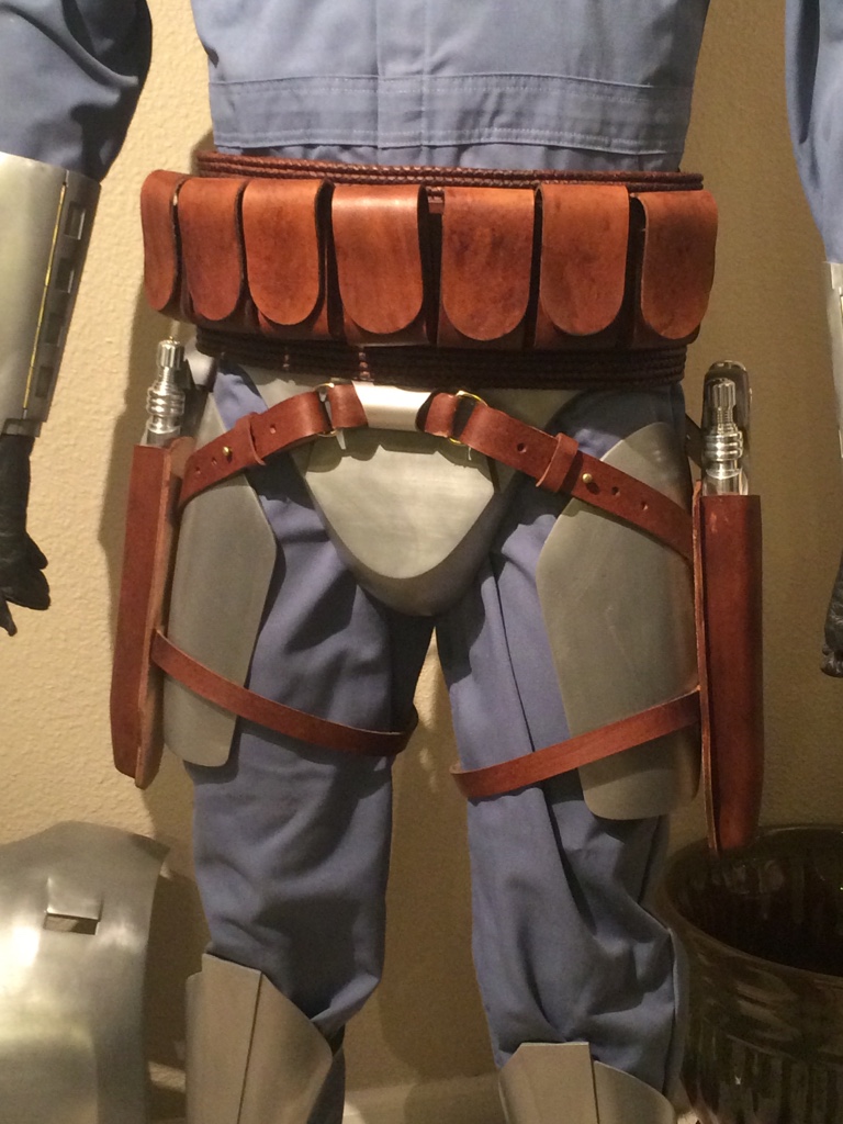

But I do enjoy figuring out the most efficient and effective assembly processes. For example I like attaching the holster assembly to the cod armor with a single medium Chicago screw that is hidden in the middle of the d-ring holder housing and runs through the leather strap that holds the d-rings and through the cod. I've noticed this method allows the cod to comfortably shift slightly back and forth while walking. I'll try to post more pics as the build progresses.

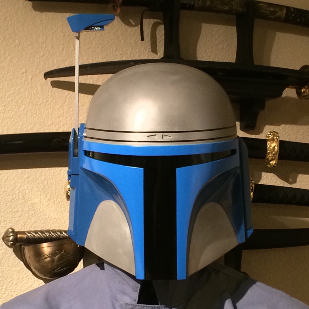

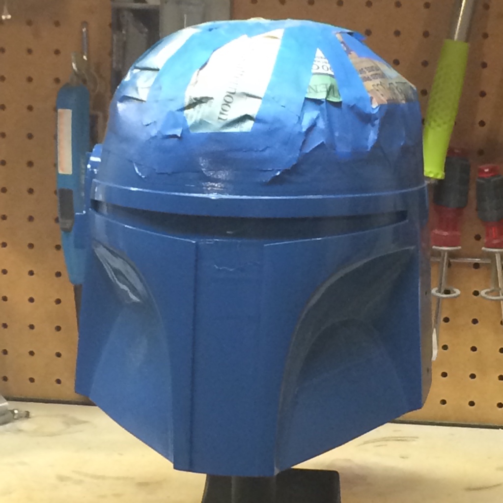

The helmet is one of my cc fiberglass casts of a BKBT Jango.

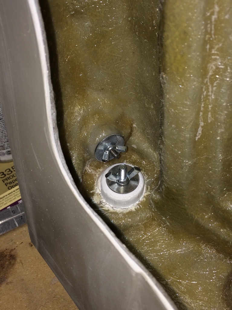

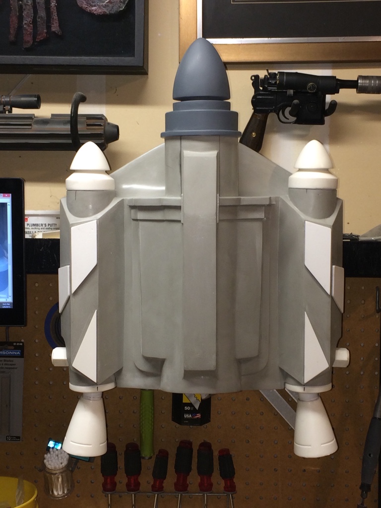

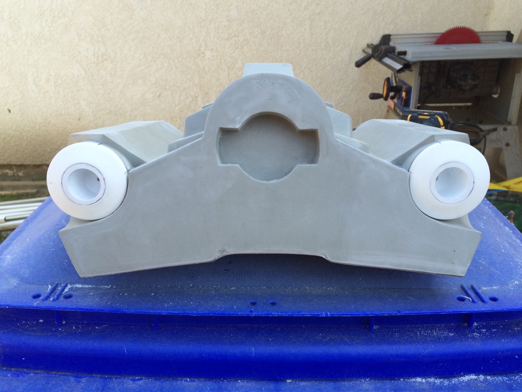

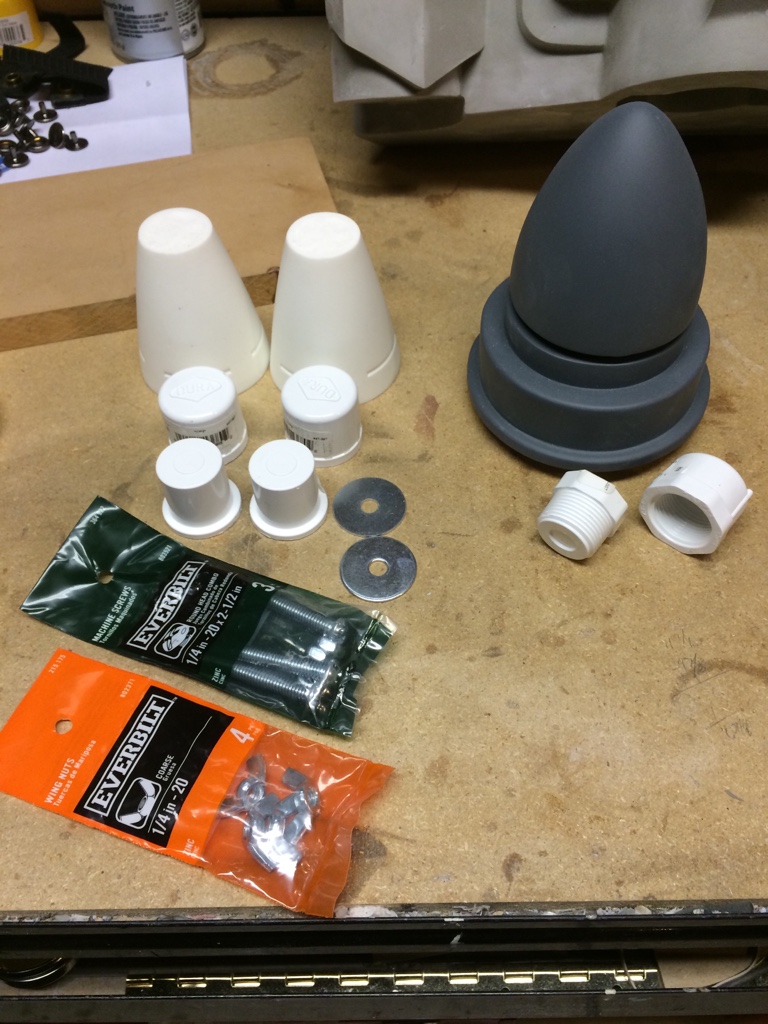

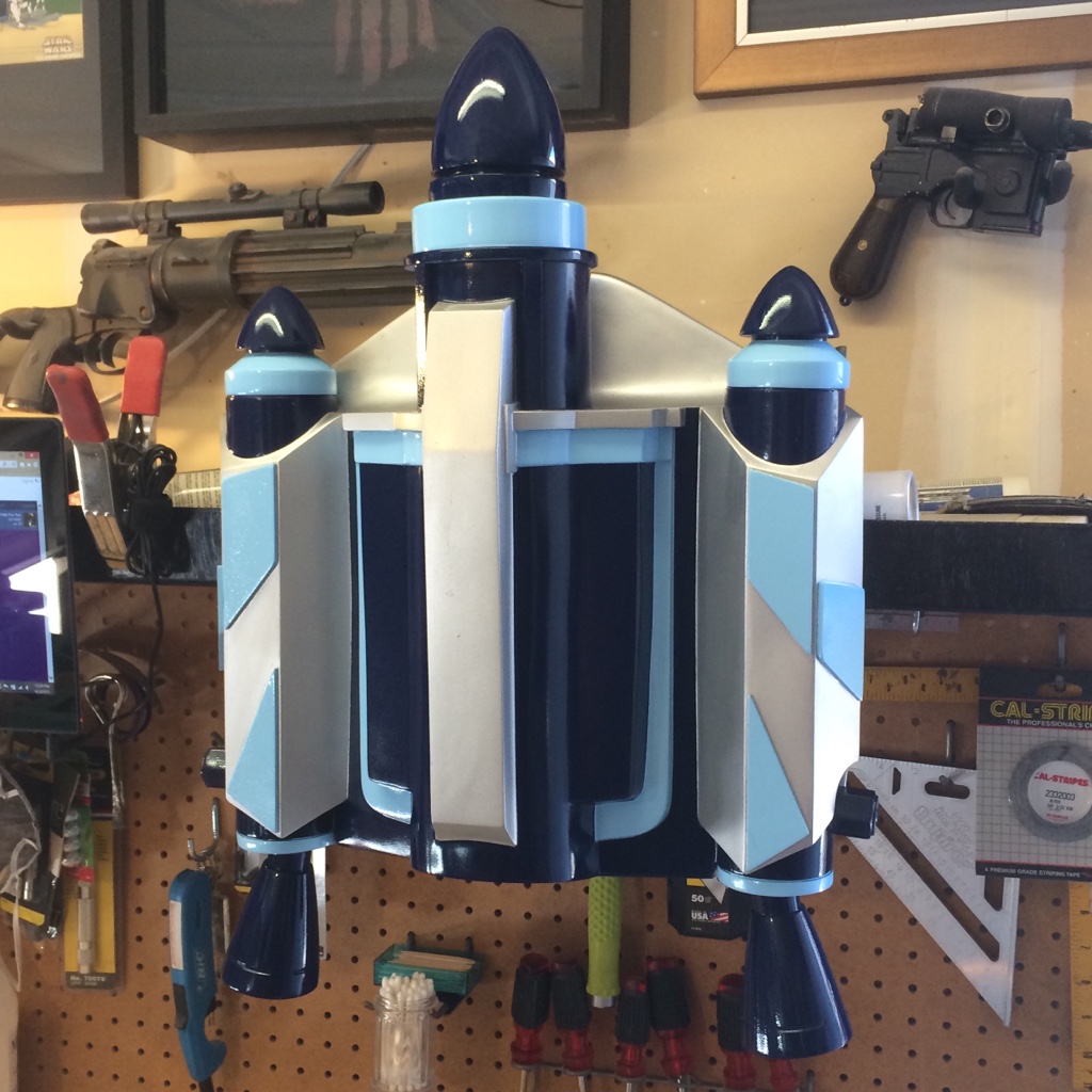

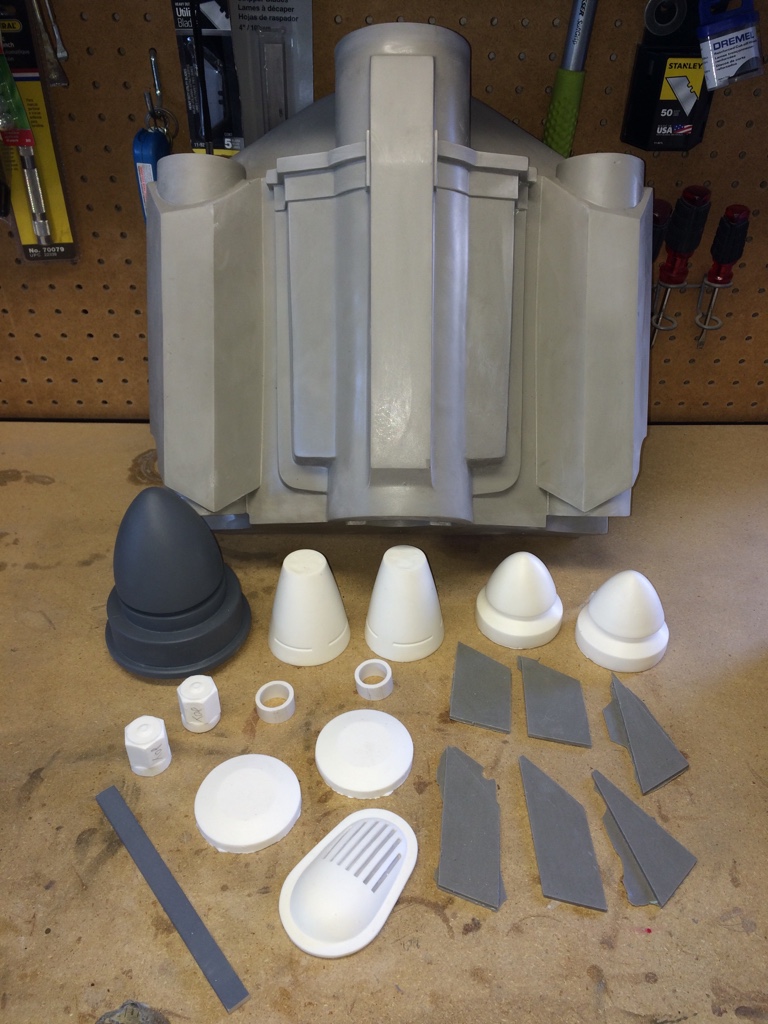

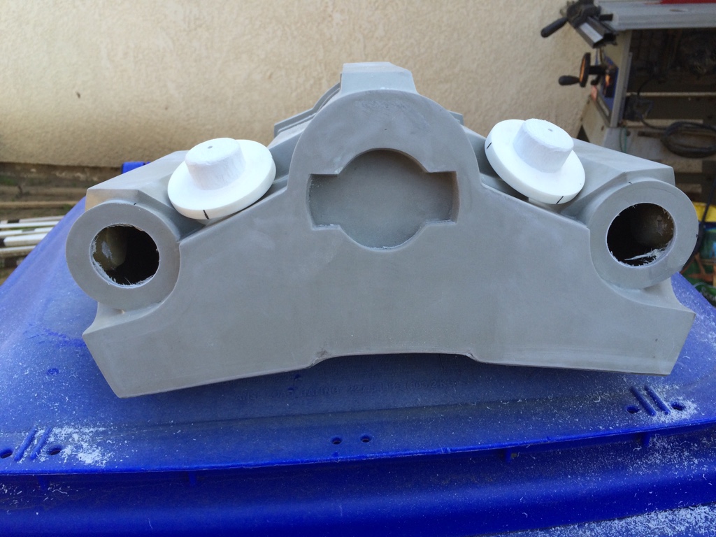

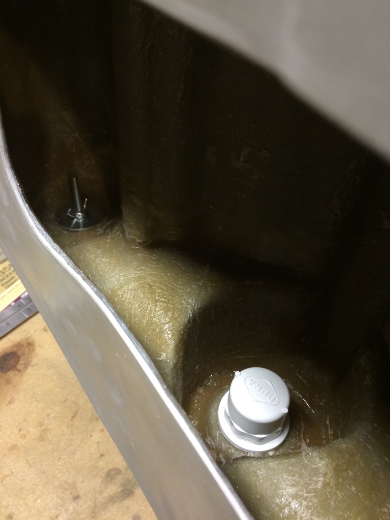

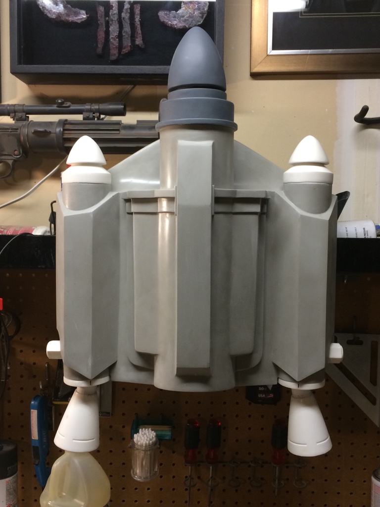

The jetpack I'm using is a FettSeven design. It's a quality jetpack for the price that allows the buyer to determine how they would like to attach all of the parts. The suggested thruster assembly seemed more fragile than I was comfortable with, so I came up with this solution. I cut the slip caps at a 10 degree angle using a table saw and securing them to the wood block seen in the pic with a screw to keep my fingers safe. The only step I forgot to document with a pic was the fact I used a 1-1/16" forstner bit to create a recessed hole at the top of the thrusters to glue the pvc plugs into place after grinding down their flared bases. The only glue used was Satellite City's yellow label CA glue.
I also filled the small nose cones with some lightweight resin in order to give the hanger bolts something to grab on to and help give them a solid feel. This added a few ounces to the total weight of the pack, but I didn't mind because whoever made this jetpack did a great job of keeping it light but sturdy.
Update:
I had to switch the machine screws on the thrusters to 3", and the hanger bolts in the side knobs to 2"

Don't let him kid you folks! His attention to detail is top notch.
Very nice work on this! I can vouch your method of attaching all the cod, ammo, holsters, and thighs. It makes it so easy to put on and troop.

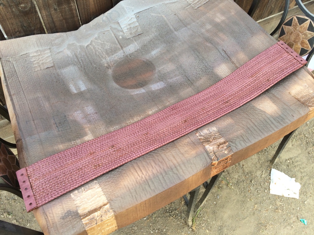

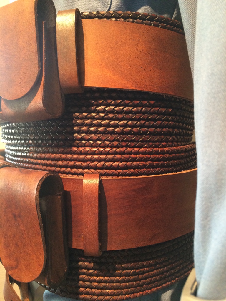

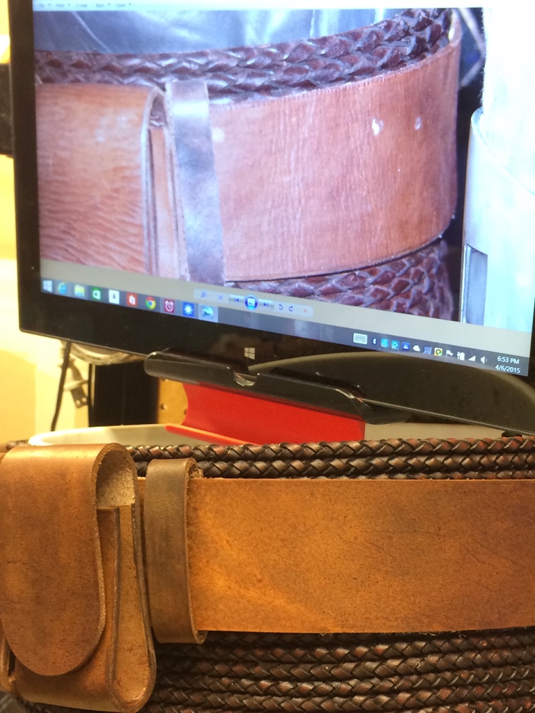

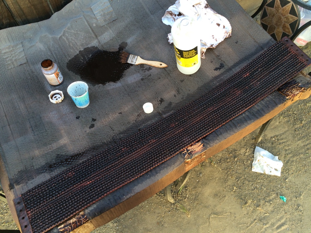

Tried something I've always wanted to attempt, but had to wait until I was working on my own girth belt in case it was a fail. Sprayed an initial base of EcoFlo Dk Mahogany to try and capture some of the burgundy hue seen in the C2 reference pics. Followed it up with a generous sprayed coat of 1/1 parts of Bison Brown & Range Tan. Then brushed a generous layer of 1/1 parts Java Brown & Fudge Brown All-in-one to get deep in the nooks and crannies. Then took a cloth with some solvent and wiped the surface to take off some of the "dark" tone; followed by brushing it with a soft wire brush to further bring out the color, highlight the high spots from the lows, clean out the grime between the braids, and scratch it up a little. I think I'm happy with the results.
