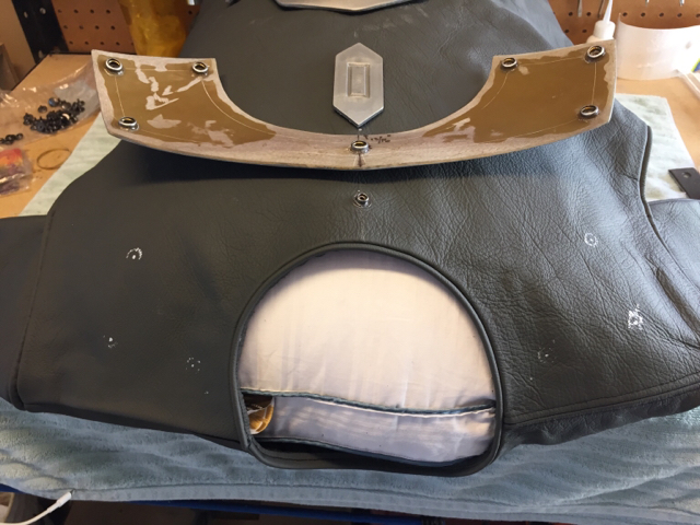

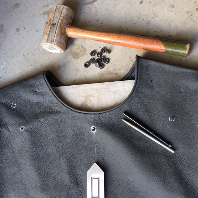

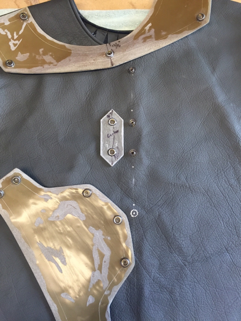

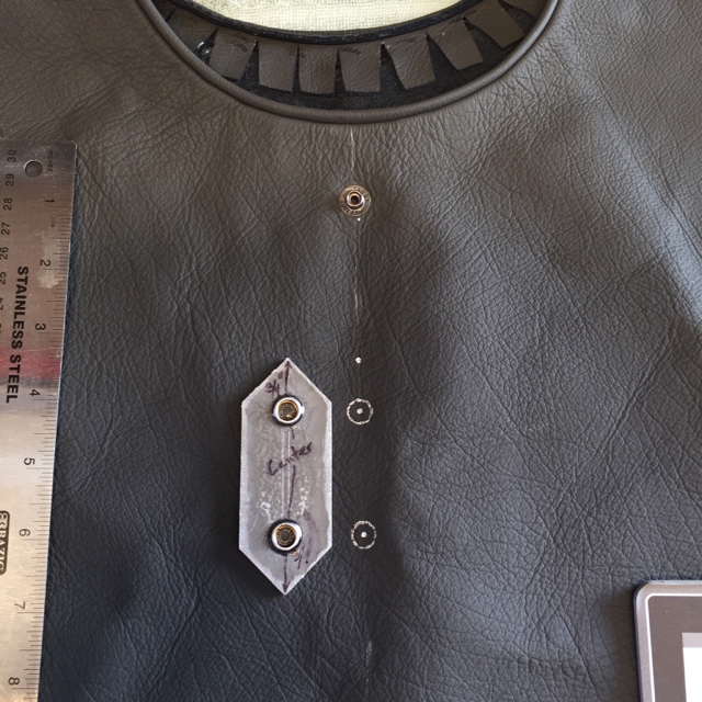

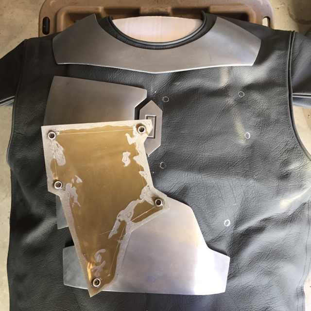

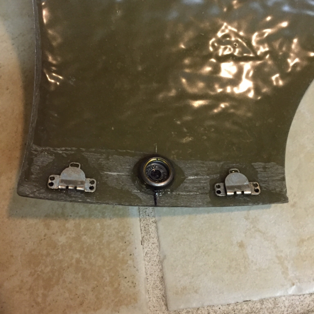

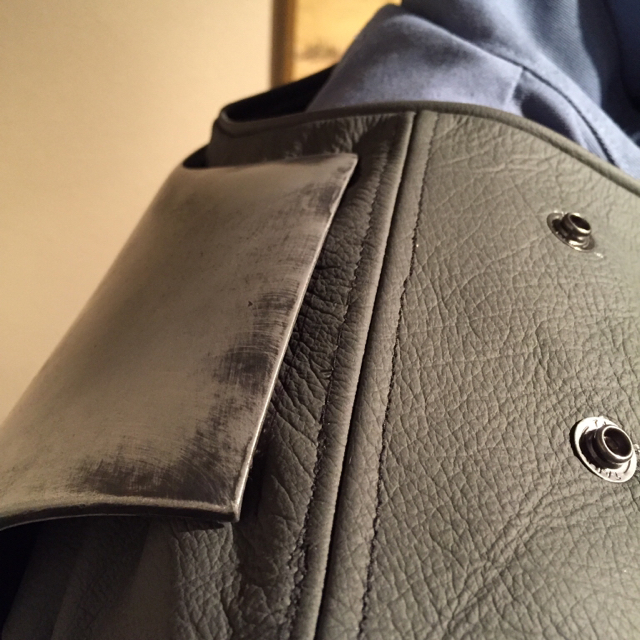

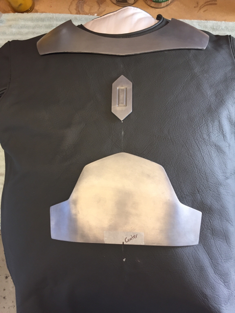

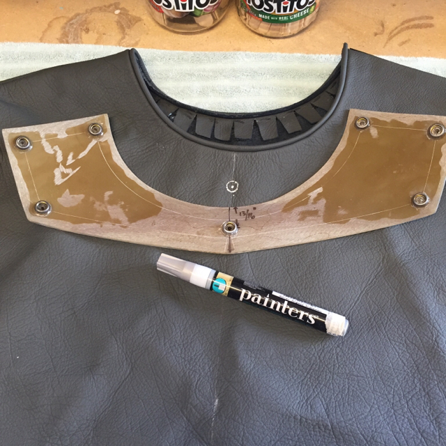

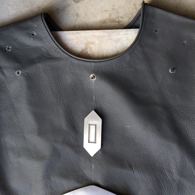

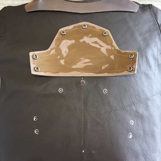

Thanks guys. I'll document the backplate install to the same vest used prior to this post and add progress pics as I go. Here are the first few with the same attachment methods used on the front upper body armor.
ImageUploadedByTapatalk1447737932.760762.jpg ImageUploadedByTapatalk1447737943.848548.jpg ImageUploadedByTapatalk1447737952.601926.jpg ImageUploadedByTapatalk1447945508.538519.jpg ImageUploadedByTapatalk1447945520.064675.jpg ImageUploadedByTapatalk1447945532.612666.jpg ImageUploadedByTapatalk1447945545.235354.jpg ImageUploadedByTapatalk1447945567.729879.jpg ImageUploadedByTapatalk1447945588.776132.jpg ImageUploadedByTapatalk1447945635.214033.jpg ImageUploadedByTapatalk1447945645.269695.jpg

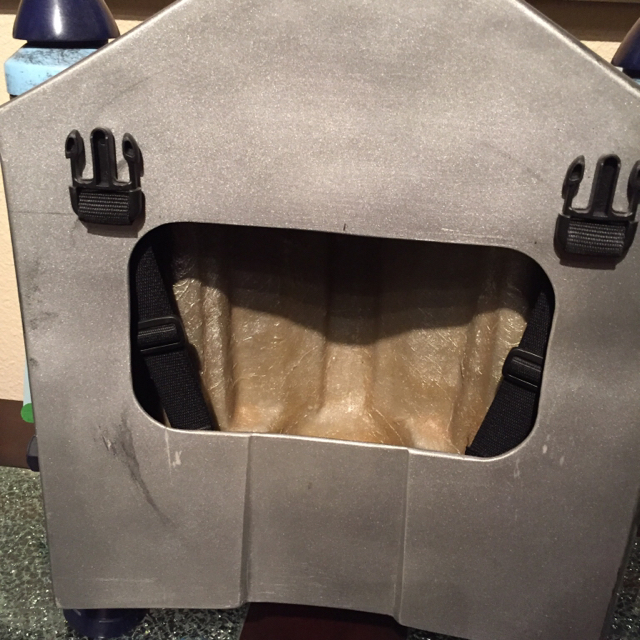

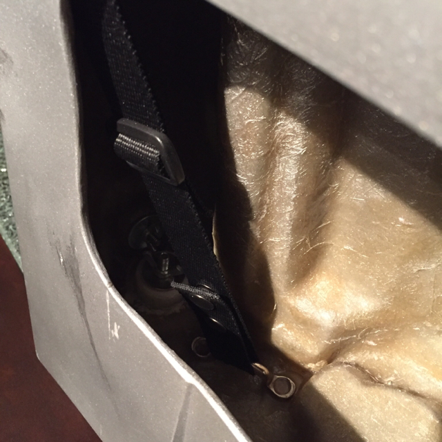

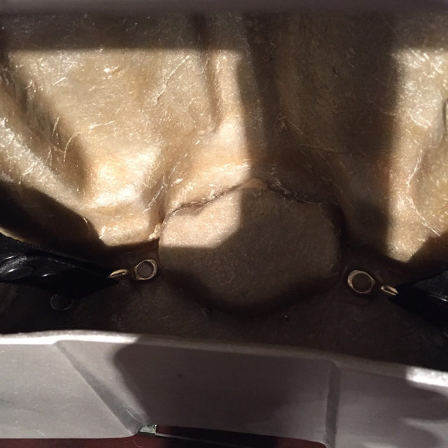

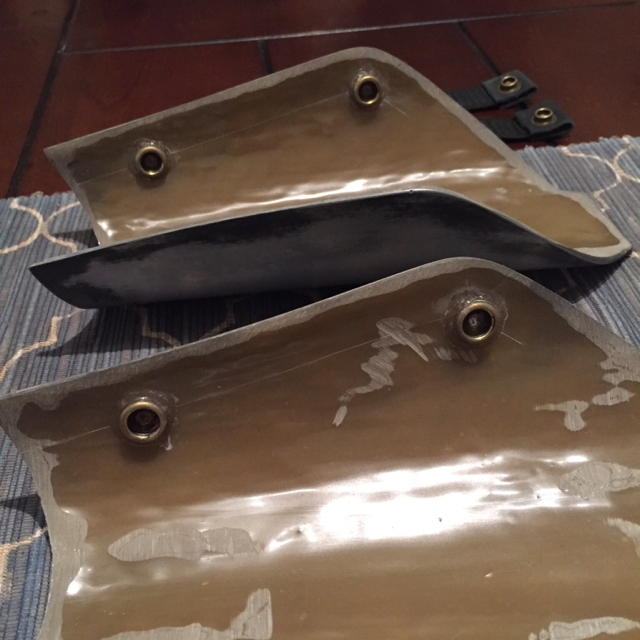

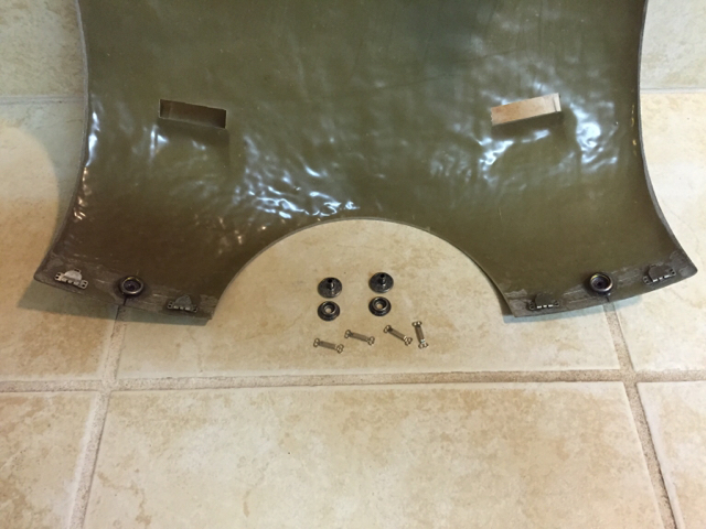

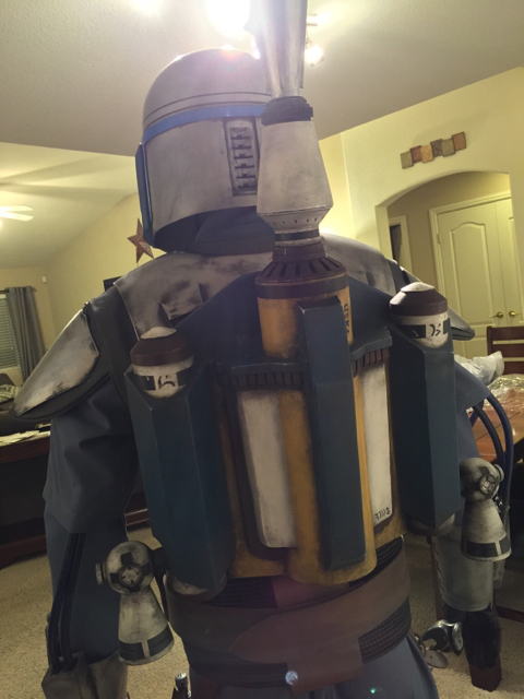

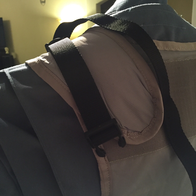

Here are two internal jetpack strapping systems that I've used. One is removable and the other non removable. Both use 1" webbed straps and hardware. The non removable system is easily glued together with Satellite City CA glue. The 1" footman loops (aka battery tie downs)can be found on eBay. The straps are coming out of a 1"x 1/8" slit cut in the jetpack bodies.
ImageUploadedByTapatalk1447997834.224778.jpg ImageUploadedByTapatalk1447997852.568843.jpg ImageUploadedByTapatalk1447997865.258399.jpg
ImageUploadedByTapatalk1447997877.647800.jpg ImageUploadedByTapatalk1447997886.369283.jpg

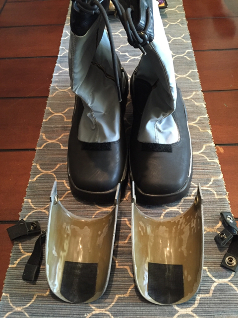

Interesting. Do you have a reference for using two straps on the shins? From the pictures in the gallery I could always only make out one strap.
All of these assembly methods I've shared are just what I've found to be most efficient/effective after assembling numerous suits for trooping. An example would be attaching the holster assembly to a webbed belt versus directly to the girth belt like the screen used suit. I've found that using the webbed belt helps keep the vest pulling out from under the girth belt with upper body movement, as well as helps distribute the weight of the blasters and thighs from pulling your girth belt down to low. I'm certain there are many other assembly methods used by members here, with Seeker's methods probably being the most screen accurate. [emoji106]

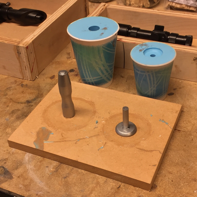

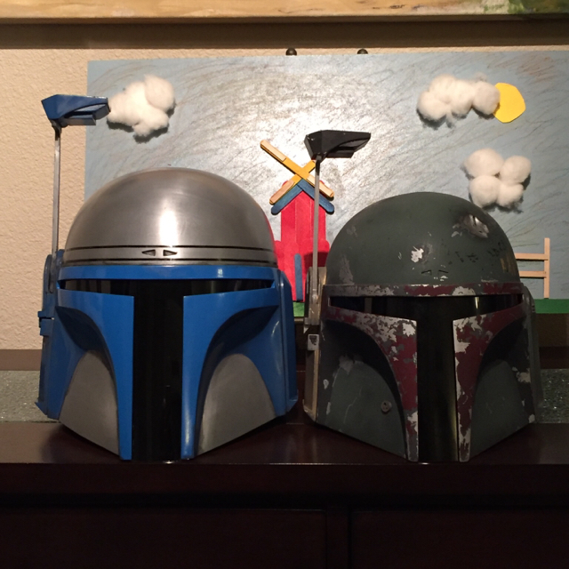

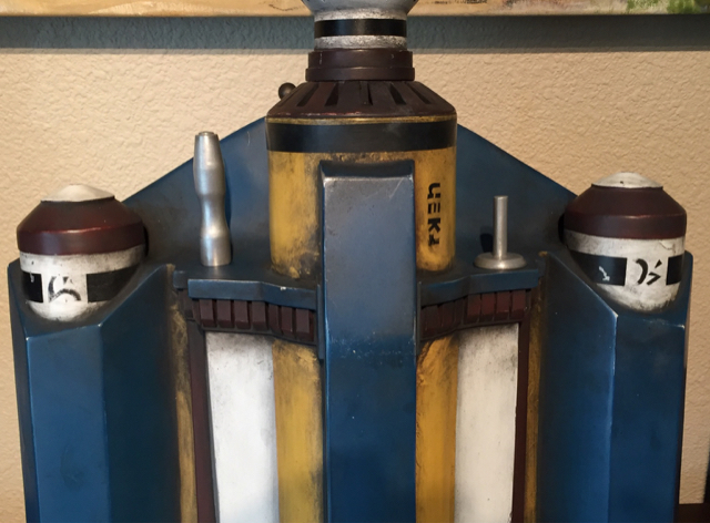

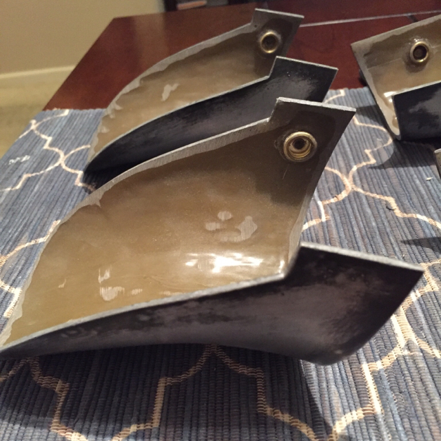

Thanks guys, I appreciate the kindness. So one last item and then this suit is off to its current owner. I couldn't find sources for screen accurate Jango jetpack beacons and stabilizers, so ended up making my own and molding them. I used a 3/4" wooden dowel for the beacon, carefully drilled a hole down the center to spin it on my drill press, and used a button from Walmart for the top nipple. I made the stabilizer with a nylon bolt (threads cut off later) and two nylon washers for the base, and shaped on the drill press with sandpaper and files as well. I'm happy with how the beacon turned out, but I think the stabilizer might be a tad oversized...may be just a result of typical male overcompensation. [emoji14]
They're both cast in cc.
ImageUploadedByTapatalk1448470856.291849.jpg ImageUploadedByTapatalk1448470870.546589.jpg ImageUploadedByTapatalk1448470880.718066.jpg
