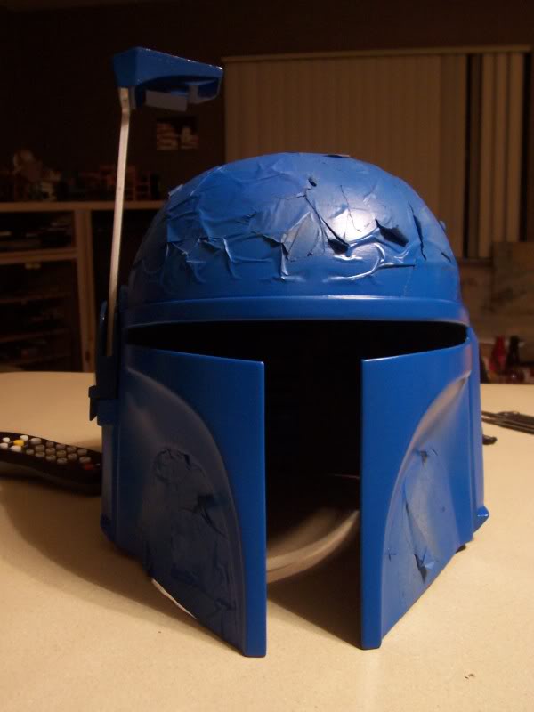

Keep wet sanding. It'll look spotty until you get an even surface. So just try to keep wet sanding. You can also add another light coat on top of what you sanded. Pretend like the krylon is a primer and you're trying to get a perfectly smooth, even surface for rub n buff.
Still sounds like you're spaying on the Ocean Blue too thick and air bubbles are remaining below the surface as well on top off. I still recommend sealing all the painted areas with the Rustoleum and then spaying a light coat of the Ocean Blue. :thumbsup:
Sanding the helmet all day today, still a ways to go, but I'm gonna get everything all smooth. I'm going to switch primers as well. I've started using the automotive gray primer for awhile, but I'm going to go back to the rustolium white primer that I've used on all my past commissions. Can't say it will make a difference, but nothing to lose. I'm gonna be getting the rangefinder assembled w/ bolt method as per my last screen-cast build. Shouldn't take too long to do in a day, then paint it up.

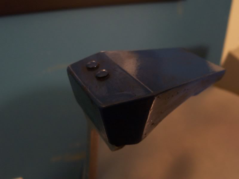

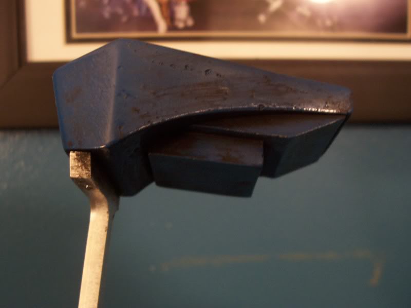

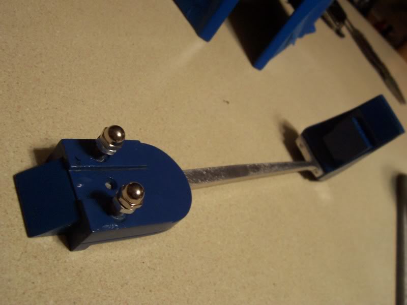

First up is the RF ear cap assembly. The stalk hasn't been permenantly attached yet, but this is pretty much how it will look. The odd thing is that the ear cap dosn't sit perfectly flush against the helmet, but adjusting the bolt's tightness will actually help bring it closer

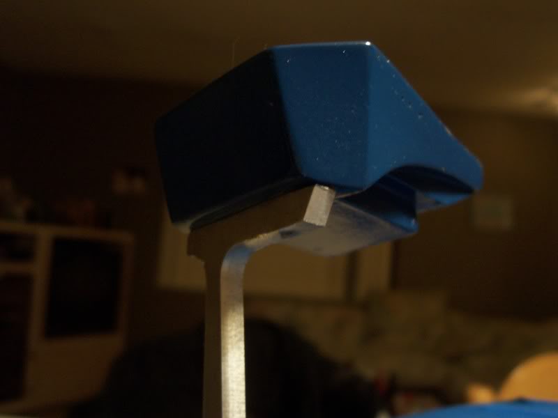

A close up of the RF box. I grinded down the screw heads to make it appear like the screen used helm. (Plus, its neater looking!) hmmm..May need to take a sanding drum over it to clean it up a bit more

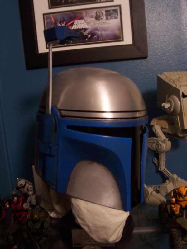

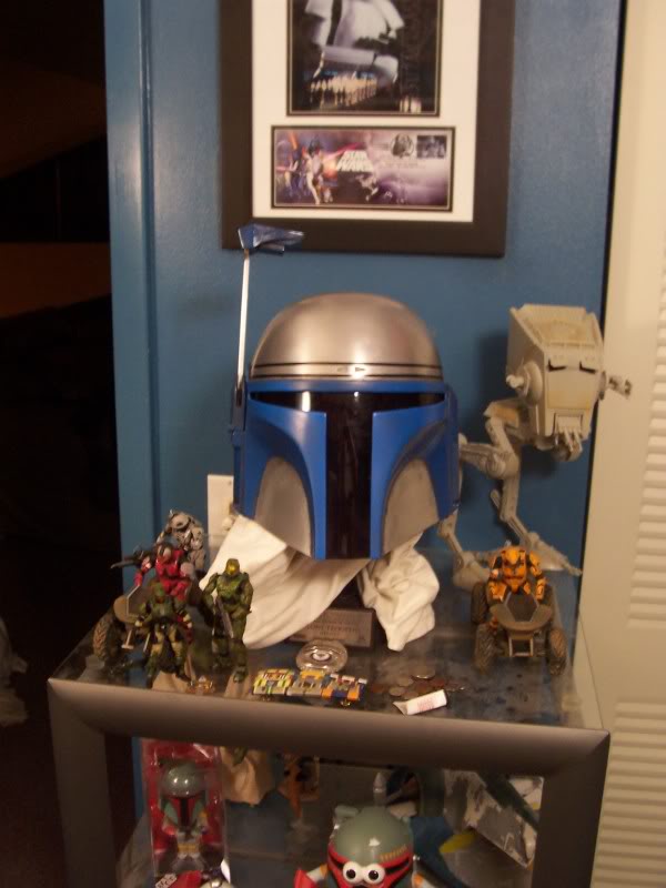

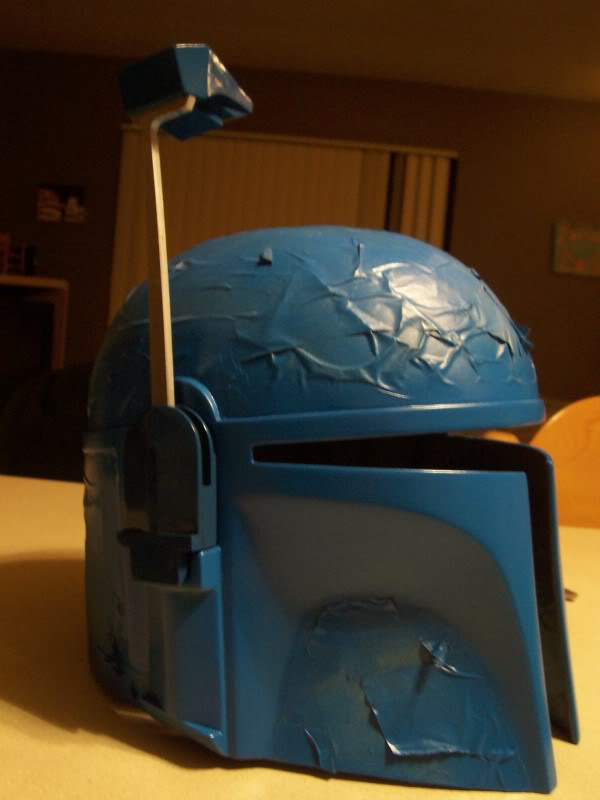

And here are some pics of the helmet w/ ear and rangfinder
Tomorrow, I'll paint the cheeks and ears, JB weld the stalk, add some pin-striping and by Sunday, install the Visor and weather the sucker

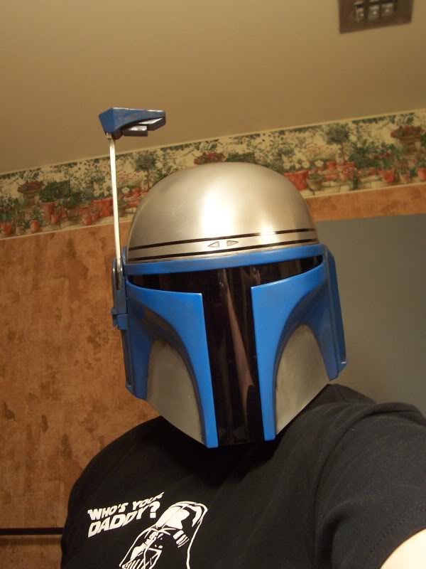

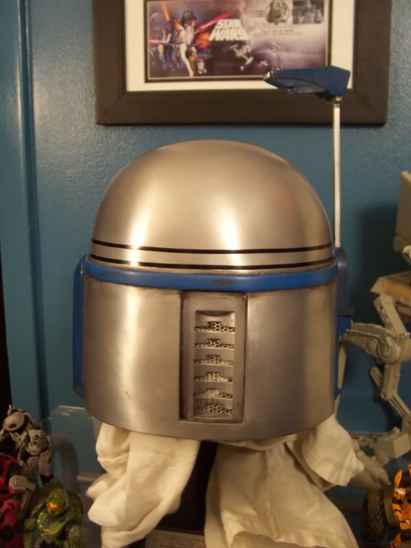

I suppose miracles can happen. This helmet is FINISHED!!! I'm going to bed now, got ALOT to do in the morning, like ship this thing out!
You can't see my weary eye'd expression under it, but this is my obligatory "me wearing the thing" pic
The one thing I will say is that the inside looks NO where as pretty as the outside!
