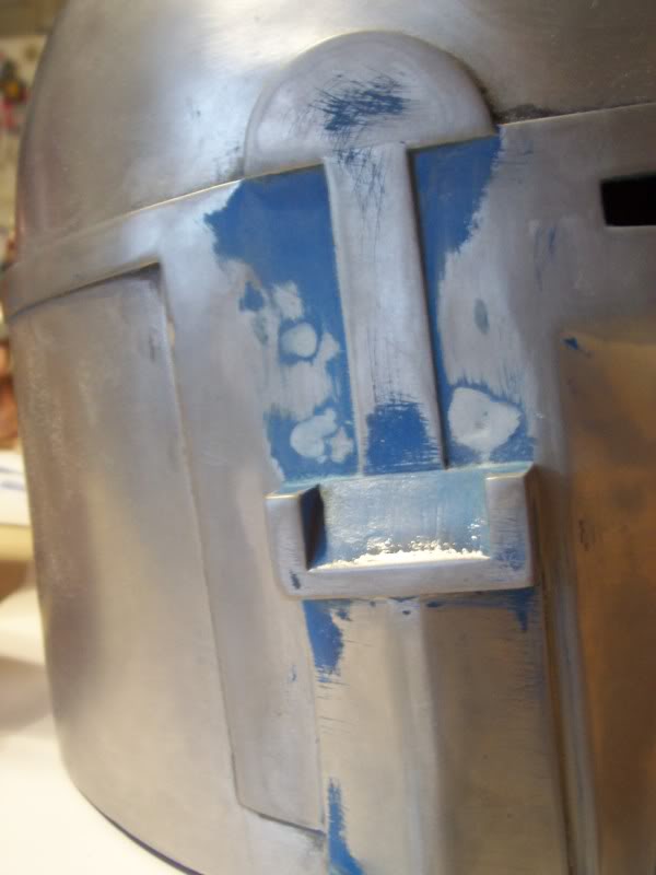

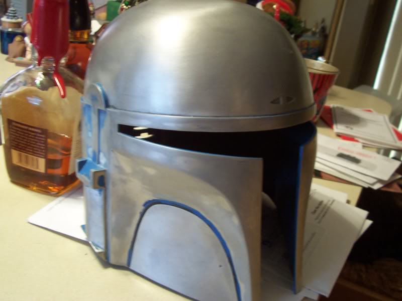

I have just under 5 weeks left before I leave for Basic. I'm not proud of myself for having held onto this helmet for this long and as I've said before, theres no excuse. I've been working on this for the past week, stripping down the paint. I recieved a BobaMaker Jango visor as well this week. I've completly wet-sanded the entire helmet, and should have gotten rid of the un-eveness of when I used the mouse sander sometime ago. I feel that was the cause of the splotches of paint as posted above.

Finally was able to finish stripping about 98% of the previous paint off, completly wet-sanded this time. Filled some holes where the previous builder had put some wood screws to hold the ear cap in place. Got that sanded down. I had to remove the original masking tape, repolish the silver. I'm gonna be re-masking it again tonight, and put a few layers of primer down for me to sand. The weather is alot cooler, so if things go as planned, painting shouldn't be an issue.

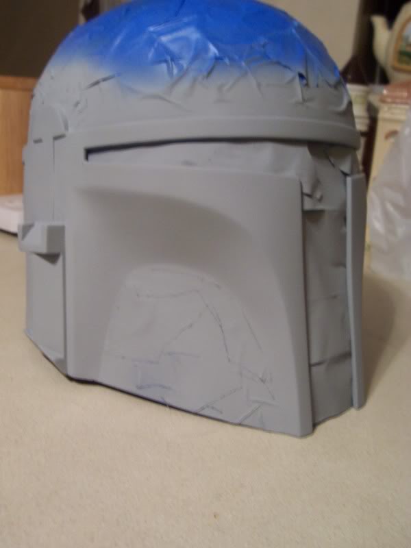

Okay! So I had somehwhat of a busy day today but I was able to mask everything off and get a few layers of primer down. Tomorrow I have nothing to do, so I'm gonna do another sanding to smooth it out again and put some blue down. Hopefully it won't bubble like before :fingerscrossed:

For the most part, I haven't had too many issues with the two paints conflicting. The biggest issues have always come from the krylon application. The Rustolium always came out fine for me. I will say that other projects I've worked on, the rustolium paints do have issues within it's own brand.
Don't strip it off yet. I had similar problems with the Krylon. I ended up just putting on several layers and wetsanding it with like 2000 grit sandpaper. It ended up coming out great with a natural semi-gloss finish.
The final coat on mine is a wetsanded coat. You may have to apply several layers but the finished coat can be wetsanded with 2000 grit.
I've had bubbling occur in the Krylon when I applied it too thick and it's was placed in front of a source of heat. Might that be your case? I would recommend sealing all of the painted areas with the Rustoleum and then going back and taping off the Krylon areas and painting over the Rustoleum. That's how I've done all of my helmets and it has worked out fine for me when I've applied the Krylon lightly. When I went to heavy with the Krylon...it bubbled.

I've actually considered that before. The reason I haven't tried it is that I think it'd make masking off for the krylon a little more challenging. If the method that foxbatkller dosn't work out for me, then I'll give this a shot.
As for application of the krylon, I've tried going as light as possible. It has even bubbled when I tried "misting" the helmet. I cannot explain it for the life of me
