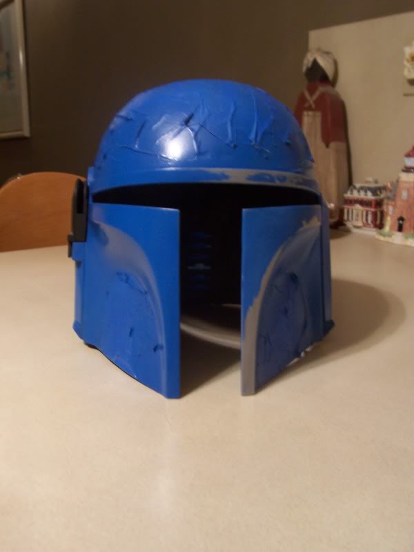

This is frustrating...the krylon keeps producing this crinkled/bubble in the paint and no matter how careful I am, it happens. I am trying to get my BKBT ready for the last SWW but I cant get this paint to work!

Well, it's been awhile, but I'm getting back on this shortly, amongst other things. I think I may have discovered the reason as to why the paint was going on as it did. It is because of how I was sanding it.
I need to buy new sand paper so I can fix it
how does the way you sand it make a difference in how it accepts paint? i've never heard of that.
Well, the surface texture of the material affects how the paint goes on. I discovered it while attempting to paint another piece. I sanded it mostly with a mouse sander, and then took a 300 grit to it, but it still showed marks from the mouse sander. I repeated sanding with regular paper and wet sanding. Because I didn't start with the lowest grit and work back up, it still revelead the mouse sander marks, which caused the paint to have a crinkled or extremly spotty affect.
I am pretty sure something similar is happening here with the helmet, because I used a mouse sander on quite a few areas.

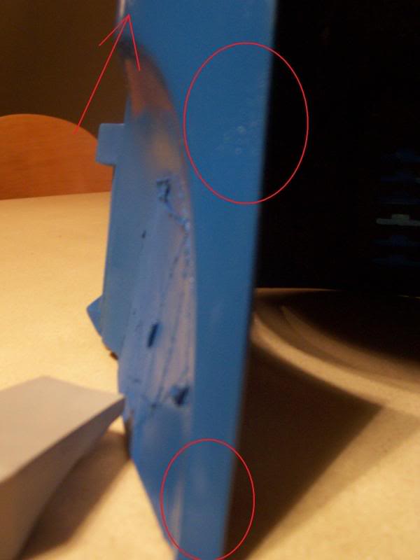

Had a similar reaction again, but this time, it was much more minimal, so I feel I'm just about close to getting past this one thing. It's been really frustrating but oh well. I've begun sanding down again (wetsanding it off, no more mouse sander), going to finish sanding again tomorrow.

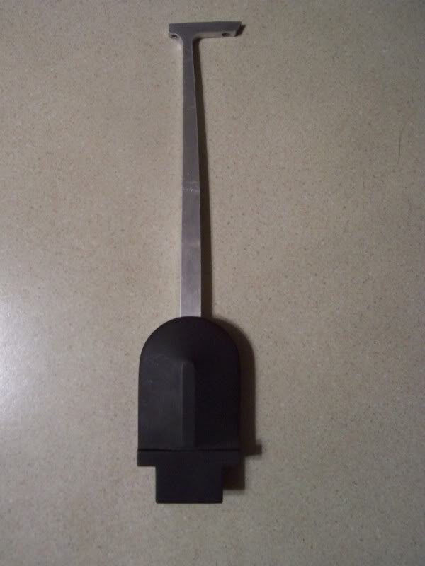

Also in the pics is the New RF ear cap generously supplied by FettPride
Hard to see here, but I've circled where the bubbles re-surfaced. Much more noticable in person
