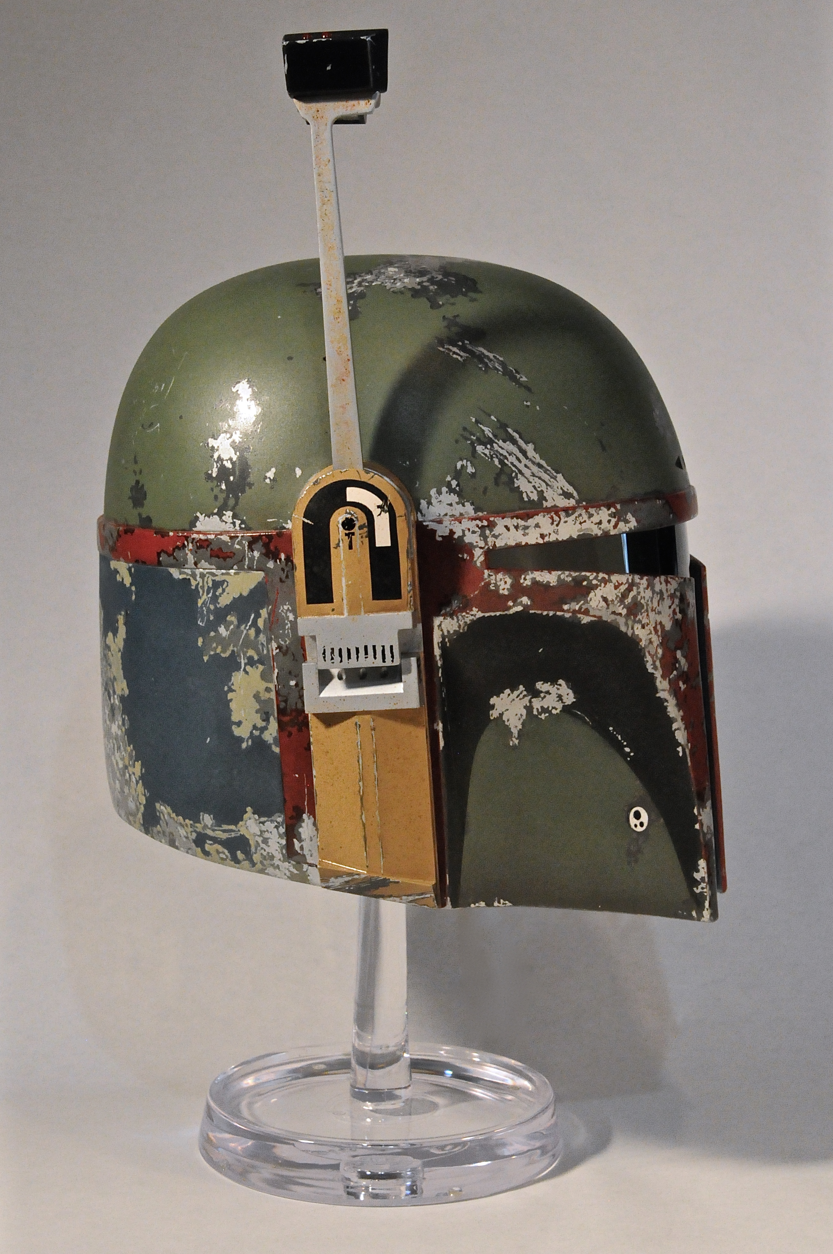

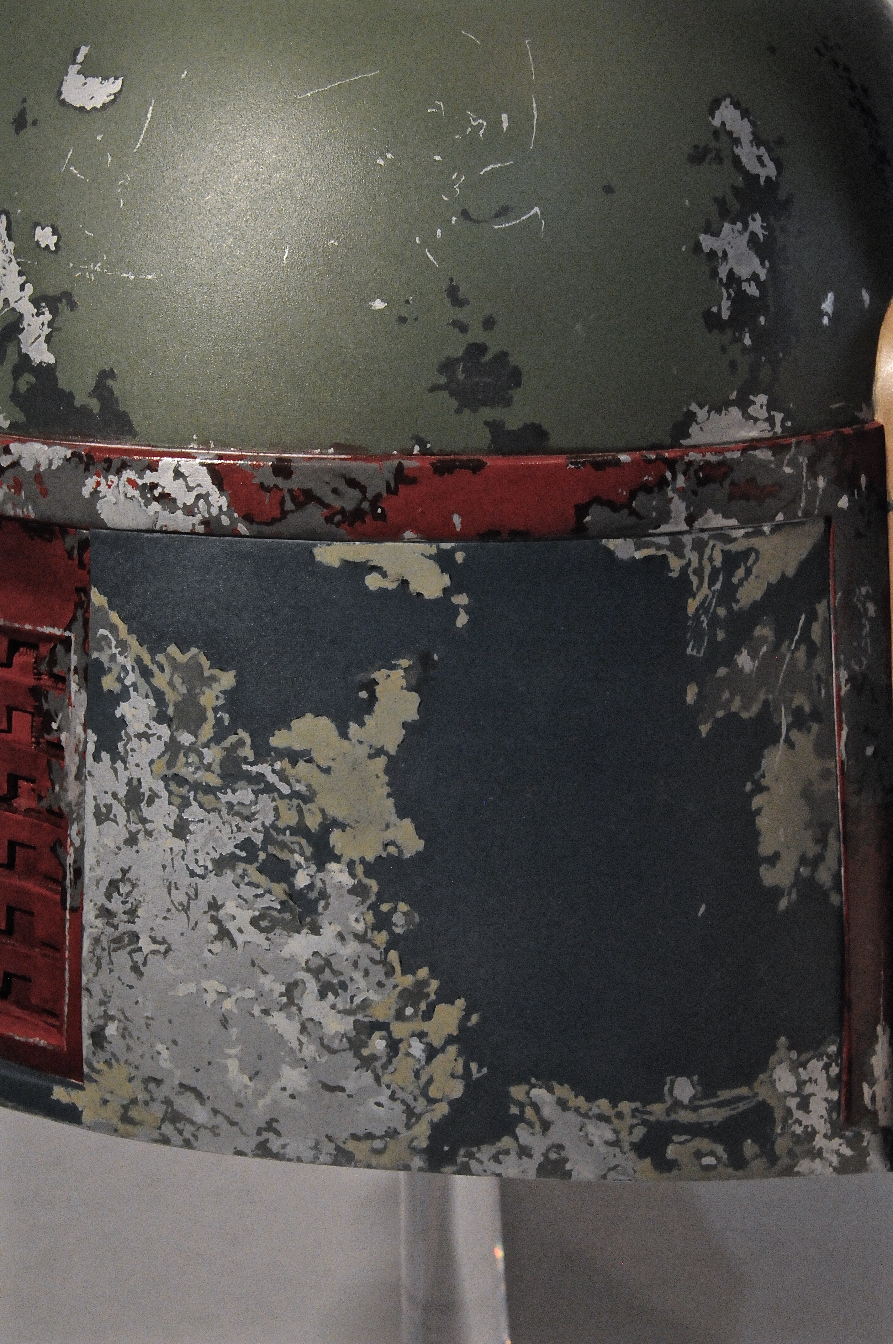

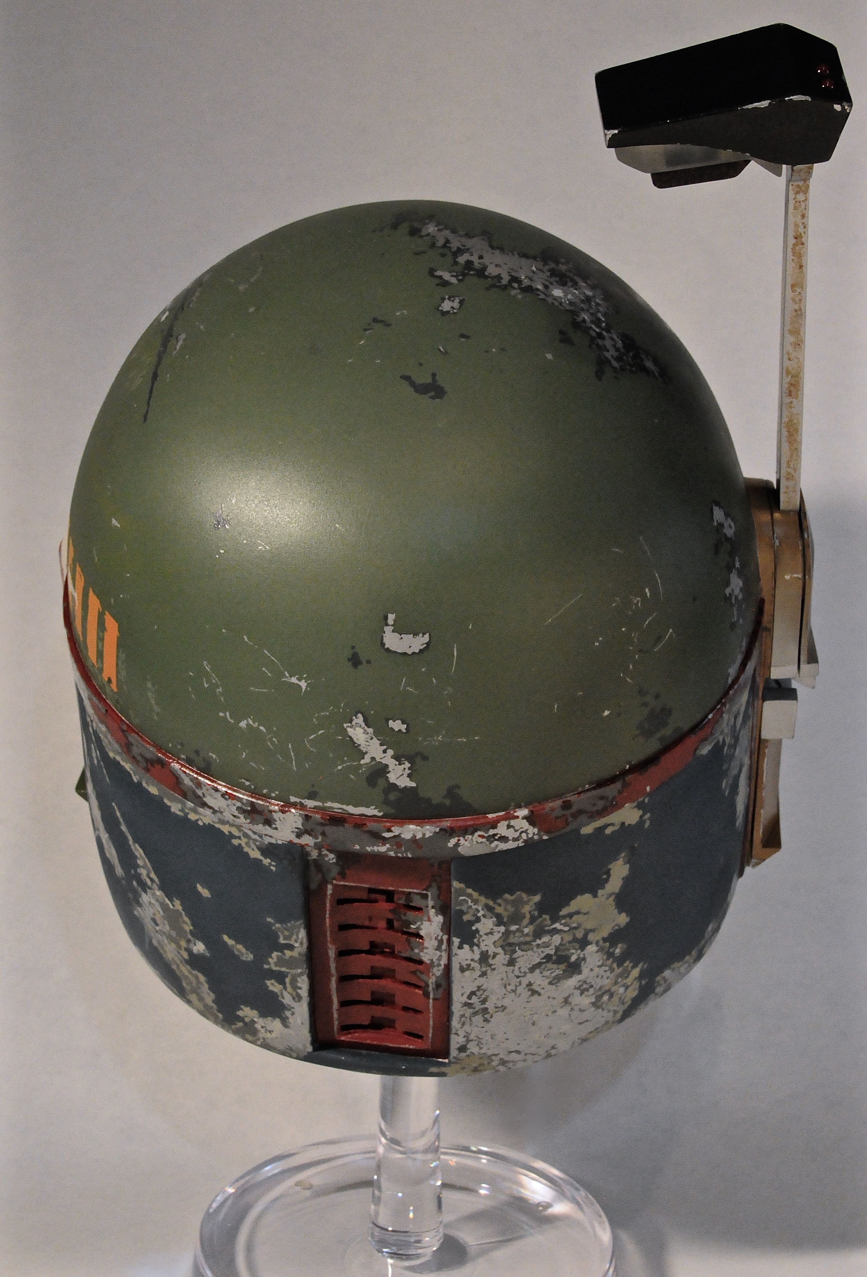

After some minor work on paint I decided to take some new photos so I'll start posting some here.

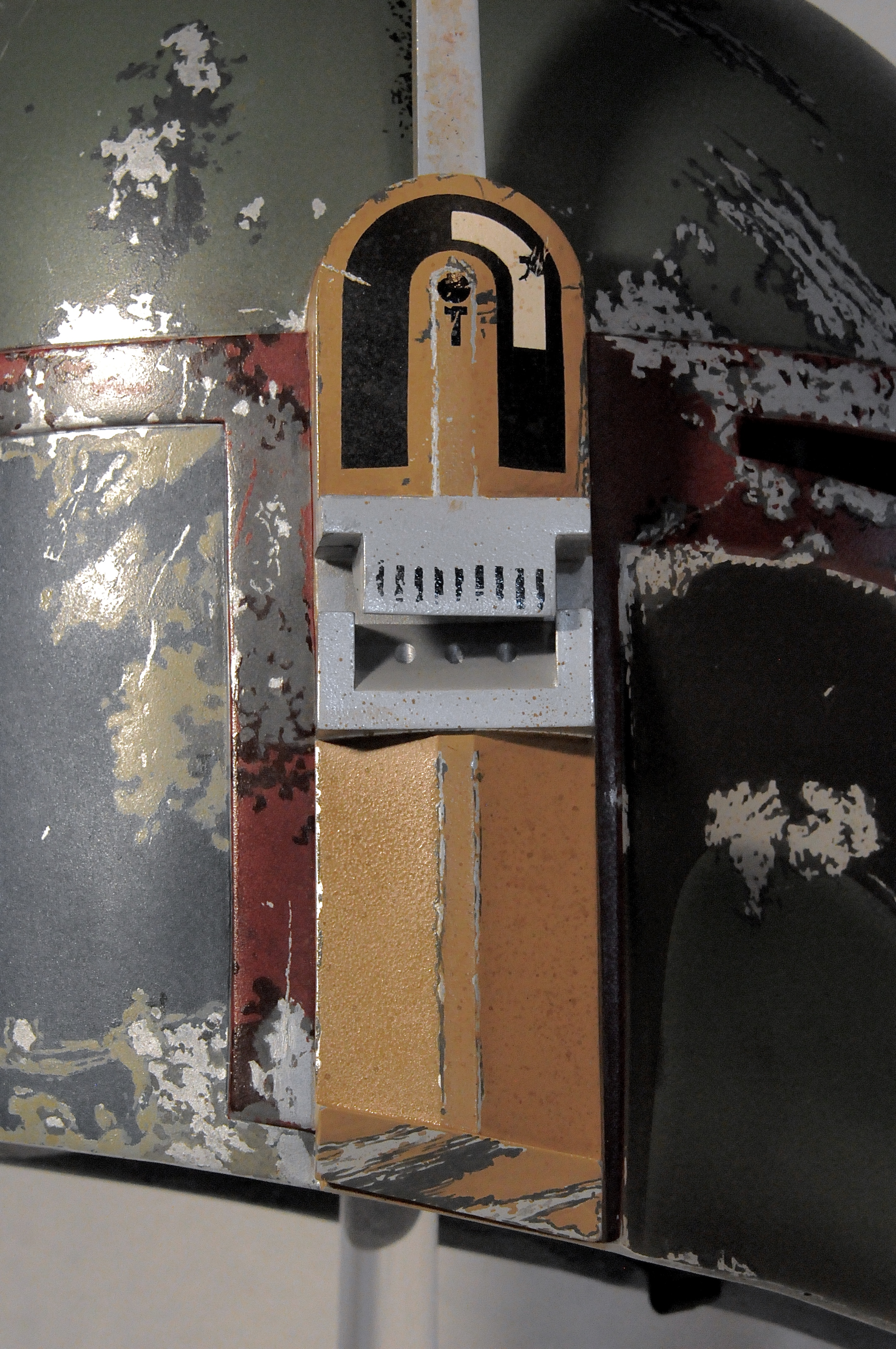

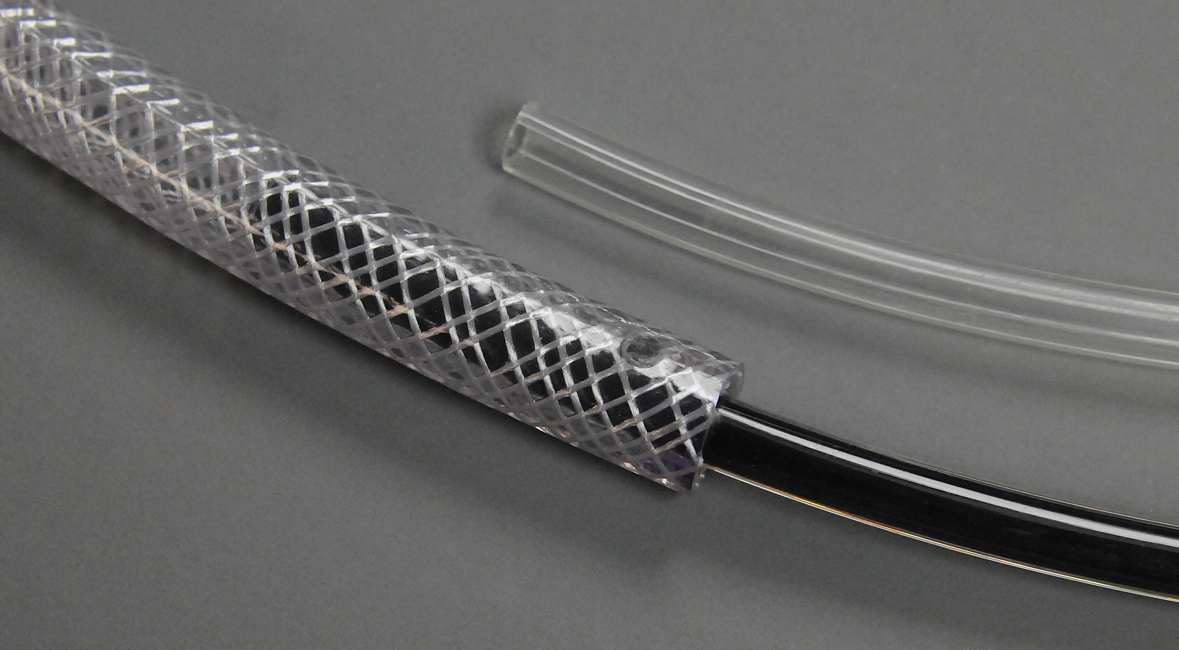

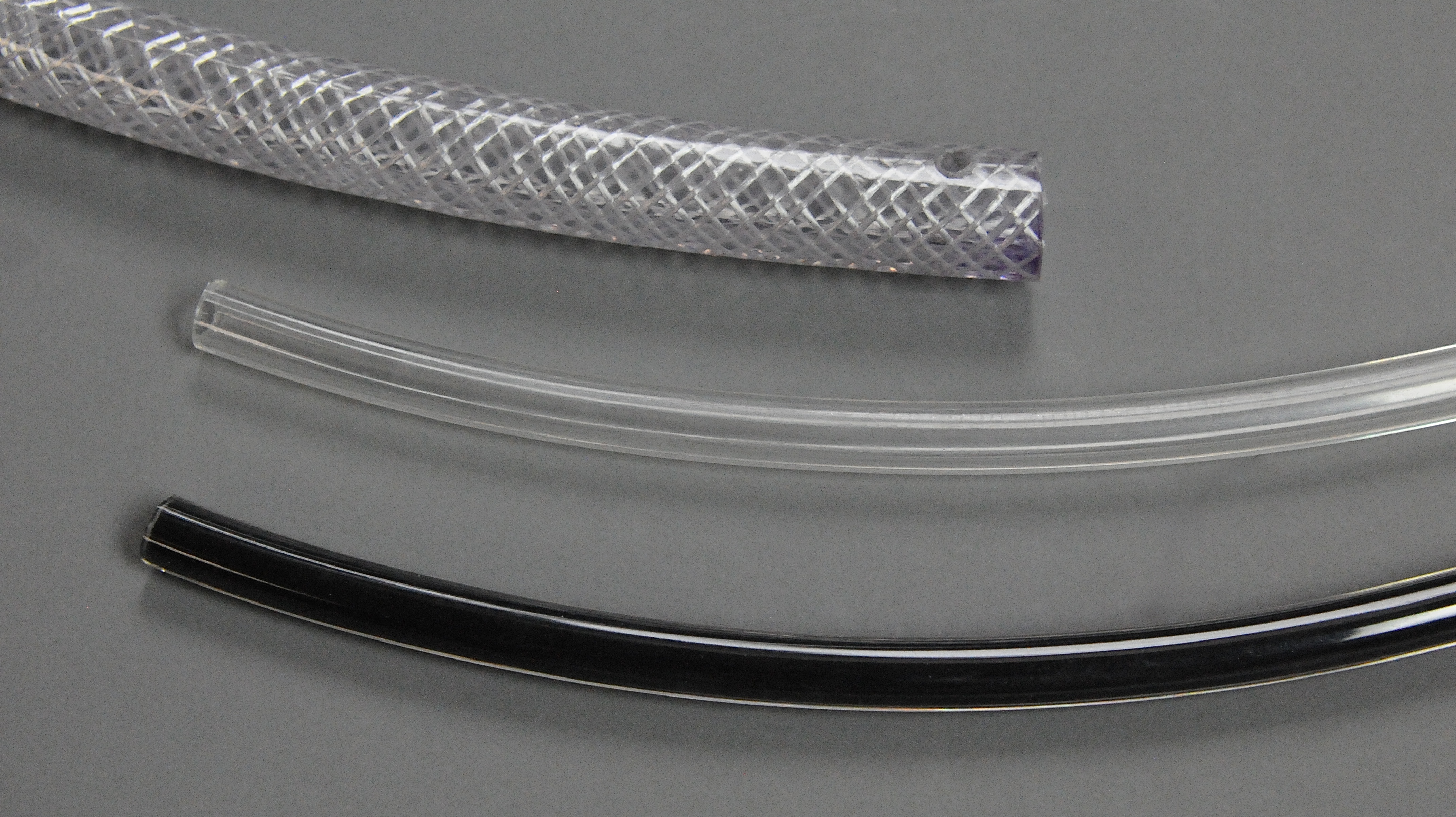

The other day I decided to do the small paint upgrades in the CLR to the right gauntlet.(Red brown dart tips,black rangefinder switch tips, and
red brown light button top.)
As I was working I noticed another way to add the black interior to the clear tube out of the back of the gauntlet. It also would simulate the loose sliding nature of
the clear tube on the black interior wire like in ESB.
As anyone who has followed some of my construction methods knows I tend to build for the "look" rather than absolute movie
accuracy on every construction detail. At any rate you may want to give this some thought.

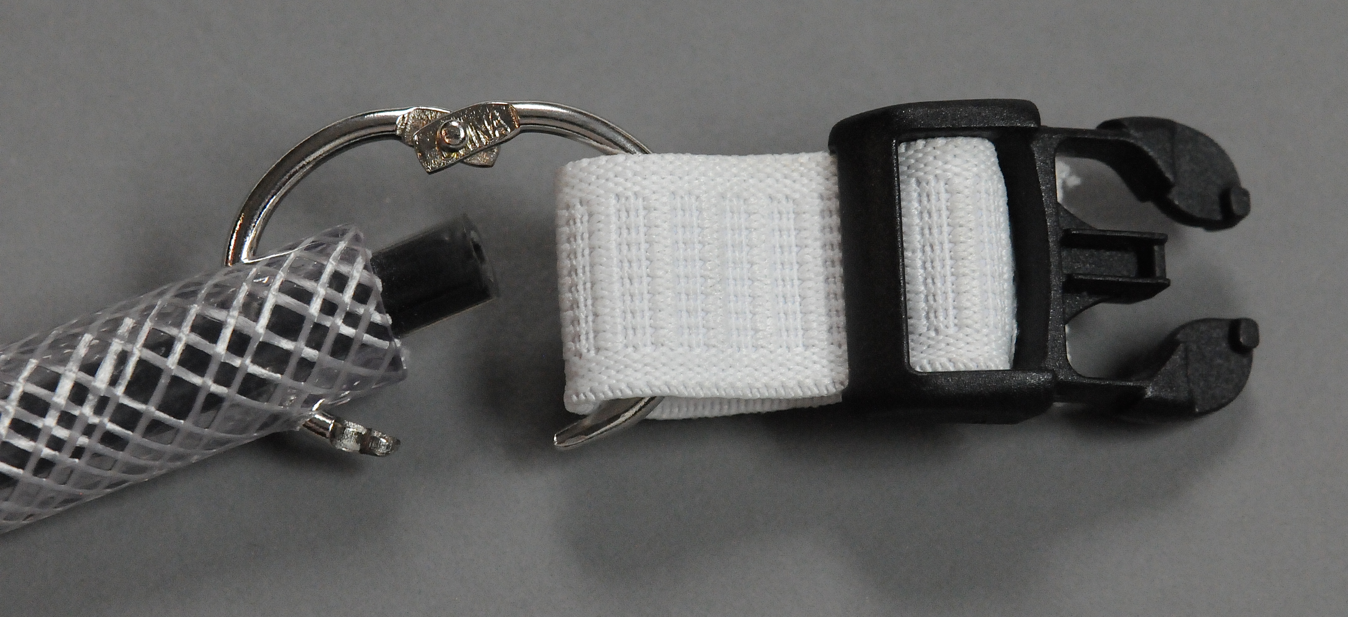

The first photo shows our large outside tube which has a inside (I.D.) diameter of 9mm(3/8") and
two small tubes with outside diameters (O.D.) of 8mm(5/16"). Found at the hardware store.
The small one slides easily into the large one.
I changed the clear to black by poring a slightly thinned black paint inside to coat it.
You could then use the black tube as the mounting point into the gauntlet any way you might want to.
These plastic tubes are quite strong. The movie look was similar to this.
I simply added the black tube to my current attachment method which is shown eariler on this sight. No sliding tube at this time.
Here's the way ours fits together now.

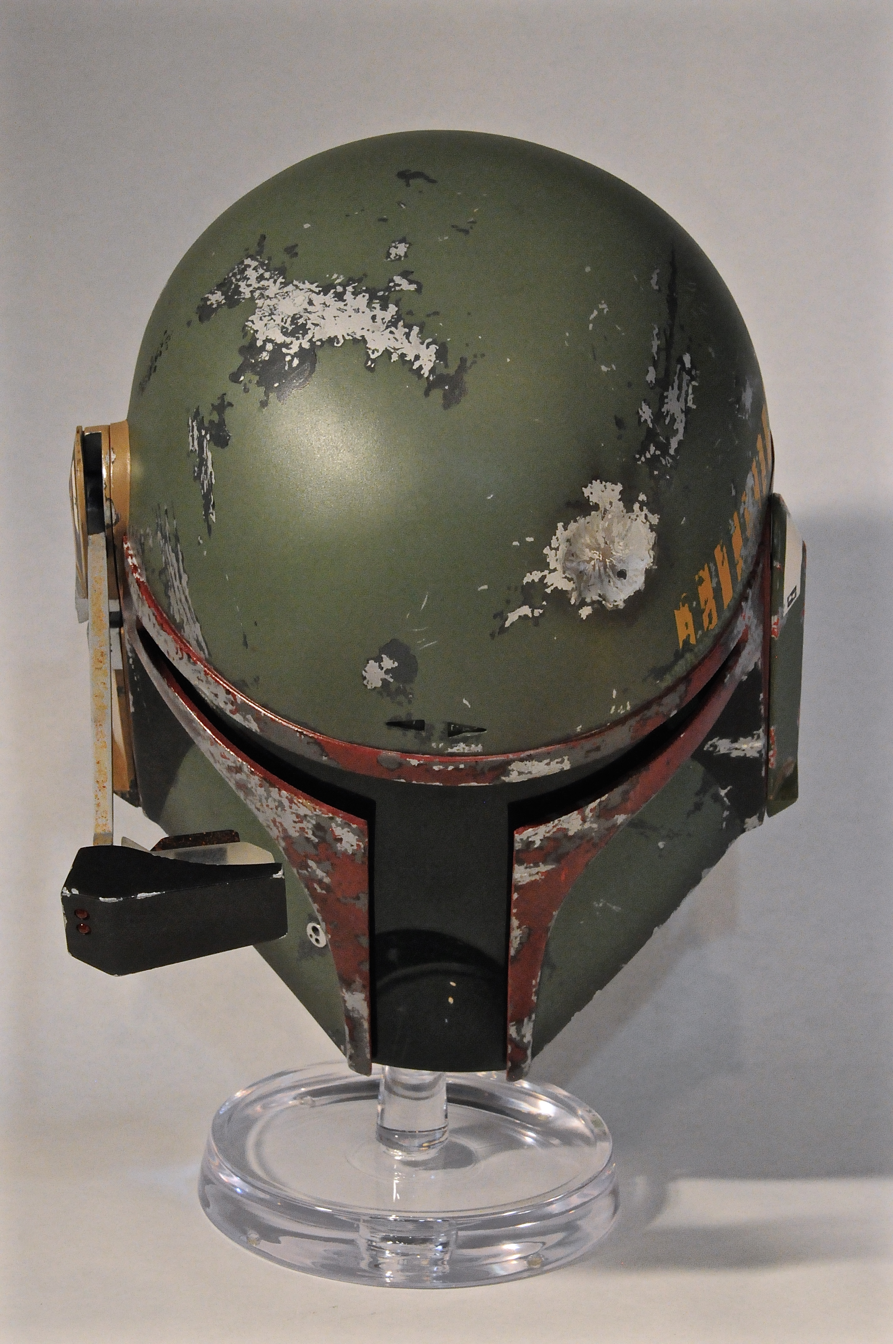

As I am painting I tend to try small things to make a more personal statement if it enhances the basic required look we all are trying to achieve.
A couple of cases in point. You might consider trying them.

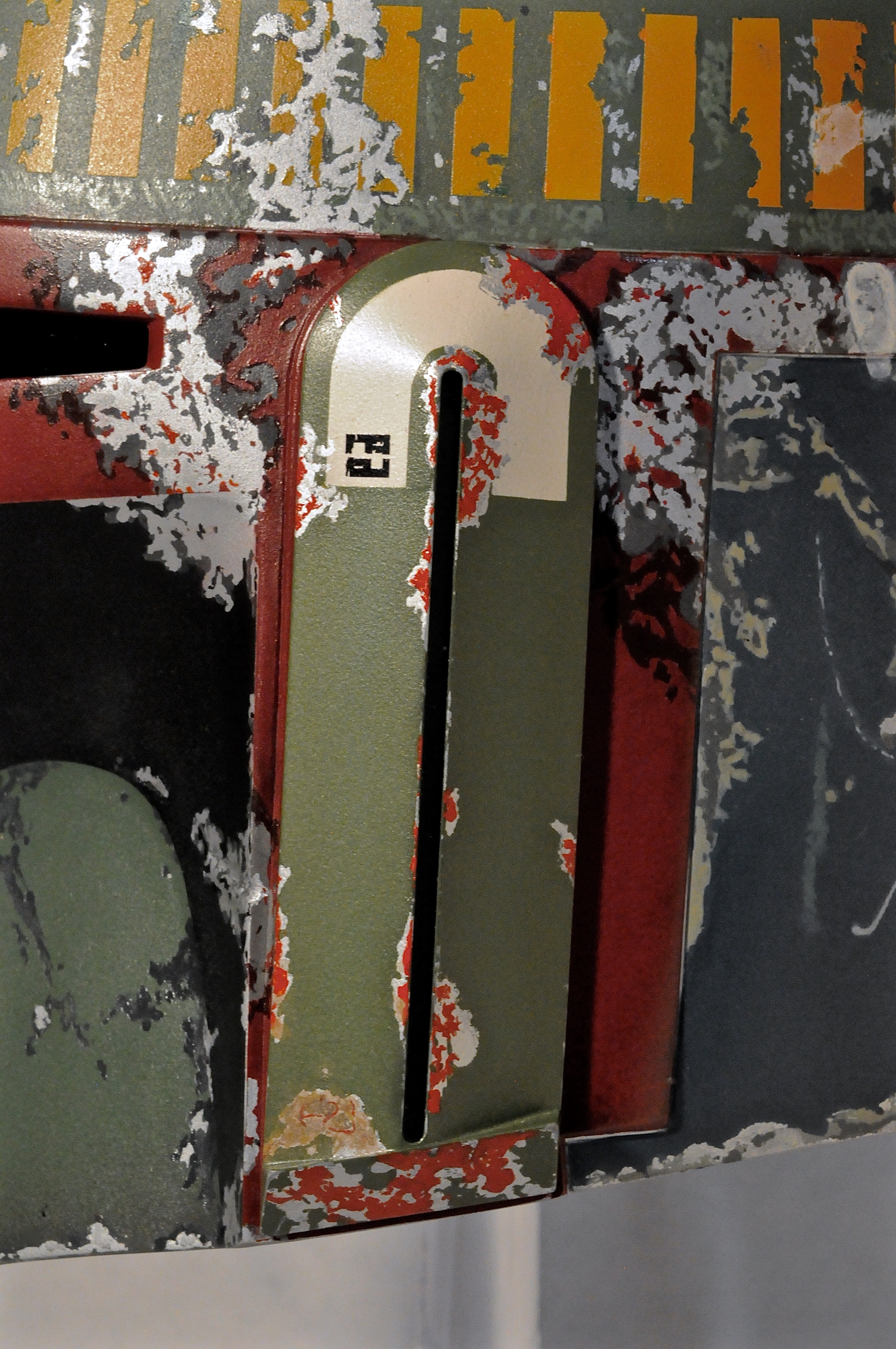

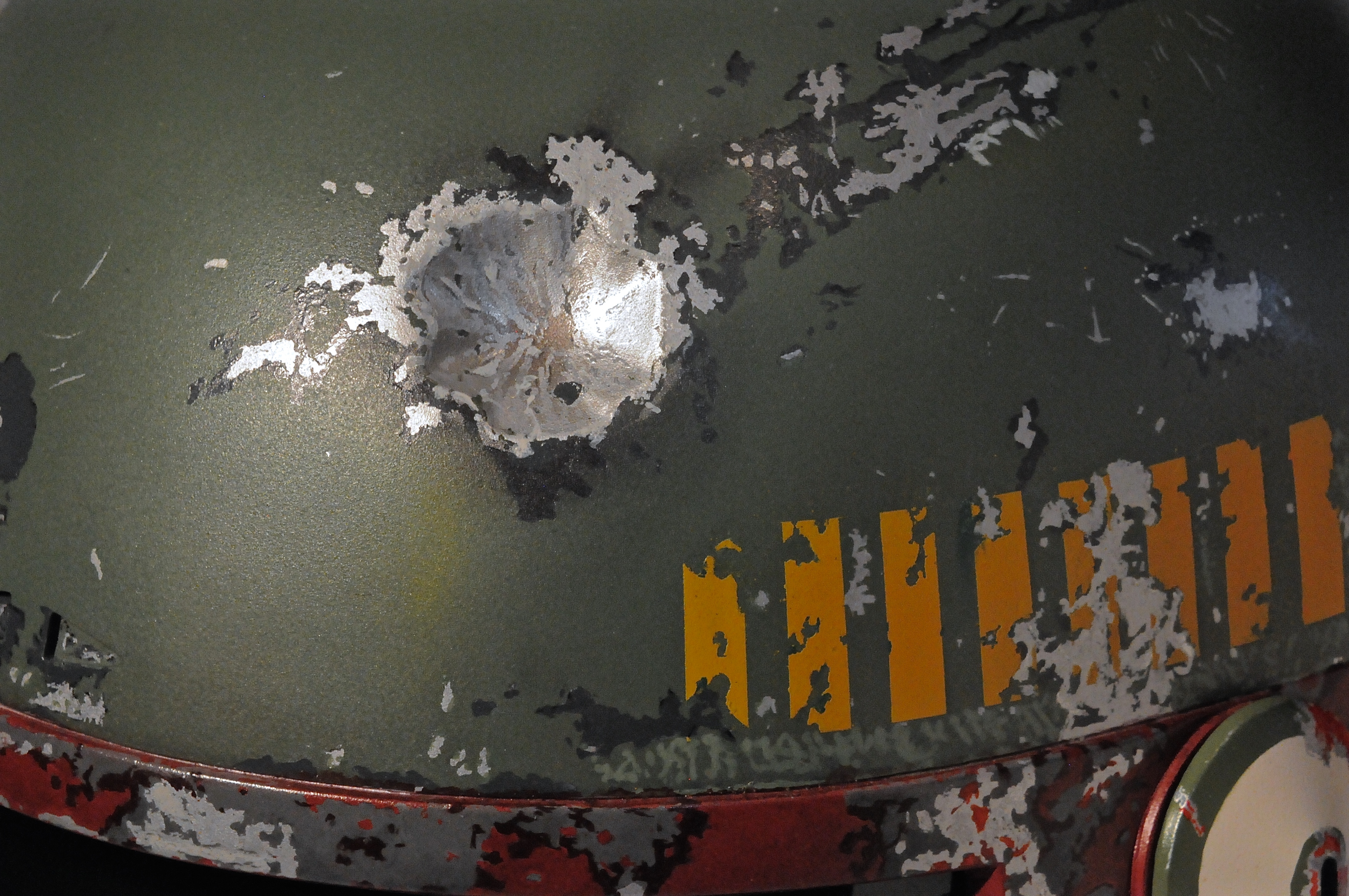

The first is putting a small touch of Model Master Burnt Metal in the helmet dent. Adding a very subtle bit of color to the silver enhances it I think.
It shows in this photo without being over done.

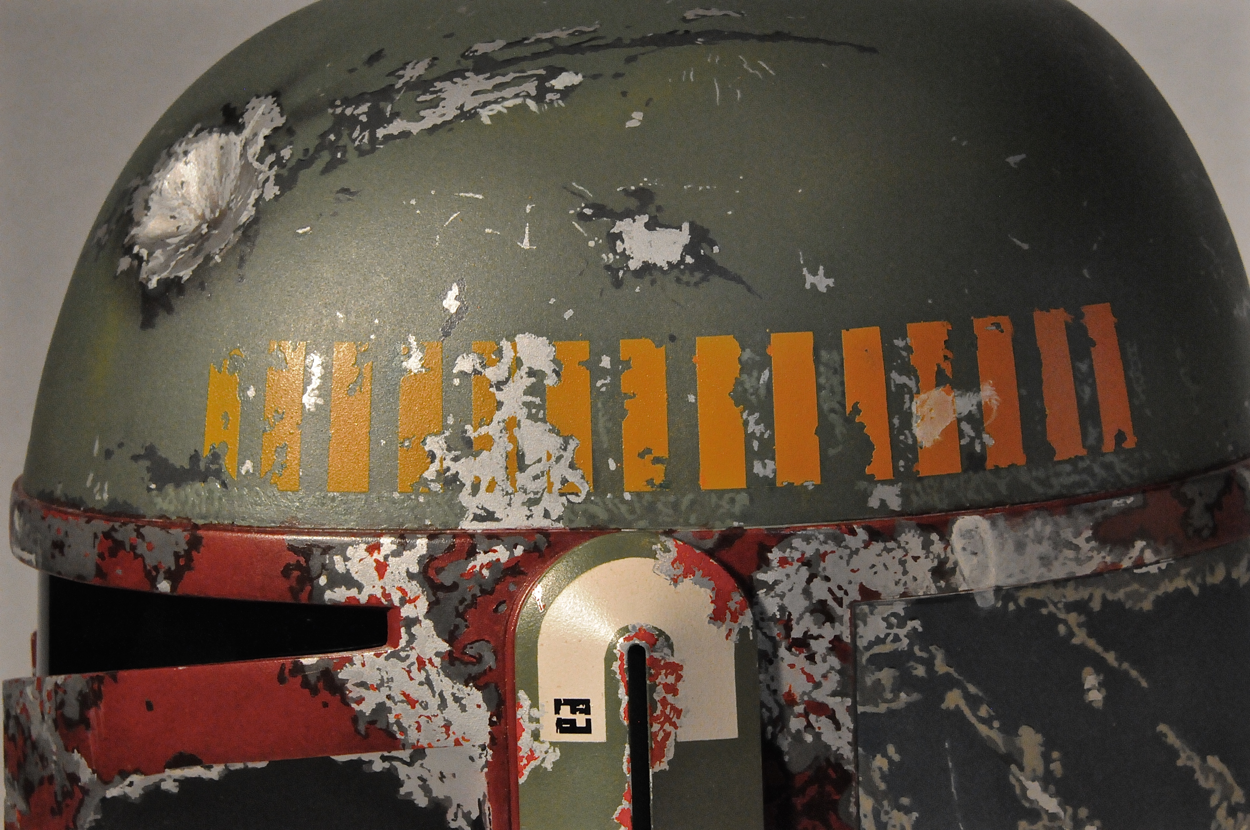

I mentioned before when talking about Rafal Works stencils how the kill stripe stencil must be done by each person to create even divisions between the stripes because
Rafals reflect a curvature of the helmet in the spacing between the stripes. What I didn't talk about was the way the stencils include (which is helpful) the small bits of paint that
protrude, here and there,outside the main lines of the last seven stripes. These were most likely areas of paint bleed under the original mask. When paint does this excess pigment can
pool making these small spots denser in color than the sprayed areas of the stripes. To replicate this effect just spray your stripes then topically add extra color to make the spots of bleed denser.
It's a very small detail but easy to do. Here's my attempt at it.
