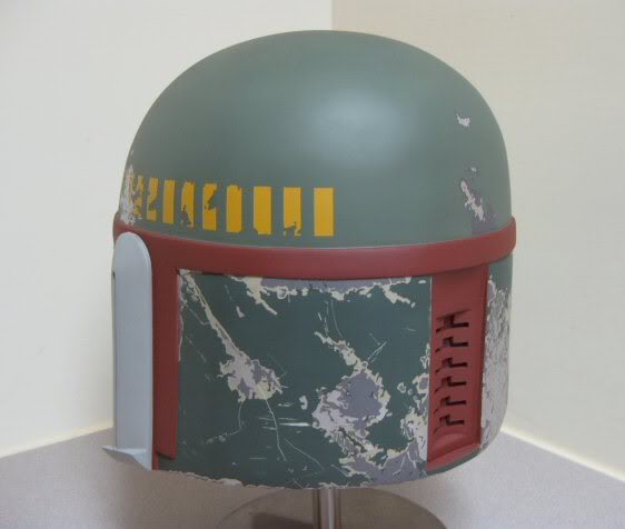

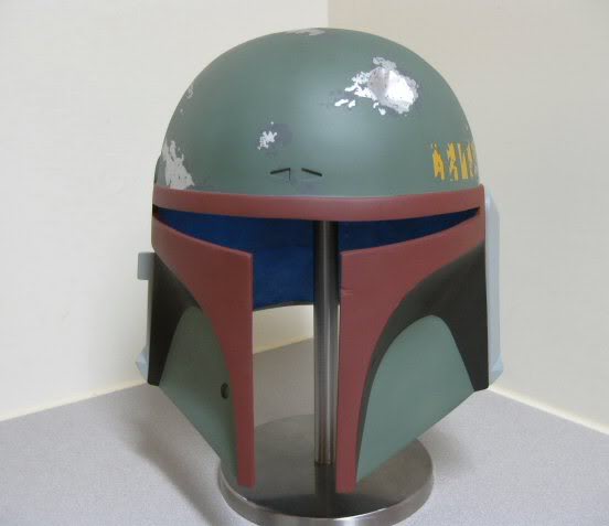

Here are a couple of overall shots of the helmet.
You can probably already see some of the differences in patterns between this bucket and the screen-used ESB.

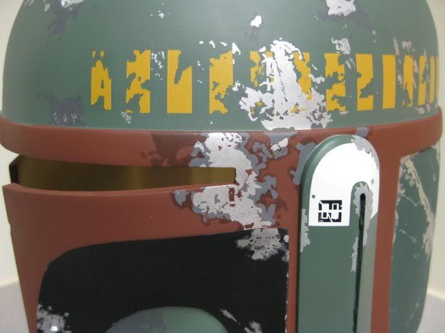

Here's a shot of the kill stripe side. Notice there are 15 stripes.

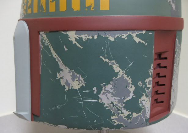

Here's a tighter view, showing some of the damage I've begun to paint in that area.

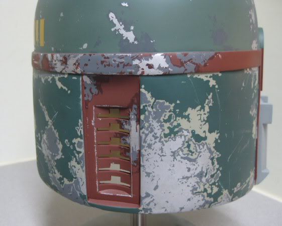

A couple shots of the back panels, showing the differences in the patterns. Lots more scratching and scraping on this helmet as well!

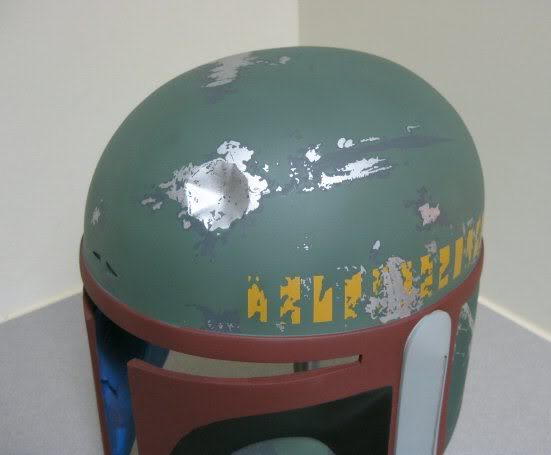

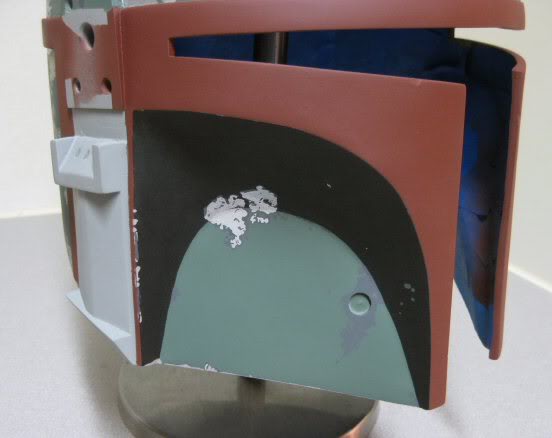

Here's the dent/killstripe side of the dome. Pretty much finished the basic color application on the entire dome now. Weathering the whole helmet will come once all the painting is done.

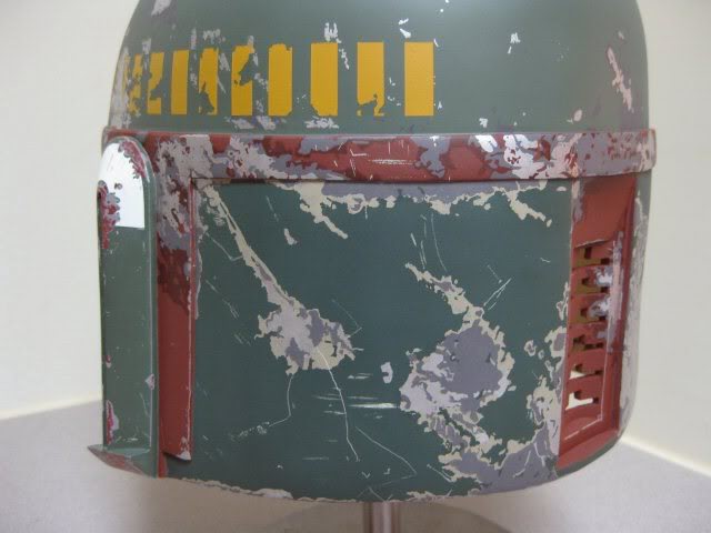

Also got the cheeks done. Well, the right cheek and the lower left cheek anyway. :)
After I finish the upper left cheek, I'll begin on the red portions. :thumbsup:

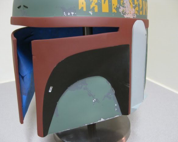

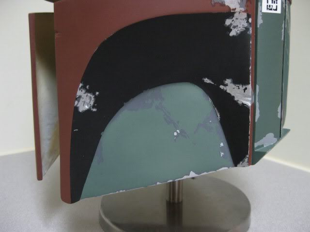

I've made a little progress on the left side of the helmet. I finished the upper left cheek
Then started some of the damage on the red areas

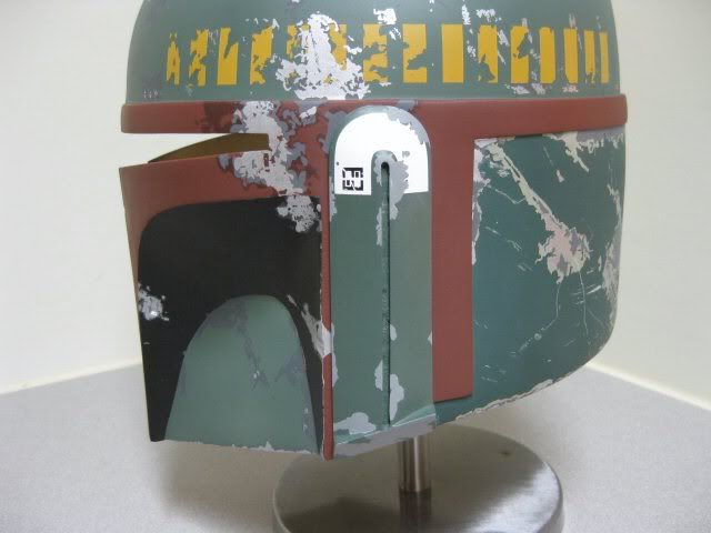

And I've started working on the left ear. The white arch was marked, masked, and sprayed with flat white. The damage was pre-masked with W&N masking fluid first. The black markings are dry-transfer letters.

I've finished the left ear, using Polly Scale Rock Island Maroon for the red damage. There are more fine scratches apparent on this ear than on the ESB helmet, and I used my compass tip to scratch those in. (Same technique as on the rest of the helmet.)
You can see I've also started working my way around the red band.
Here are a couple more shots, just moving around toward the RF side.
Last one shows where I've done the bottom portion of the red area behind the ear. I'll start working my way up from this point.

I love all the hairline scratches, i think its this eye to detail that really makes the damage seem real and compliments the painted damage. How did you achieve the white paint scuffs? If that's what they are...:thumbsup:
Thanks, all. I'm enjoying this paint up. :)
Garrett, the scuffs are also scratched into the paint. I'm using an X-acto blade and scraping very lightly in multiple passes.
There are a lot more scuffs than the ones I've done so far, but most of them will be done with pastels once the rest of the paint work is complete.
