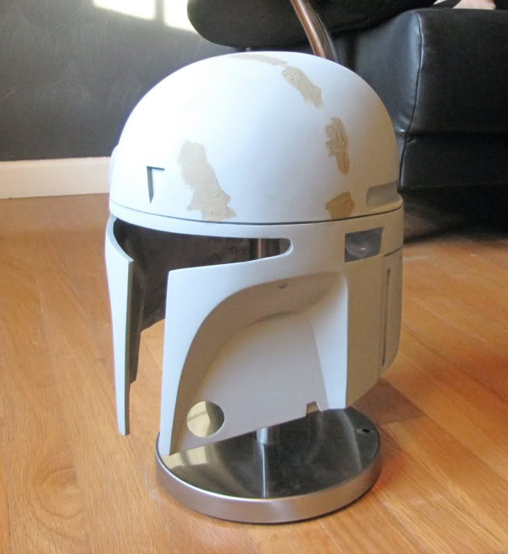

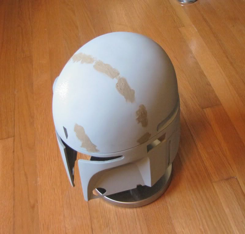

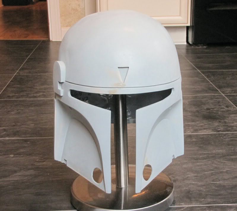

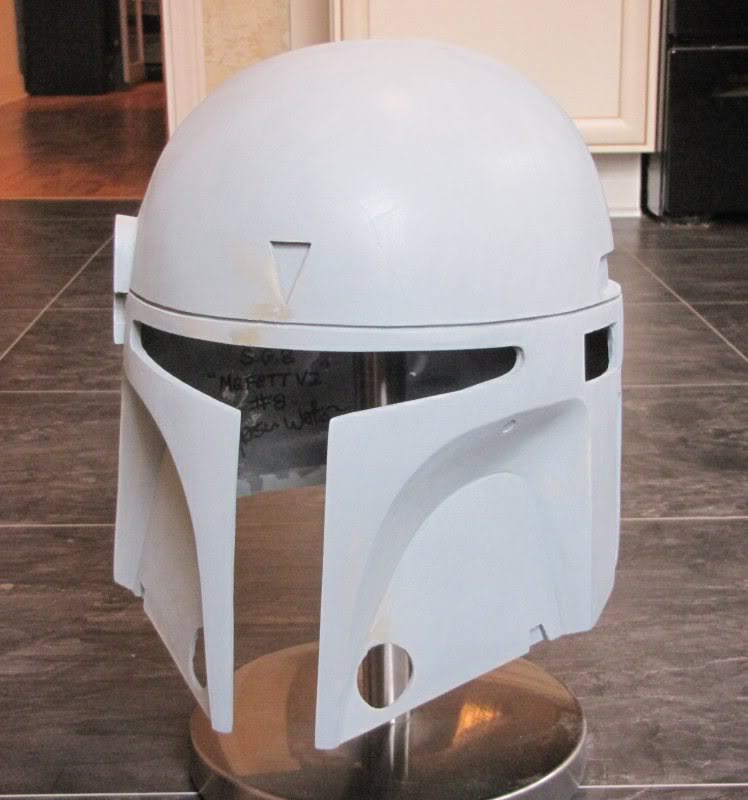

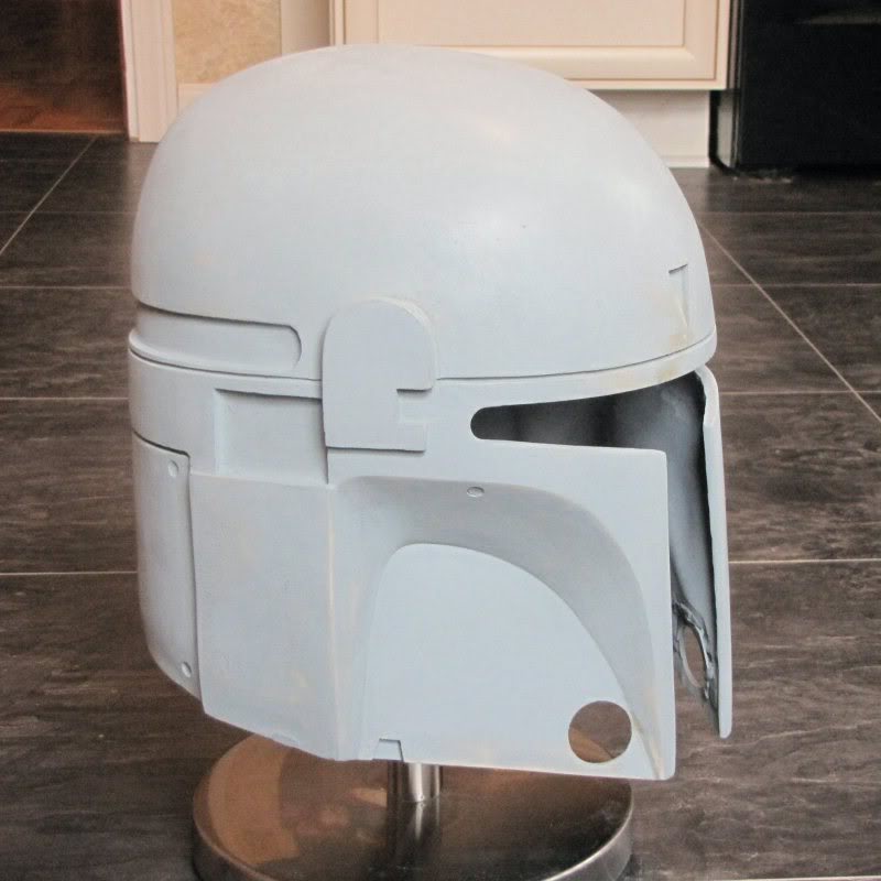

I've got the bucket in primer. All the cutting and sanding is done on the visor area and the 3 locations for the insert pieces.
I used a "filler primer" for my basecoat, just to level things out nicely and see what else needs attention. It did reveal some
small spots here and there that will need a dab of filler. No big deal. Here's the helmet as of this afternoon.
Jason really did a great job capturing the feel of the McQ sketch.
The detailing on the back of the helmet is great!
The cutout over the left ear is where an insert part will go. After everything is primed/sanded, I'll epoxy
the detail part in place. Same with the 2 circles on the lower cheeks.
In this last helmet shot, you can see where Jason wrote the maker's info on the inside. Mine is #8.

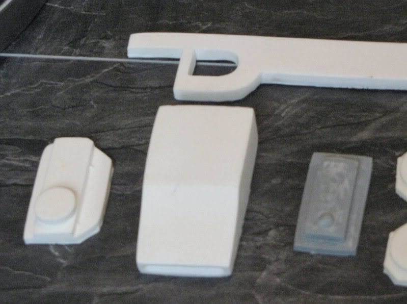

Here are the accessories that came with the kit.
Closer view of the 3 RF parts. The detail piece goes on the right side of the RF topper.

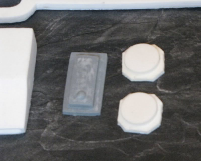

Finally, here are the 3 other detail pieces. The rectangular part goes over the left ear, and the
two circular parts are inserts for the lower cheeks. The flanges around the parts are to set them at
the correct depth, making them level with the helmet surface.

Not much to show this morning. I got the first round of primer/filler sanded down, and as I suspected, there were
a few low spots that needed a little more attention. Nothing major, just around the seam on the dome, and one
small area near the forehead triangle. I slapped on some putty last night, and I'll sand it down today and shoot
one last light primer coat.

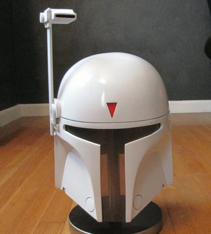

Here's a front view.
The white is very glossy and smooth. Not quite mirror-smooth, but it looks great! I painted each of
the accessory pieces the same way before they were attached. Below you can see the rectangular
insert over the left ear and one of the circles on the lower cheek.

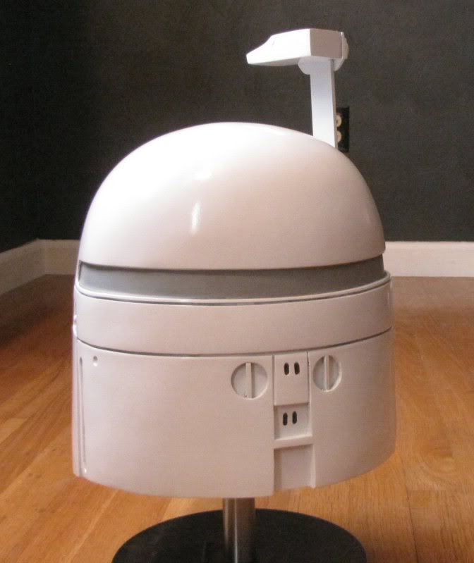

These pics of the back of the helmet show that I also painted the 4 small oval "vents" in the center of
the back panels.

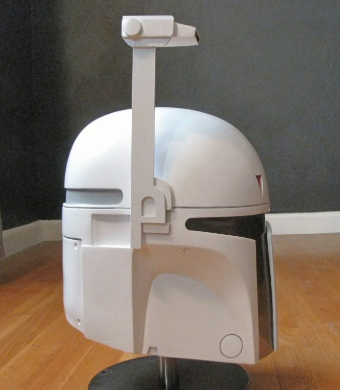

This shot of the right side shows the RF stalk attachment. I actually didn't use the part that Jason supplied.
I was having some trouble getting the part sanded evenly lengthwise. I just couldn't get a flat surface
all the way up the length of the stalk. So I traced the shape onto some 1/4-inch Sintra and cut a new stalk.
It's a bit thinner than the piece supplied with the kit, but I like the way it turned out.

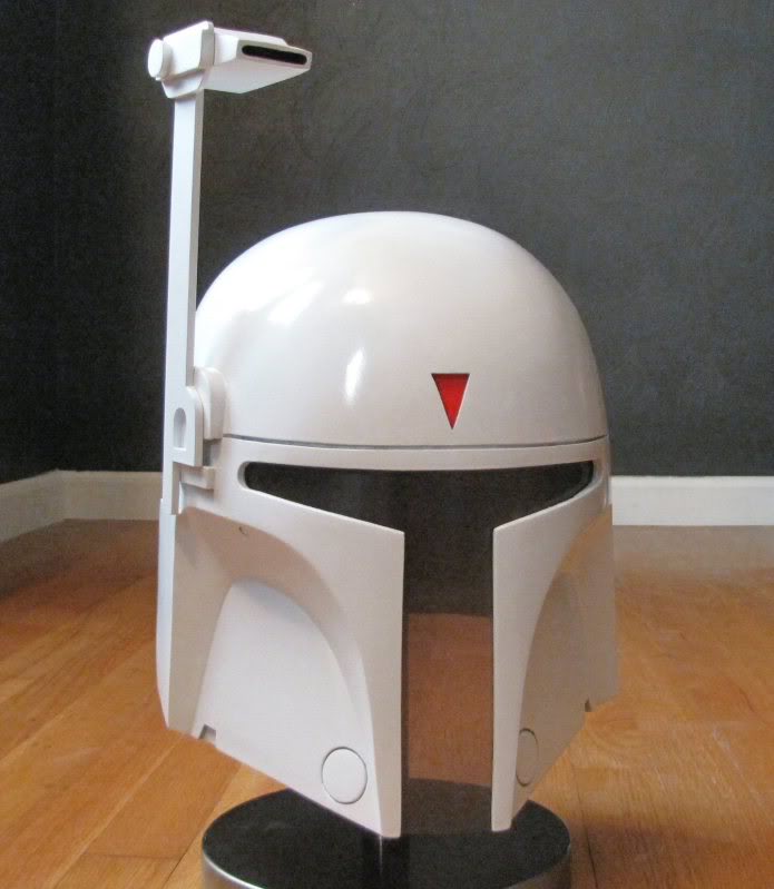

Since this is purely for display, I made a makeshift visor from a smoke gray report cover. Just a really thin
piece of plastic like you might use to protect a term paper or something. It's actually just taped into the
helmet with plain ol' masking tape. :lol:
If the light gets behind it just right, it's still kind of translucent. I may add a second layer to make it
less see-thru.
