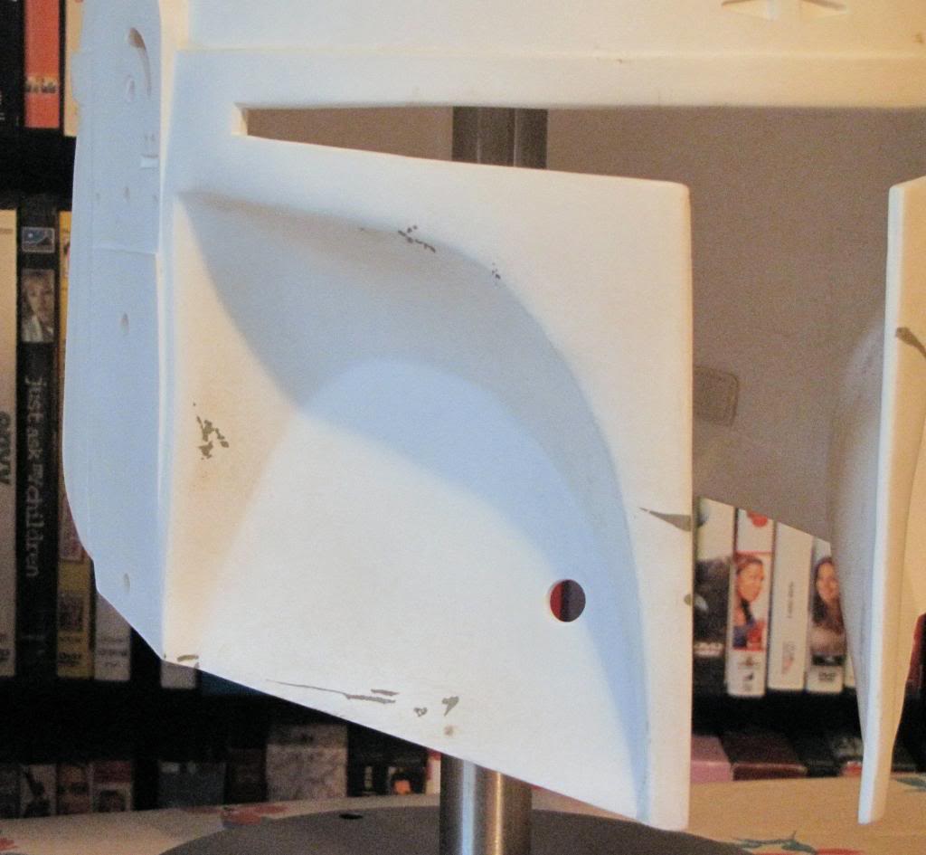

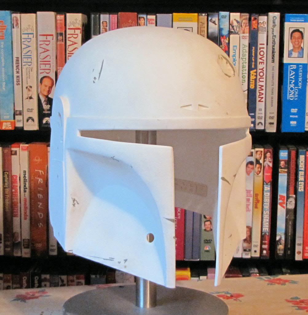

To begin this job, I finished doing the trimming and sanding. There was some
smoothing to do around the visor cutout, and then I sanded around the bottom
of the helmet, and cut out the keyslots, and drilled the holes in the ear platforms.
Since this is to be an ESB bucket, I used some glazing putty to fill in the GMH's
physical damage.
I got it as smooth as I could in preparation for the primer. I also drilled out the
resin Borden piece and cut down the Borden connector.

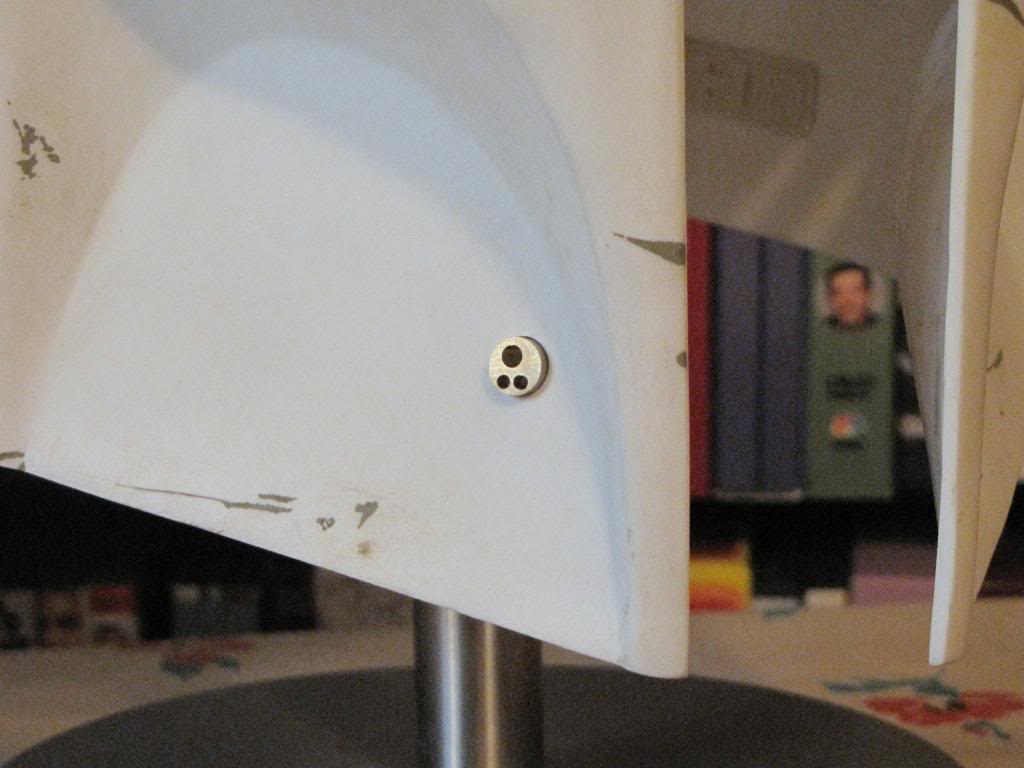

Here's the Borden rough cut and sanded. I'll do a bit more fine sanding.
Here's the Borden in place. Nice, tight fit!
I put on the first coat of primer a little while ago. It revealed a couple of places where I
need to apply some more putty. I'll do that tomorrow and shoot a second coat of primer
and then I should be ready to start adding some color to this bad boy!

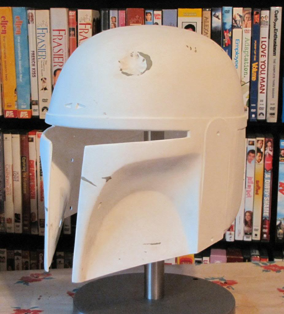

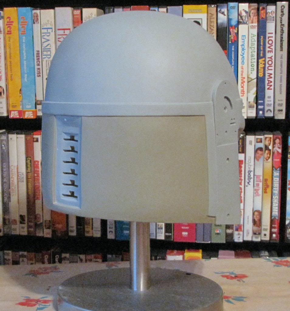

UPDATE: December 23, 2012
Not much to show right now. It's always slow going at first, but it should ramp up in the
next couple of days. I finished the puttying and sanding, and marked the position of the
ESB physical damage. A few minutes with a very sharp #11 X-acto blade and the helmet
was given another light coat of primer.
The physical damage can be seen in the picture above.

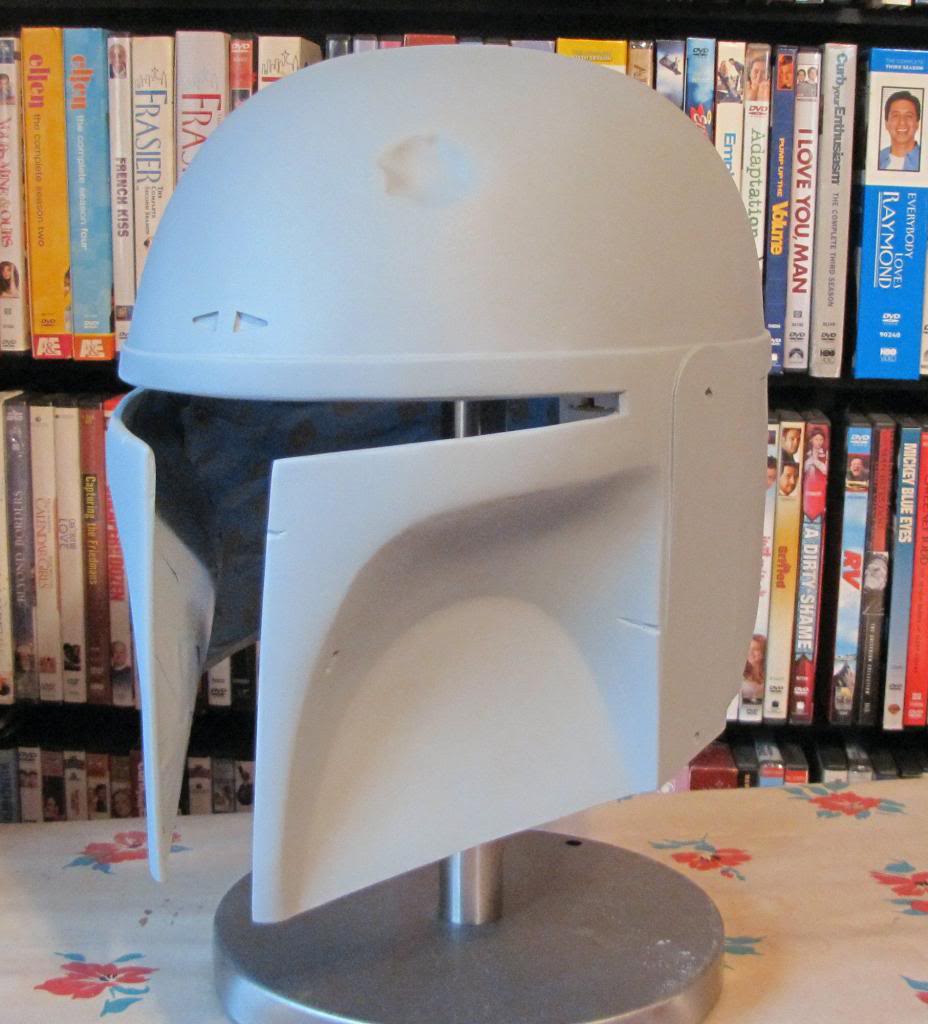

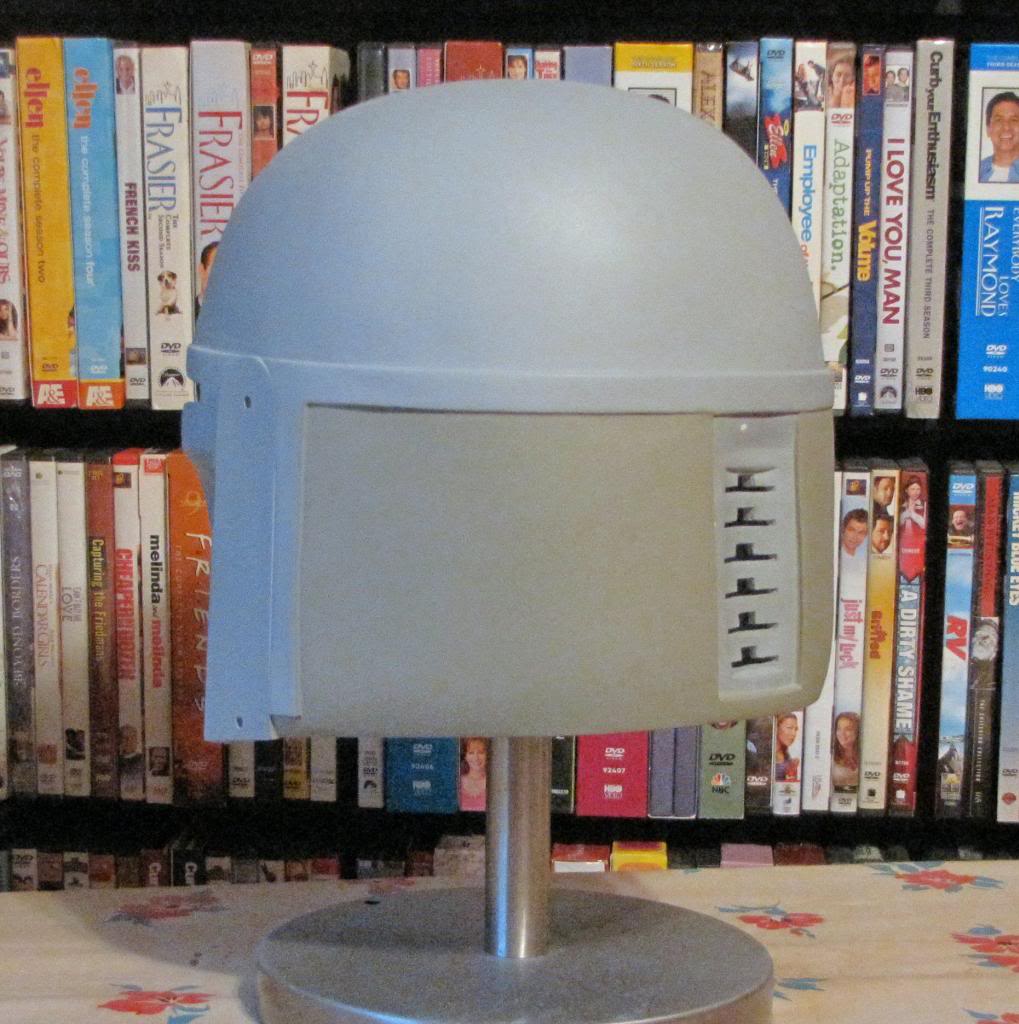

Once the primer had dried, I masked off the rear panels and sprayed the first color coat:
Floquil Concrete. Again, the pics are kind of boring, but here's where she sits as of tonight.
Tomorrow I'll begin the measuring/stenciling for the rear panel dark green. I haven't done a set of stencils
yet for the ESB version sized for a GMH, so I'll be taking my time and making sure everything is proportioned
correctly. Rafal's templates will be a big help as always!
Finally have something to show you guys. :)

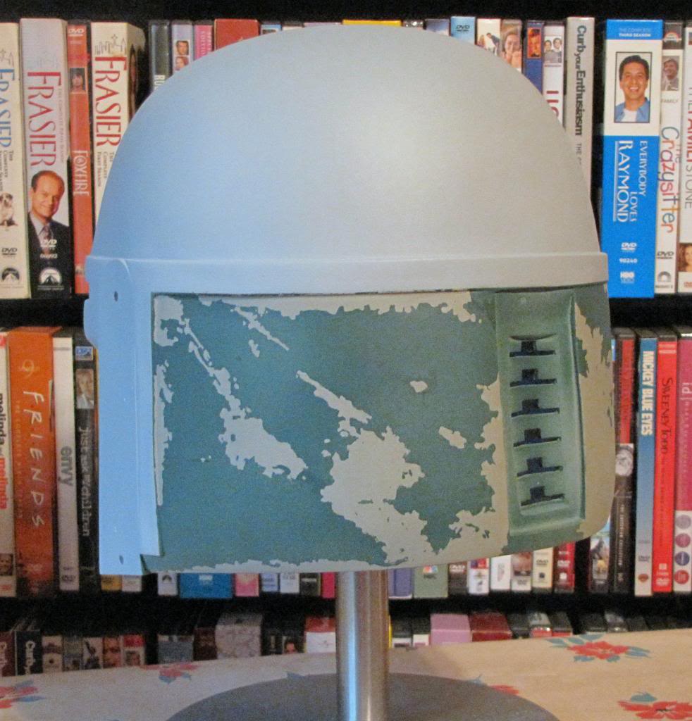

Once the masking fluid had dried, I got my rear panel green ready to go. I begin with a
1/2 oz. bottle of Model Master Acryl Euro I Dark Green, and add about 60 or so drops of
Polly Scale BAR Blue. That's the mixture I've been using on all of my ESB paint ups for years.
The BAR Blue darkens the Euro green, and shades it just over into the blue/green range. It
also gives a nice color shift depending on the lighting conditions.

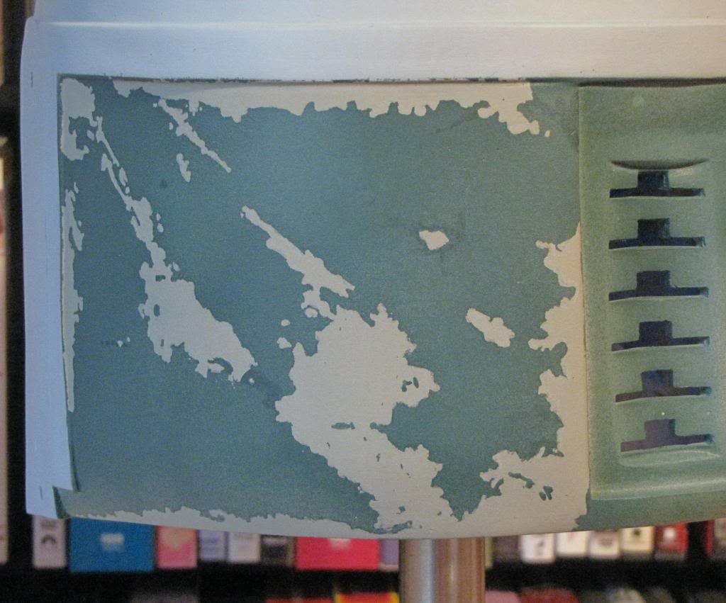

Here's the left panel.
I thin my acrylics with water. I got it fairly thin, and airbrushed it on in a couple
of pretty light coats. I wanted it to have some translucency, and not be one solid expanse of green.
I allowed some of the Concrete to show through very subtly in places.
I then tightened my spray pattern and went back to darken the green in certain places. I usually have
my laptop next to where I'm painting, and I keep a couple of reference pics on the screen as I'm
airbrushing. This shows me exactly where I need to go darker, or feather some of the color as
I'm painting.
When I had gotten the patterns I wanted, I went back with a wider spray pattern and shaded
the panels a little darker overall. That got me pretty much exactly where I wanted to be colorwise.
These next shots show the small dark areas scattered around the back panels. I didn't use a different
color on these. I used the same custom mix that I had airbrushed on. Applying the color with a brush
made it more dense, and it appears darker to the eye.

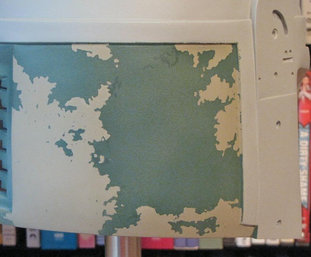

Here's the right side.
So that's a big stage done! Next will be to add the gray and silver areas on the back panels. I will probably
do the fine scratches as well before I move on to the next portion--the dome and lower cheeks.
Thanks for looking!

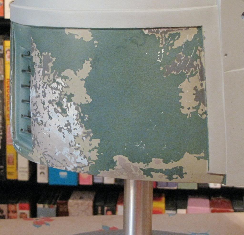

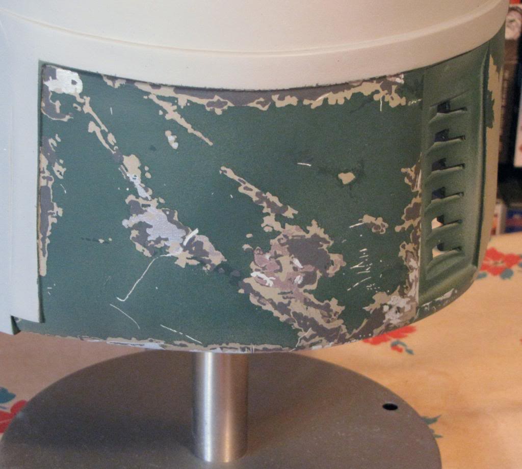

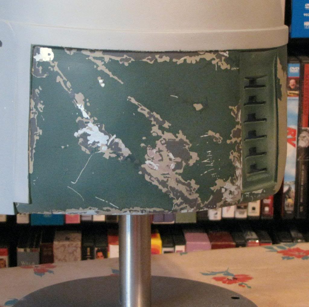

UPDATE: December 27, 2012

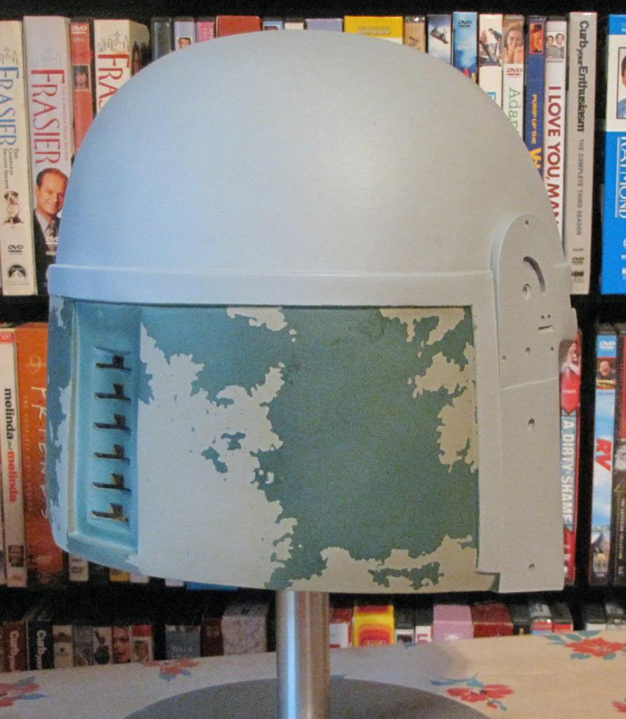

Left rear panel is complete. :thumbsup: I used the "standard" colors as usual:
SP Lark Dk Gray, and Bright Silver. I cracked open a brand new bottle of silver
for you, Scott!

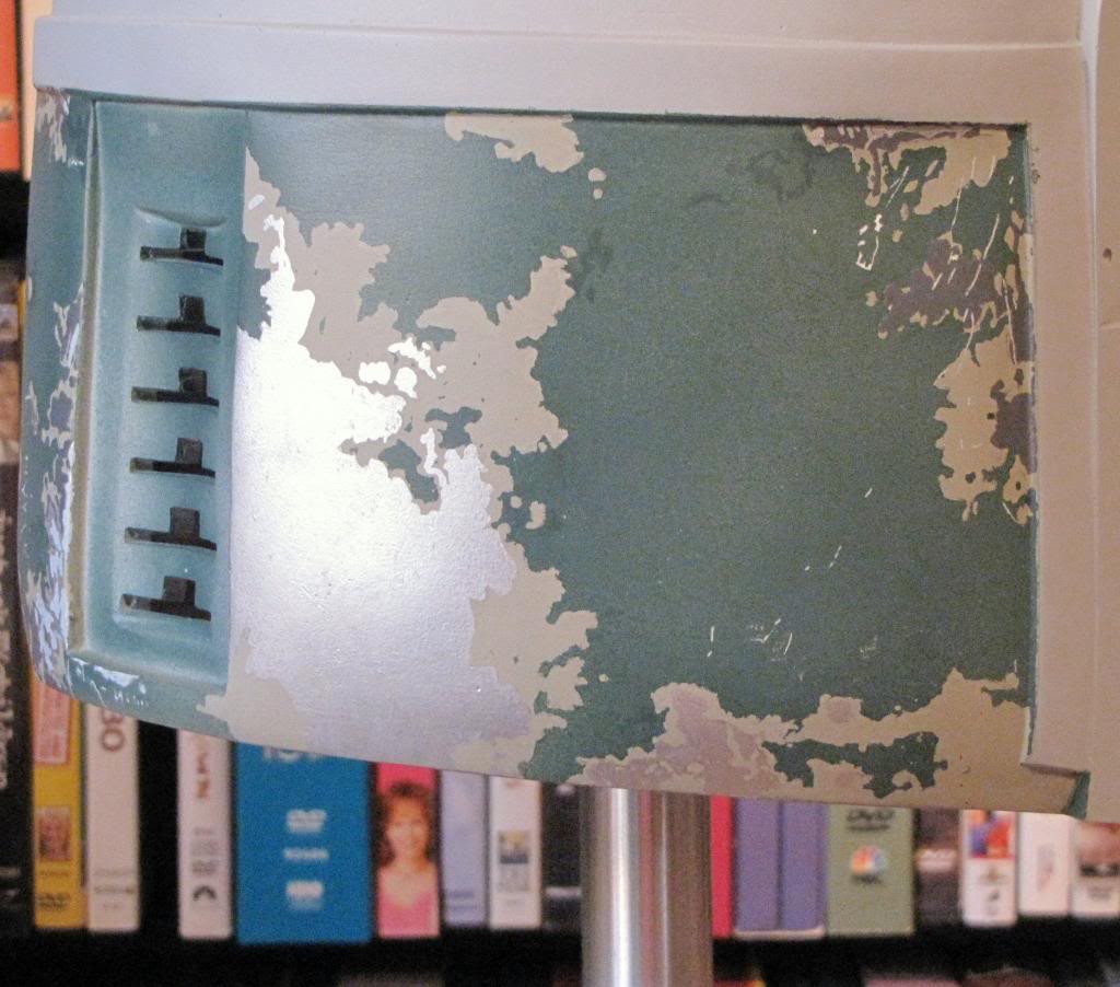

Once the basic colors were on, I went back with my compass point and added the
fine scratches. I also added the contrasting pale gray base color. It really changes
appearance depending on the lighting and the angle. There will be more of this color
on the right panel, and then in several places on the front of the helmet once I
reach that stage.
Oh, and to do this detail work, I held the paintbrush between my eyelids. :p
Thanks guys. Here's the latest:

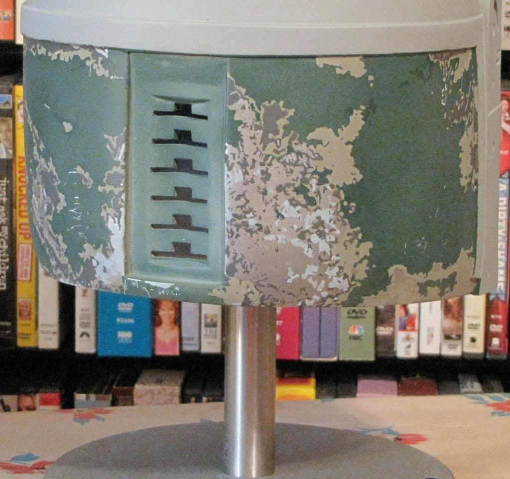

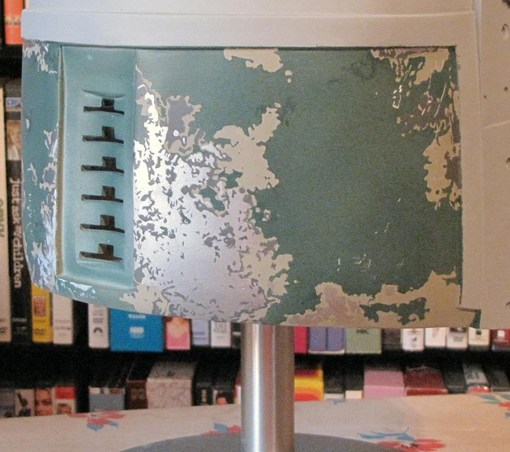

UPDATE: December 28, 2012
Continuing to work on the rear panels. Since I work topically, I thought I'd show the progression
from "blank canvas" to completed section. I began by laying out the large silver area next to
the keyslots. It looks very featureless at this stage. I just want to block in the entire area.
After adding the gray damage, it transforms into what we're used to seeing.
With the addition of the contrasting gray, this section is done! I've included two shots
to show how the color shifts depending on the angle.
You can see that the upper right corner of this panel is done also. All that's left now
is the area in the lower right. When that's done, I'll do the fine scratches and then
I'll mask and prepare to airbrush the dome and lower cheek areas. :)
