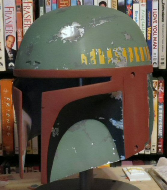

At last, something that's not gray or silver! :lol: Got the base color down for the mandibles
this morning. Lots of masking for a relatively simple stage, but getting nice clean lines is key.
Here are a couple of shots of the increasingly Boba-like helmet.
In the shot above you can see the additional damage that's between and around the killstripes.
I won't do anything else on the actual helmet today. I like to give this coat at least a good
12 hours to really cure up hard before I begin the damage portions. But I will work on a couple

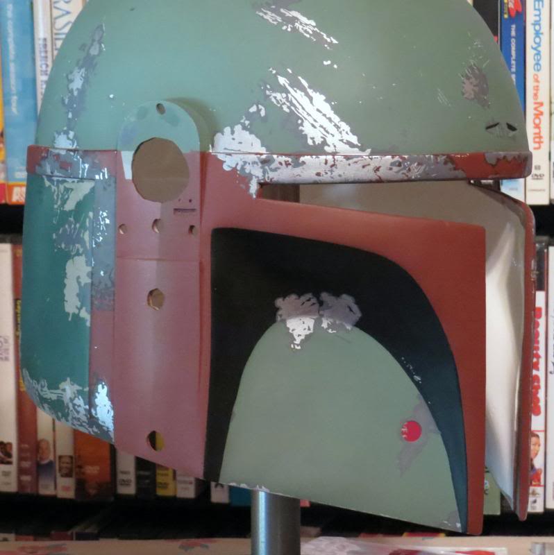

As I just mentioned in the last update, I'm now working on the red band on the rear half
of the helmet. I break this area up into three sections: left, center, and right. It makes
it much easier to focus on all the small shapes that way. Here's a shot of the center section.
I like to complete each of the sections before moving on to the next. Once I had the center
section done, I worked on the right section, including the vertical space behind the RF ear.

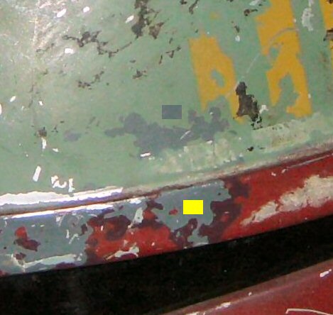

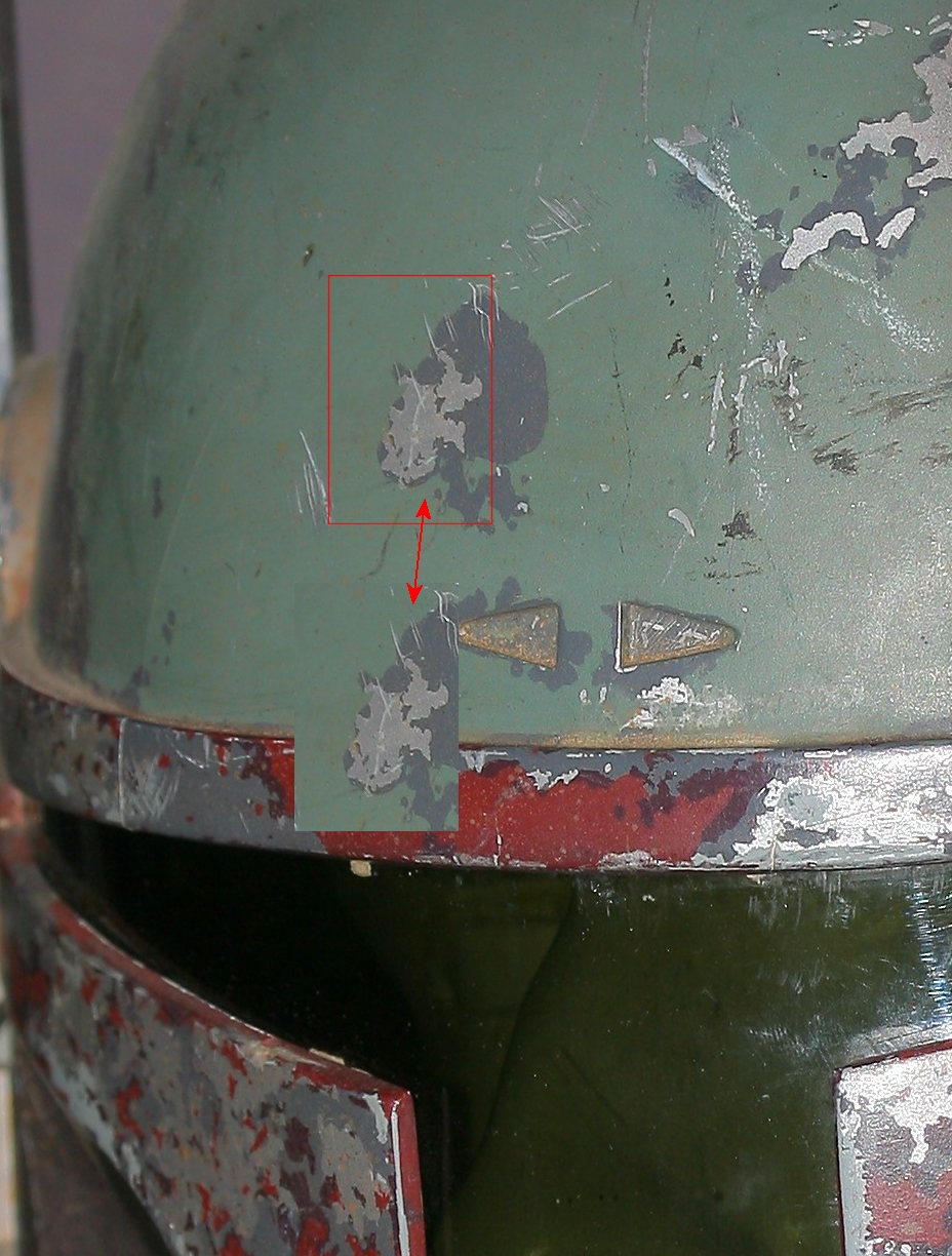

These shots show one of the weird illusions of the ESB helmet. The gray I'm using on the
red areas is the same gray that is used on the dome and cheeks. But against the red, it takes
on an entirely different tone. Here's some proof.
I chopped a little square of the gray and moved it up onto the dome.
The illusion holds even when the grays are right next to each other. Pretty weird, huh? :)

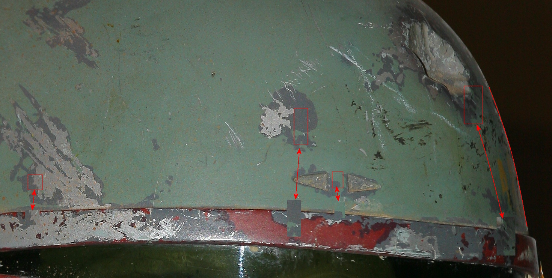

I really would like to believe the grey on the dome and cheeks is the same as the grey on the mandibles and trim, it would make perfect sense, but I can only seem to get the colours/ tones to work when the dome/ lower cheek grey is darker?
Hmm. Not sure what to say, Garrett. The last several helmets I've done, I began applying some
misty, broken patterns over the dome and inner cheeks before I added any of the gray/silver.
I mix a slightly lightened version of the base green and apply that.
For the gray, I begin with 'pure' SP Lark Dk Gray and see how it looks against the green. This
usually appears to have a bit too much contrast over the lightened green of the dome, so I begin
lightening the SP gray a little at a time with a much lighter acrylic gray. I test this until the
contrast between the green and the gray looks good by eye.
I don't really keep any formulas or anything, and I do this process for each helmet that I paint.
So this may be one of those cases of serendipity where the custom gray I mixed came out with
that odd balance.

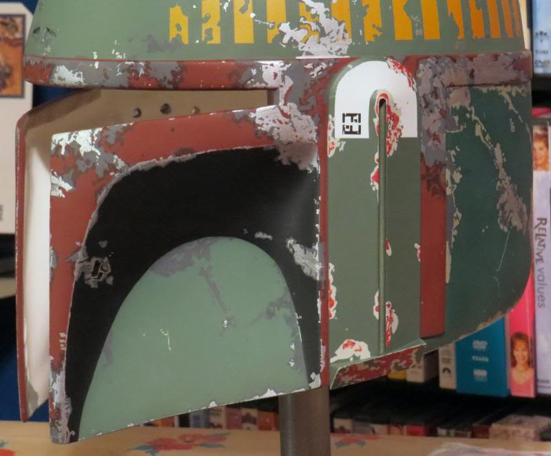

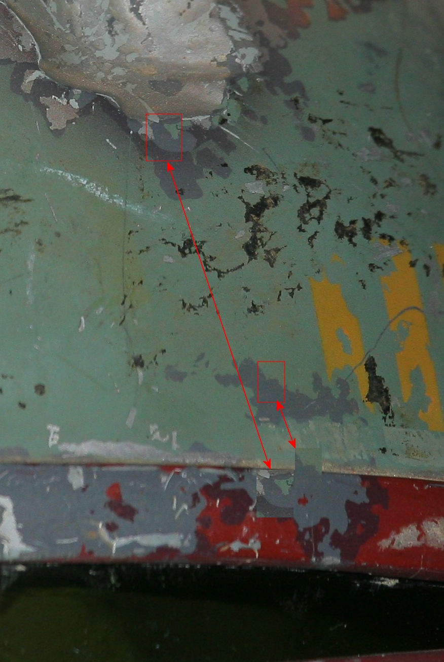

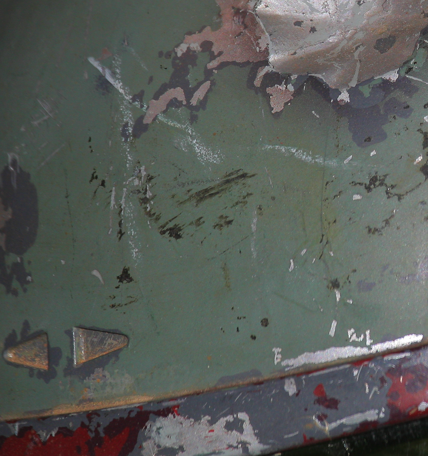

Here's a reference shot from one of The AoSW exhibits a few years ago:
I've cropped it and done the same thing as in my previous post. I took a small square of the
mandible gray and moved it up onto the dome. It seems to show the same color shift.

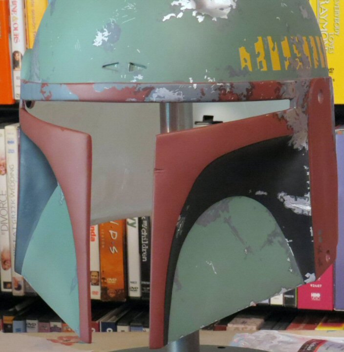

Convincing. Raf, can you do a colour comparison on this pic? The greys I'm interested in are the light grey at the six o clock position to the dent, the darker grey immediately below this point and the grey of the brow trim... thanks...:thumbsup:

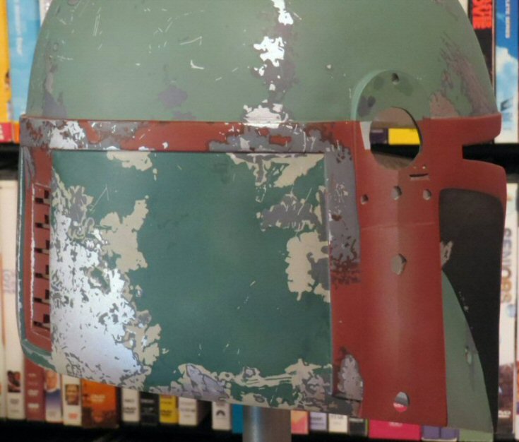

Yea, that pic is the interesting one fellas, and the area I remember doing a good amount of dissection on when doing ESB. The '6 o'clock' area Garrett mentions, definitely appears to have two different greys - the little upside down 'c' type shape appears lighter, while the grey underneath it appears darker. The lighter shade by eye, appears to be similar to the grey on the red trim, though this could be thrown off with the greys playing off the other base colours. But I definitely went with two types of grey around the dent, and this could also be some sort of evidence, that two different shades of grey were indeed used around the helmet.. :)
I know about the 2 type of gray around the dent and the left lower cheek (thanks to you), but the majority of the grays looks the same on all the base colors. There are slight variations on the right side where the orange/rust color is misted in excess. Also the light is playing some tricks to the eye especially when you look at the dome colors (being a round, cup-like surface) and the rest of the helmet (round too, but with a tube-like surface), so the light didn't shine the same way even on close areas. Here are some other comparisons of the front of the dome:
ESB Lark Dark Gray 02.jpg ESB Lark Dark Gray 03.jpg ESB Lark Dark Gray 04.jpg
But looking at the dent and the long scratch behind it, it seems that the darker gray is present all the way. I need to look at some images to see if that is the case or not.

But that third pic Raf posted in post #29 is very interesting. In that pic, whether it's
due to lighting or the angle, it seems that the lighter "upside down C" under the dent
matches the mandible gray, while the other gray is slightly darker. Hmm. . .

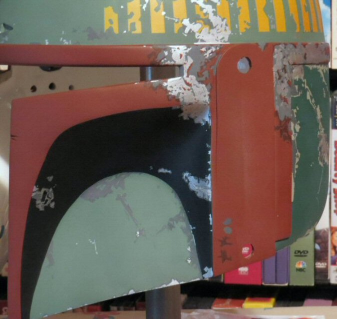

I've completed all the remaining red areas behind the ears. Still using my gray/silver/maroon
combo, and I'll continue on with this for the remainder of the mandible areas.
This area will wind up looking different once the thumbprints are applied. There will be some
white streaking coming back from the lower thumbprint, which will give it a slight washed appearance.
I've also made it around the ear platform and just started on the front portion. Here's the left
corner of the T-visor.

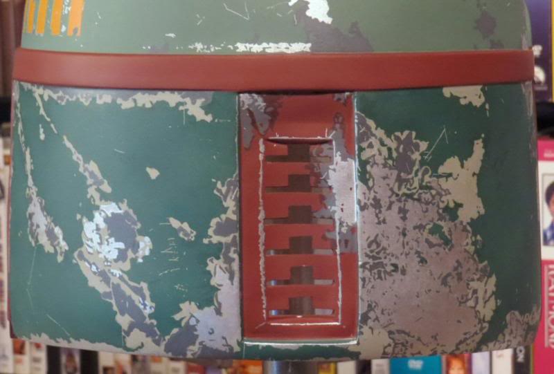

UPDATE: October 24, 2013
OK, back from my trip and back to work on the helmet. :)
I've continued onto the band above the visor cutout. This is the left half completed.
Same colors, and some very fine scratches added with my compass point. You can
see that I've laid down the base gray around on the right half as well. I'll detail this
portion next with silver and the maroon color.

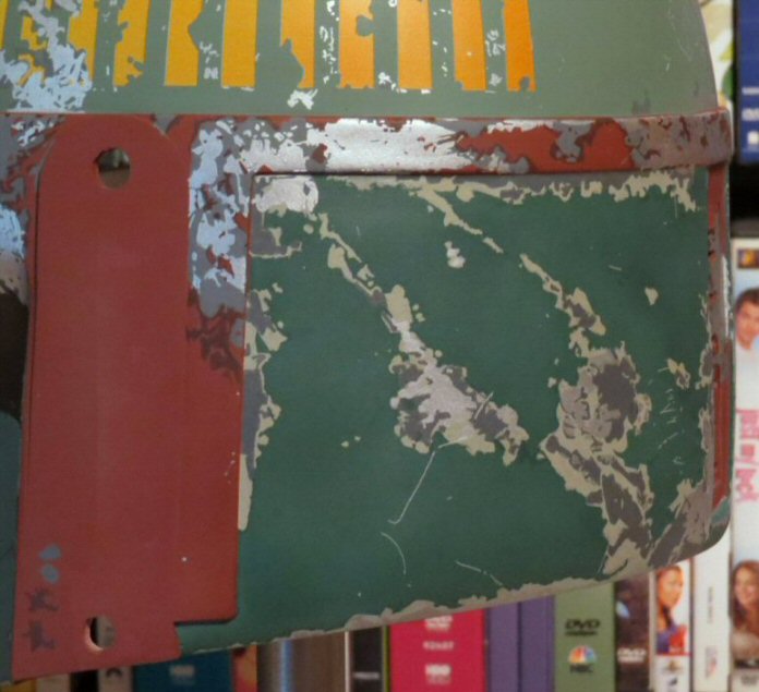

I did the left mandible after that. Lots of juicy detail here! :)
I'll begin laying out the damage on the right mandible next. That's the last "major" portion

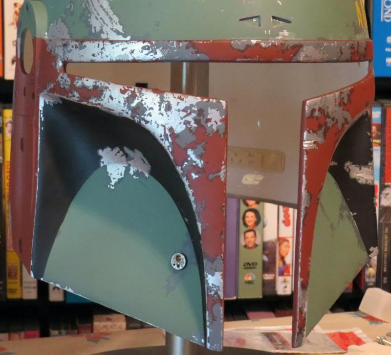

UPDATE: October 30, 2013

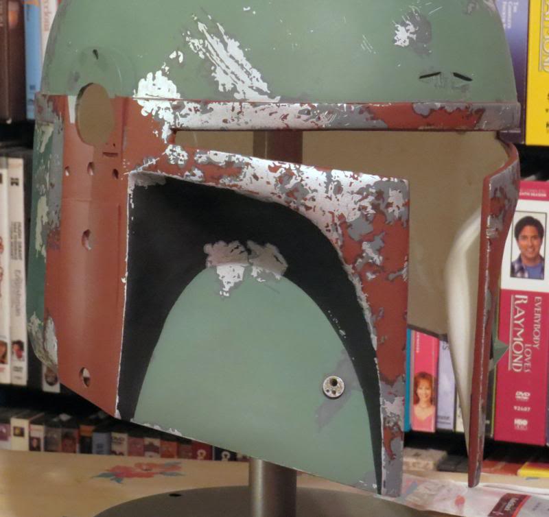

Whew! Got lots done over the past 3 or 4 days. After about 7 sessions, I got the right
mandible done. This area always makes me cross-eyed. :lol: It's one of the most detail-intensive
parts of the helmet, and it takes constant checking of the reference pics to make sure the
shapes and proportions of the damage are as close as they can be.
This area, and the whole helmet, will receive a bit of the pale contrasting gray. So even
after all that effort, it's still not quite done! But there's much less of the pale gray on the
front of the helmet than on the back.
Also seen above is the brass Borden connector. The Borden received a thin wash of a light
green/gray mixture to give it a sort of patinated look, like "old" brass. The wash is applied
sparingly to allow the base metal show through. Then it was detailed with a bit of silver.

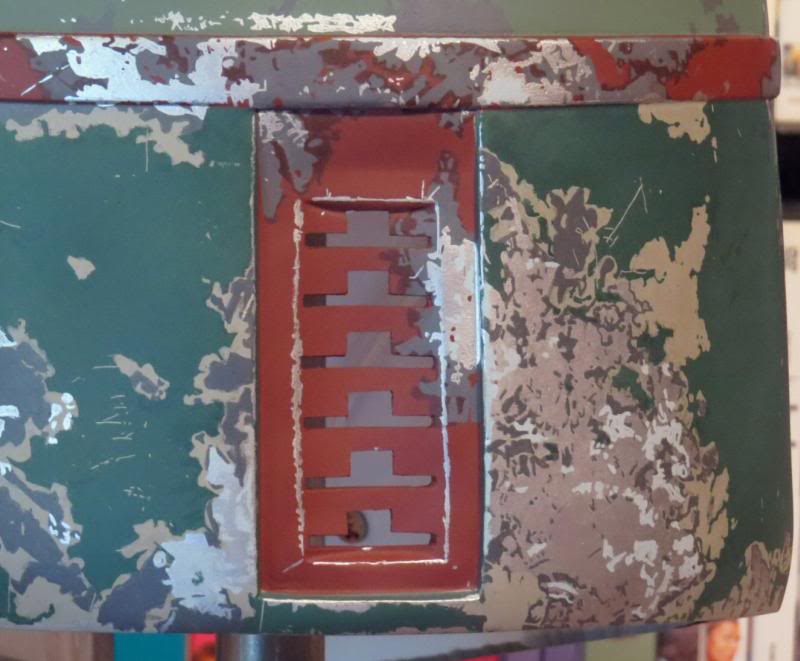

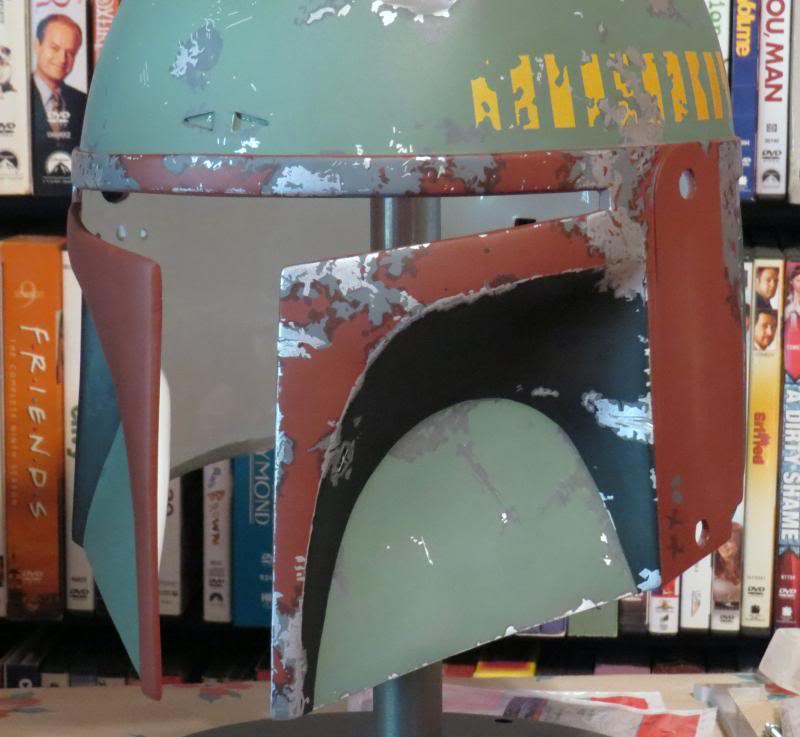

When I didn't have quite as much time to spend on the helmet itself, I worked on the left ear.
The white arch was masked and airbrushed on, with chips courtesy of Winsor & Newton
masking fluid. It was then detailed with light gray and red. The black markings were done
with dry transfer (rub-on) lettering. I used 2 capital E's and 2 tiny squares cut from other letters.
I use a bolt-on method of ear attachment, so they are removable. The ear is yet to receive its
final weathering with some tan/brown staining near the bottom.

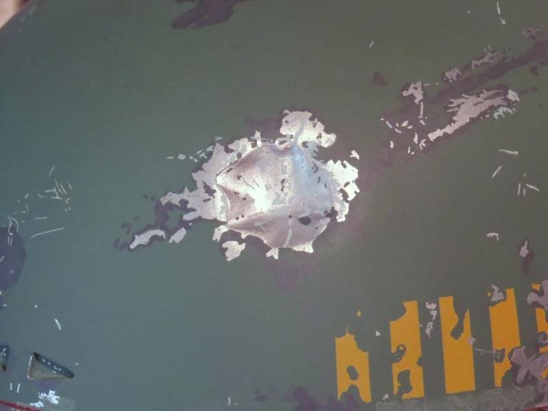

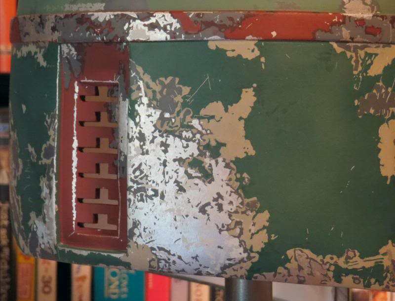

Here are a couple of pics showing how this color "hides" depending on the light source and
the viewing angle. First, the back panels. This shot, in more direct light, barely shows
any hint of the contrasting color.
When the helmet is rotated so that the light falls at a more oblique angle, the color pops into view.
There are several other small areas where this color appears. The next most evident area is down
the outer edge of the right mandible. Here's an angle showing that the color blends with the silver.
But when the helmet is rotated away from the light, it becomes more apparent.

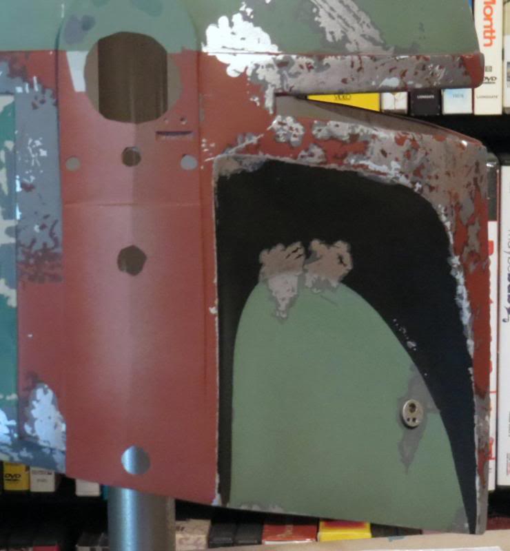

There are very fine traces of this color within the dent. Viewed in direct light, the color is
slightly evident, but not fully realized.
Change the angle, and those fine lines and scratches come into view.
