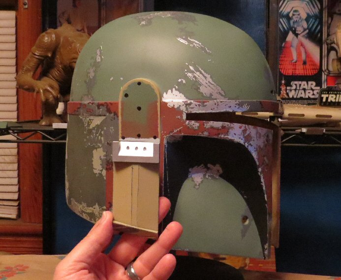

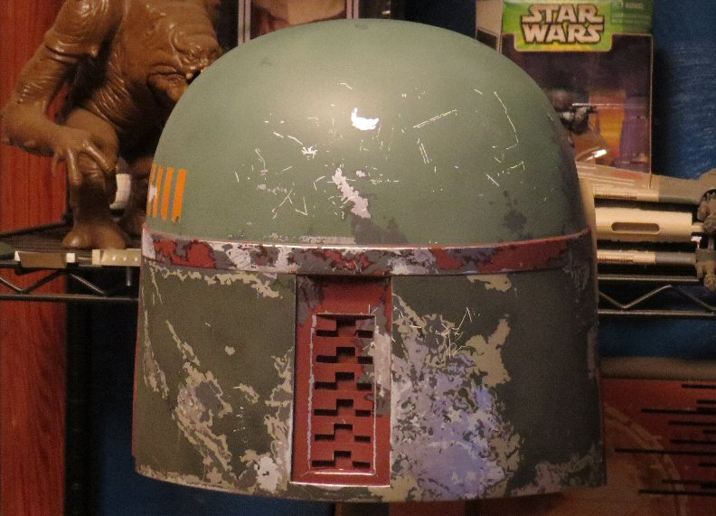

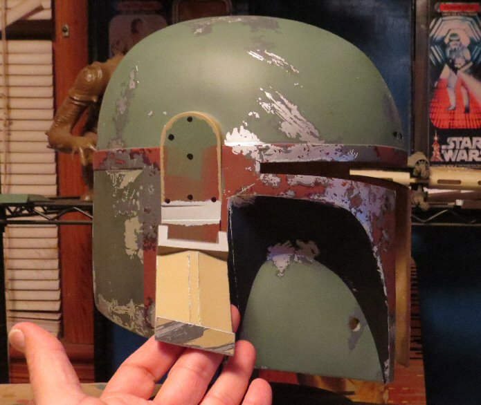

Got the left mandible done yesterday but it got too late to post the pics. This one has some good detail on it, but it's
nothing compared to the crazy right mandible!
Again, the screen used version doesn't have all the damage seen in the exhibit pics. I always think the pics at this stage look
kinda funny. . . Fett only has half a face!

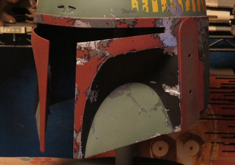

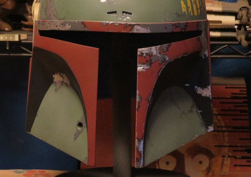

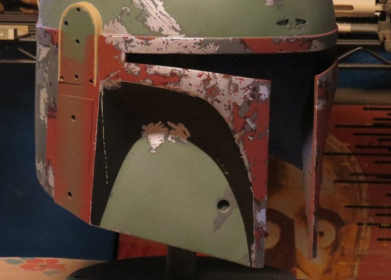

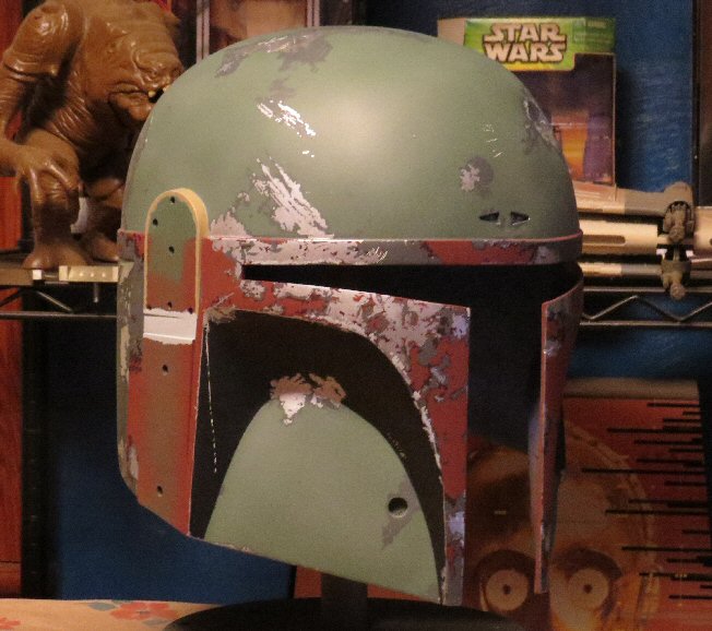

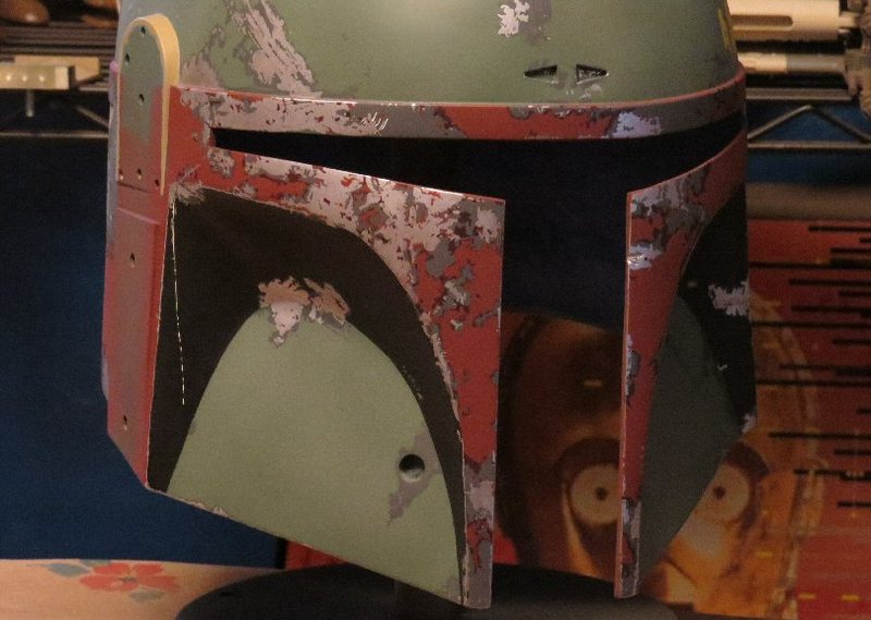

The right mandible is done! :thumbsup: Whew. . . this is always a killer. So many little intricate details.
I did this area over a few sessions the last couple of days.
Not only did I finish the mandible, but this also completes all of the "basic" paint application on the entire helmet!
I still have the detailing to do on the ears, and the effects painting on the helmet. So we're getting there. :)
Here's another angle.
Effects will be underway soon!

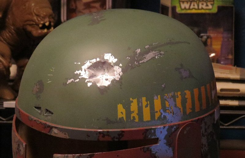

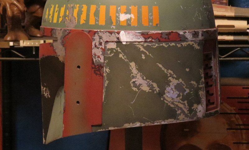

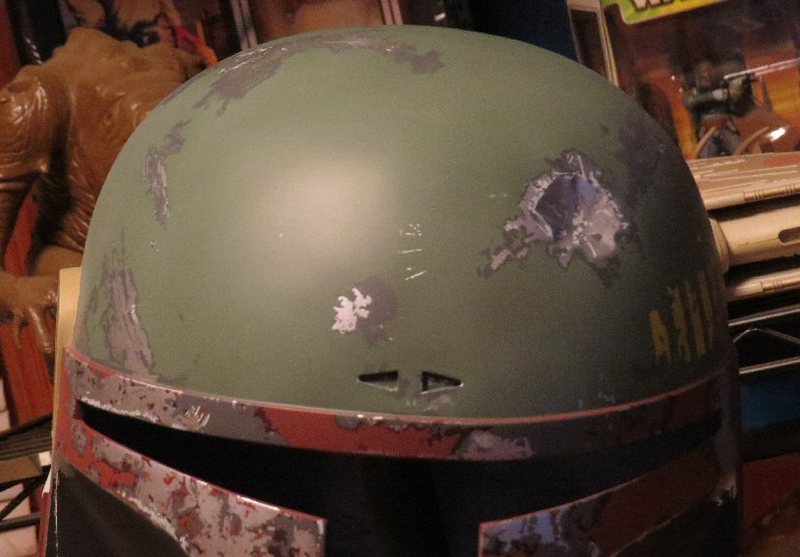

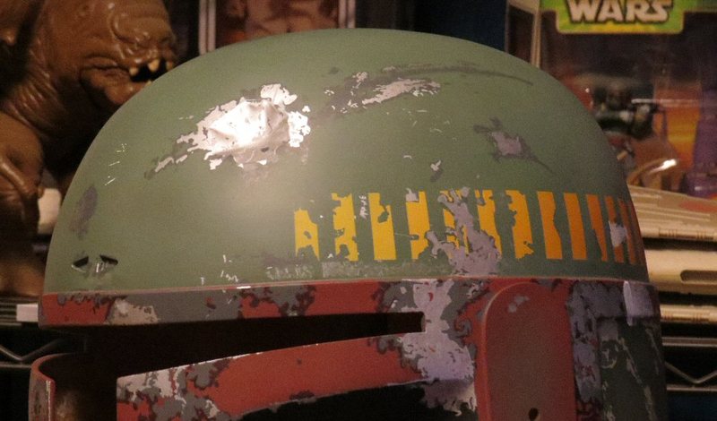

Got a couple of the effects completed. I added the pale contrasting gray that's scattered all around the helmet. There's a bit more concentrated
in certain areas, like the right rear panel, down the curve of the right mandible, and in the dent. Here are a couple of shots.
In the above shot I have also blocked in the pale gray in the open area between the upper and lower RF ear pieces.
Here's the dent.
I also did the white thumbprints. I always think this feature seems like a "whoops!" kind of thing, but they are visible in screen shots. :)
Next up I'll be adding the fade under the killstripes. Then I'll start detailing the ears.

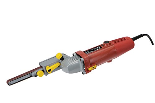

You might enjoy this tool for the grunt work, prior to the final clean up. Adjustable angle on the belt and gets into those hard to reach areas nicely. There are lots of brands out there and even air powered ones, but this was one of the times I felt a Chicago electric/ Harbor Freight tools, cheap tool was the way to go. But I am getting a larger version in Mikita after one of the guys on astromech showed us how useful it was. This one is called a 1/2" band file belt sander.

Skyfire, that might be worth looking into! Appreciate the info. :thumbsup:

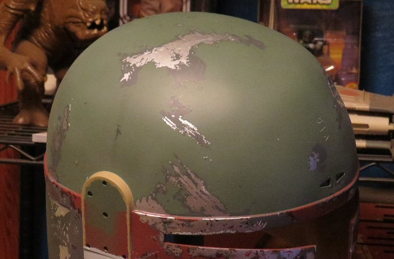

Still working on some effects and ear details. First I did the "stain" on the right side of the dome. This is a subtle vertical smudgey looking stain
that has a couple of darker spots. I add this by drybrushing with some Polly Scale Tarnished Black. It's a bit more apparent by eye, but still pretty faint.
I also added the fade below the killstripes. I use an acrylic silver mixed with the dome weathering shade and apply it with a fine brush.
Here, it's not very apparent.
But when the light catches it at certain angles, it's readily visible.
