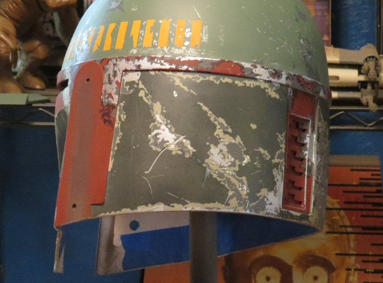

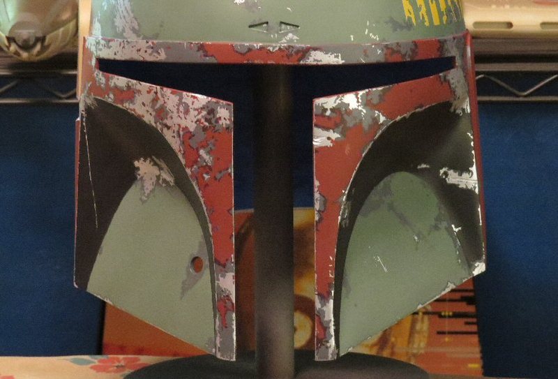

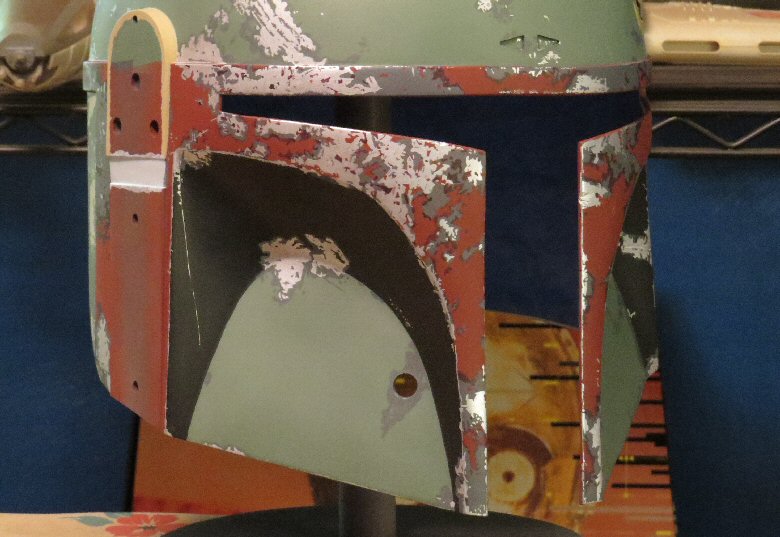

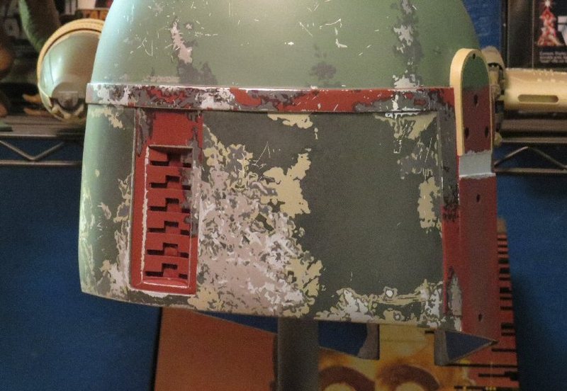

Been busy the past few days, but I managed to finally finish the left mandible. This is an area that requires careful
examination of the reference pics vs screen caps to determine what is "incidental" damage that happened after filming.
Just the weathering pass remains on this part of the helmet. Here are another couple of angles.
So this leaves the right mandible as the only section left that needs the "basic" painting. But it's really complicated and I think
I'll just not do it. Think anyone will notice? :lol:

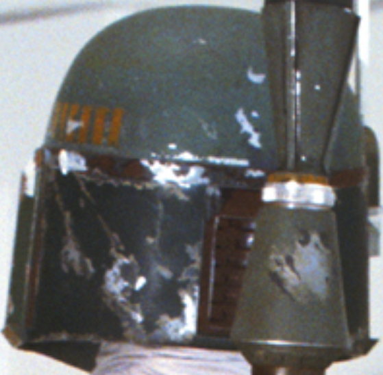

Oh, those are what I call the "grease stains" because. . . that's what they look like. :lol:
They're pretty evident in the MoM and AoSW exhibit pics, but the helmet of course had suffered all kinds of incidental
damage since ESB, and it's extremely hard to determine whether those stains were present during filming. I like them
and think they add some grungy character to the helmet, so I tend to incorporate them into my paint-ups.
Here's a screen cap--not the clearest, eh?
Are the stains there? Is it pixelation? Hard to say. But if you look above the last 4 or so killstripes, you can see
a sort of brownish horizontal stain. This is overspray from when the killstripes were painted on the helmet, and
that part of it is definitely part of the original paint job. The other stained areas have that same appearance in this
screen cap, so that is what makes me think they could have been there during filming.

I agree with you, that was the image I was looking at, and because of the location over the killstripes I thought it might be overspray, but then you have the discoloration that wraps around the back of the dome, beyond the kill stripes. Those are the ones that I don't see a "logical" explanation for. Did Joe Johnston do a little dry brushing with some orangy yellow for some breakup/dirt/grime/grease in those areas? I've just seen them done pretty "loud" on some lids and toned down or non-existant on others.

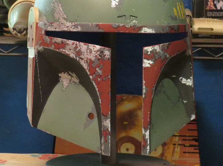

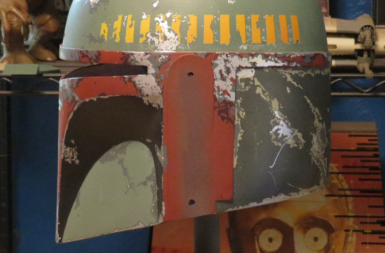

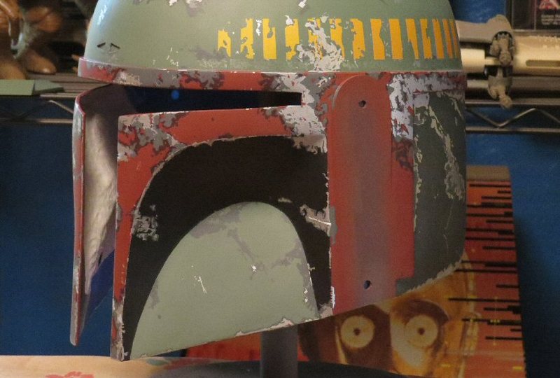

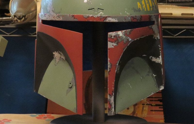

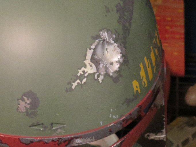

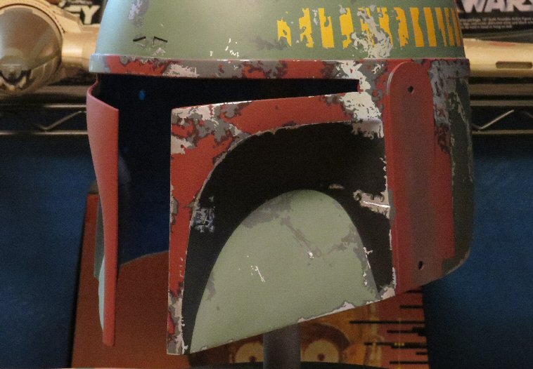

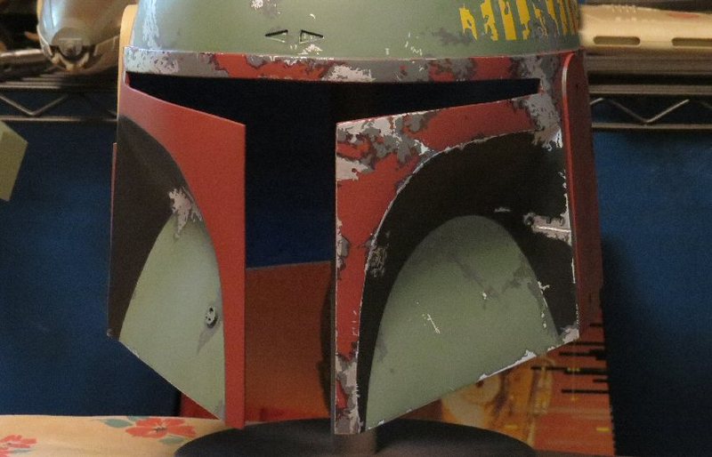

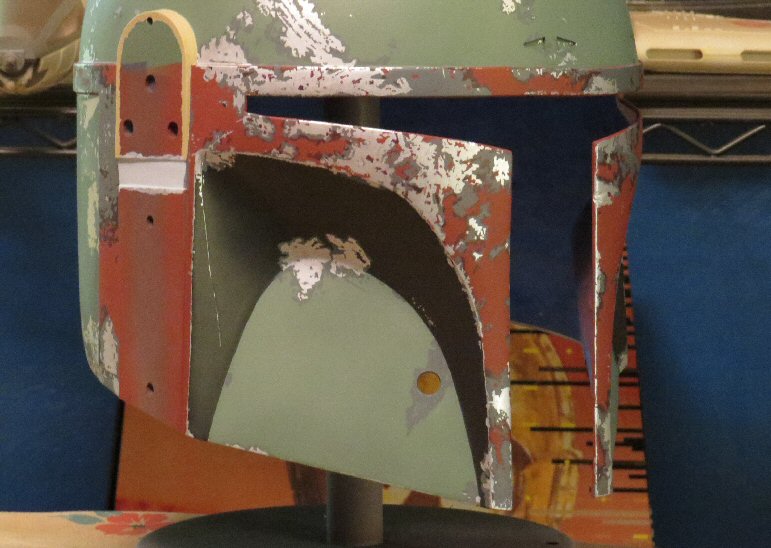

Been working on the right mandible the past few days in short sessions. Finally got it done a little while ago. :)
This is one of the most detail-heavy areas on the ESB bucket, and it takes several passes with each of the colors
to build up the tiny chips and dings.
Here's a shot of the entire "face" region.
A couple of other things to note in these pics--I Dremeled out the cast in Borden in preparation for installing the machined metal
replica. I use a bullet shaped grinding bit to slowly widen the hole, checking carefully to make sure the metal part will just slip
through the hole. Once I've weathered the Borden, I'll fix it in place at the very end of the project. I also did the big scratch on the
right cheek, and the small red chip on the left mandible.
I can now begin the "effects" painting which consists of the pale contrasting gray, the fade below the killstripes, some pastel weathering, some small
detailing with colored pencils, and the spatter. I have already base coated the ear parts and I'm giving them a few days to really cure before I mask for
the black and white arches. Getting pretty close now!

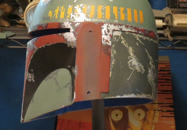

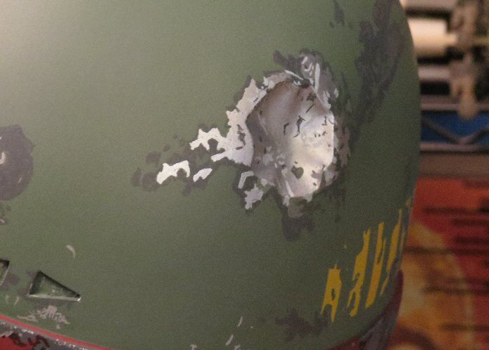

Part one of effects painting--pale contrasting gray.
This is scattered over several portions of the helmet. Most noticeable on the right rear panel and in the dent, but there's
a bit on the left rear panel, the keyslot area, the red band above the keyslots, on the right mandible, the "brow" above
the visor opening, and even a couple of flecks in the cat scratch.
Here are a couple of overall shots.
It's more subtle in certain areas. The dent is tricky to photograph due to reflections, so here are two different angles.
Next up will be the fade under the killstripes.
