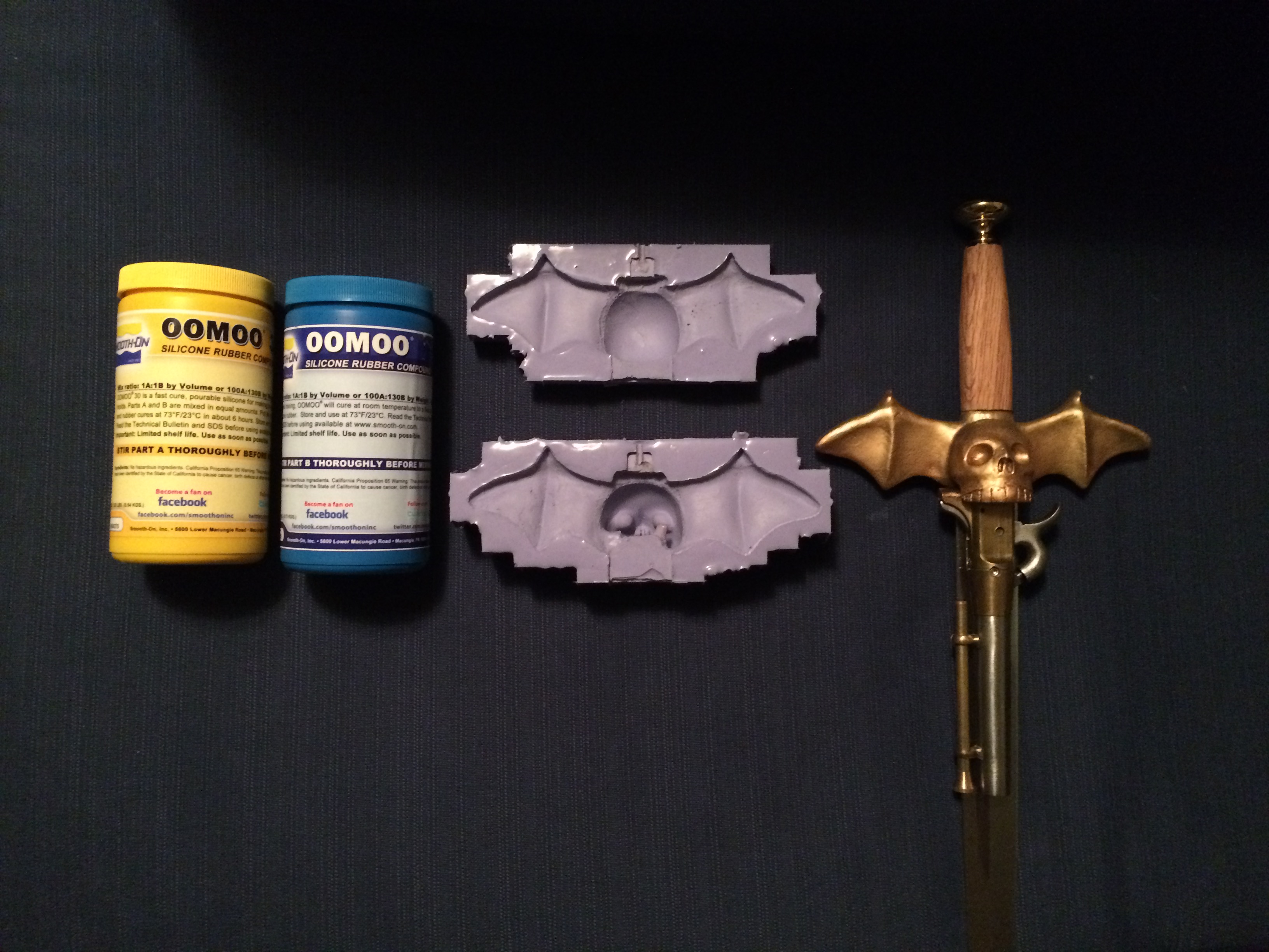

Mold release will definitely help; I've used this one with Smooth on (https://www.amazon.com/gp/product/B0013IZSDM) and it works pretty well. They also make a couple of different set-time mixtures (but that may only be for the plastic used in casting from your mold), and using one of the longer ones allows a bit of stirring onto your master to help fill all the small details and remove bubbles. The most success I've had making the mold is with using Legos to frame a pool and suspending the master over the top, then filling the pool up and over the edge of the master, trimming it out after the silicone dries/hardens. Here's a pic of that, maybe that will help make sense of the description:
