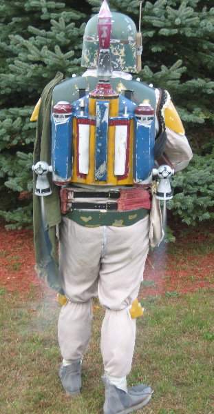

Here is a shot of my :moon and my :jet pack in action. The sun washes the smoke out little, but this is the best picture I could get.

Zeever Fett
looks cool, but is there a way to make it look more spread out, right now it looks like it is coming out of a small tube instead of a funnelled thruster ;)
Gator Fett
I have tried a couple of different things to get the smoke to look more spread out, but I could not get it to look any better than in the picture above. :facepalm The problems could lie with the gas (CO2) that I am using, or perhaps with my piping arrangement. :confused
