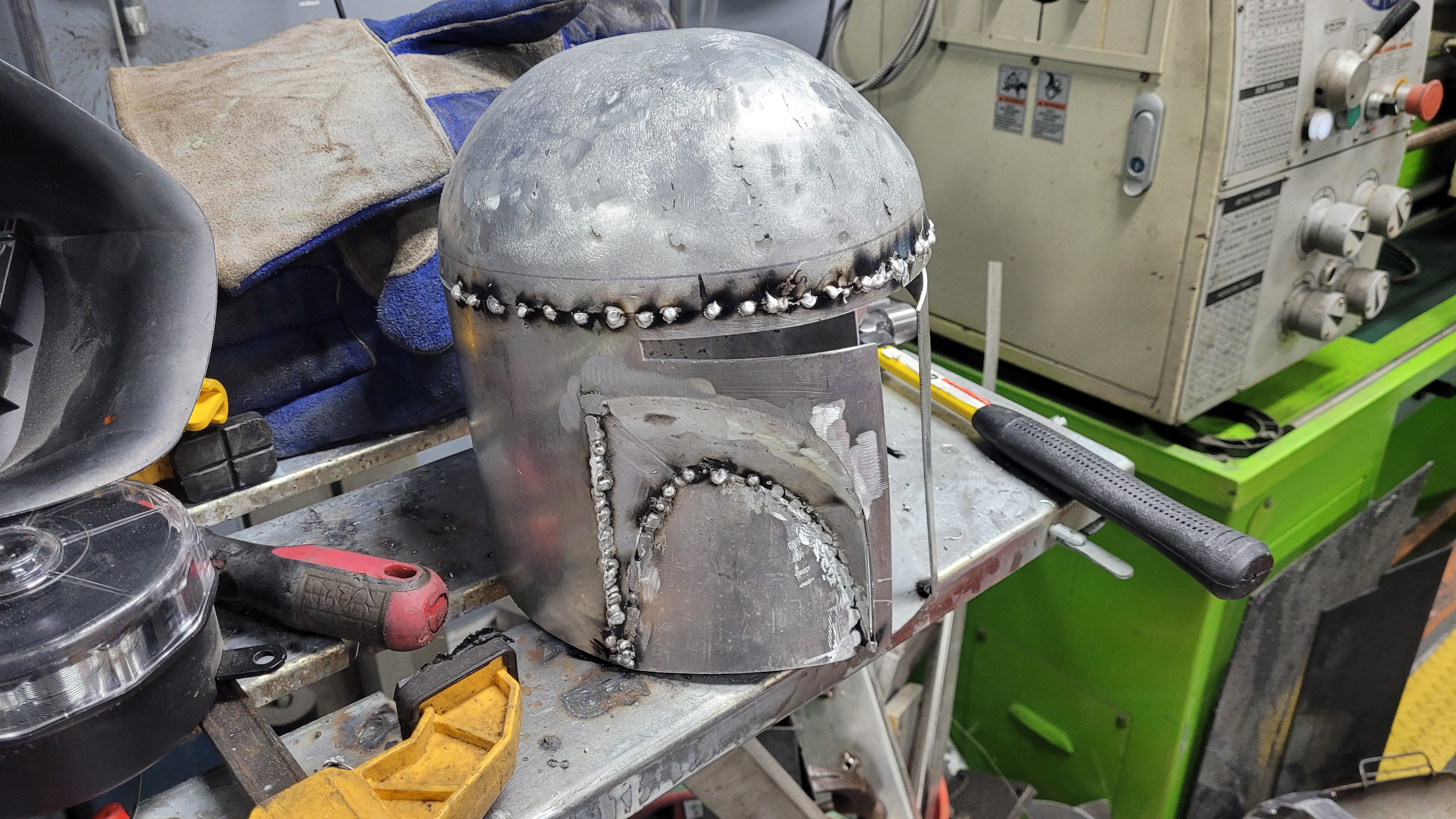

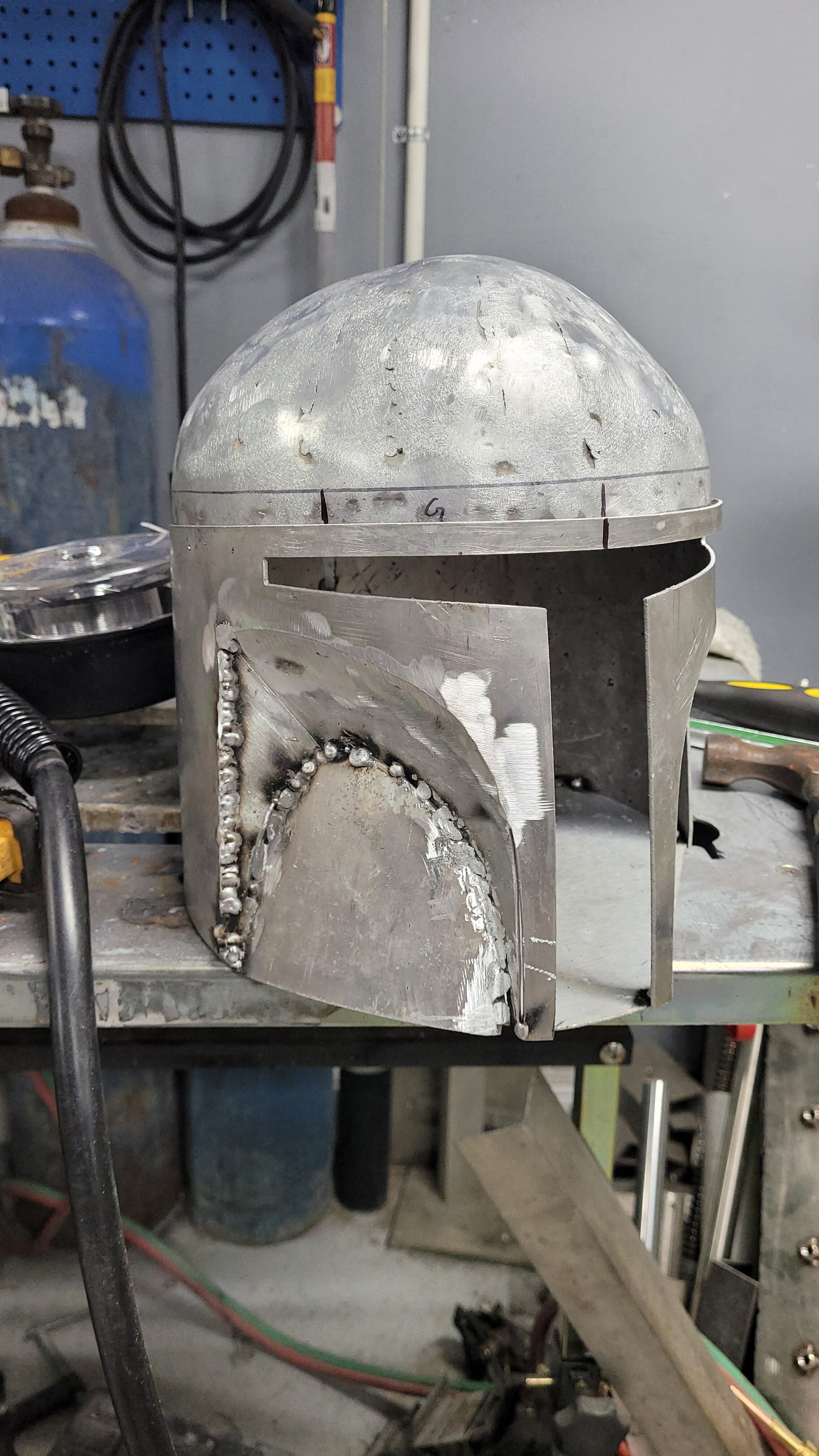

So I just got back to the project. I decided to begin working on the helmet. I still haven't been able to dial in the welder just right with this 14 G aluminum. So I slaved all day on this thing and realized my scaling was off. It didn't scale all peices evenly. So I think. I need yalls opinion....is this fett helmet too tall? To me it looks more like Djinn's helmet not Fett's. I'm ready to scrap it.

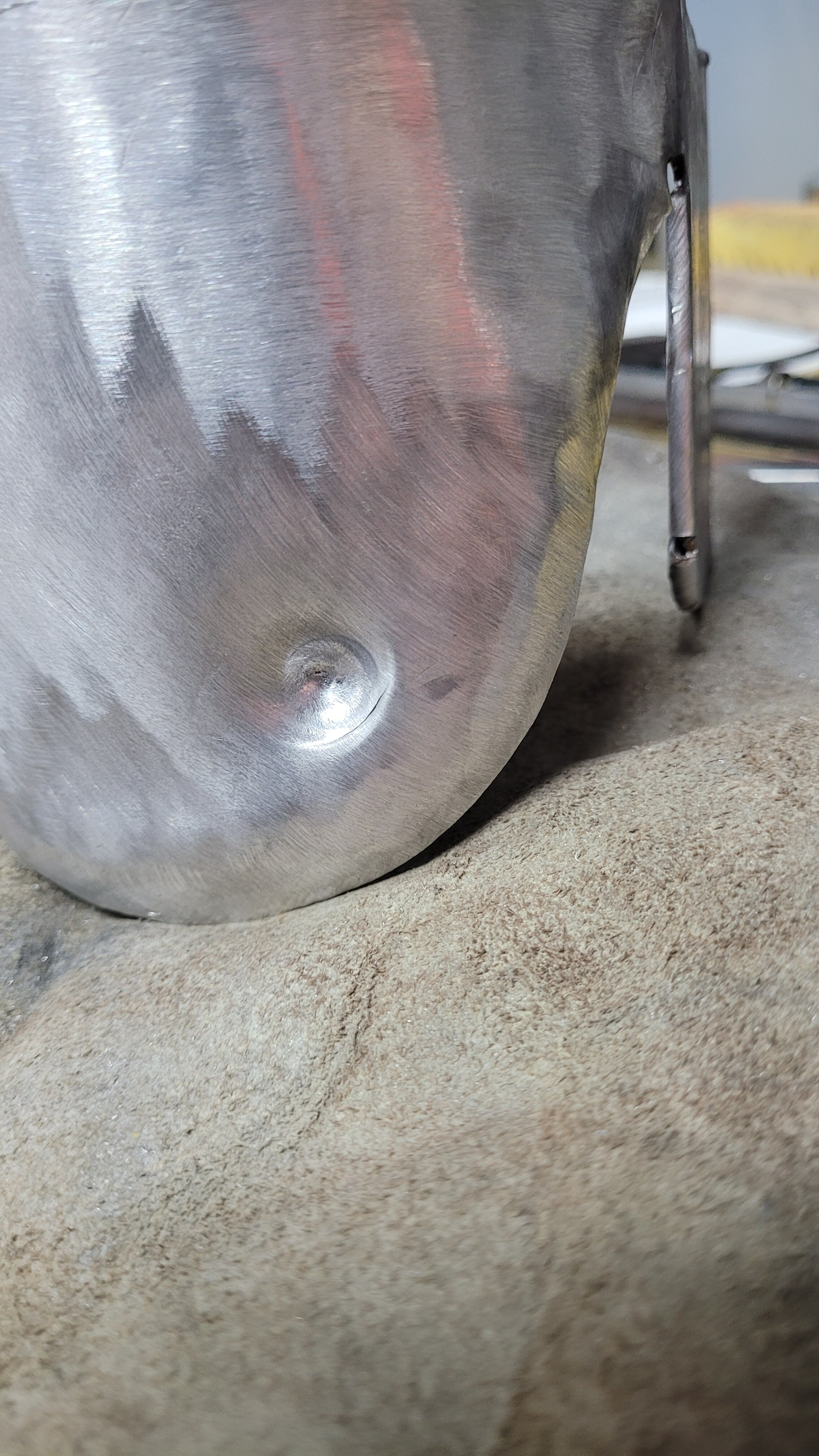

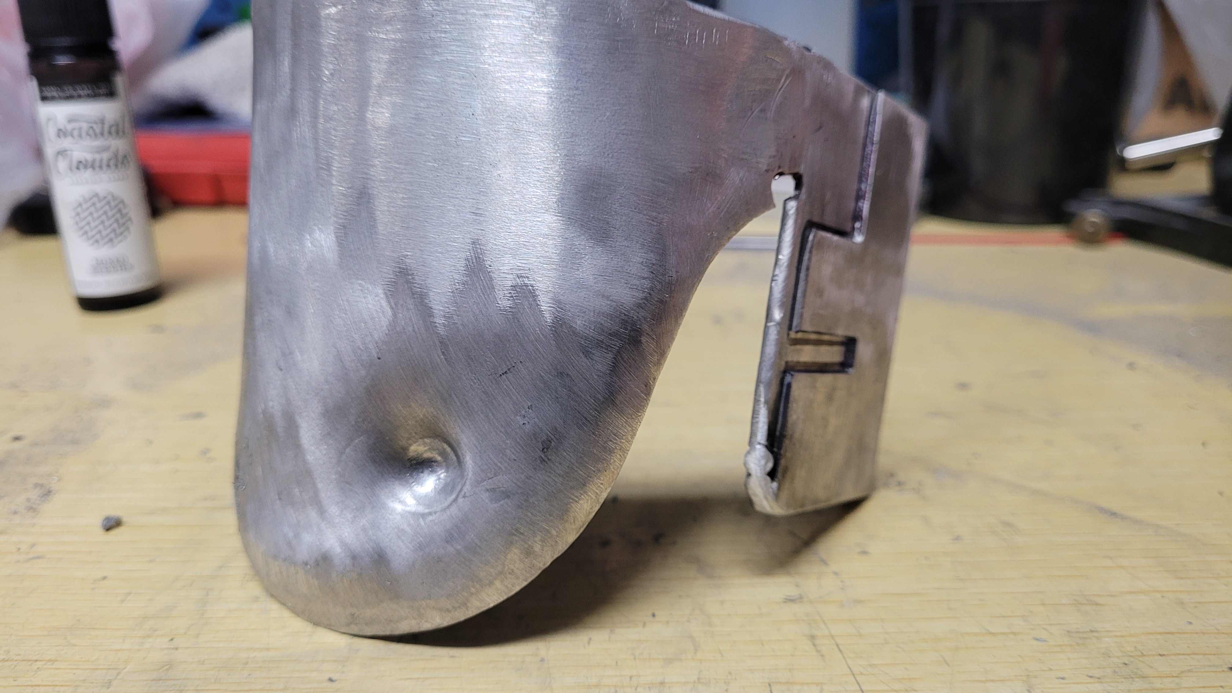

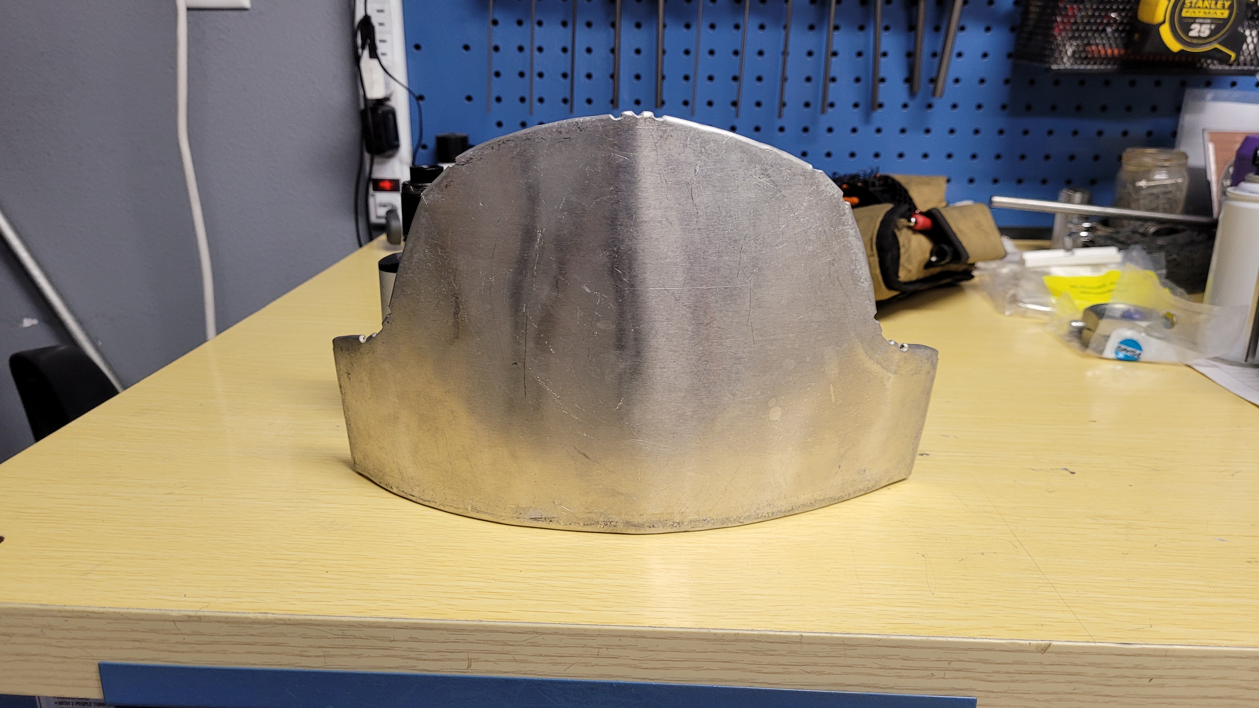

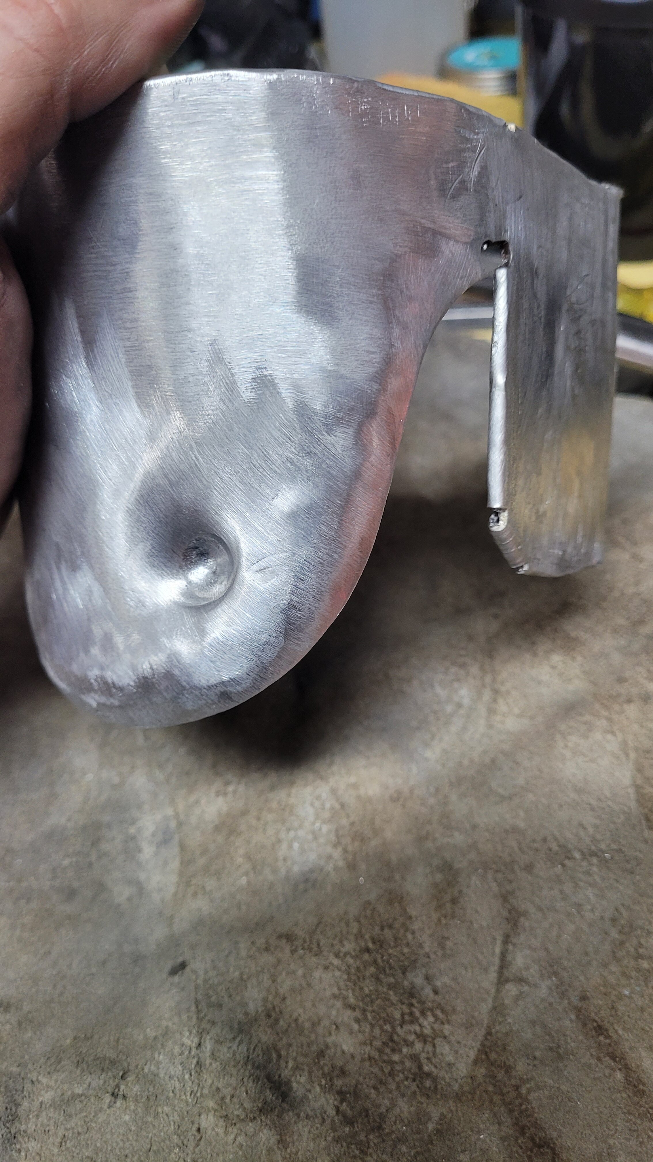

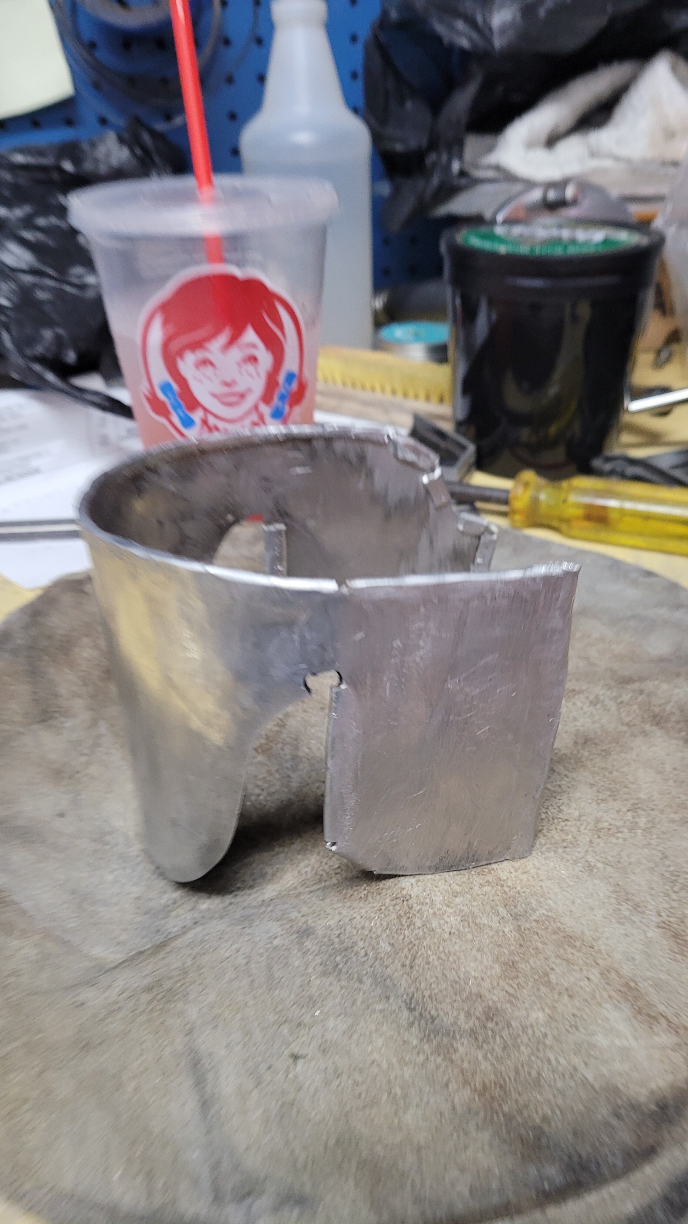

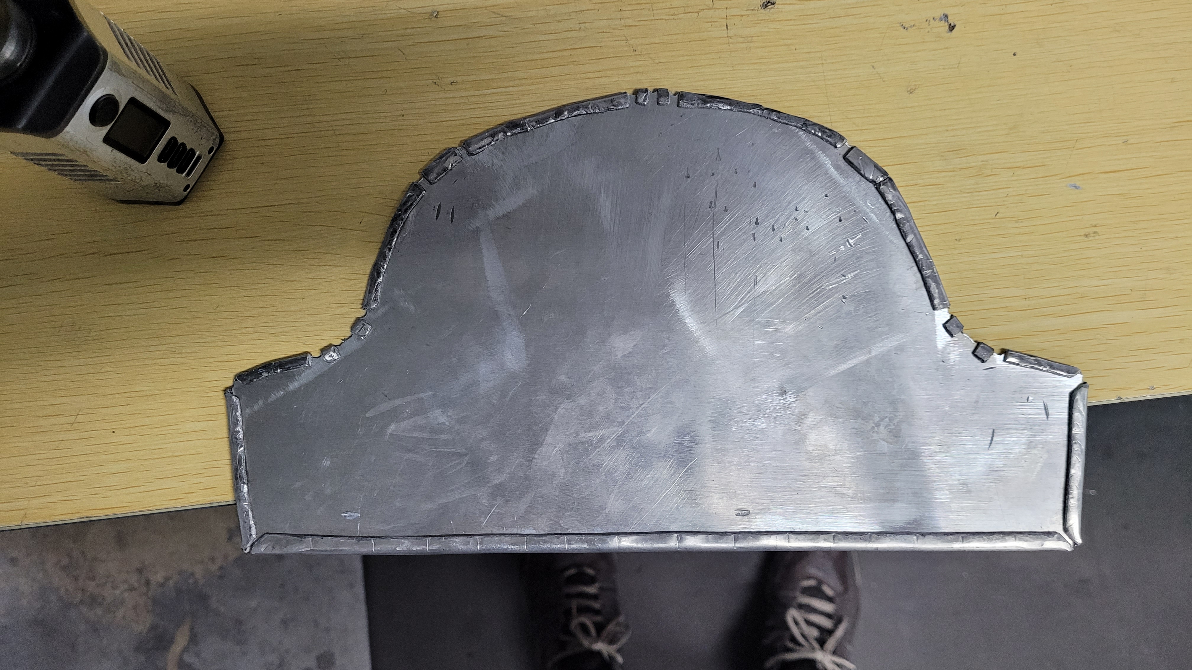

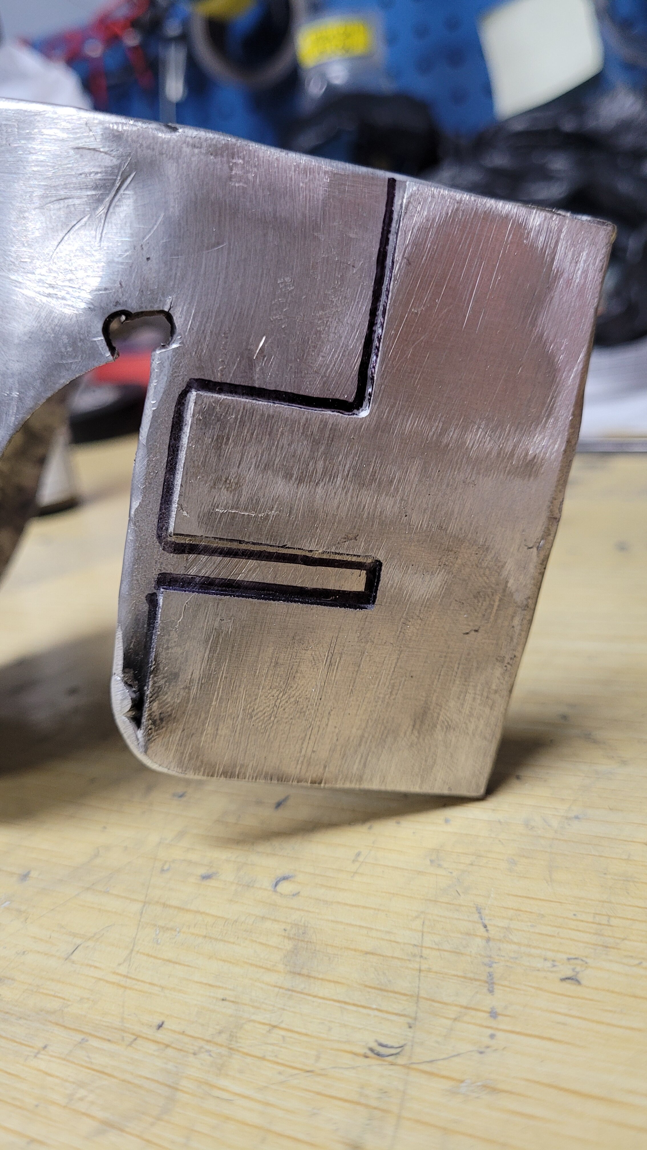

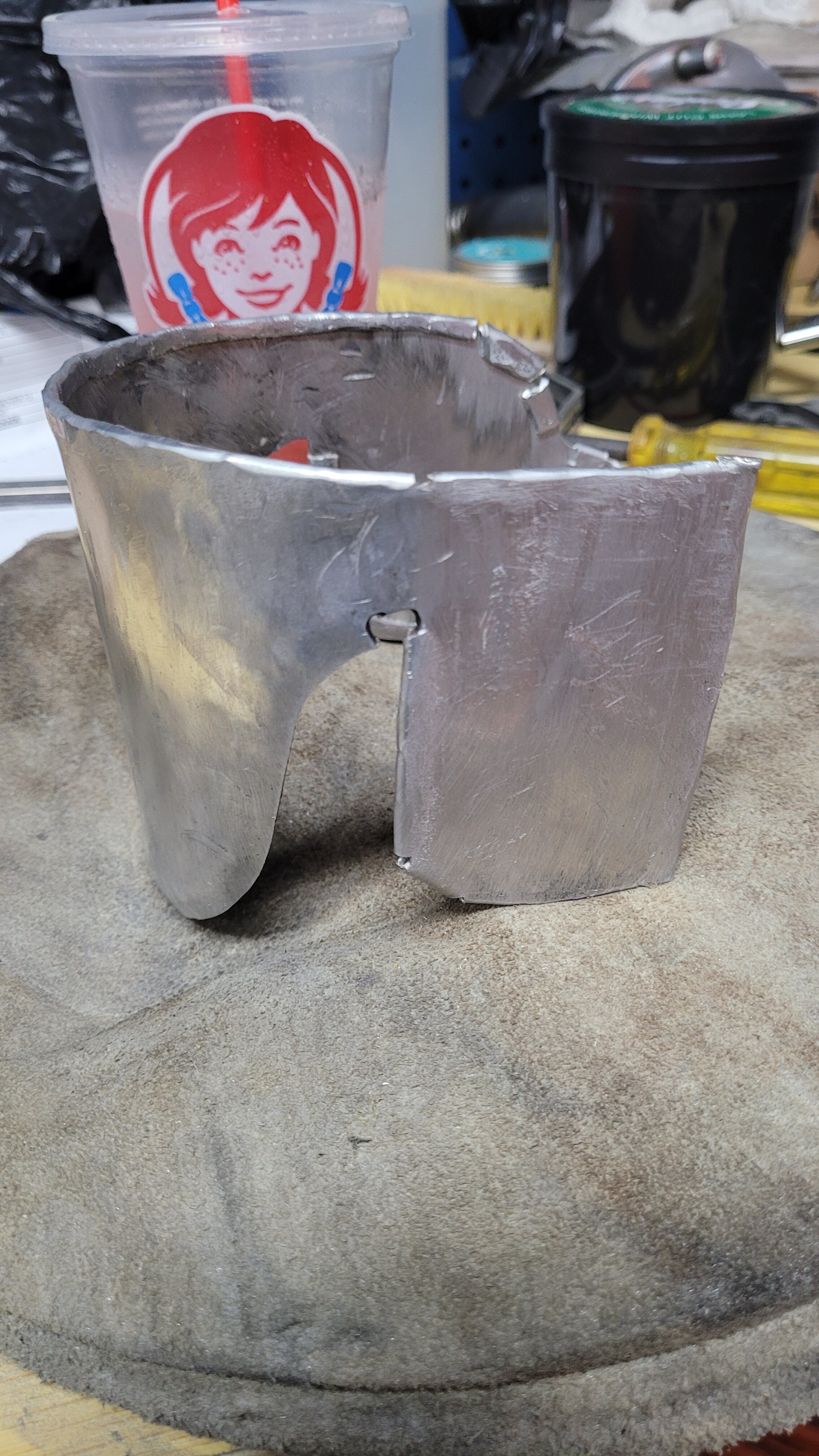

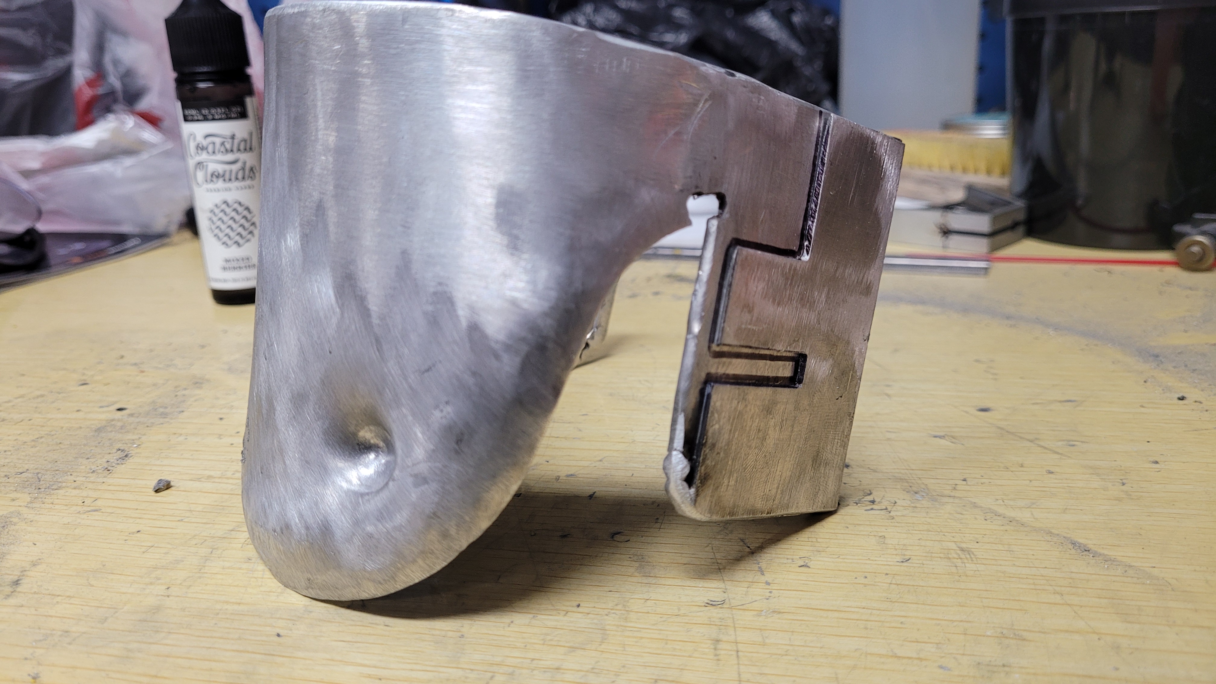

After the last frustration of building a helmet that was scaled incorrectly, this weekend I decided to recut everything along with some armor pieces that I hadn't yet cut out. Here are some photos of the right knee I created today. It needs some minor adjustment and welding of the seams not to mention the F and knee rocket ports. For the dent I used a 5/8 aluminum rod machined to a round tip and hammered into a die block AFTER I shaped the knee. I then went back in a made some readjustments with the hammer to restraighten my previous shaping.
Edit: Added F before calling it quits.

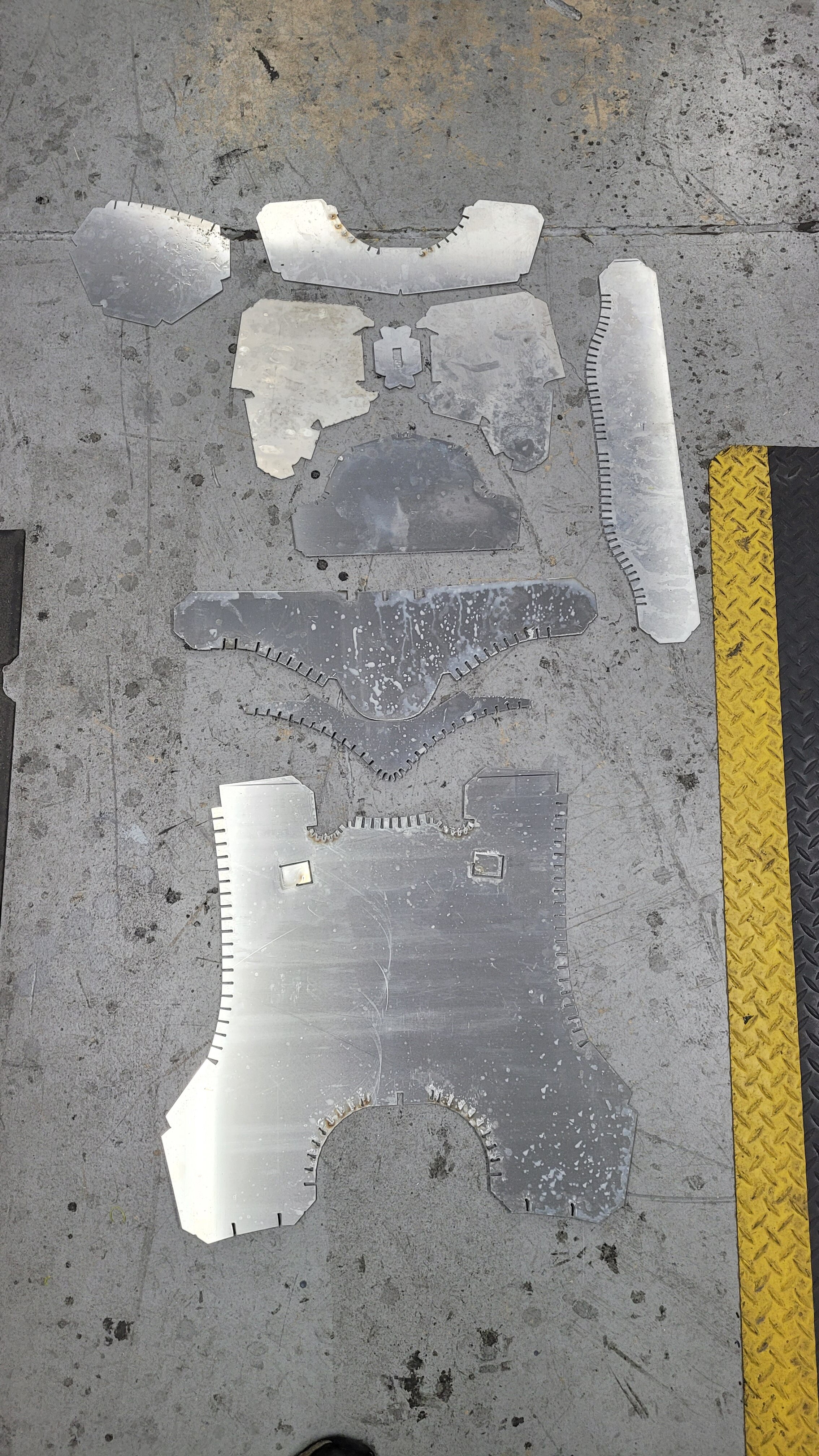

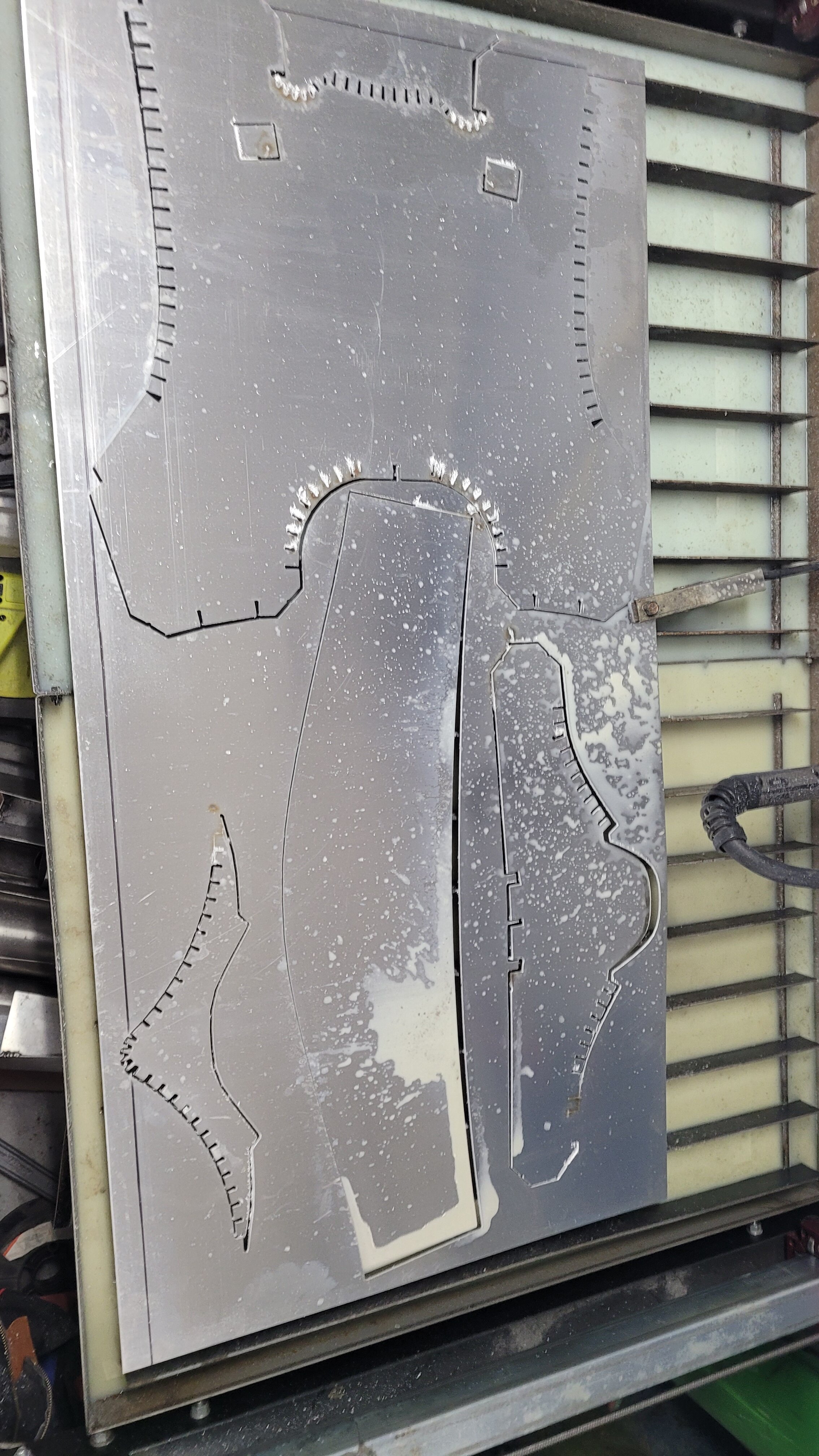

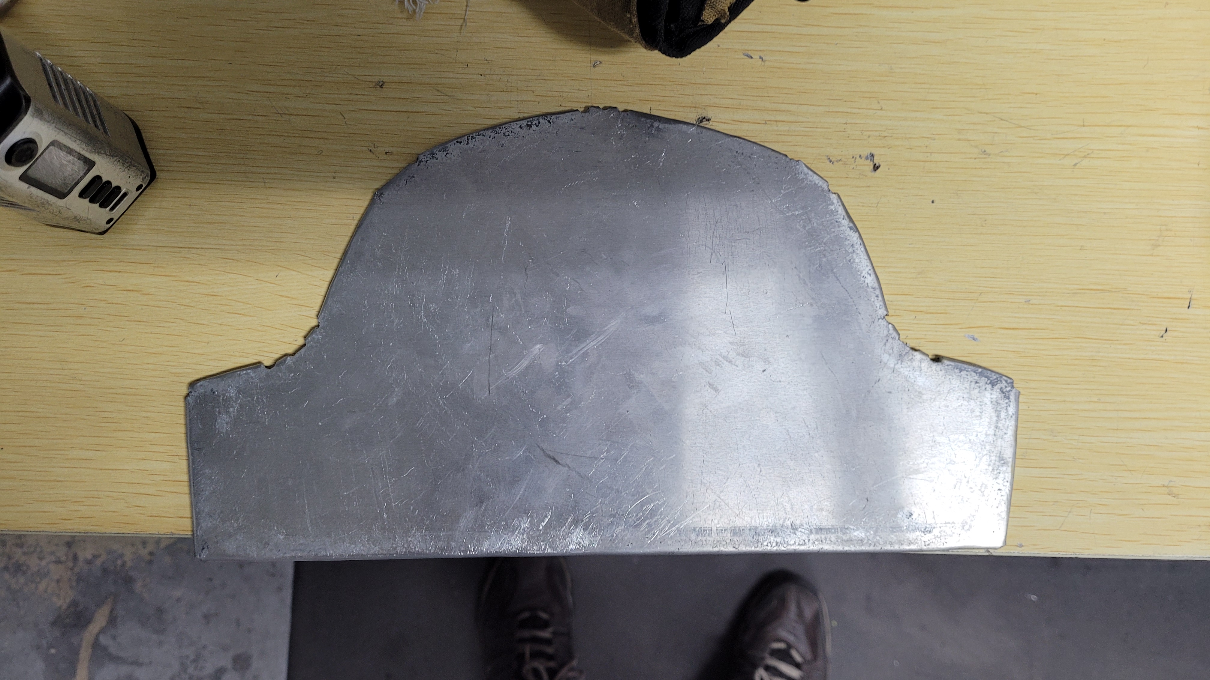

Hello all! I've finally got the plasma cutter doing wonders and cut out many pieces today! Take a look!
The abdomen panel has too hard of a crease in the middle but I can reshape that better. I had to drop what I was doing to go pick up one of my daughters so, next time!
