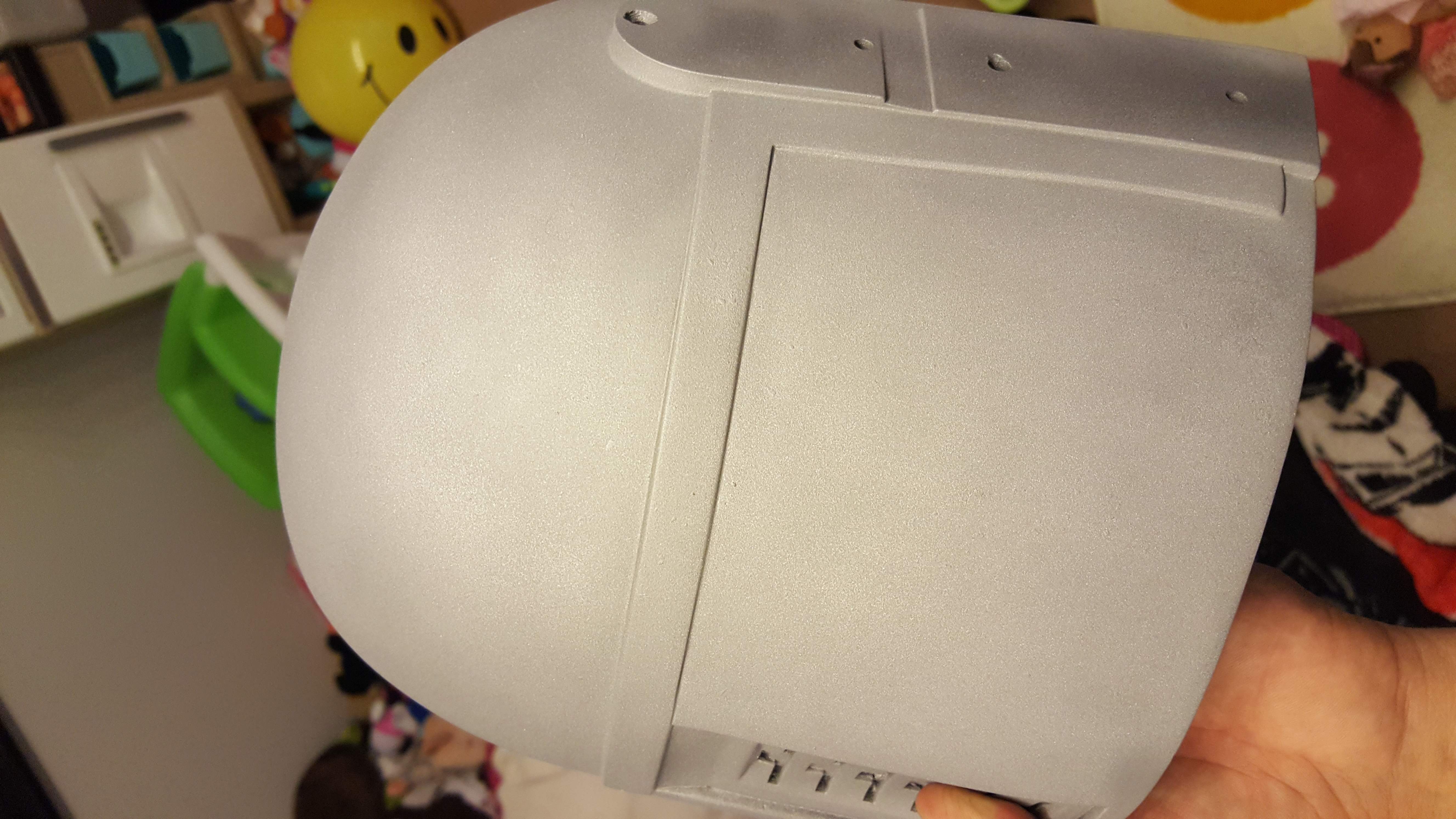

Hey guys quick question. I put the layers of Humbrol silver 11 down and it seems kind of matte to me. Am I suppose to wet sand with steel wool or something to bring out a little shine or is that how it is suppose to be? I duno but I feel like in your guys pics the silver layer looks more reflective and foil like. Thanks in advance.

It's pretty normal, it's not too realistic of a metallic paint, which is good because the original prop's isn't too good either.
It's why cold cast helmets often look a little weird, because their metallics are too shiney and real.
Only the real metal parts like the borden and ears should have a realistic metal shine to em. Rest just that sorta dull slightly-reflective aluminum look that Silver 11 gives.
That said if it's coming out super dull, could be a thinning or humidity issue making your layers come out a little grainy. Micro textures like that will naturally create a more matted appearance. If that is the case you can try steel wolling it a little to smooth it out and re-layering. But I wouldn't fret to much about it, as said, it's supposed to be a weak effect, and yeah, any un-masked clear coat will kill it completely anyway.

If that pic is accurate to how it looks in person, then ya... that's pretty darn flat.
My batch which I bought about 6 months ago is a pretty crap metallic, but it still at least gives a dull aluminum look.. Yours looks almost stoneish.
I guess see if the steel wooling/recoating helps any, if not, then yeah, might be worth considering a mix or alternative if you want some better accuracy.

Damn, was afraid of this but glad I asked. Thanks. And yeah i think stonish is the perfect word for this.
