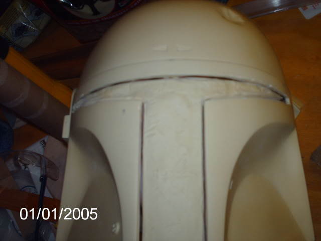

In this pic i cut out the visor, and held it up in the hole, just holding it where it was once attached.

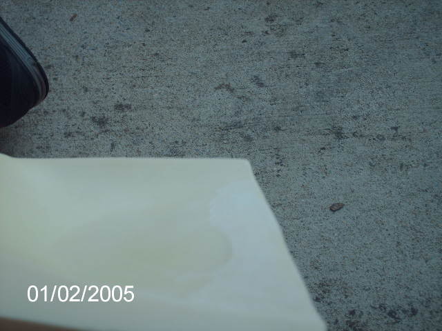

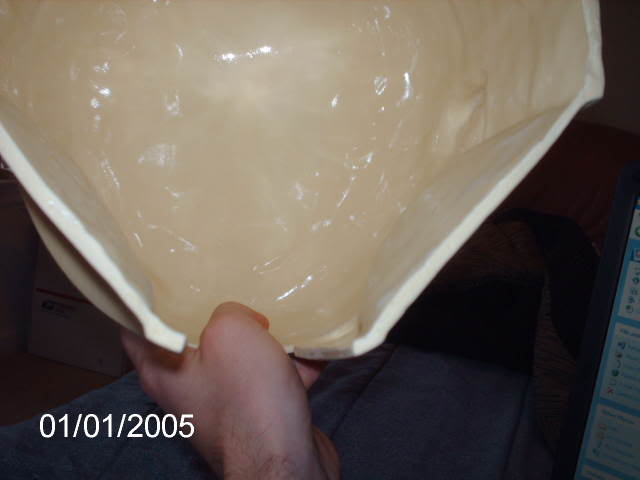

In the next pic you may (or may not) be able to make out the raised bumps on the lower cheeks along the bottom edge. While not horrible, the more I looked at them the more they bothered me.

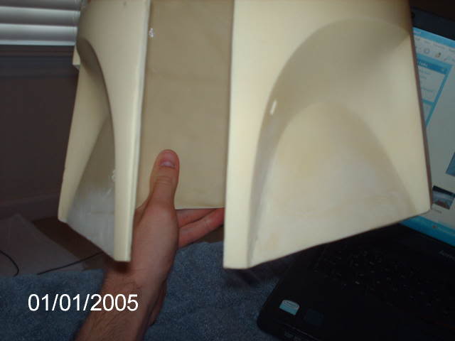

Another left cheek angle.
Here's the right cheek.

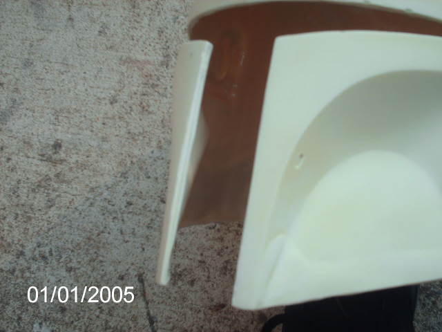

Here's the left cheek after sanding with the dremel.
Now, in this shot, you can see how much better it looked once I sanded it by hand with a high grit piece of sandpaper. Notice the absence of that bump on the mandible shown in an earlier pic. (Ignore the right cheek; I had to go back and do more work on that side.)

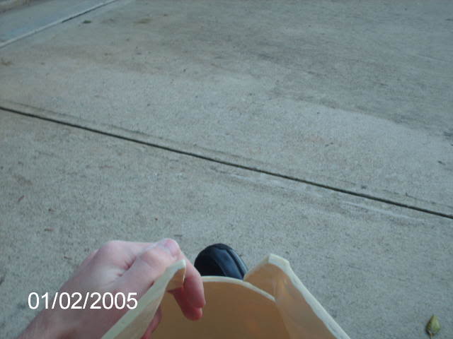

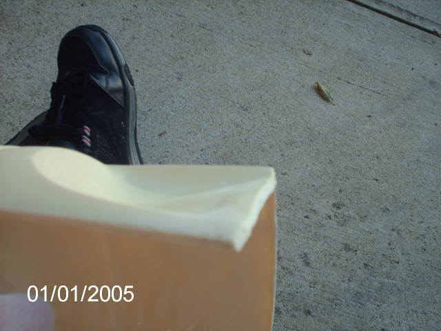

The bottom tip of the mandibles weren't perfectly symmetrical either. Before:
After (not a good pic, I know, but it DOES look better):

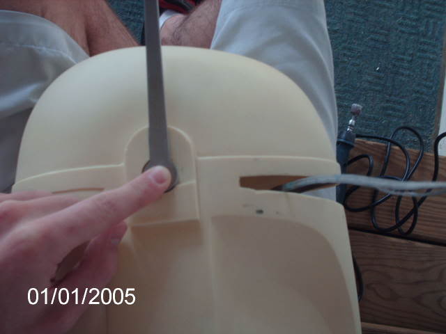

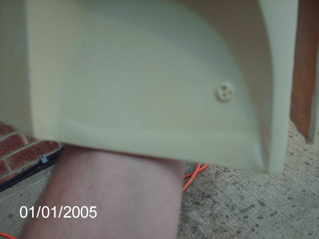

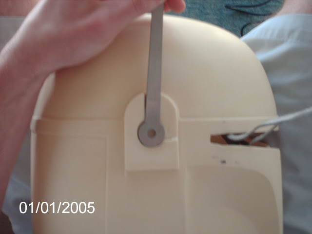

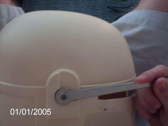

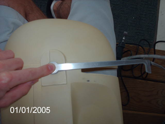

In these next two pics, I was unhappy with where the RF stalk would sit in place. I wanted to insure that when it was up, it was completely vertical. And when down, absolutely horizontal and parallel with the top line of the t-visor.
Now, after some sanding. Much better.

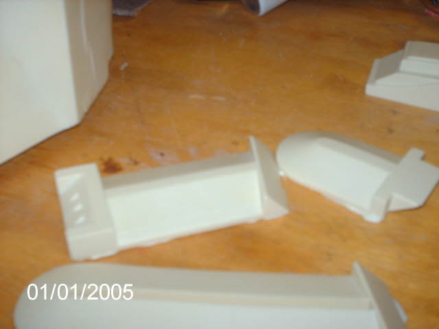

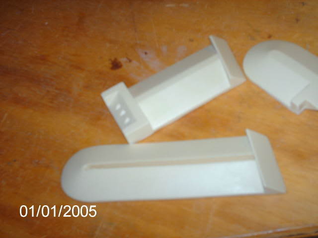

And now the ear pieces. Just a tiny bit of sanding needed.

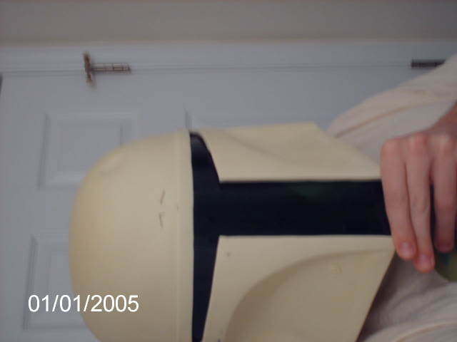

Finally, once all that was done, I taped in the visor just as a temporary placeholder to see how it looked when I wore the helmet. Not bad.

One more thing tho, I completely KILLED the left and right corners of the T hole where the visor sits in. That was the first thing I ever cut with a dremel, so I didn't do too great of a job.
You can't see from the pics, but it is actually very sloppy. I'll try to get some pics of them later.
Does anybody have any good suggestions on how to go about fixing them up nice and neat, using some kind of filler or something?
plumber's epoxy putty!
you can find it at your favorite hardware megastore. at home depot they have it in 2 places. the adhesives section has a nicely packaged, small, overpriced version. the plumbing supplies aisle has a larger tube for about the same $$, but no carded blister pack to throw away.
you cut a little off, mix it together (it's a white layer wrapped around a dark grey core. mix until it's all 1 color)
you can then shape it however you need to. it cures to steel-hard in about 5 minutes, so only mix a little. once it's cured you can sand and file it.
it bonds to just about anything, and it's easily workable. i find it way easier to use for stuff like that then bondo.

Wow, thanks man. That stuff sounds perfect!
