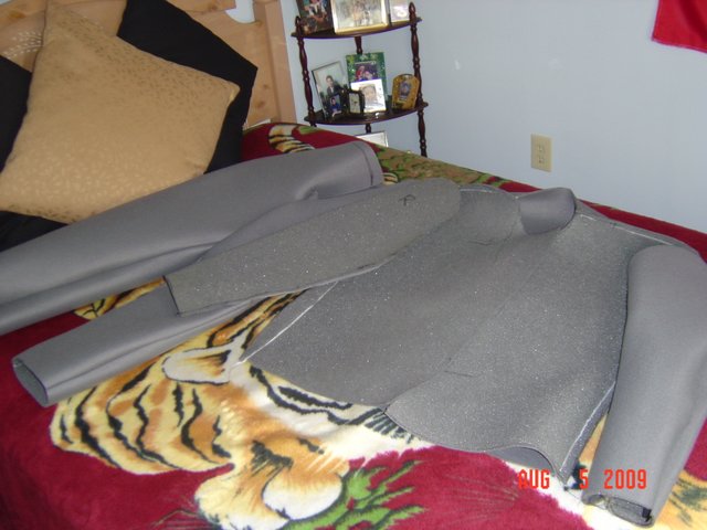

QUICK UPDATE: (SUIT TEASER PICS)
Progress being slow, but better to take it slow and precise than fast and sloppy. Here's just a TEASER pic of the suit itself, almost finished stage. Pants are basically done, and I still have to make the neck and attach the sleeves to the jacket, plus the crease details along the front and back.

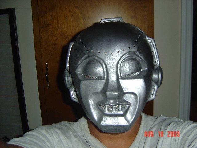

HELMET/MASK......90% DONE !!!!!!
Sorry, I've being really busy rushing with this project, that I've decided to complete ALL the hard parts first, to then finish the soft parts, which they're almost done.

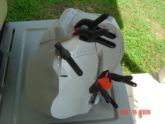

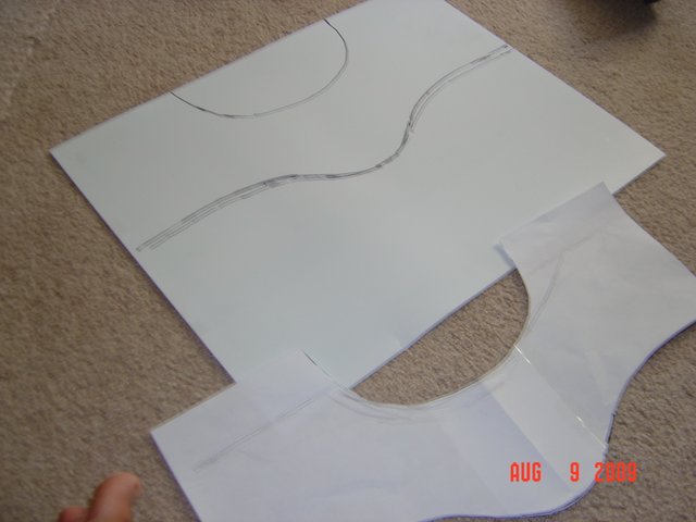

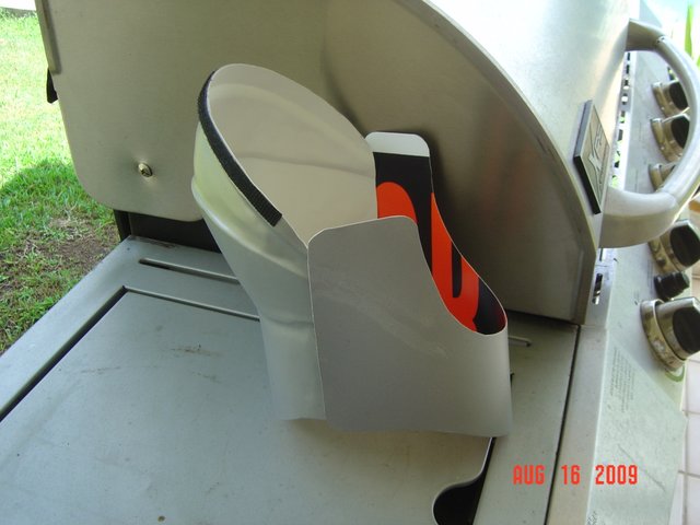

Started cutting to shape the piece that goes in front of the neck (will be barely visible once dressed up)...
Added velcro on the opposite side to add to the back of the neck...

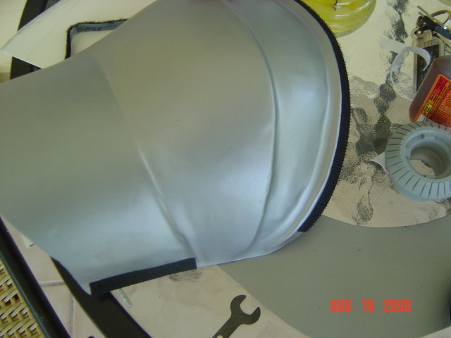

Painted, cut, sanded, and added the negative velcro, that will be in touch with BOTH the back-top section and the front neck piece.
Way the neck and back pieces would look like, before the whole mask.

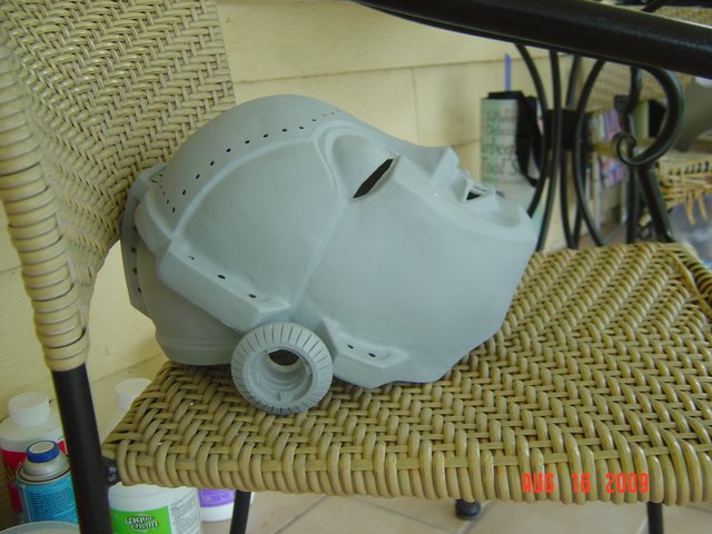

I've had to add small pieces of sign plastic in order to attach the "ears", due that I failed to add those in the original sculpt design when doing either the front mask (preferred), and the top-back part assembly.
After figuring out what's the best way to attach the "ears", I've found that the best way is just to add a "layer" of material (whatever it could be), as long it could "grab and hold" any kind of material.
Here's a pic of the "ears" aleady attached with "GORILLA GLUE", to then make holes to be able to hear with the helmet on.

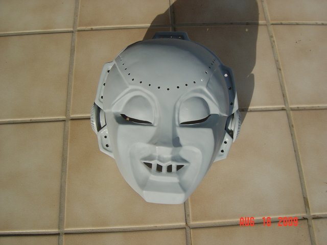

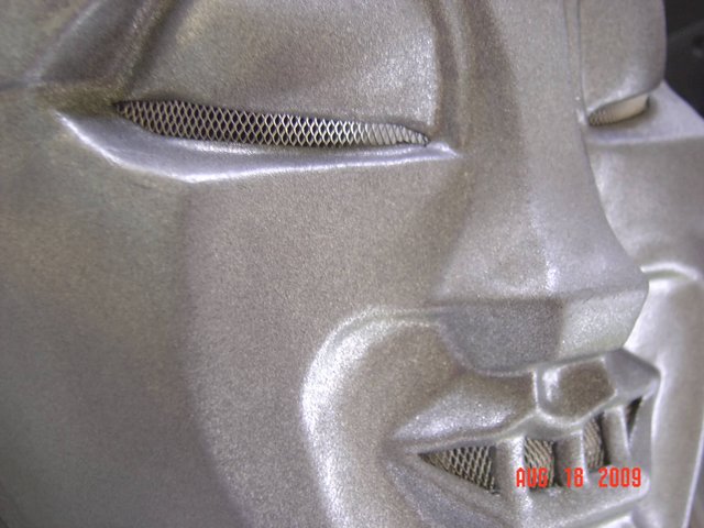

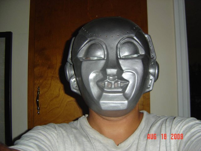

Well, mask ready to be painted and detailed...

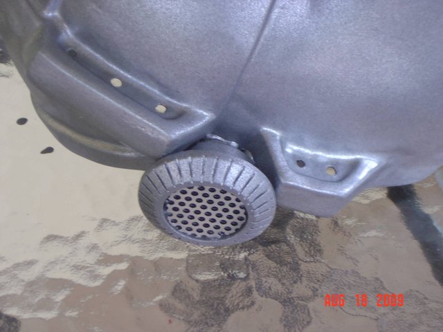

Installation of the "EAR FILTER".

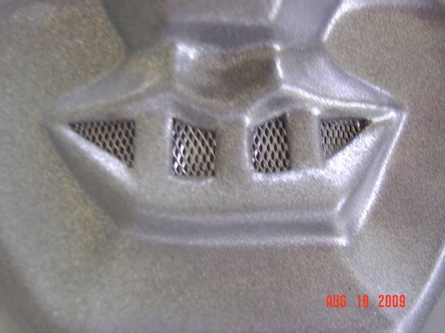

Mouth mesh installed....
Now notice that in the original video, some sort of reflective material (plastic, mirrowed) was placed in the eye sections.....but since we're in the south, I've decided that THE ONLY item outside the oriignal used on screen, is to replace the "mirrowed lens" with small aluminum mesh material, which won't let you see inside but a lot to see from the INSIDE....plus, the mouth mesh is close to the accurate one used in their videos and CD cover...

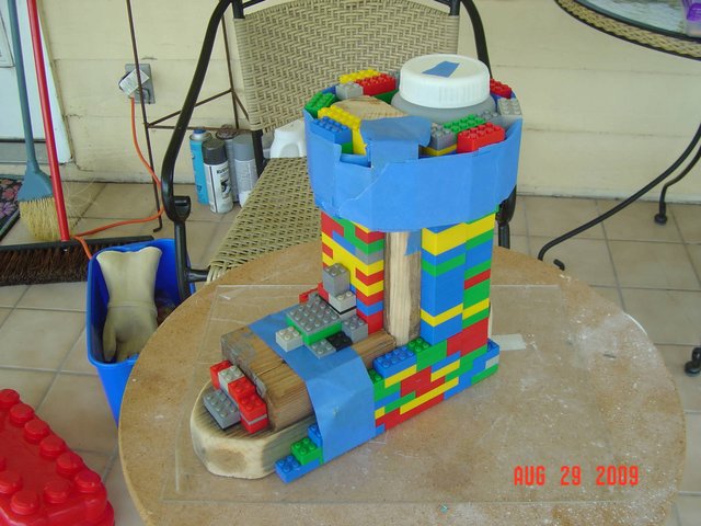

Less than a week left before Dragon*Con, and I'm STILL working my butt off. I've being working this weekend in the hardest part of the whole process....another sculpture and mold creation. This time I'm referring to the BOOTS, which I've never had to start.

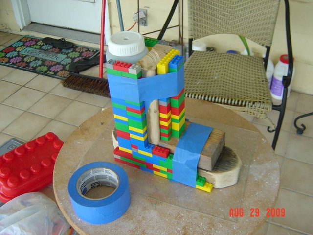

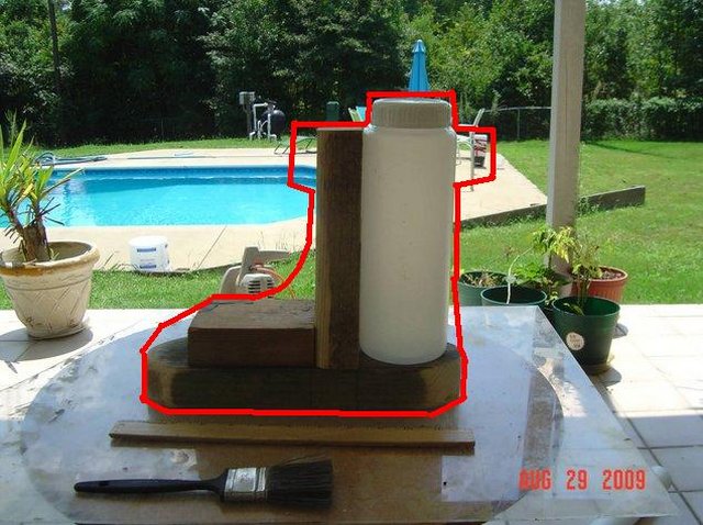

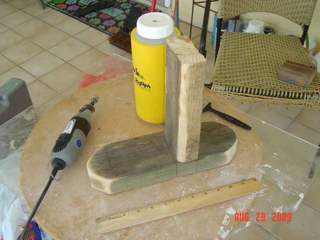

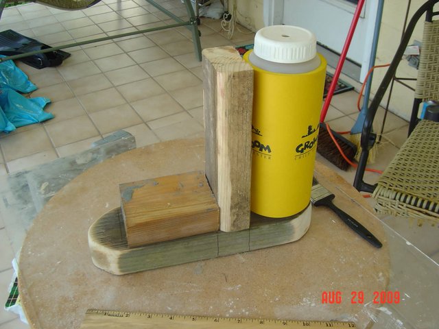

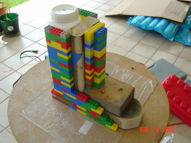

First, I've started with some items to use as a skeleton for the boot, and I used some wood (cut to size), a drinking bottle (minus the foam layer; I took it out after the first two pics were taken), PLENTY of LEGOS, and clay. Reason of the "skeleton" is just to save on clay, plus to have a strong support for the clay.
I've nailed and hammered in place the horizontal and small wood pieces, so they don't come out or loose while sculpting or grabbing the piece. ( PLEASE NOTE, THERE'S BARELY ANY REFERENCE PICS OR INFO ABOUT THIS PARTICULAR ITEM, SO I'M DOING THE BEST I CAN....PLUS SOME EXTRA DETAILING). ;)
Showing how the pieces fit all together before applying the clay-and-LEGO "skin"
Now, this outline is showing the way the boot SHOULD LOOK LIKE once it's finished. The top part (cover of the water bottle) is meant to be the input/output of the latex rubber where the liquid is meant to be poured and extracted from,
Best way to hold things when they fall while sculpting.....PAINTER'S TAPE. I've use it just to hold the LEGOS in place while assembling the whole boot sculpture,
Now, your best friend while making molds, (or frames)...LEGOS! I've grabbed LEGOS and assembled TWO WALLS side-by-side, so they could measure the same and I could use at both sides of the wood frame, to save on clay,
Now is a good time to apply more PAINTER'S TAPE, to prevent the "walls" of LEGOS to spread or fall,

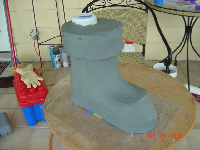

I've added more LEGOS to the "neck" of the boot area, plus in other areas, specially the front, to make it as round as possible,
The basic "skin" is already applied and shaped in its most basic; still need more clay to cover those hollow areas and do some more work to make it more round in shape,
This is the way I've ended the day, and I'm taking the liberty to make this one. If you take a close look (basically, a personal touch of design).....the front of the boot it lightly resembles Mr. ROBOTO'S "face";. Notice the "smiley face" in the front of the boot. I've thought about doing it while sculpting the piece, and I came with the idea....which sounds good in a way; not to look too WEIRD for the costume, but rather to go along with the similar "architechture" of the mask design,
