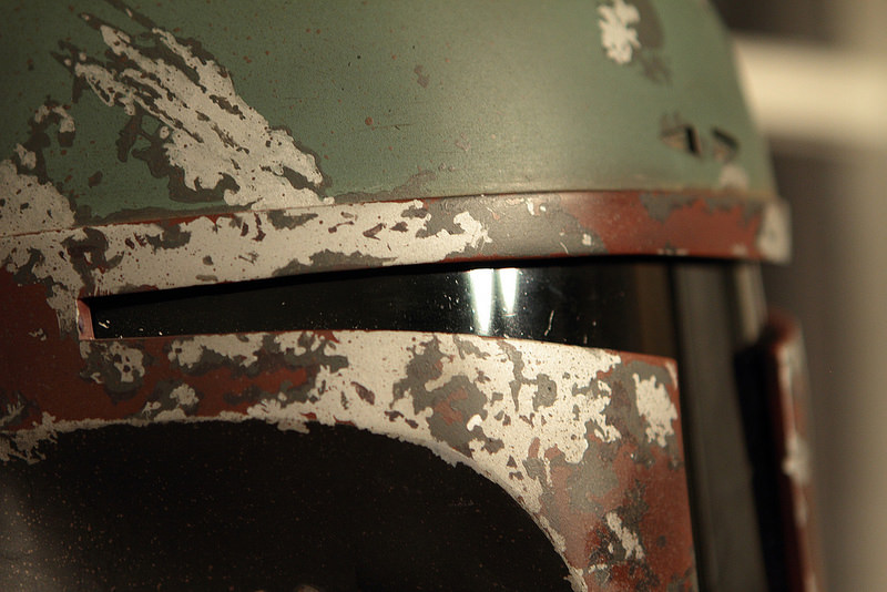

So, I kind of prefer the slightly teal appearance of the colors on the ESB Boba. It's different than most colors I've seen used.
I know the color bcurtis has on his helmet has some of this tone, which I understand to have been painted by Ponte but anyone have any idea what color might be a close match? Ponte isn't easy to get a hold of...
Ill tell you this... Ponte mixed his colors and didn't record ratios, or so he says. Ive never had the opportunity to put one of his next to one of my more recent helmets personally, BUT a few guys at C8 did put BCurtis's next to one of superjedis and as I remember it was very close in hue. And lighting and editing is going to play a role. You want to have the right relationships between the colors on the helmet. If it were me....Id do some color tests.
Oh I will. I'm going to do some searching around and testing. That's interesting though, thanks for the input!

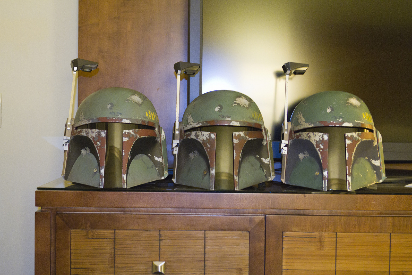

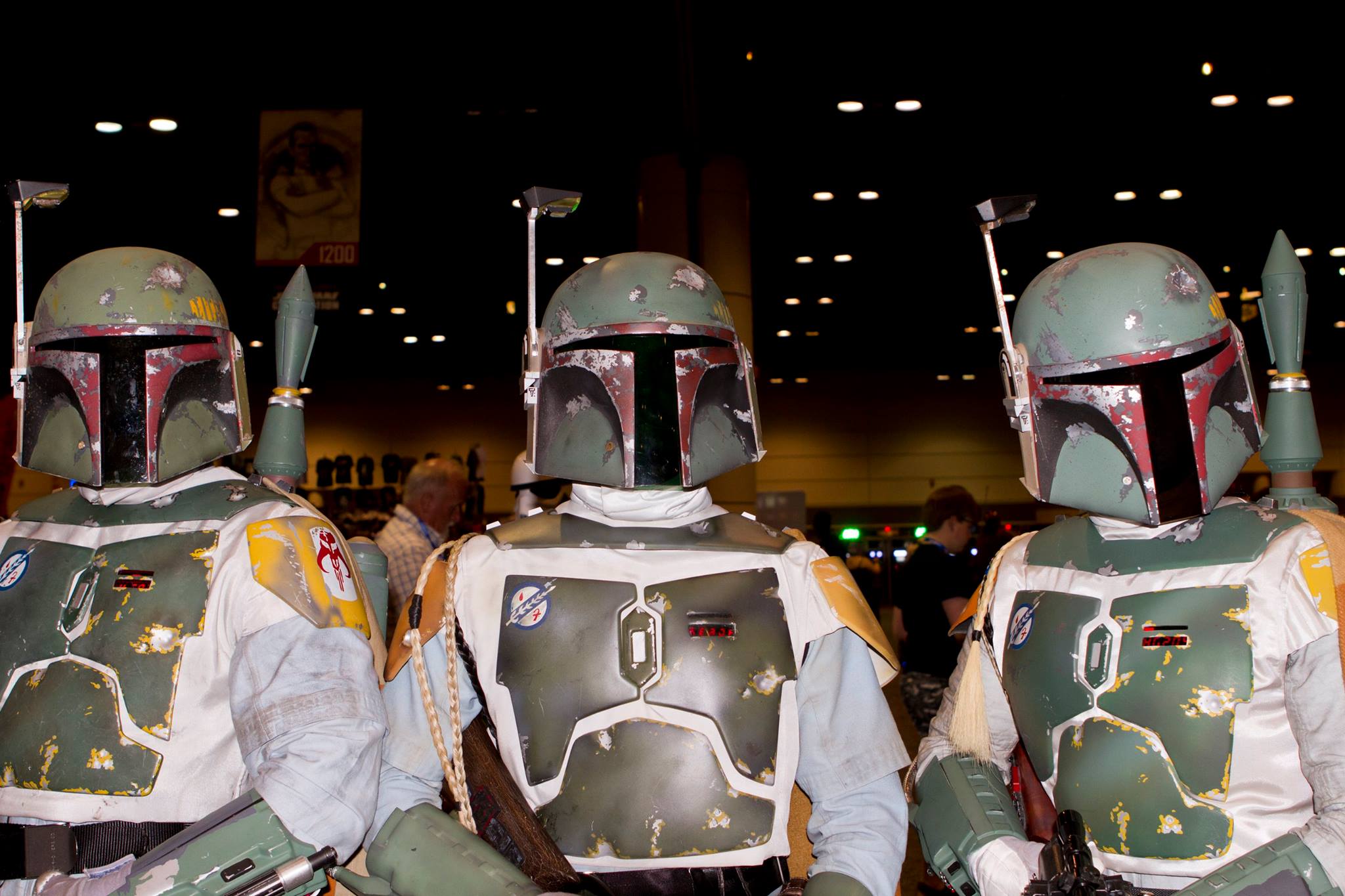

Dom is right, lighting plays a huge part in how these things translate to our eye, both on screen and in person. The studio photos of mine you posted were taken with incredibly bright lighting. My helmet doesn't look that teal in person. As for PW and SJ comparison, I have a pic we took at CVIII in our hotel room. It's not the greatest photo but you can see the subtle differences.
SJPW by Bryan Curtis, on Flickr
(above photo) SJ on left, PW in the middle, and I can't remember on the right. Dom is that one of yours? Alejandro's perhaps?

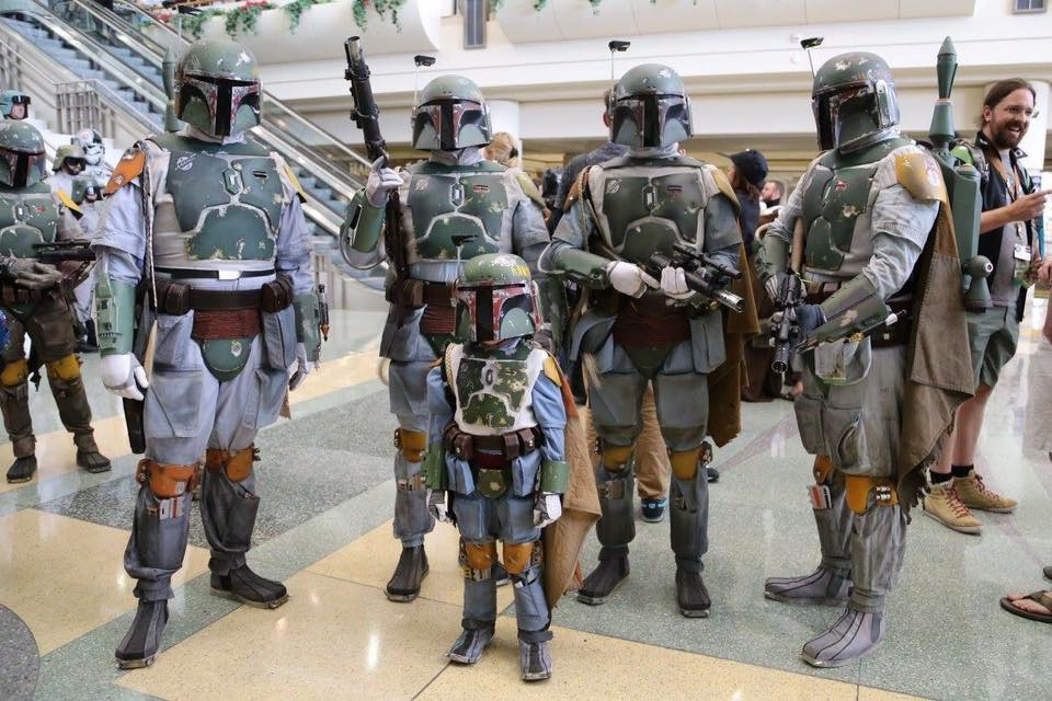

Here's two at CVIII of Wasted Fett, me, and Fandango Fett (older Dom, Ponte, Newer, but not newest Dom)
And here's one of a SJ (JbDubz in center left) and mine (center right) as well as Major (far left) in his. They're definitely close.
Lastly, this photo captures the truest to my eye depiction of my Ponte bucket (taken in my dining room under 'natural' led light
IMG_5176 by Bryan Curtis, on Flickr
Hope this helps some. I'm sure I have more comparison pics around. I know that Rick was adding a little more blue to his mix than he had in the past, but that's all I know. lol

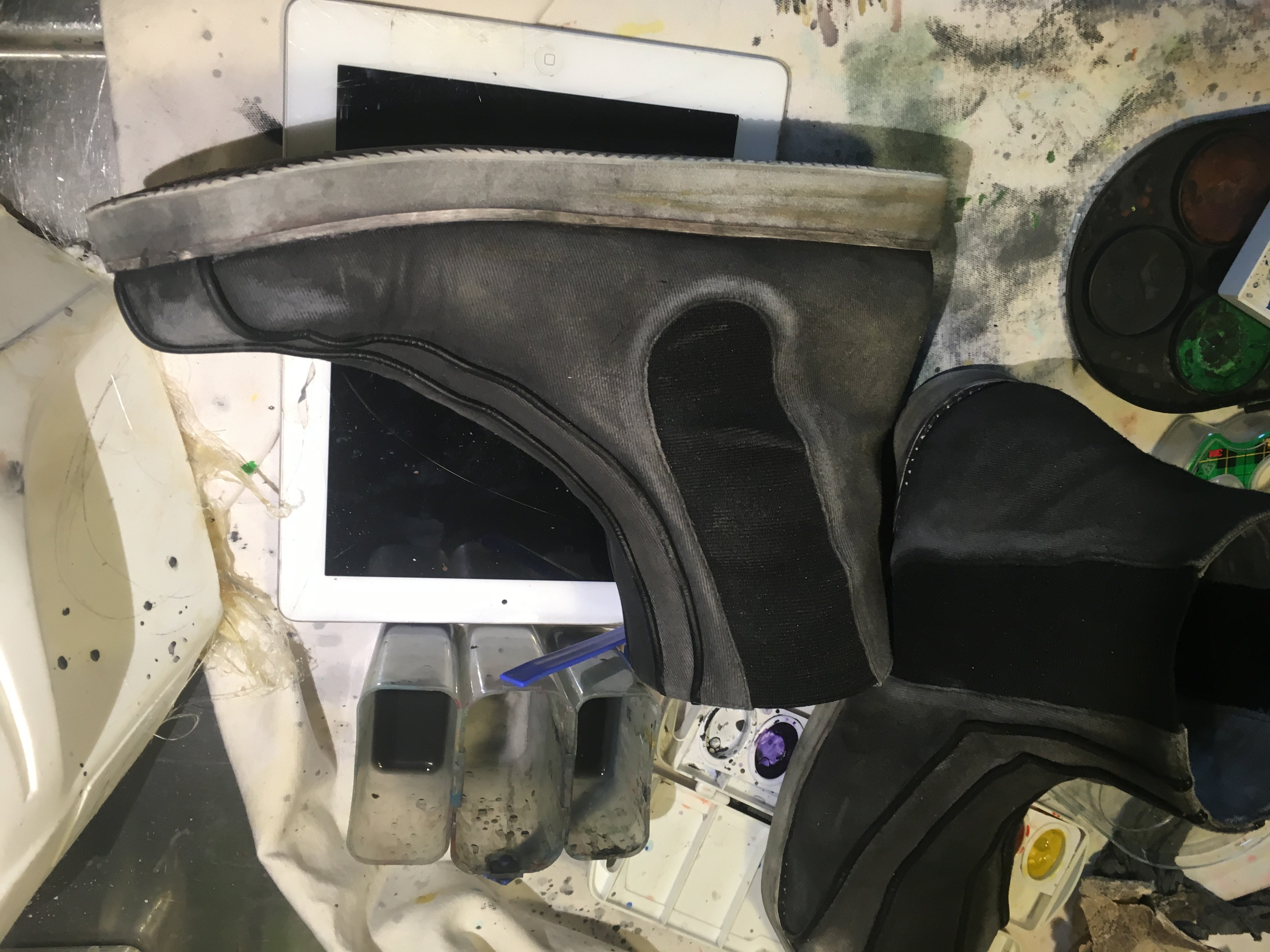

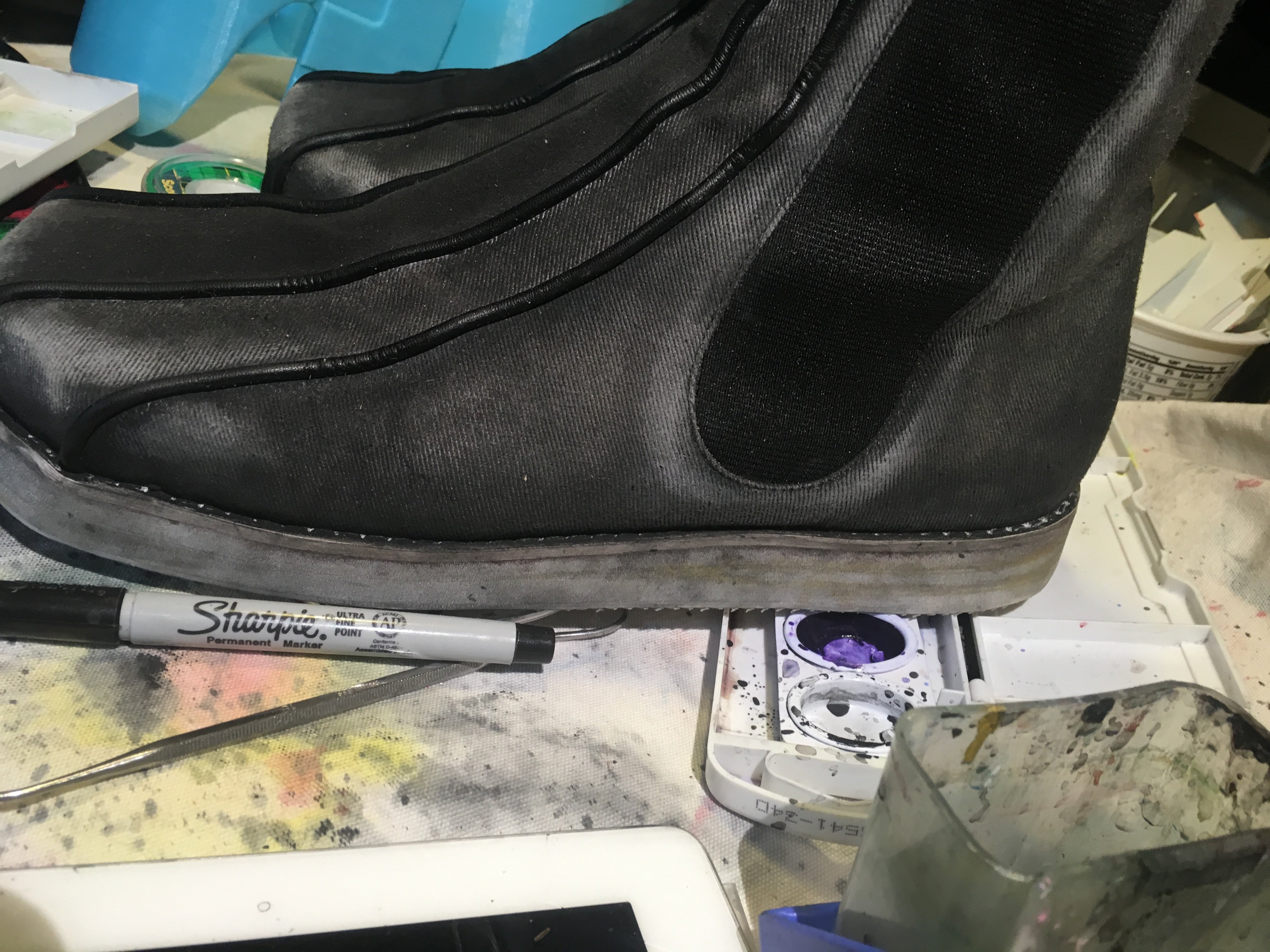

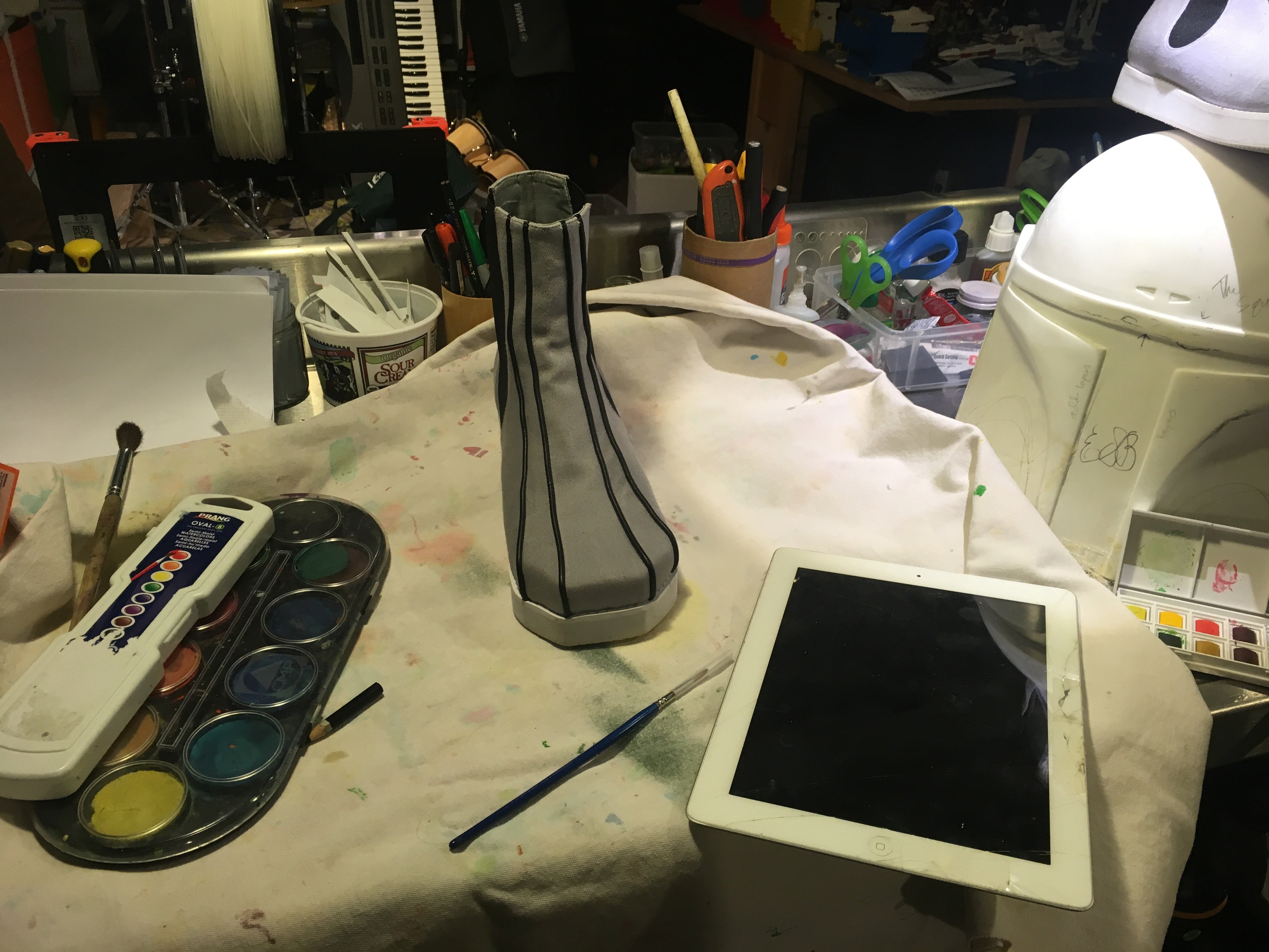

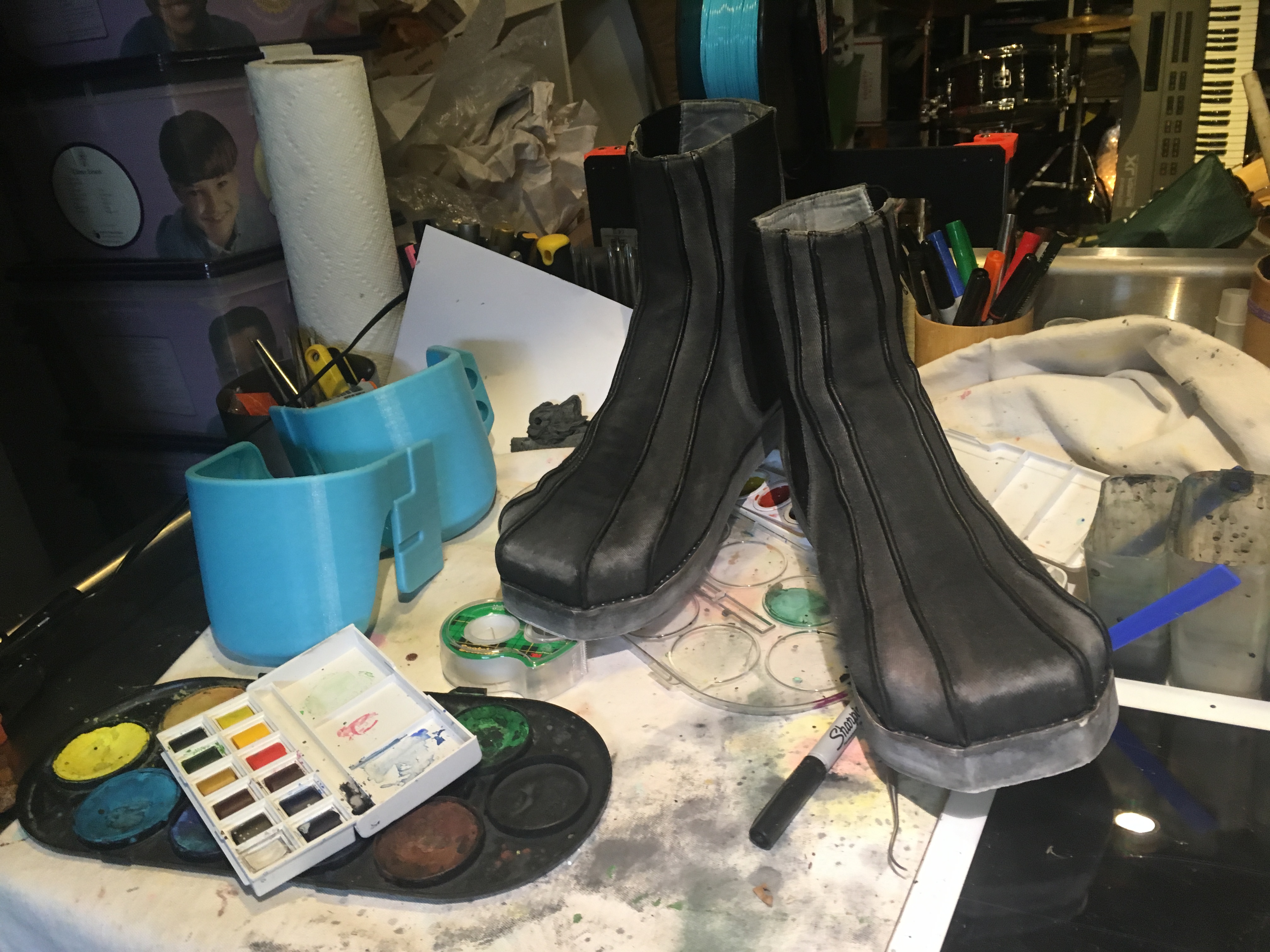

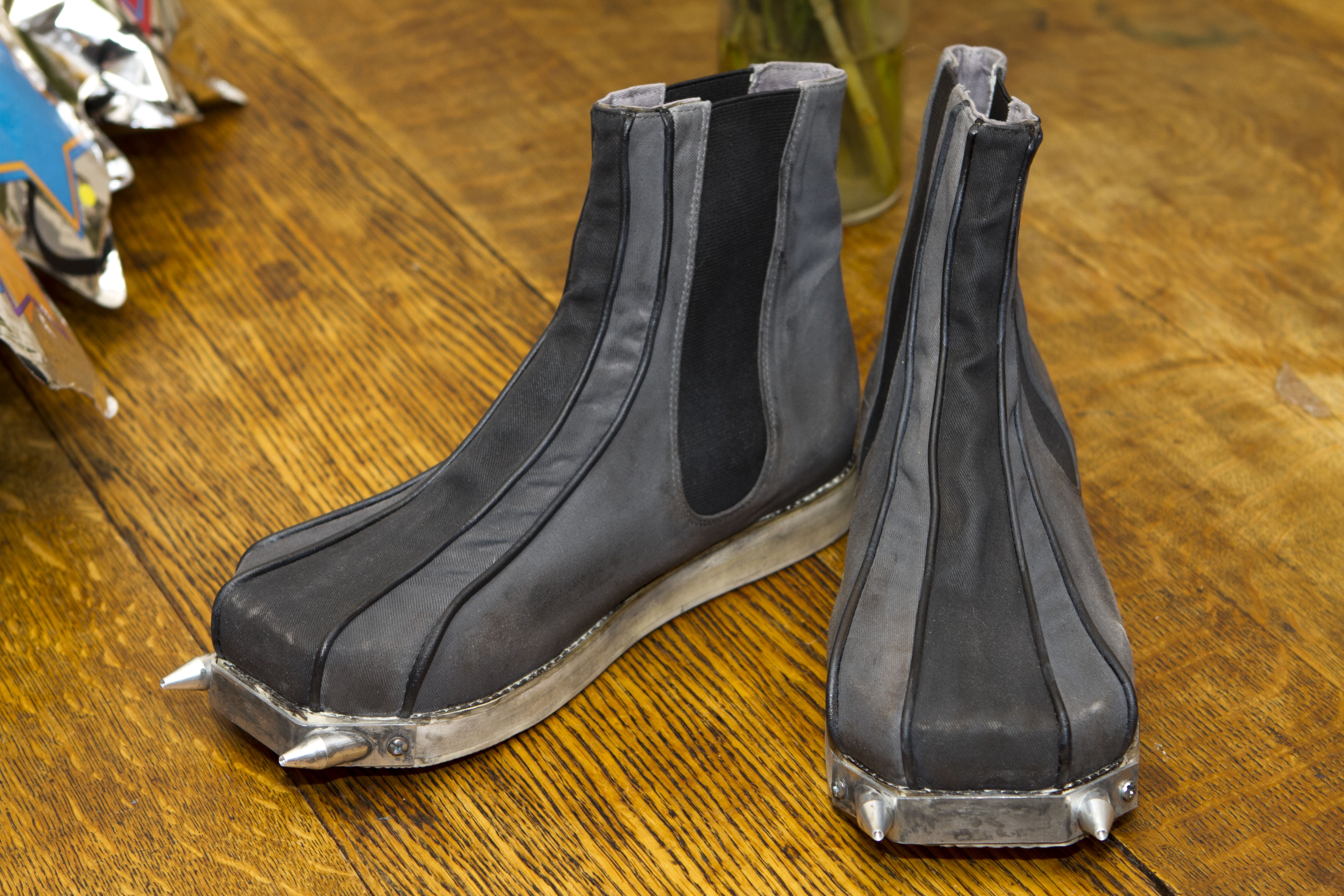

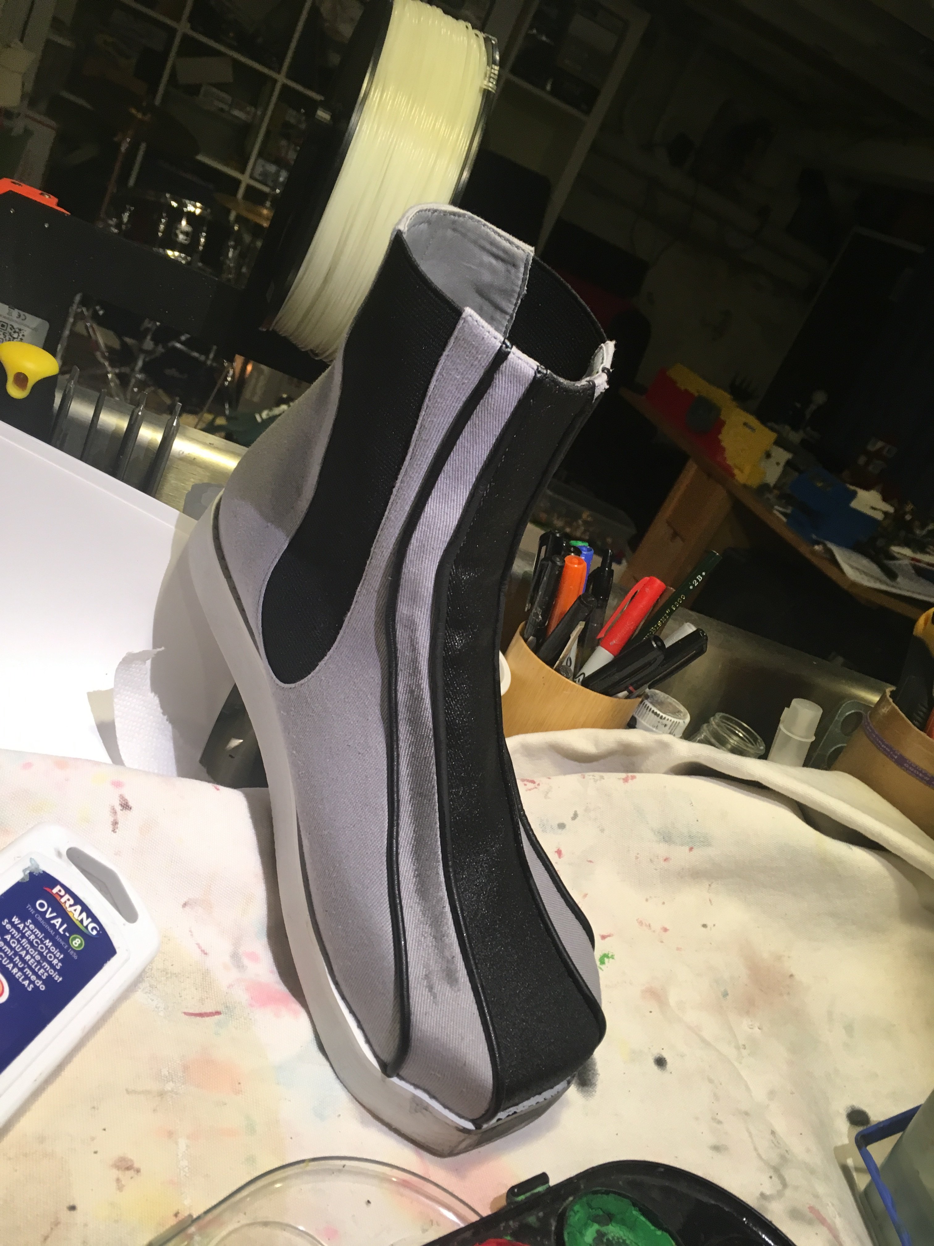

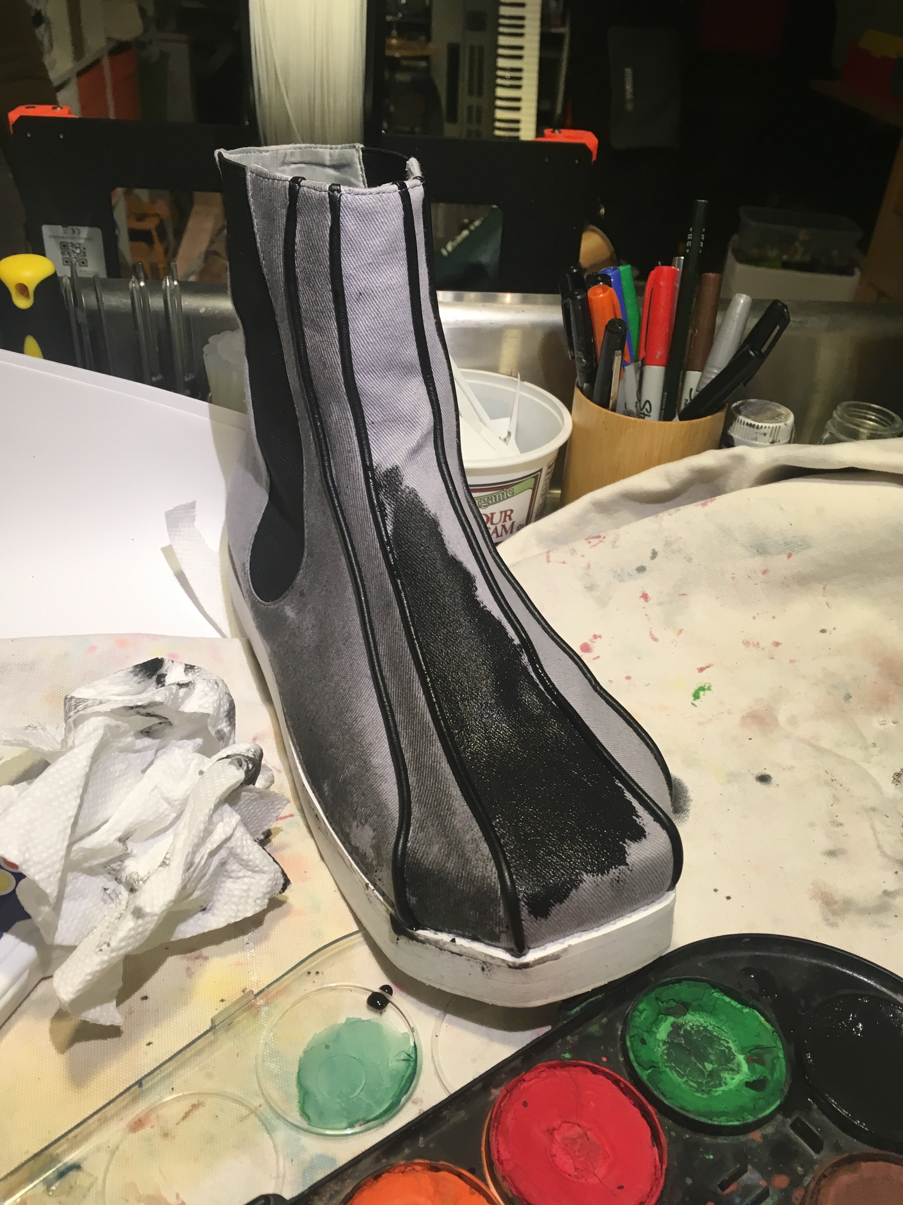

So I "finished" weathering the boots. I'm kind of a believer in wearing stuff to give it some of that real worn feel, so I will wear these boots around town, even if I have to repaint some of the wear. I followed SpideyFett's tutorial, but also knew I wanted it darker since I was going ESB.
At this point the first stage of weathering had been done...

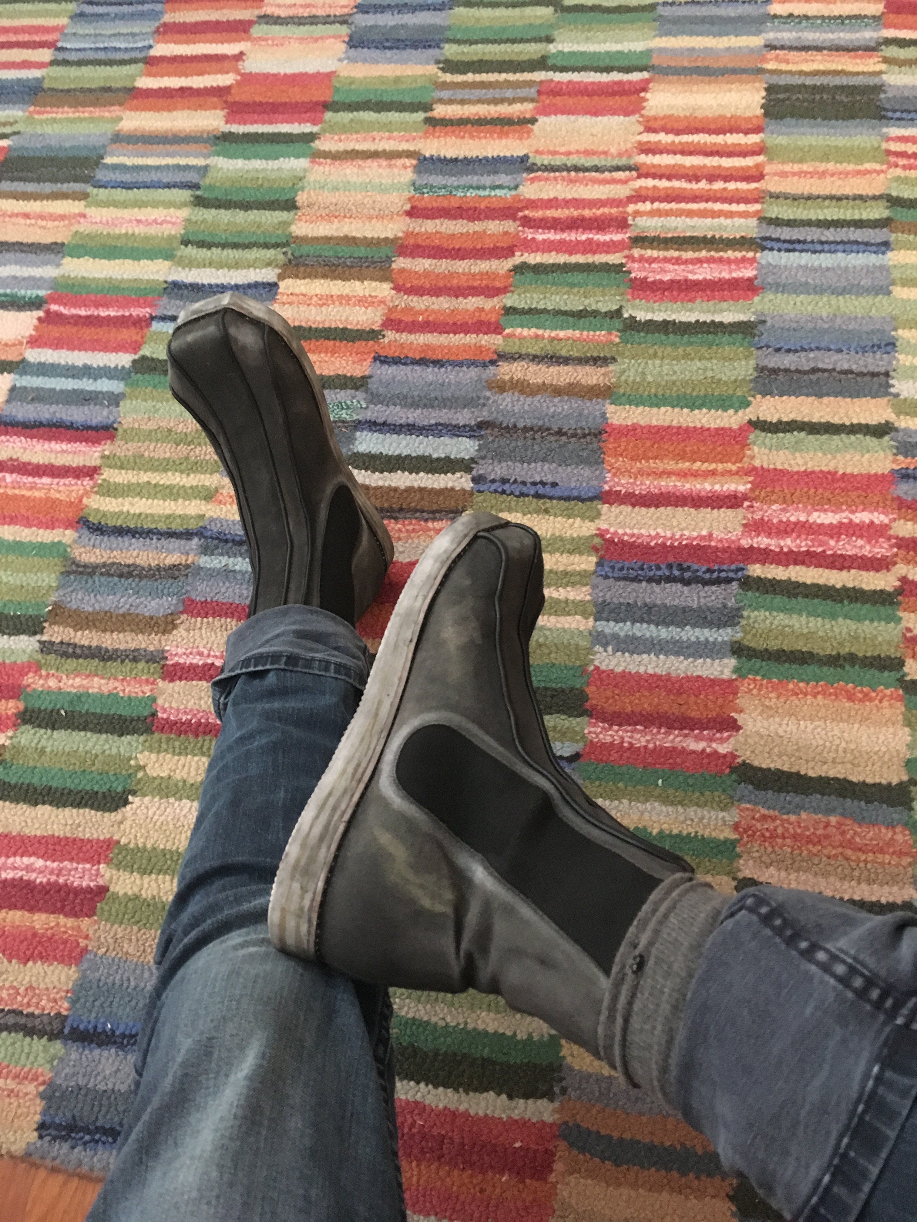

And then I wore my boots to work.
I feel like the black stripe needs to be a more saturated black, so I'll add something to it.
Would it be a bad idea to add black shoe polish to the canvas?
Also, chime in if something feels missing, I'm always happy to have some good constructive criticism.

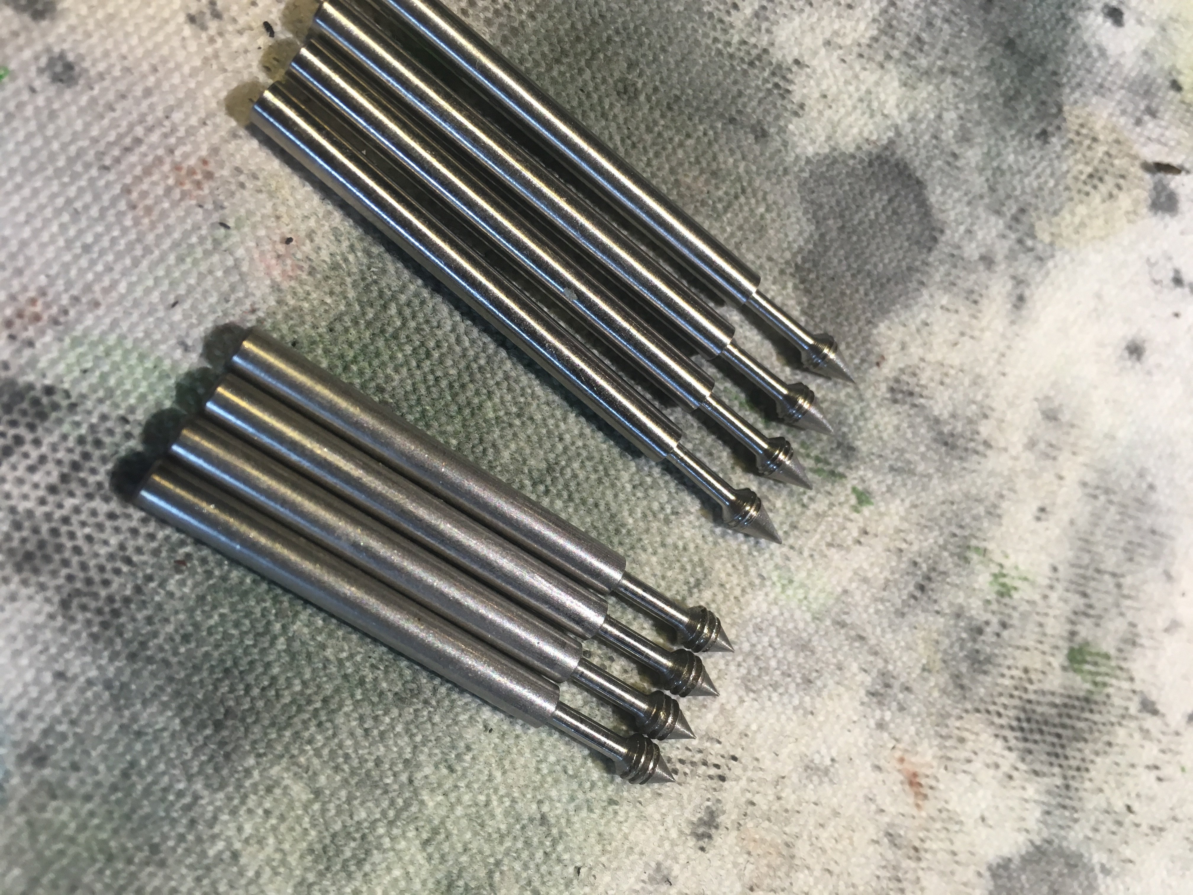

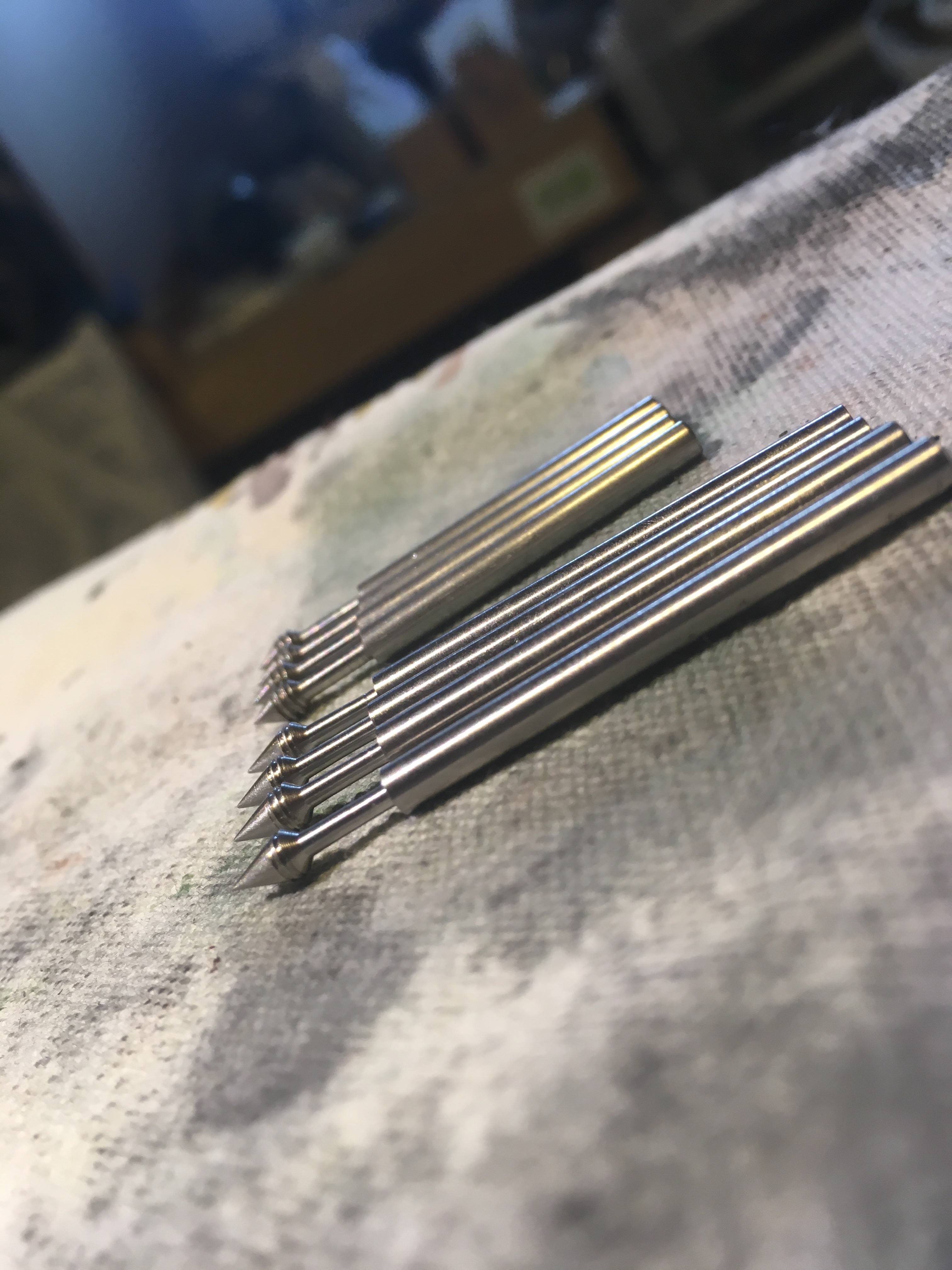

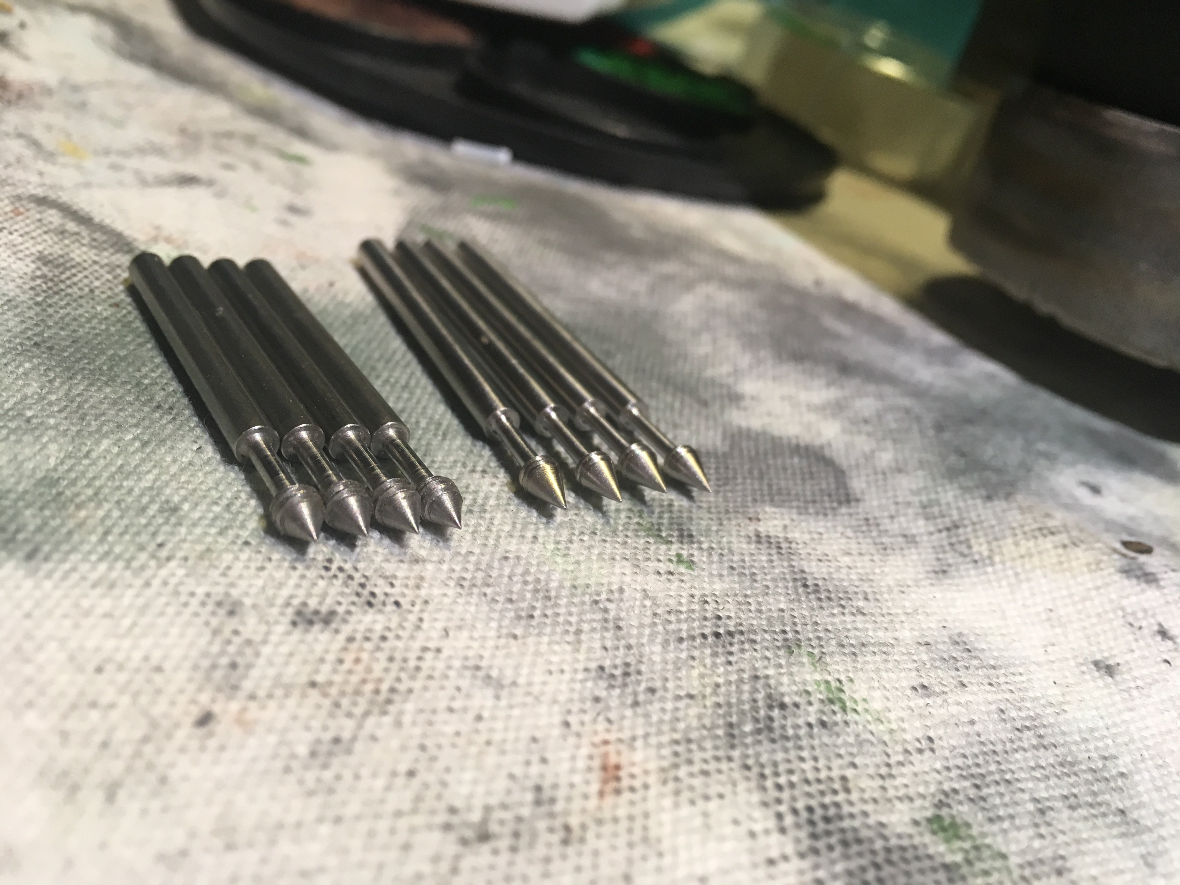

Also, my gauntlet darts from Dana KenChan came, and I thought I'd compare them with my MachineCraft replicas darts:
The longer ones are from Dana. They're both very nice, but I think Dana's really nail the real part. I still plan to use the Machine Craft set on the ROTJ suit I have dreams of completing.

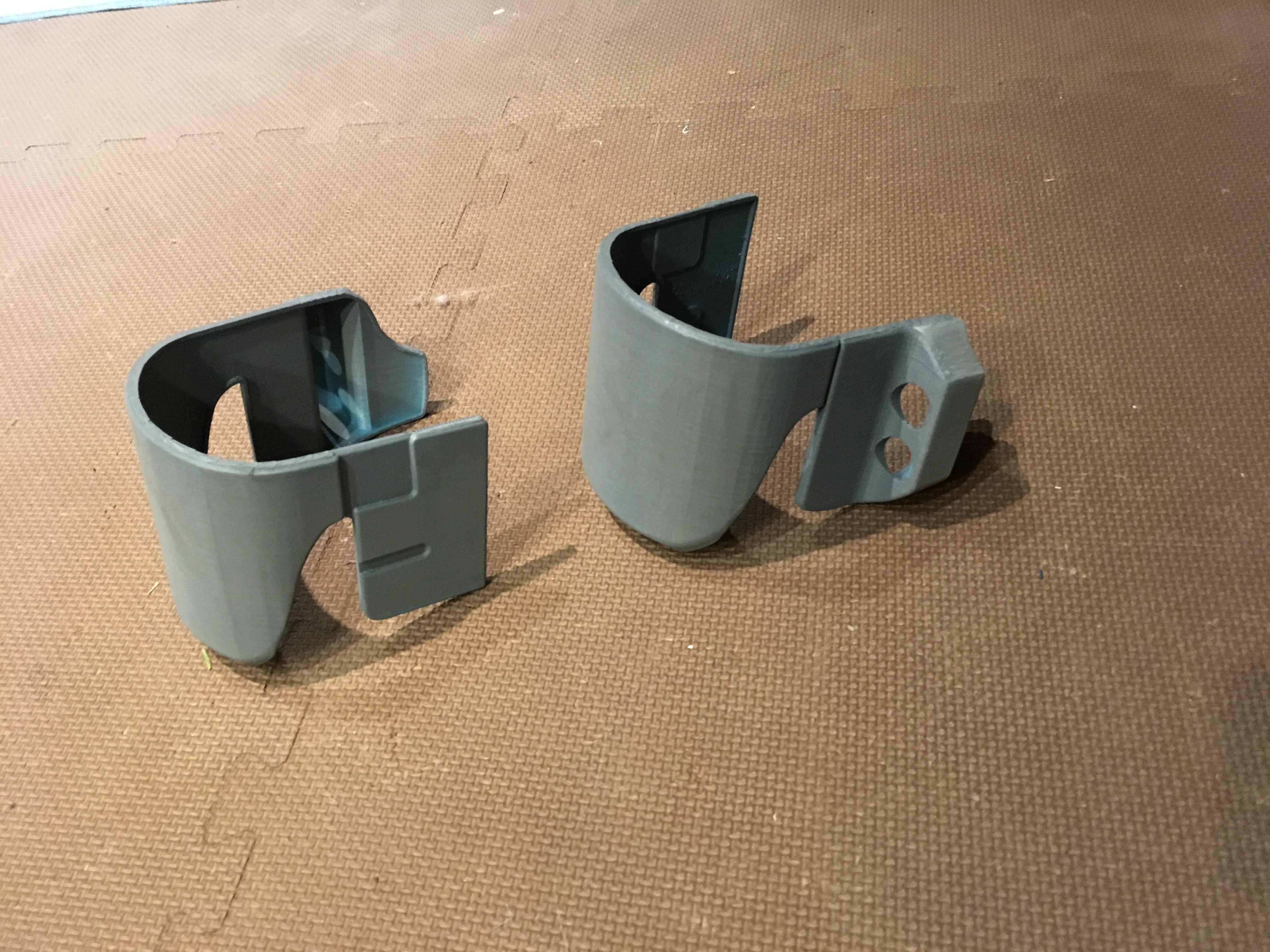

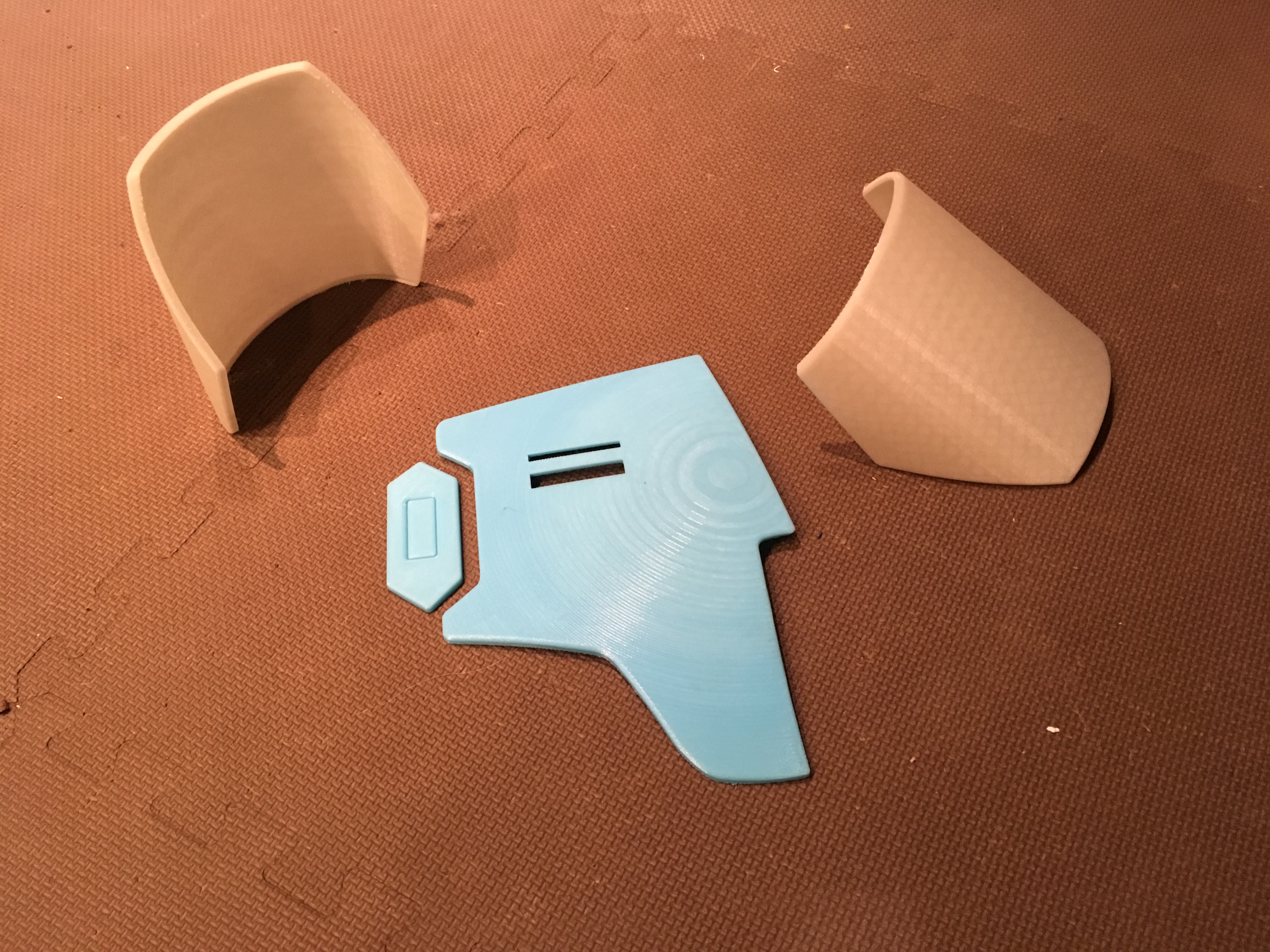

I've been slowly 3D printing the armor. Got the knee armors in primer, just gotta smooth out the striations.
The other armor will probably need some XTC-3D, a sort of smoothing resin meant for 3D prints.
FYI these files are all coming from RafalFett 's files on Shapeways. I don't know what I'd do without them.

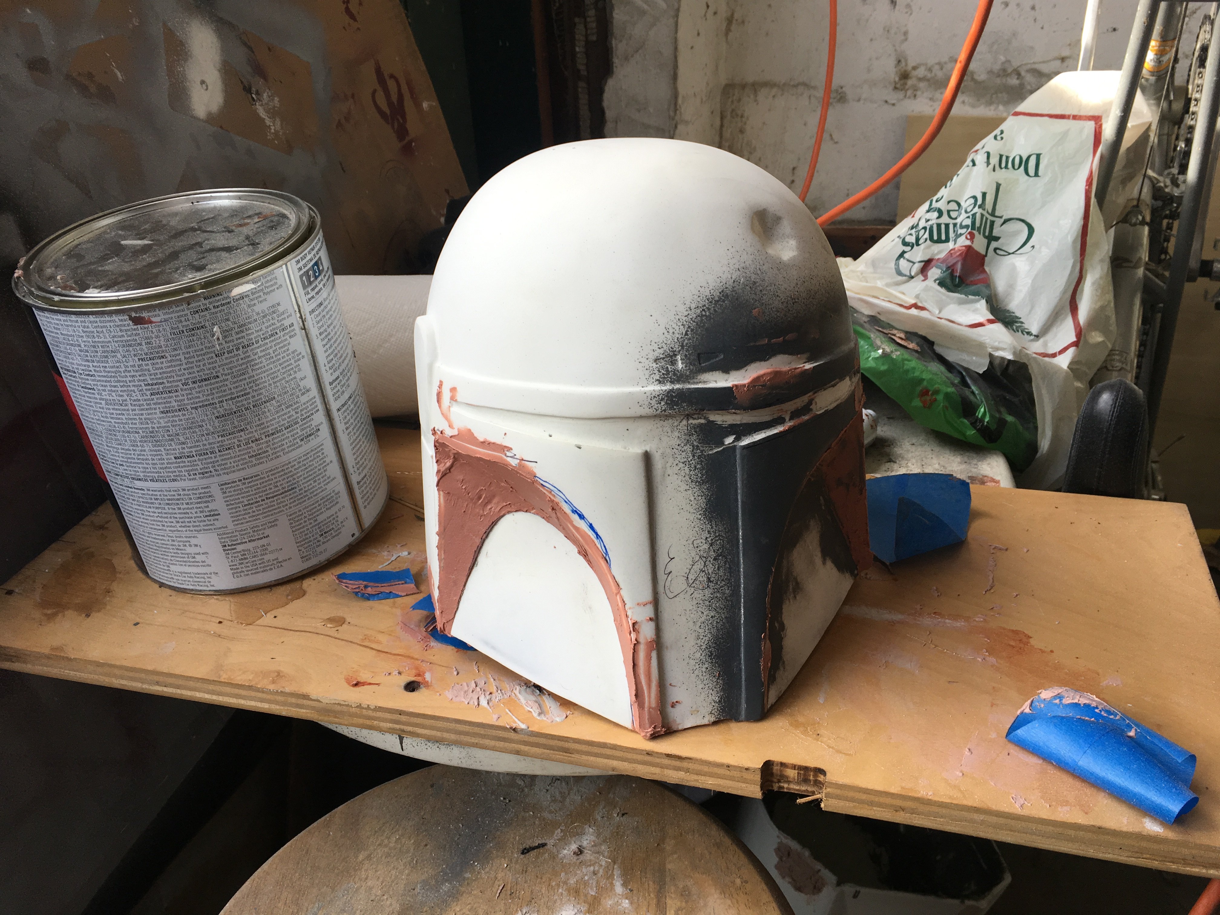

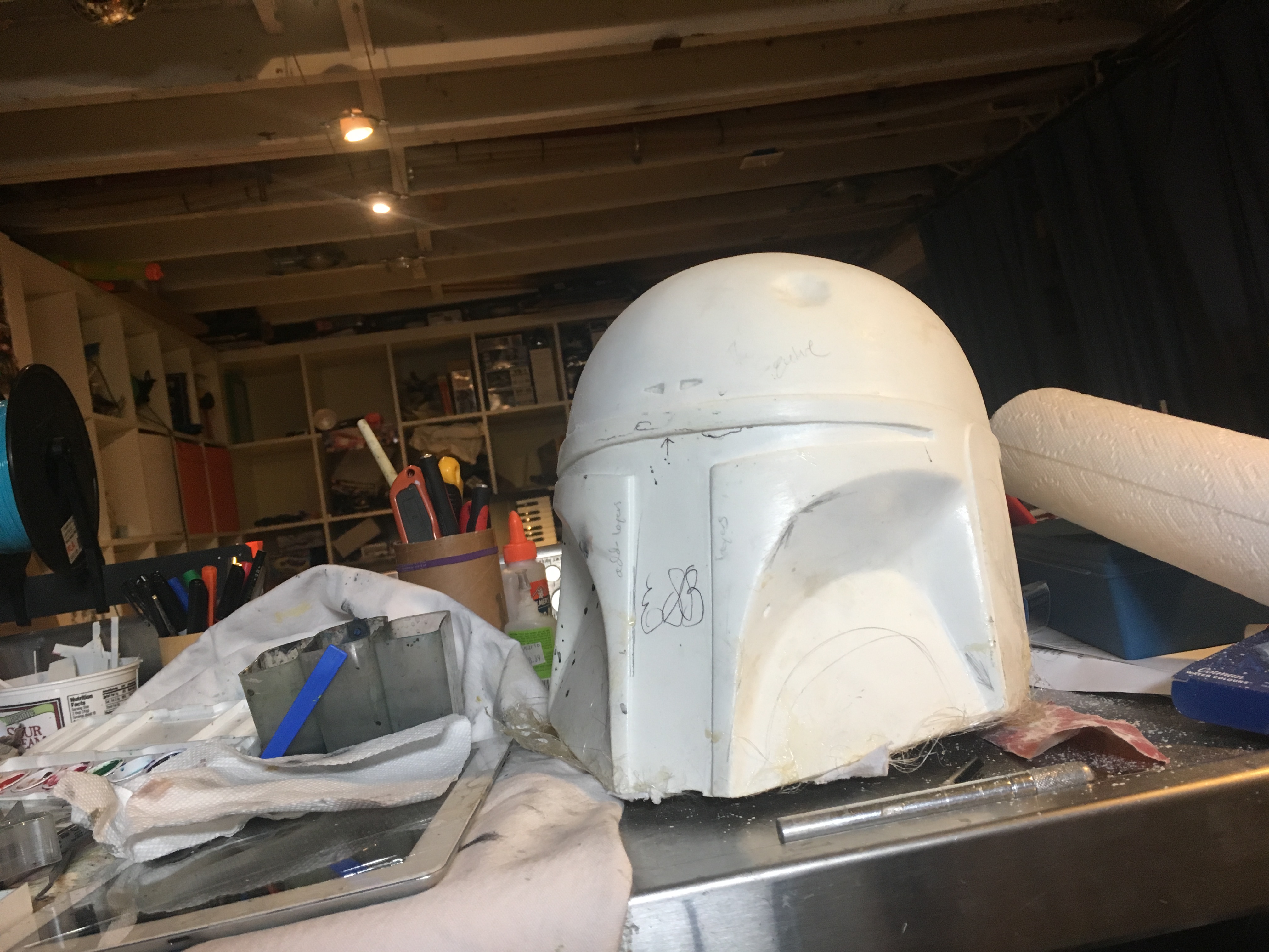

I'm steadily working on making an ESB specific helmet...the first version wasn't perfect so rectifying those issues now.
Ignore the "two-face" look....

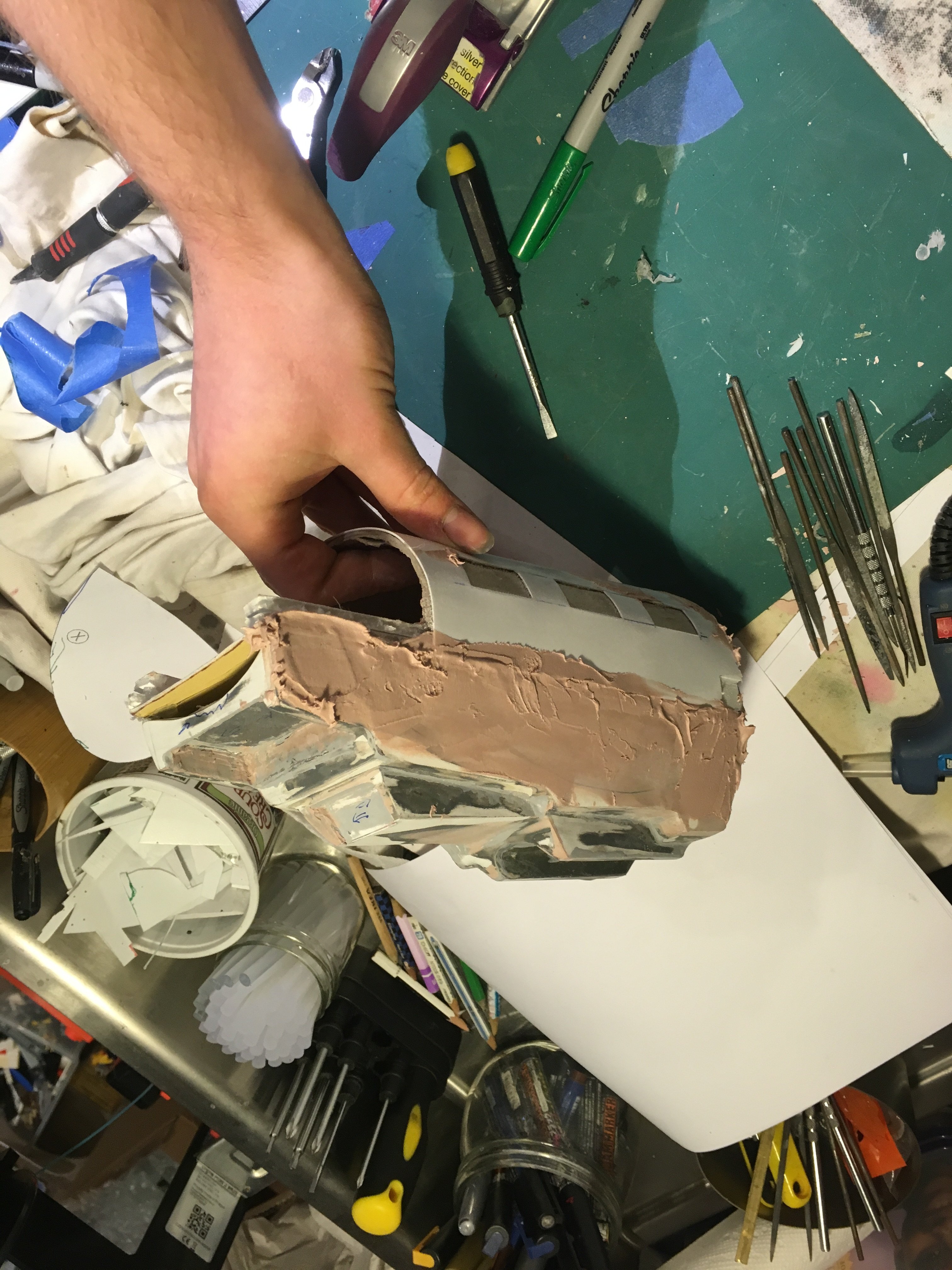

The gauntlets are also coming along.
I'll also update my actual gauntlet thread lol
I am very curious to see how you add the dents to the 3d prints. I made some DIY armor with sintra a number of years ago. Now that I a have a 3d printer, I may try redoing the armor.
