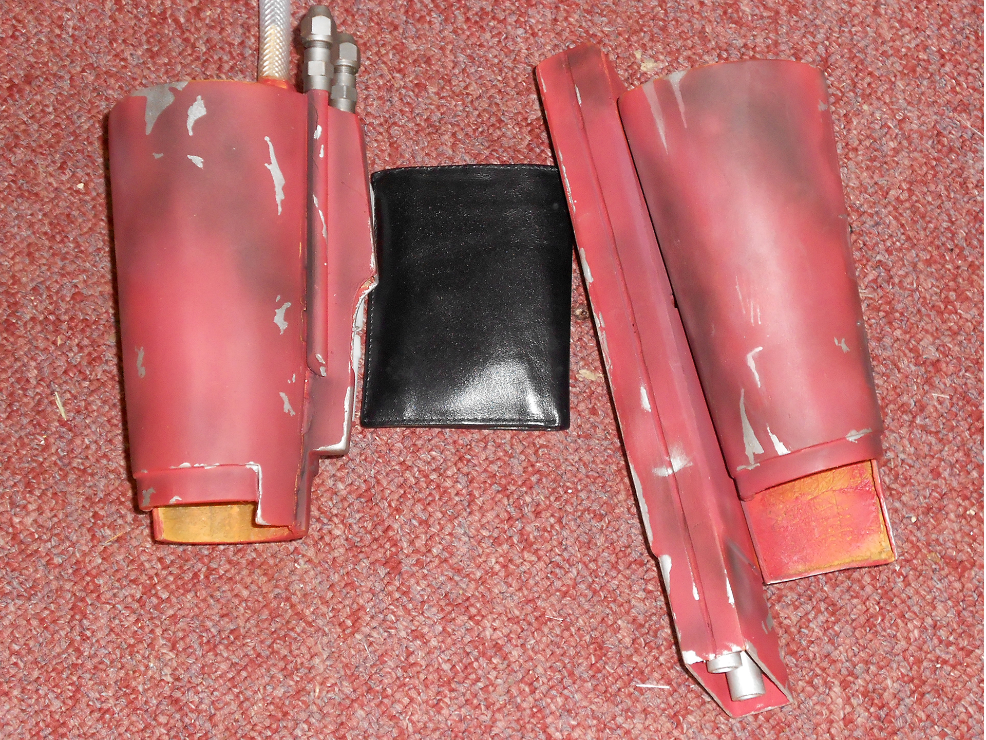

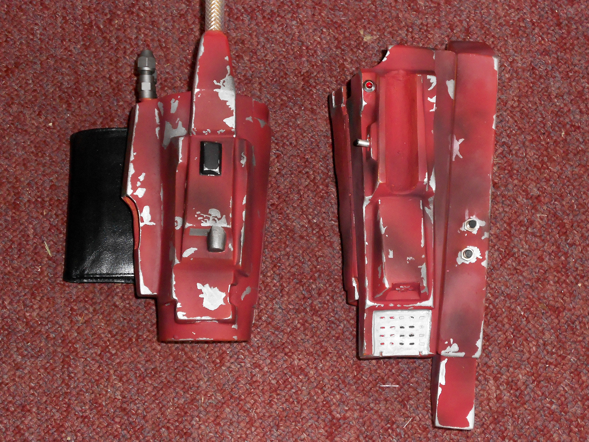

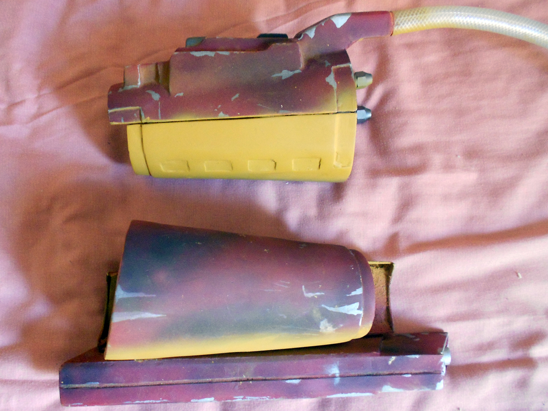

I had to enable the flash for the scorched weathering to show up. Does anyone know where I could get 3D printed gauntlet rocket/darts? The reason I ask for 3D printed is because I'd like mine scaled down since the gauntlets are smaller than the actual ones.

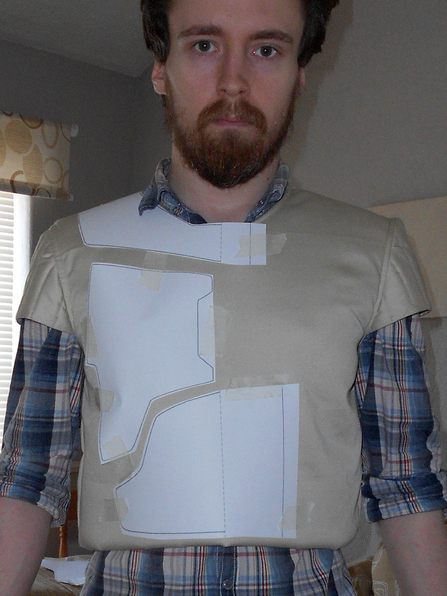

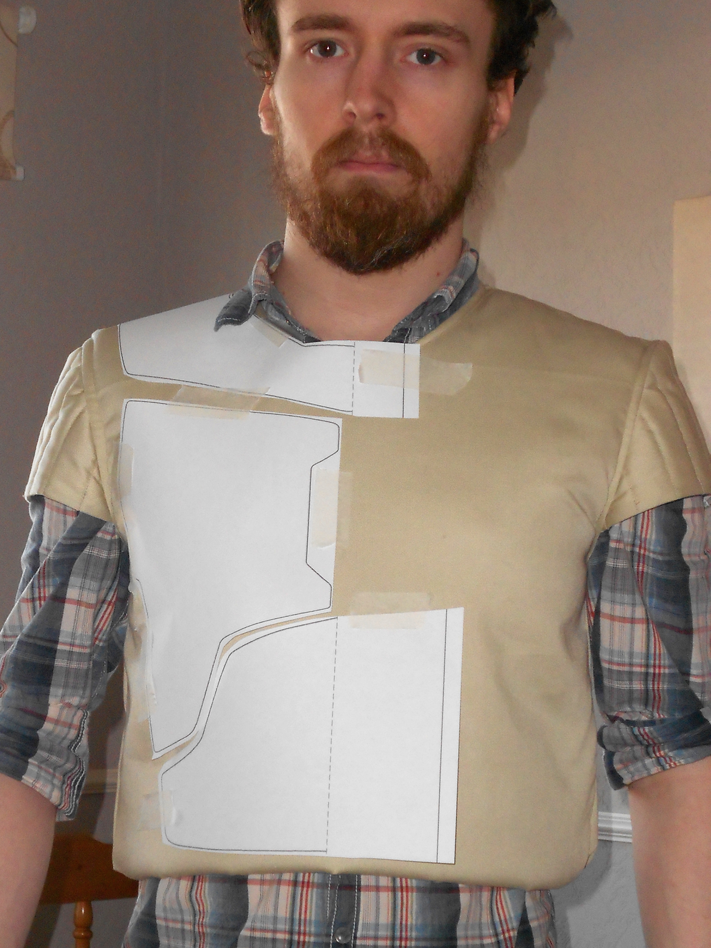

Hey, guys. I'd like a quick opinion if you don't mind. I'm back home for Easter and the PVC sheets have arrived, so the plan is to get all the armour cut out sharpish so I can easily take them back home after Easter, but first I was wondering how I did for sizing.
I ended up using Raf's templates rather than WoF's for the armour after the good experience I had with his helmet templates and I scaled it down by the same amount as the helmet. I'm not quite sure if I need to scale it down a touch more though so thoughts are welcome.
Here's half of the paper stencils attached (and flipped). It looks proportionate, although my concern is with the side of the chest plate; it tucks rather sharply around my pec when form fitting (there's more of a curve to it than other chest plates I've seen) and if I simply didn't curve the PVC so much, it would jut out from the flak vest.
I'm terrible at explaining things; I'm sure you've figured that out by now but hopefully that makes some sense.

The abdominal plate's height looks over dimensioned (you stretched it to fit the vest?), but as you said, the armor looks a bit big on you, so you should reduce the dimensions with 5-10% and do another test fit. I hope you won't use the flipped armor (to gain symmetry) as the whole suit is full of asymmetries, which gives that real look to it.
Keep us posted with your build. You are doing a great job!
I didn't mess with the proportions of the ab plate, I just reduced the scale to 95% as with the other pieces. I'm using an old copy of Adobe Acrobat to print the templates; maybe that's doing something it shouldn't. Don't worry, I won't be flipping the armour; I just couldn't be assed to print out all the pieces for a test fit.

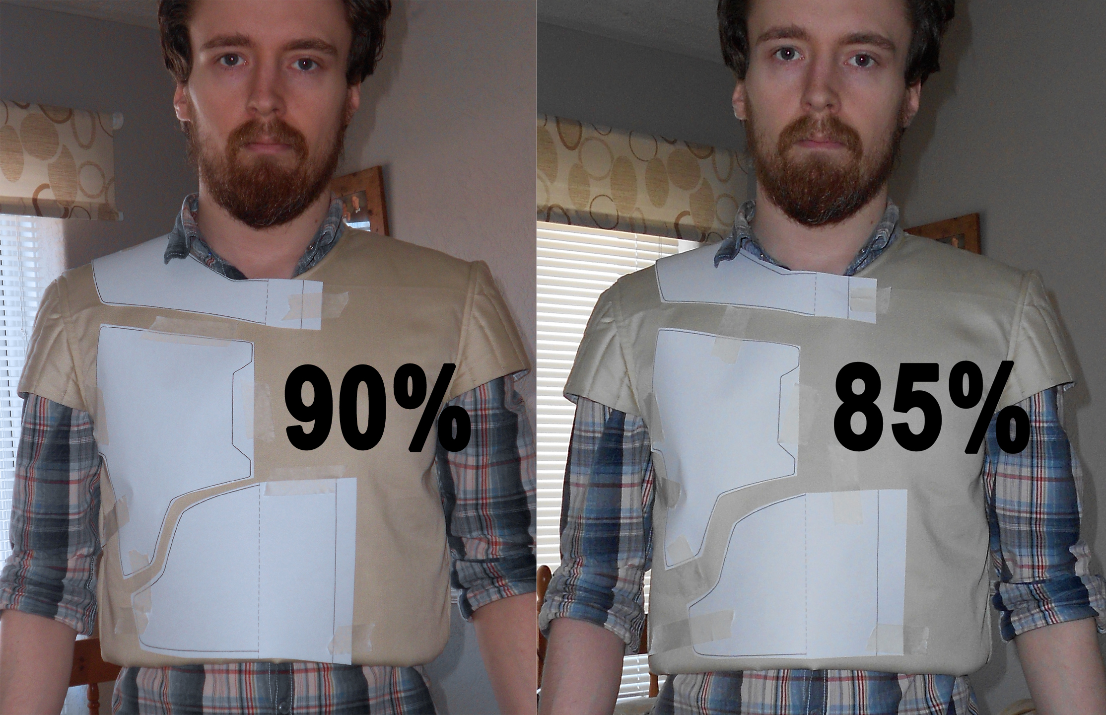

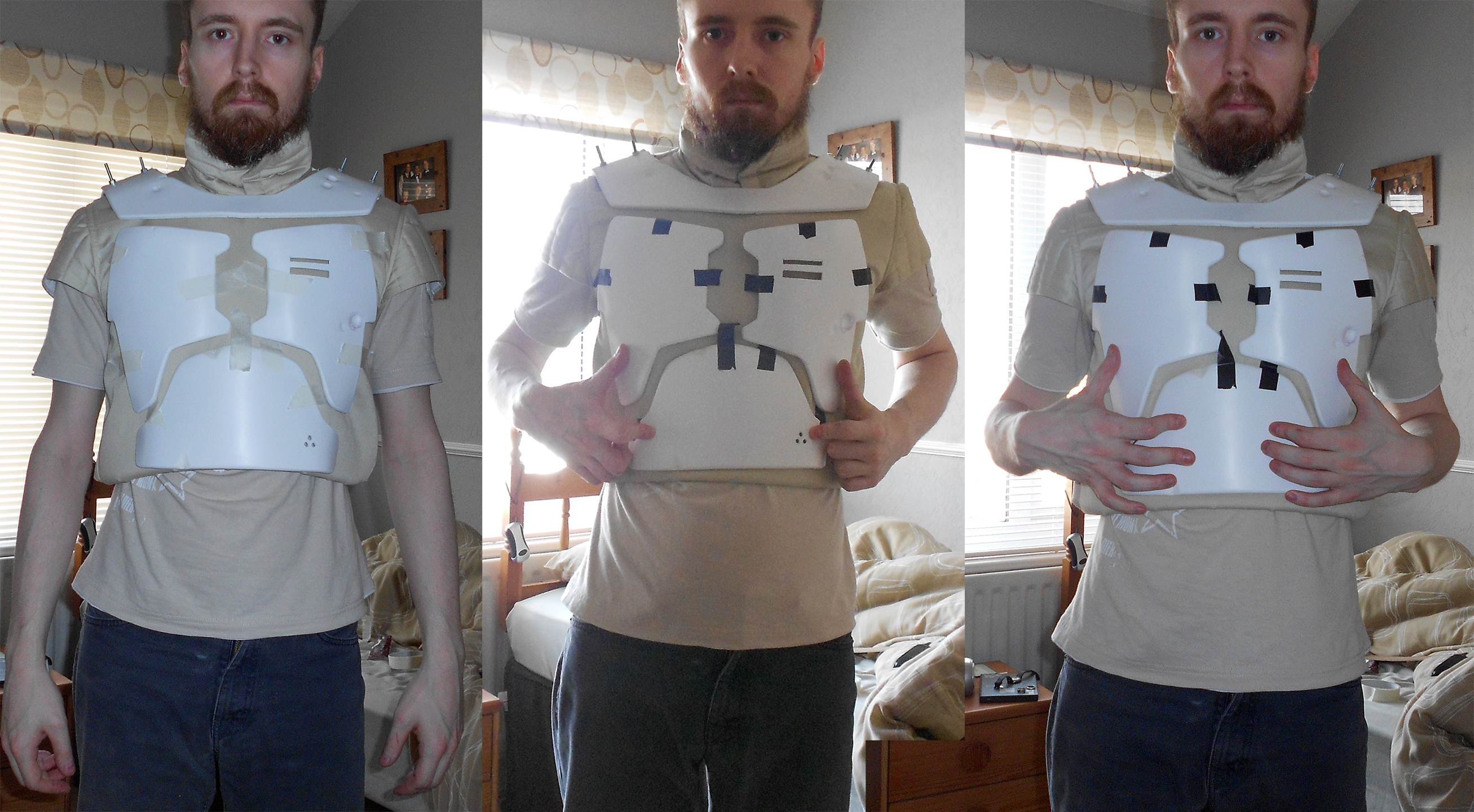

So I did a couple more test fits. One in the 90% fit range and another in the 85%.
90% feels neater although the chest plates still seem a little wide. I'd say the 85% chest plates are the right width, but there's a big gap between all the plates. So I took the smaller chest plates and put them with the larger pieces to get this:
The ab and chest plates, being different scales, will need distorting height-wise if I go with this option to make the gap between them more consistent, but the 90% option is still a possibility. What do you think?

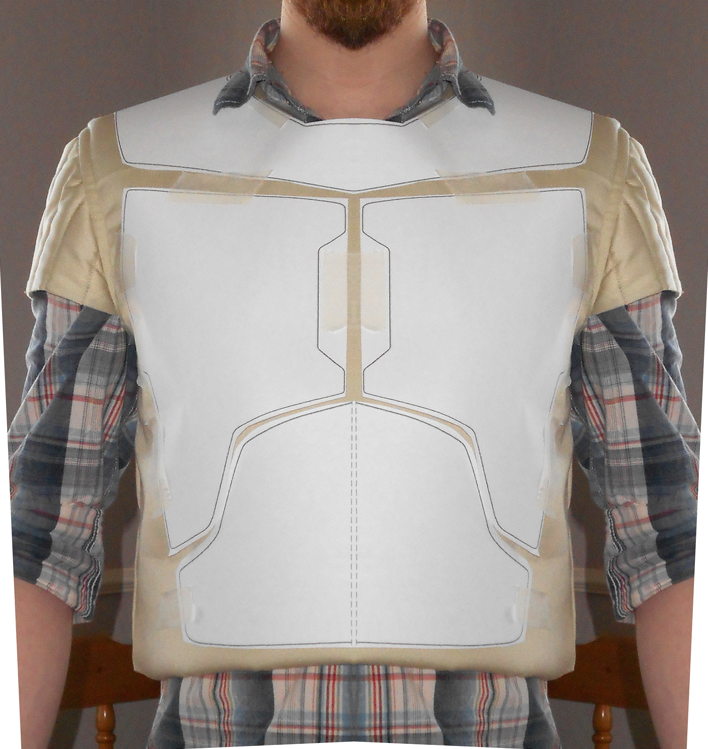

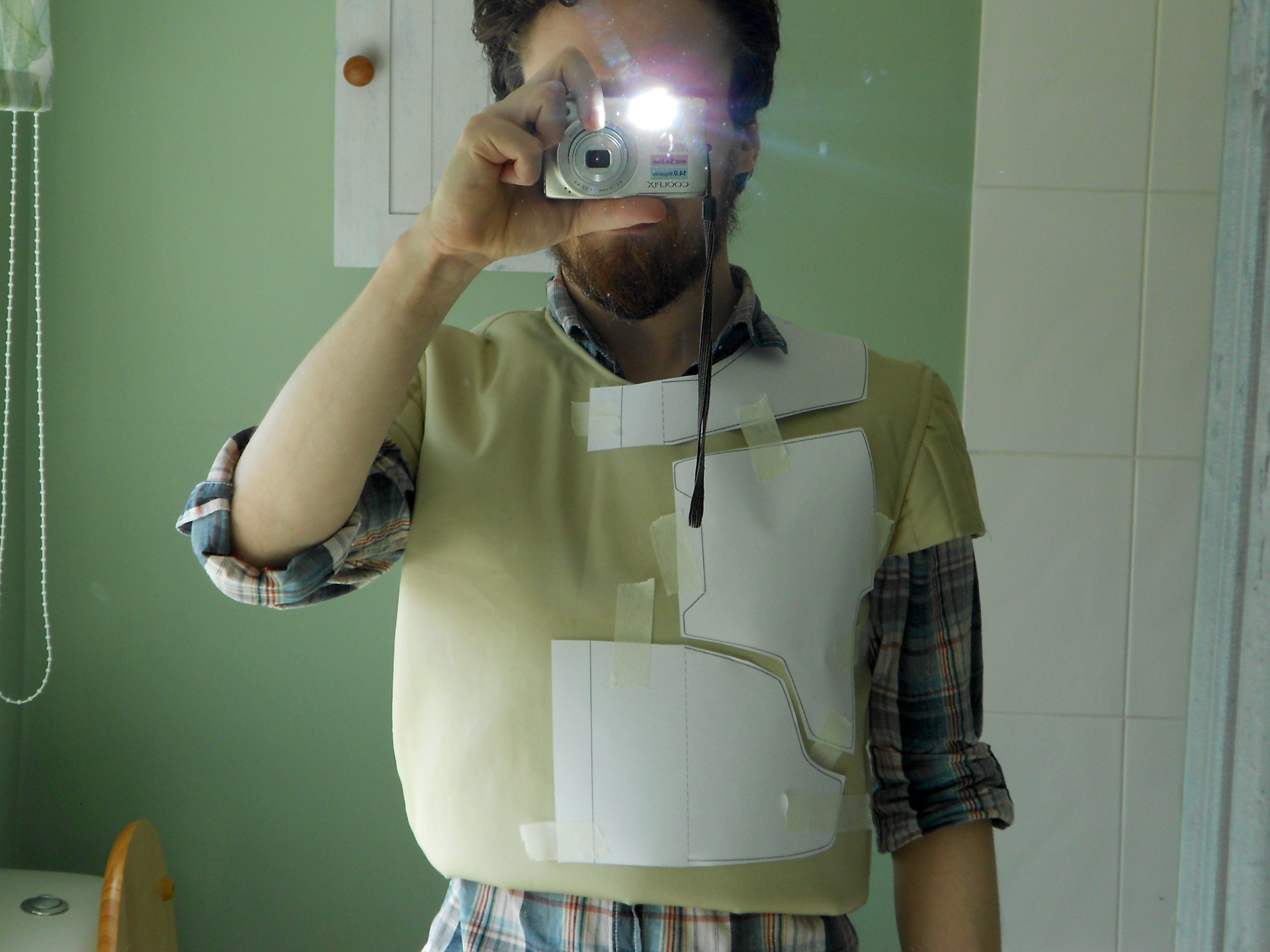

EDIT: Now I'm even more indecisive. Since my flak vest comes down to my waist (I tuck it up past my belly button for pictures), I wondered if I was folding it in the wrong place. I took the 85% pieces and pushed them up to what I think the gap spacing would be and it looks much better, despite the large space at the bottom of the vest.
So now I have three options, but I'm not sure which is best. Thoughts?
View attachment 76190View attachment 76191
Hard to say because I was using rafal fett templates at 93% and liked the way they laid out. Although once I had those it'd made my helmet look way too big so I made a new one scaled down slightly and everything seems to match up pretty well. You look a bit slimmer than me, but around the same size so I don't know maybe you wanna try that percentage?
I really like the one at 90% as it sits well on you. You must also take account of the material thickness, because it will give a 3D look to the whole armor. The length of the vest in the front (neck to belly) is around 440-450mm (17.3-17.7 inch) at 100%, so in your case at 90% you should have around 400mm (15.7 inch) to accommodate the armor (which you have in that image with the 90%).
Okay, thanks. I'll tentatively go with the 90% option and keep in mind that I'm not wearing my helmet which will make it look bigger (hopefully my 95% helmet won't look too big now). I can tweak certain parts down if needed anyway. I'm not sure how the collar piece works though; in my pictures I have it laid as high as my neck will allow, but in pictures, I see it's quite a lot further back, almost choking him. The collar plate reaches back only to the half-way seam on my vest and I'm not sure if it'll reach the back plate. I don't know whether this is a limitation of my flak vest's wider tshirt-style neck opening, or whether I'm laying it out wrong.

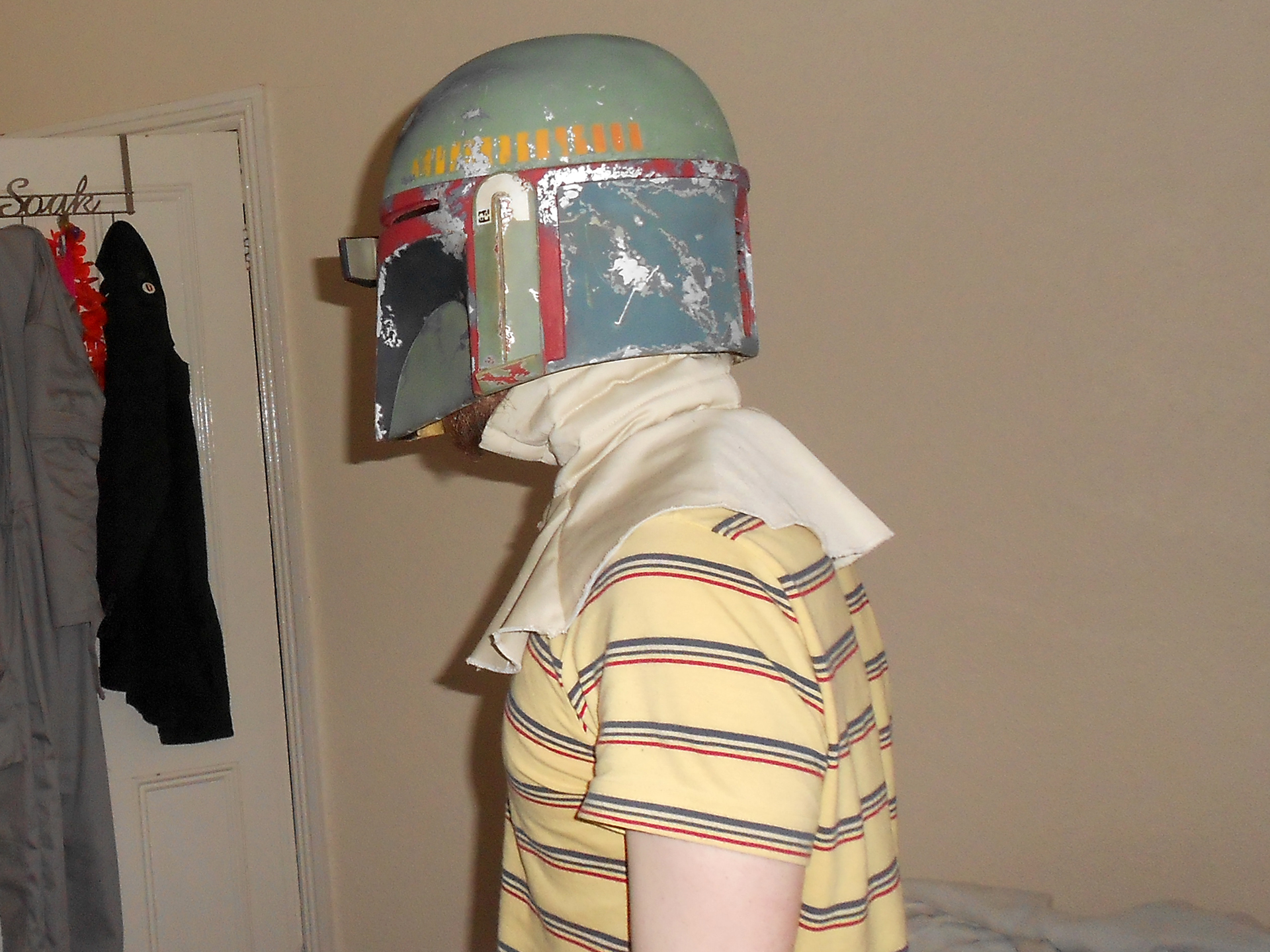

I'm back home from easter and look what new problem I've found...
I feel like I'm falling into a rut. While I made a lot of progress on the armour while I was away, I've recently been stumbling into problem after problem. I have a bit of a beard which could do with a trim (although I'm not losing it) but it appears the whole bottom of my chin is on display on the side view. This is after I dremelled out more of the interior supports. Currently, it sits a lot more snug than it did before, although my eyes still don't line up with the horizontal part of the T-visor (I don't think they ever will given the height of the dome versus the height of my forehead). I took this profile shot after to see how the helmet sits, but found that height issue instead. I could do another dremel session on the dome support pieces but I don't think I'll be able to lower the helmet more than 5mm. Is there anything I can do? Maybe a chinstrap? Or a chin skirt?

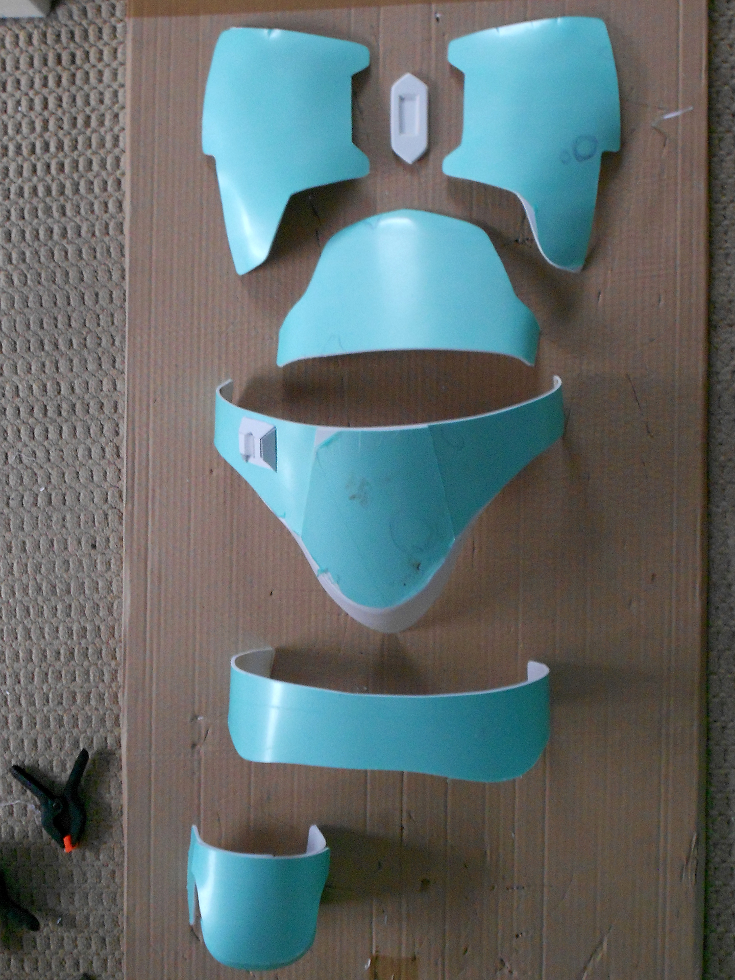

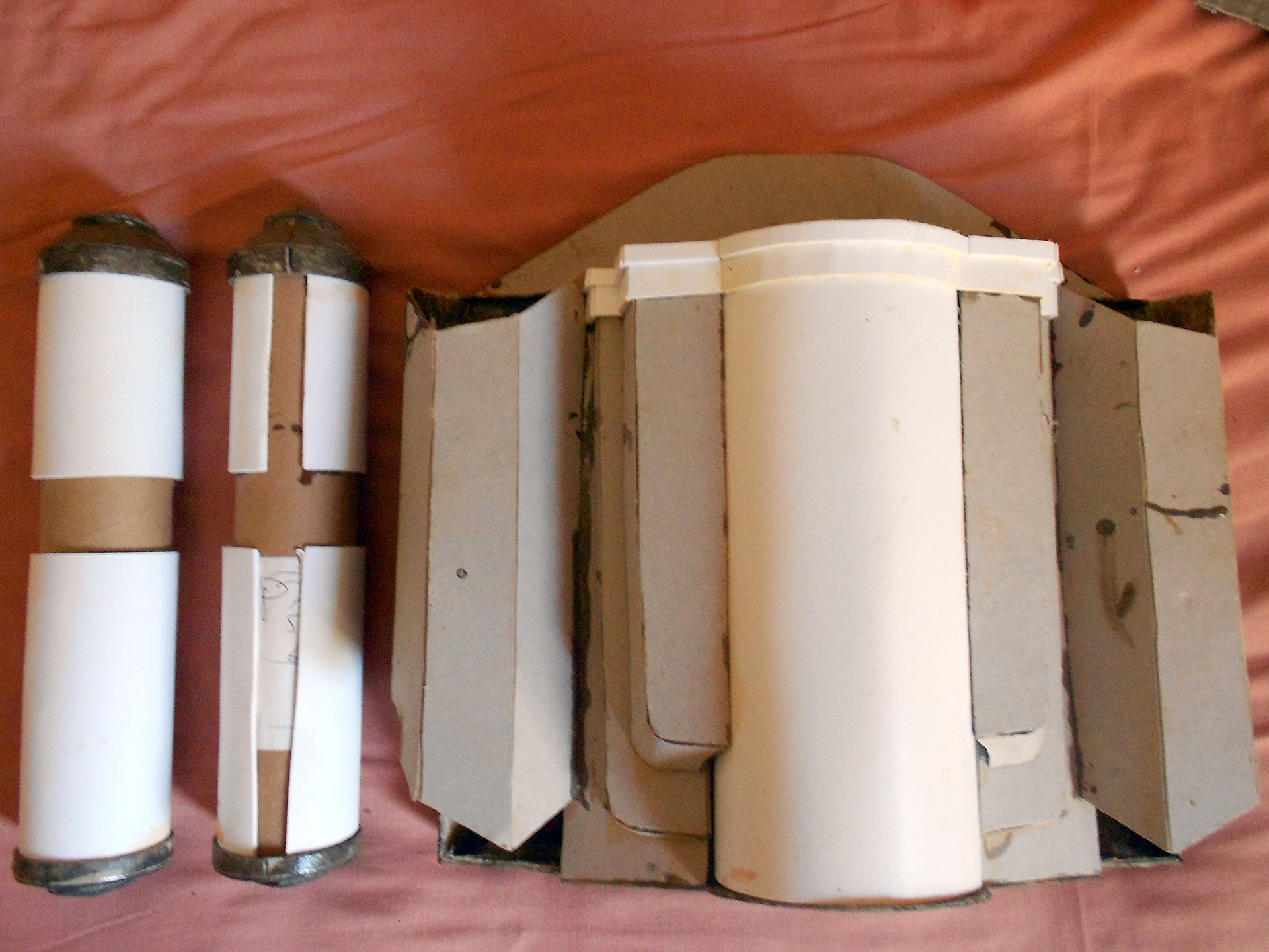

Now onto updates! I've finally got some pictures to show.

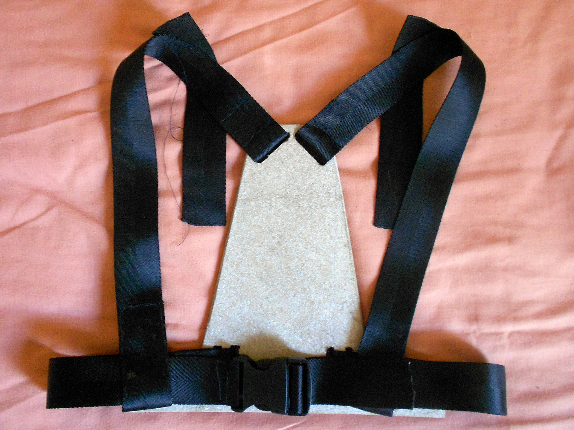

HARNESS:

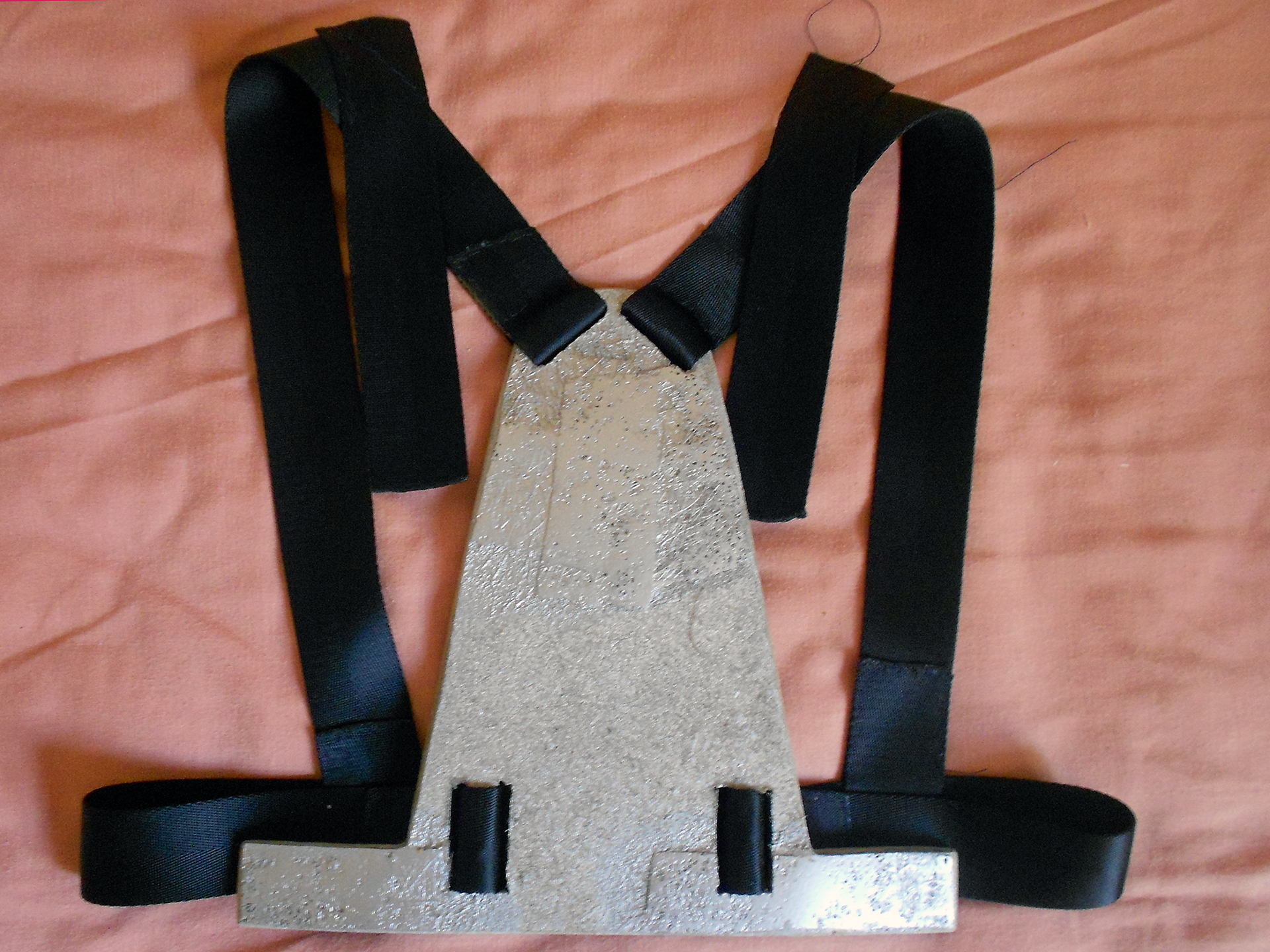

My scratch build POS. The back is MDF formed slightly to accommodate the curvature of my back and the curve of the jet pack, with fiberglass on some cracks. It looks awful, but it's functional which is what I care about most for this part. Based on the original harness concept, I simplified it. The bar at the base wedges the back plate snug against my back, and the nylon webbing I sewed together keeps it tight. I've still got to add D-rings for the top half. It's not bad for the price of a roll of nylon strap.

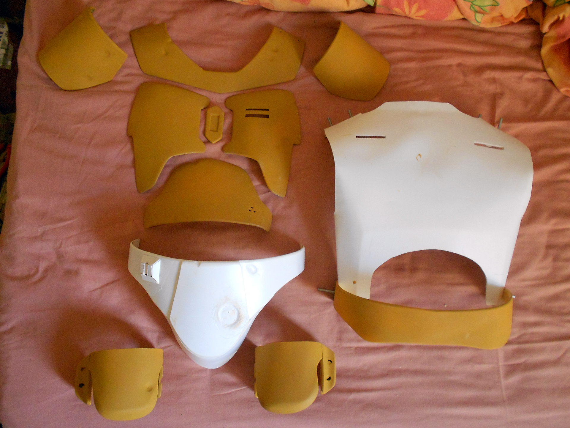

ARMOUR:
I've filled and sanded the majority of the pieces, I just have the codpiece and back plate to go. Pieces are primed and have snap fasteners attached to the other side. I heated up the sintra and pushed a scalpel butt into the PVC for the dents and dremelled in the rough scratches. The codpiece dent was trickier as the sintra is doubled up, so I hacked away at it with a scalpel and plan t even it out with the bondo stage. Again, the back plate isn't that accurate, but it fits my back well.

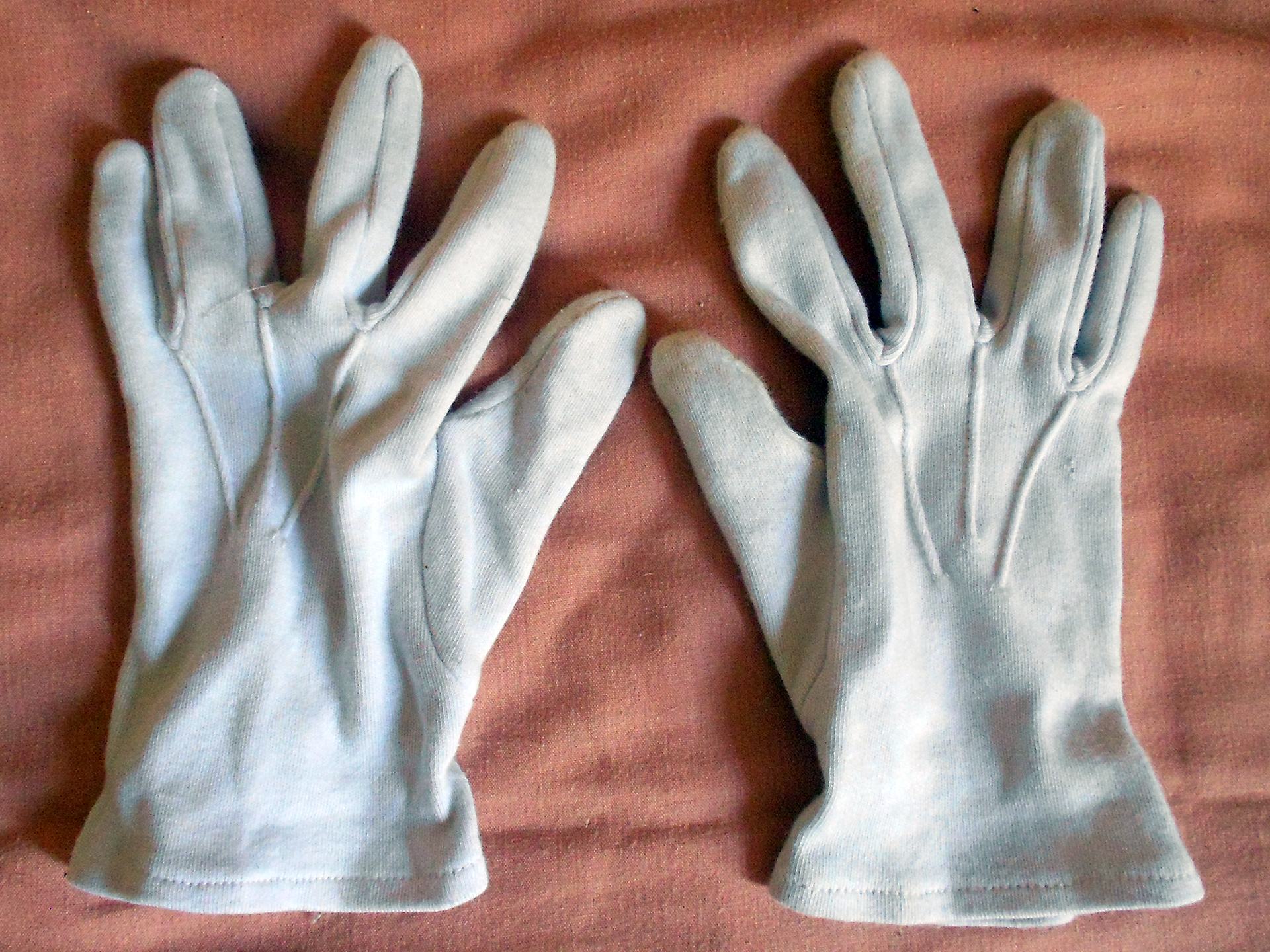

Just a quick picture of the parade gloves I bought. I used Pearl Grey Rit Dye to darken, although I used it very sparingly in stages because I didn't want to take them too dark. You can't really see the colour in the photo but I think it may need a bit more to fit with my flight suit grey.
GAUNTLETS:
After suiting up with what I had, I realised my gauntlets were far too tight, and the magnets would pop open with a flick of the wrist. I do have slightly shorter arms in proportion to the rest of me, so while the length of them on my forearms feels right, I really didn't have enough circumference to handle my arms. So, despite having painted them to a standard I was happy with, I added some spacers to let my arms breathe a bit easier. More bondo and sanding. Now they're a little screen inaccurate, but comfort comes first for this part, and wearing the suit, every little helps in that department. So here they are primed and ready for another spray session.

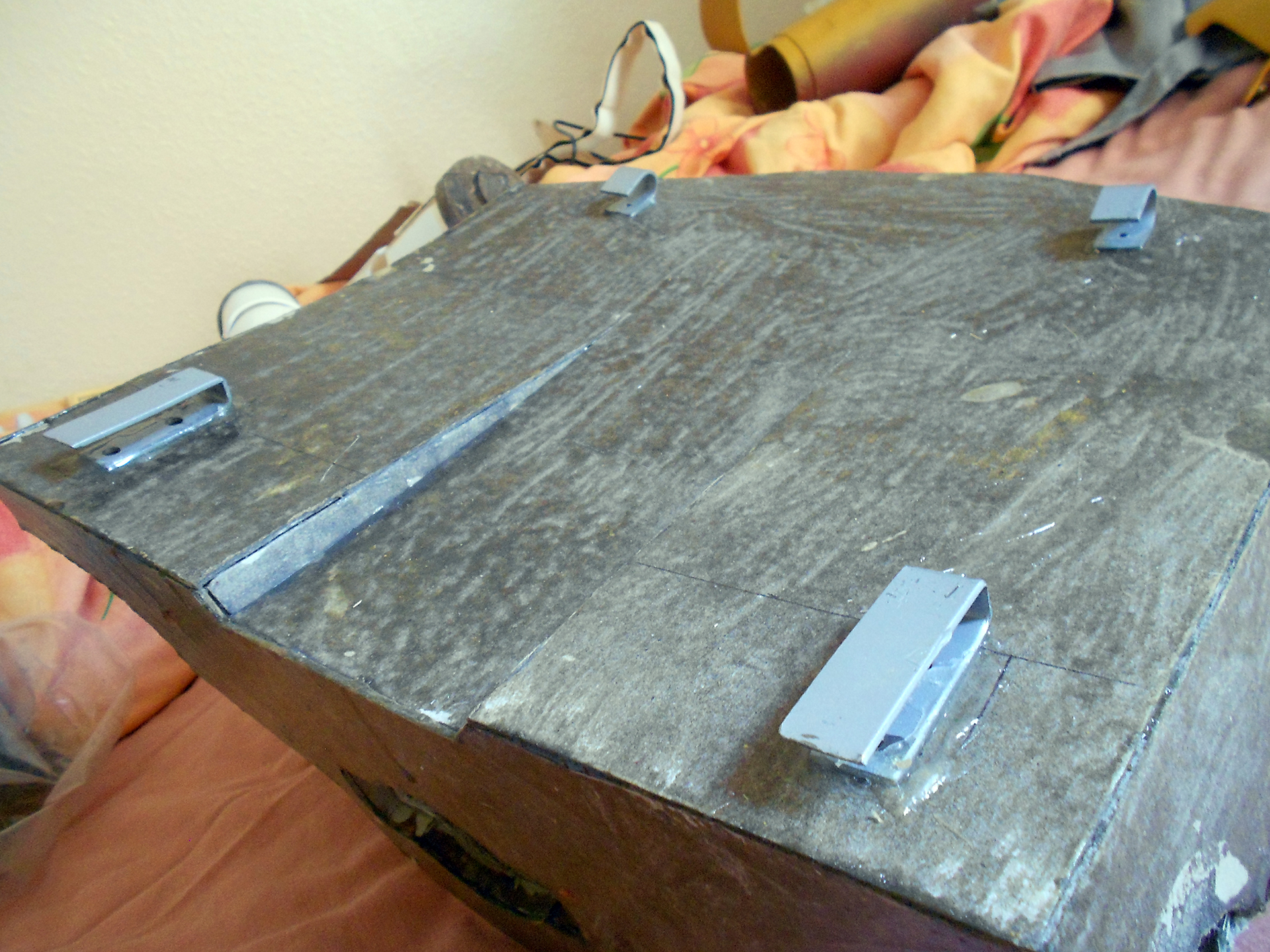

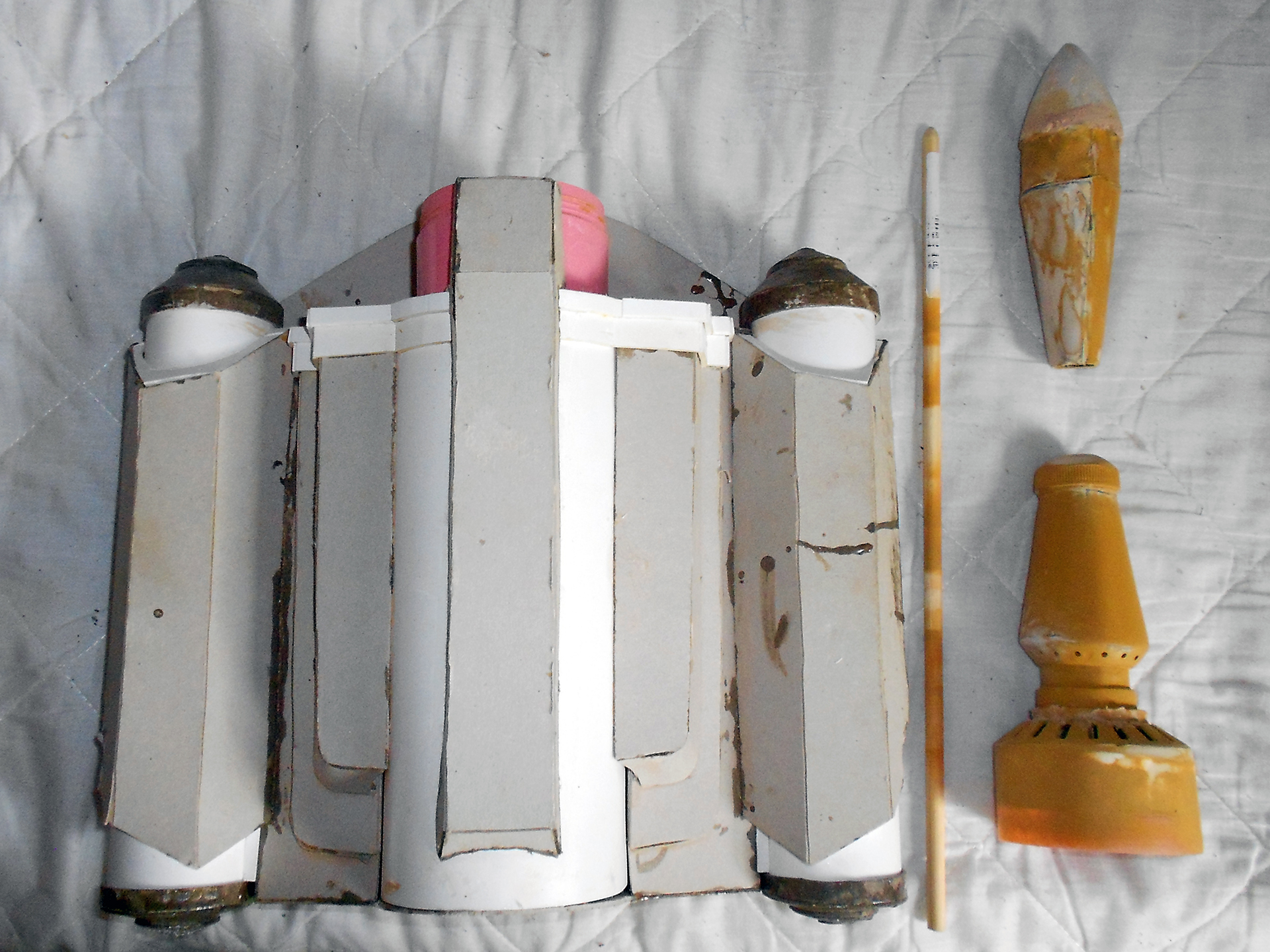

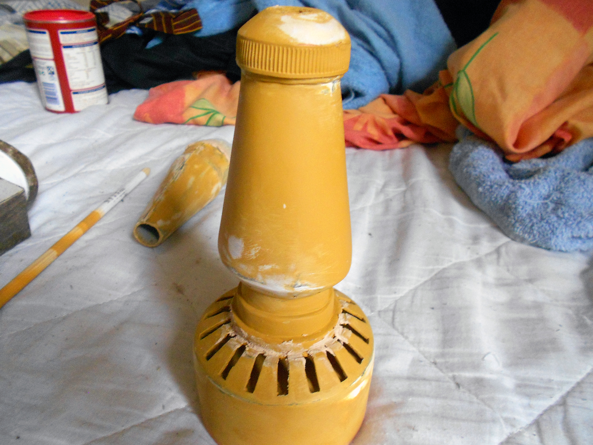

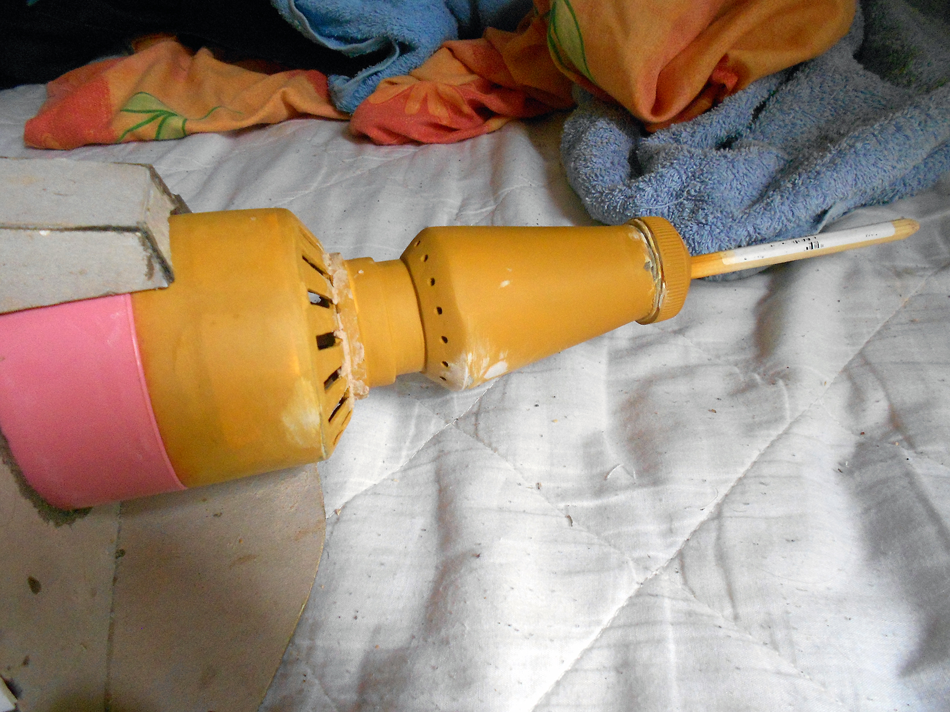

Not done a lot the past few weeks. I'd suddenly got the urge to work on my jet pack missile, so that took priority over everything else (given I wasn't looking forward to the bondo work on that part of the jet pack, I made sure not to waste any enthusiasm I had). A couple weeks later, it's still not perfect but I've gotten the bulk of the missile done. I think I may have to live with a little unevenness. Remember kids, lay a good foundation of work; don't expect to fix mistakes in the bondo stage if the cardboard stage is shoddy. I should have probably broken down the missile even further than the three segments I actually went with so sanding wouldn't be so difficult. But alas, progress has been made so I'm happy with that.
The Jetpack body has been fully built up and is just missing piano keys, greeblies on top and thrusters. For the missile, I have the top piece, middle piece and the bottom piece (the middle and bottom are glued together here. To hold all the sections together and bring some support to the missile, a wooden dowel runs from the tip all the way down into the jet pack body. This also helps me line up the pieces.
I replaced the horrid cardboard grooves I made on the top of this part with a Sunny Delight bottle cap, giving me much neater lines I could never hope to emulate myself.
And this picture shows the attachment method. With a shower gel tub glued onto the jetpack, the missile simply screws on top. I know this means there will be a screen-inaccurate groove where the tub lid screws on, but I like the idea of being able to take the missile off for transport.
I've still got a lot to sand and bondo. Now it's just really the tip of the missile to concern myself with. I'm starting to feel the grind of the costume now. I don't want to quit the costume, but I am finding it more difficult to get myself to work on it. :/
