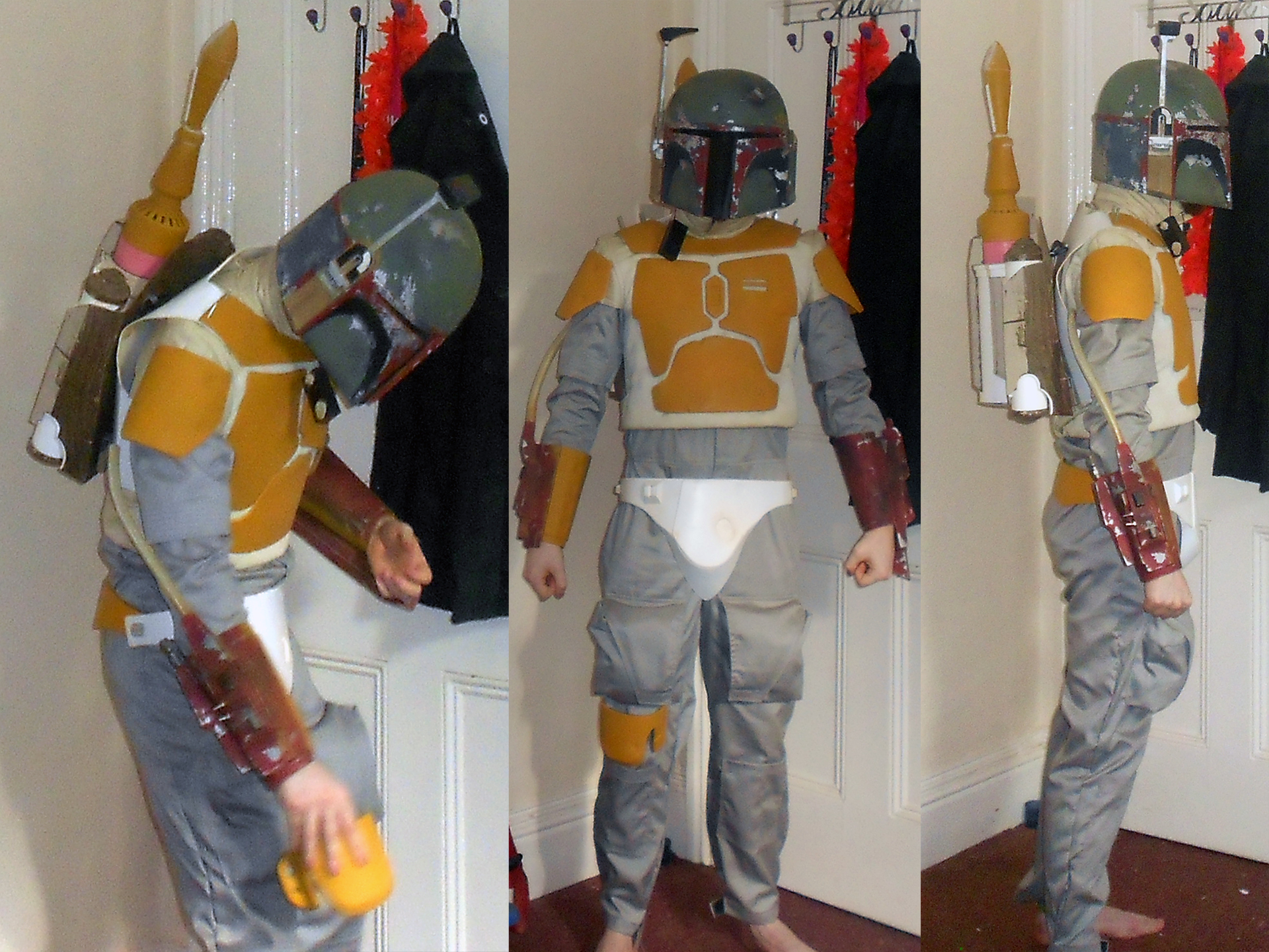

I finally suited up with what I have and the jet pack really brings it all together.
I sewed a tighter seam on the left arm and leg to see whether it looked better but I can't really see a difference. I have realised one thing though. It is HOT in there. Just five minutes and I'd already sweated into the back of my flight suit where the harness was. How do you guys cope? Is under armour a good investment. I understand it keeps the sweat off you, but it is another layer.

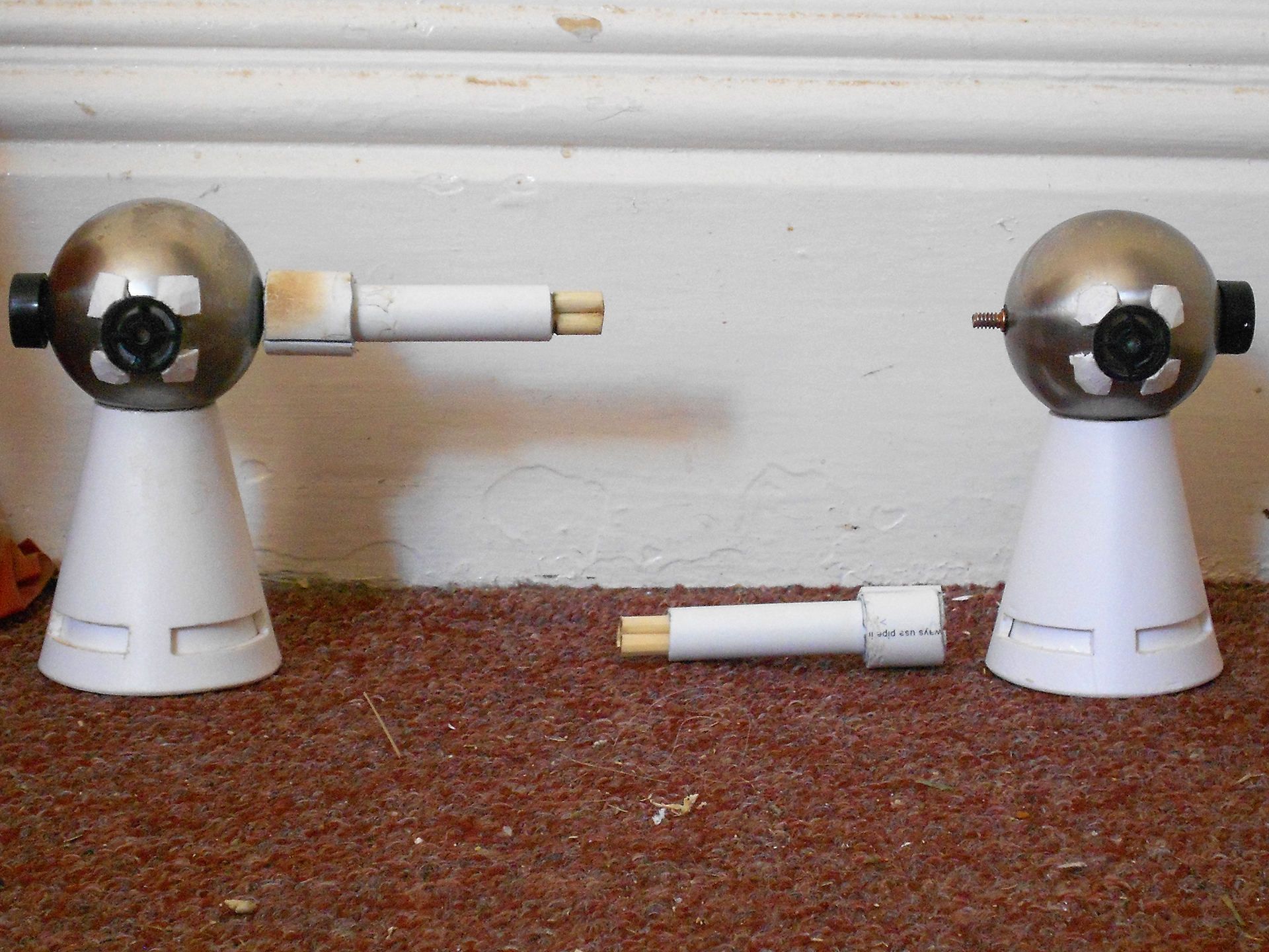

I found some old metal balls off the ends of a curtain rail in my cellar that are a similar size to the thrusters so I'll be using them. From the weight, I don't think they're solid but I'm having trouble cutting into them. However, they have screws which happen to match some nuts I have lying around. The missile is done, thank god, and is sitting pretty on top of my jetpack. It's a little uneven but I'm happy with it. I bought some more supplies yesterday (celebrating the fact this should be the last time I'll buy bondo for this project) including paints for the armour.

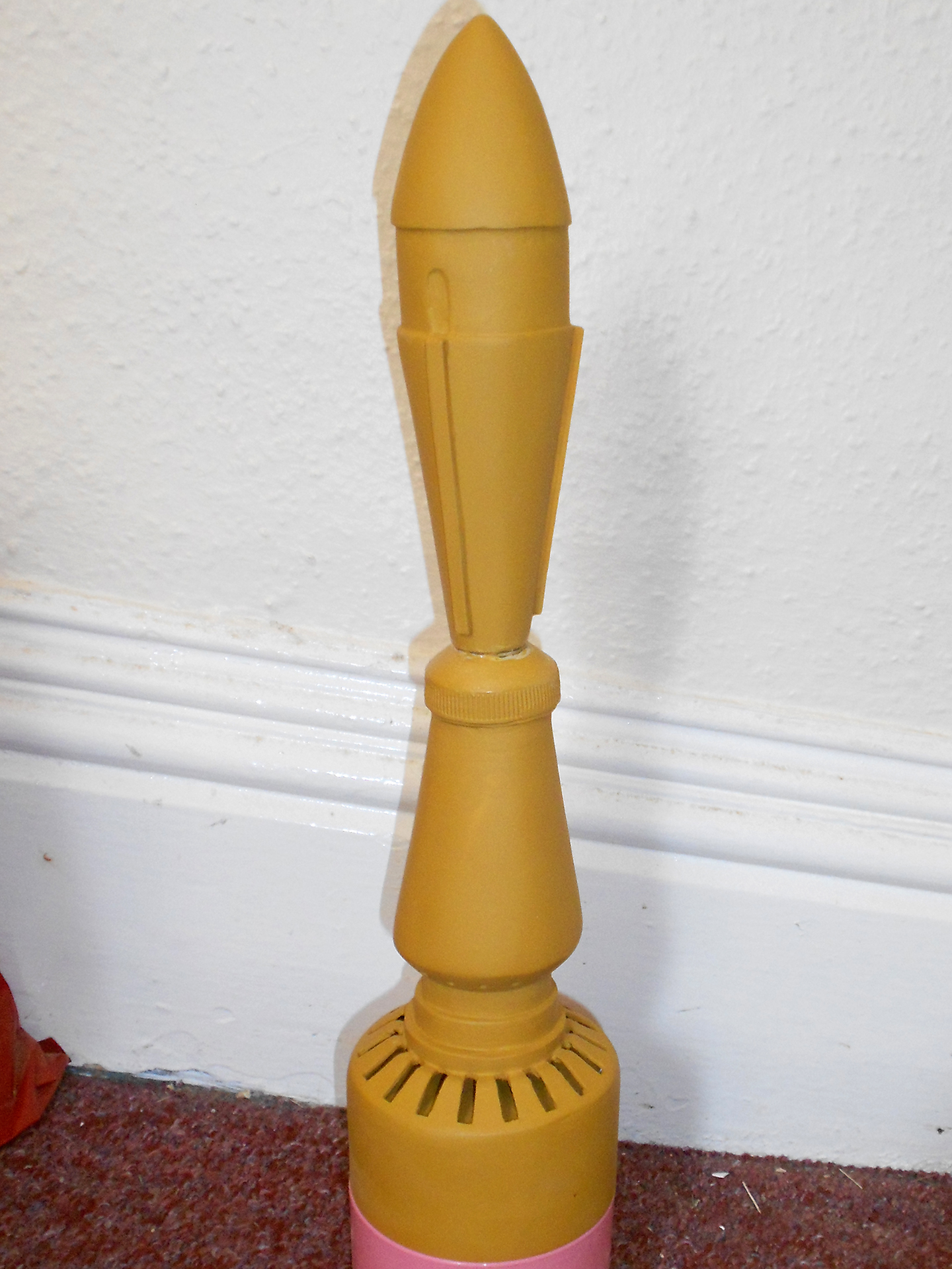

Some progress. Here's the finished missile now awaiting paint:

With this completed, I started work on the thrusters. Using the metal curtain rail ends as a base, I doubled up spare sintra for the cones and used greeblies I found in my bits box to create the inner circle detail. Since I can't cut into the metal balls with the tools I have, I'm having to stick them on top of it which isn't ideal and will require bondo to give the illusion that the detail is sunken in. I used small slices of sintra to use as support for this.
I'm not sure how sturdy these will be. Ever since I started this costume, I was concerned that the thrusters would be the most vulnerable part of the costume. Using the screw attached to the curtain balls, I built the connector out of 5mm PVC pipe (layered messily to the correct thickness) with a nut inside that the ball can screw onto (nuts, balls, screwing; if I was a lesser man, I stoop to making a joke :D).
Essentially, the connector slots in to the fuel tanks. The two wooden dowels inside the pipe slot into an oval shaped hole on the far side of the tank, the 5mm PVC pipe slots through the centre of the tank and the overlapping pipe sits flush with the outer side of the tank. If that makes sense. Then, I'll epoxy the thrusters in their washers and bondo over the gap. This means they won't turn, but that's a sacrifice I'm happy to make. Especially since I'm sure people will love fiddling with them behind my back and I'm one of those people who'll be upset if there's a picture of me with random thruster directions.

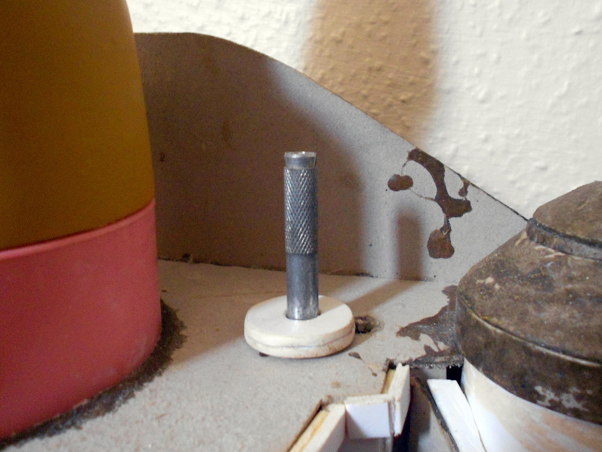

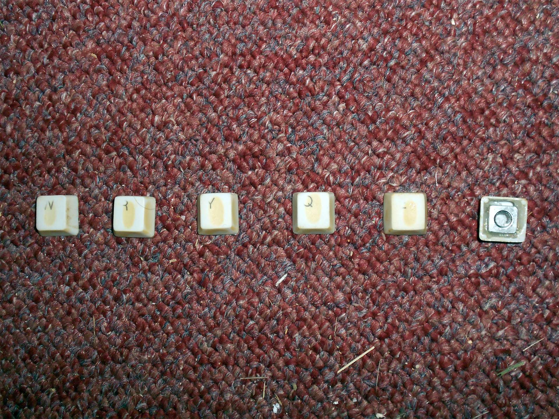

And finally, the keys for bolting the armour. Just regular keyboard keys (again free) sanded flat and gratuitous epoxy to attach the nuts inside. I'll bondo over the nuts just to be safe.

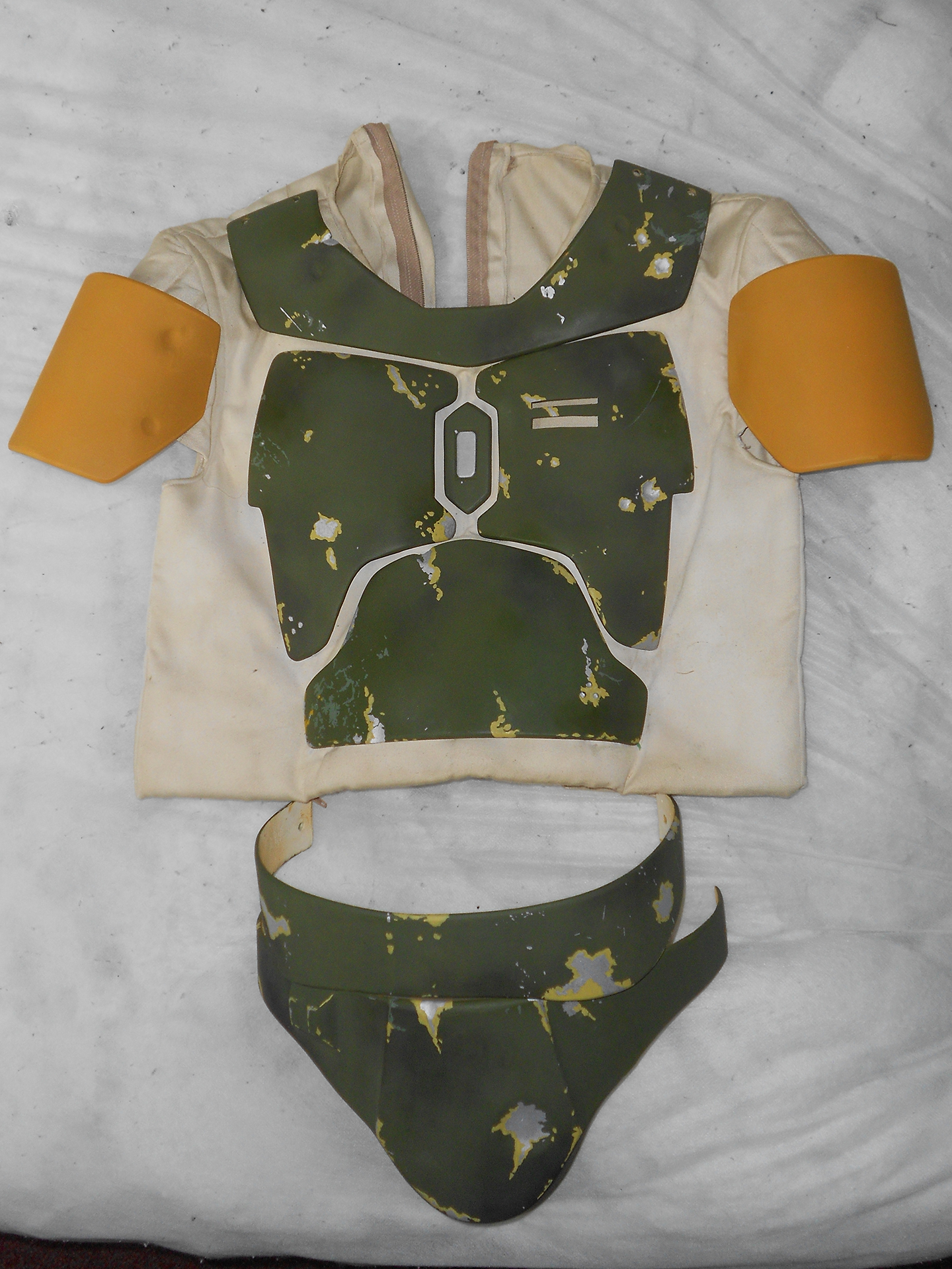

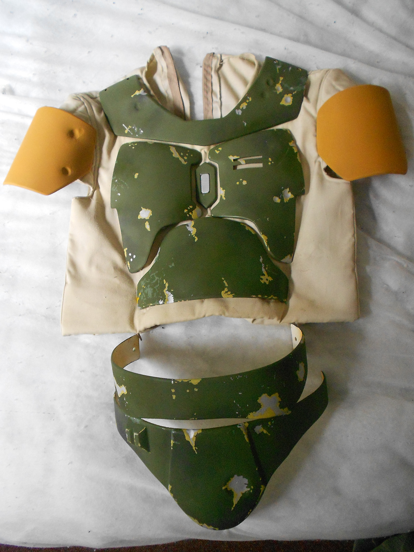

I've painted my armour, topically as with the helmet.

Not everything is in the right place and some edges are a bit fuzzy/brushstrokey, but it comes together nicely. When I was painting the yellow, I was concerned it might be a bit too bright but it looks okay when finished. How does everyone weather their plates? I misted black over the green and then painted the yellow and silver on top of the black weathering, although I've seen people who mist their black over the top of the yellow/silver chipping.
All that's left is to paint on the symbol on the left breast plate. Not sure how I'm going to do it tbh. I think I'll have to make out a stencil, I definitely don't trust drawing a circle with my freehand skills. I haven't painted the back plate yet. The time at which it was taking me to coat the other pieces with the green led me to believe I'd be at it for hours before I got a decent coverage, so (prepare to wince) I'm going to get a rattlecan as close to green 117 as possible to do the back plate. Since you don't see much of the back with the jet pack in the way, I'll live with any colour differences and hopefully mist in the difference.
I've still got to paint the knees/shoulder bells. A difficult task I'm betting given the transparency of yellow 154 but several light coats should do it.

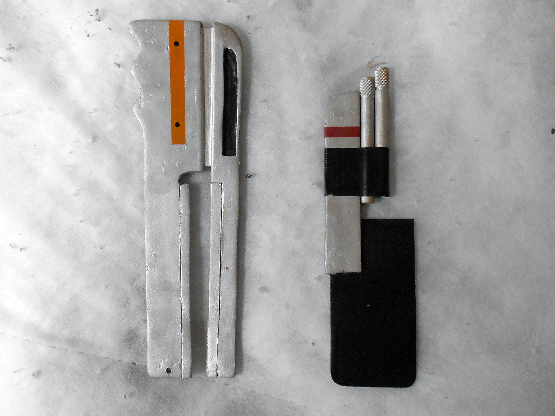

Shin tools are filled and primed ready for paint. I didn't spend a great deal of time of these as they'll be tucked away in the pockets.

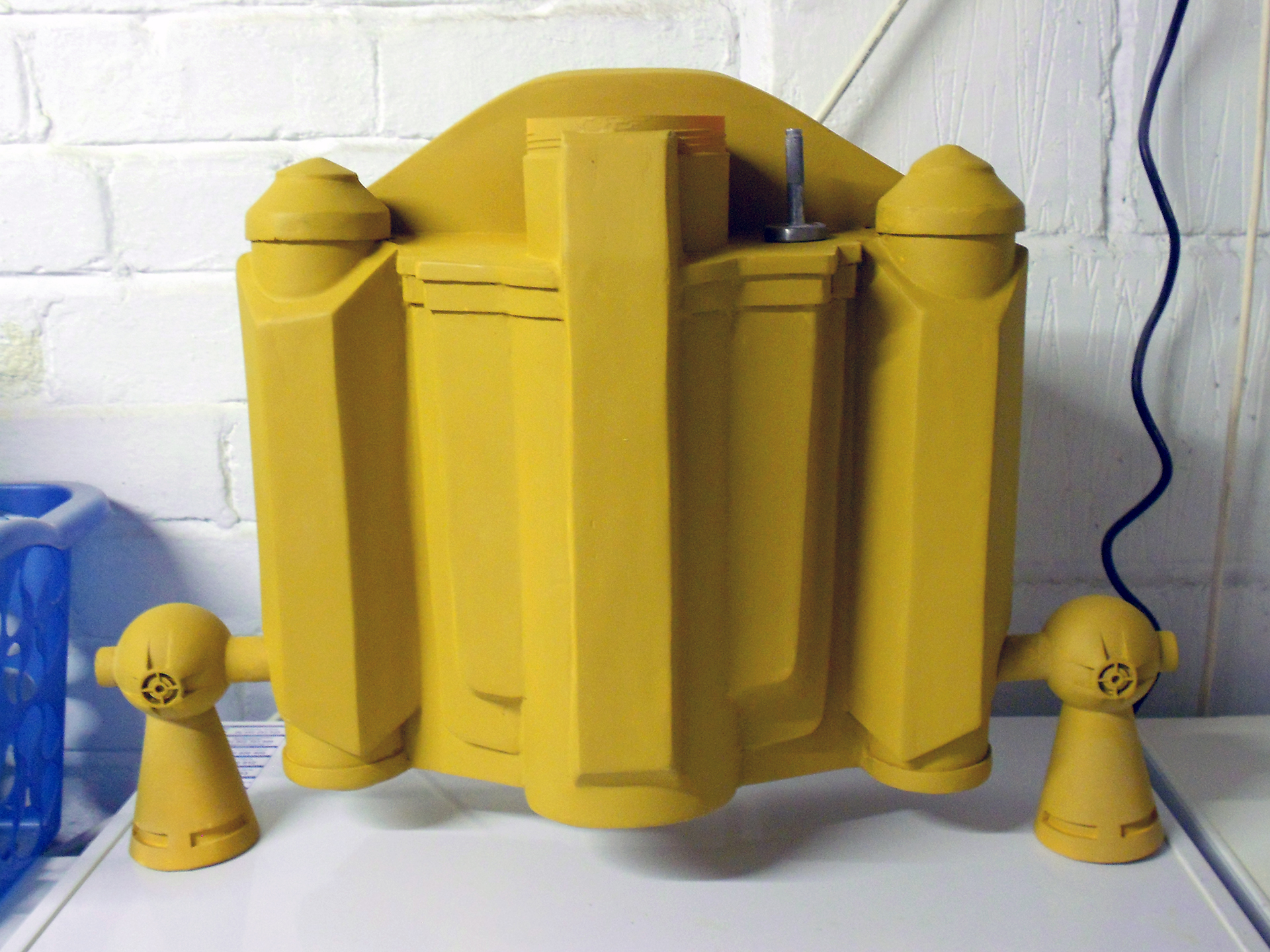

I also finished filling and priming the jet pack thrusters. They feel pretty solid, but time will tell how they hold up. Now the gruelling task of doing the jet pack body.
Nice work all around. Gotta hand it to ya your quite resourceful ! What did you make the anti security blade out of?

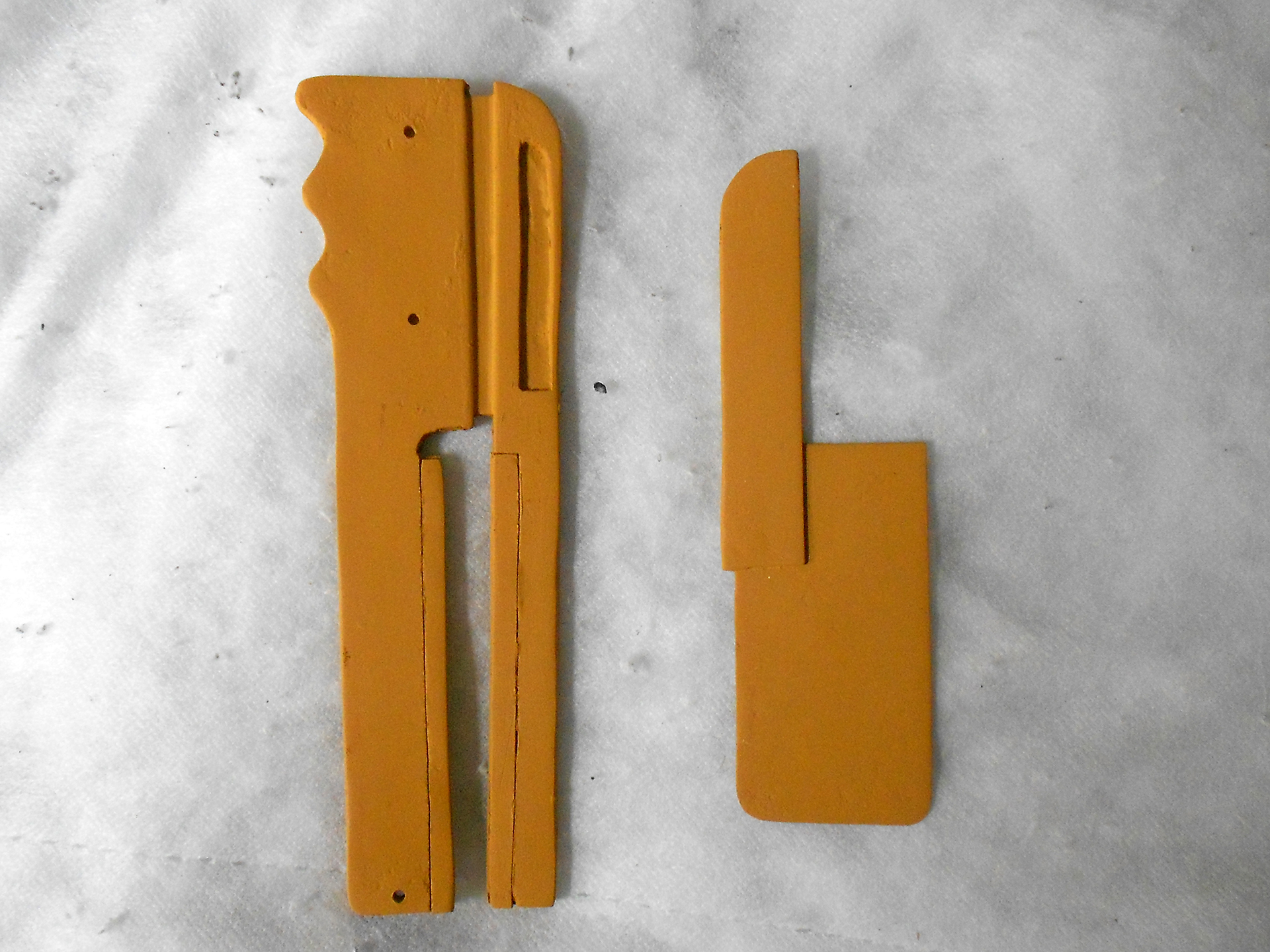

Thanks! Both tools are made from layered cardboard. A centre layer encompasses the entire tool, and an additional layer on either side builds up the detail. I added some spare wooden dowel offcuts for the tubes on the anti security blade with two headphone jack adapters slotted into the end for the detailing.
I could have spent a bit more time on them to smooth out any rough spots left over, and the black part of the squeegee should be stencilled on rather than bevelled out like I did but for something that will barely see the light of day poking out of the top of the shin pockets, they look the part.

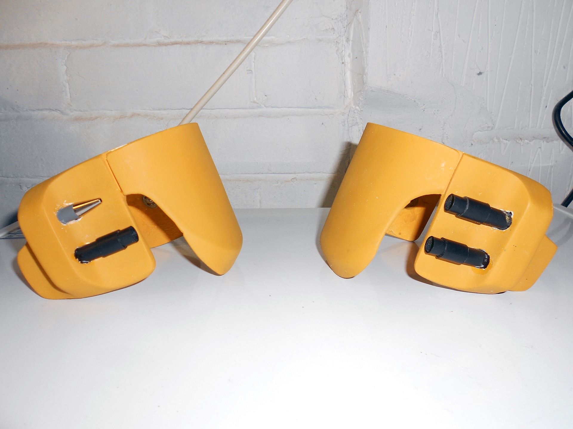

I've cut up some random tubes I found a while back and a pen to provide the knee darts. Again, screen accuracy is an issue, but after I bondo the holes I made for them and add paint, they should look the part.

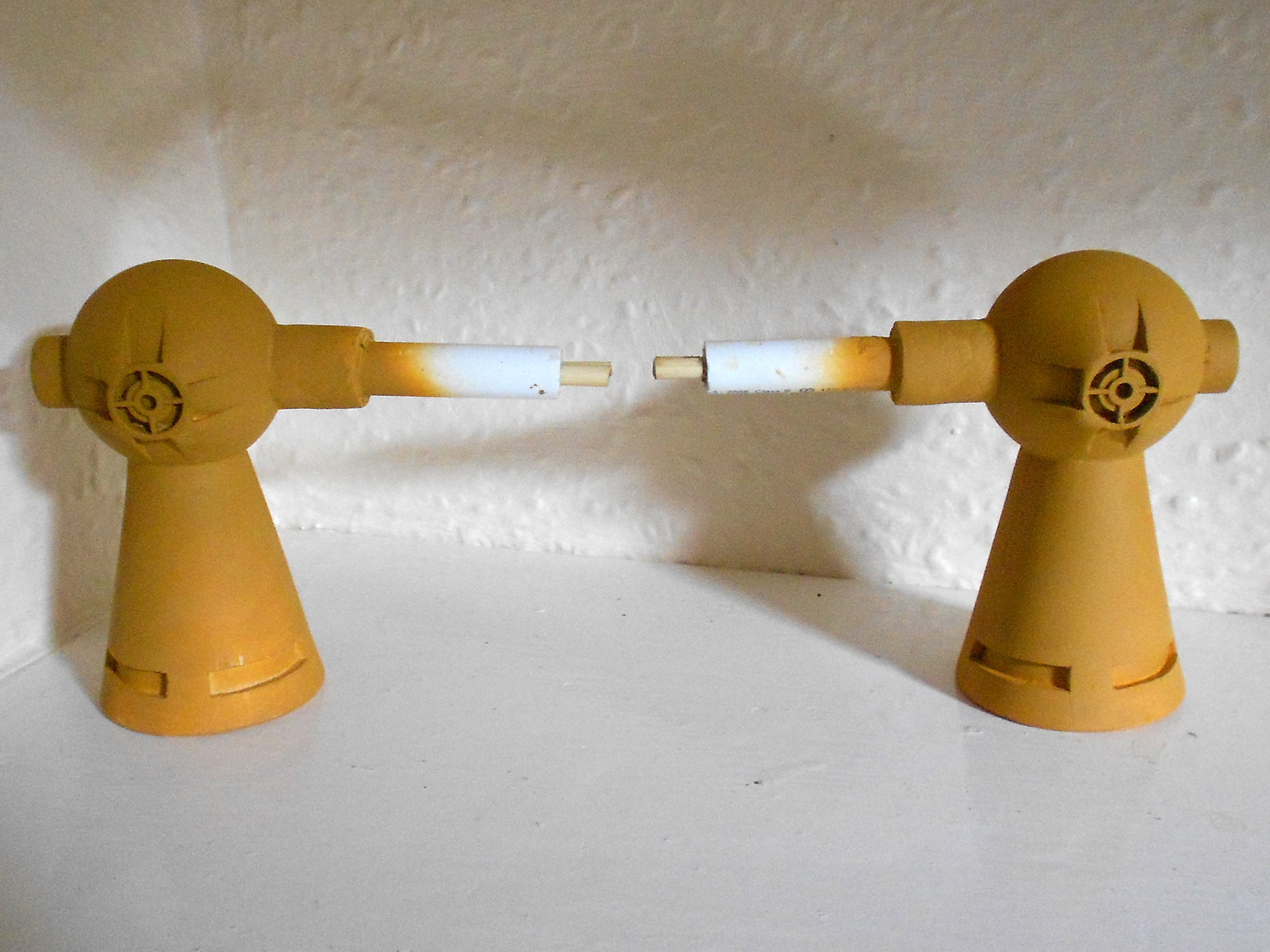

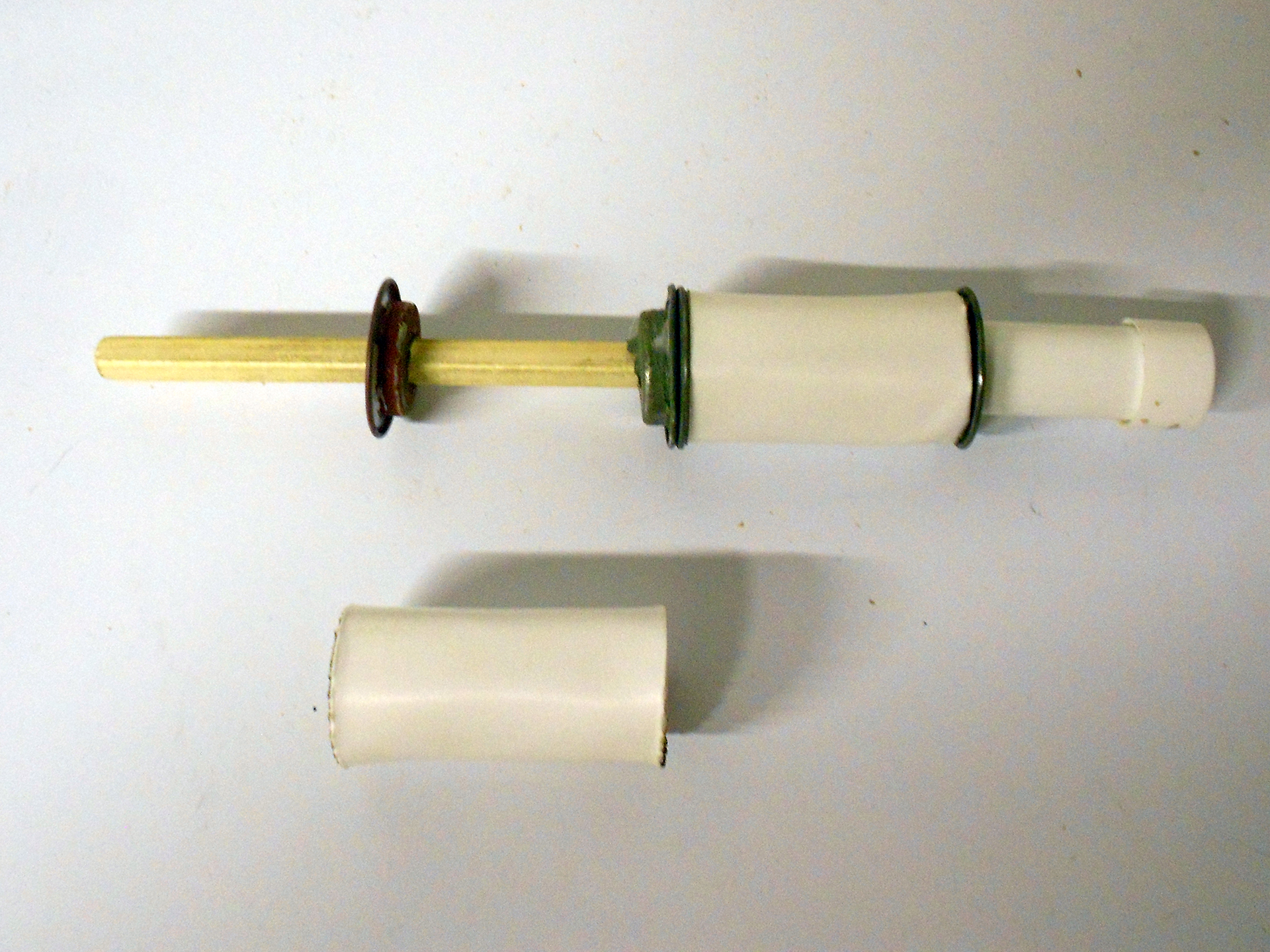

After a lot of humming and hahing about the gauntlet rocket, I decided to give it a shot making it myself. I initially tried a pepakura model, but it turned out far too delicate for my hands and I considered buying one. My problem was that these gauntlets are significantly scaled down and a regular rocket won't work. So back to building one. I'm taking this one step at a time. Using dowel (or a chopstick in this case), I skewered four Humbrol paint lids to it after finding they were the correct girth. I used some PVC pipe for the back tube with a cap slotted over it, but unfortunately I didn't have any pipe that fitted over the Humbrol lids, so I rather messily wrapped some sintra into a tube. The lip of the paint lids will provide a support and contact point for the glue and four lids, arranged as in the picture will provide the length of the tube section. Bondo will level out the messy sintra warpage. The pieces are currently unattached and the picture shows the second sintra tube seperate to show how it goes together. As far as the front end goes, let's cross that bridge when it comes to it.:confused

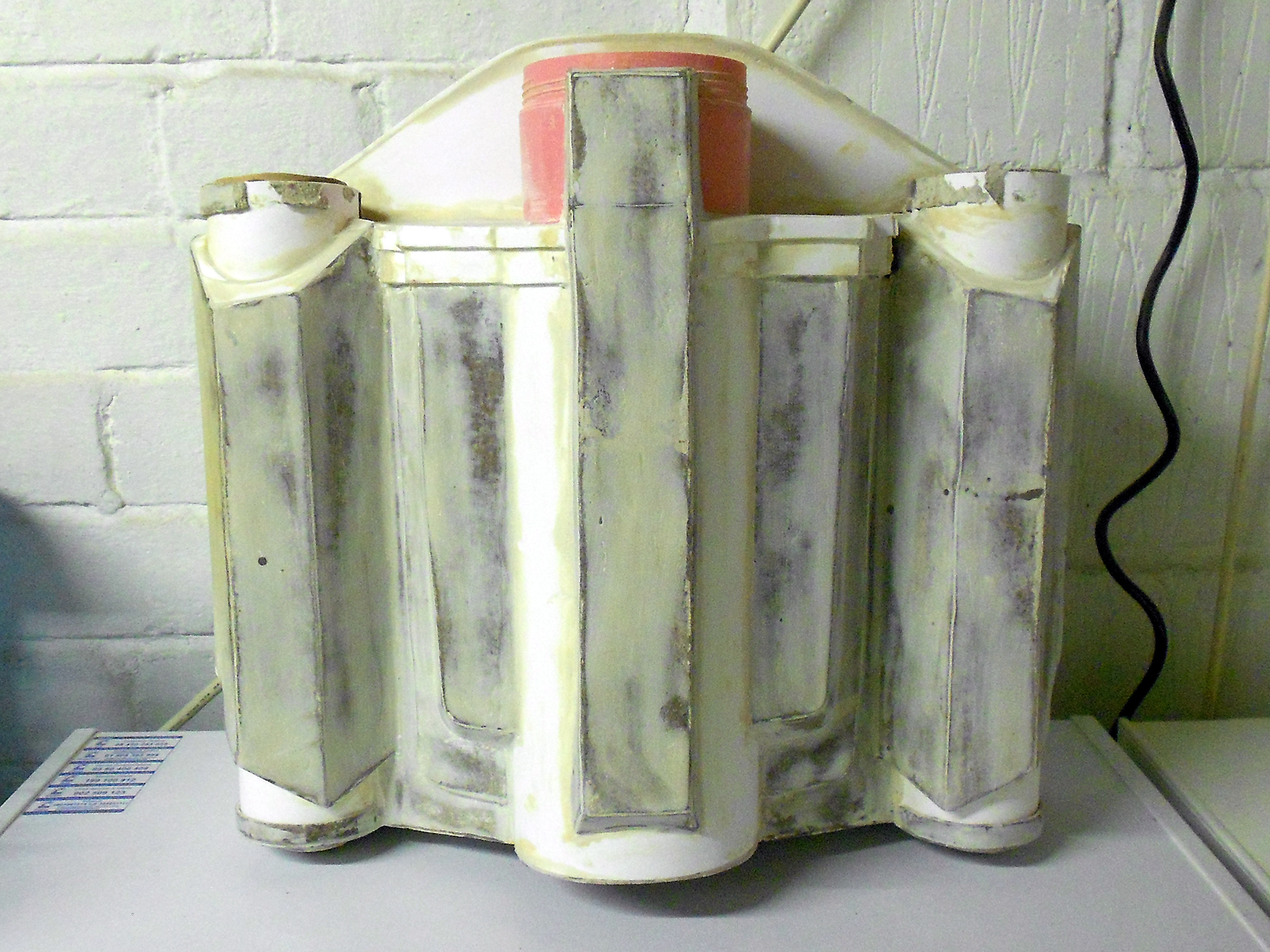

I've done a first pass of bondo on the jet pack.
I pulled the rocket tops off to make it easier to get in and sand things down. I've given one half a spray with the filler primer to see any imperfections and thankfully, it's smoother than I anticipated. It will still need a bit of work though.

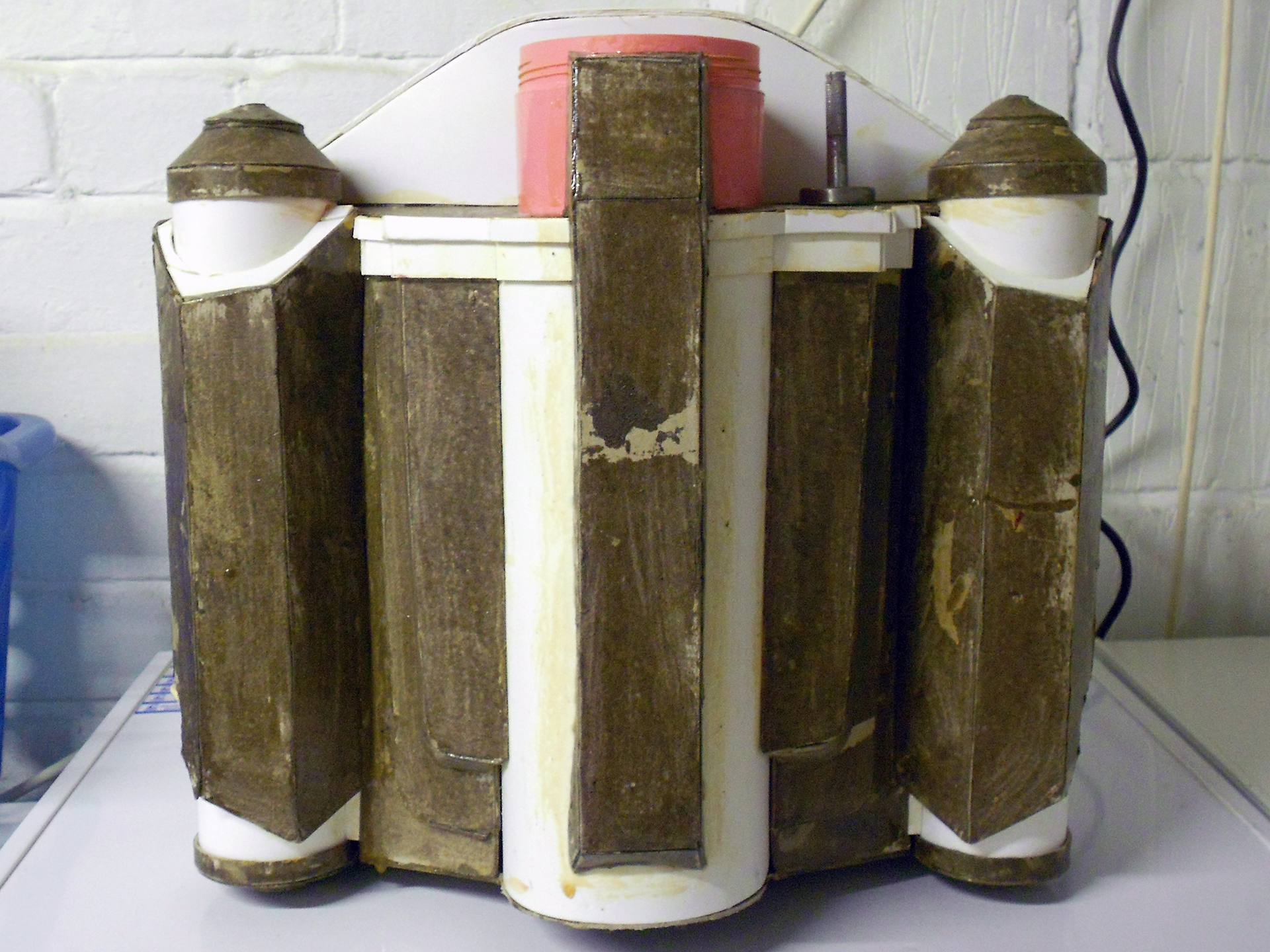

And here it is.
Thrusters have been slotted in place. They fit snug, but they'll need to fixed more permanently.
