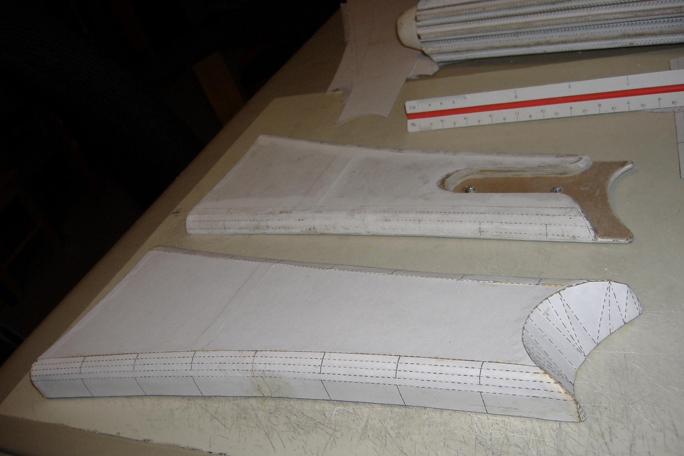

The way I constructed mine was I used the card stock as a shell & then glued architectural cardboard onto the inside of the card stock. This created a shell. I then cut piece of the card board & layered the inside creating 2 solid halves. I filled in the areas in the radius with smooth cast to tie it all together. I didn't take any pics of this. You can see some of what I did on the side with the recess for the stock attachment with the layer cardboard. When glued together it got a coat of smooth cast on the outside. Hope this is some help to you if you want to give it another go.
I am fairly new to pepakura. The stock printed out great and assembled perfect! I fiberglassed the inside of the two halves, but dispite having a good mix ratio, the resin never fully cured and ended in failure..

There is definitely a learning curve to pepakura. I have had similar issues with the resin not setting up at times & not sure why. But over all I am rather impressed with smooth cast products. Glad to hear you are going to give it another go.
