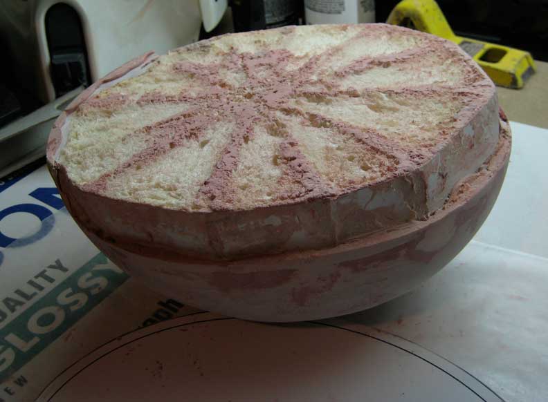

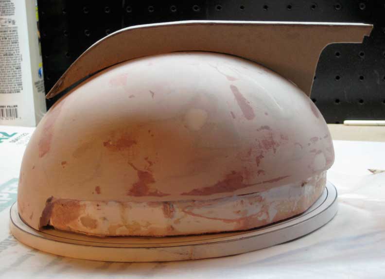

I haven't made much progress, but will show what I've done so far. From the front and side templates of the dome, I created a framework. You can see the framework on the underside of the dome in the first photo. I filled the framework with expandable foam and finished it off with body filler. It still needs some work. At his point I'm using the Kelleggs helmet as a base knowing full well it will be completely different by the time it's finished, but it helps me to have a starting point. As I build I will continue to refer to my templates and make adjustments as needed. From the templates I also built the fin and a starting point for the ears. None of the pieces are actually attached yet, just set up for the pics.
That looks like progress to me! Beautifully done too. The dome is a crucial part of the model; you've got a great start.

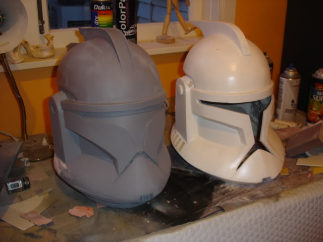

Nearly done with mine, still a bit of work to do on the back, and some general tidying of lines and details etc
no kellogs/hasbro ect used in these
