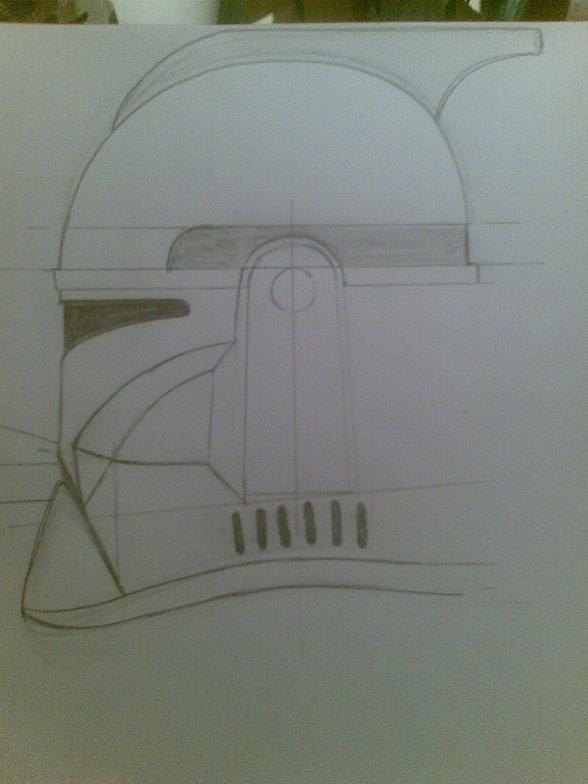

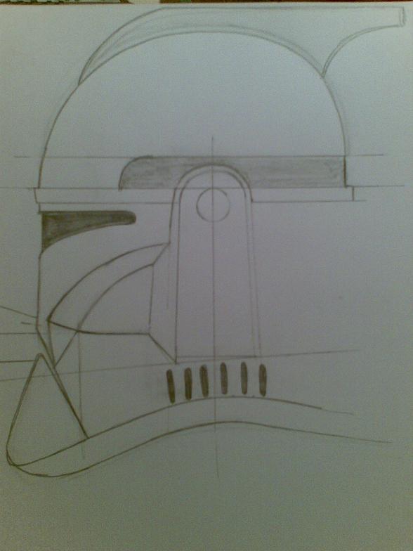

Ok, early days but here's where I am with my first profile shot, I invite any and all critiques as that's the whole point, and yes I know the fin is missing, second pic shows a few minutes later when I had decided the done was too tall, also mocked up a rough fin :thumbsup:

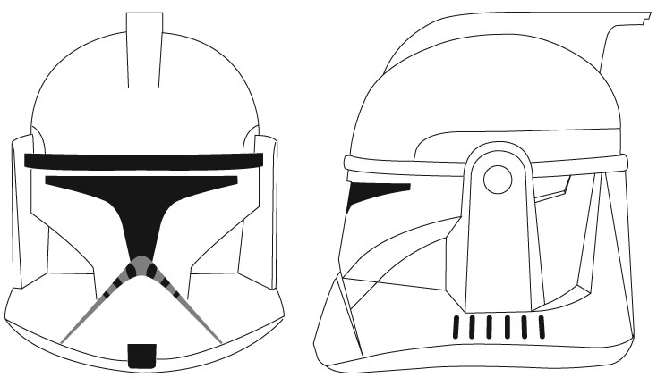

Here is my drawings done in Illustrator over actual screen grabs. I can email large versions of these to anyone who would like them.
Try try again :thumbsup:
Even better. Nice drawing.
Here's my obsevation thus far, The cheek triangle look a little curved. My thought on that is that the bottom most leg of the Cheek Triangle should be parallel to the Disk.
Observation #2: For the sake of one's nose, the angle between the face and the disk need to be increased by enough to allow for the distance between your nose and your forehead. This is two fingers for me.

Ok I think I am understanding what you are saying, and the angle of the cheek line did seem a bit curved to me also, I should stress that the drawing I have done is at half size, I just wanted to get the profile I was happy with before going full size, this is pre-preliminary prep work :lol: As far at the ears I agree that they taper from front to back as you look down on the helmet, they are wider at the front
Also I think the 'base curve disk' swoops in a little more at the front of the helmet, beneath the chin as per Firesprays image, thanks for that by the way its a good one

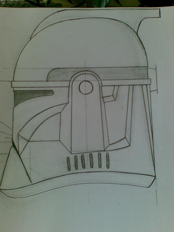

Here's where I am at so far, I elongated the dome slightly, narrowed the visor, added the rear quarter detail, I expect I will make yet more adjustments :thumbsup:
Yep, thats looking much nicer. Ilike even better if your drawing to scale, because building it in scale is good practice before commiting 1:1 scale resources to the project. I have built several quick scale models in an evening to test building technicques before going full scale.
My nose will thank you to angle the front more. Anyone who has worn any form of clone helmet, smashes their nose.

Firespray, your Illustrator version look just like the digital model. I need to get illustrator. Can you generate other views? Top? Rear?
What gave me an idea that they were wider at the front was this shot of the EFX helmet, thanks to Jez at starwarshelmets.com hope you don't mind the use of the image :thumbsup:
I'll see what I can come up with as far as screen grabs. I believe the Star Wars Chronicles Prequel edition has CG photos of the back view and possibly a top view. I don't recall if it shows the top view but I'm thinking it does. I'll look this evening. If so, I can scan these and draw them as well.
