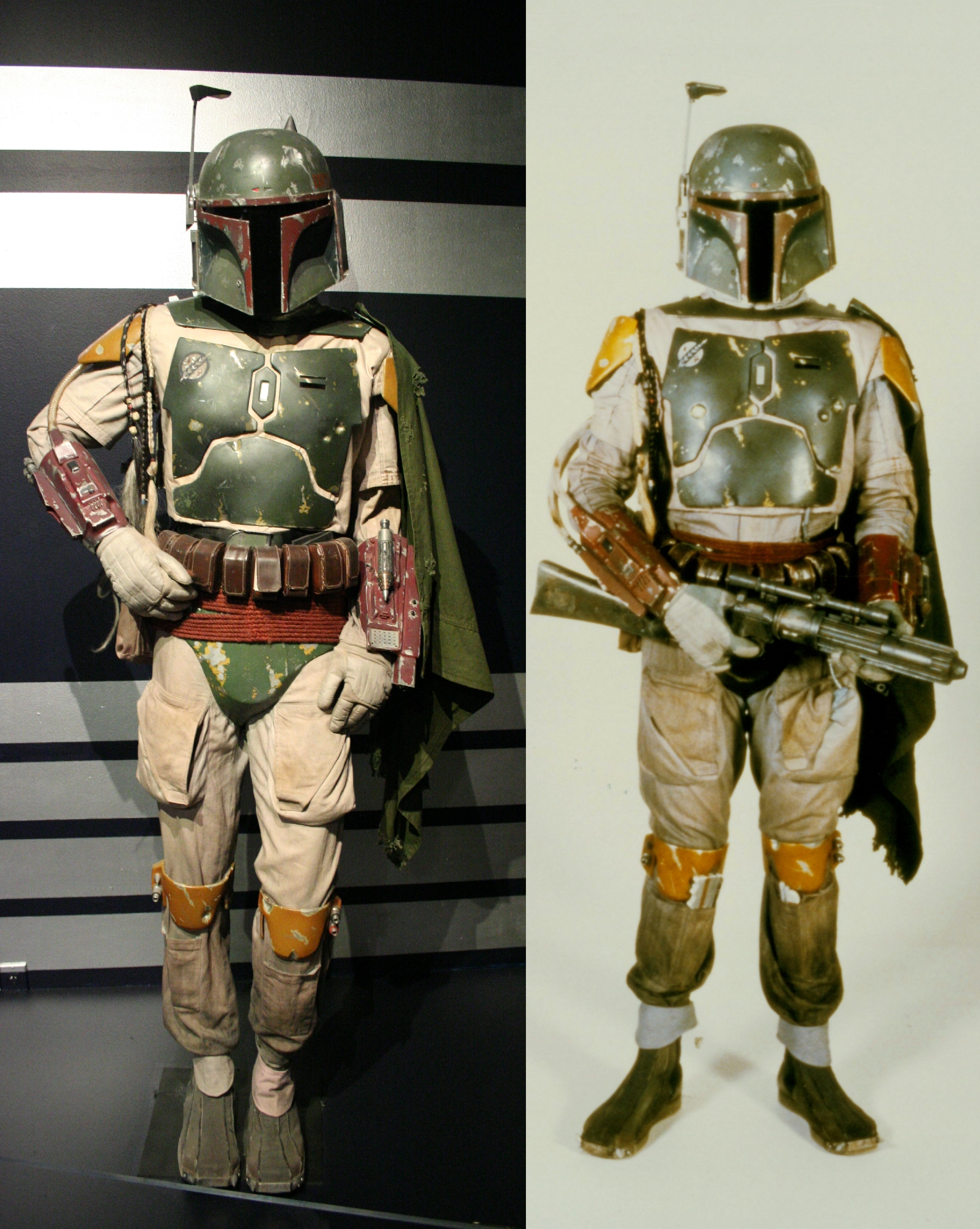

The rest of the costume in that gallery is ROTJ, whoever gathered the costume from storage for display just grabbed the wrong cod plate. In every display of the costume there is at least one part that doesn't match correctly because the average person isn't as crazy as us. Best to reference movie source material to find out what parts are accurate, then use the gallery to find good close up parts from various exhibits.
That's not entirely true. The right chest plate is not the ROTJ Hero (it doesn't have a dent), the jetpack is from the ESB Promo #2 suit (the ROTJ Hero jetpack is on the AoSW/C-IV suit - or ROTJ SE), the left knees and the right gauntlet is from one of the ROTJ stunt suits:

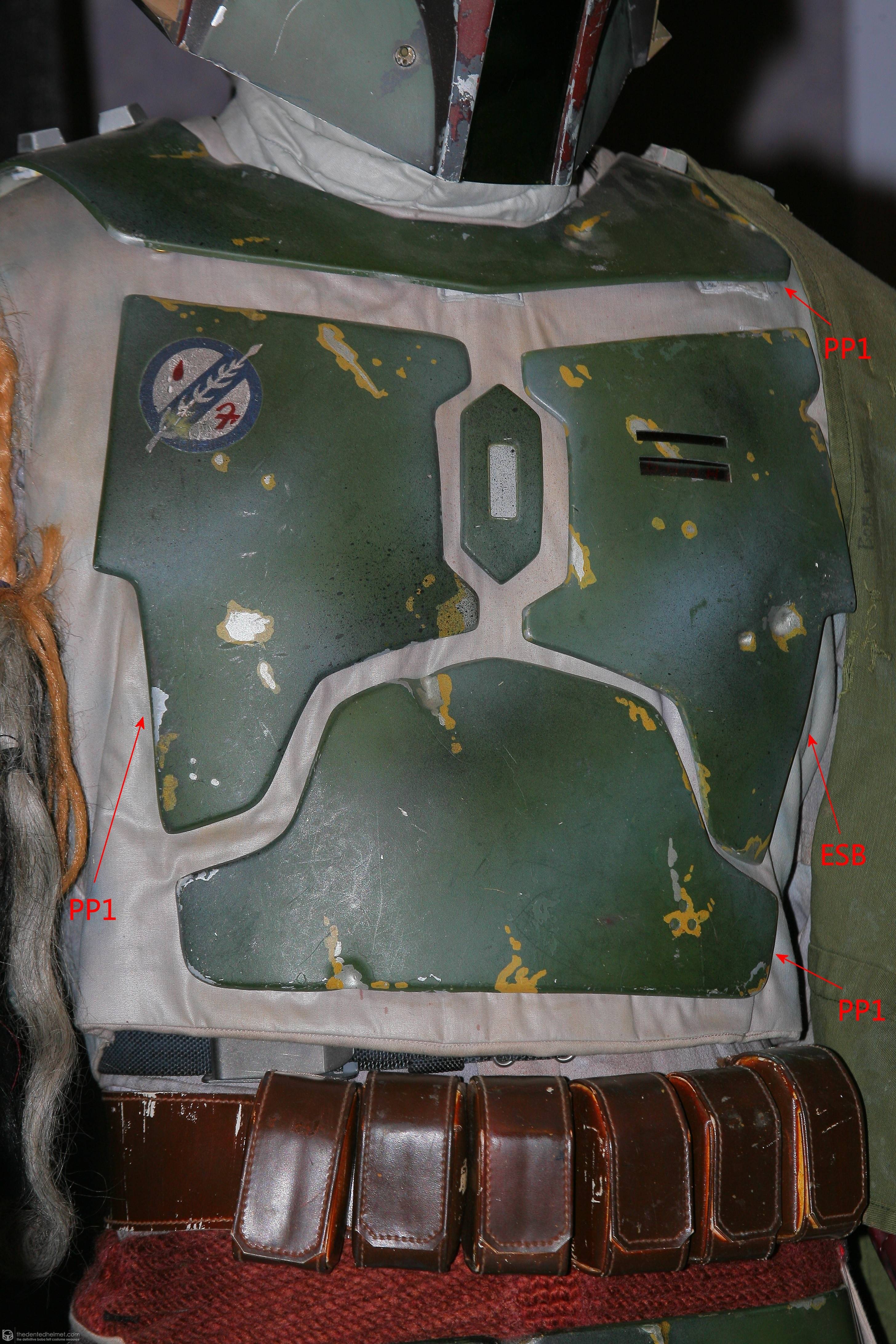

Do we have a gallery for a complete ROTJ workup that contains closeups of individual components? Even if the gallery had to be shots from multiple exhibits where necessary, that would be invaluable to those of us just starting out. I'll admit that I'm pretty lost at this point, I've gone down the road pretty far on painting and I'm not sure I can rely on what any given gallery labels the armor. Especially now that the 501st is updating the crl.
RafalFett can you clarify the dent on the right chest is for the hero stunt or something entirely different maybe SC or one of the promos ? Which one should have the actual dent not just the damage for it ?
Only the ROTJ hero had the dent in the right chest plate, the rest of the right chest plates are dentless.
