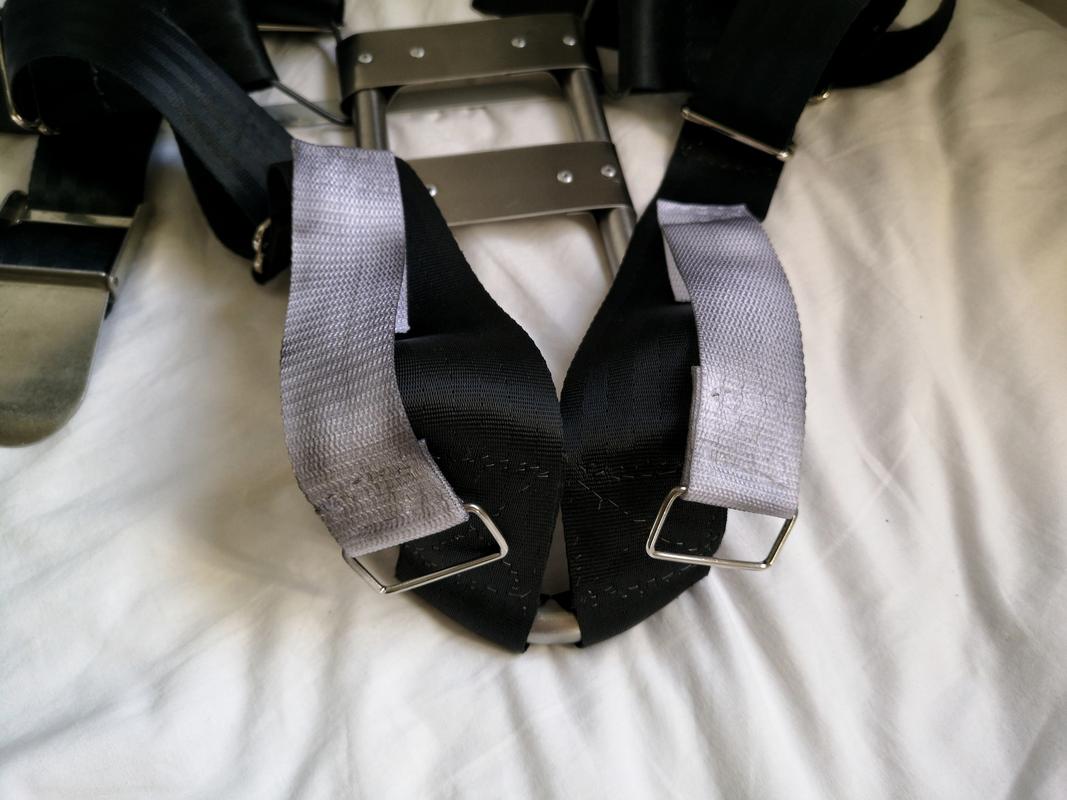

Replaced my shoulder straps on the JP harness to white nylon ones.

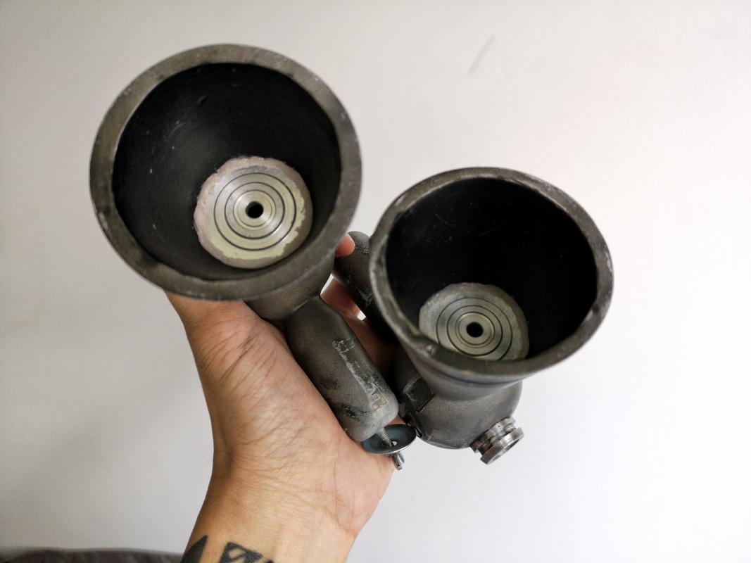

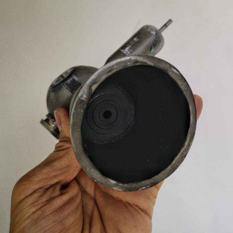

Installed a more accurate JP stabilizer from MachineCraft and removed the dental file.
Installed JP thruster discs from MachineCraft

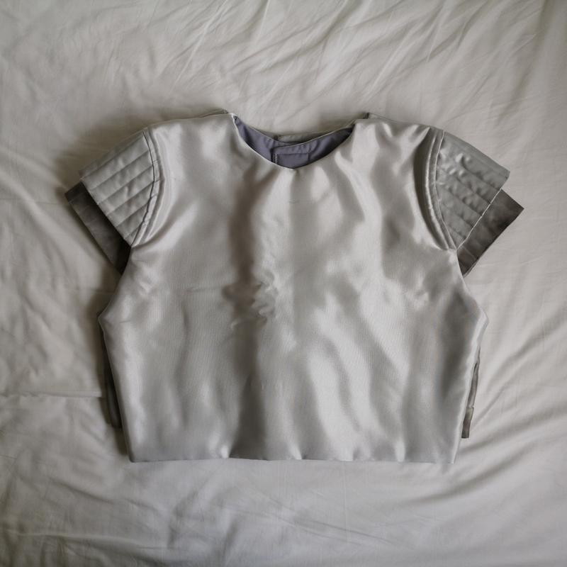

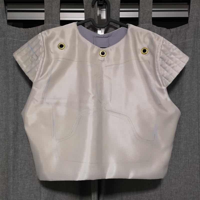

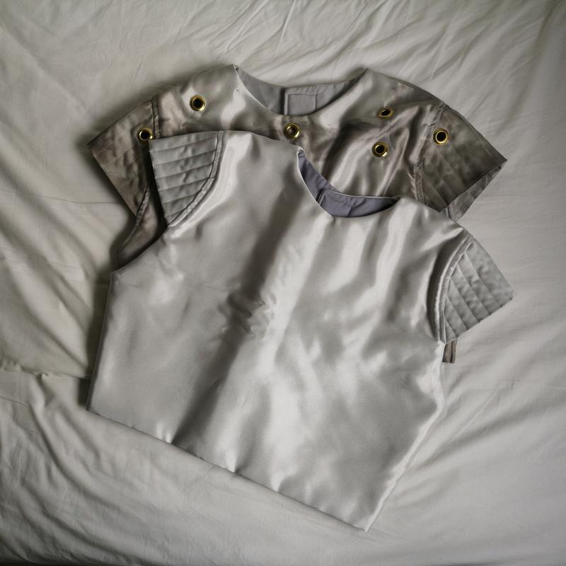

My new vest from Arkady arrived!
The discrepancies with the shoulder width on the previous one is pretty obvious here and it fits me around the waist a lot better. However the new one will need to be shortened at the bottom. I can only determine the precise amount to remove after the placements of the armor plates have been established.
*To be fair, I must have given Carole bad measurements the first time, resulting in an ill-fitting vest that I was also too lazy to get altered before I punched the grommet holes.

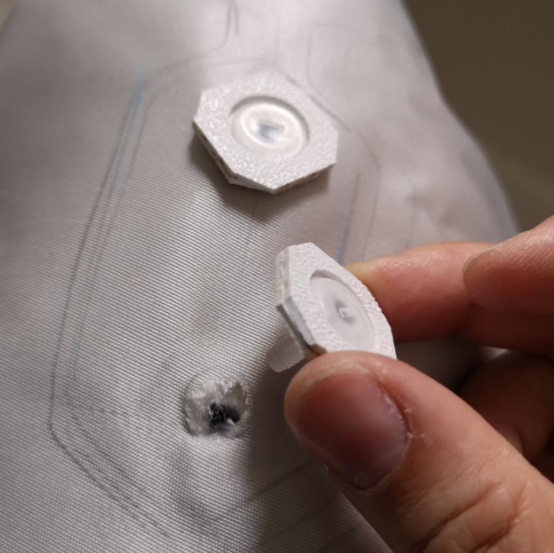

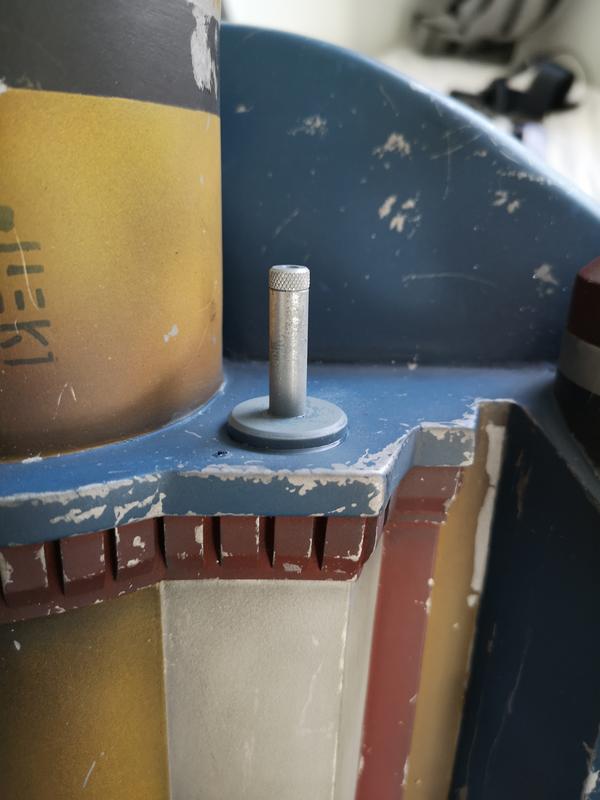

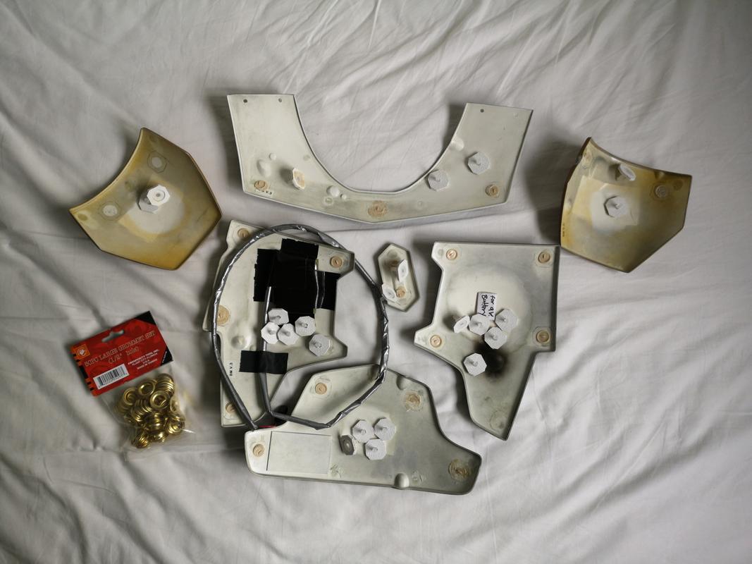

In order to re-align the plastic screws and grommet placements, the screws were removed so I have a clean slate to work with. After this photo, the residual epoxy putty were removed with a rotary tool after this photo. I then sanded the surfaces down with a low grit paper to rough it up so the adhesive will "bite".

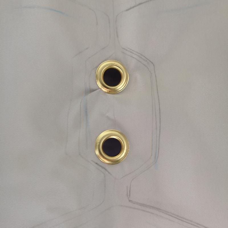

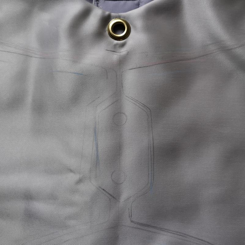

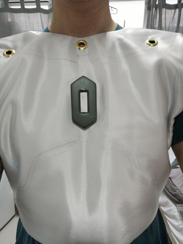

I had a friend help me mark out the placement points for the armor plates and I installed grommets for the collar first. This will serve as the anchor point from which the chest plates, "diamond" and ab plate will correspond.

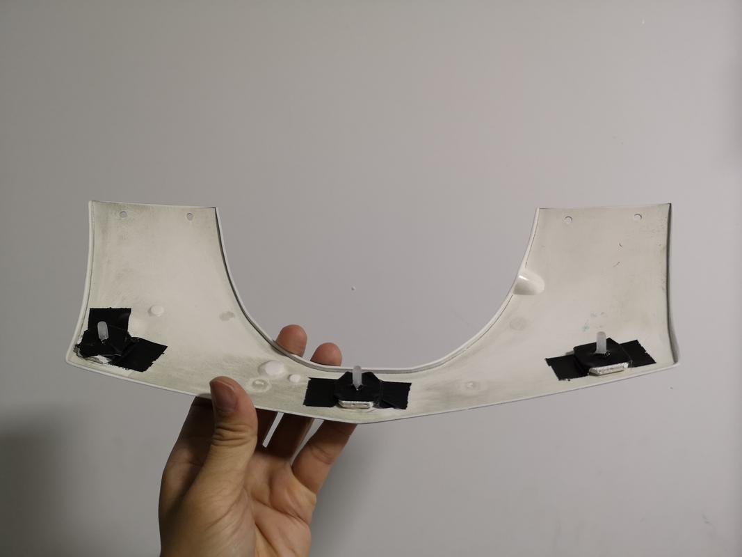

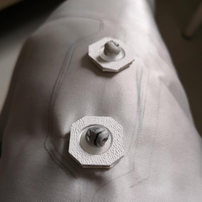

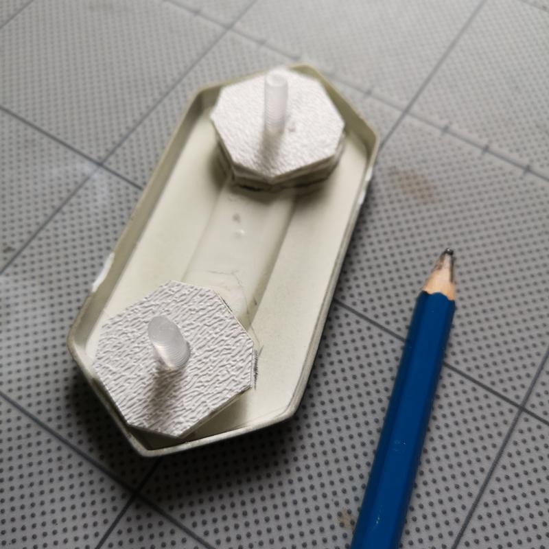

Plastic screws were installed on the collar with a two-part epoxy putty. This time, I reinforce them with tape so the screws will remain in place if they pop off the armor from aggressive handling.

1. Mark centre line on the front of vest and approximate placement points of armor plates. Placements will be further refined as each plate goes on. I recommend getting a friend to help you since it is ideal to do this with the vest on your body.

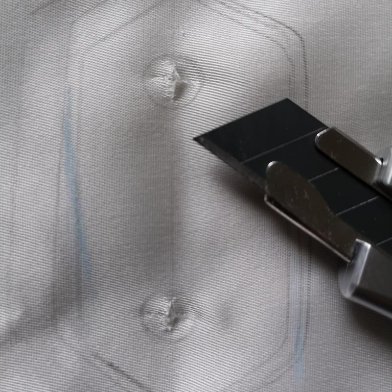

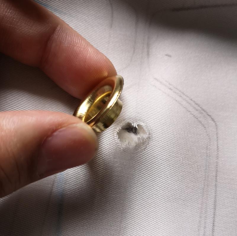

2. Use a grommet to trace the holes within the armor plate outlines. As you can see, the guiding outlines are off centre so I'll have to correct this as I install each armor plate.
3. Cut a cross within the grommet outline and cut the quarters to make a hole.
4. Insert the screw assembly and fasten with nut.

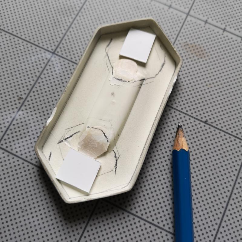

5. Affix blu tack on the base of the screw assembly. These will be contact points for your armor plate.
6. Wear the vest, use a mirror to ascertain placement of the armor plate and press it down against the blu tack. Remember to mind the centre line.
6. Remove the vest, unfasten the nut and trace the base of the screw assembly on the armor plate.

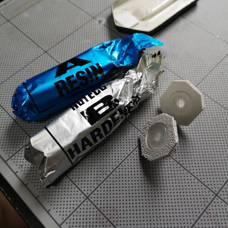

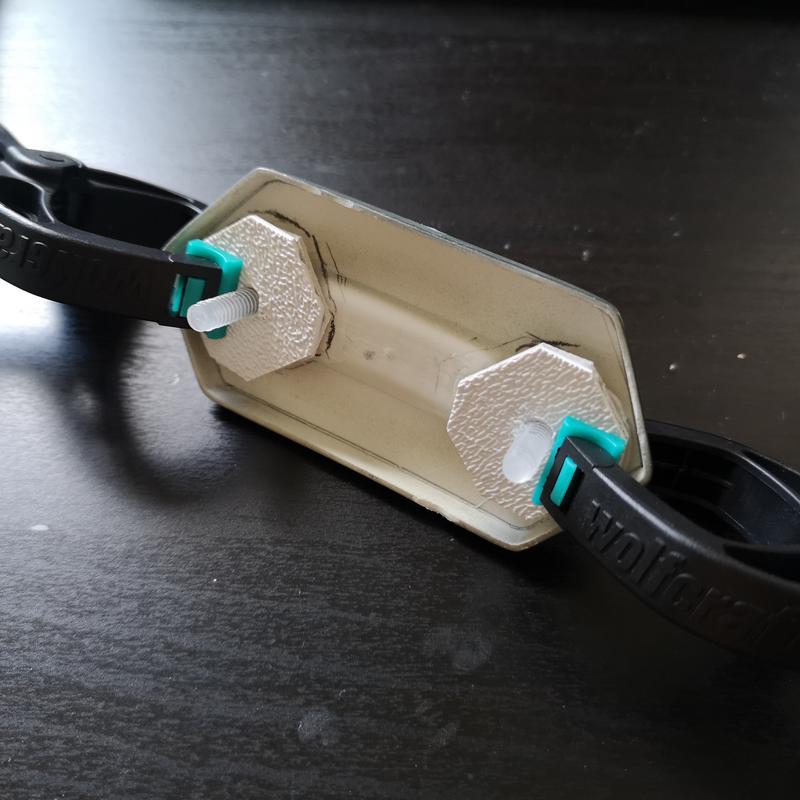

8. Affix the screw assembly to the armor plate with an adhesive of choice. I use a two-part epoxy putty and leave it for 24 hours before handling. I recommend sanding the surface with a coarse grit paper for better 'grip'.

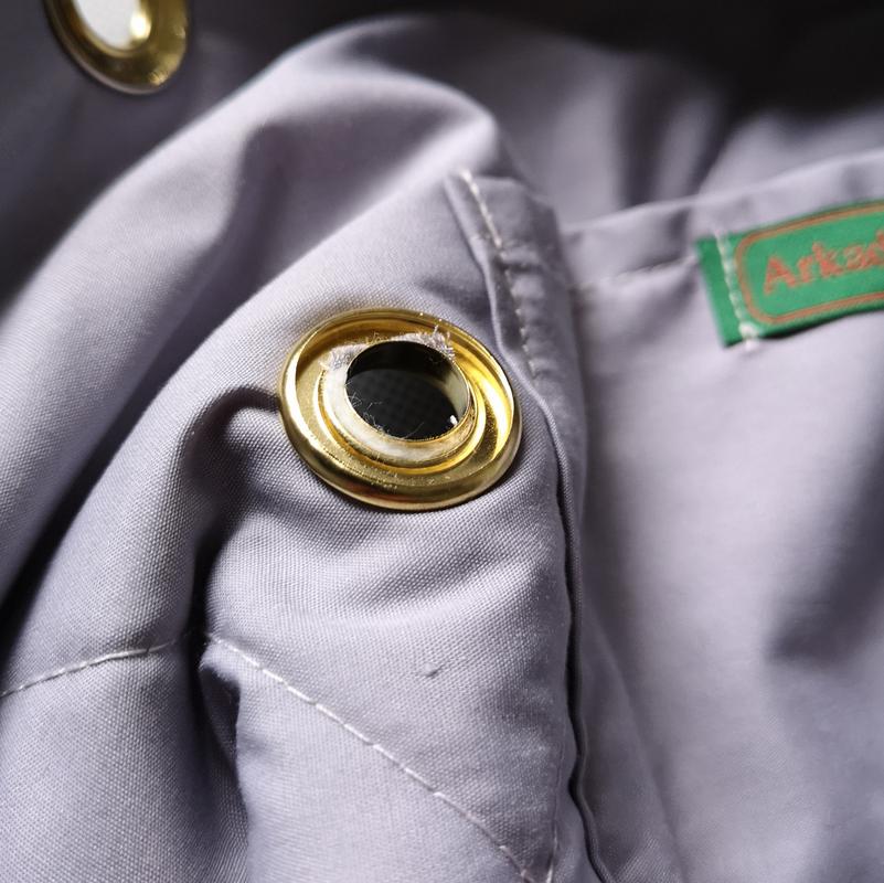

9. The grommets may now be installed following the usual method.
The grommet ring is upside down in this photo. Doh!

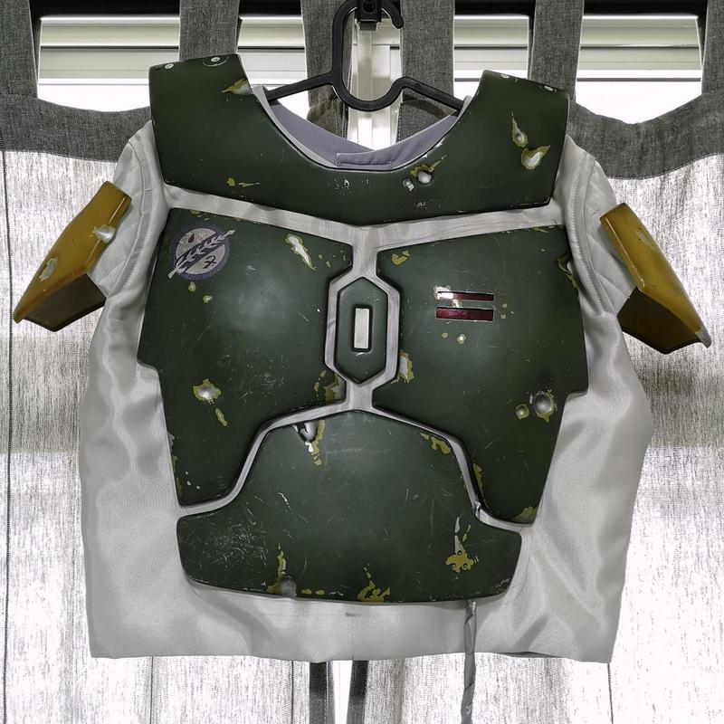

That's it! Now repeat for the rest of the armor plates going from top to bottom. I hope this is clear and is actually helpful to someone out there.

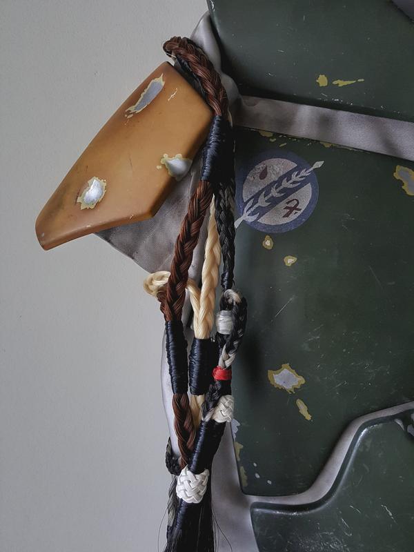

Sewed the braids to my vest with fishing lines.
Any chance you could take a close up of the place you sewed the scalps to the vest. Are they laid out side by side or stacked, and if stacked in what order. No one really takes close ups that I have seen of this placement. In all the photos the braids move around so much it is hard to see how and where they connect. Thanks!
The close up photo is in the post you quoted. But here it is anyway;
Hope this helps. Btw, do not use fishing lines like I did! I've found that the correct way is to use black thread.
