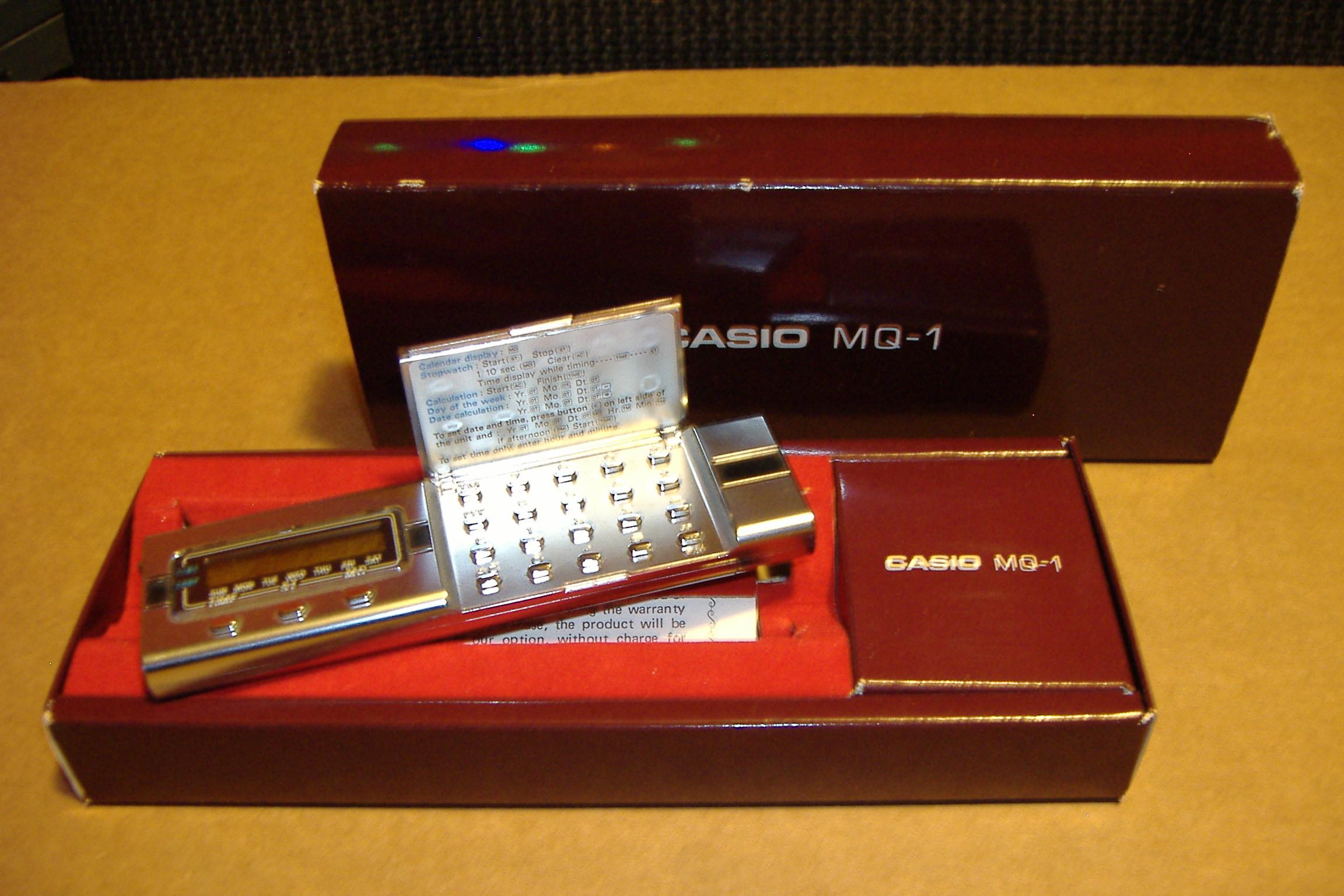

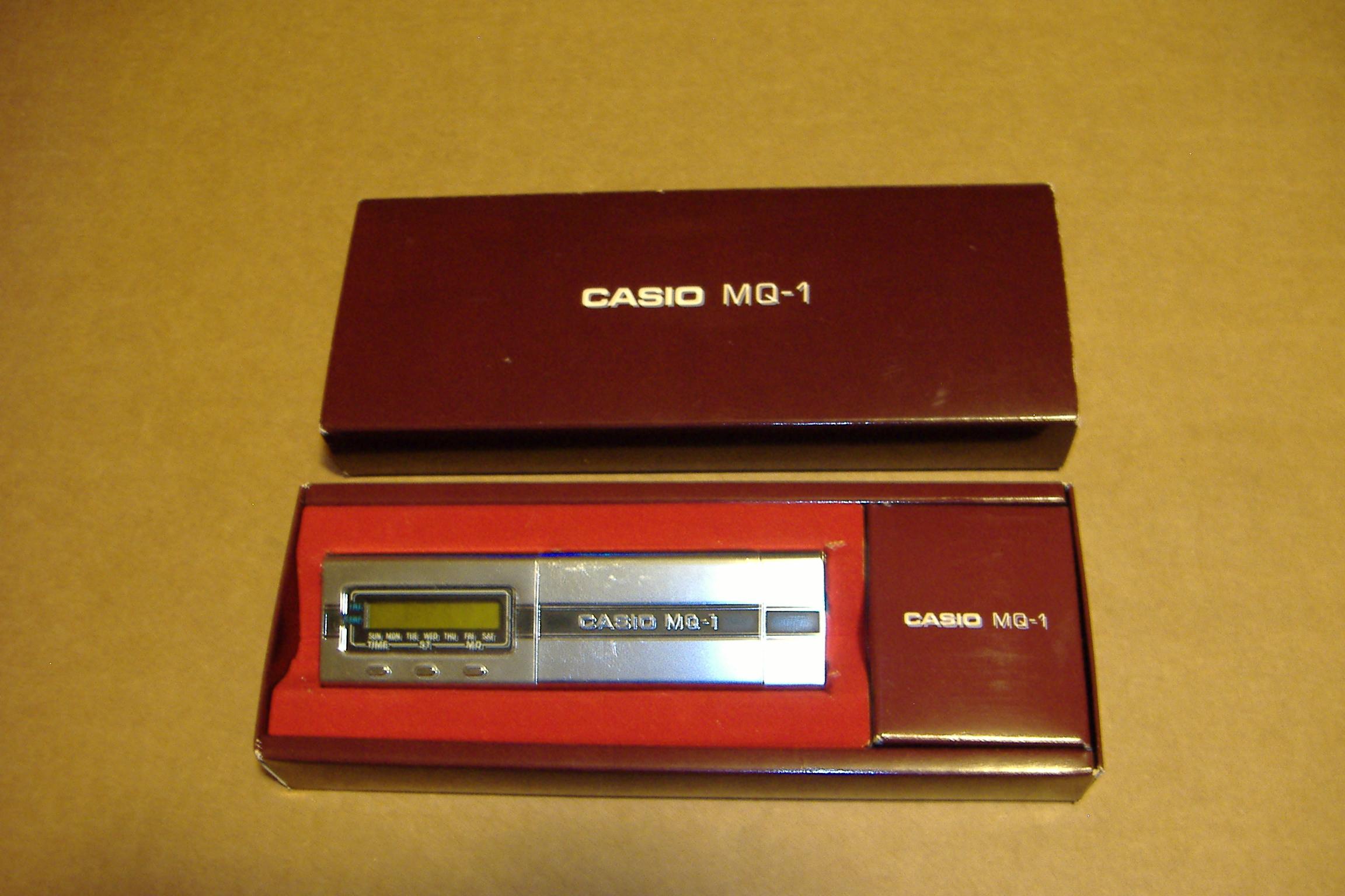

Well I managed to get something that I never thought I would get. I scored a very nice Casio MQ-1 calculator on Ebay for a decent price. I don't have plans to dismantle this but have something else in mind.

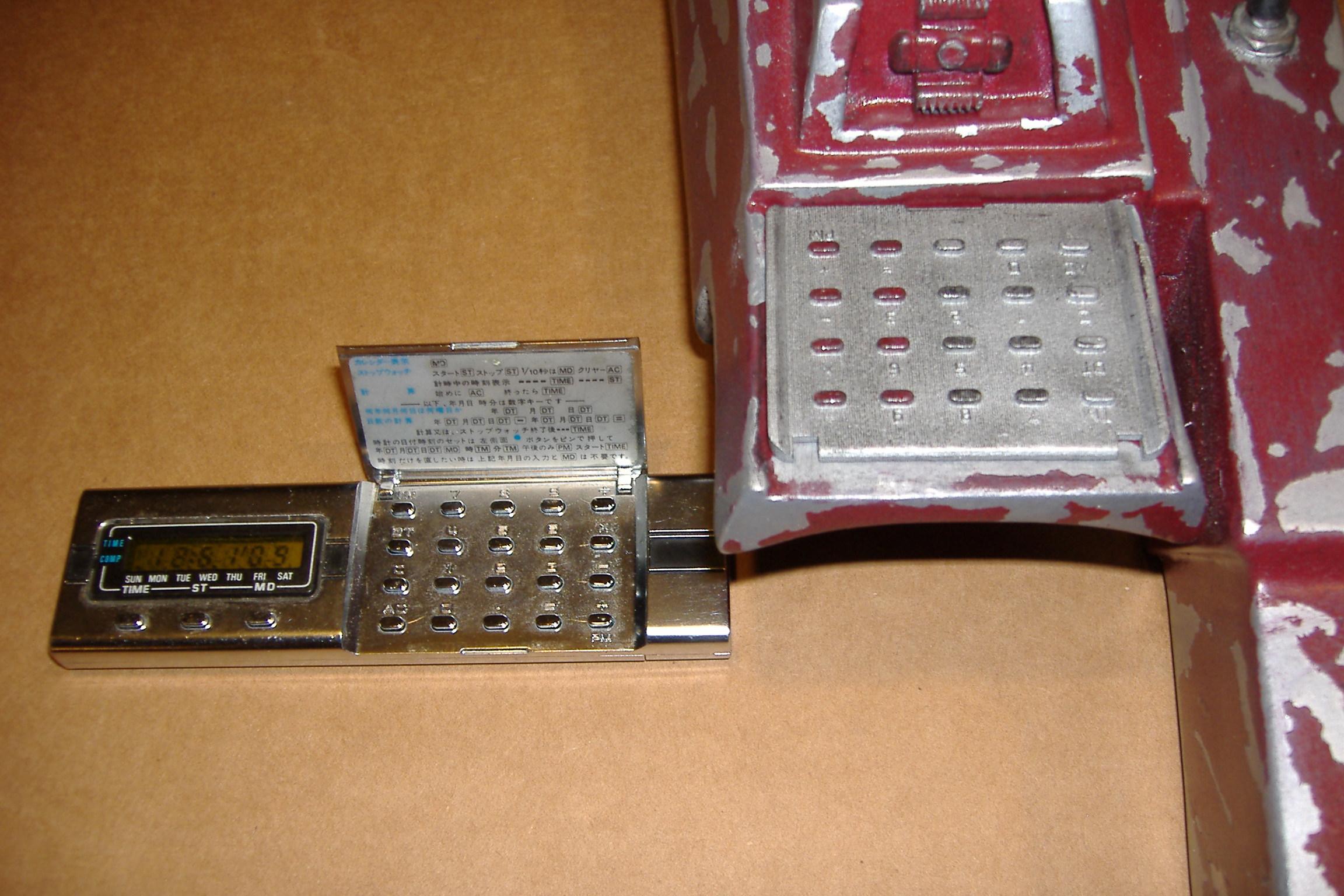

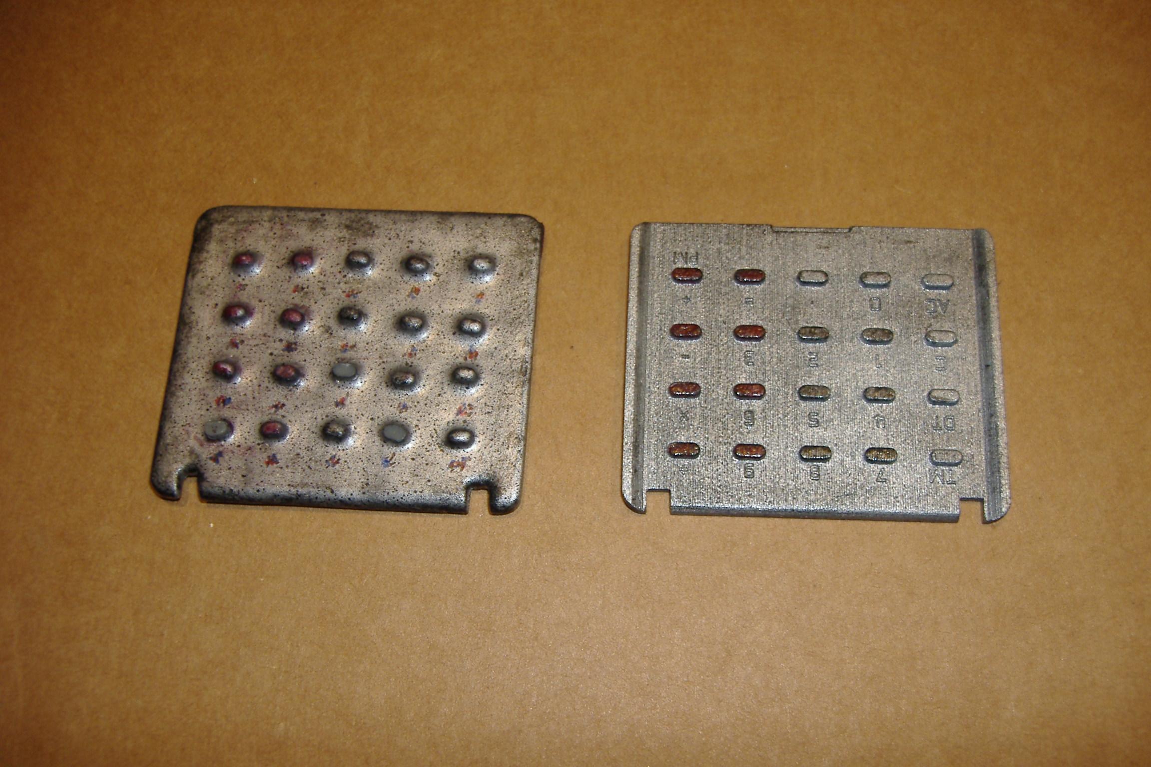

Did an upgrade to the left gauntlet. I had originally made my key pad from scratch it was passable but something I just haven't been happy with. So I designed & 3D printed a modified version of the Casio MQ-1 key pad that would fit my gauntlet due to it being a little bigger than actual size. This gives it a little more accurate look even though it is a little bigger. The width is correct but the depth is about 5/16" too long, but spaced out the keys to make it look right. I tried to get all the numbers & letters as close to how the MQ-1 key pad looks. Helped to have a real Casio MQ-1.
Syper
Holy **** I thought your 3D printed version was the painted MQ-1. that looks cool Mr. I would keep your 3D version on the gauntlet and hold the MQ-1 for the Fett collection.

The MQ-1 key pad would be too small for my gauntlet & wouldn't look right. So I lengthened it some. I am amazed at how well it turned out. The MQ-1 key pad measures 1.250" X 2.000" the one I had 3D printed measures 1.675" X 2.000". So it is closer to being a square than a rectangle. I thought I would give this a shot, to make a custom sized key pad instead of tearing into modifying the nose on the gauntlet. Gives me a reason to make another set in the future cause there are a few other things I want to change
As much as I would love to use the MQ-1, I will be making an accurate sized 3D printed key pad & possibly making it so that all the buttons are separate & could be made to function. This was my test piece to see how well it would turn out.
I did model up a dental expander & had that 3D printed as well & will try & swap that out as well.

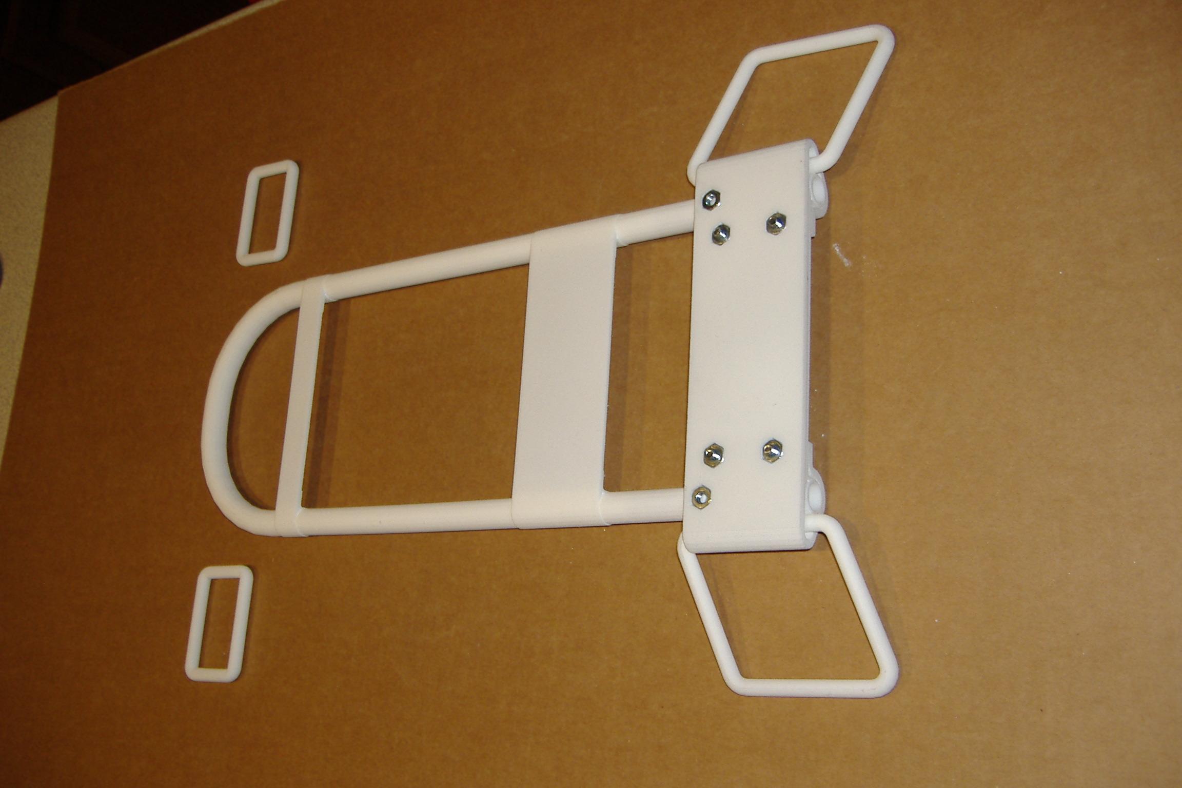

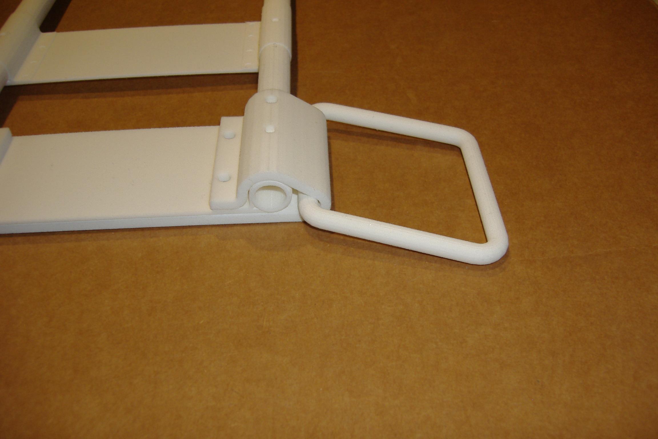

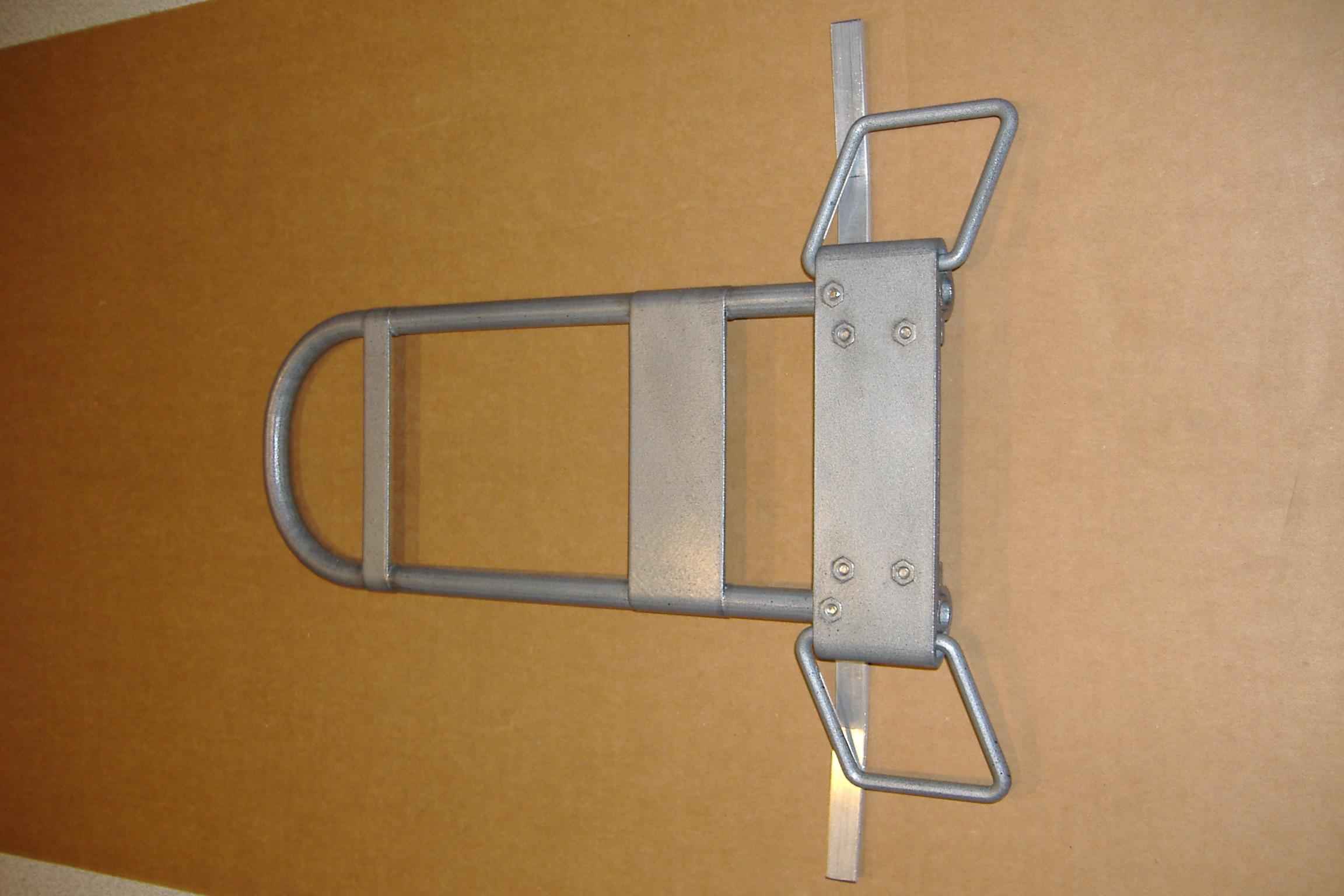

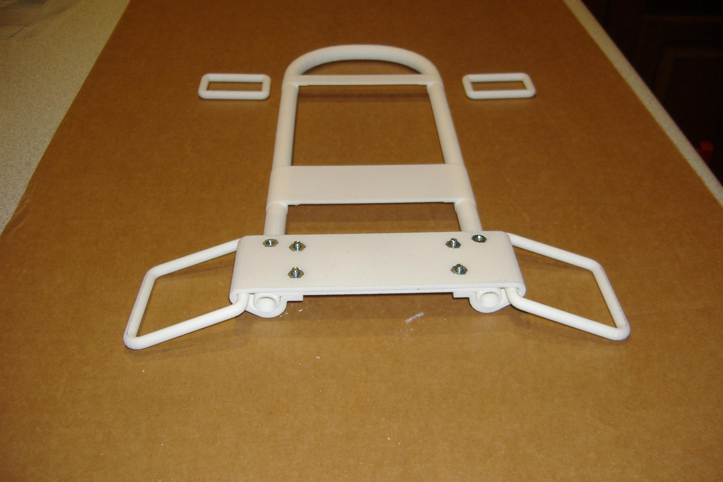

I got my jetpack harness in today. I opted to try something & am rather pleased with the outcome. I modeled up the jetpack harness from the reference photos with some modification to allow for 3D printing. Need to do some light sanding & then going to give it a good metallic paint job. This is a super light weight alternative, weighing in at 5.5 oz. It has some flexibility but strong. Only the lower 3.5 inches of the frame is hollow. The rest is solid.
The rings are .250" diameter round.
I will be adding an 1/8" by 1/2" aluminum bar for the lower jetpack hooks to sit on. The frame was design for this so that it would be structurally sound.
The jetpack hooks that I will be using came from full metal fett.
Need to get the strapping ordered.
T
toolguy301
Guest
Painted up the jetpack harness & assembled it. Added an 1/8" by 1/2" aluminum bar for the lower jetpack hooks to attach. Have strapping ordered. Going to use 2" wide seat belt straping for the black & 1.5" wide white nylon strapping for the pieces that attach to the upper jetpack hooks. I have a U.S. Diver's belt buckle that I need to do some modification to being that it is not the exact one.

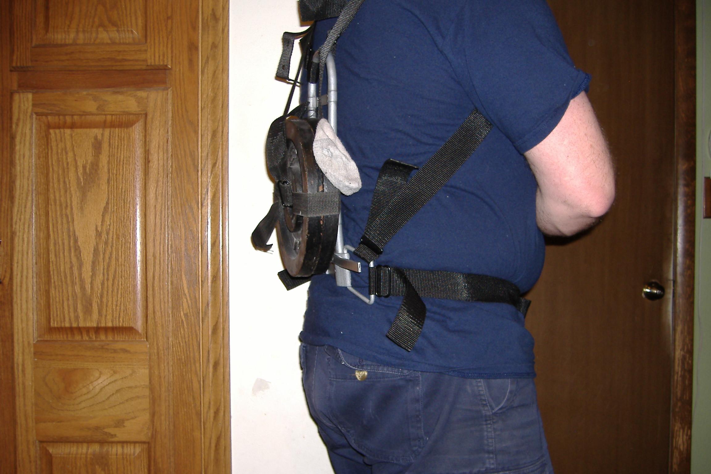

Did some testing to see how the harness would handle 20 pounds of weight so took 2-10 pound weights & rigged up some strapping similar to how the jetpack is connected. I used some 1.5" nylon webbing that I had on hand but this will be changed to 2" wide seat belt webbing. It handled the 20 pounds very well & I think this will work very well. I figured that the 20 pounds was over 3 times heavier than my pack so that was a good test. My pack weighs in at just under 6 pounds. Personally I wouldn't want to go trooping with 20 pounds on my back but was good for testing purposes.

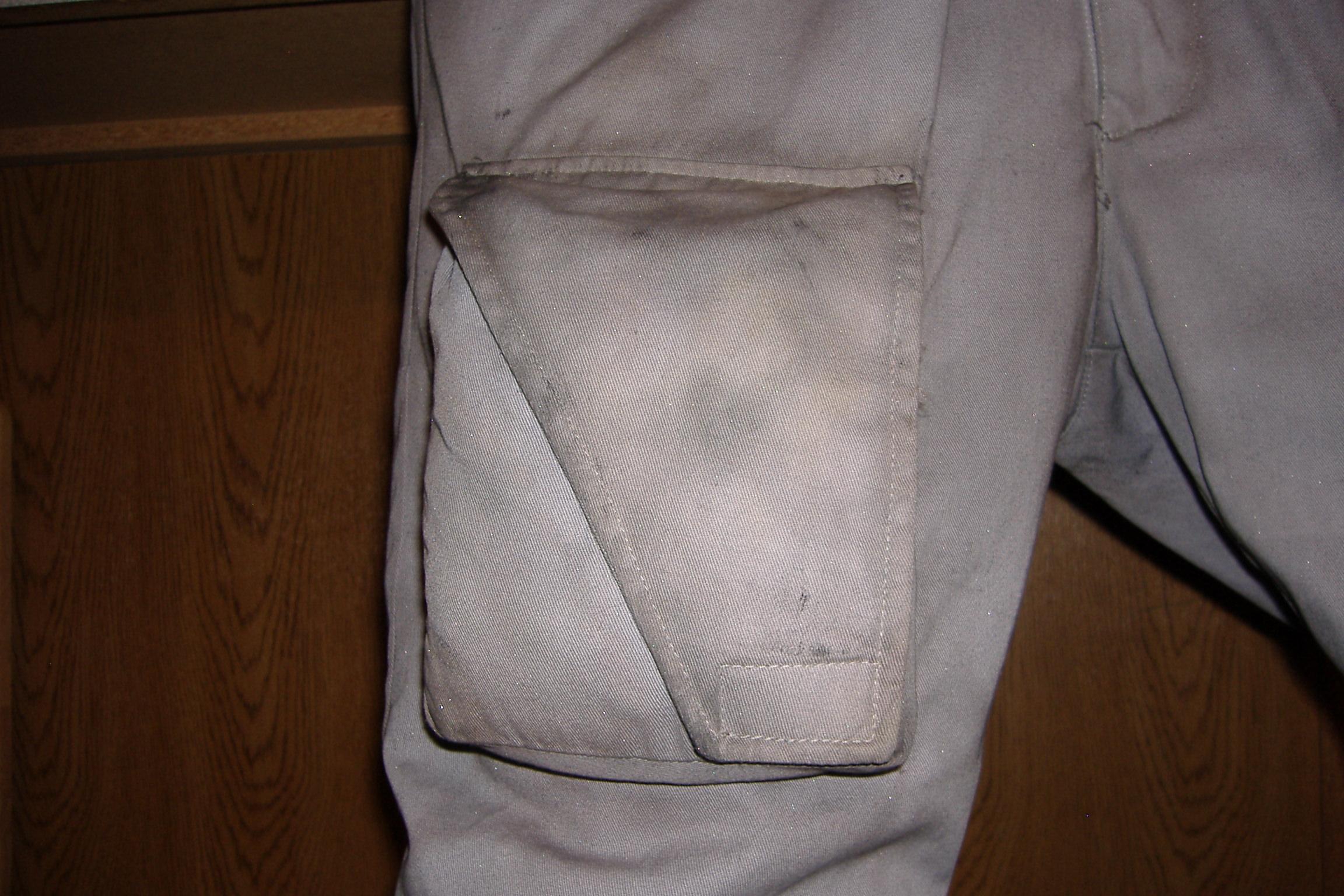

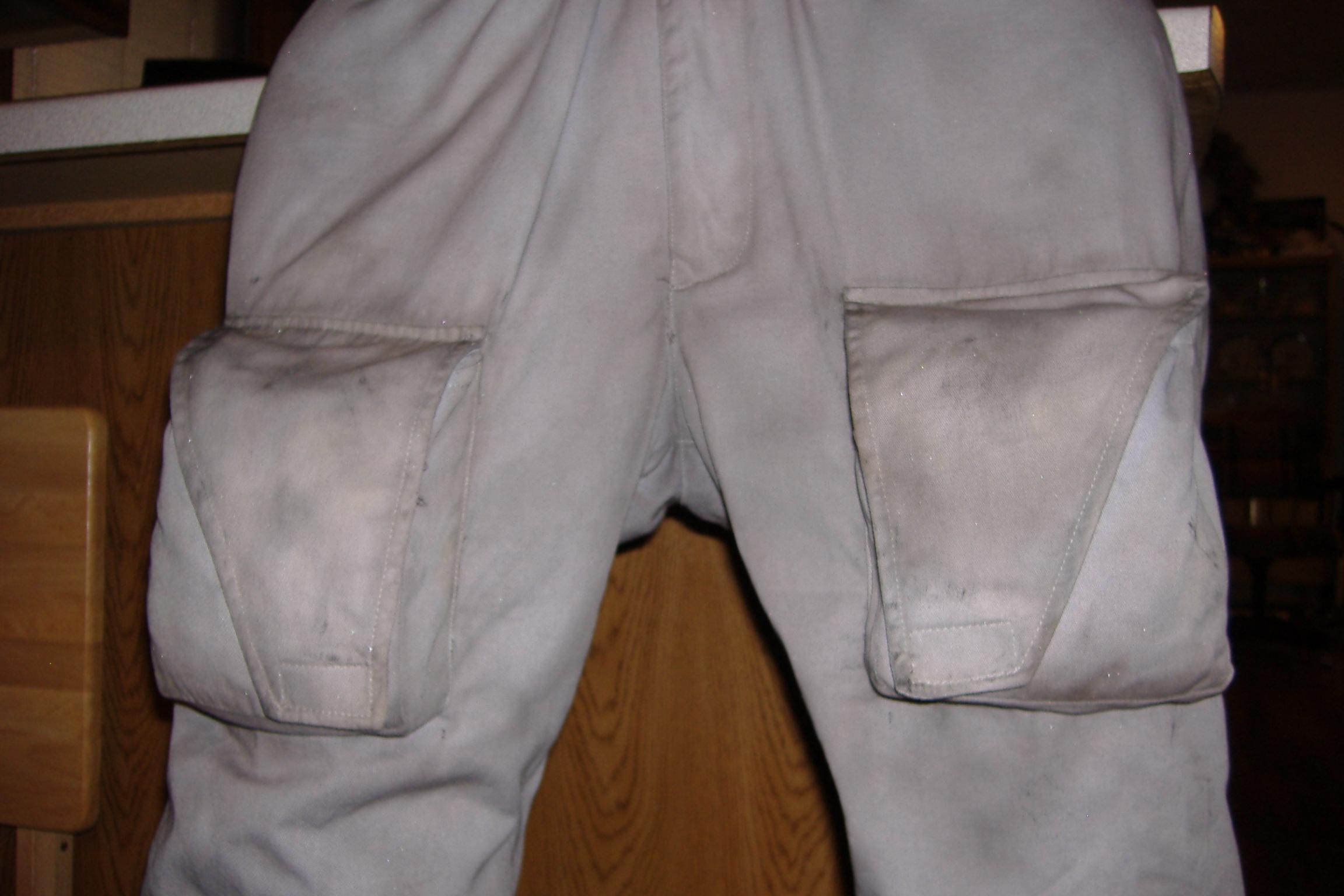

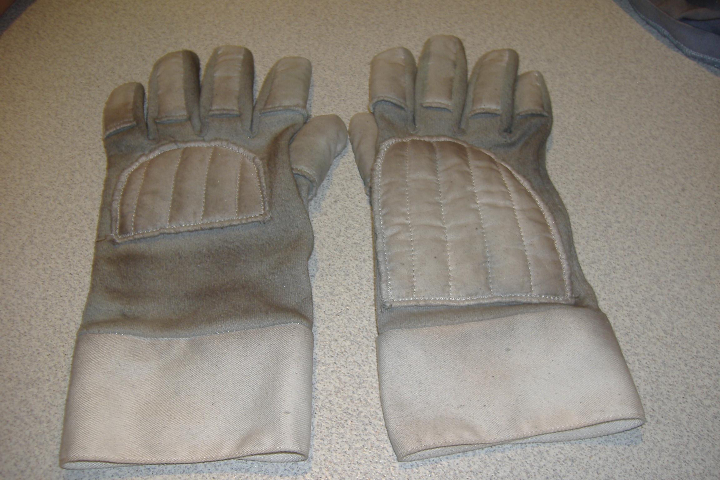

Today worked on finishing the weathering on the flight suit, flak vest, & gloves. Hope I captured the look of the ROTJ suit.
The gloves I had worked with a wet on wet to get some of the weathering & finished it off with some air brushing. These were tough because depending on what reference photos you use they have different looks to the point of some of the tour gloves are almost white. I went more with the screen grabs to get the weathering.
The flak vest I just did some air brushing using a mixture of acrylic fabric paints to make a dark brownish gray & a light brown color. These were just misted & then I did some scrubbing in areas to give that rubbed in look.
Added some distinct hard black smudges to the pants using a stiff bristled tooth brush. Did almost a dry brush method. The color was a mix of acrylic paints mars black & burnt sienna. To give it an old grease look.

Kick ***, sea bass. I like the subtle tones you've got going on the flight suit. The gloves look perfect! I would be interested in seeing the photos under a different light. You used a flash for these, right? The flash may have washed out a lot of the work you did.
One thing that I worked a lot on was the gradient from the knee down the shin tool pockets, ankles, and finally to the boots - gradually getting darker along the way. It's weird - you can totally see this in the jabba scene...but once he's on the skiff, the sun just washes it out.
I think you go could deeper on the flak vest - maybe just a bit more in the key areas - edges, underarms, around the neck a bit....think almost sweat marks.
