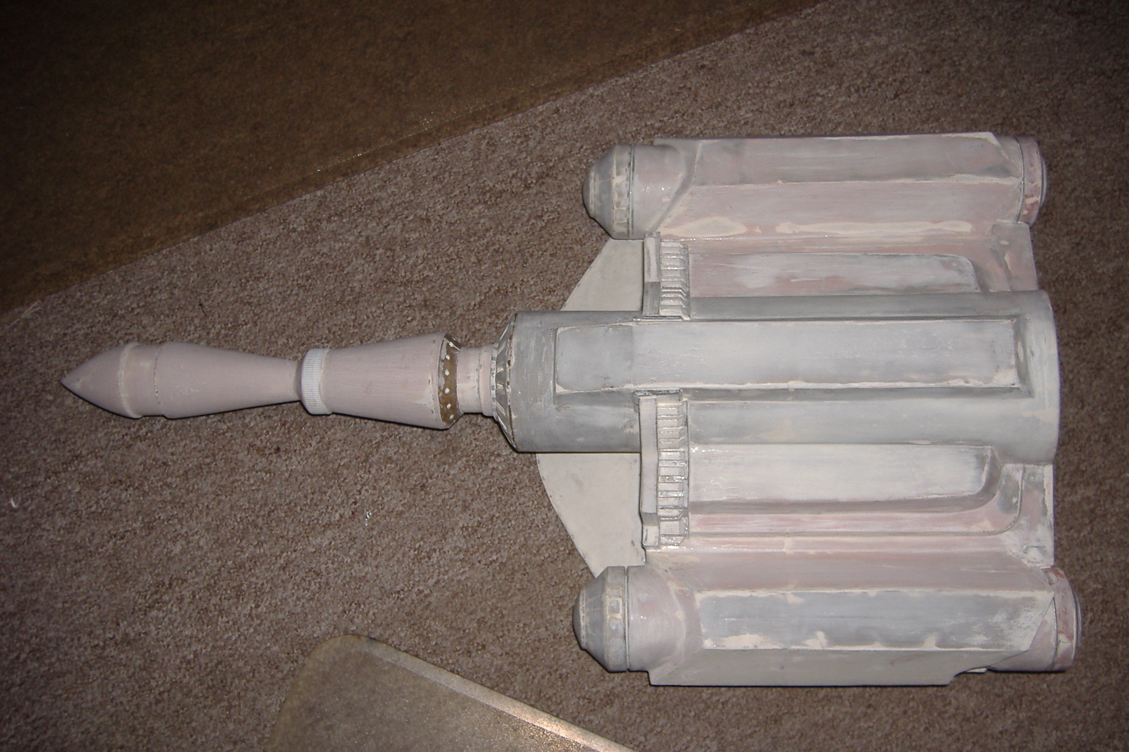

Doesn't look like much but block sanded the jetpack & worked on the rocket. I need to do some spot putty work & the main body of the jetpack is ready for primer. Need to do some detail work on the rocket.

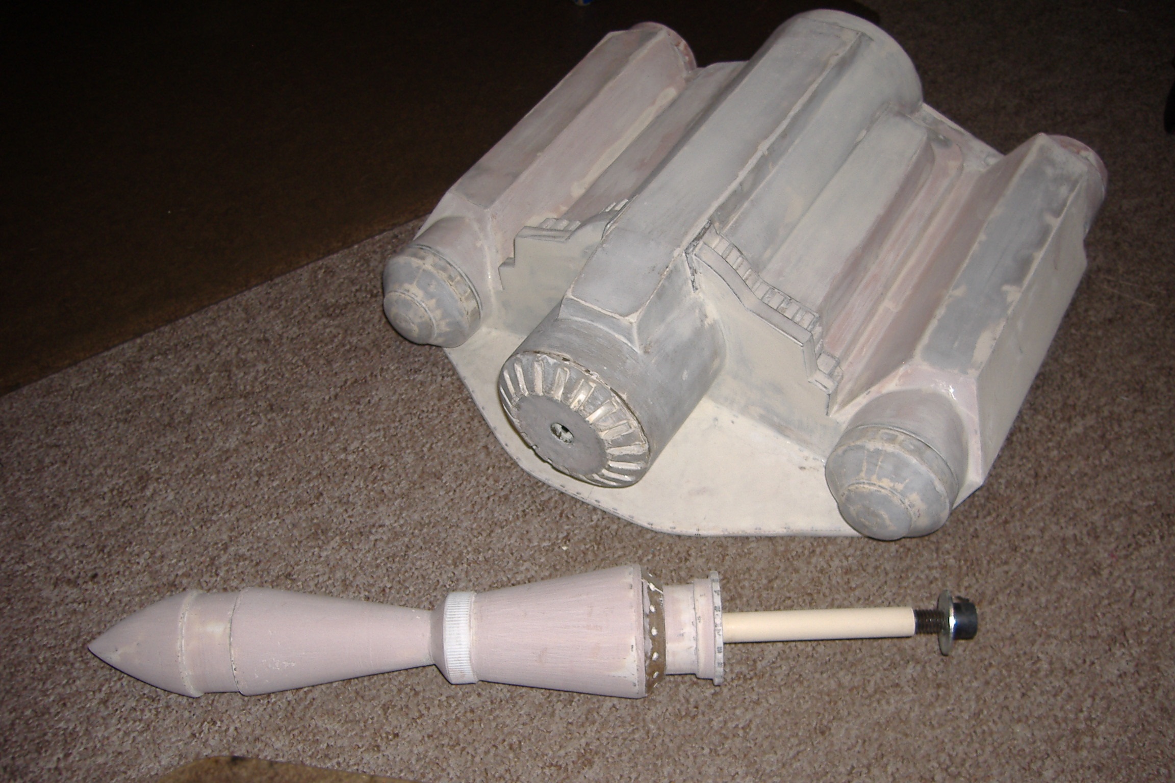

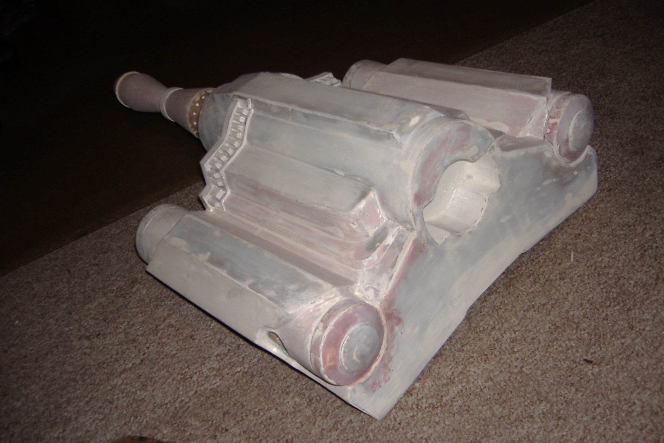

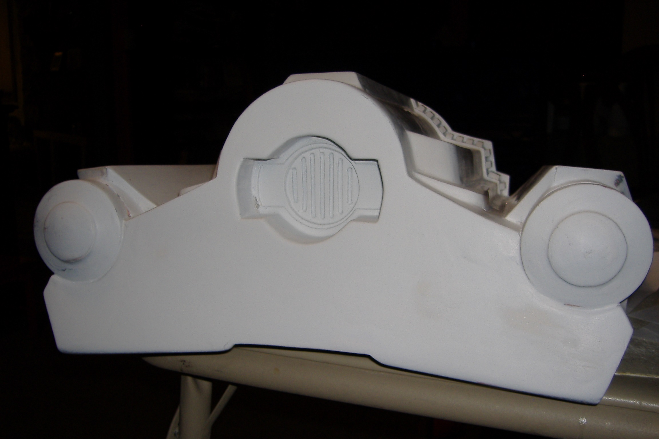

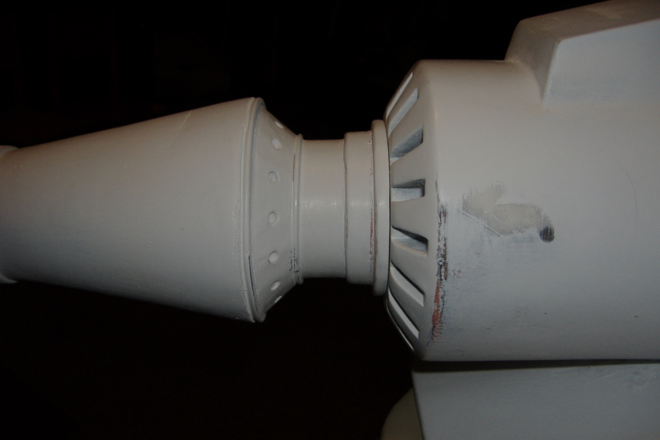

Been getting my jepack ready for paint. Got some primer on it, spot filled & did some block sanding to smooth it out. I am hoping to start painting the main body this weekend.
The bottom grate piece was made from architectural cardboard & layered to give depth. Didn't take any pics of prior to gluing it to the body of the jetpack.

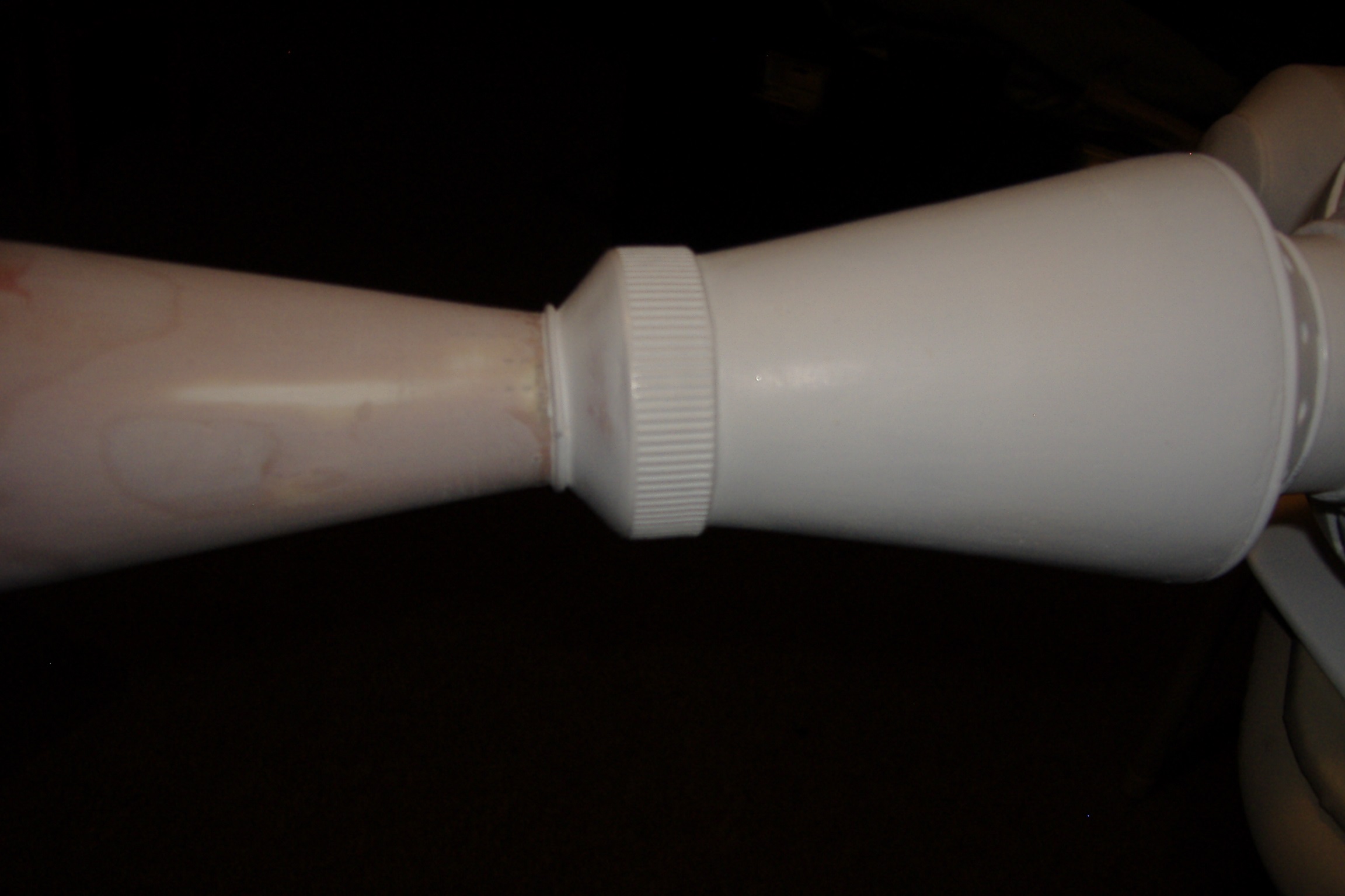

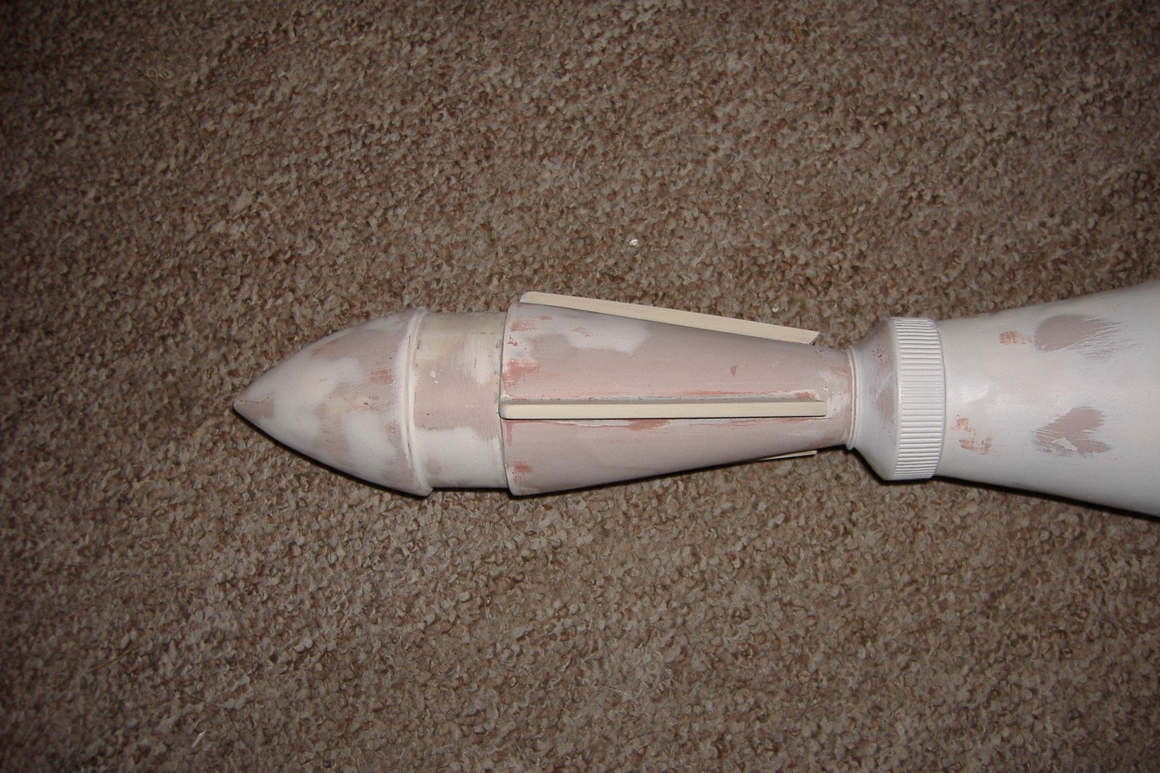

Worked on the details on the rocket. I used the rims from plastic cups to make the small thin rings. The collar piece towards the top of the rocket, I used a medicine bottle lid to give the vertical spline. Need to finish the tip with the 3 vertical strips & have some filling & sanding left to do.

I finished up the 3 straight pieces on the rocket using plastic trim for 1/8" fiberglass sheeting. Used epoxy putty to fill in the center to make it solid and attached it to the rocket. Sanded it and blended it in.

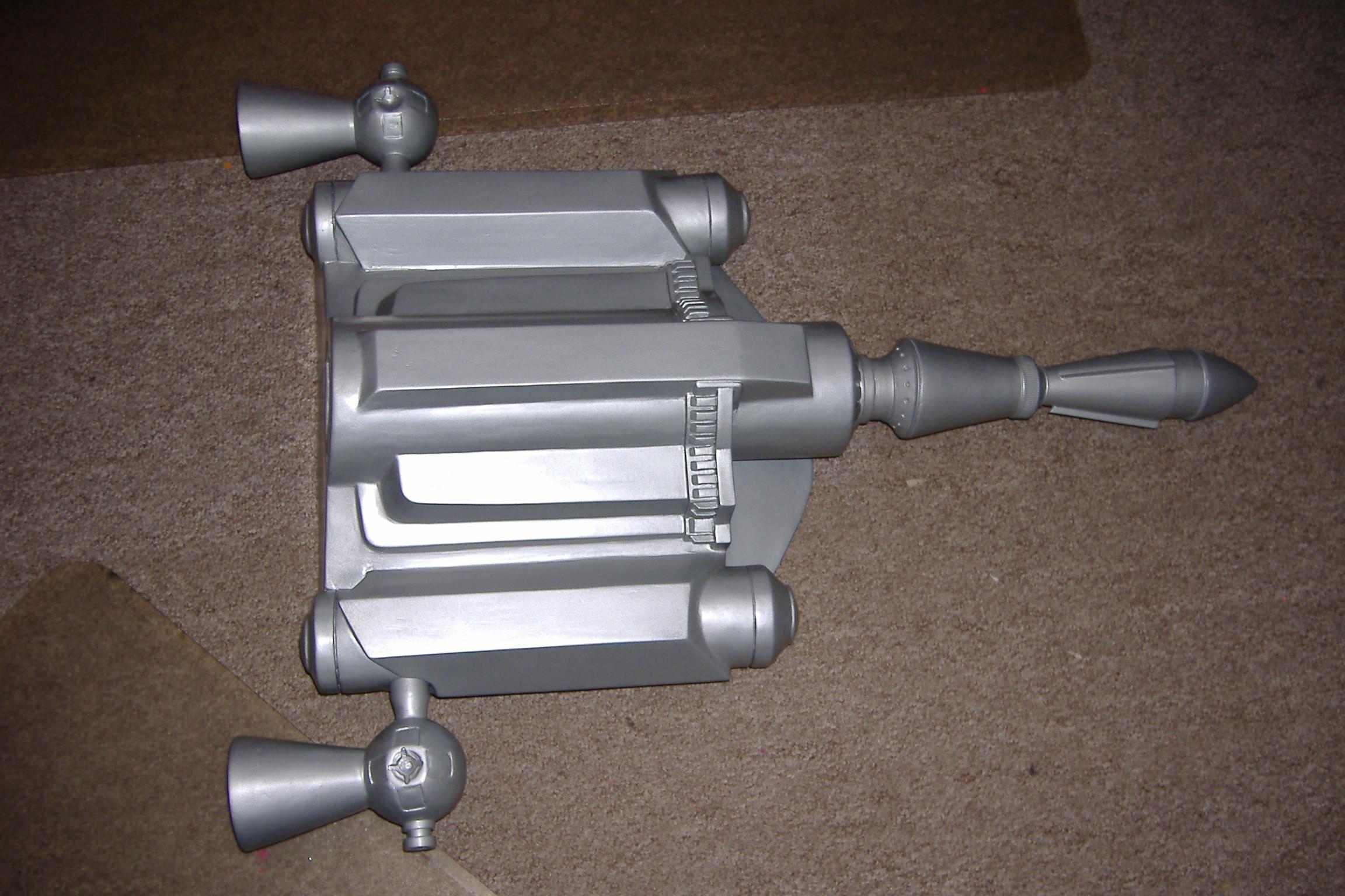

Painted the body of the jetpack, rocket, & thrusters with silver & cleared it to begin the rest of the paint process. I have found the putting a clear on the metallic paints helps adhesion of the rest of the paint.

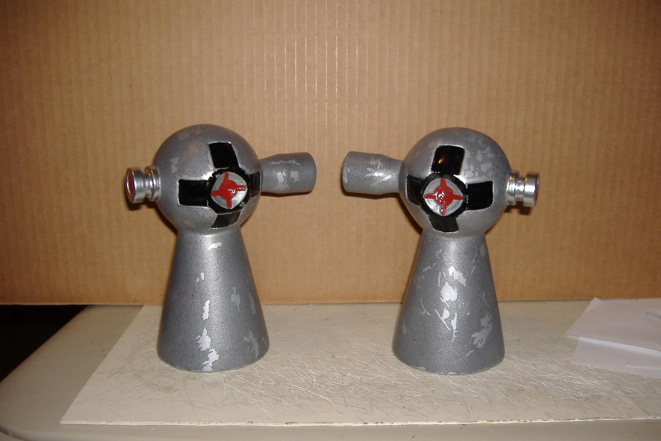

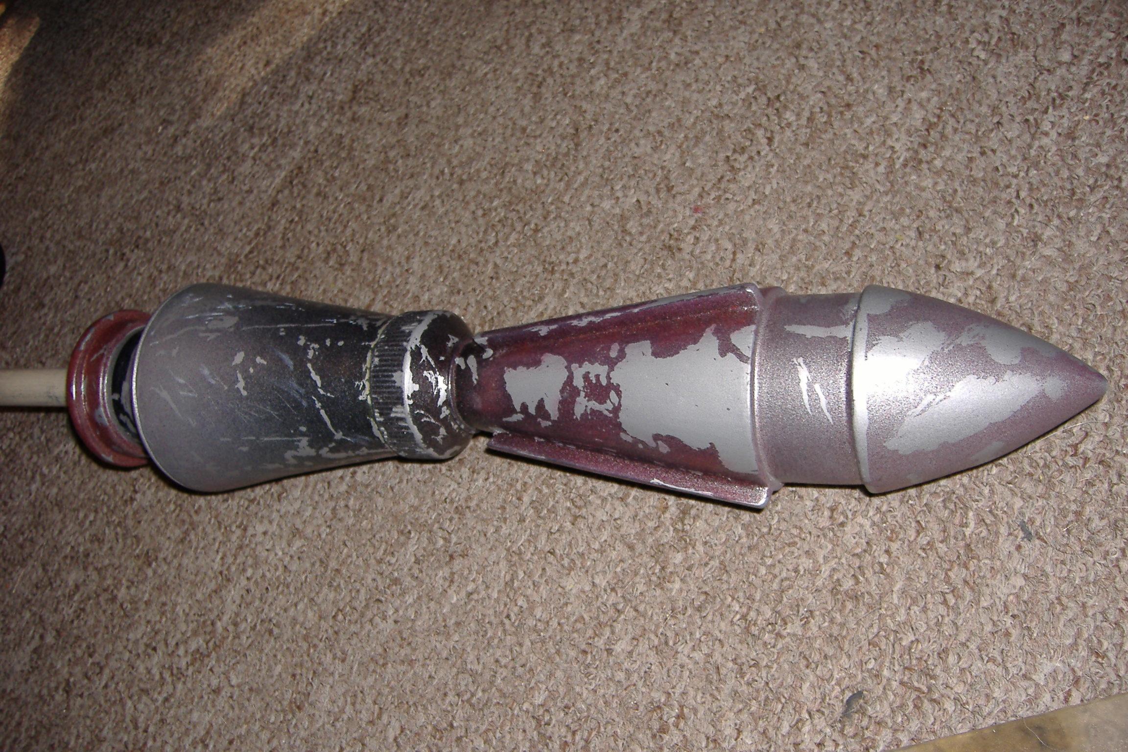

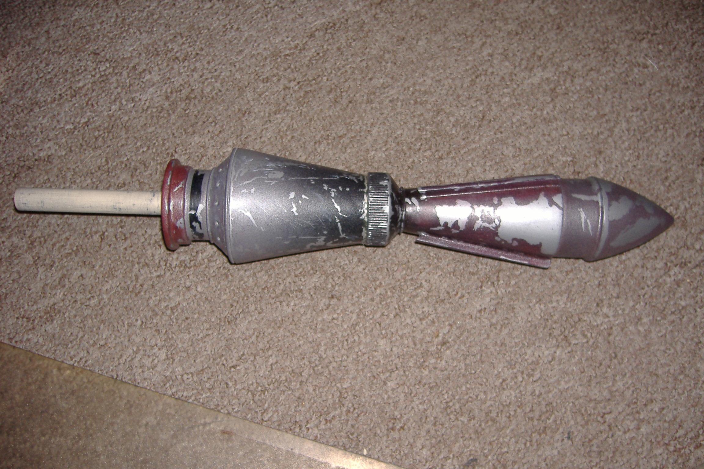

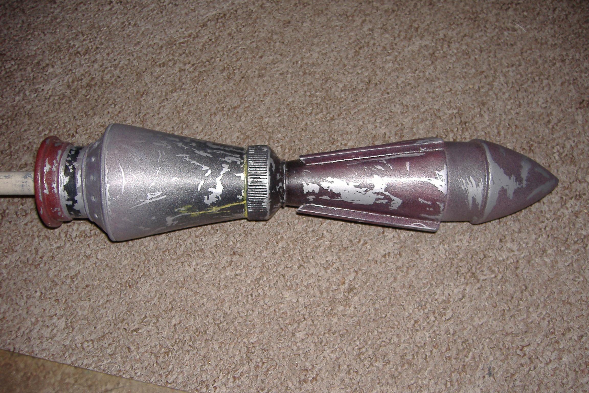

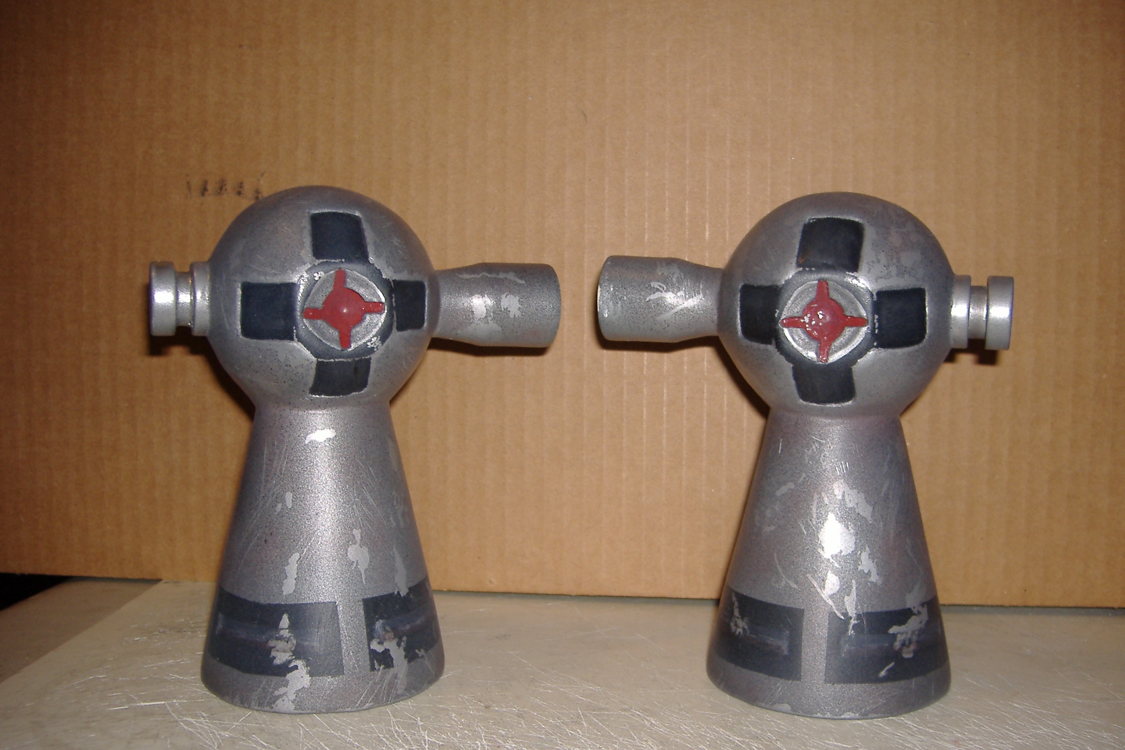

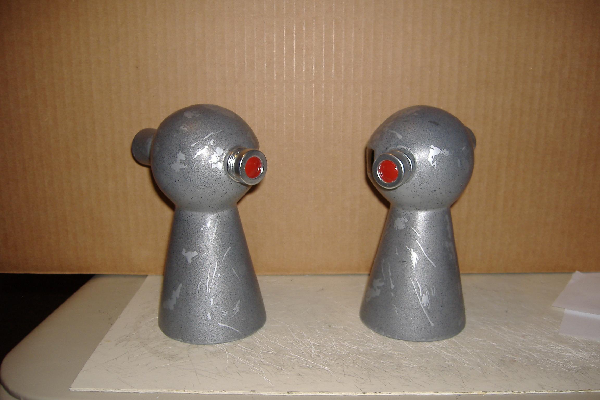

Almost completed with the paint on both the rocket & thrusters. Thought I would start with the smaller pieces & get them done first before tackling the body of the pack. The rocket is pretty much complete have to do some minute weathering & clear coat it. The thrusters have some more work to be done but they are getting there.
Finished up the painting on the thruster, but need to give them a coat of clear. Then onto the main body of the jetpack.

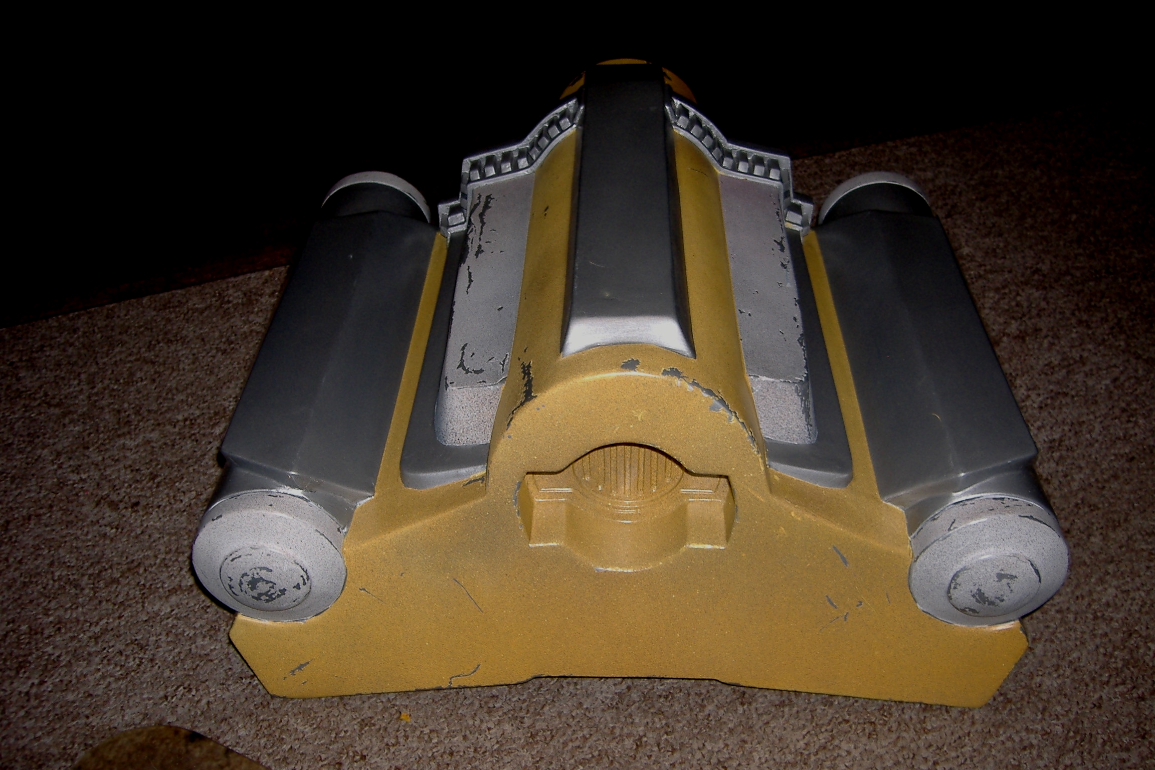

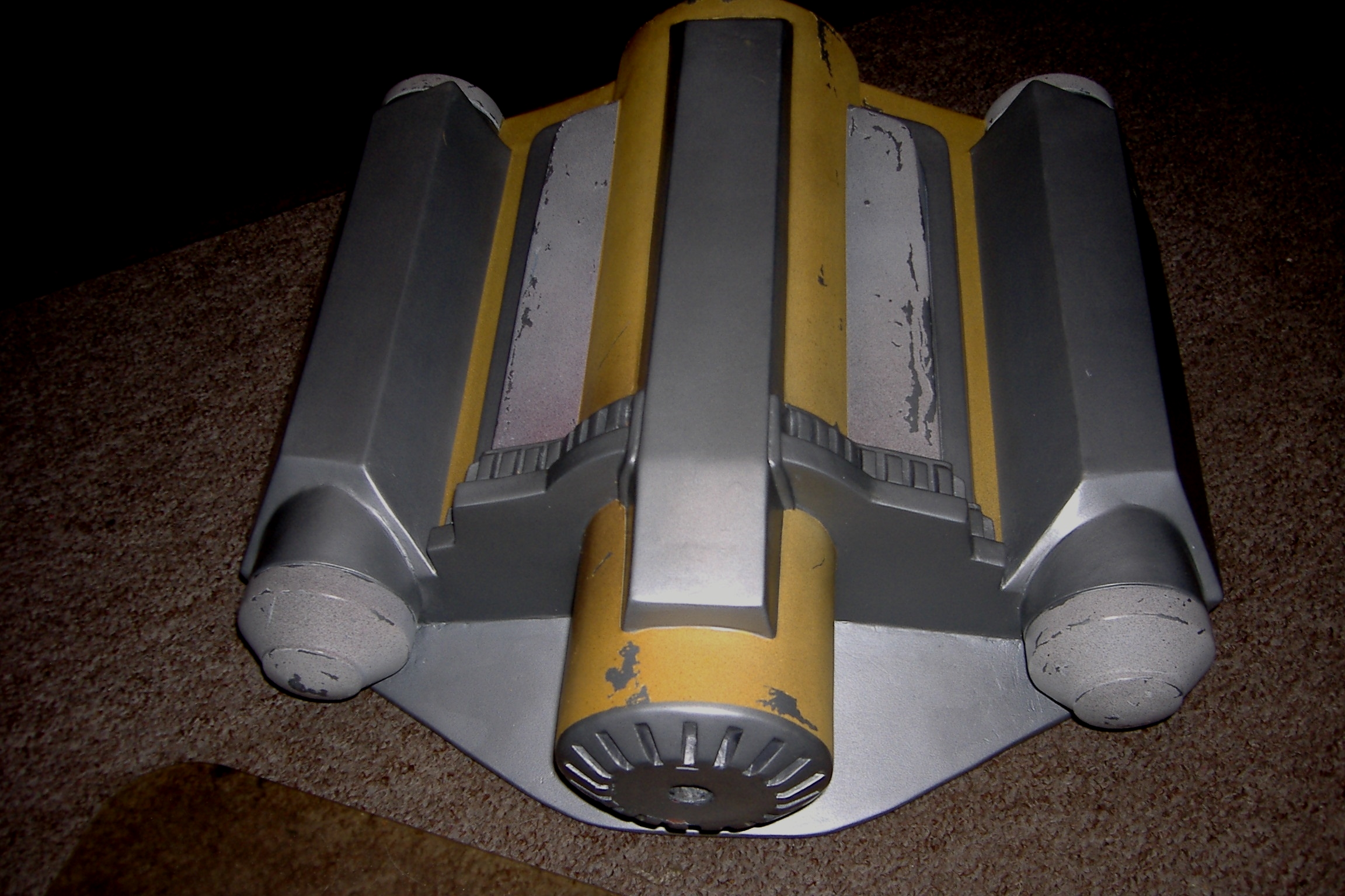

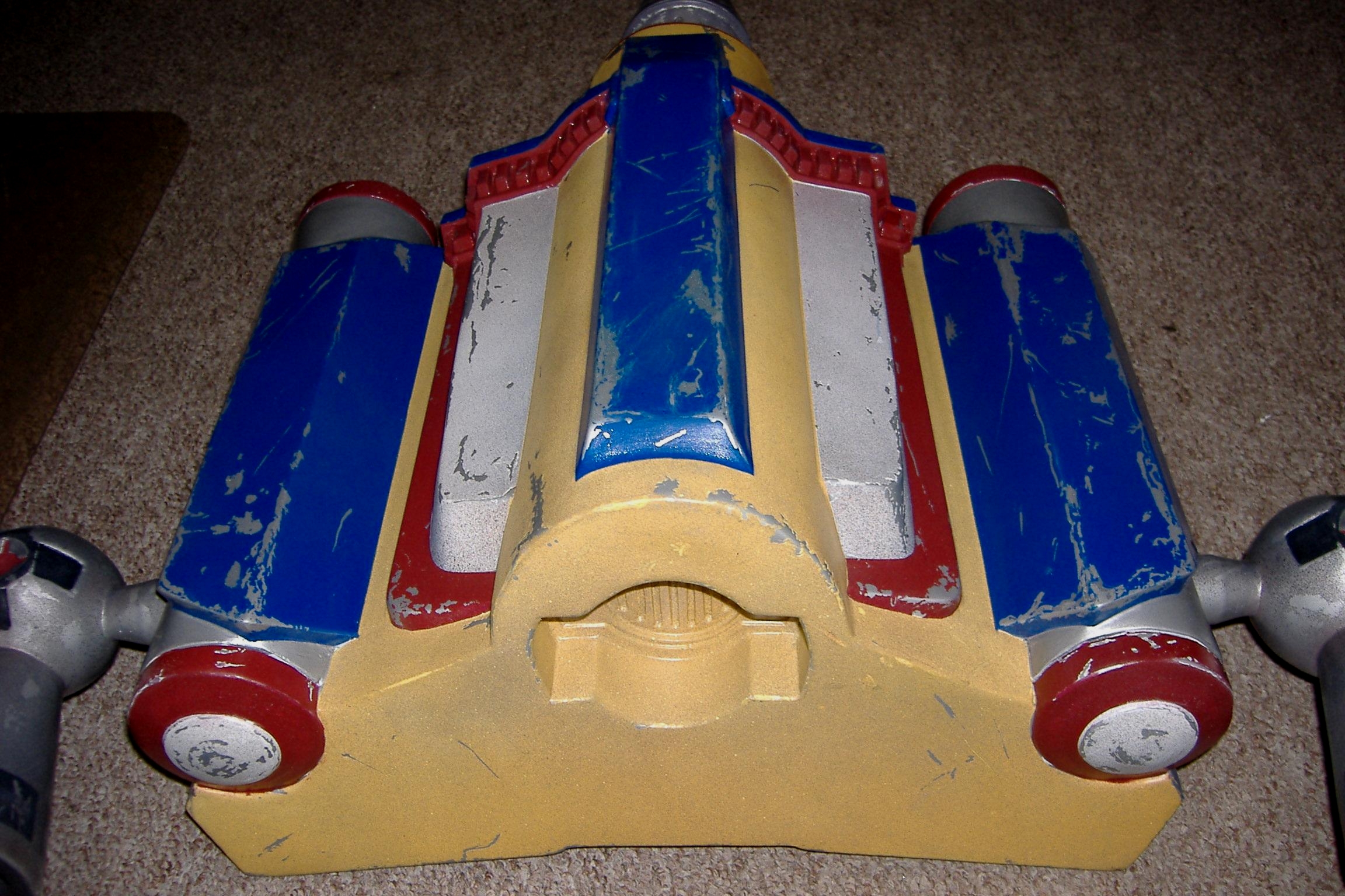

Started painting the main body of the jetpack. Have the white & yellow done with some misting of browns & grays for some weathering. Still have some finish weathering that I plan on doing once all the colors are done. Not too sure if I am happy with the yellow color, thinking it needs to be more orange. May do some work on that some more. Plan on doing the blue next.

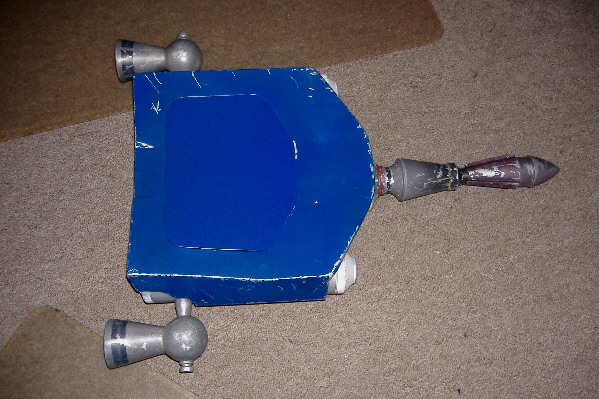

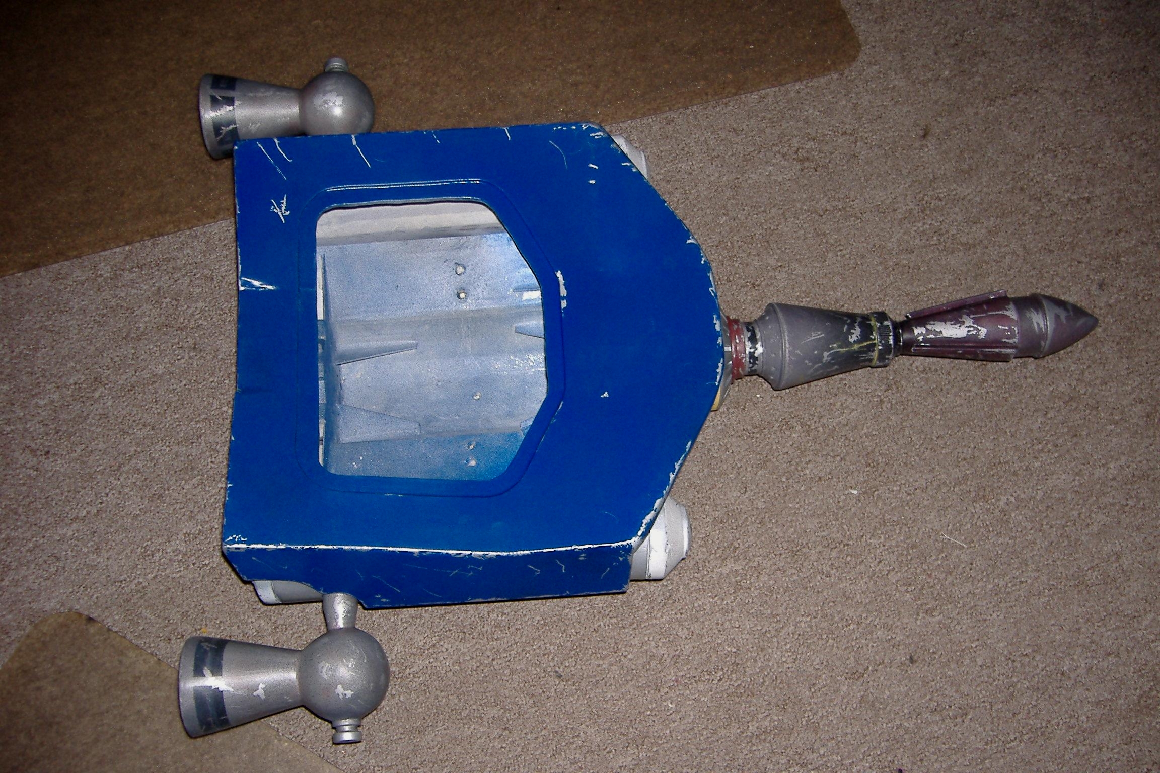

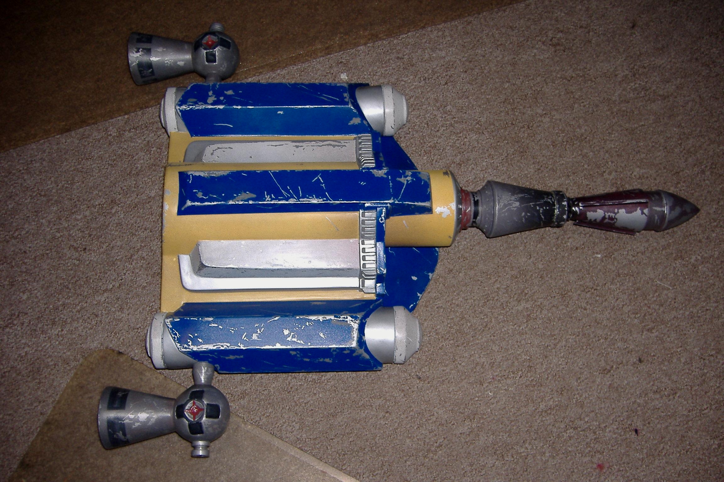

Got the blue painted onto the jetpack with some light weathering of gray & black misted.
Been busy got the red paint onto the jetpack. Need to finish up the top & bottom of the fuel tanks & then onto some fine weathering detail. Plus I plan on painting all the symbols & stripes instead of using decals.
Jetpack looks great! Looks too clean, dirty that thing up,lol
Alittle pastels and steelwool...my secret weapon :)
Thanks, but I so agree, it is way to clean at this point & it will get some more weathering.

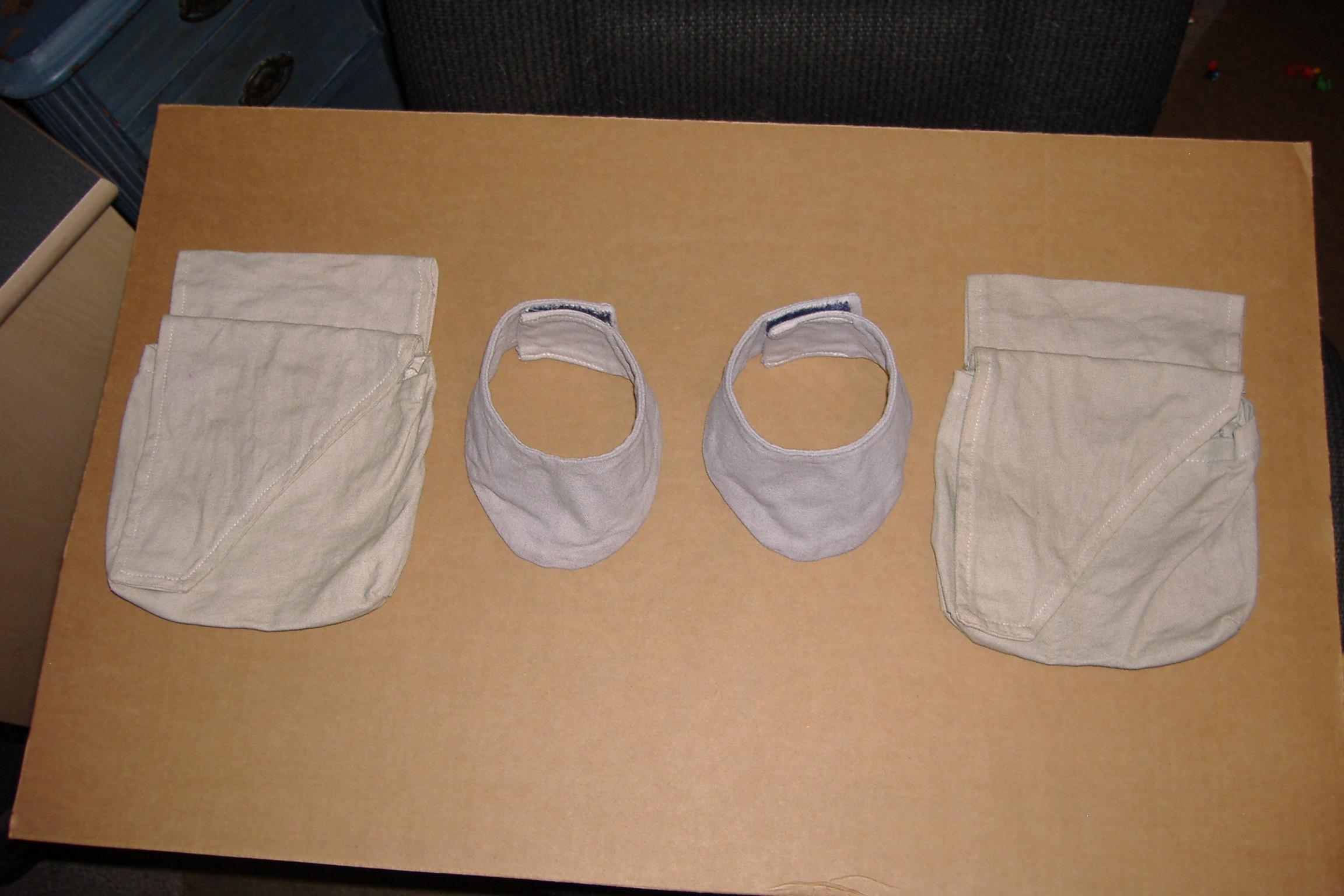

Started dyeing my MOW soft parts. Have the belt pouches & the spats done but need to be weathered.

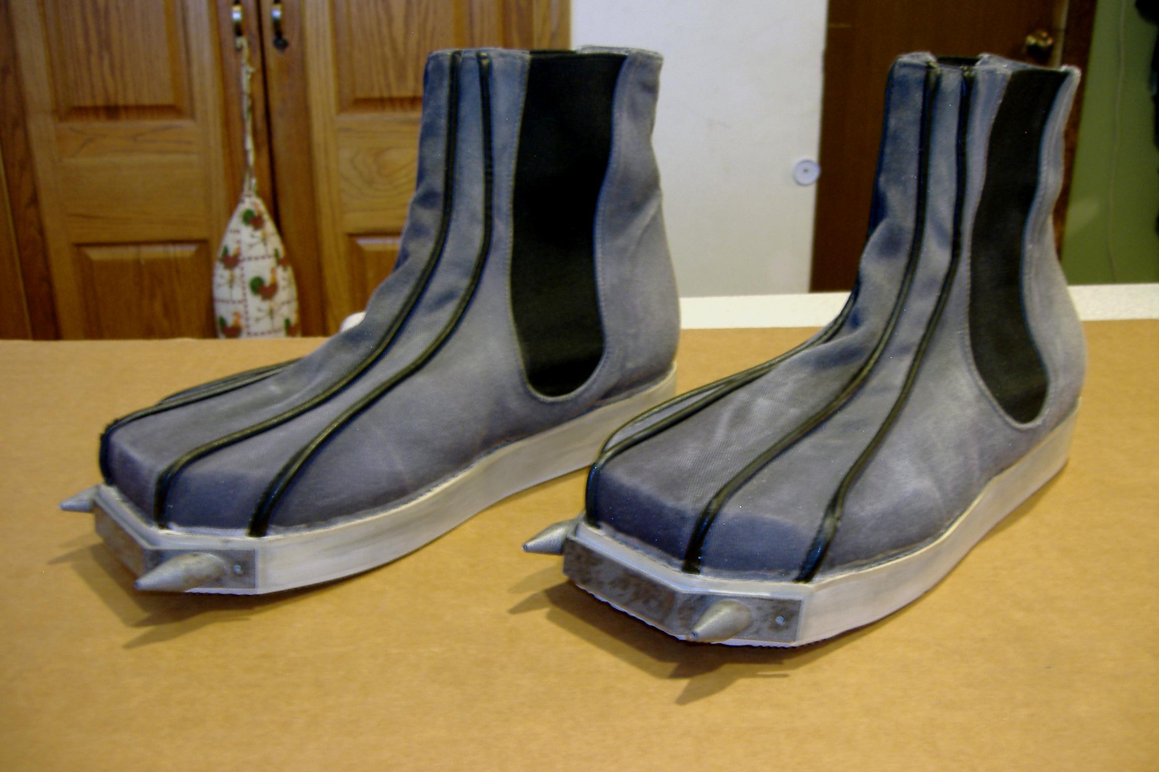

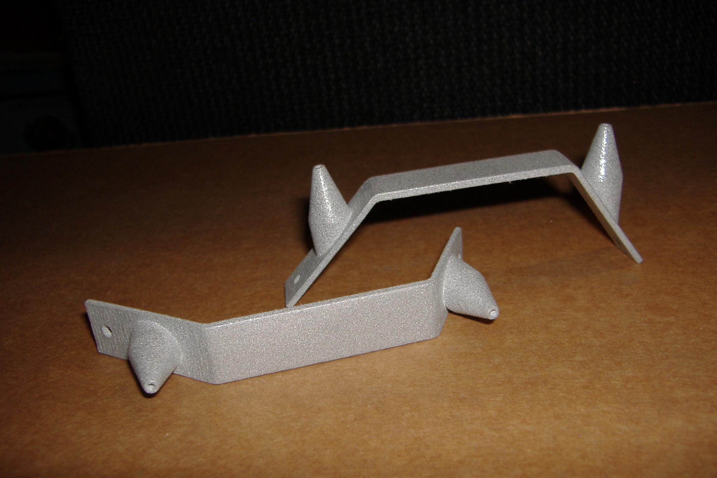

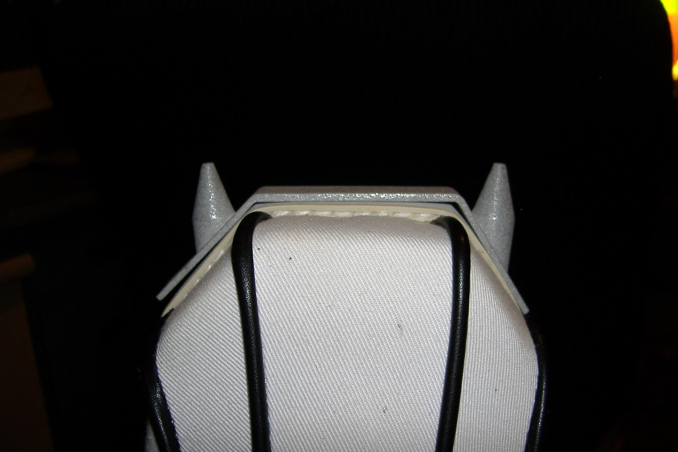

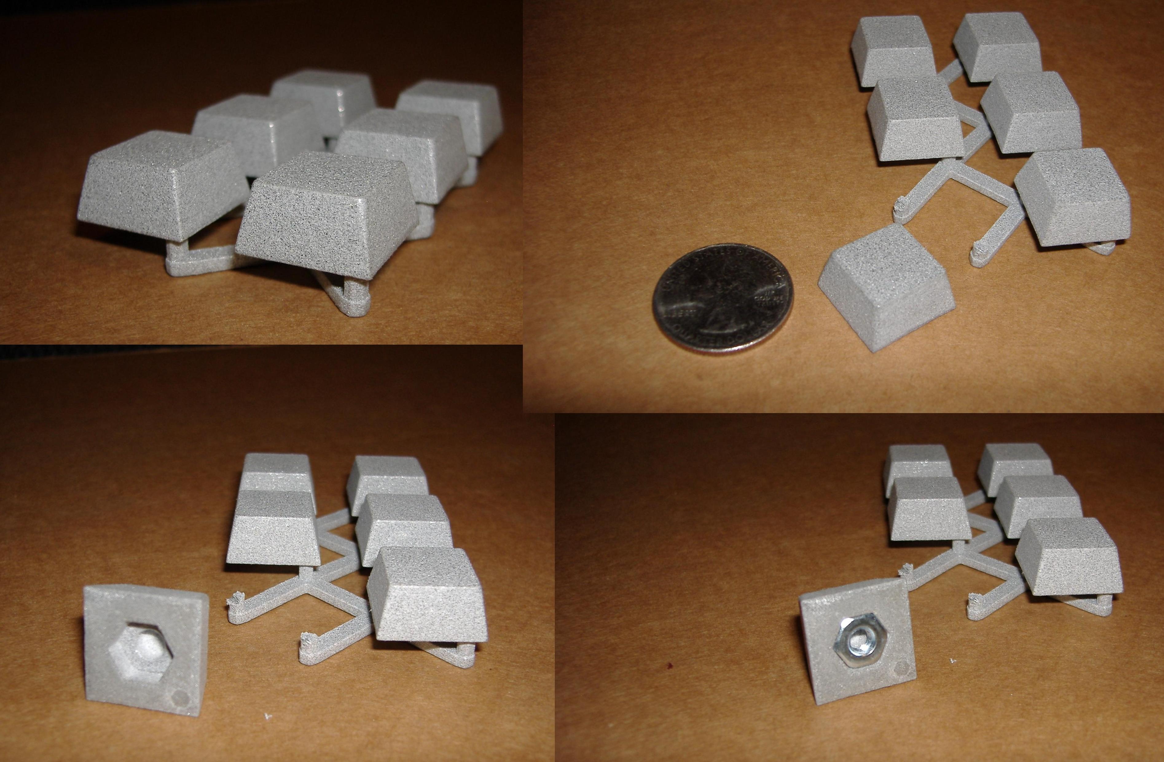

Did take some time while it was cold out & spent some time on the computer. I drew up a 3D model for the toe spikes to be 3D printed which I received today from Shapeways. I designed them to fit the MOW 2013 boots that I have. The toe on these boots is different than any of the templates that have been done. Used Raf's template as a reference for rough sizes as well as scaling reference photos but had to make deviations to the spikes & angles in order to fit the toe shape of the boots. I had them done in a polished aluminide to give it a metallic look. I am pretty happy with how they turned out.
Got in the shoulder attachments that I designed up & had 3D printed. They are printed in the polished aluminide like the toe plate & spikes. Pretty impressed with the 3D printing.

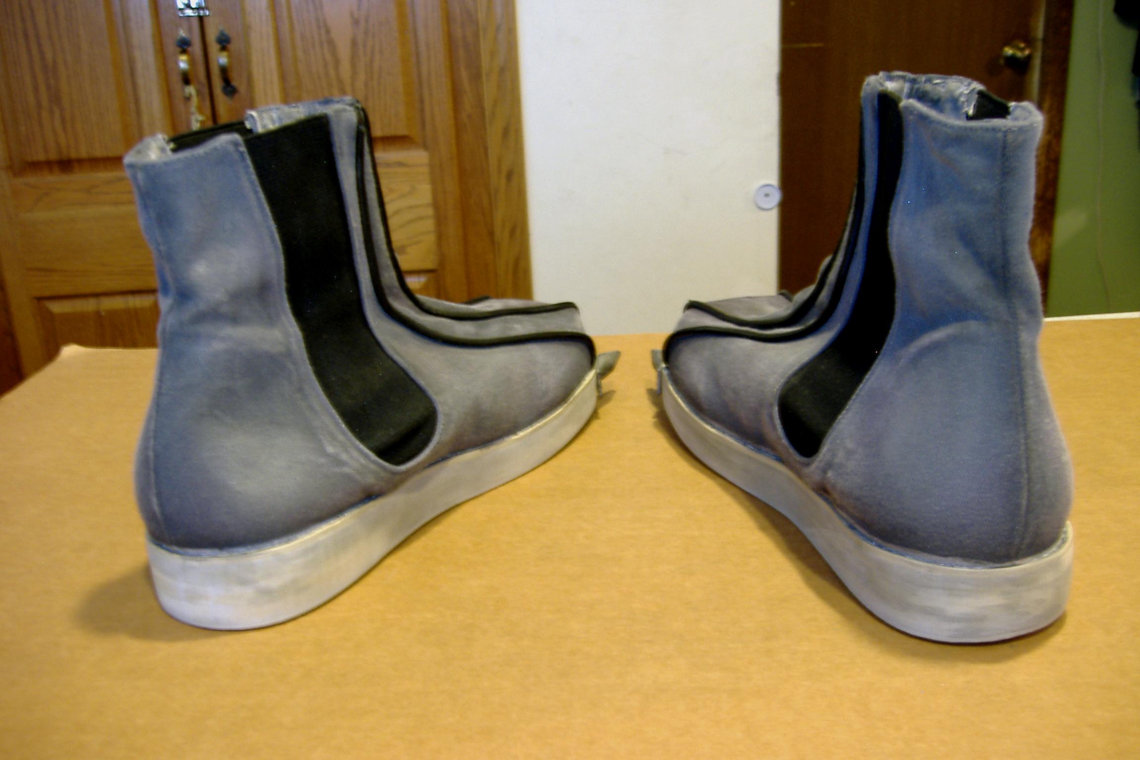

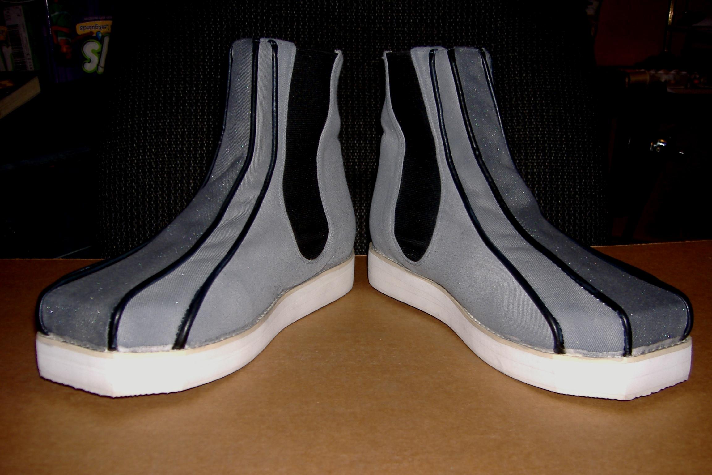

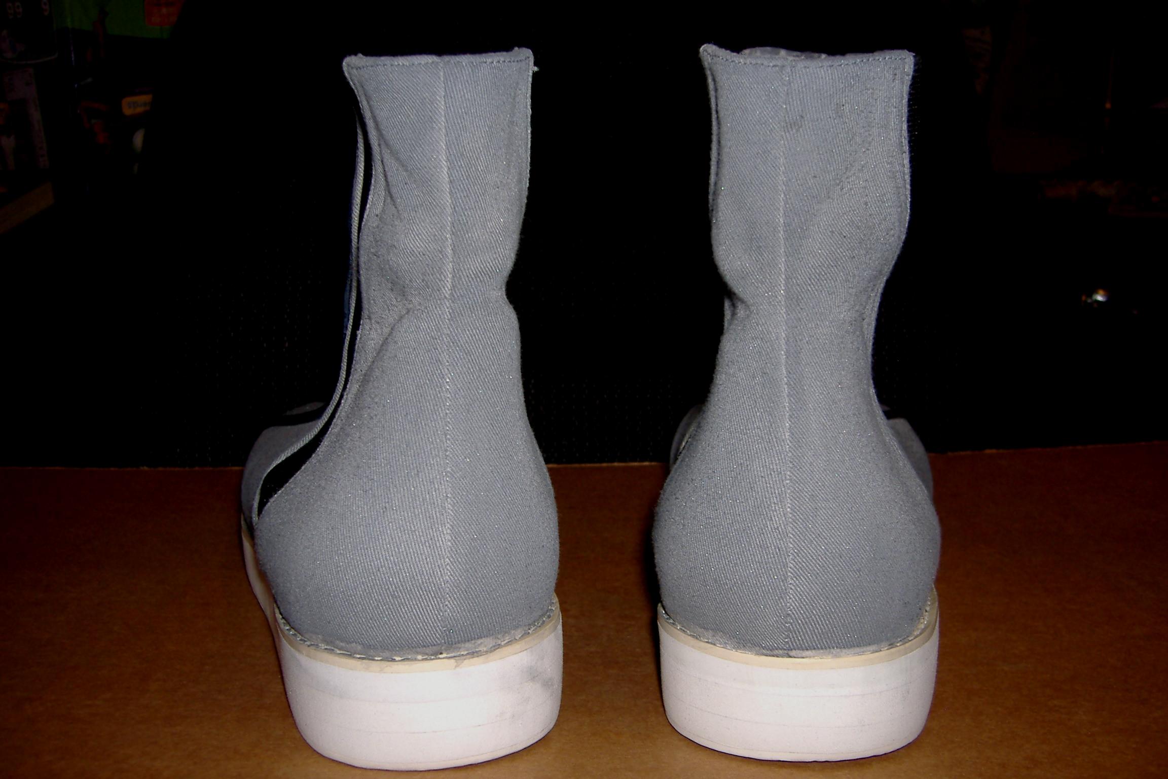

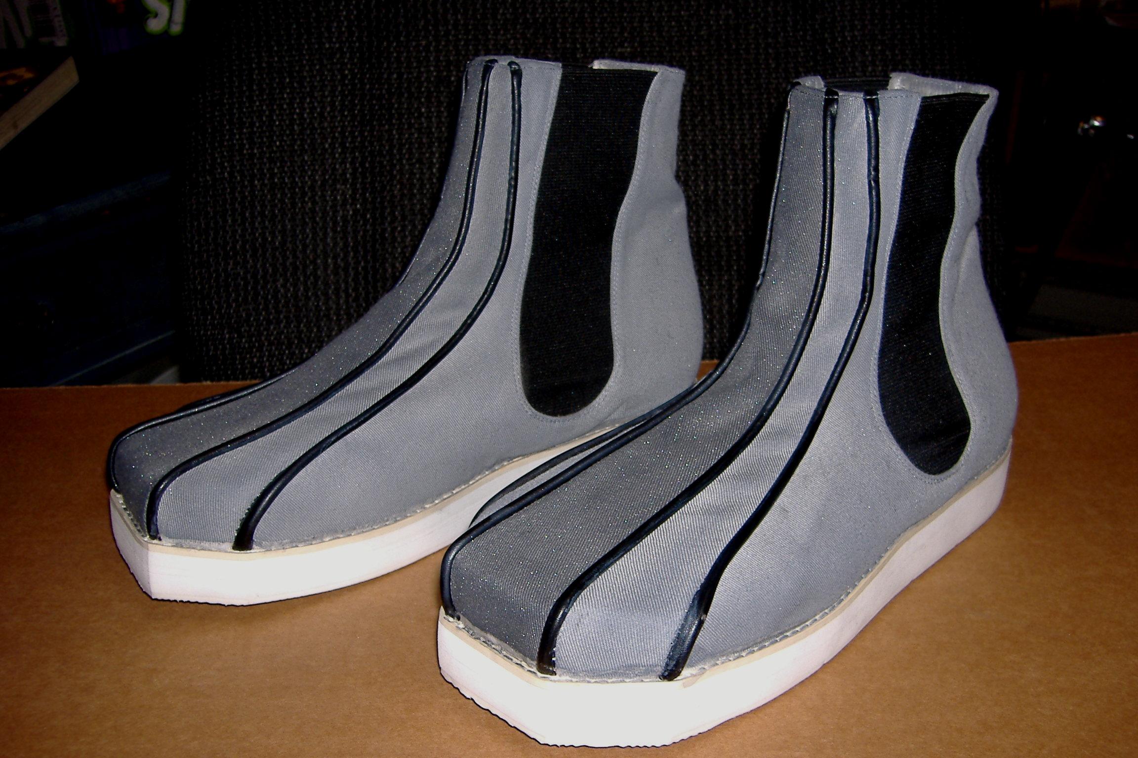

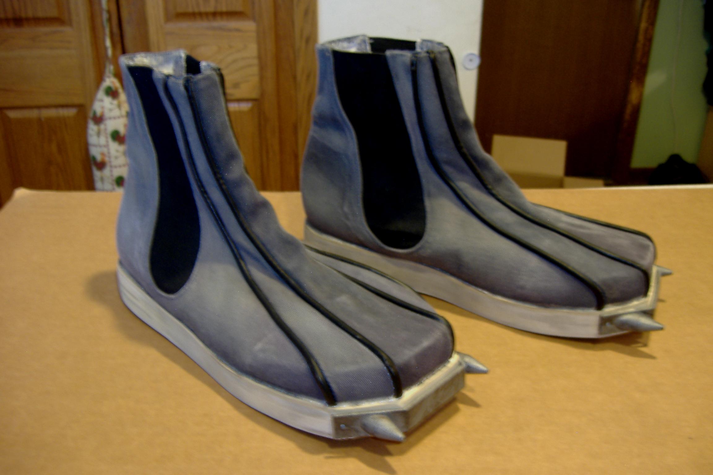

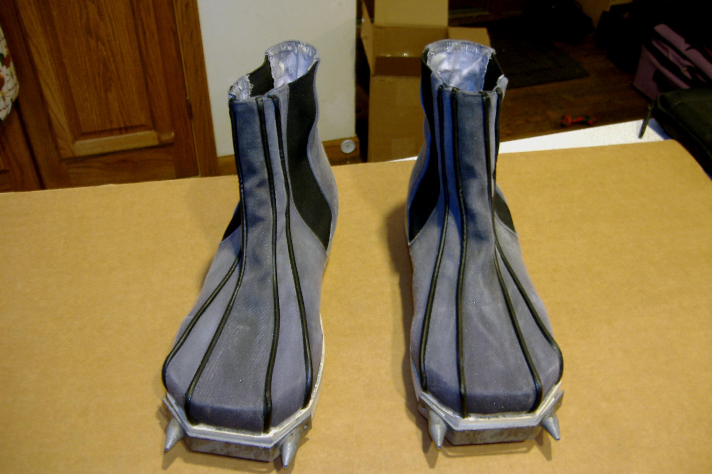

Started coloring my MOW 2013 boots as most know they come all white. I used an acrylic fabric paint by Tulip called Soft Matte. Most fabric paints require a heat setting where these don't. Used Spideyfett's tutorial. For the light gray I had to mix black & white till I got what I was looking for & dilluted it with water. Did the wet on wet, definitely helps with soaking the painting into the fabric. Just like painting with water colors. The black was just straight black diluted to give it a more watery consistency. Onto weather them next.

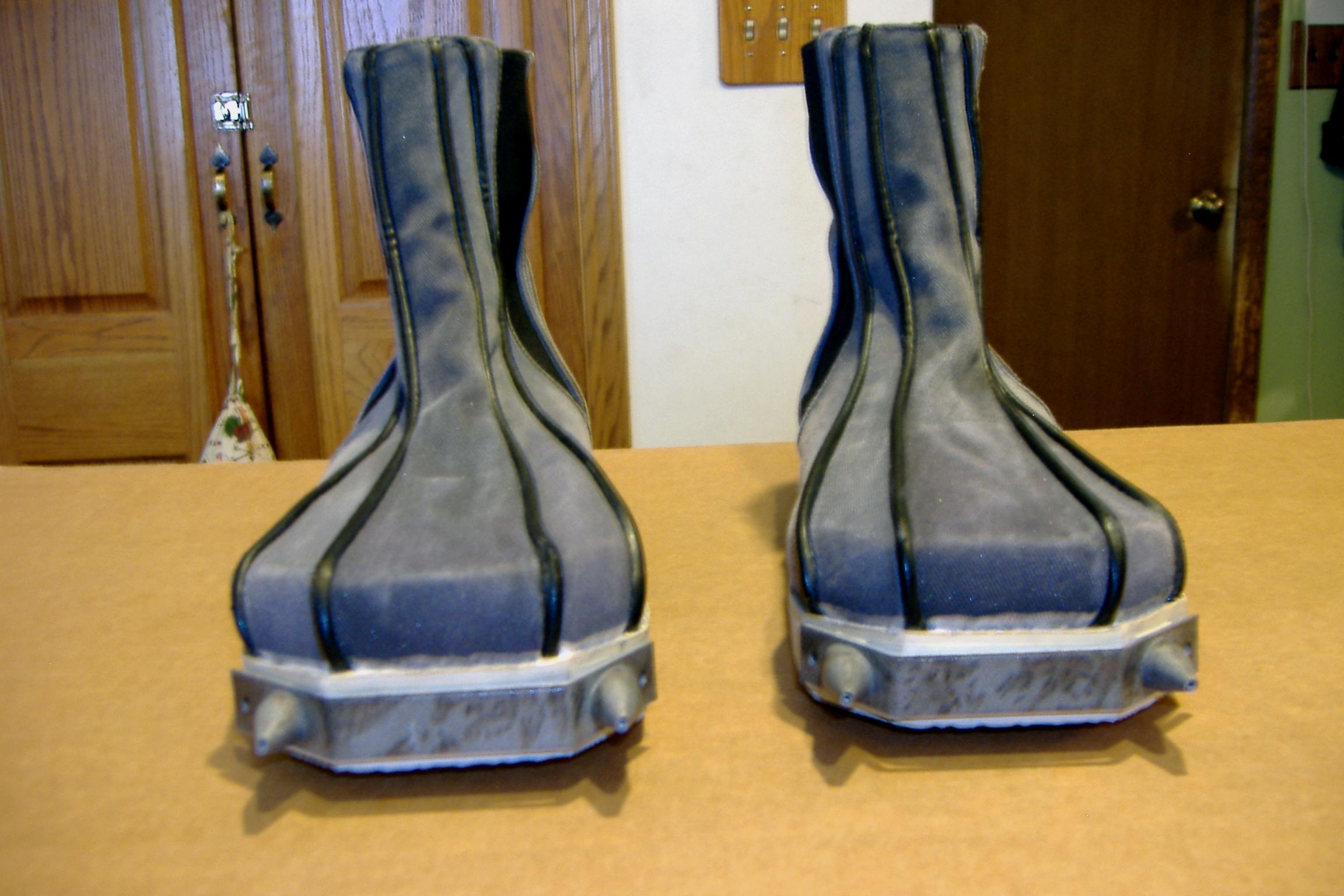

Boots & boot spikes are all weathered. Need to get some screws to attach the boot plate & spikes, they are taped on for a mock up. The boot plates & spikes are the ones that are 3D printed. The boot plates & spikes I went with the MOM tour look. Added some yellow, purple, black, some scuffing of sand paper for the weathering. Not sure if they need to be darker because lighting changes the look of them. Over all pretty happy with the look of them.
