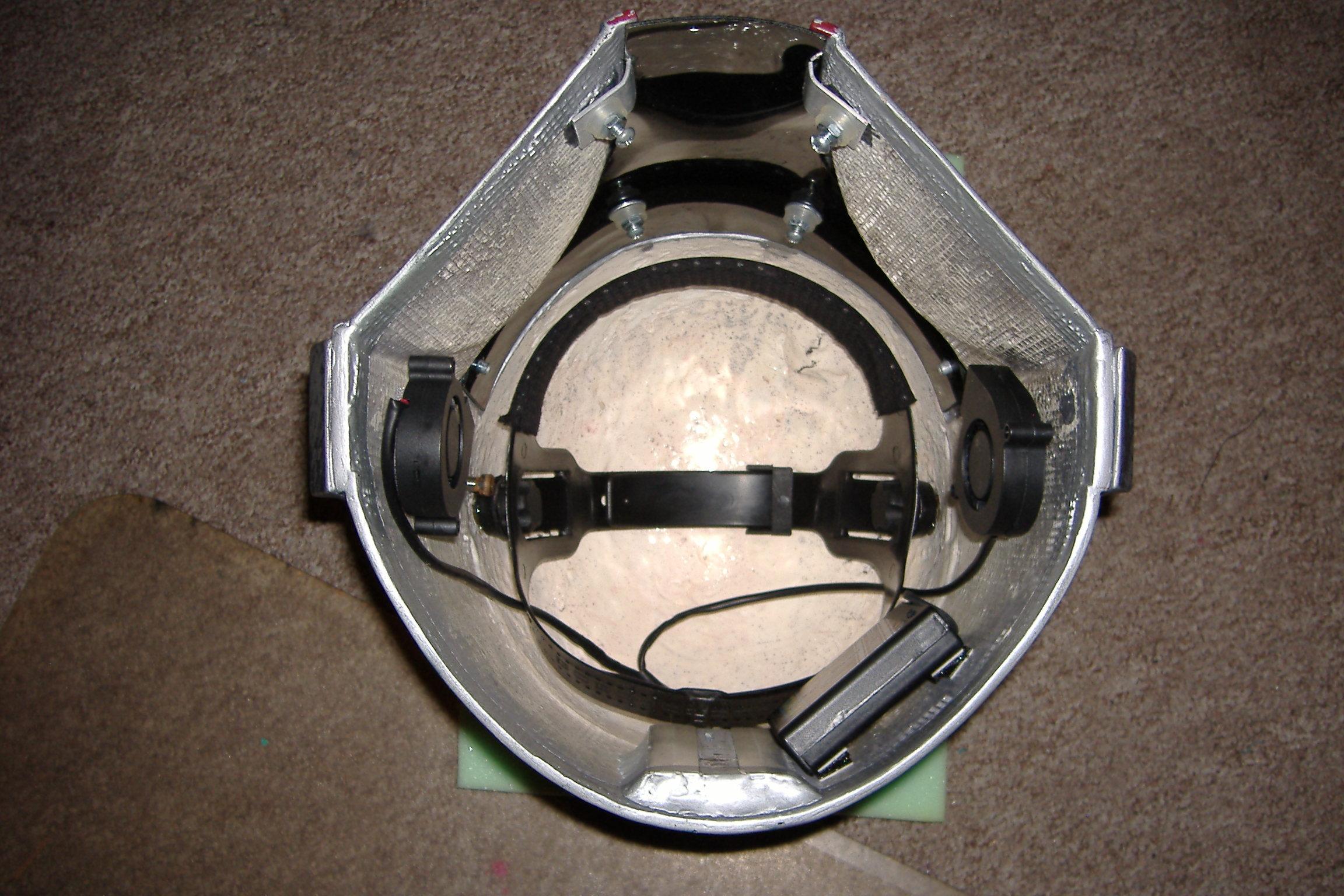

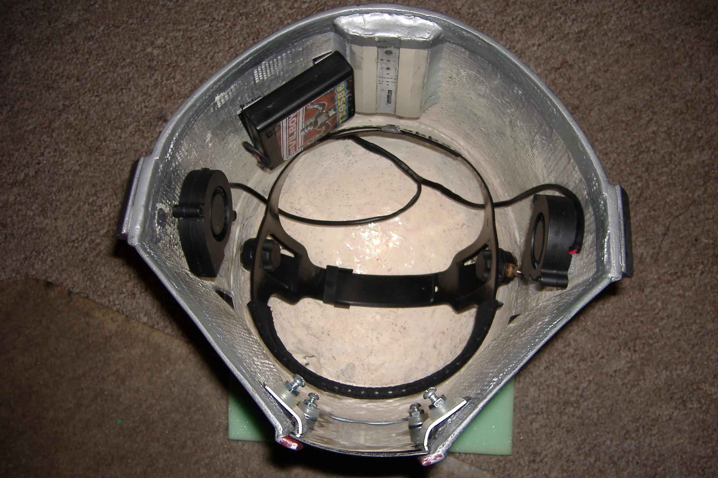

Got around to adding fans to my helmet. This is the kit from Evil Boy. The fans are pretty quiet but there is a little hum but nothing too bad. I would rather have the air circulating.
I used double lock velcro for the battery pack to keep it in position & an industrial velcro with "T" hooks that is used for hanging things on imperfect surfaces. Evil Boy does send velcro with the kit I just opted for something I thought would be more secure.
