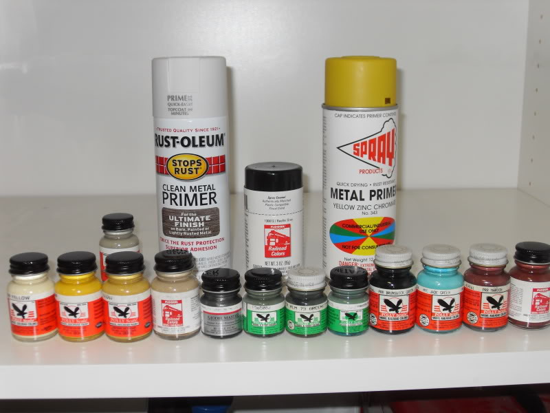

Weird... Mine is PollyScale, which is also Testors. It is dark, but it's very definitely green. Here are my accumulated Boba colours:
The "Ger RLM 73 Green" is 6th from the right.
Here's the link to the paint. It's a little lighter when airbrushed on, and lighter still when seen under strong set lighting.
