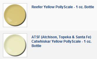

I have a question, though. I saw that the main colours for the shoulders and knees are these:
* Reefer Yellow (Shoulders and knees put on heavier on knees but not much this color gets darker the more you throw down).
* ATSF Catwhisker Yellow (Shoulders and knees the trim around the scratches).
I found them at testors, but they look way too light?

And now I see they don't ship to Europe. Is anyone willing to help a girl in need of paint? :)
Most vendors I´ve been in contact with will ship to Europe, but they won´t reimburse anything taken in customs.
And regarding customs, I have a friend who´s a customs officer and he said that they usually won´t bother confiscating such small amounts of paint. I got all my paints from the US... Oh, and there are European webshops selling these paints as well. PM sent.
Thanks! I've sent them a mail, and hopefully they will be helpful. I looked at the link you sent me, but couldn't find the right paint names when I searched? I have no clue on what numbers to search for, so I'll have to see if I can find a conversion chart or something. They had a lot of colours, so it looks promising if I can find the colours I need.
