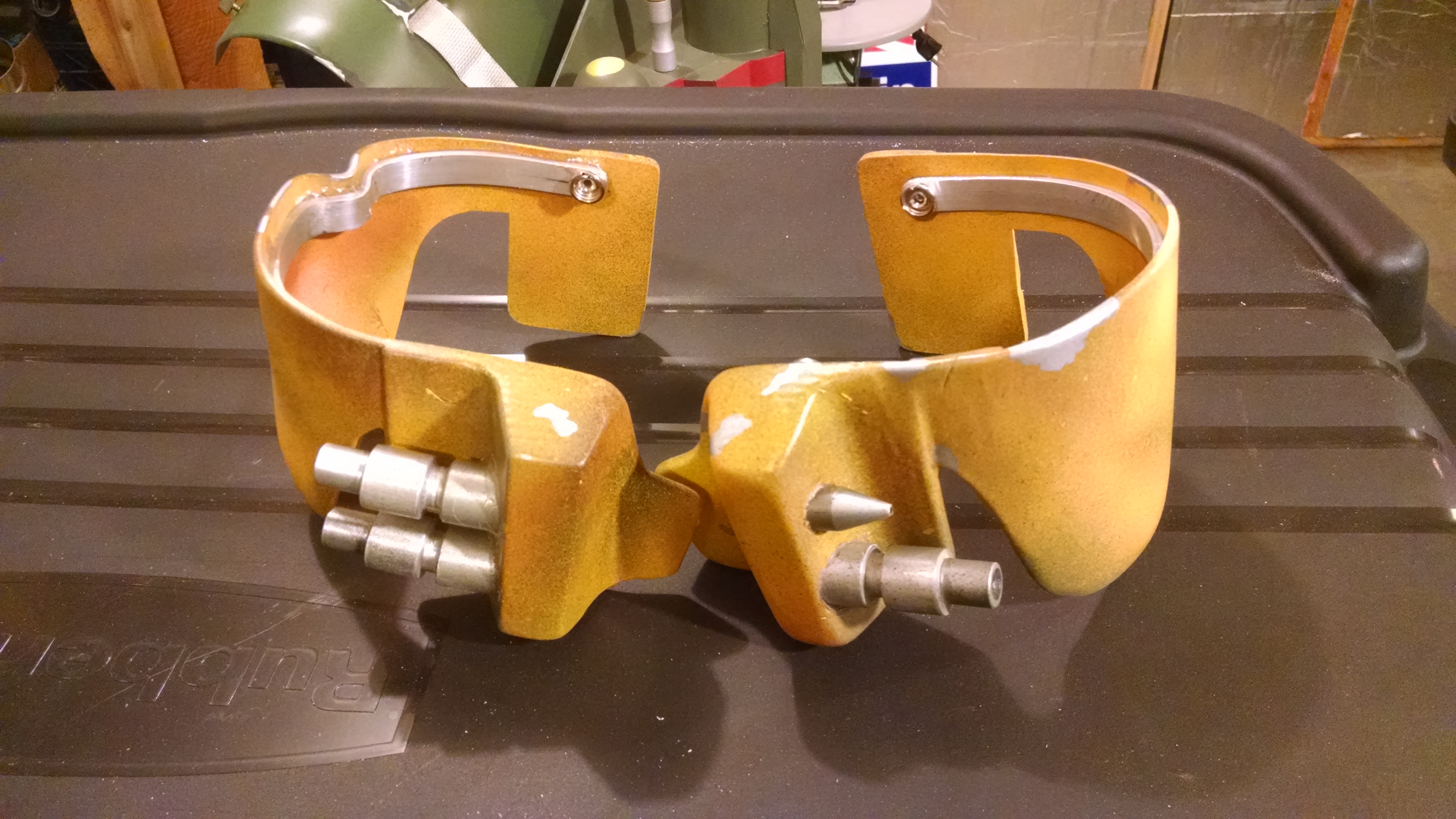

Might consider an aluminum bar bent to match the rim shape, glued to the inside. This is what I did to my knee armor, I dropped one and it broke so I reinforced it with aluminum glued with E6000.
