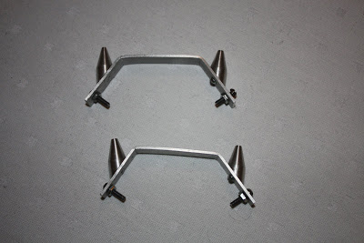

I had to mod my boot spikes to a smaller size, and to do that I had to dremel the screw heads off in order to get the spikes off. Any ideas on how to attach them again? I have seen a few Bobas with missing spikes, so I guess they fall off easily when you accidentally kick something, so I want to fasten them really good. :)
One modded, one not.

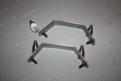

Both modded.
This is what I need to fasten again. ;)

I had to dremel them off to get the spikes off because it was impossible to unscrew them. That left me with some damaged screws I can't get out, and a big glueing issue. ;)

So, you are saying that your spikes have headless screws in them that you can not remove? Put the spike in a vise and cut the screw flush with the rear of the spike using a dremmel or grinder. Then, use a center punch to pop a divot in the center of what use to be the screw. Using a very small drill but suitable for metal, drill a small hole in the center of the lodged screw. Repeat with a slightly larger bit. Ideally you should be at the threads of the screw or just beyond. Reattach metal plate with self tapping screws slightly larger than the hole you made in the spike. At least, that's what I would do if you can't get a hold of the screw any other way, like say with needle nose pliers.

They were just too big, see the first picture. I shortened them a lot, and therefore needed to move the spike. Small feet, you know! :D
Thanks! I have bought some flexible metal glue and will check out what it does, but if (or when) it fails, I'll do your method. :D
