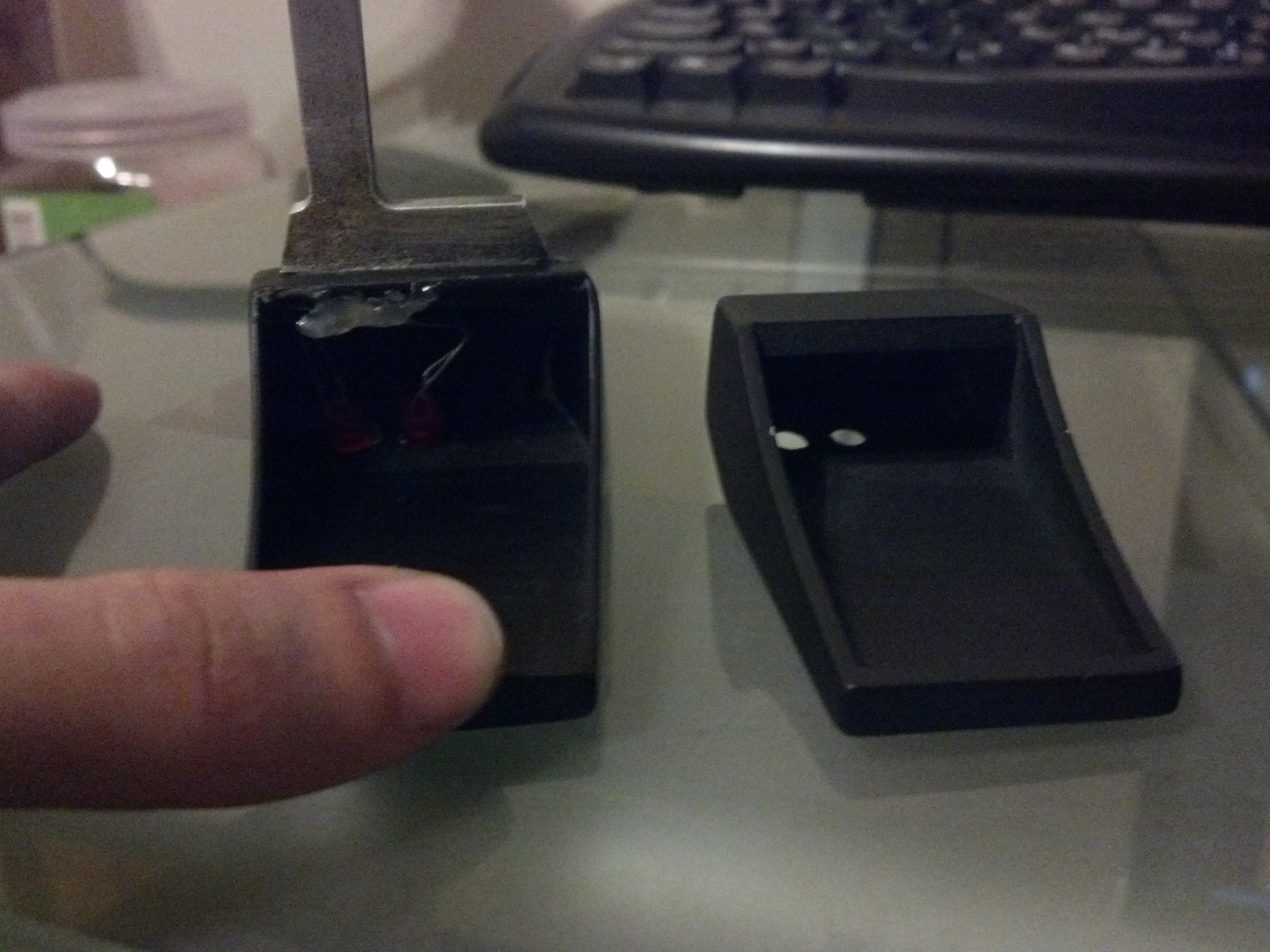

Thanks that will help. If you could take a pic of the inside that would be awesome. I need to check my circuit to see the dimensions but it should fit.

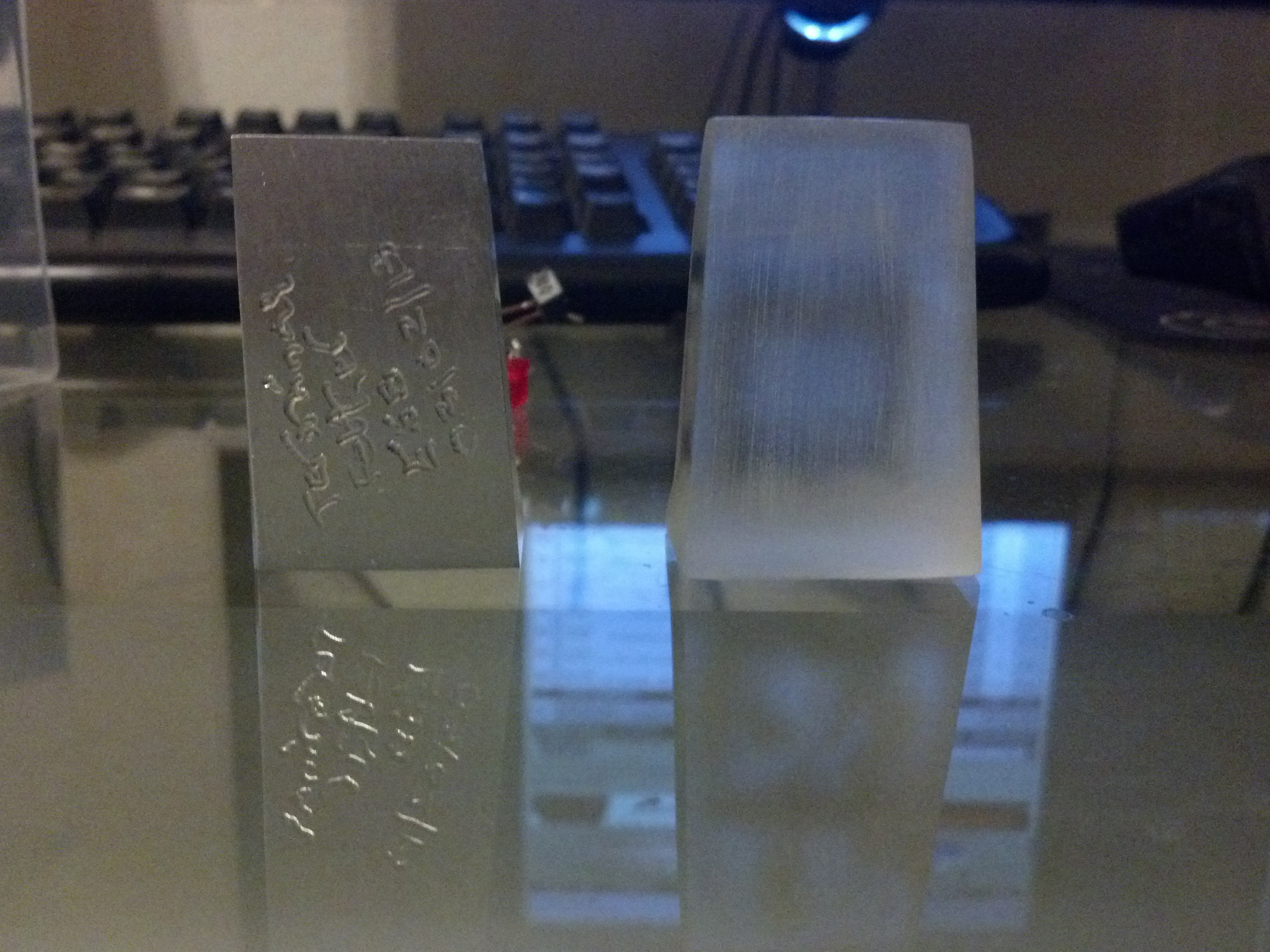

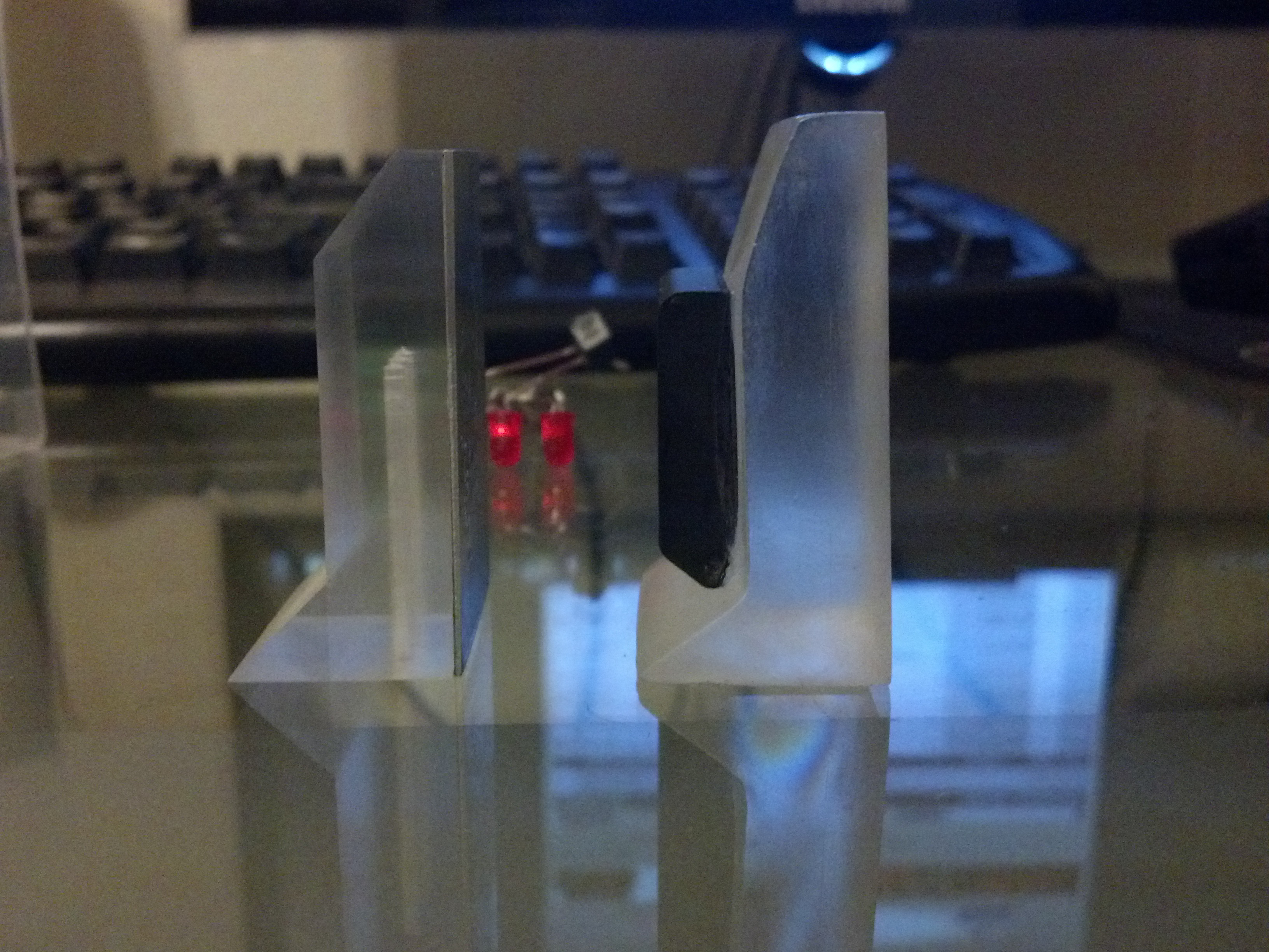

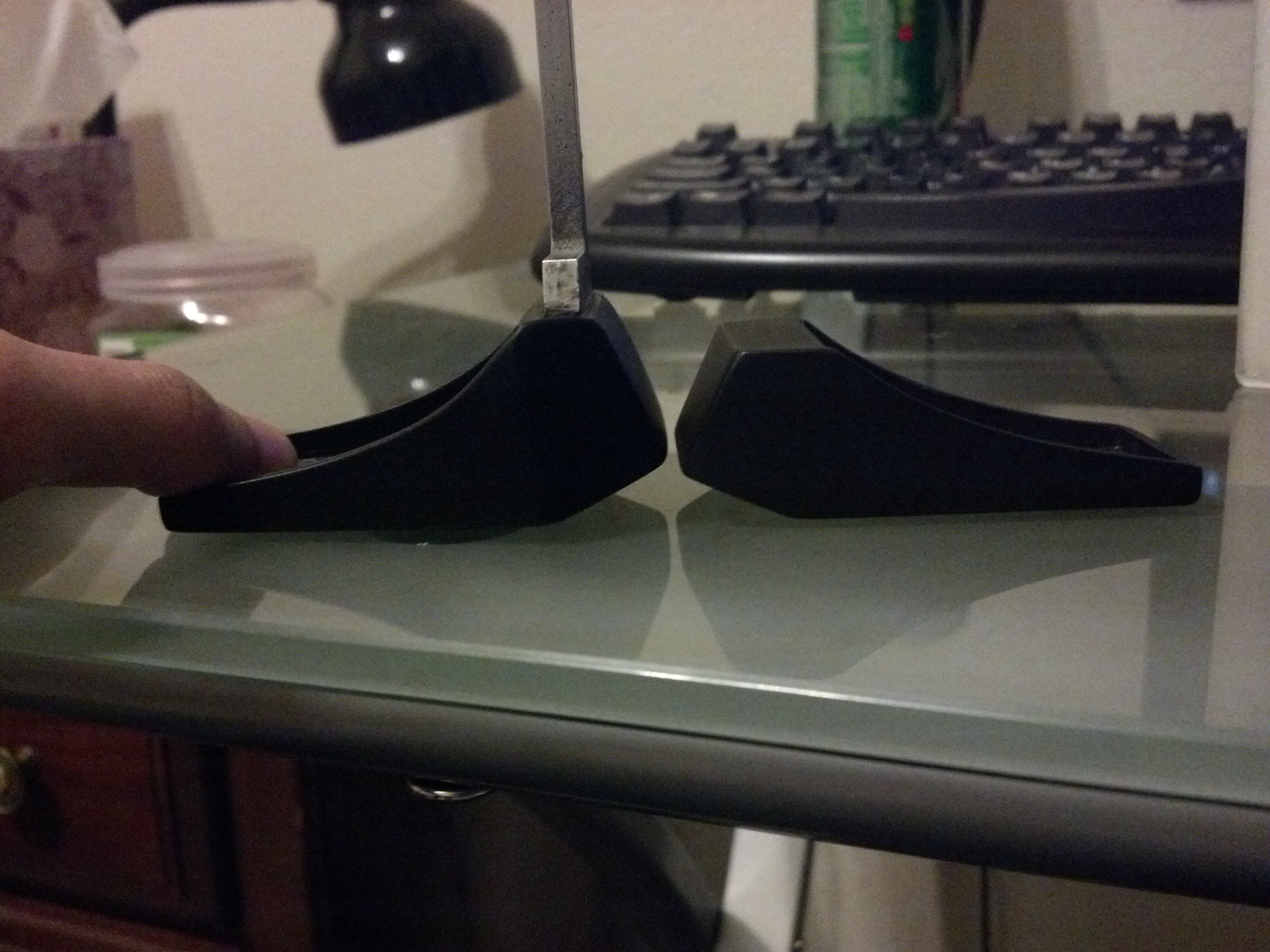

Heres a comparison between the TF Topper and a RS Props Topper which is similar to ASOK's size. I can't stress how nice the TF's toppers are. I've had them all in hand at one time or another but the TF really stuck out as the most accurate of them all in my honest opinion and his block and lens are very clear and clean. Sorry I wondered off topic there. But I hope these comparison pictures help you out.
if you need a better pic or something specific just lemme know
